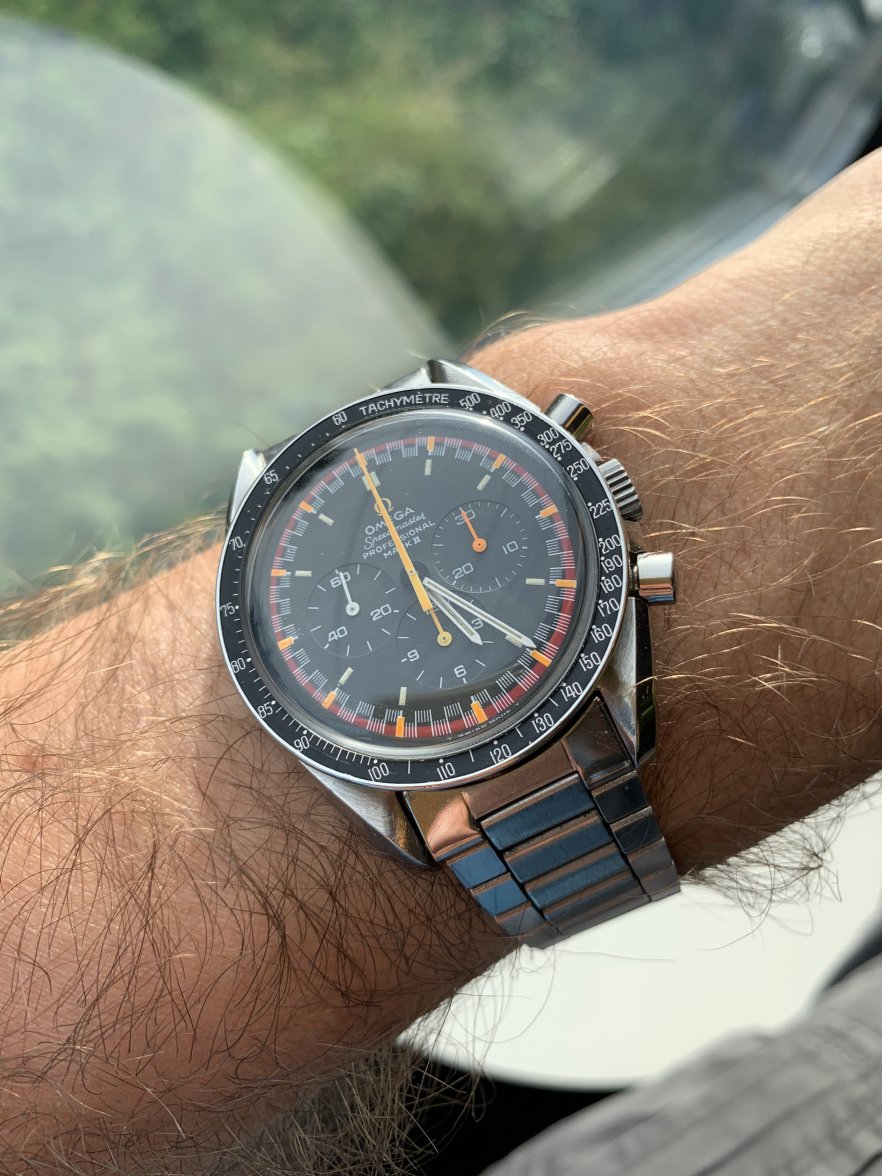

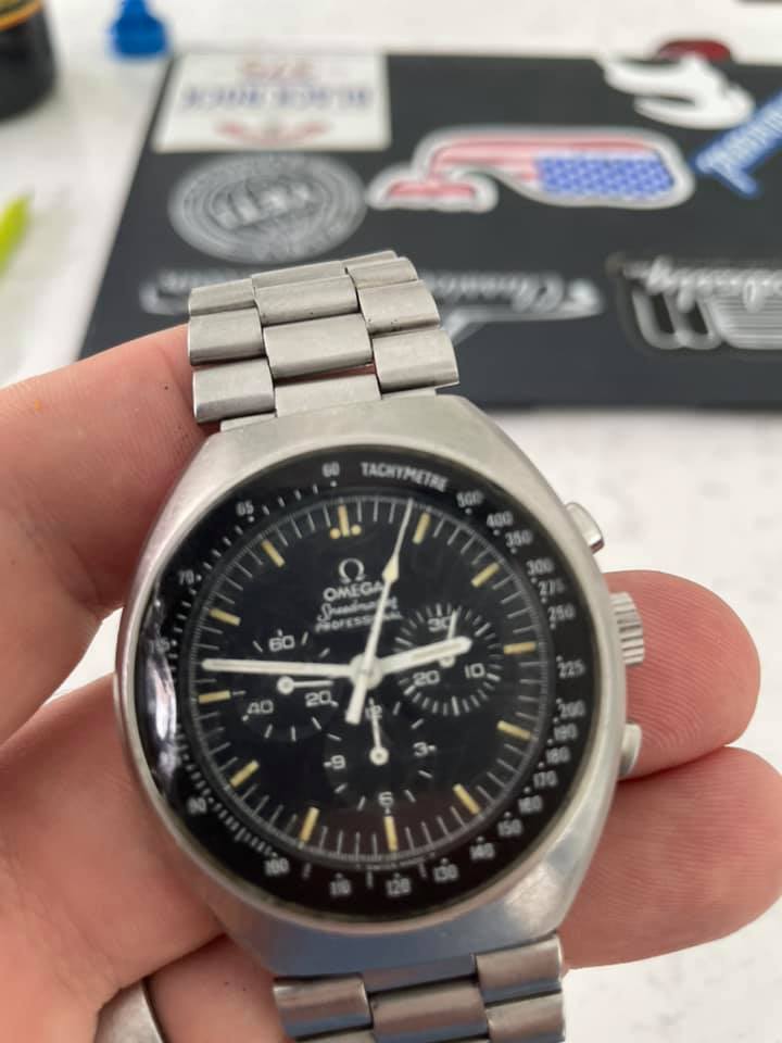

I'll just leave these pictures here, lets see who can figure out what exactly is wrong with it. If you know for sure at a glance give it 24 hours for the new guys to guess.
18,326
27,695
Seems to be going through a bit of an identity crisis. On multiple levels.
You can say that...
97
79
Ok, I'm a newbie so I will give it a go 🤦
So, The dial and hands are correct for the movement. But they don't belong in this case. Neither does the case back.
How did I do?
6,609
26,780
Technically speaking, yes… Both this dial and these hands are found on the 861 movement, but not at the same time. 😉
A little hint: if you zoom in on the dial text. This Speedy mod is common but in the other direction.
18,326
27,695

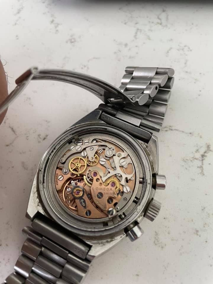

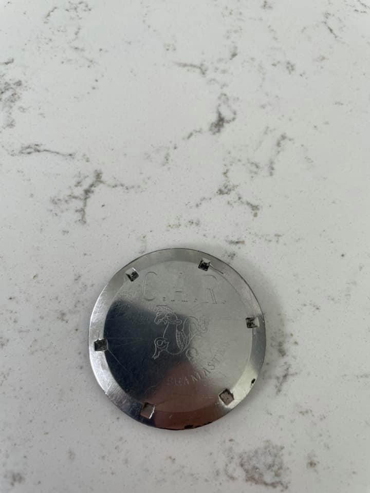

OK folks sit down....
Its a case back from a MK IV
A case from a MK II ( we think)
MK II hands
Post 1977 dial
Very early pre 71 861 movement.

Can you explain this for a newbie? (It's my watch)
1,372
2,001
@Dale3743, a run down on the composition of your watch from further up the thread.

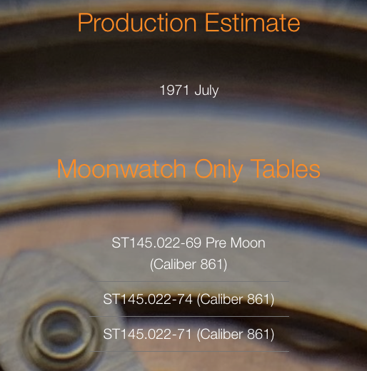

Well Foo,
You were pretty close. I ran the movement serial in ilovemyspeedmaster and got this

Well Foo,
Ahh, but do you know how I knew that without looking at a serial chart? It has nothing to do with the serial number. Your right I should have said 71 and earlier....
6,609
26,780
For lack of better terms, the brass/yellow colored gear train?
18,326
27,695
The metal brake. 😉
6,609
26,780
The metal brake. 😉
Bah!!🤦 Haha. I was looking at my 85 for reference and completely overlooked the brake. In my lighting the brake looked exactly the same material as the surrounding metal. Only when I zoomed in did it's (plastic) grey color go that typical plastic opaque color. Good job!
