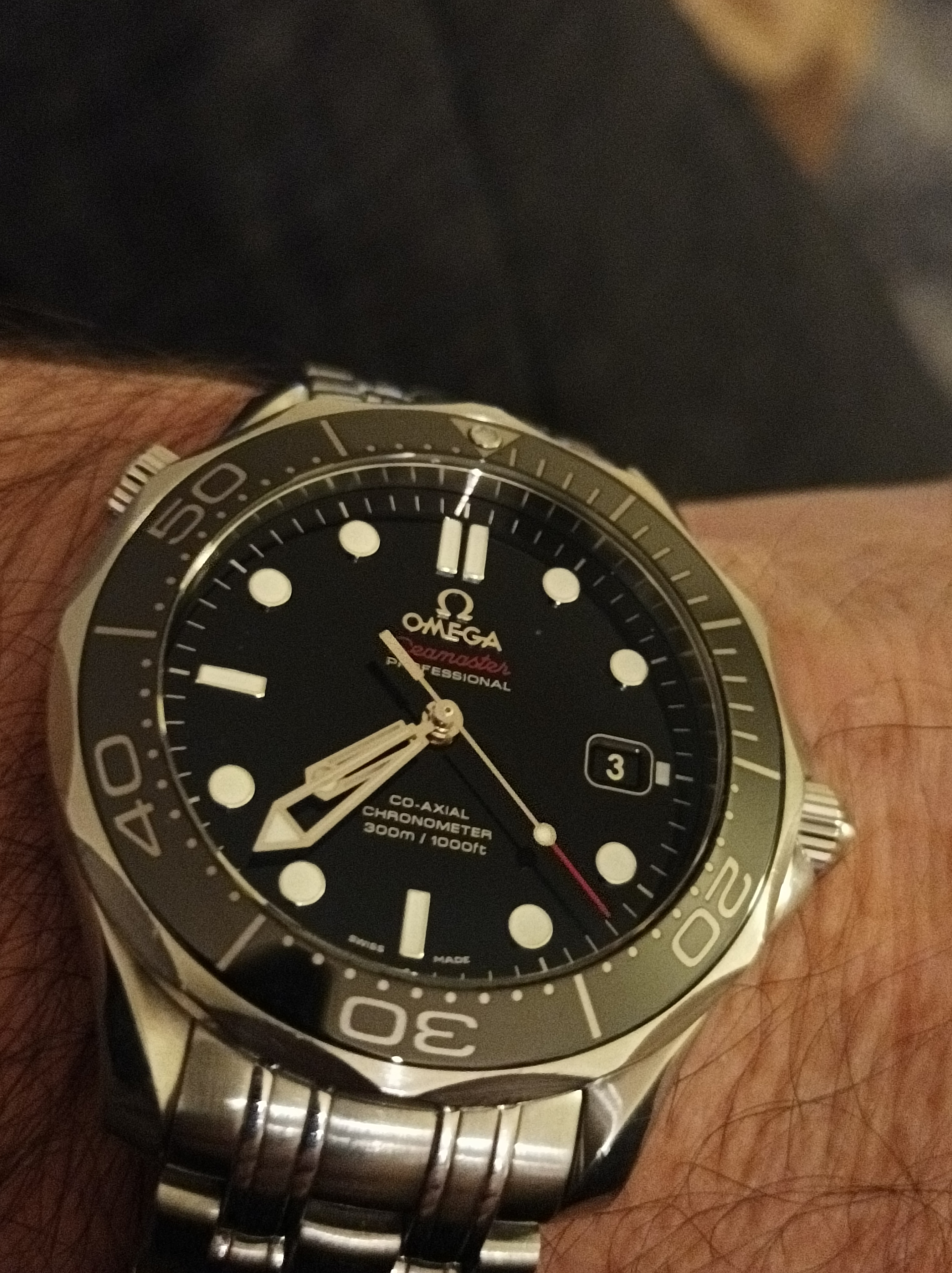

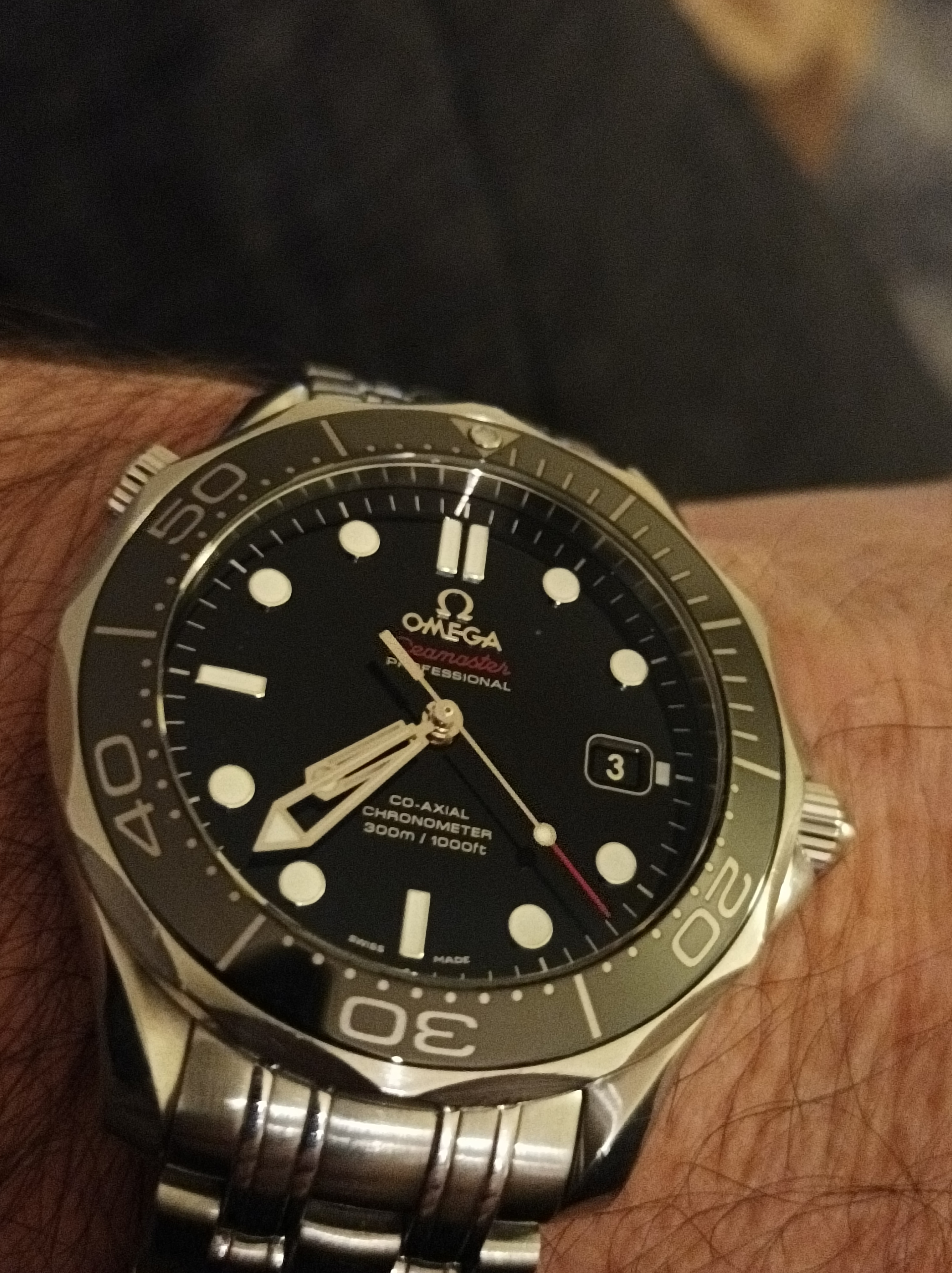

My early 2016 SMP300 with the 2500D co axial movement, completely fault free in my 7 years of ownership, fairly hard work as well, I race and cruse yachts, and this one has many miles covered, not to mention daily wear and tear, basically it's no safe queen.
I’ve had a great experience with the same model. Mine is the 2017 SMPc with the co-axial caliber 2500D. Now going into its 7th year with no issues. Added to that, it still looks brand new and, as Marisa Tomei would say, it’s dead on balls accurate. Great watch.
