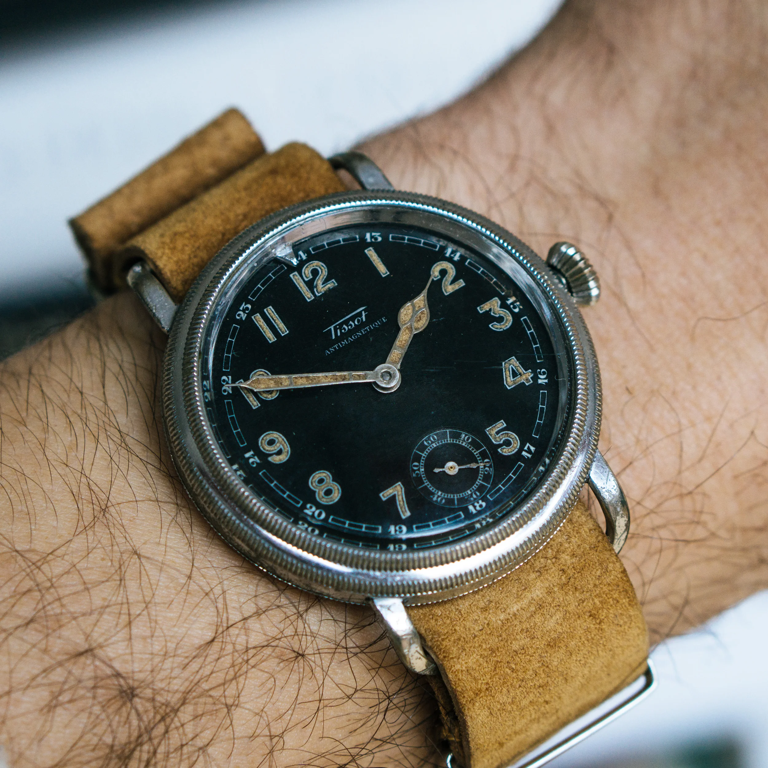

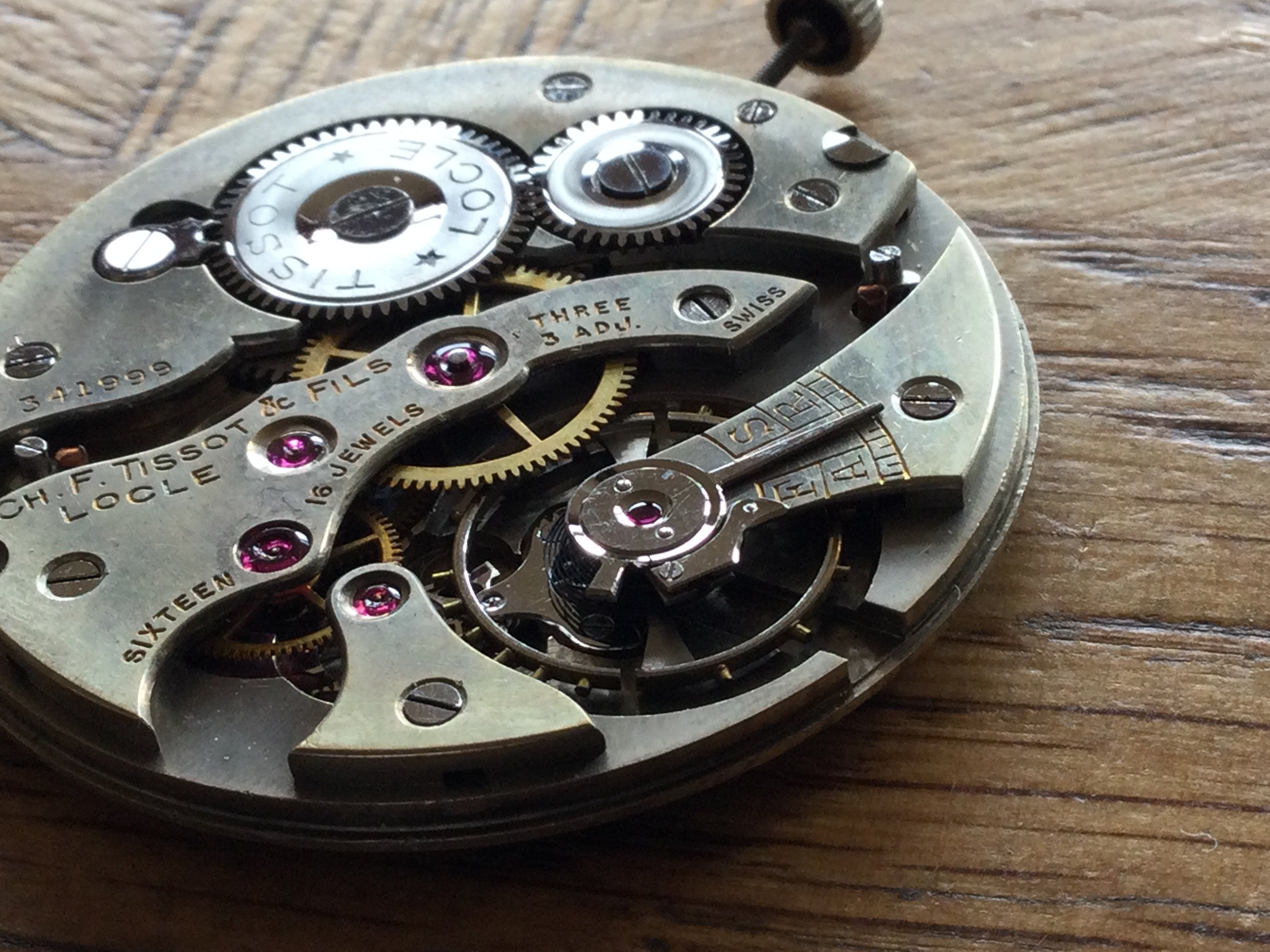

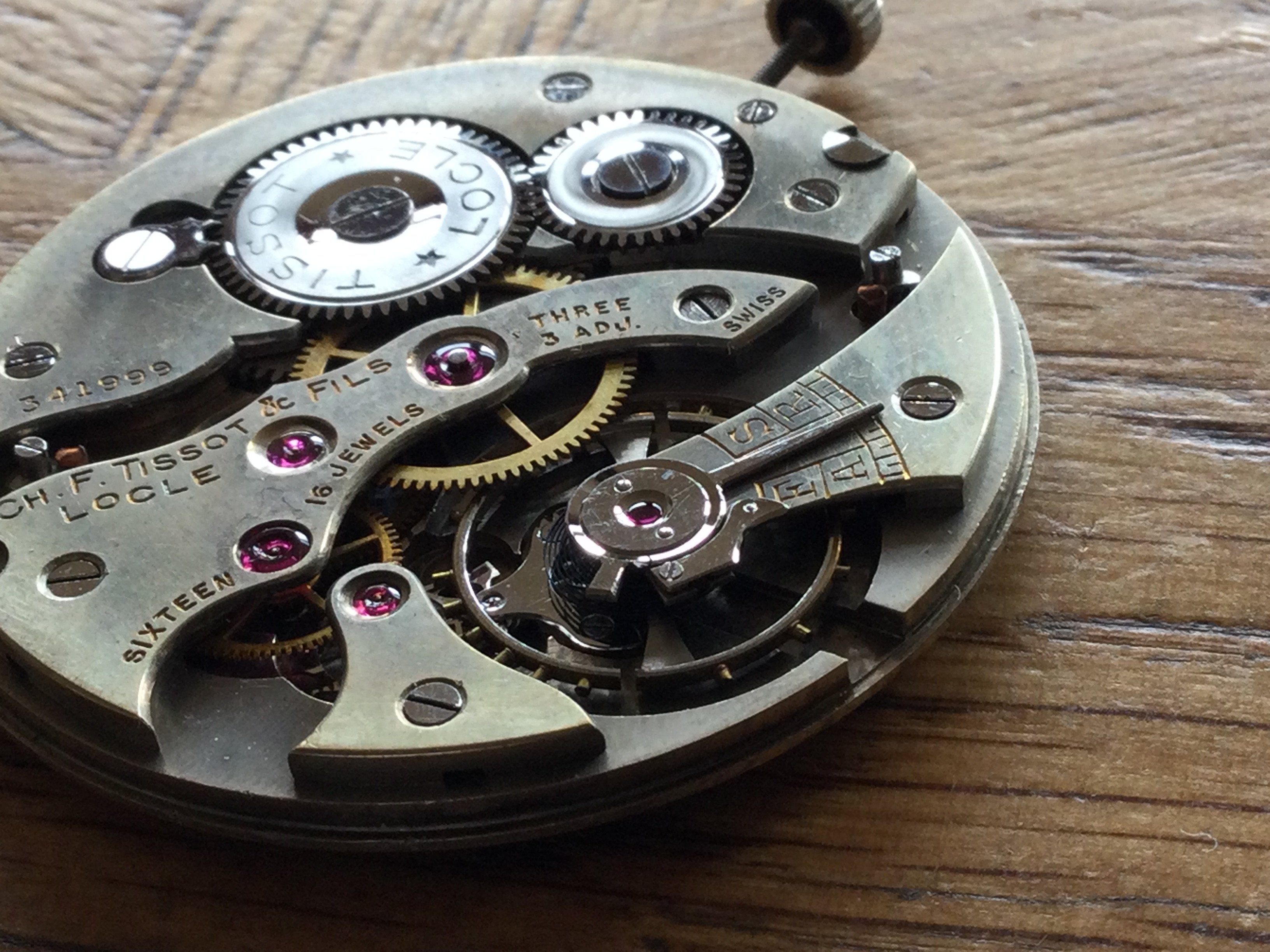

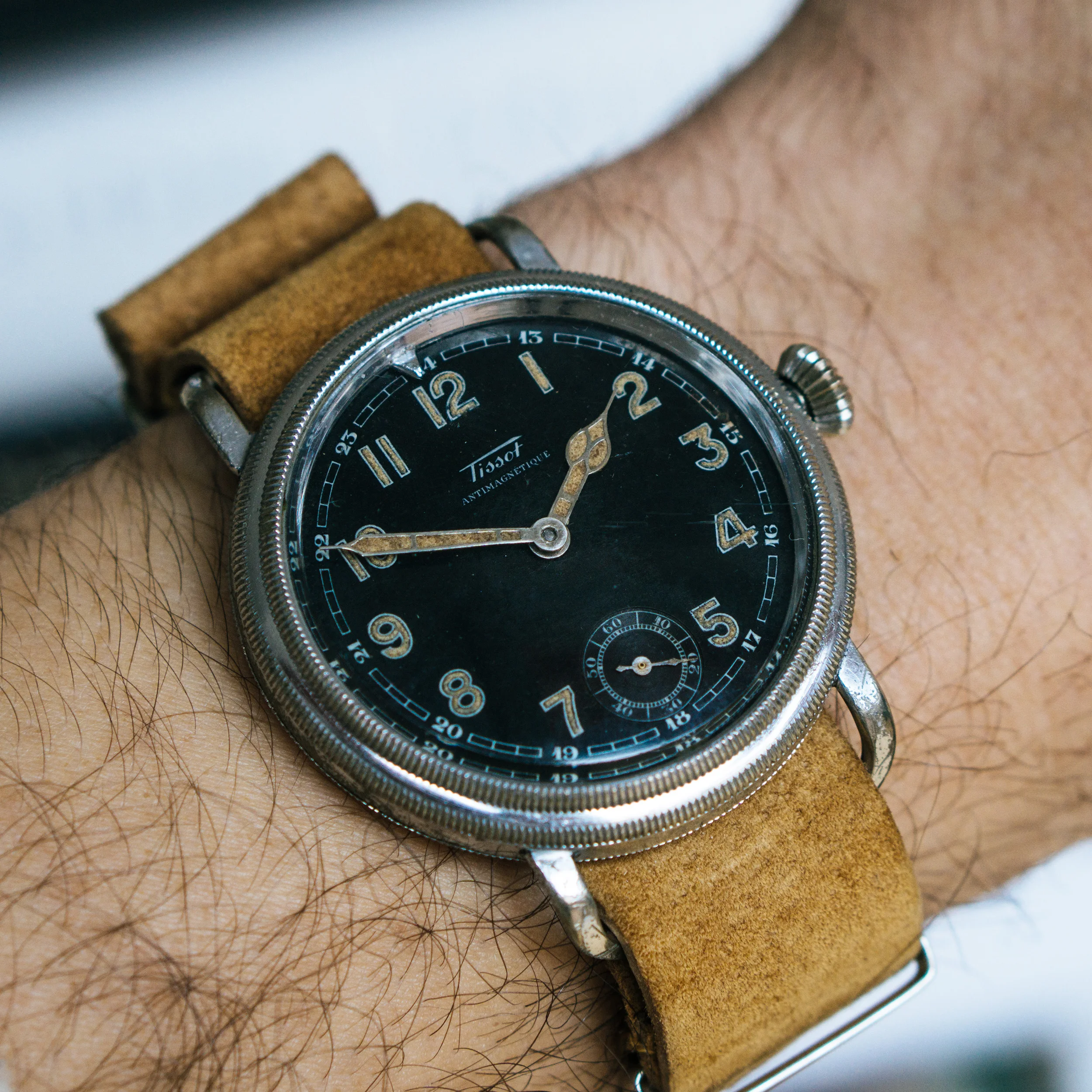

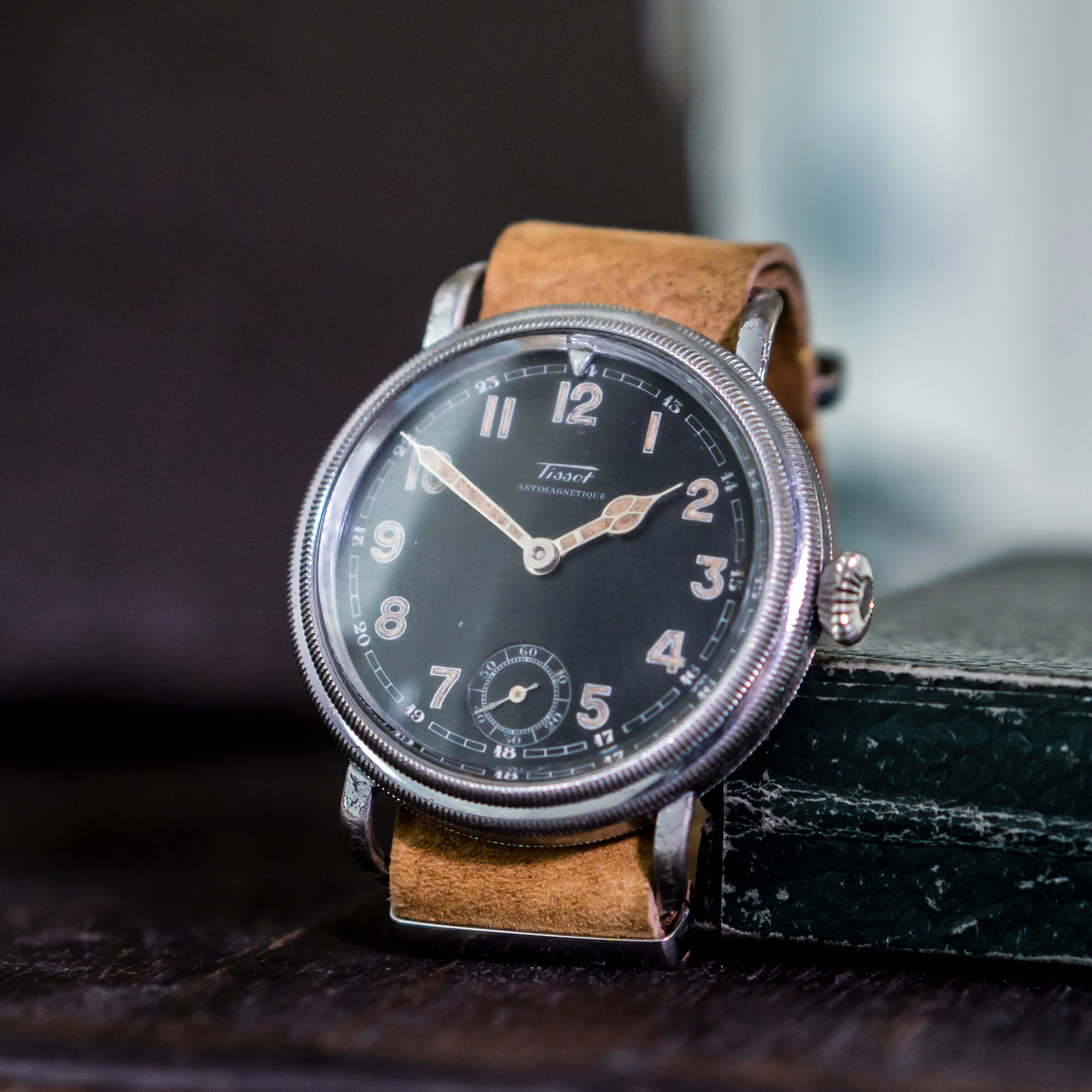

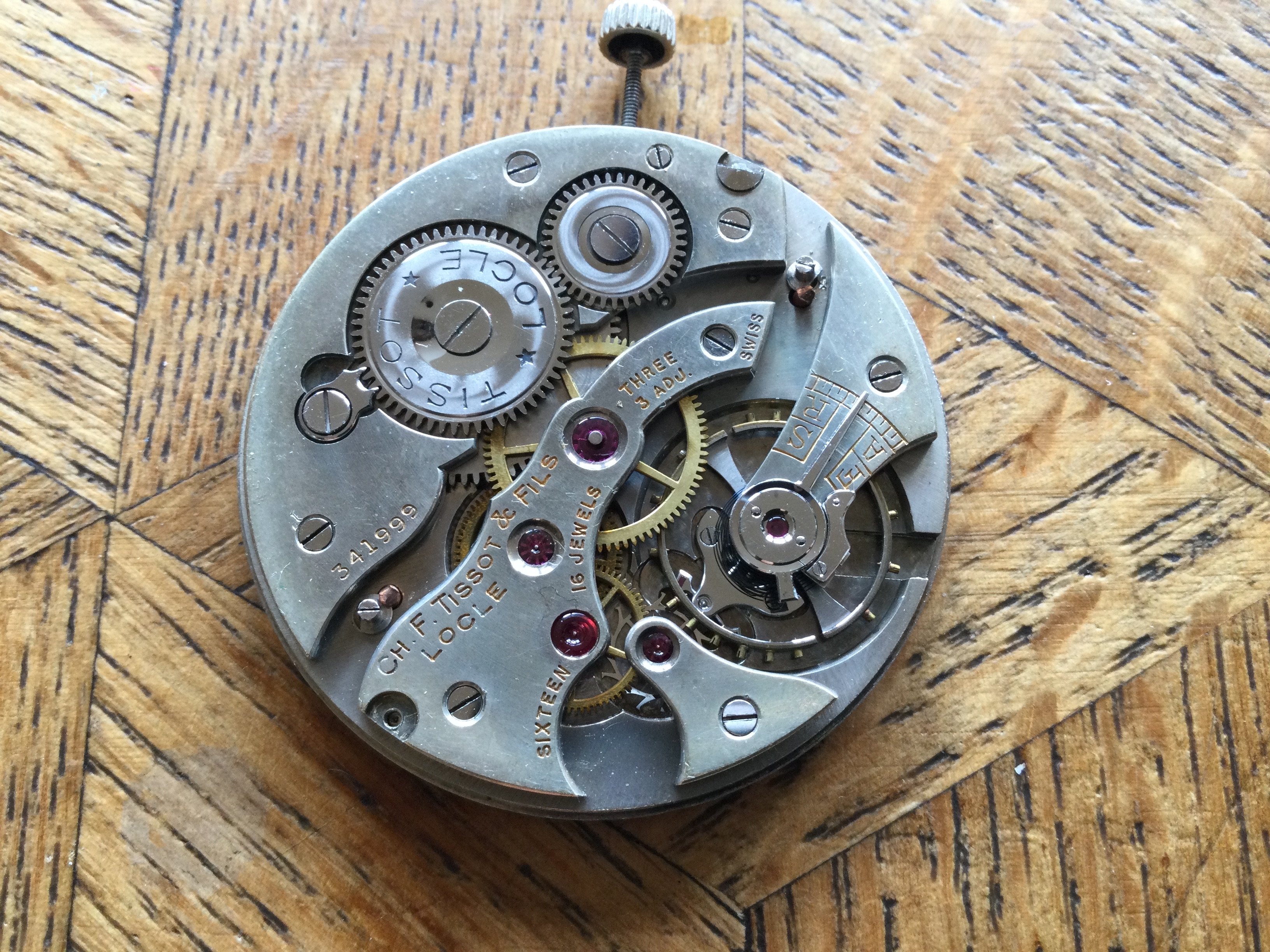

Took the watch out for some daylight. The minute hand was shortened a bit too. Watch is running, but balance is not really good. If someone of you know of a donor movement with intact balance, hook me up please 😀
Great thread !
I made a research and could not find any info on the 39.3 movement anywhere. So I guess you used a different movement for parts, probably from pocket watches. Most pocket watches from that era have a 38.2 movement with flat hairspring. So when asking for a donor movement, what movement are you refering to ?

I see your watch has a breguet hairspring, so maybe this could fit ?
To my Knowledge the Cal. 115 would be the best fit. Thanks for your help! The Movement you show is a Cal. 225, correct? Unfortunately they are thinner, so its unlikely the balance will fit 🙁

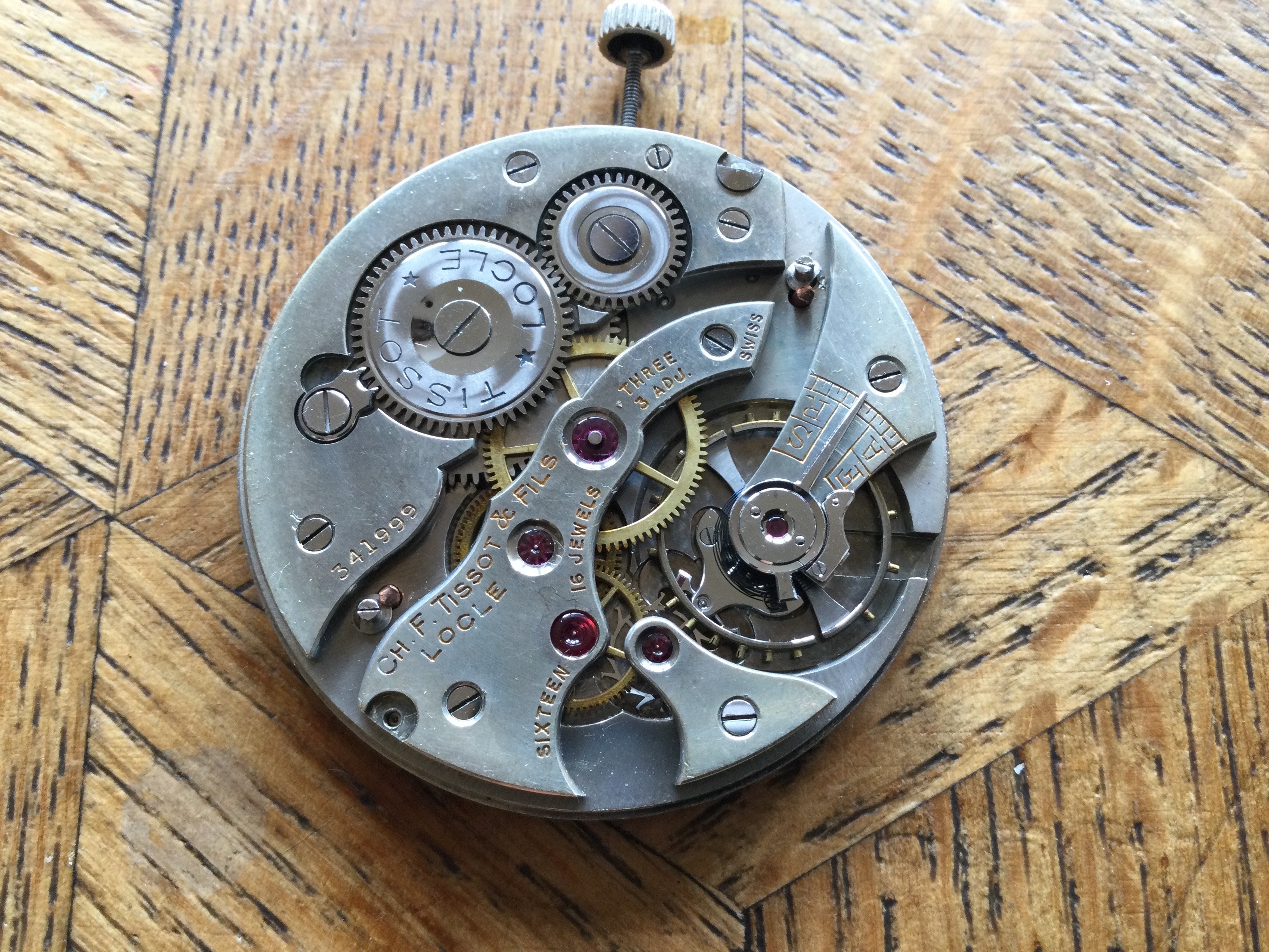

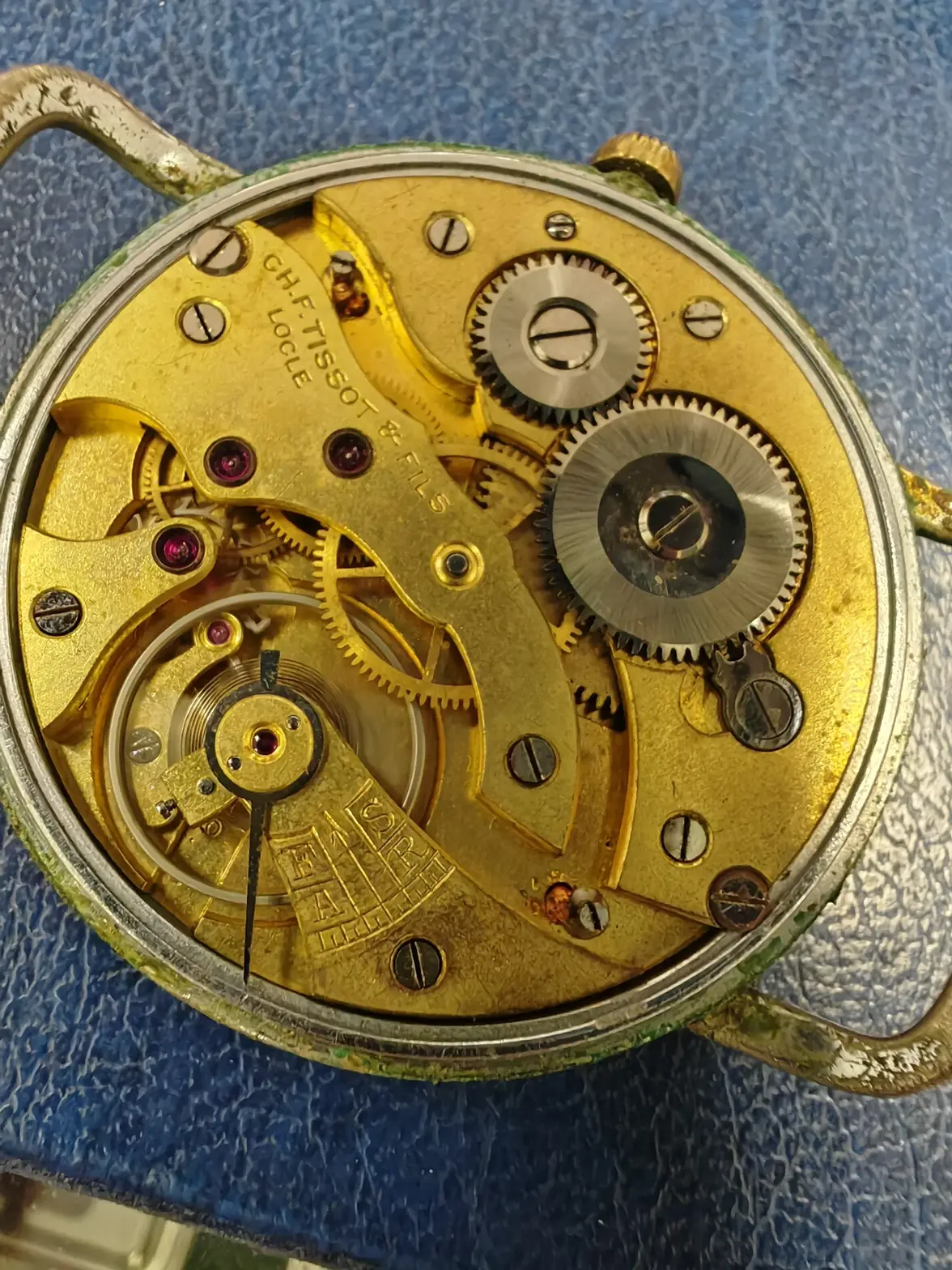

According to litterature there are basically the 17, 18 and 19 lignes movements. Those movements are later called 38.2 : 17" , flat hairspring 38.2A: 17" , Breguet hairspring, 40.5 : 18" , flat hairspring and 43 : 19".
From what I understand, 38,2 , 40.5 and 43 have the new bridge layout.
Your movement has the old layout so is linked to the 17", 18", 19" family of movement.
I have found in a balance staff catalogue in which the 18" is the 115 and the 210 using two different balance staffs.
Finally, those movements are often not marked.
Quite a mess !

Indeed! Maybe @Vitezi can confirm? I am a bit confused right now 😁 Thanks for helping Omegastar!

I would try buying a same size movement with the old bridge layout and a breguet hairspring balance.

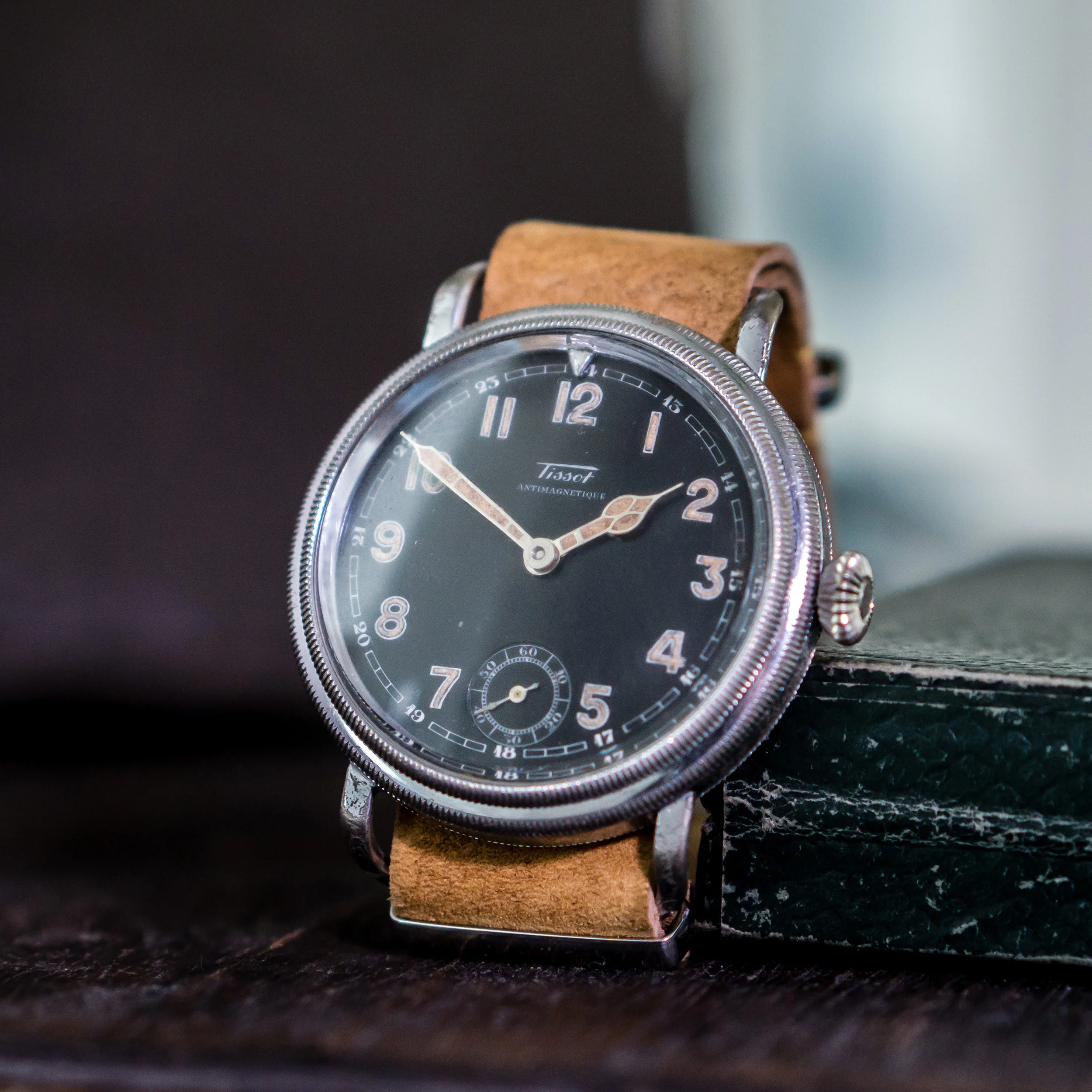

Took me some time, but now the watch has a new balance and is working like a charme.

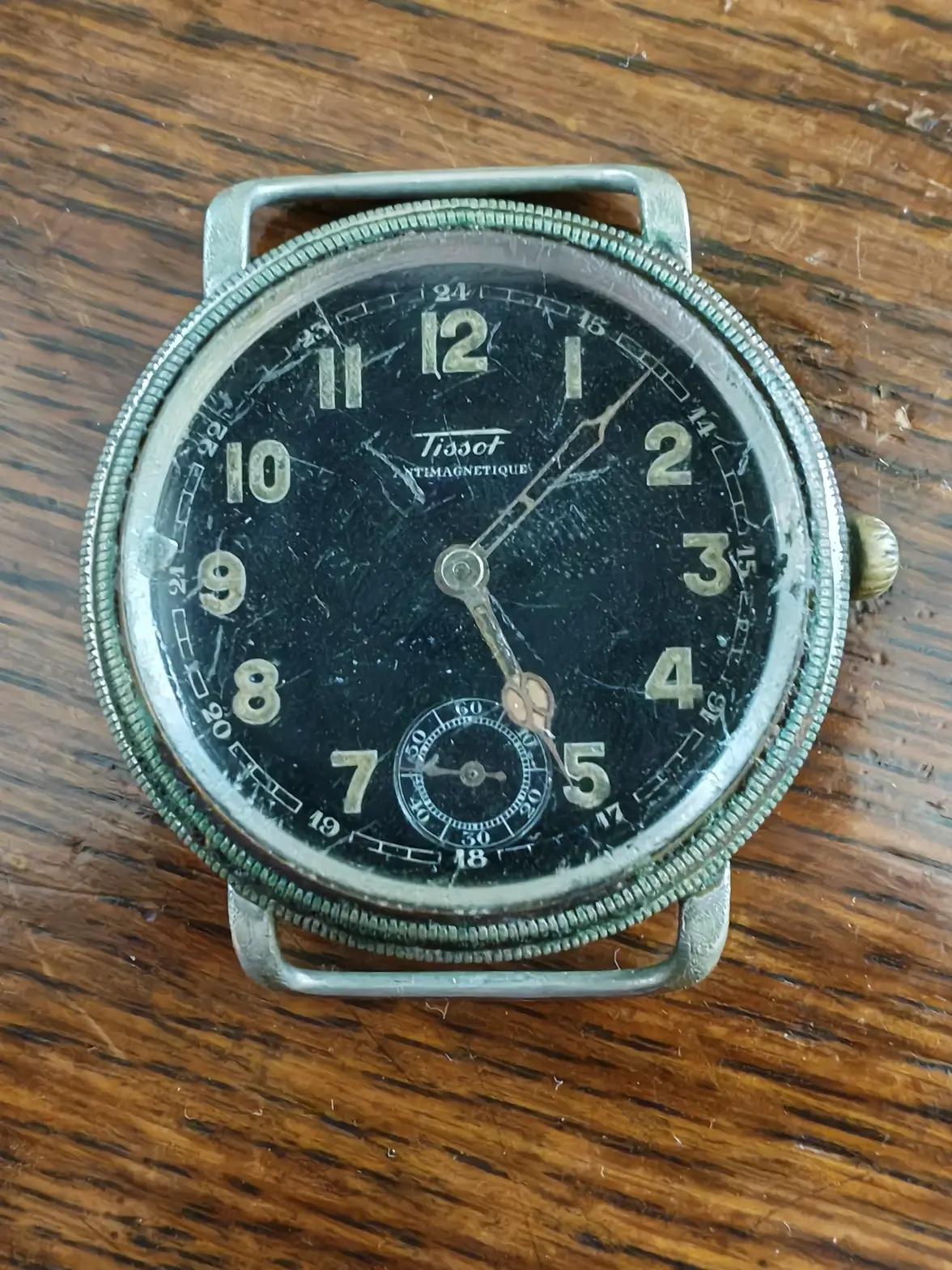

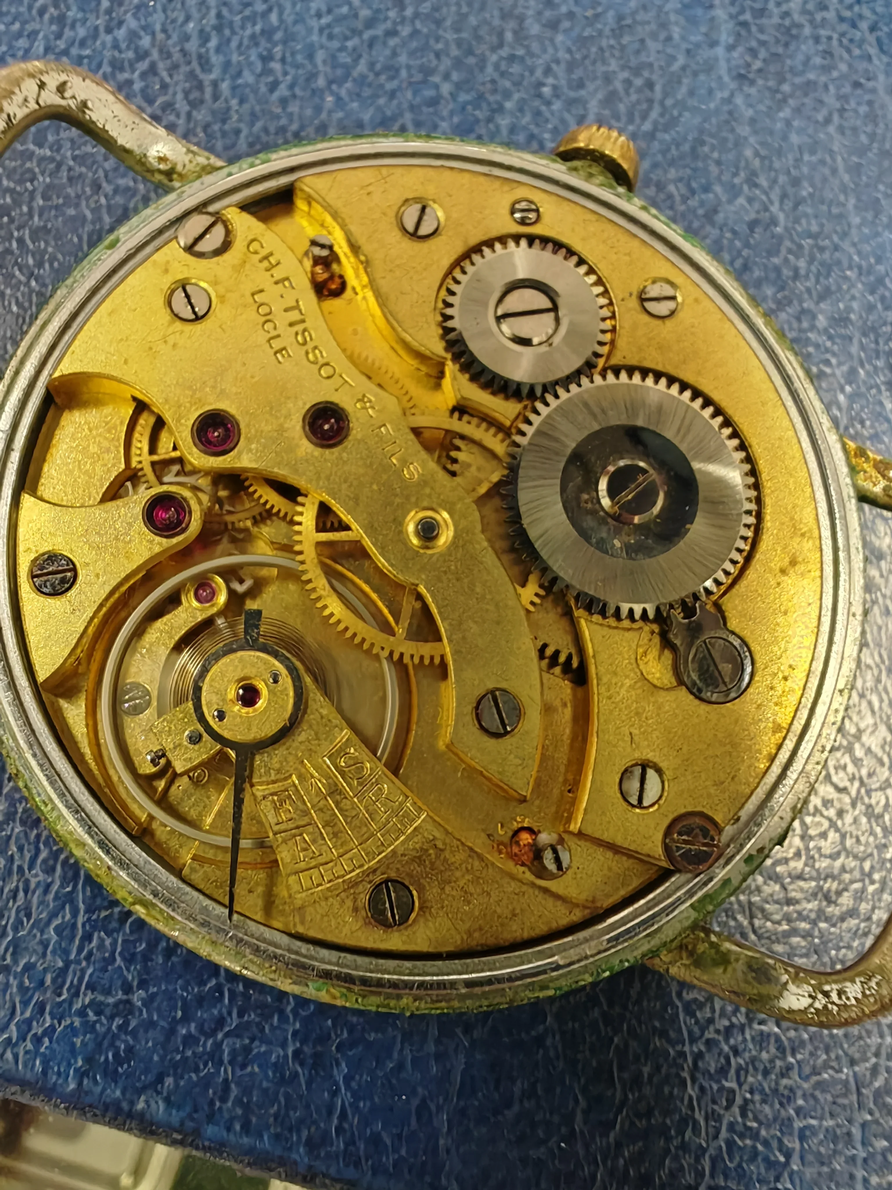

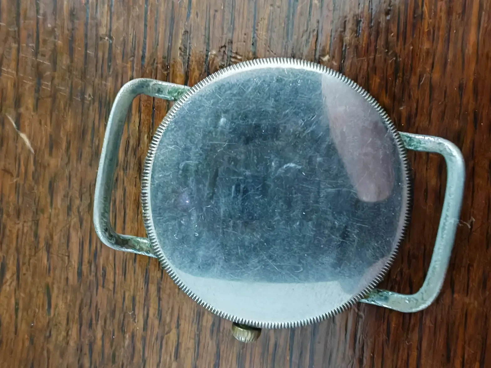

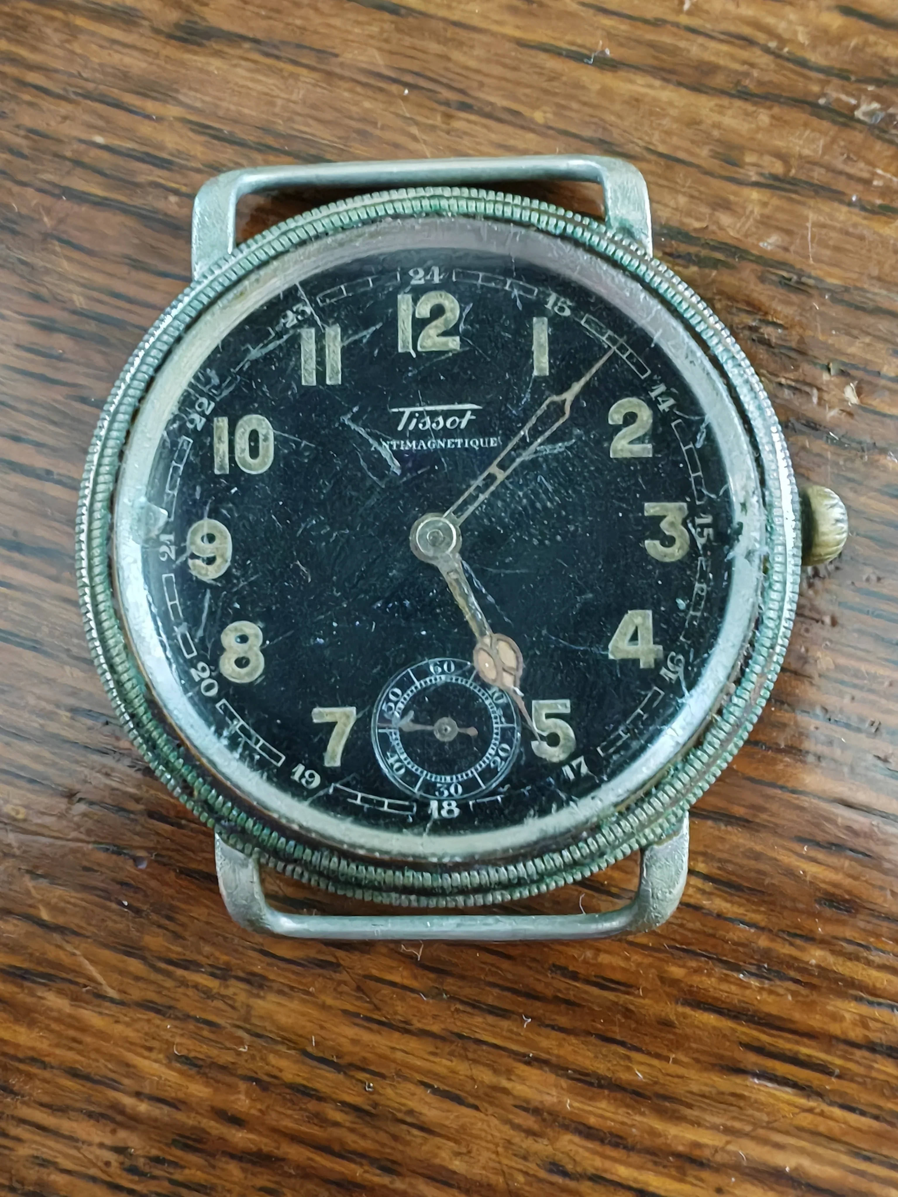

Wow, yesterday a guy from Serbia contacted me with another Jumbo Flieger, just 4 numbers away from mine (805415 vs. 805419). The watch is in his family ever since (or at least as long as he can remember).
I am allowed to show some pics. Cool to know that mine is not alone and I guess we can say that regarding to the serial at least 5 (10?) other watches will exist.
