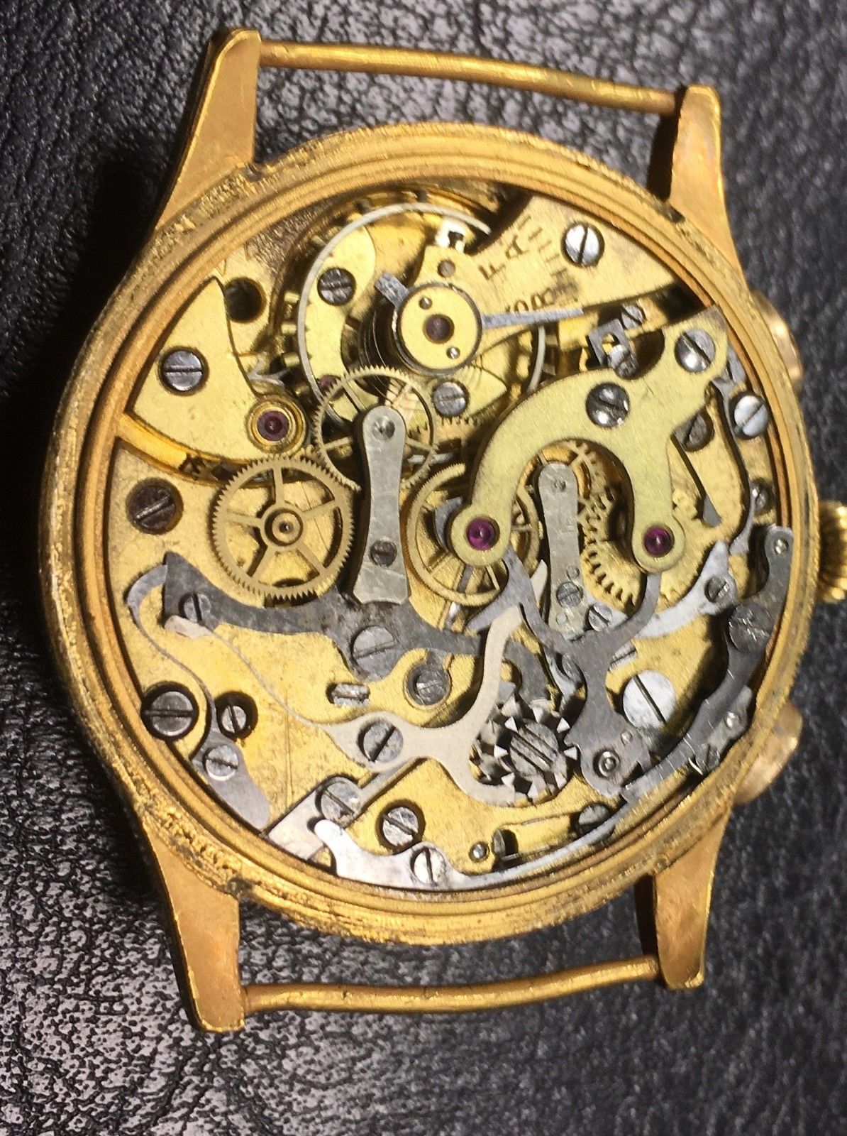

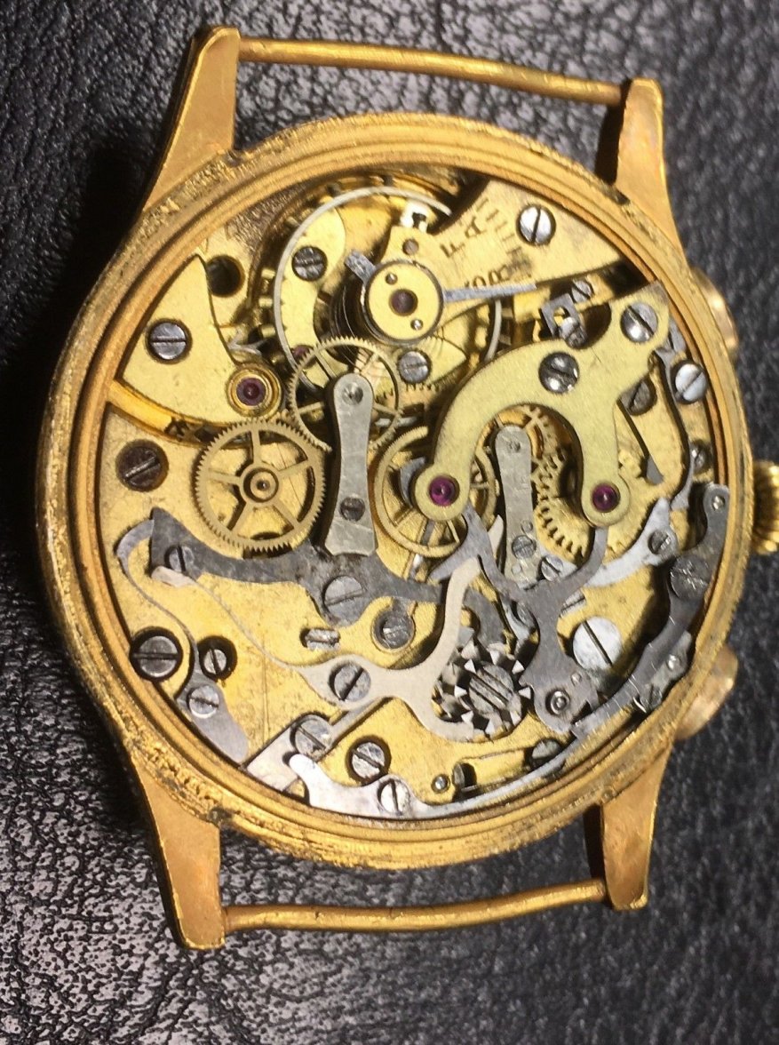

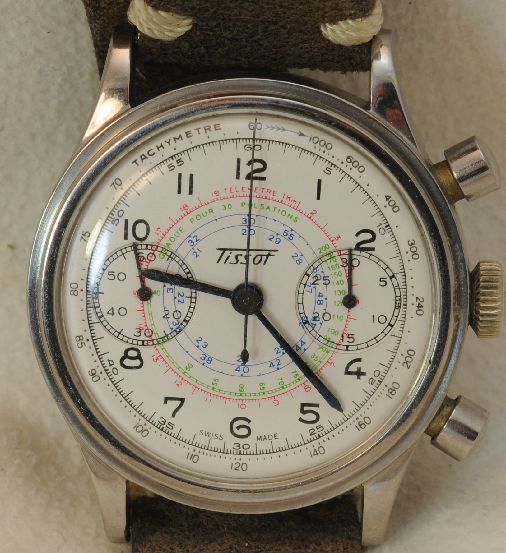

    Hey Guys,
    I need some help figuring out what I have here...and if this watch is correct or franken..
    case approx. 38mm
    Your thoughts and criticism are welcomed-
    TIA
    Todd
    DSC_8826.JPG DSC_8827.JPG DSC_8828.JPG DSC_8822.JPG DSC_8823.JPG DSC_8824.JPG DSC_8825.JPG

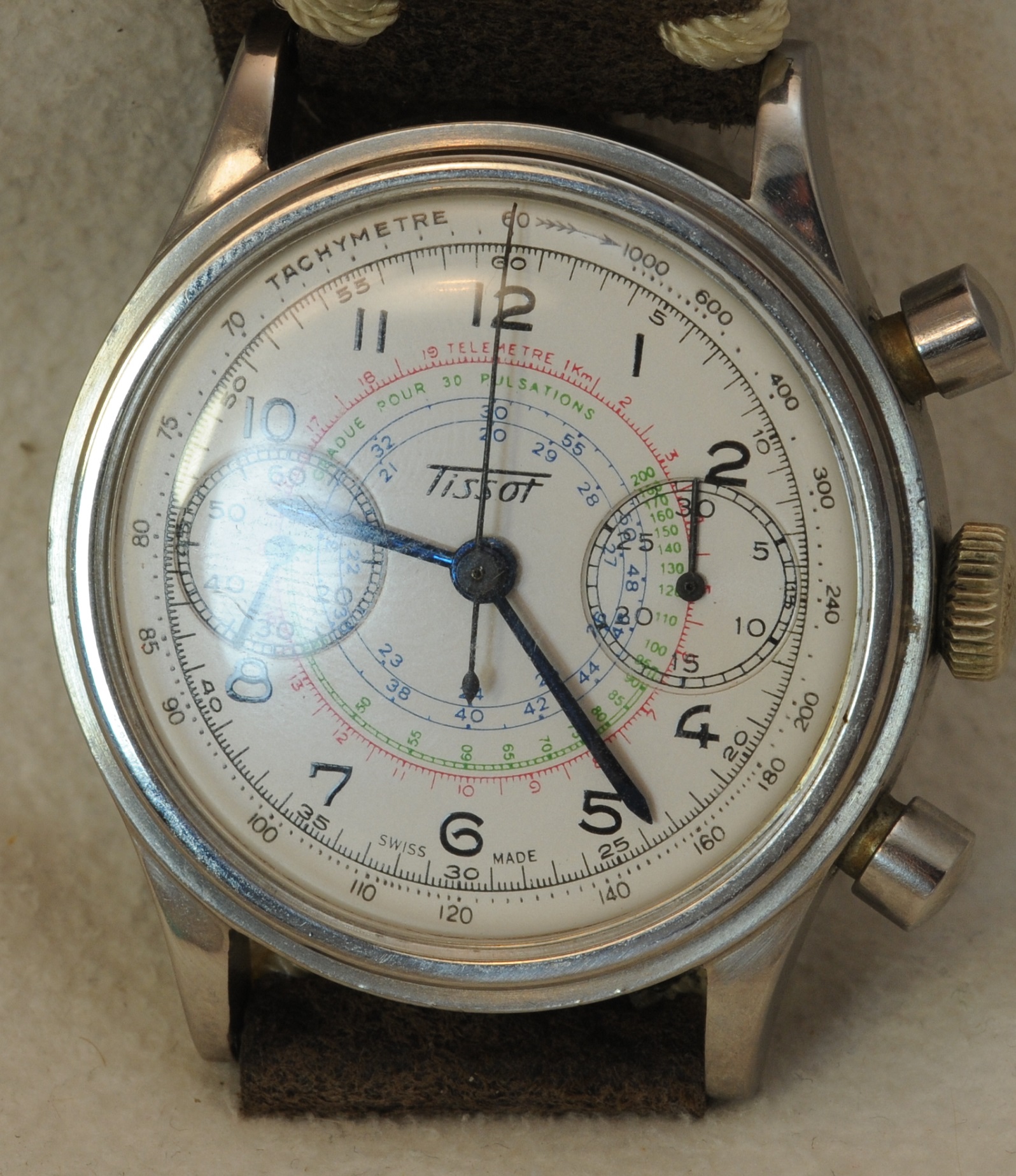

    Looking at the macro makes me think redial....
    The more I look makes me think bad redial.....oh well..

  3. sdre Mar 9, 2019
    2,460
    7,449
    I thought the 5s and 2s in the subdials don't look consistent. I believe the tissot font looks too thick as well?
    My 2 cents.
  4. tmw57 Mar 10, 2019
    1,426
    5,430
    yes, and the minute track has an inconsistent thickness..
    anyone else?
  5. Blaise Mar 10, 2019
    234
    401
    100% redial, albeit not a bad one. The Telemeter "tracks" that rather look like spots are clear giveaways. Not to mention the odd color scheme which is also not something I've ever seen on a vintage chronograph.
  6. tmw57 Mar 10, 2019
    1,426
    5,430
    Thanks, that's pretty much what I was thinking..

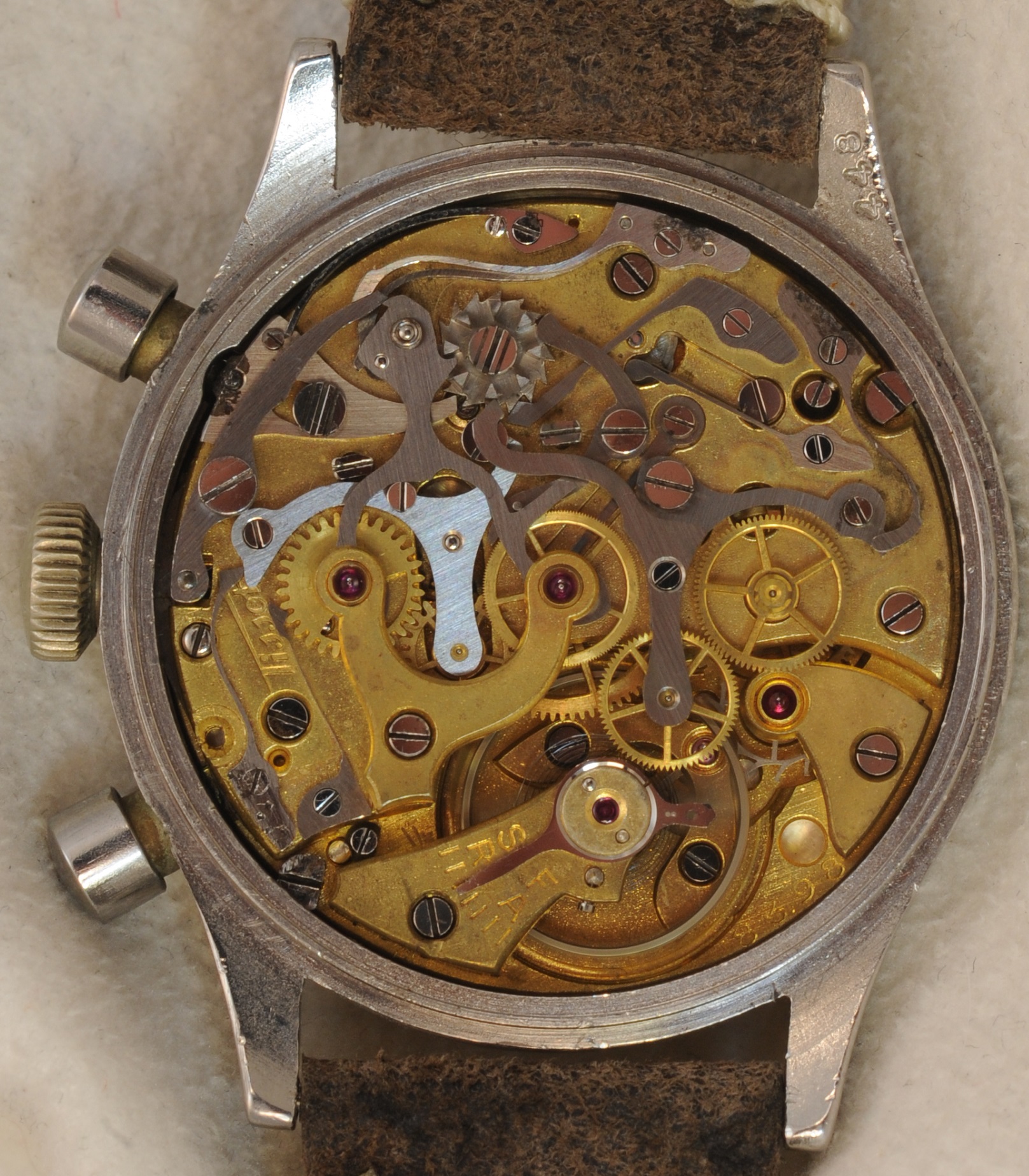

    And the movement? Anyone know what it is?

  7. LarryG not KennyG, not OG, just LarryG Mar 10, 2019
    992
    3,836
    Lemania 15tl/omega 33.3

  9. VintageWatchIta Mar 10, 2019
    301
    541
    I agree, re-dial 100%, but not the worse I’ve seen in my life

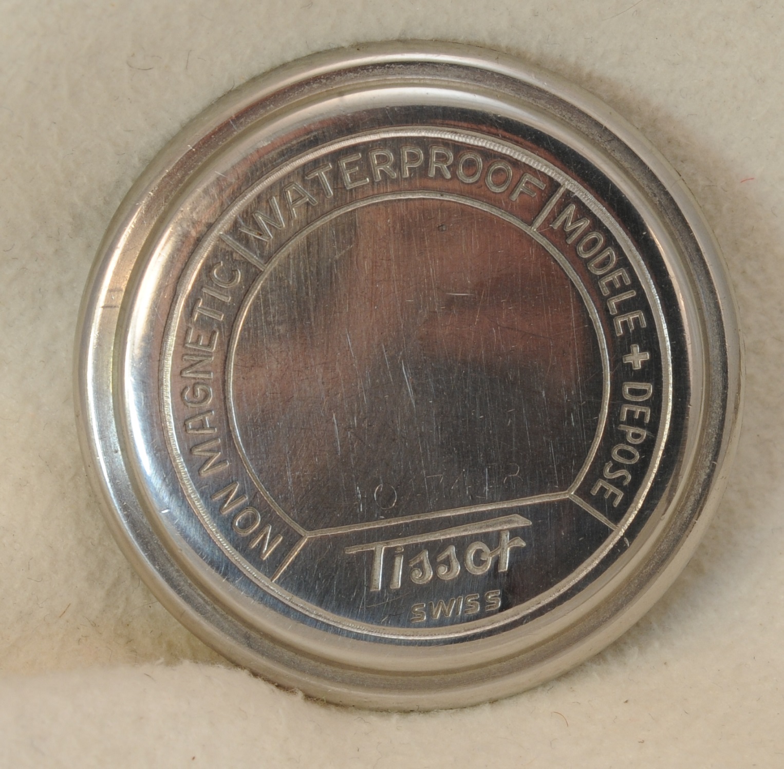

  11. Vitezi Mar 10, 2019
    3,104
    13,478
    Is there a serial number engraved on the outside of the caseback? What does it read?
    Besides being a poor redial, this watch has the feel of a bitsa watch.
  12. tmw57 Mar 10, 2019
    1,426
    5,430
    yeah, that's my big concern. that it was slapped together. if so, I believe it would have been done 15-25 yrs.ago based on what I know about this watch's whereabouts..
    serial #1047448
    The third 4 is very worn and really hard to tell if it really was a 4 or blank space....at some angles it looks like there once was a 4 there.....

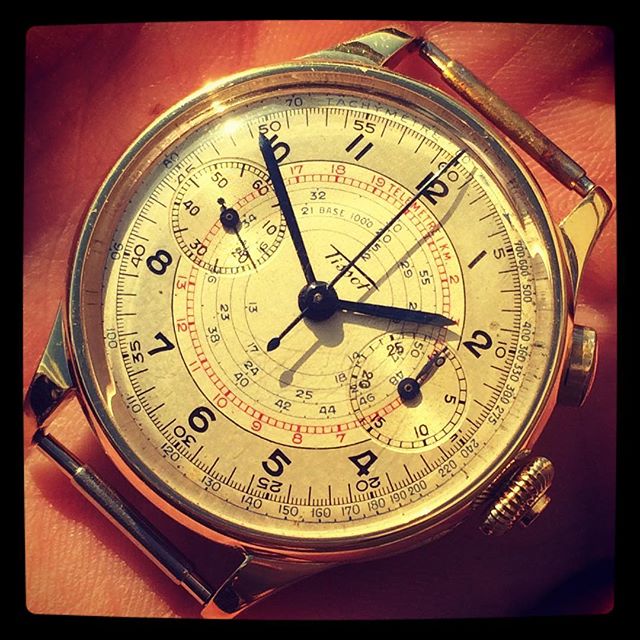

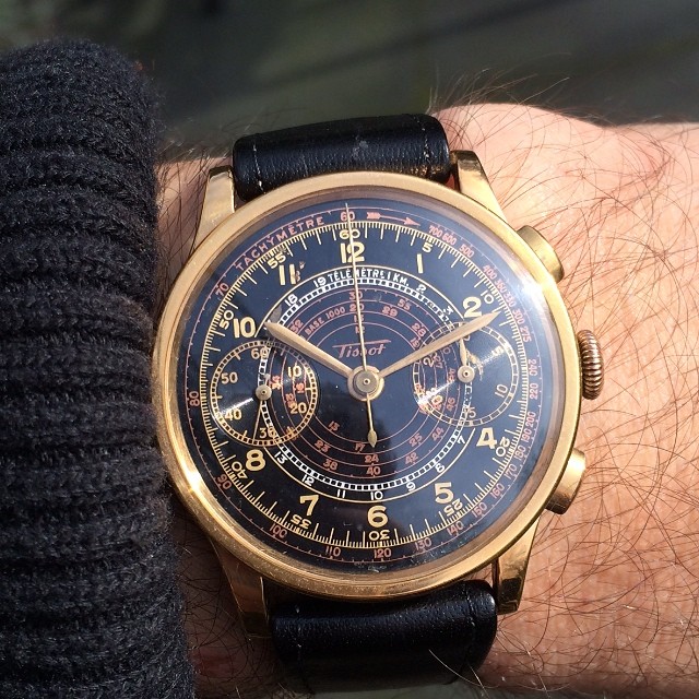

  13. Vitezi Mar 10, 2019
    3,104
    13,478
    An original version of the OP dial might have looked like this (reference picture):
    These dials more commonly came in black, like this:
    Redondo444, Omegafanman and sdre like this.
  14. tmw57 Mar 10, 2019
    1,426
    5,430
    Both beauties!
    Thanks..
    The minute and hour hands on mine look similar to the top picture. Both blued steel w/some oxidation (mine) with the exception of the three chrono hands which (on mine) are black.

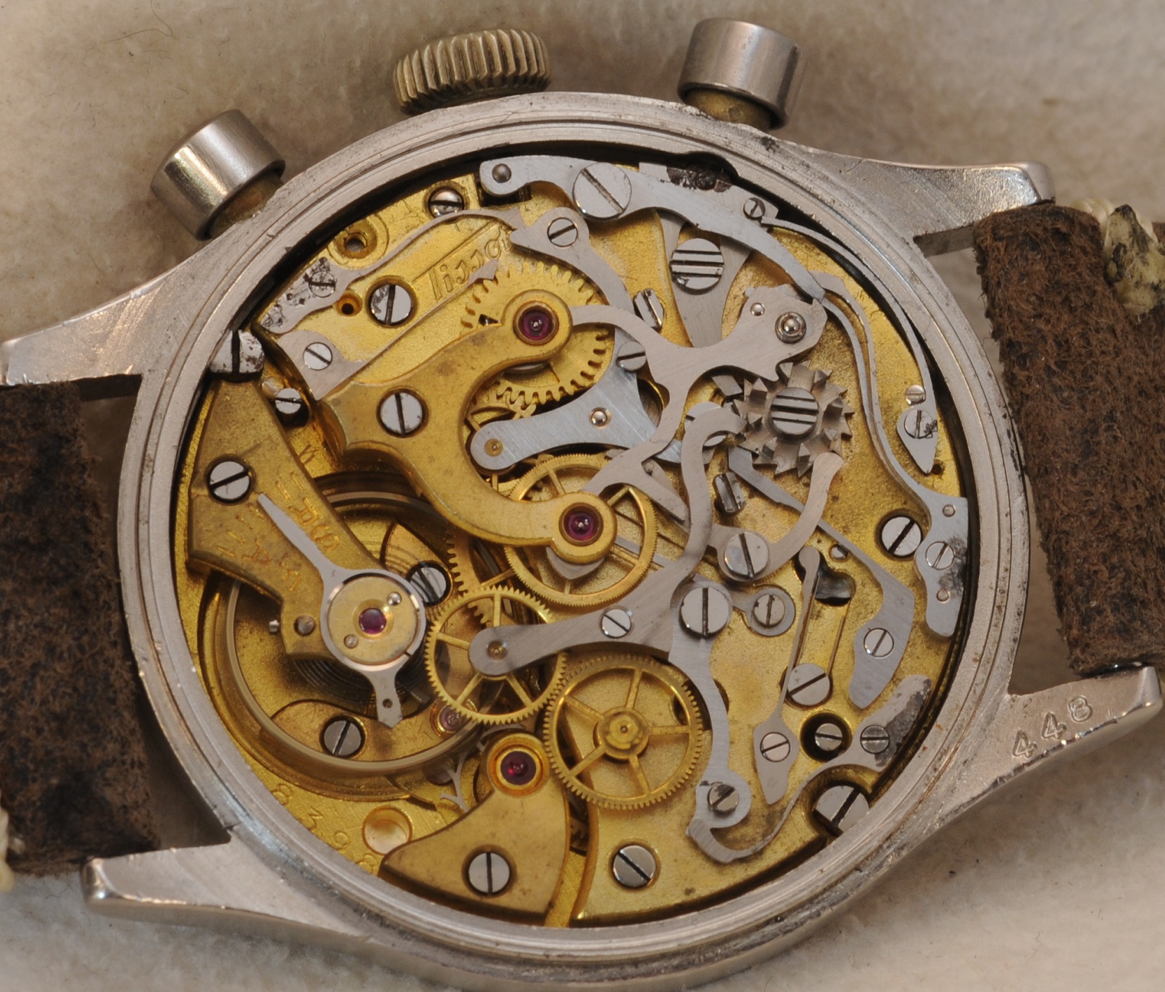

  15. Vitezi Mar 10, 2019
    3,104
    13,478
    The serial number on the caseback would date the watch to 1940. At the time, Tissot (Lemania) was generally using a version of the 15TL that looked like this (from serial 1,047,502) with a curved bridge:
    Edited Mar 10, 2019

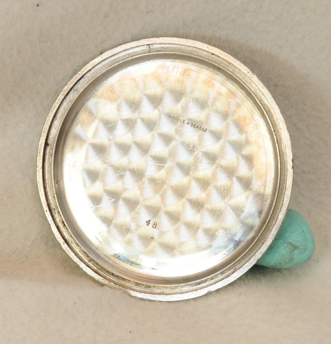

  18. Northernman Lemaniac Mar 13, 2019
    4,424
    18,137
    Caseback and case lugs matches (stamped 48, last two digits). This was done with "waterproof" case variants. Basically the case and casebacks had to be matched in order to provide a good enough seal. Round pushers was as well used to achieve some degree of waterproofing.
    Movement is a Lemania cal 15 (Omega 33.3). Correctly signed baseplate. No shock protection corresponds well with 1940s.
    Apart from the dial being refinished, I see nothing much wrong with it.

  20. tmw57 Mar 13, 2019
    1,426
    5,430
    The back snaps on nice and tight....
    And then spins freely once it's in place?!
    Is that because it's missing a gasket?
