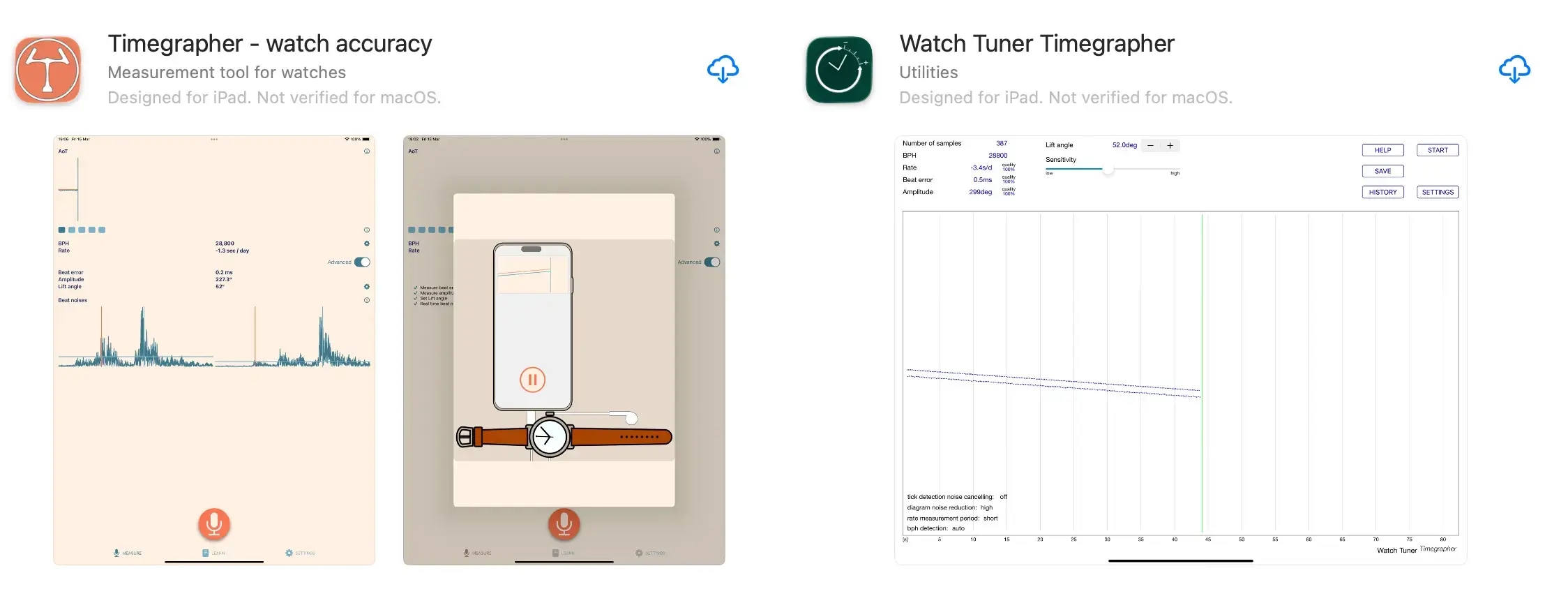

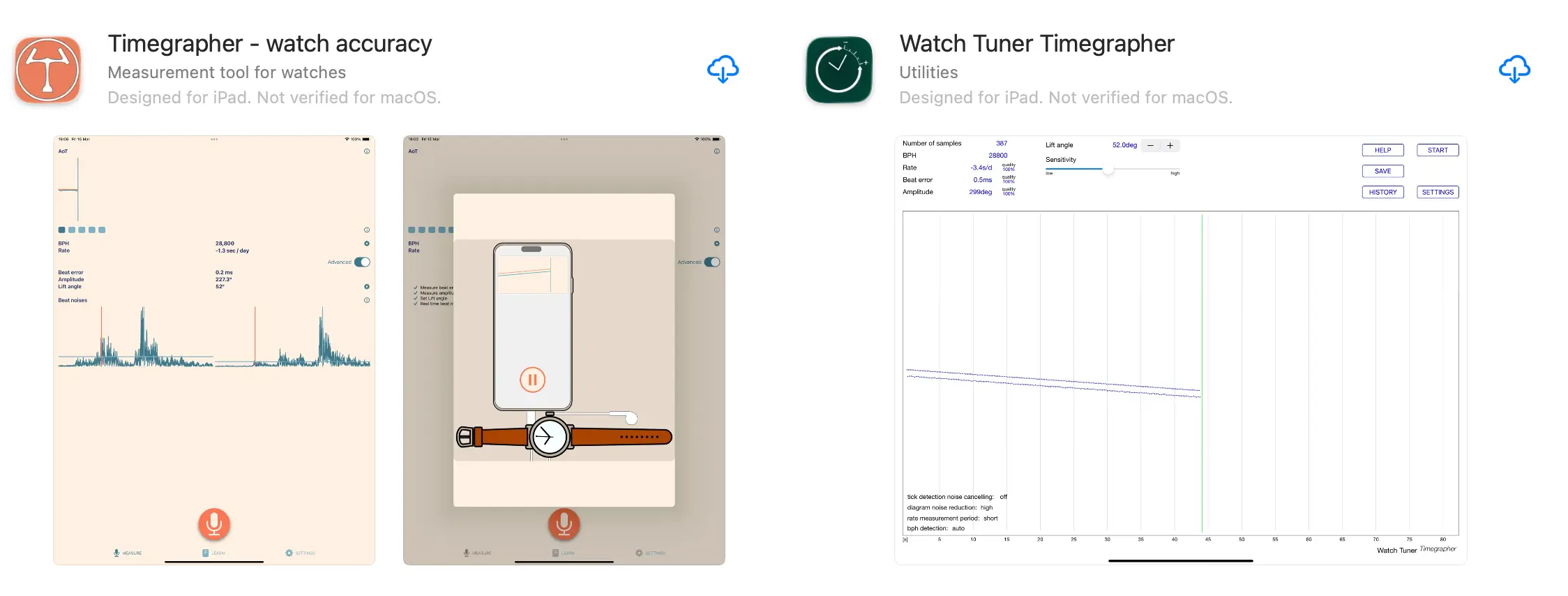

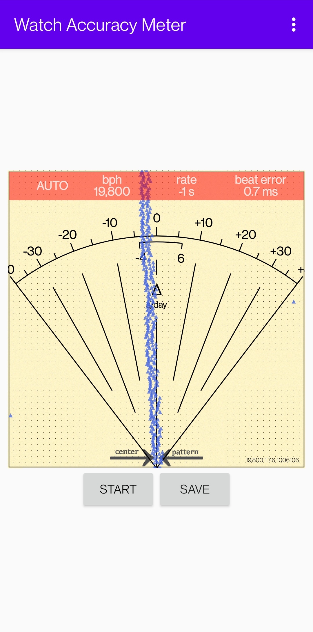

Does anyone have experience with various timeographer phone apps?
I used to have Kello but was kind of disappointed it didn’t have amplitude- only estimates of seconds delay or advance. Still useful to buy at a flea market or at a fair but that doesn’t happen so much thesr days.
On the British forum TZ-UK people had mentioned other apps a few years ago… Watch Tracker seemed to have many fans.
nowadays Watch Tuner Timeographer seems to have a handful of good reviews- and it offers two more simple variations.
Has anyone tried them— and are there better options available?
Curious to hear as I miss my app. It kind of vanished in some sync incident.

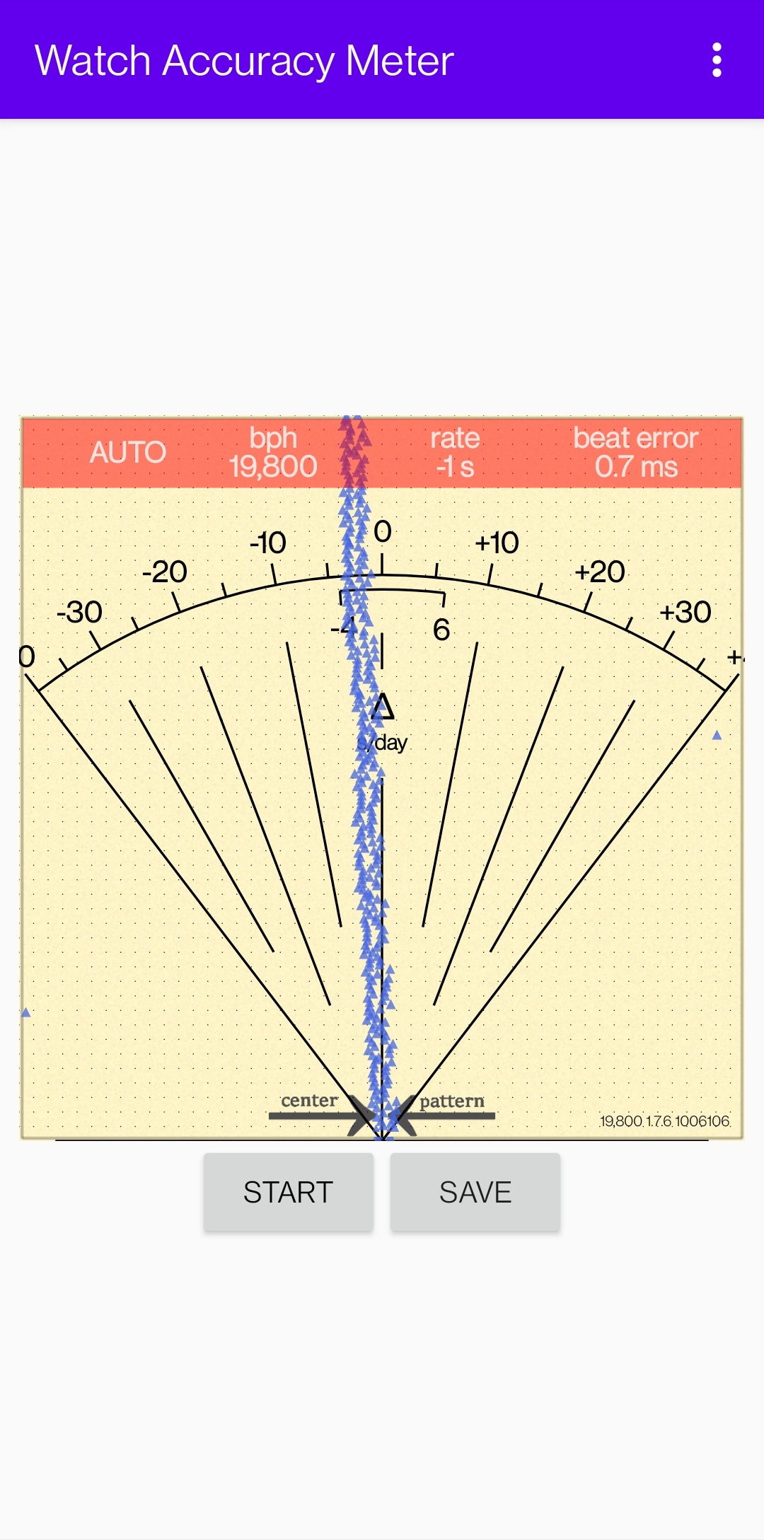

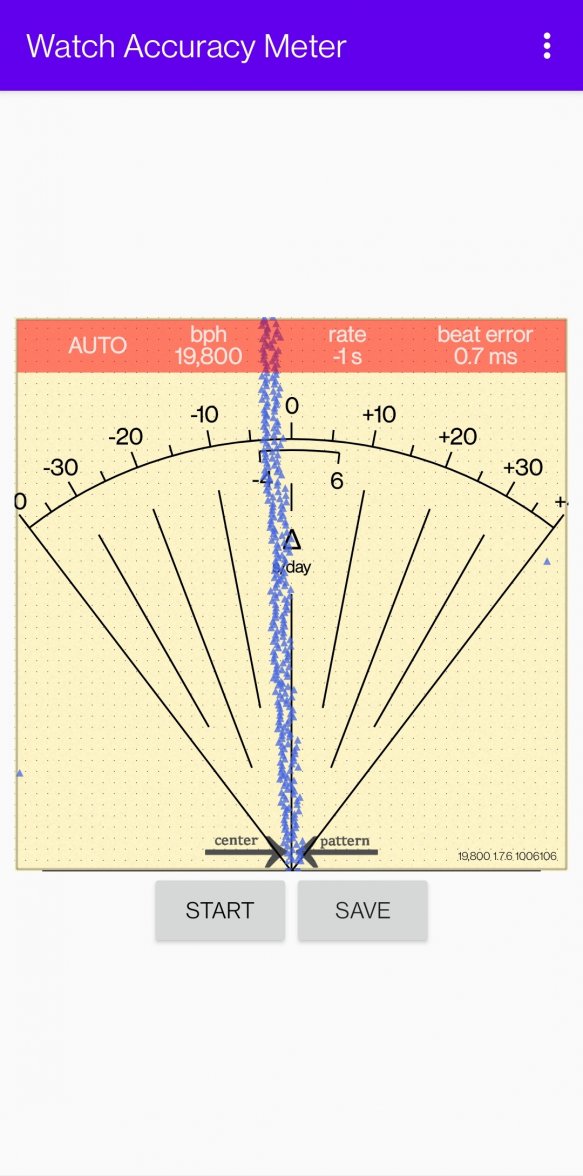

I use this with very good success. It's for a computer, not a phone. It gives correct amplitude if you input the proper lift angle. I also like that it shows beat error, and the acoustic profile is useful to assist in detecting movement issues. It's also free.

Thanks M, silly question: how do you determine the lift angle? Afraid I might not be enough of a geek for this 😬
I just tried Watch Tuner (the medium version for people who don’t need frequency, just amplitude and beat error) and it doesn’t seem to be working at all, or at least not with me or not on this watch.

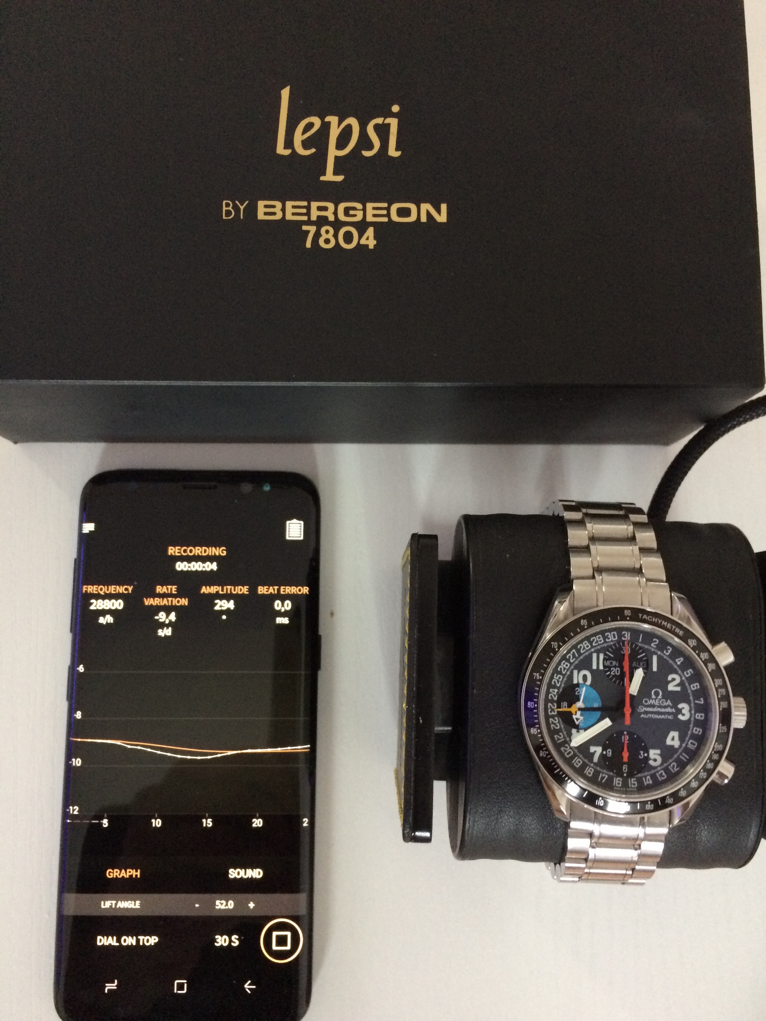

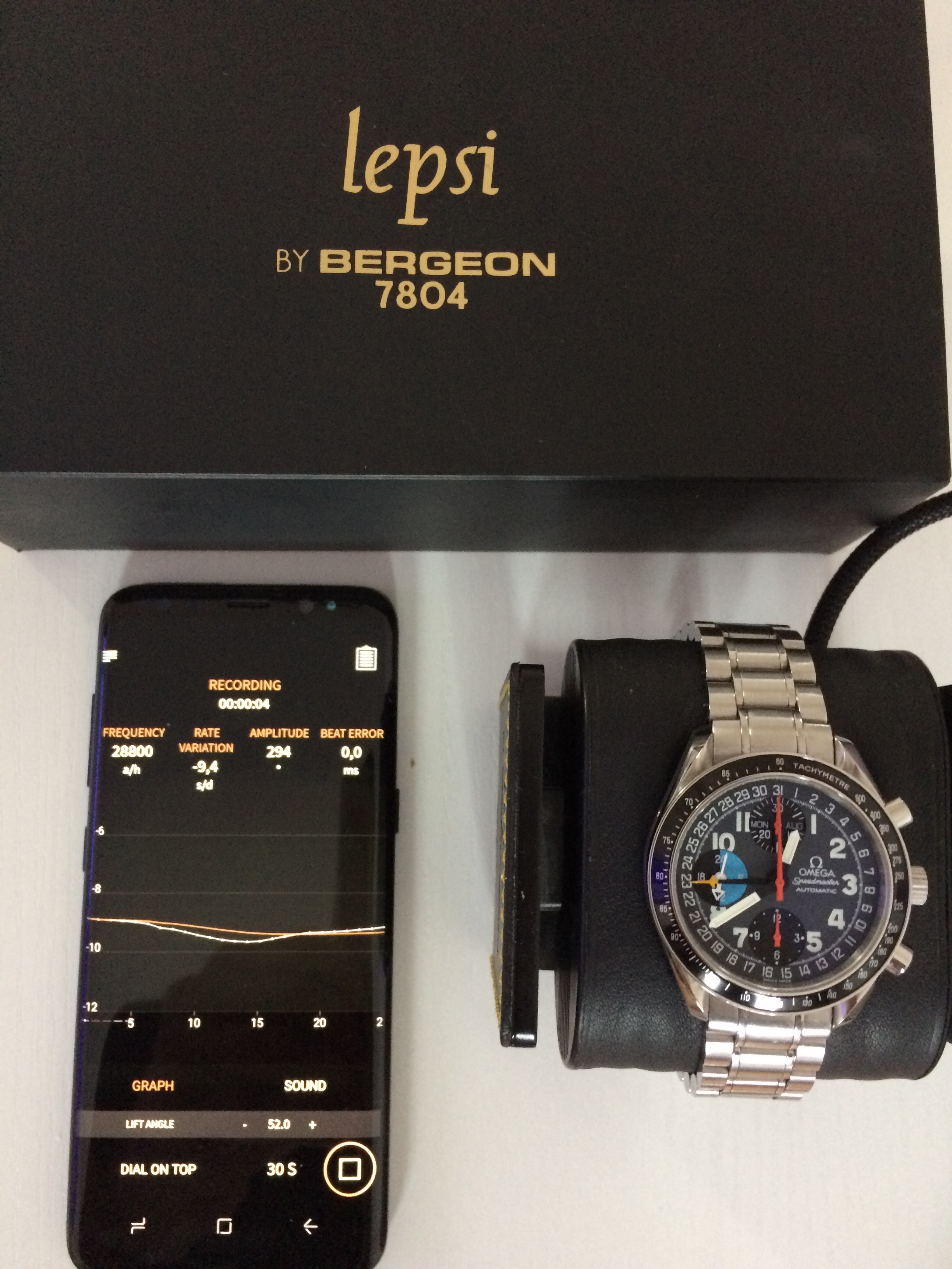

There are various lists out there with the lift angle for many movements. Otherwise, the way to determine this is to visually confirm the balance amplitude to an easily determined value, like 180 degrees, then adjust the lift angle on the timing machine so it reads 180. A phone with slow motion video is quite helpful for this if you haven’t done it before.

I bought this but i still have to learn what is with the lift angle..i am reading now the above posts..😀
