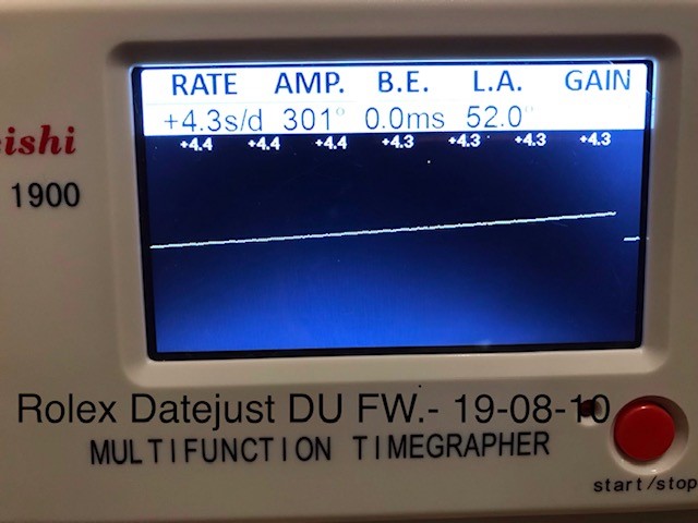

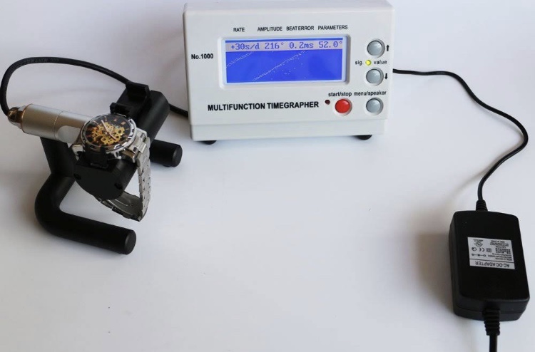

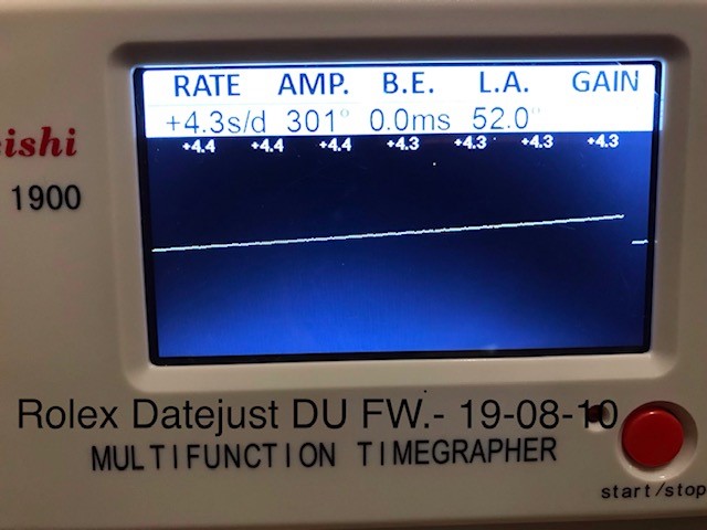

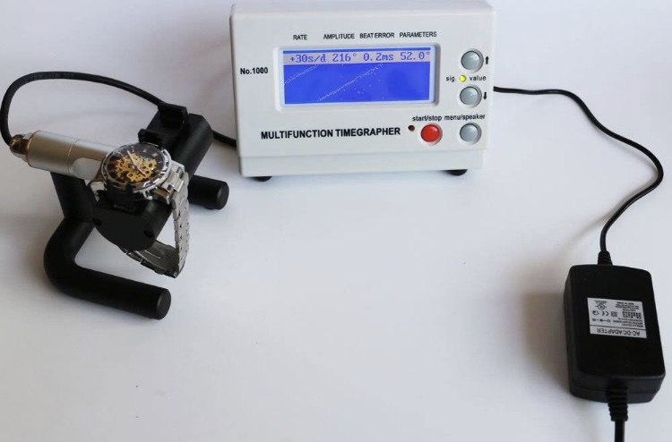

I recommend the 1900 over the 1000. Bigger color screen. Supposedly better programming.
There are a number of brands that have rebranded the 1000, MTG, TYMC, Acetimer, Ofrei come to mind.
The link right above my post is a pretty good price; I think I paid about $195 for mine. If you are wondering about the red thing in the upper right of the screen, it's a tab to pull the screen protector plastic.
