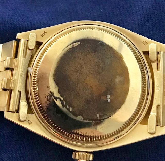

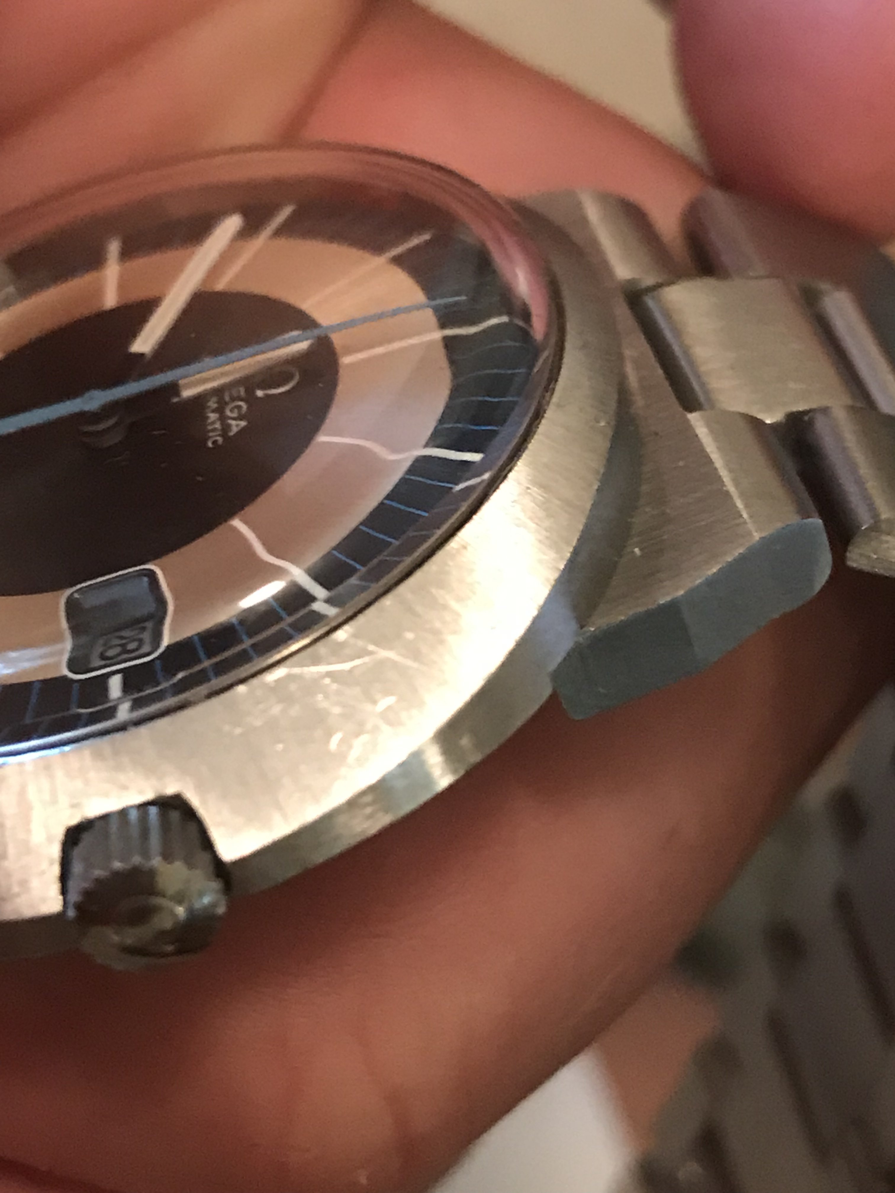

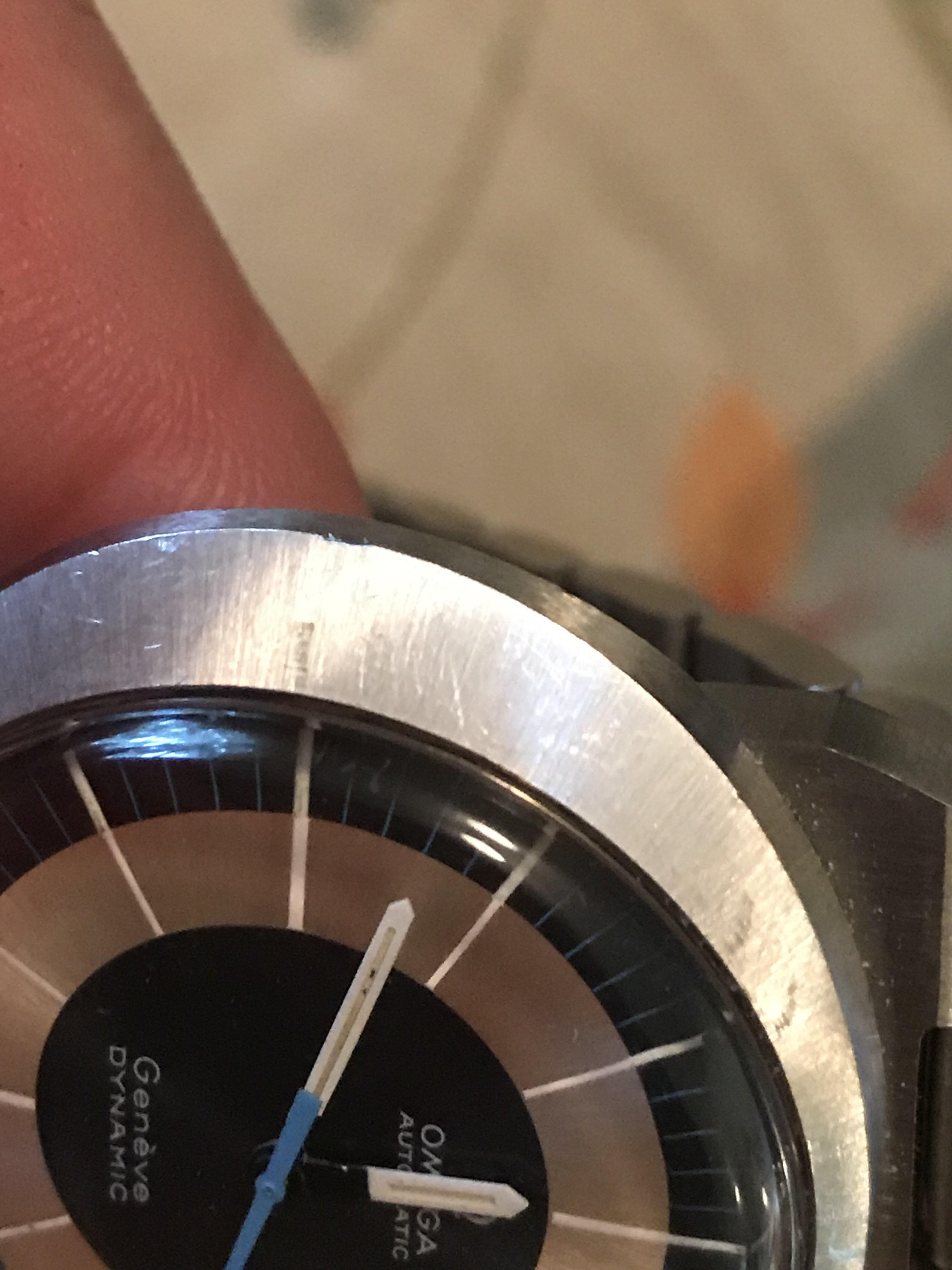

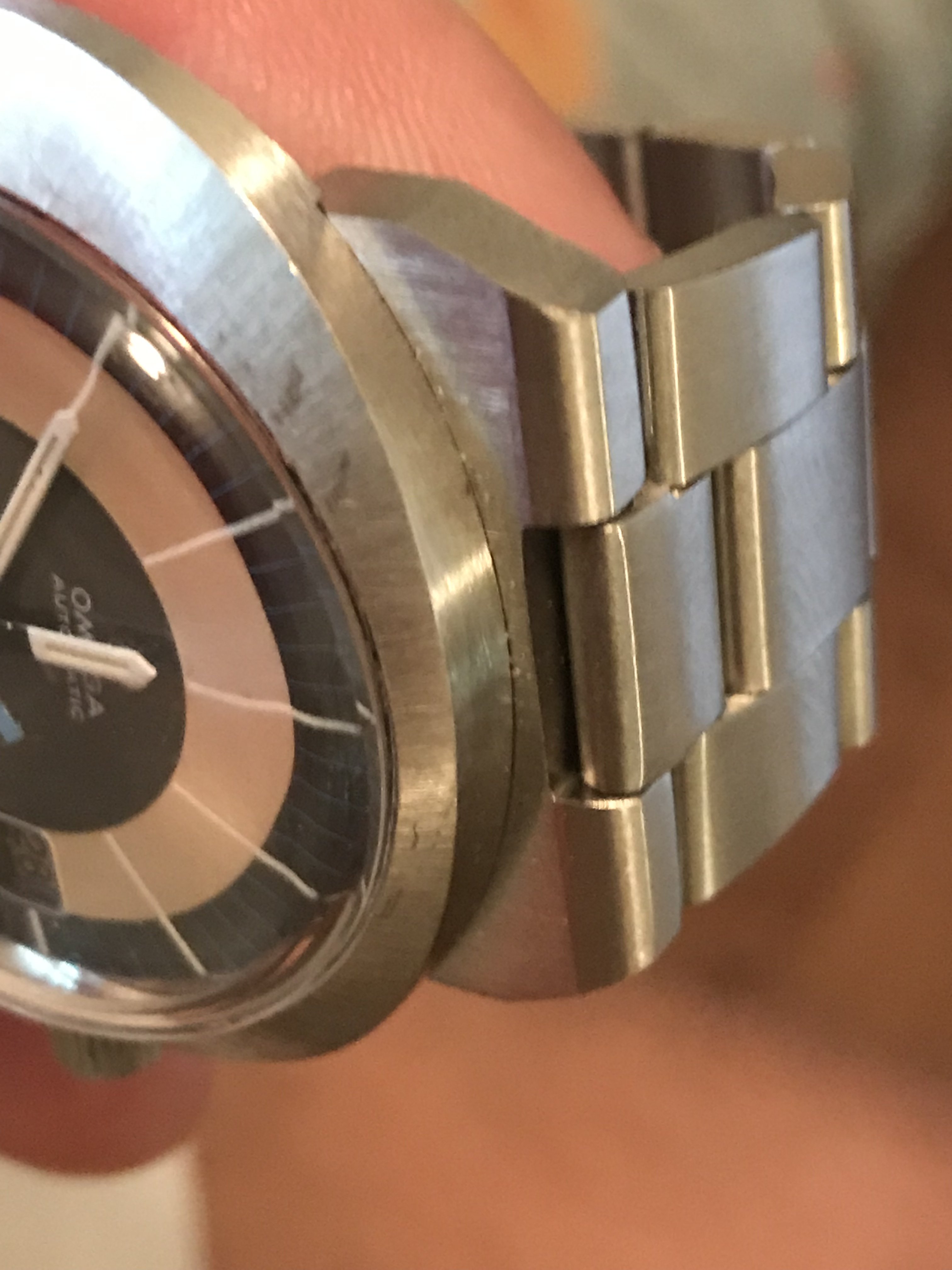

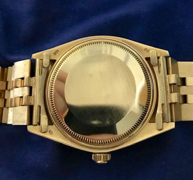

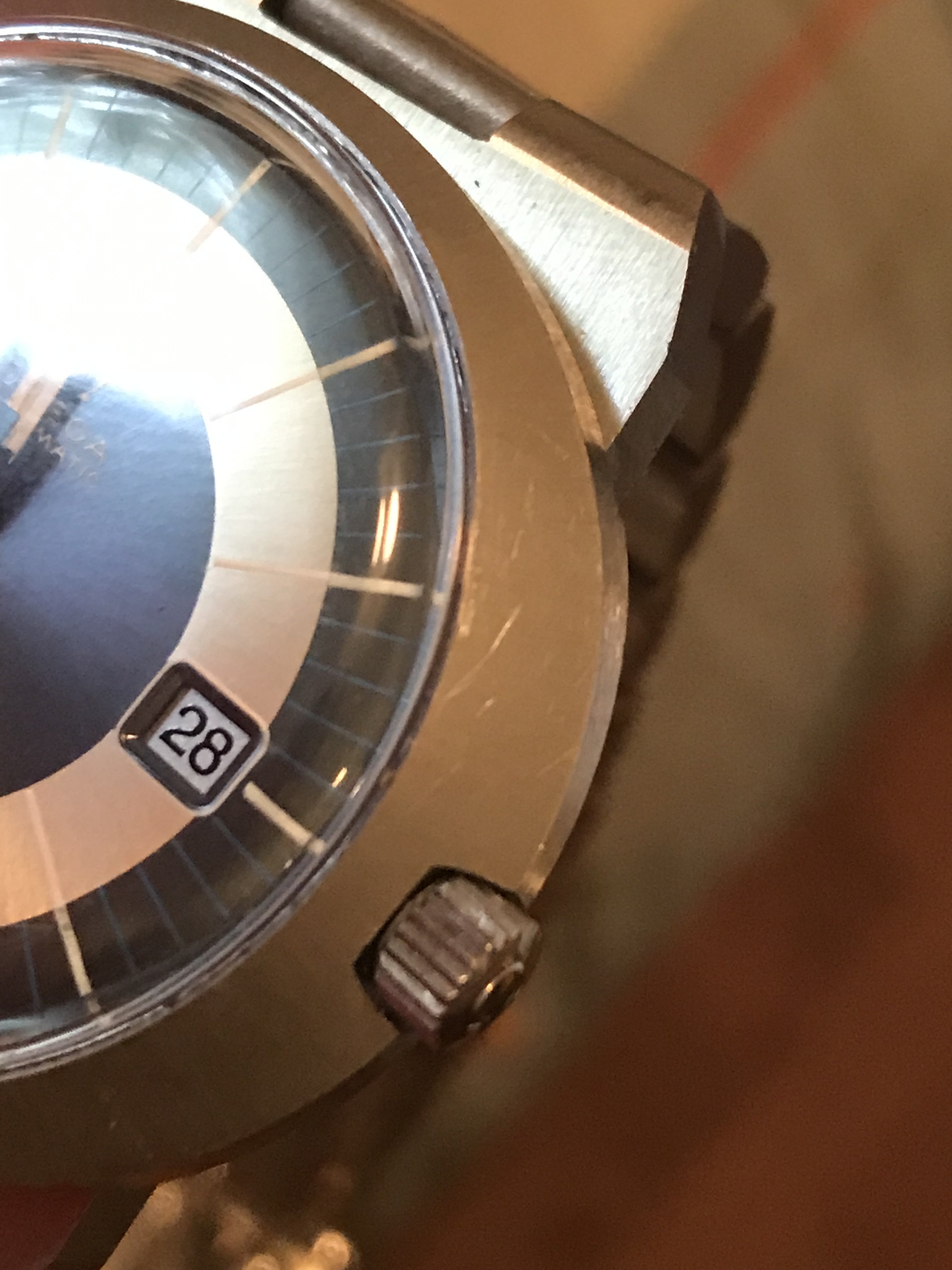

WTH, is it too much to ask to have your pristine watch come back from the watchmaker in the same condition? I sent my Omega Dynamic to my watchmaker for service. The watch was in fantastic condition with no scratches on the case brushing. You can see the result from my photos. It looks like he serviced it with a monkey wrench This is a VERY experienced watchmaker. Strike one and two was when I sent my pristine Rolex 1503 for service. The case back sticker was still present. I sent an email and a note with the watch telling him not to buff anything just perform a service. I got an email back with two pictures, one after a few minutes on the wheel and the other after the original sticker was buffed off, saying I received the watch OK but there seem to be some tarnish on the back which I removed with the buffer. I am pleading and begging for one of the superior watchmakers on this form to take pity on me and service my watches in the future. Please enjoy the pictures and empathize in my misery.

The radial finish is not simply brushing - it's applied using a lapping machine. I took this video of how it's done at the Omega service center in NJ while there for training some time ago, so it will give you an idea of what is involved:
One thing to consider is that it tends to remove a fair bit of material, and some cases (Mk. II Speedmasters for example) end up losing a lot when the wrong person does this. There are watchmakers here who do this, but unclear if they would do it just on it's own or not. I'm sure one will likely pop in and offer his services...

Would it be possible to touch up those little scratches with some lite Emory cloth or proper grit sand paper- perhaps a scotch brite pad? It’s not bad, but it would piss me off too.

I’ve seen watchmakers try this and it never ends well. I wouldn’t recommend it.
