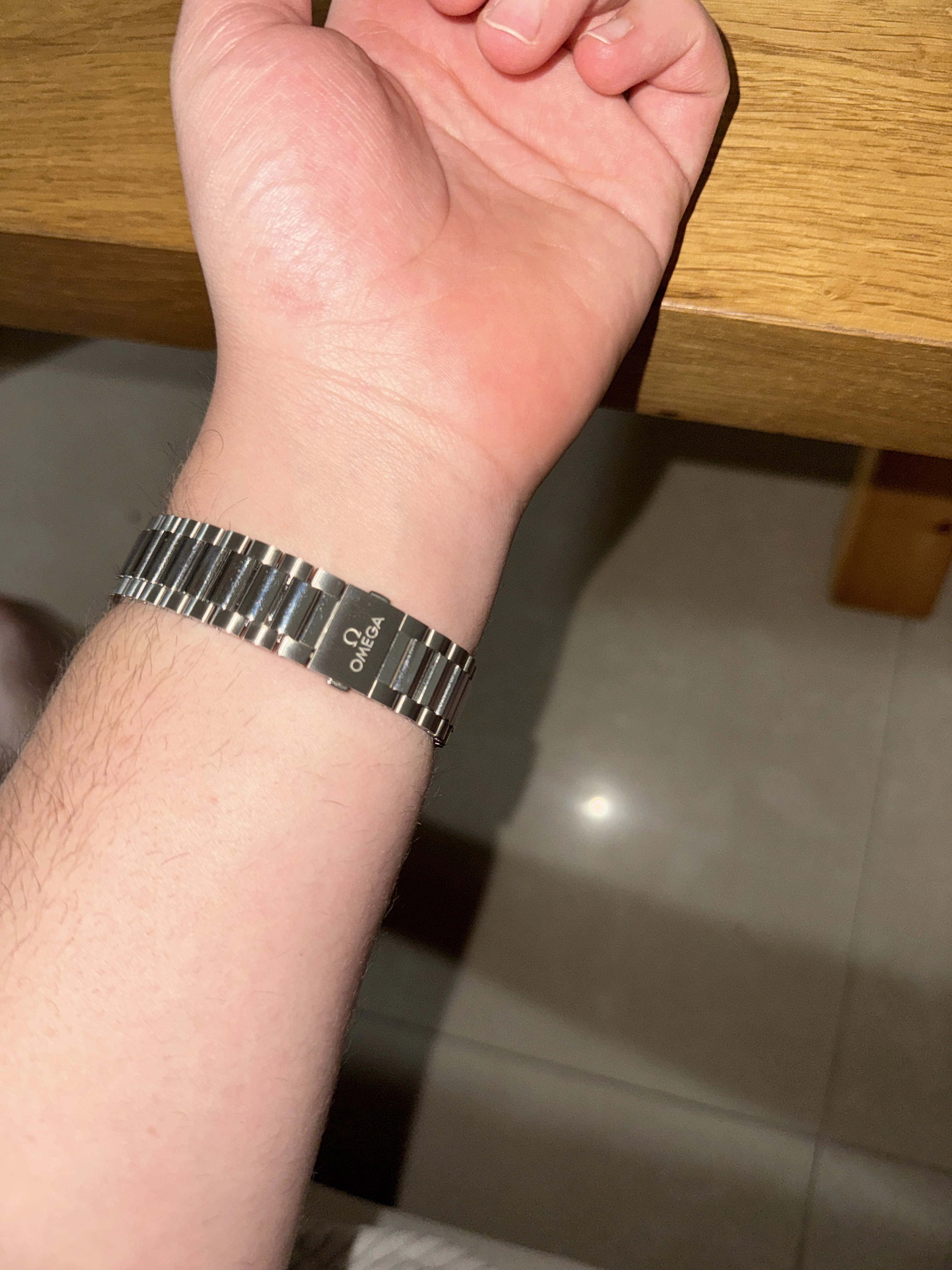

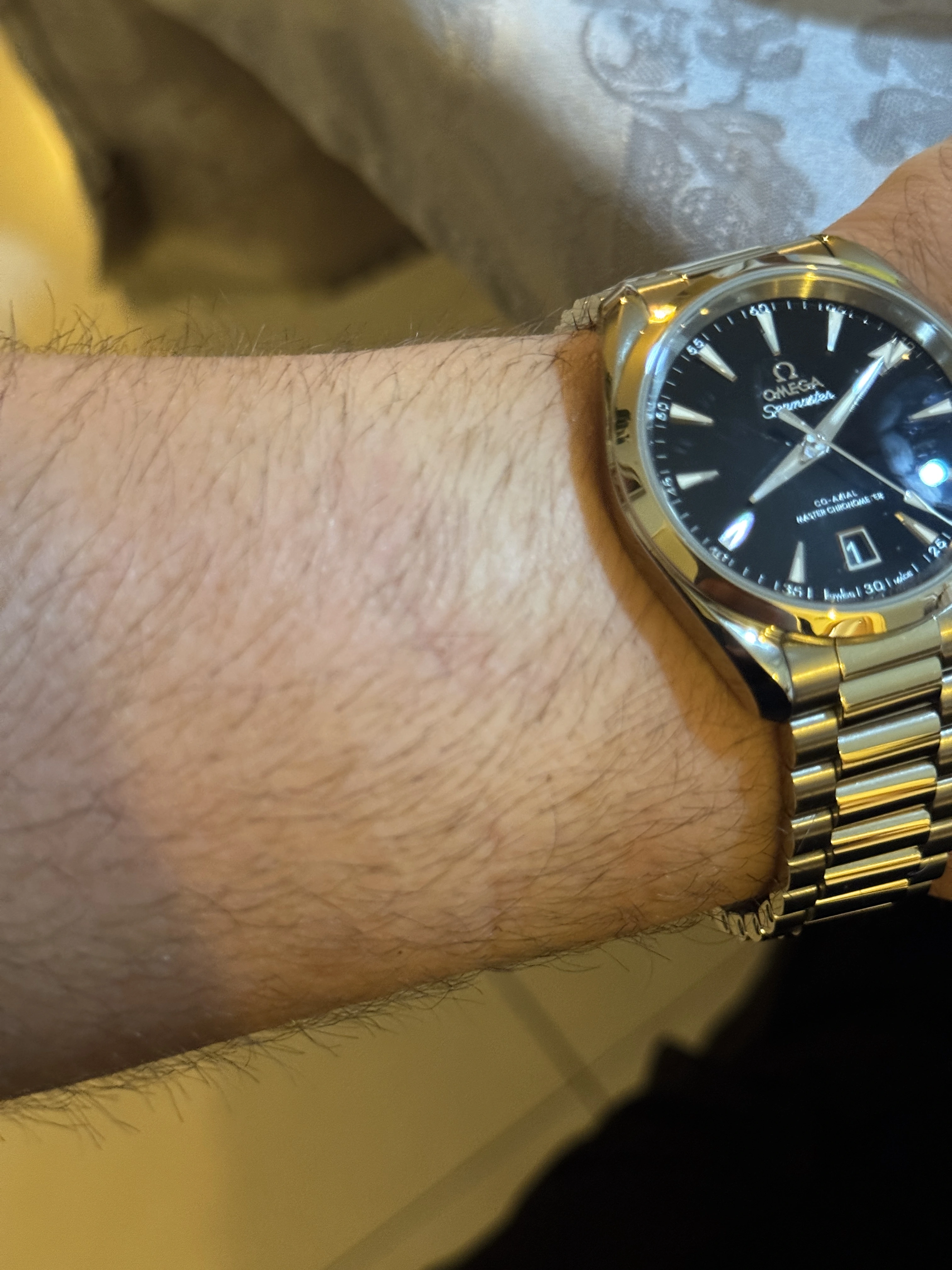

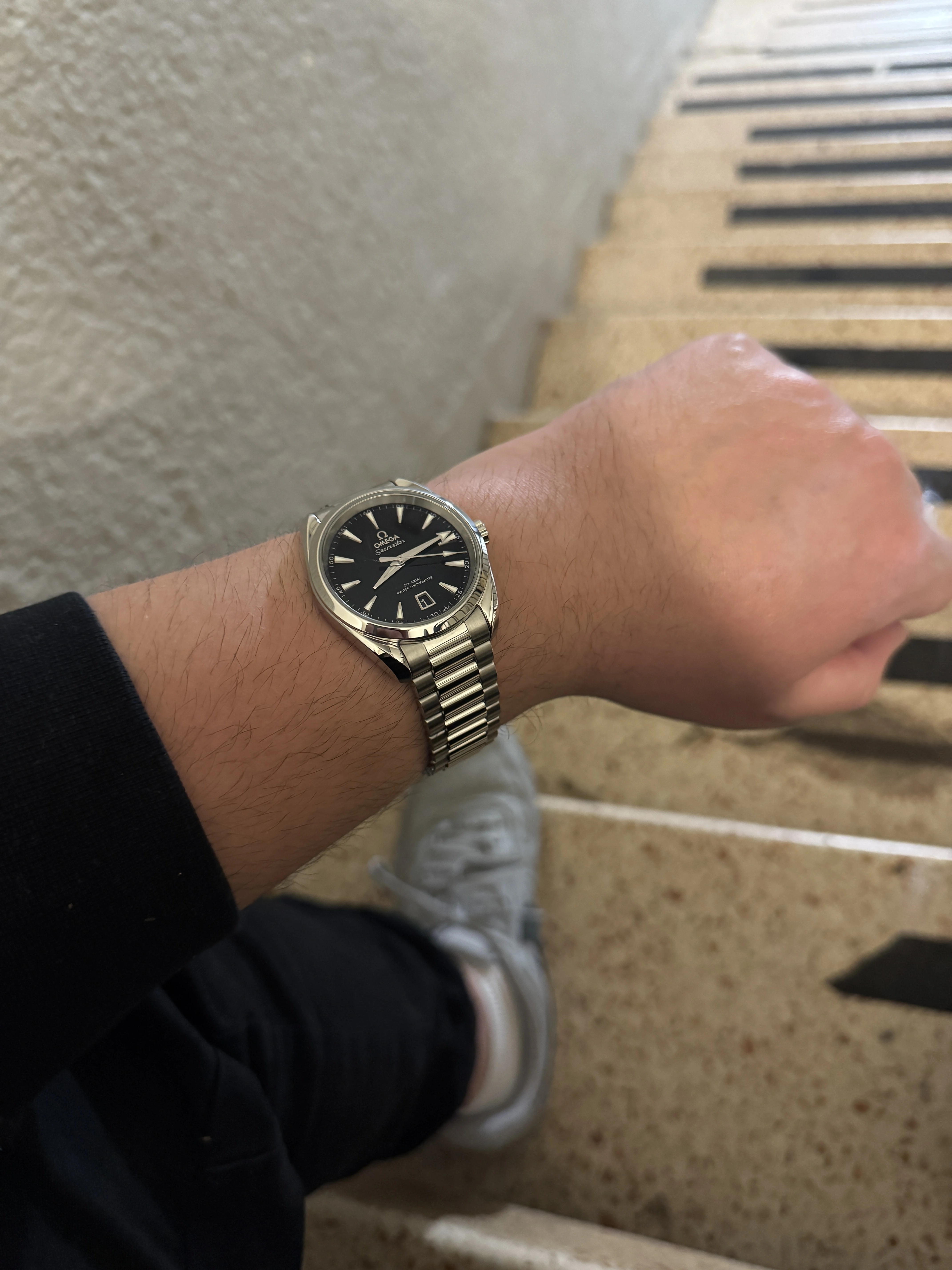

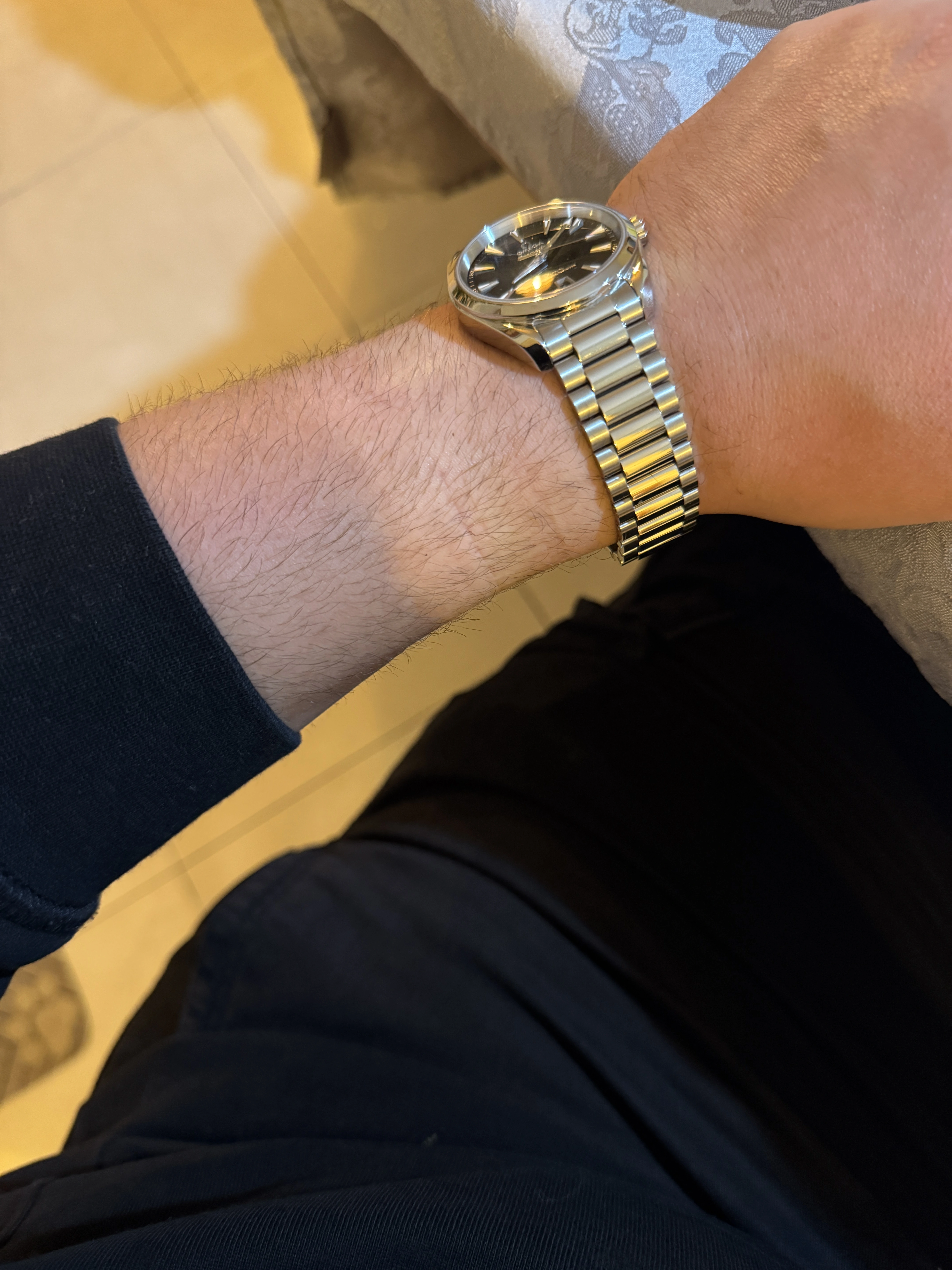

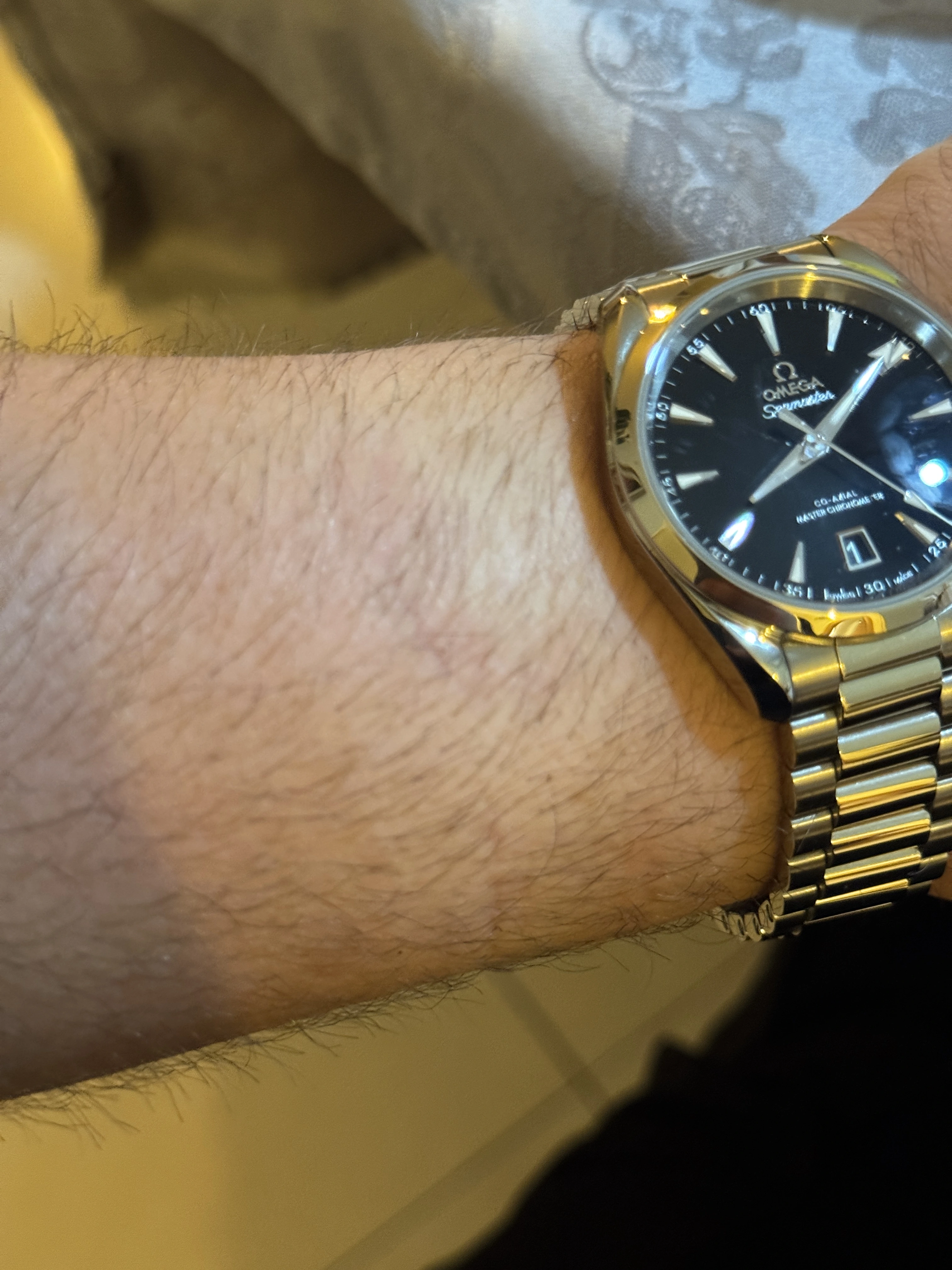

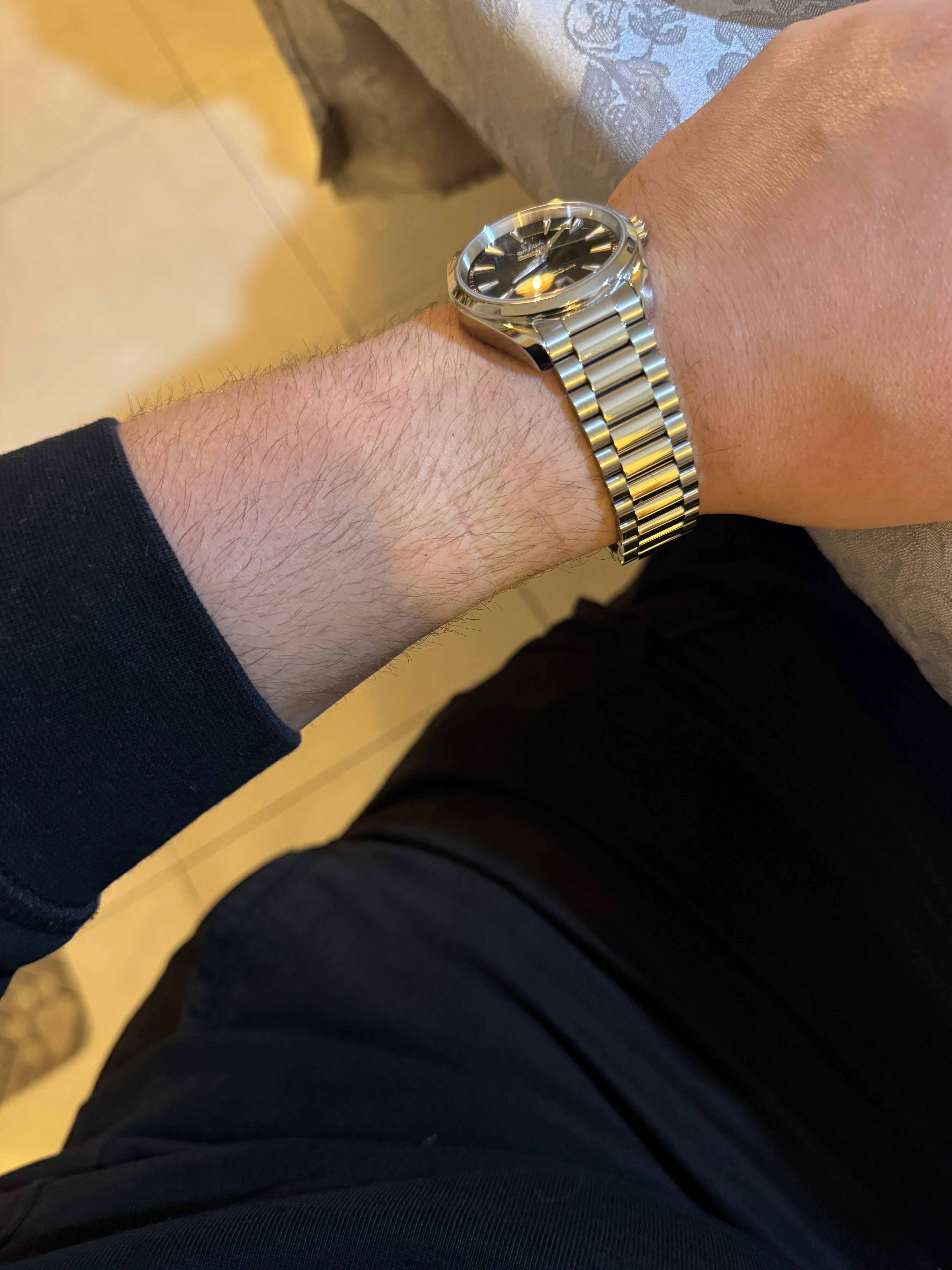

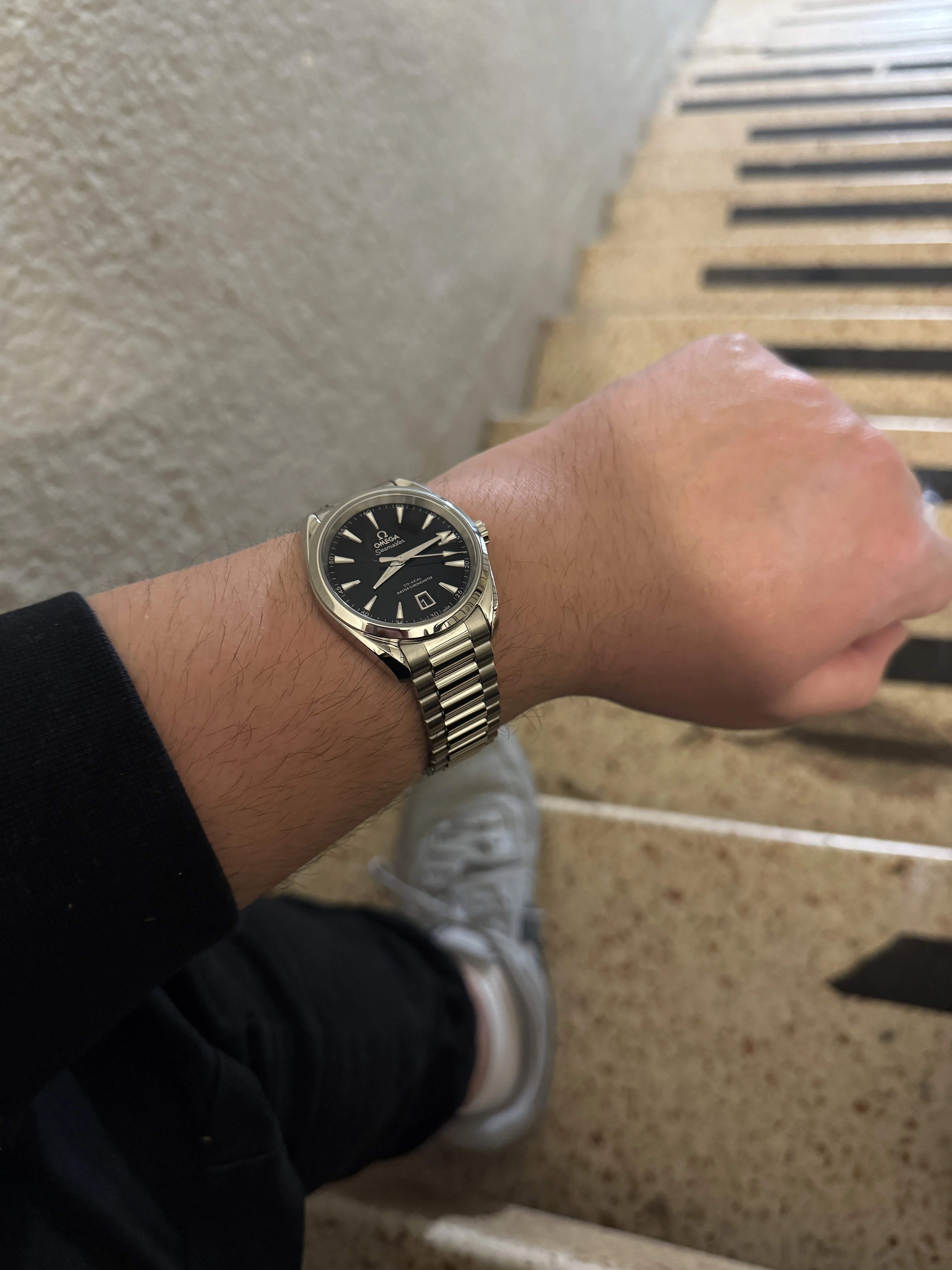

Hi everyone, i just bought my new Omega aqua terra black lacquer 38mm a week ago. We fitted the bracelet and i was good to go.
In last couple of days the bracelet is hurting me so bad and i dont know what else to do.
I did try to put a link on but then the bracelet is too big , if i remove one then its too small. I did try and use the micro- adjustment but its seems to not help at all.
What else can i do?
I saw some videos about bracelet link balancing
Is it really helping?
And also, the omega logo on the clasp is not centered, is this may be the problem?
I attached some pictures of the problem im facing.

Can we see a picture of the clasp with the logo issue you mention?
In one pic you appear to be wearing the watch way up by your hand—in others it’s (more typically) further back. It’s normal for your wrist to swell and unswell as weather changes. I don’t think any of us will have the answer for you—you’ll just need to try out different configurations of links and microadjust, and also commit to where on your arm/wrist you want to wear the watch.

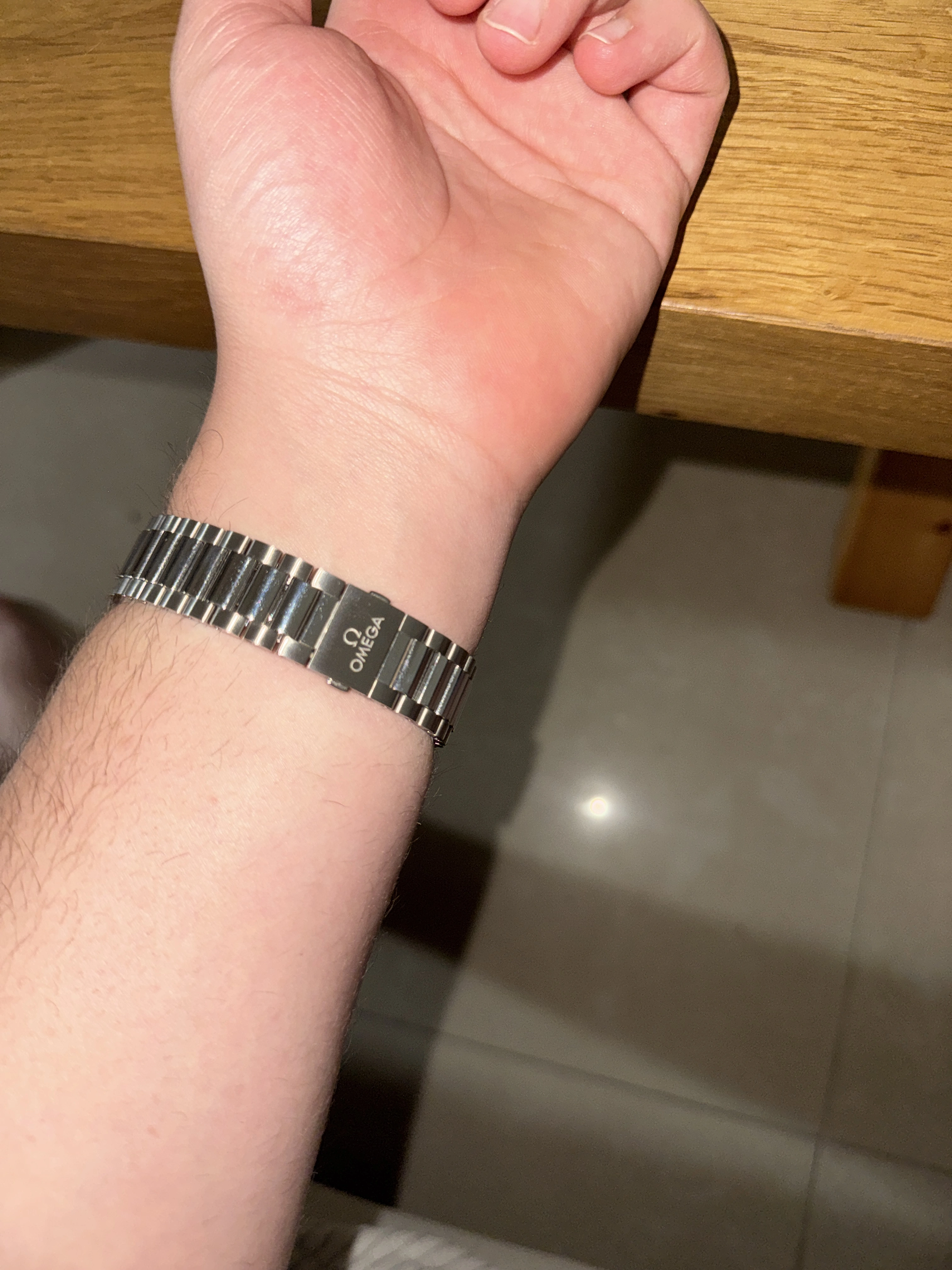

Thanks for the answer and your time.
Im attaching a picture i just took.

Fitment is always better when there's more links on the 12 o'clock side and less on the 6 o'clock. Wear the watch upside down to simulate what that fitment would be like. If it's better, have them resize it.

You can take some of the 6 o'clock links and move them to the 12 o'clock side to better center the clasp on the wrist, that often helps. It looks like whatever links were taken out to fit your wrist were taken out of one side of the bracelet only. That's the easy way for the dealer to do it, but it's not the best for the wearer.

That bracelet looks too tight … best is to see your dealer and get this resolved. That’s their job.

I thought the same thing. Way too tight. Needs at least 1/2 link or possibly 1 full link.

I wish they had a 1/2 link for this bracelet.
I did however take 2 links from 6 to 12 and i think i will add a full link to the 6 again, maybe a little bigger will be better.
