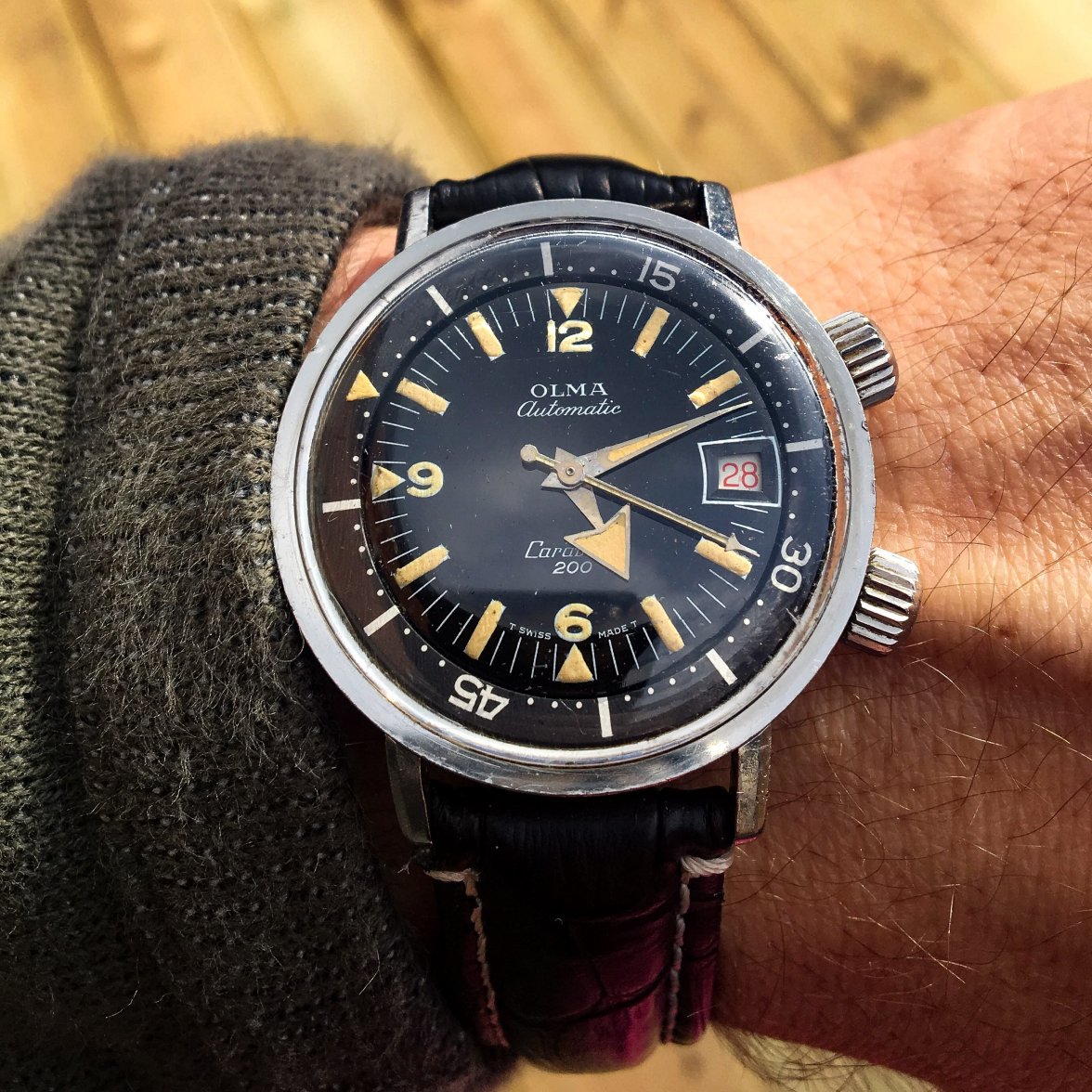

They also made a really cool double crown epsa compressor (Caravelle 200) which I was very lucky to stumble on.. 😀
Olma is in my opinion a nice brand that made some good quality watches back in time.
That has pretty much anything you could hope to find in a SC. Great watch.
