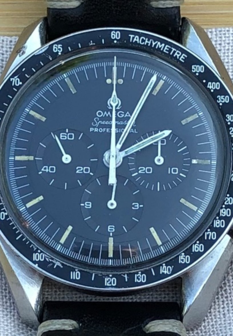

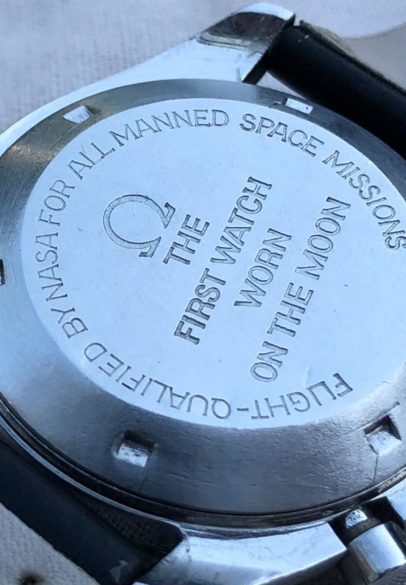

Hey Guys,
I have the opportunity to buy this piece tomorrow. For my own comfort I wanted to ask your opinions on the following pictures.
What I found so far:
-Production year ~1973 (based on the DNN bezel, straight writing caseback and inscription on the soft iron cage that says something with 1973 (serial is vague during that period).
-Hands look a bit "off" not sure what it is
-Original step dial
-New (but signed) omega crystal
Do you see any other things that don't look right?
Thank a lot!
Stan

It doesn't have a lot going for it so unless it's dirt cheap I would wait until a better one comes along. These aren't exactly rare.

The dial and hands both have unattractive lume, and they are dramatically mismatched. The hour hand might be slightly bent, or it could be an artifact of the photo. If it's cheap enough, it could be a candidate for a re-lume. There's either some damage, or a foreign object. on the 11 o'clock lug.

The pictures are zoomed too far in for my liking. With such closeups it’s hard to get an idea of the overall look but it certainly appears average at best.
I just want to note that this is something I actually like about my MKII, the original, if dark, lume. I think it matches original dials with slight patina well. I get that some people want their lume to actually illuminate, but I personally prize patina over function when it comes to vintage watch lume.
To the OP, this would make a good daily piece if it's cheap enough, no worry about adding dings or scratches, but if buying more to add to a collection you might prefer to wait. I'm an outlier because I like watches like this, so there's something for everyone thankfully.

The lume is coming off the dial markers, that's what I was referring to. Especially three o'clock. And the lume in the hands looks like toothpaste.

Also, it's not about function.
Nice yellow or orange lume looks extremely attractive on a vintage watch, whether it still glows or not. Markers that have degraded with mouldy looking green or black lume on the other hand just looks tired and worn imo.

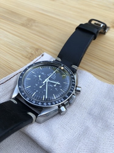

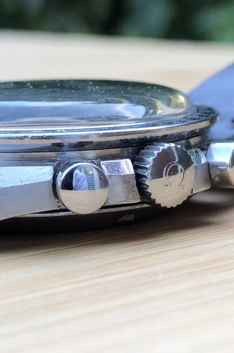

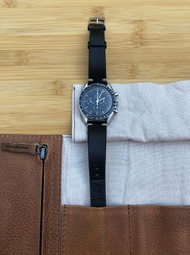

Some more pics

Oh! No one mentioned the hour reset doesn’t. Service please.
We all agree, don’t buy it unless it’s so cheap you have no choice.

The caseback between FLIGHT and the visible pusher looks pitted which is strange, and is that a crack running to the edge of the caseback in that area?
