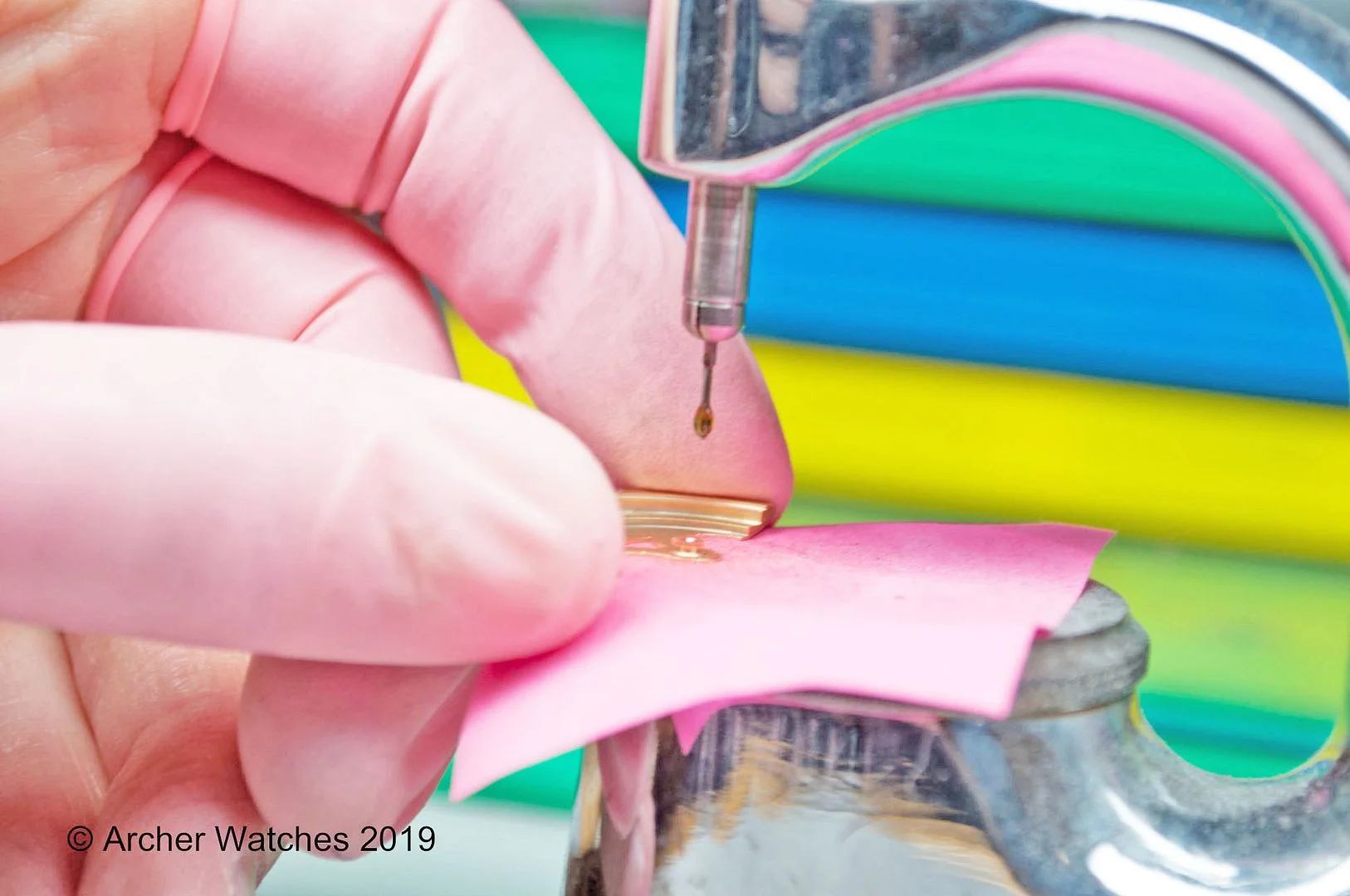

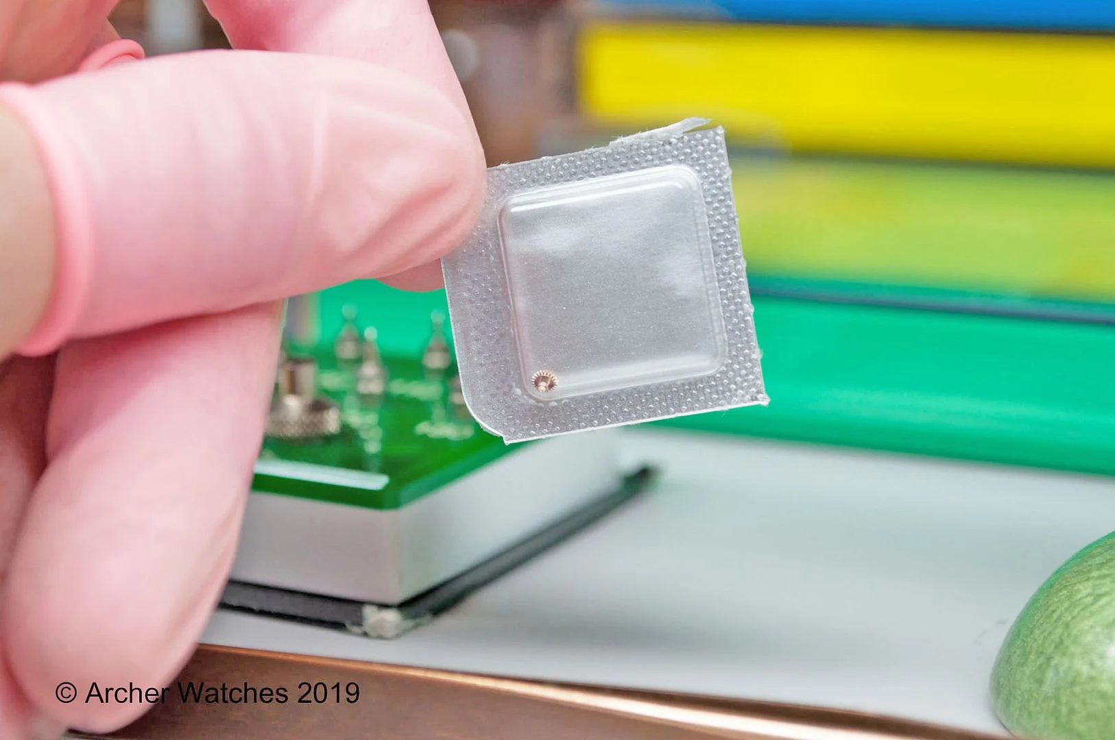

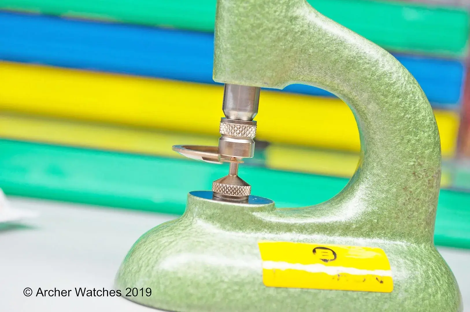

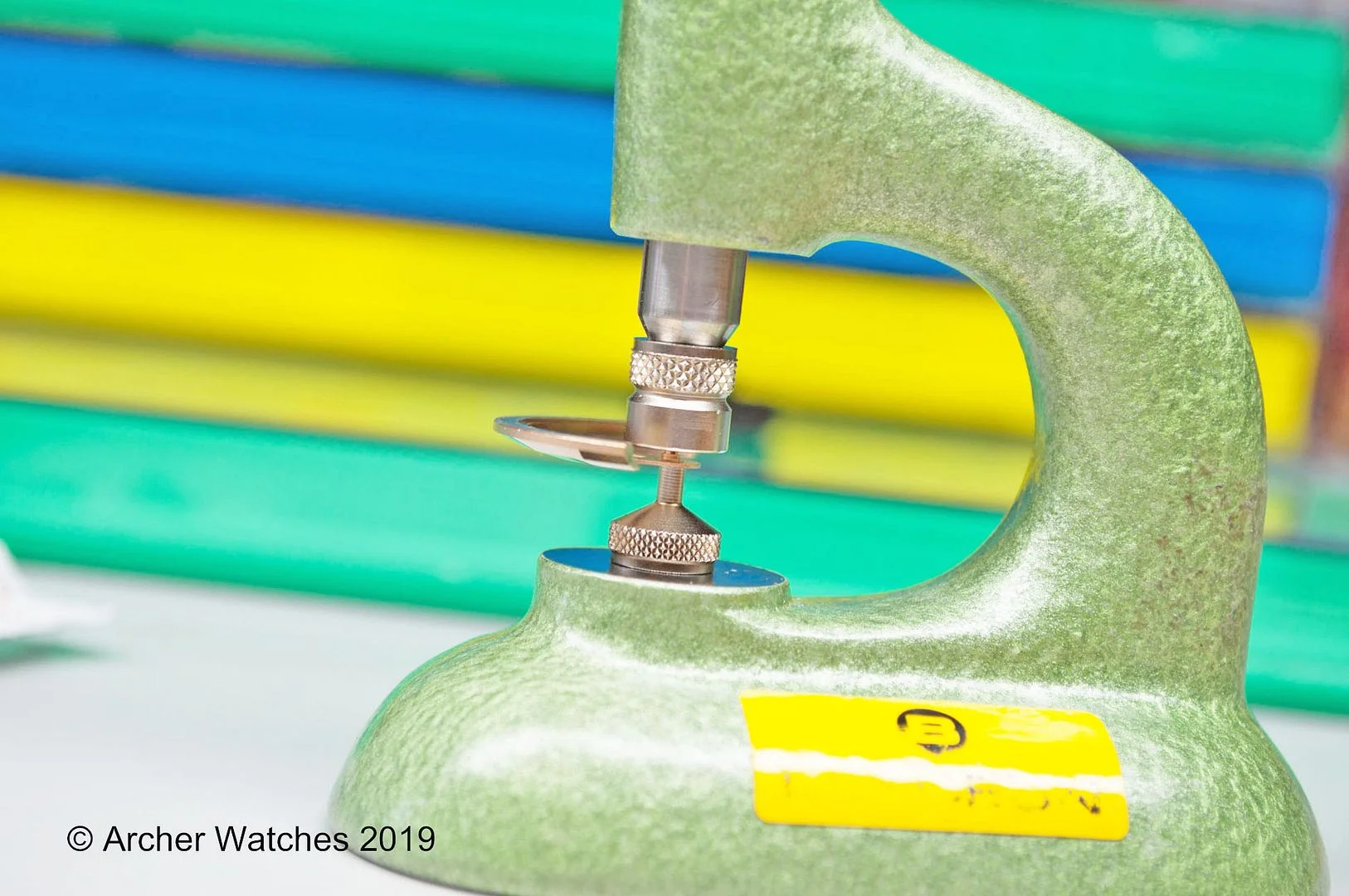

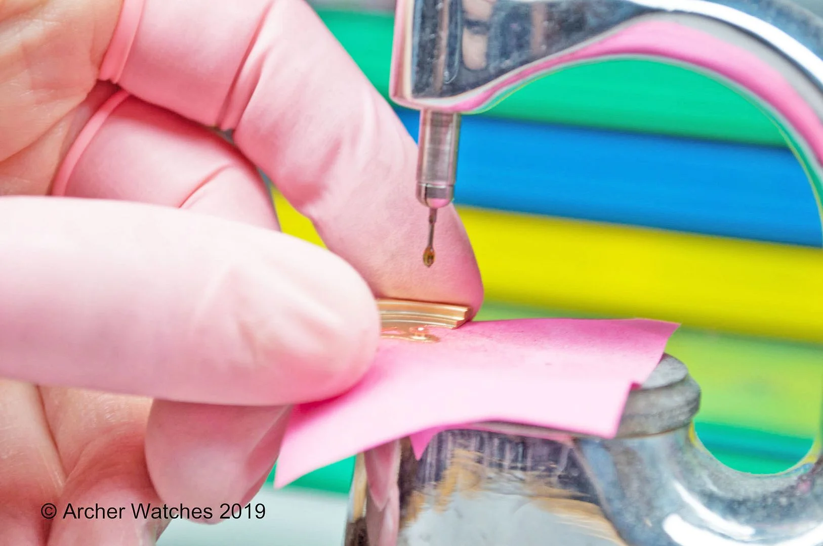

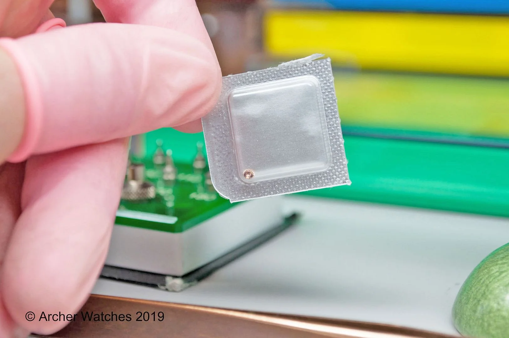

Not the case at all. The rotor pinion can still be purchased from Omega by Omega certified watchmakers. Part number is 72205501429. I buy these and replace them regularly...
They need to be reamed to final size using a straight reamer (not a cutting broach, which is tapered) - Omega sells the reamer as well:
