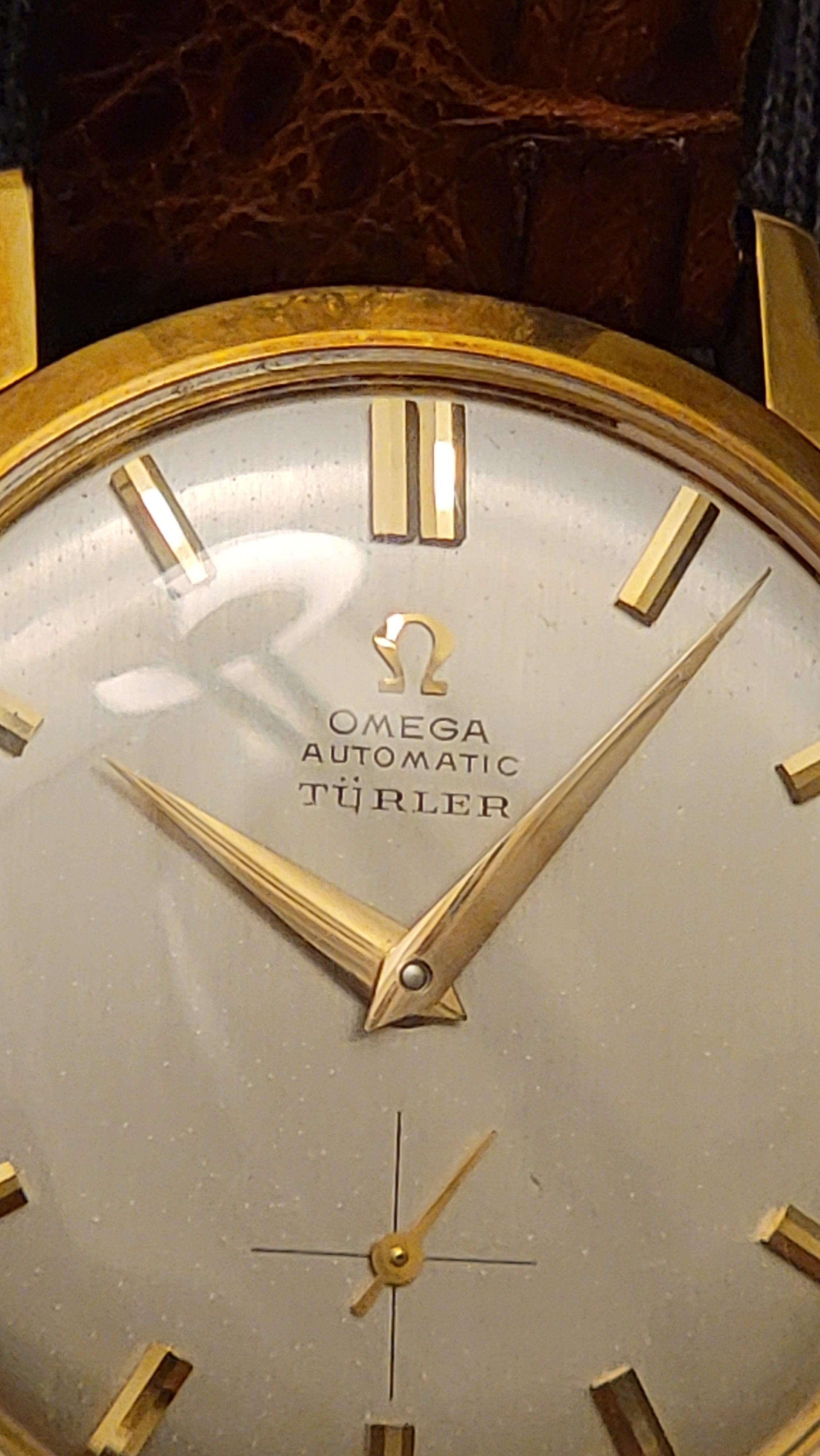

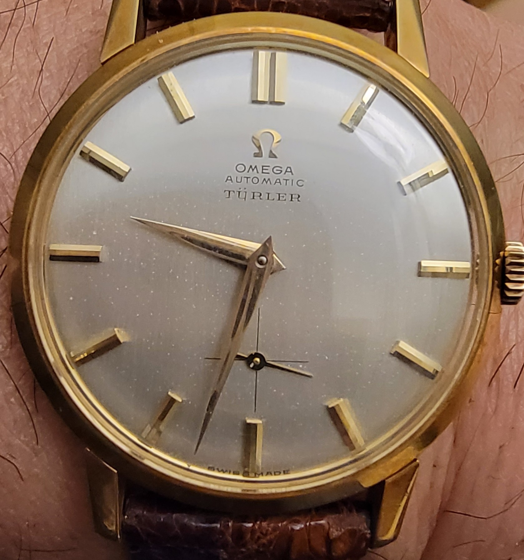

Is this Omega Turler without minute markers legit? I saw some seamaster without markers before. Need help.

Doesn't leave me with a good feeling. The Turler name doesn't mean anything in terms of value...maybe even a negative. The missing minute markers don't (literally) add anything to the watch's face and appeal. If you can, I'd say move on.

The TURLER signature does not appear to be original.

I’d vote redial. “Automatic” is all over the place as far as spacing and letter size, same with the umlauts on the U in Turler. But hey, I’ve been wrong before on dial originality.

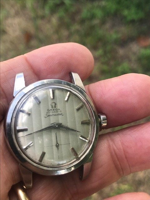

some solid gold models didn't have minute tracks for simpler looks
1,024
4,126
I vote for the redial.😀
In my opinion, if the dial was special type such as the linen or ribbon type, then it can come without the minute markers.
