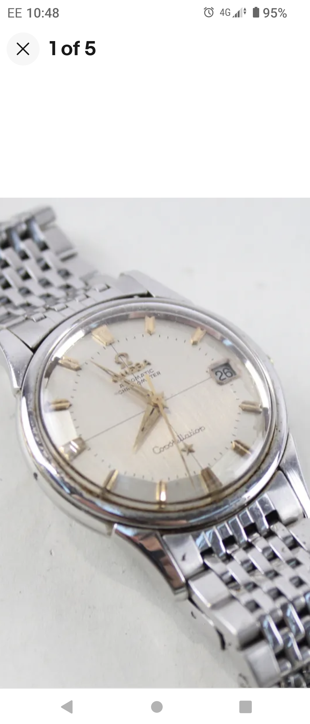

Interested in this omega constellation
Being sold as spares or repair it's got no crown and can't send any more photos of movement ect. Was just curious if you think the dial is original. I can see that the crystal is and straps. But obviously missing crown. Are they crowns easy to find for this model? . thanks appreciate all replys

Dial refinished, who knows how bad the movement is?
Yea it's a gamble I was thinking around £230 max. It's currently at £350. And no idea what the movement condition is in.

The case isn't very good either. The bracelet may be worth something, but I have no idea if it is Omega. I think you should pass.

Yea it'll get bidded up to silly price I bet. Thanks for your reply

Agreed, - the legs of the M’s are too upright, the R at the end of chronometer is out on a limb and the crosshair strikes through in all the wrong places.

It's now up to £1000 jesus
The eBay ad says cal 562 … massive red flag right there!

its the elusive chronometer rated cal 562 - that no-one on these boards (the largest collection of Constellations, globally) will admit to owning.....😒
edit: one day a genuine one will show up! (possibly)
