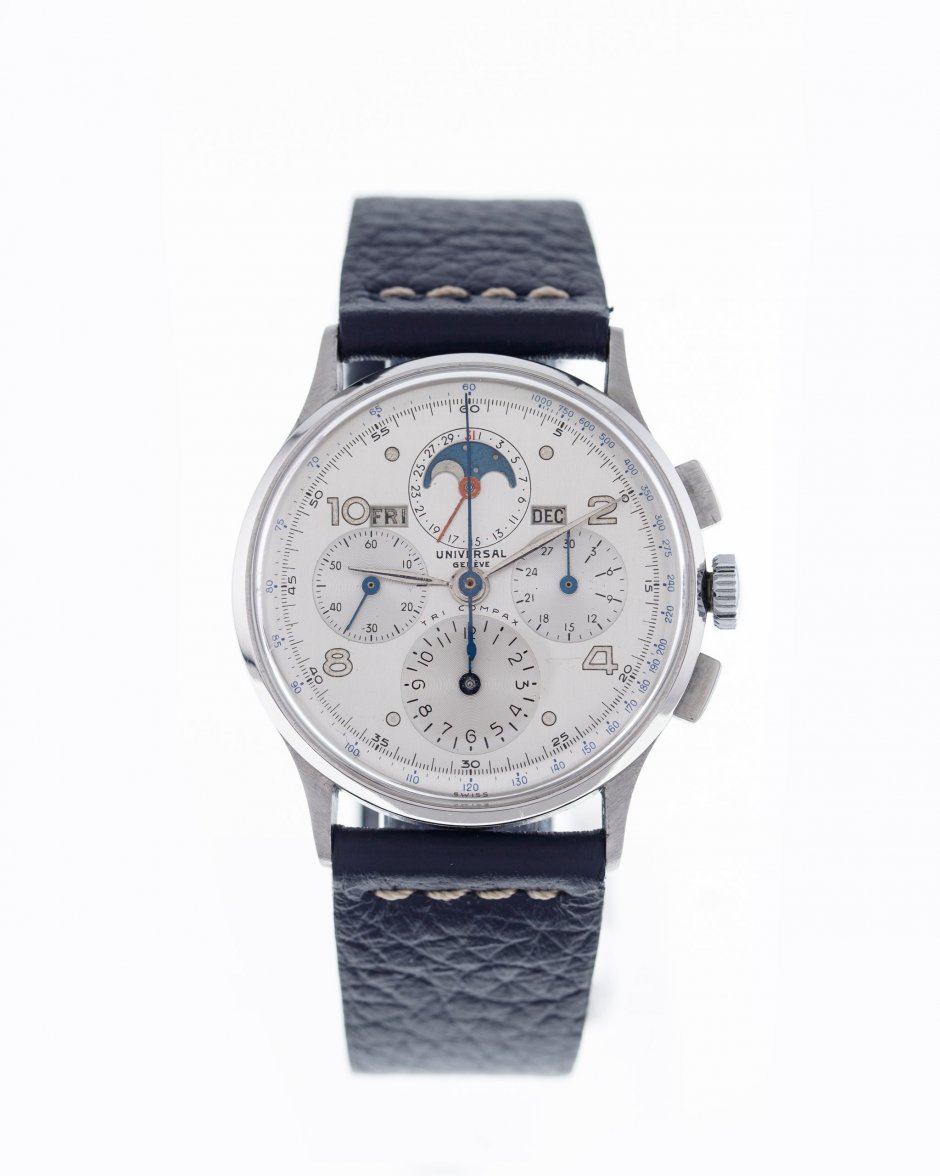

The case: Looks good except for what may have been an attempt to polish the inscription off the back. Crown is original.
The dial: Looks great..I cannot tell if it was ever lumed. Don’t think it was.
The Hands: Subdials/Chono sweep are good. H/M hands need to be replaced. Fortunately this is possible still.
The Moon: Is a service replacement. This was common as the moon faces did not hold up well. 50’s saw these silver moons as standard and deteriorated moon faces were changed out.
Wearing: These are indeed a great size. I have a 22242 that I love.

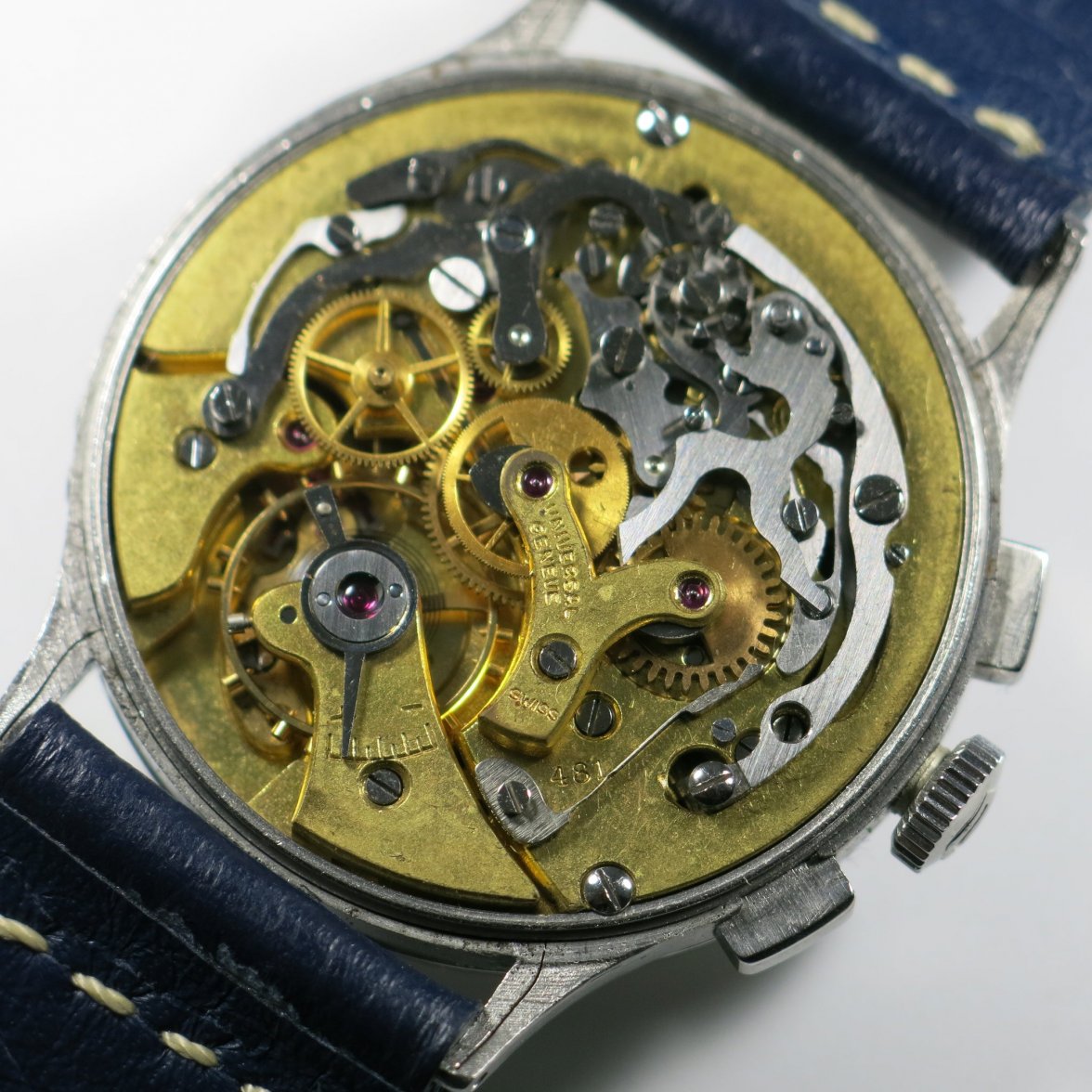

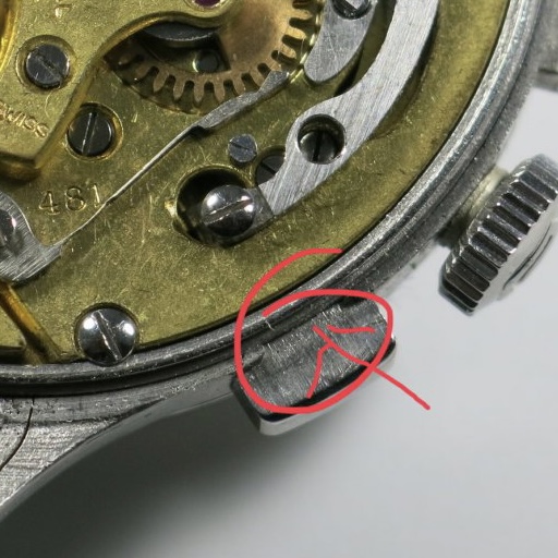

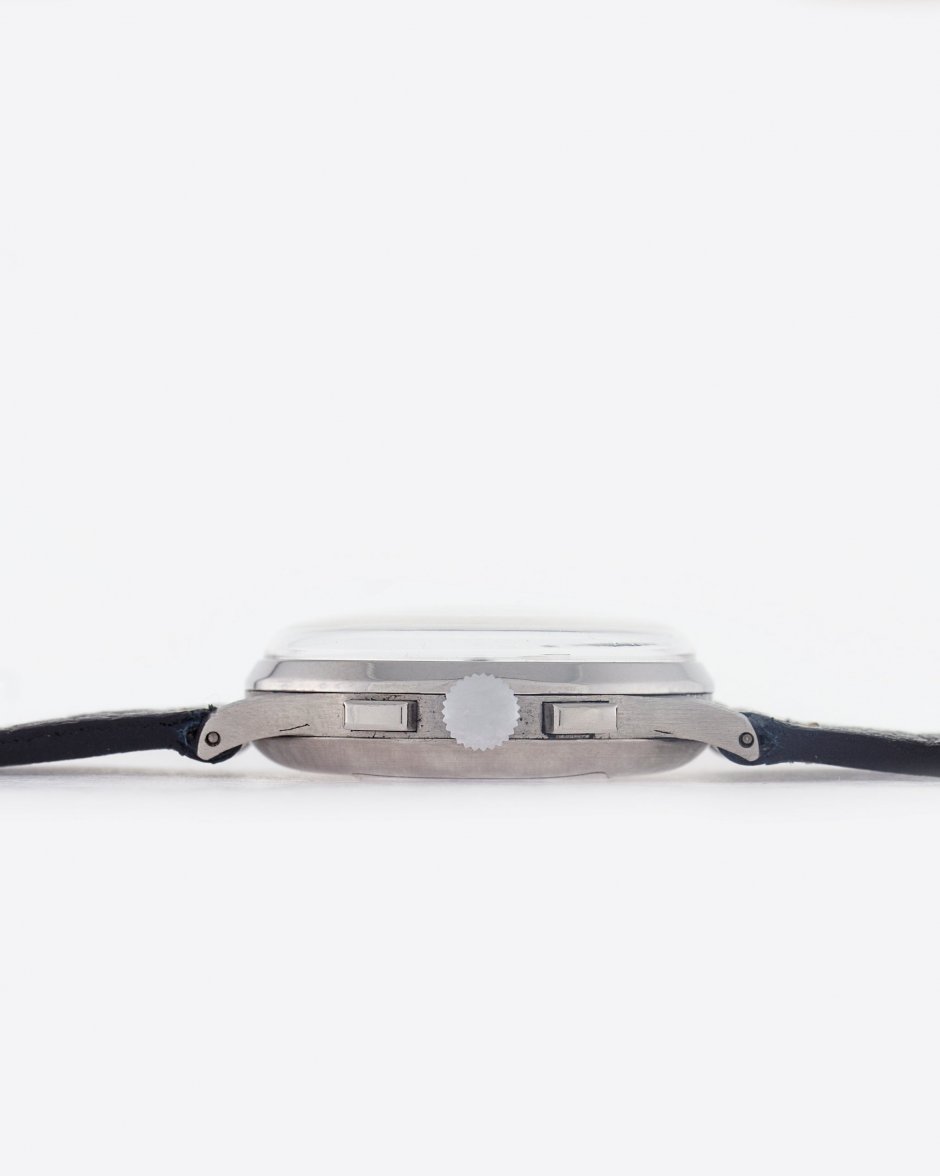

The case looks damaged by the upper pusher and the pictures show two different crowns?

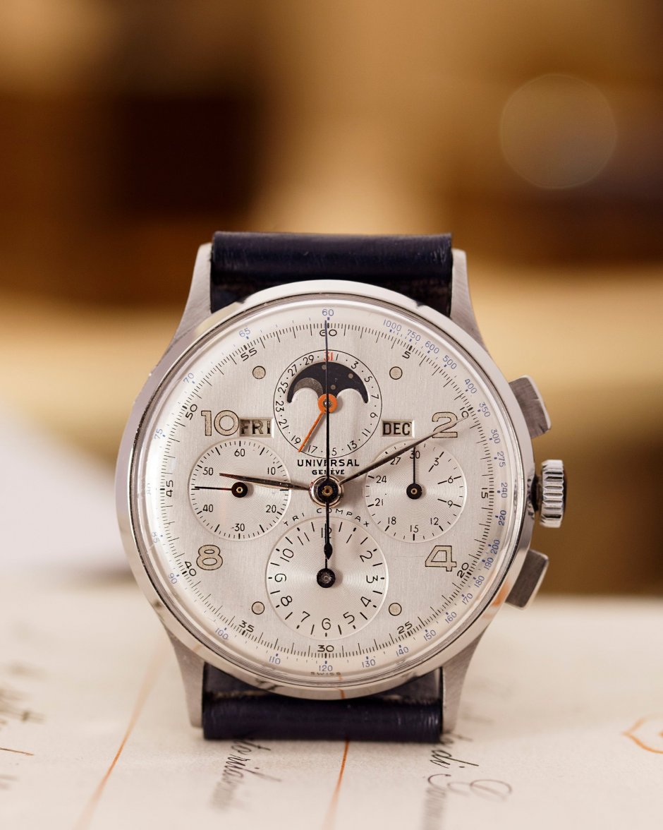

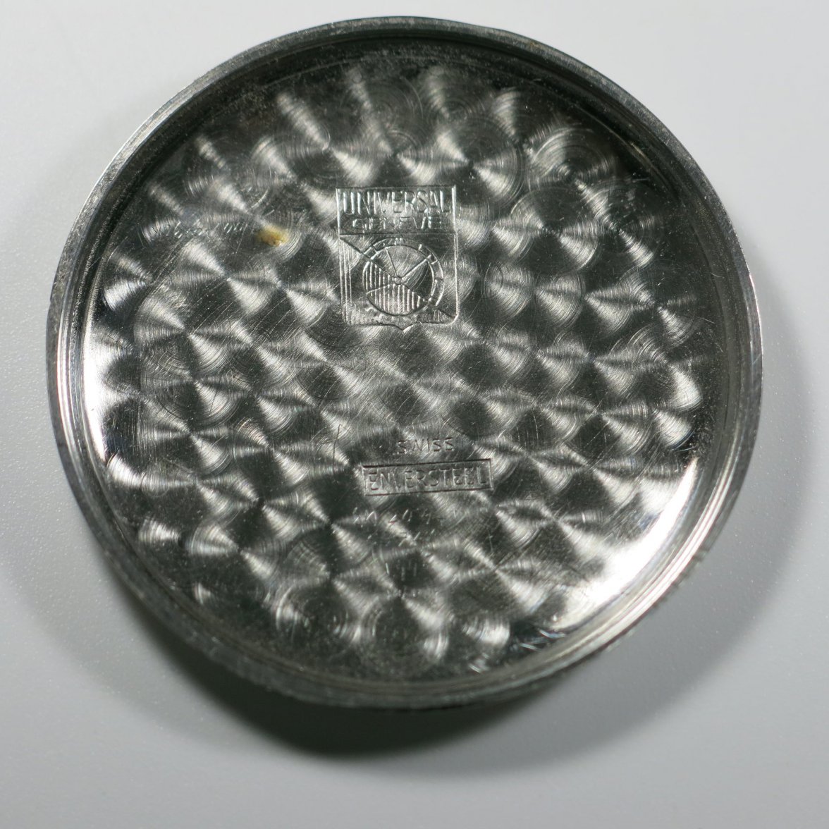

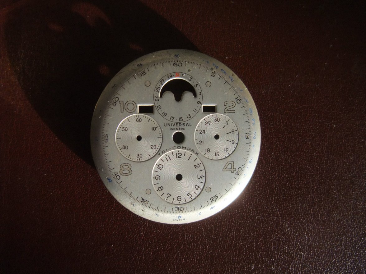

First of all, and it cannot be told enough, the case reference has nothing to do with the dial and hand configuration, at least concerning early Tri's. So if you cannot find another watch of the same reference with this dial and hands, that tells you nothing.
Larry has already summed nicely up the most points. But, as @rustynuts has mentionned there is corrosion on the case which someone tried to polish away. The polisher knew what he did so the case still looks good, but Imho it is more than lightly polished as can be seen on the back and on the tip of the lugs.
According to the serial, the watch is from 1945, not 1950, so the moon disc is a later replacement (as Larry said).
The dial is a service dial with short-tail 6 and 9 and the missing hyphen between Tri and Compax. More information here:
https://omegaforums.net/threads/ug-...eferece-guide-read-entire-thread.48137/page-7
Coming to the lume, those dials (original, not service) existed with and without lume. This one comes from a different reference, but is completely original:
and lastly, concerning your statement:
but this is apparently a man who know these watches very well and is highly, from everything I can tell, reliable.
Check this thread:
https://omegaforums.net/threads/bernardini-100-ug-event-in-milano.66000
By the way, what's the asking price?
Check this thread:
Absolutely right on the dial. Missed that … Moon makes sense now since they were changed together. What I don’t get is the hands. Also missed who is selling this. Now I really don’t get the hands. He has parts. He knows better. Given his prices, I’d demand a set of correct hands.
What's the problem with the hands? Leaf hands are totally fine, if the dial is not lumed.
But agreed, it's hard to tell if the dial is lumed or not.
Ok went to his store. The hour hand has a broken tip, no lume on the dial. I’d ask for a new set of hands or at least a new hour hand.
yes the case damage is a major issue. Plus the service dial. Plus the replaced moon disc. I can't quite tell on the hour hand, it looks a bit wonky.

Just figured out what you guys are seeing. Yep chunk is missing. If the price is right, the service moon and dial OK. The hour hand is damaged but is addressable. The case damage however is a dealbreaker. for me.

First of all, I must say, that this is some very, very impressive combined knowledge that you guys bring to situations like this. I read and re-read all of your replies and even went back to the images to verify my understanding.
I grasp all of it except one thing, but allow me to summarise my thoughts below so it's clearer:
1 - As suspected the hands (specifically the hour and minute hands) are replacements (I sort of pat myself for noticing that by comparing with similar listings on Hodinkee and on the UG reference pages). I assume what I refer to as sword (or alpha) hands would be right for this reference? A certain seller on ebay frequently brings these up for sale but we can discuss this if there is an intent to pursue (which now seems to be a bit in doubt). I specifically asked about the originality of the hands and was told it was original.
2 - I think the dial was one threw me off the most. It is in great condition (though weather and time beaten, as it should be), however I couldn't (and still can't) find a similar dial from that era so it made me reconsider whether it was period correct. Again, my hunch is confirmed by the thread linked by @Oku (many, many thanks), that since it lacks the dash ("-") between Tri and Compax it must be a service dial. Which is a shame because it is really a good condition, quality dial. I did not specifically ask about the originality and period correctness of the dial. I will also now reference that other thread in it's entirety so that I am better informed. A question, knowing that any real insight from UG itself is missing - how accurate are the inferences made on that thread or are they best speculative?
3 - Moon: Since you've taught me how to fish so far, I'd like to know, how did you determine that the moon is a replacement? Especially since the moonface isn't even shown....
4 - Case. This is the one that really puzzles me. I can see dings and small dents but I can't see the case damage that everyone refers to especially near the upper pusher. Can someone highlight or point out what they specifically mean about the dial being damaged?
5 - Crown: I see now in the movement picture that the crown does appear to have a UG logo which it shouldn't. I specifically asked about the crown and was told it does not have the logo, so is the movement picture even of the same watch? I'll have to ask again...
6 - Hour hand tip damage: Yup, can see it on a pic that I didn't share (see below).
7 - Price: They are asking 8500 Euro but it's negotiable. This puts it in the same ballpark as other models of this reference sold by Hodinkee in the past couple of years (but they had the right hands and I assume but have not verified, the dials as well). The other tri-compax are gold which I would not consider (only SS unfortunately). They have 2 other UG that I am interested in that are cheaper but they aren't Tri-Compax. I will talk about those separately, if I wish to pursue.
Again, incredibly thankful, not just for the hints and tips but the learning!!!
Looking forward to more of your comments and thoughts.

Case broke away. It’s been worked on. My guess is the dealer replaced the crown with a period correct one. Given that it has service parts it would be logical that the crown was replaced when dial and hands were.

To sum. Damaged case. The tip on the hour (leaf) hand is broken off. The moon and the dial are UG issued service parts. As to how we know about the dial and the moon, this is detective work done by the network, some of whom knew UG employees or knew people that did, and uploaded to the forum. Regarding the moon, these appear on original 50s watches as does the crown logo so we “know” this transition began late 40s early 50s. It is important to remember UG is dead as a doornail. It was chaos at the end and folks just grabbed parts and what documents they could salvage. Sala did his best but even his book is incomplete. We see patterns and make inferences. If you seek absolutes, there are none. These SS models from the 40s saw hard duty, it was common to replace worn parts, no one thought that folks like us would be obsessing in the next century. This dealer is a UG insider, thus the frustration on our part that he would put this out.

its good you asked here before buying. 8500 euros is way too much. For that kind of money you should be getting closer to a completely correct oversized SS Tri.
As Oku already said, the case reference tells you nothing about the dial or hands type, there are not fixed combinations during this time period. It's completely possible and even likely that leaf hands would have been original to this watch, but there is no way of knowing, since we do not even know the original dial.
the moonphase disc is visible enough in photos to see it is the later type (without face), and the case serial places this in a time period where the moonphase disc should have a face.
I think all your other questions have been answered. Happy Hunting ! Be patient and keep running options by forum members.

The two killers on this piece IMO are the hour hand (fixable) and the broken case below the upper pusher (deal killer) .
