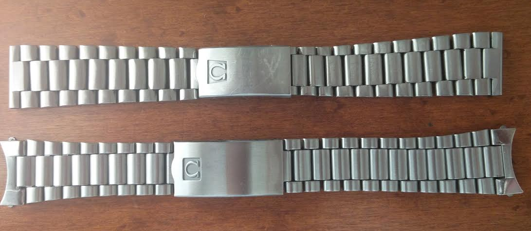

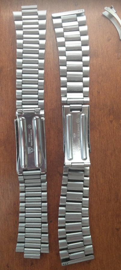

I have both. There are some differences, so and more easily seen in a pic
The Newly minted 1171 is on the left side, the vintage on the right side.

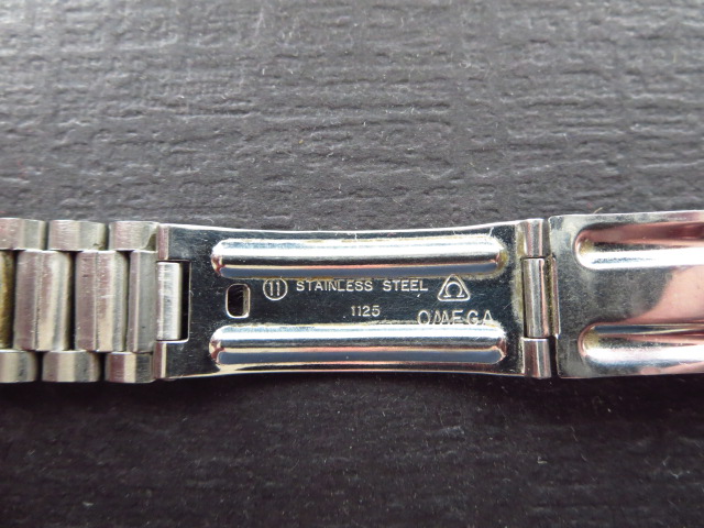

On a related subject. Can anyone direct me to information related to Omega bracelet 1125 with circled 11. What watch this bracelet typically came with?.
Note how the clasp on the newer one is quite a bit longer than the original.
That's a bonus when you have a large hand and skinny wrist like I do.

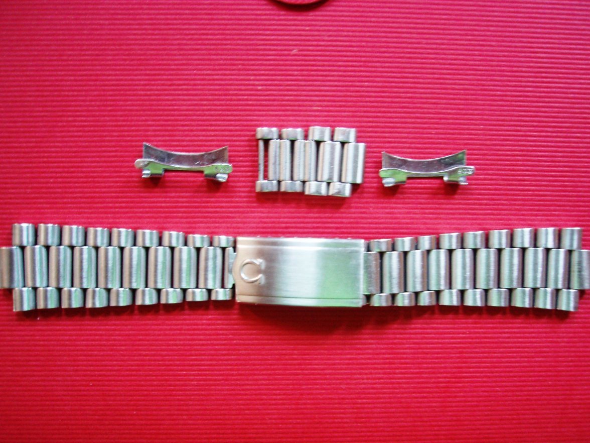

Staying on the 1171 theme, is it worth bringing up any endlink differences too? Take the 633s for example-vintage vs. new. I understand there are slight differences but presumably they are both interchangeable with the original 1171 and 1171/1...........?

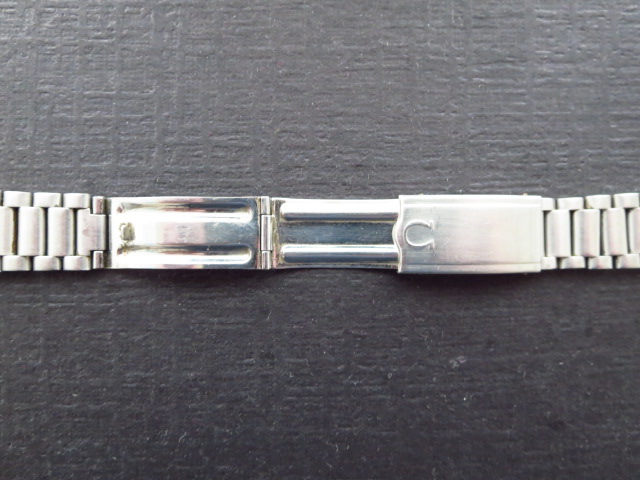

1125 is not on https://issuu.com/mstanga/docs/tab_bracciali_omega_ultima.xls, so I'm guessing that it's not vintage. I know a lot of folks use them on the FOIS for a vintage look.
It is vintage only, and looks essentially the same as the vintage 1171 and 1162 including the screw pins and 16mm clasp. It's not documented to be equipped on Speedmasters, but seen more on Seamasters - chronographs and non-chronographs.

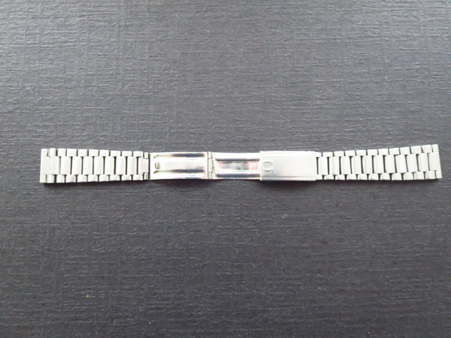

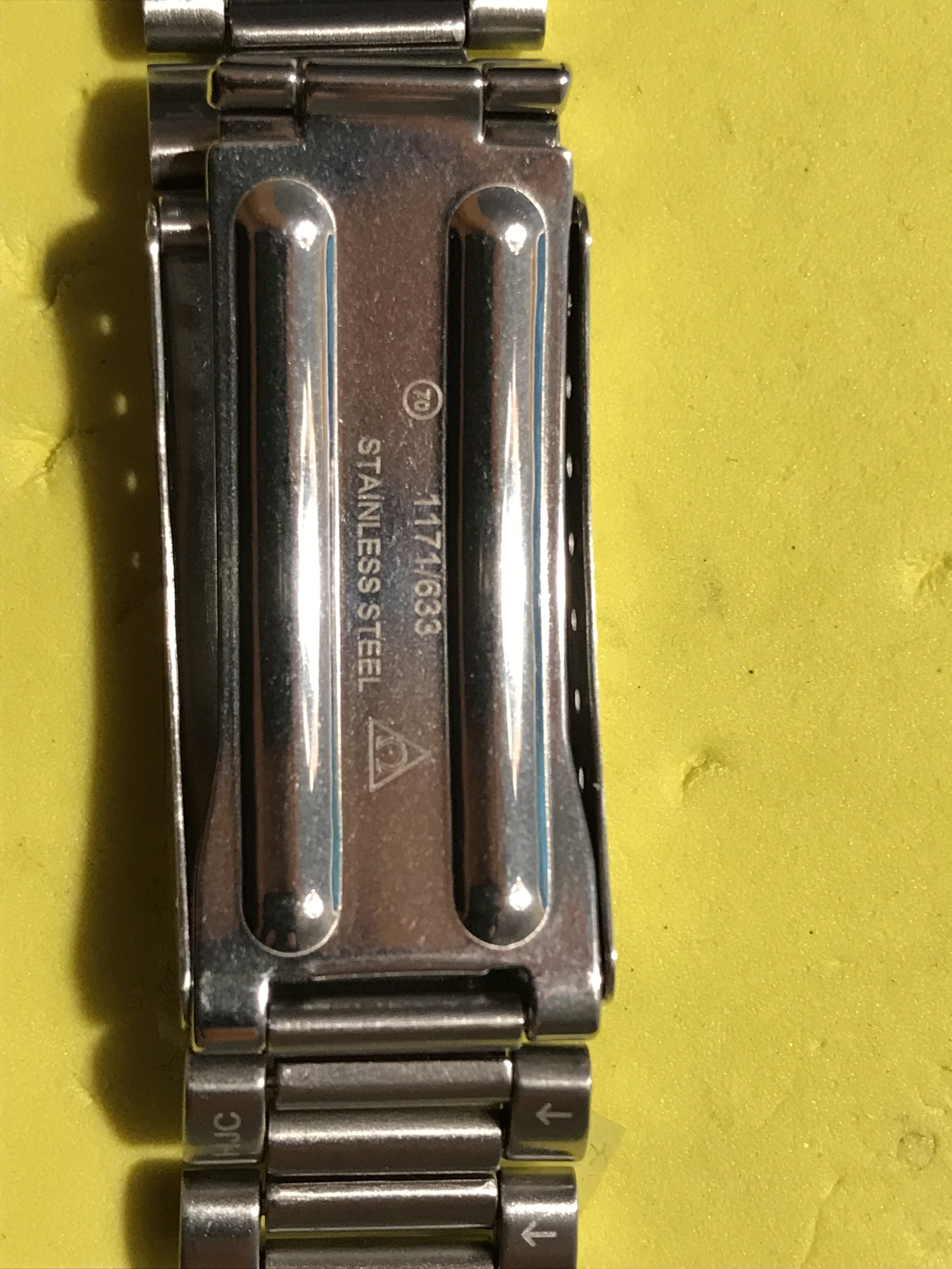

How 'bout I really "muck" things up. I believe this to be an older service 1171 bracelet with screw pins.
This came with my Straight Writting 145.022-69. The original 633 end-clips were included 😀
The raised logo clasp cover was the first iteration of the 1171, like mentioned by Ash. Not only that it was the only type of clasp cover for this bracelet until 1978 when the sunken trapezoid logo was introduced, according to AJTT and therefore for most of the -69, -71 and -74, the correct 1171 bracelet should have this type of clasp cover instead of any of the sunken ones. The sunken square was introduced in 1981.
awesome info, thank you! is it mainly documented by owners? AJTT? other? I'd love some reference points.
2,876
1,958
Just my observation. It's not covered in either AJTT or MWO, not sure if anywhere else though.
PS: I think it's most prevalent on those sparkled Seamasters, one of which you have.

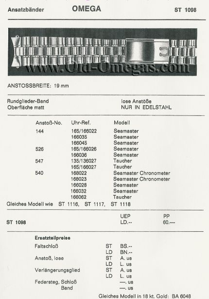

then I must have one! I've got a 1098/540 for it, but it's not in great shape. maybe a 1447 would do.
2,876
1,958
The 1447 is much nicer, but not sure if it'd fit with any 19mm end links for your sparkling, and you've already got the correct/original already.

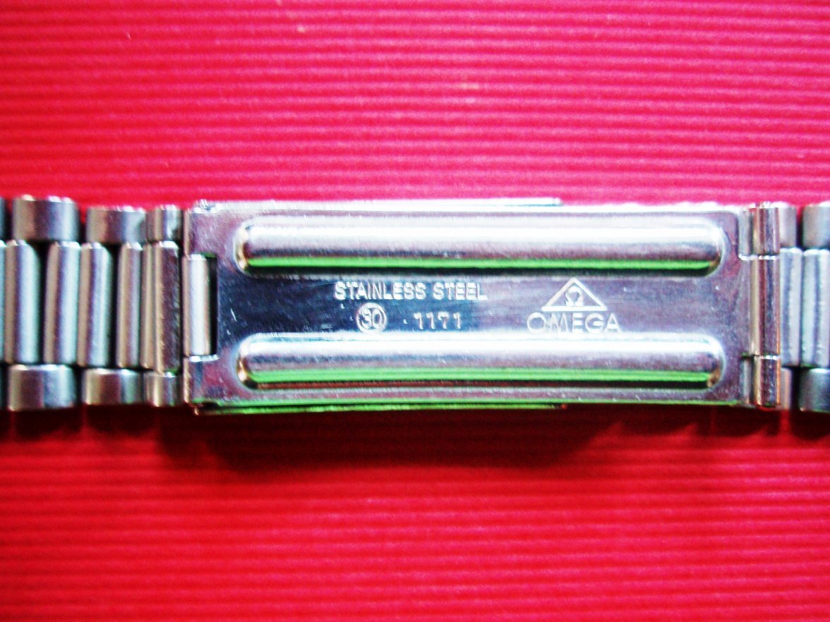

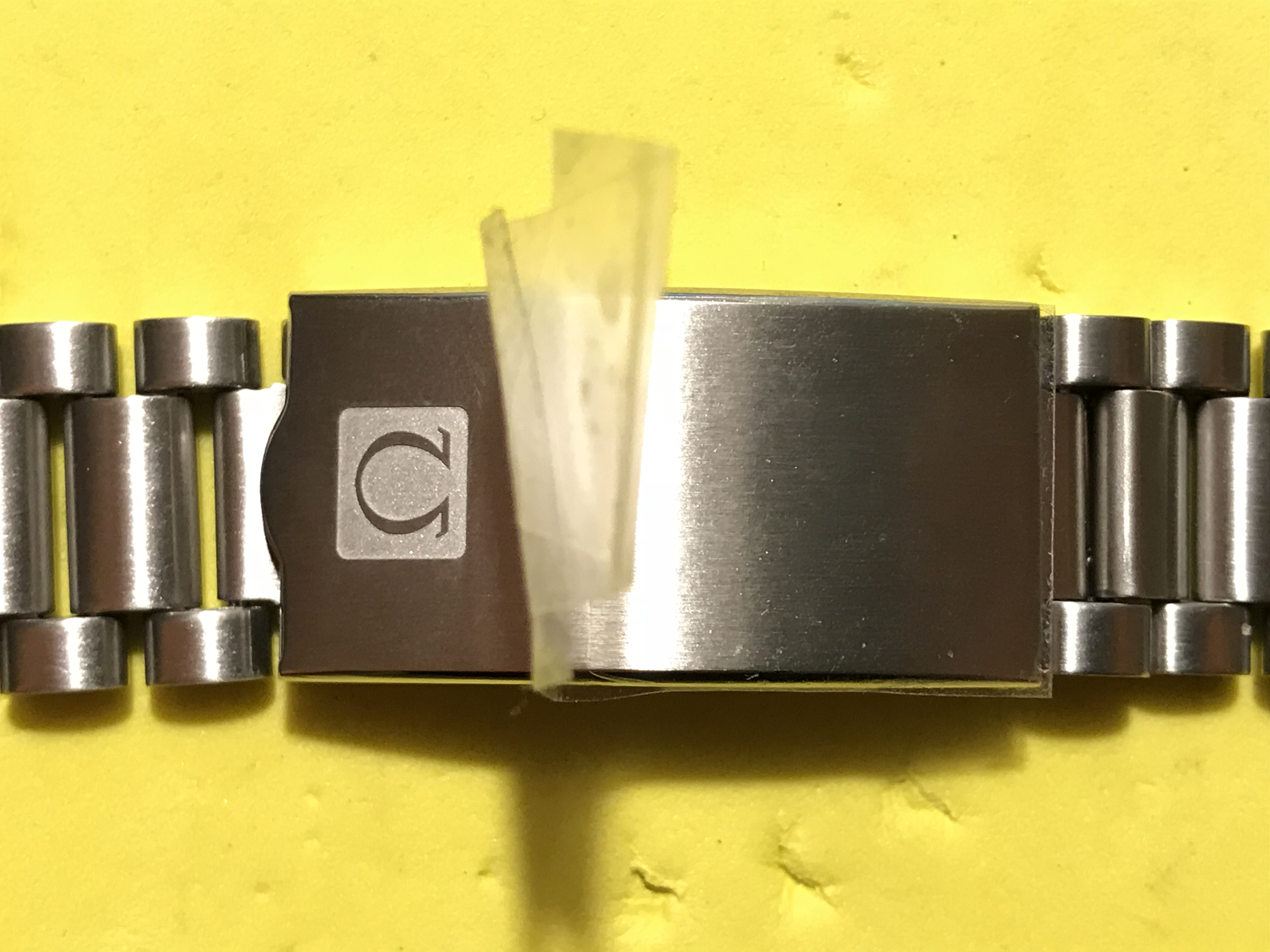

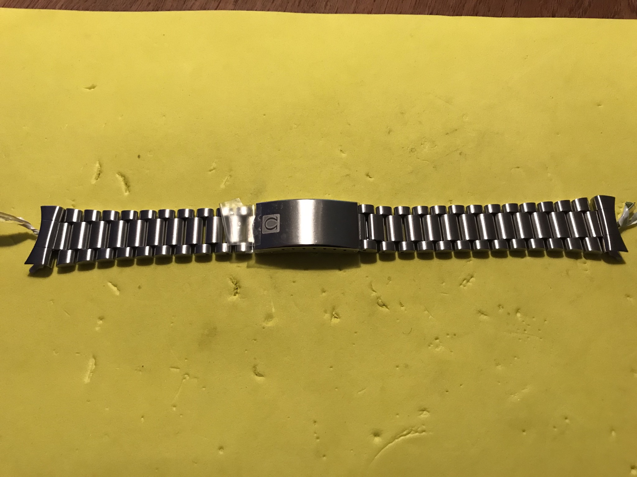

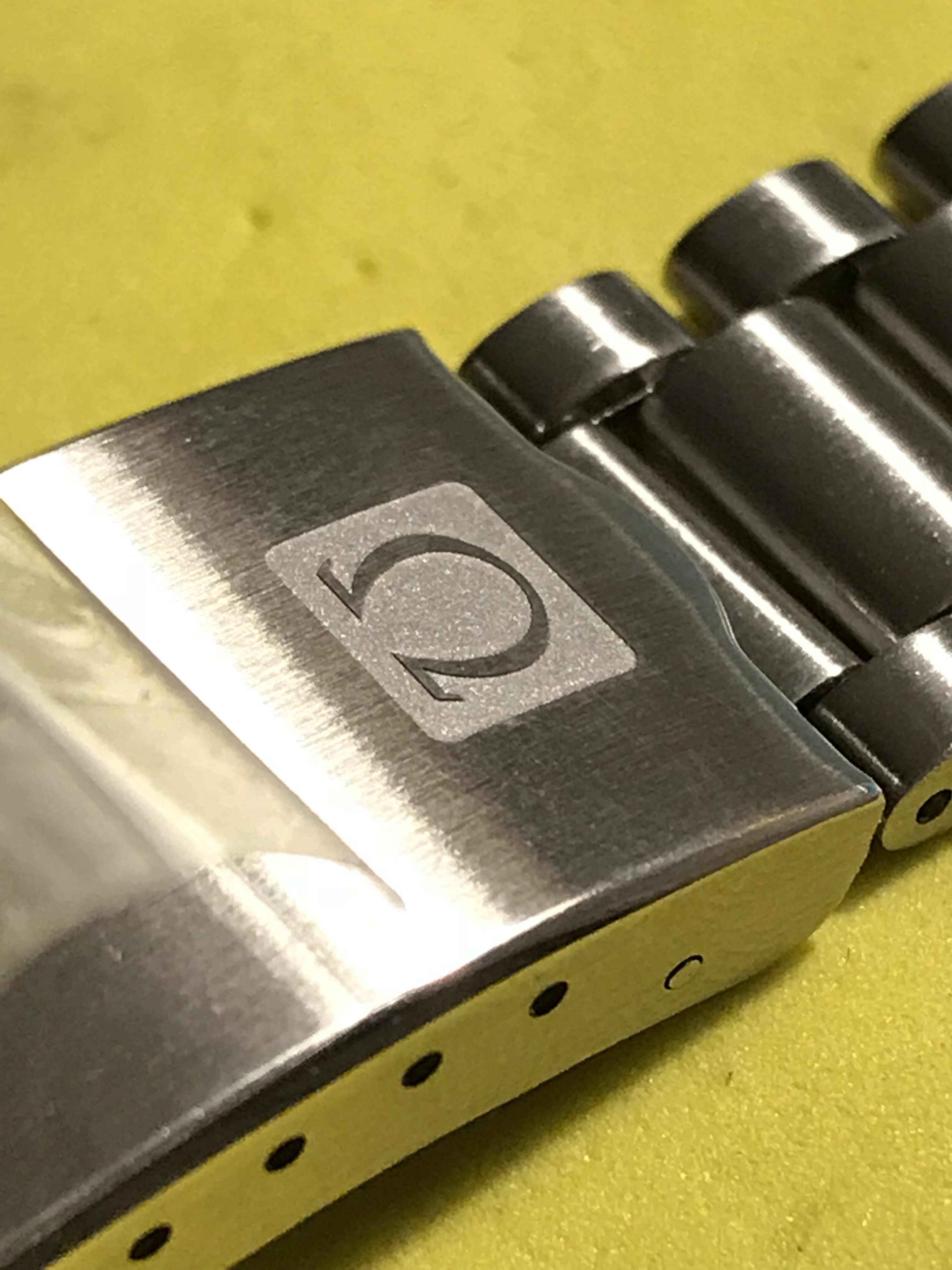

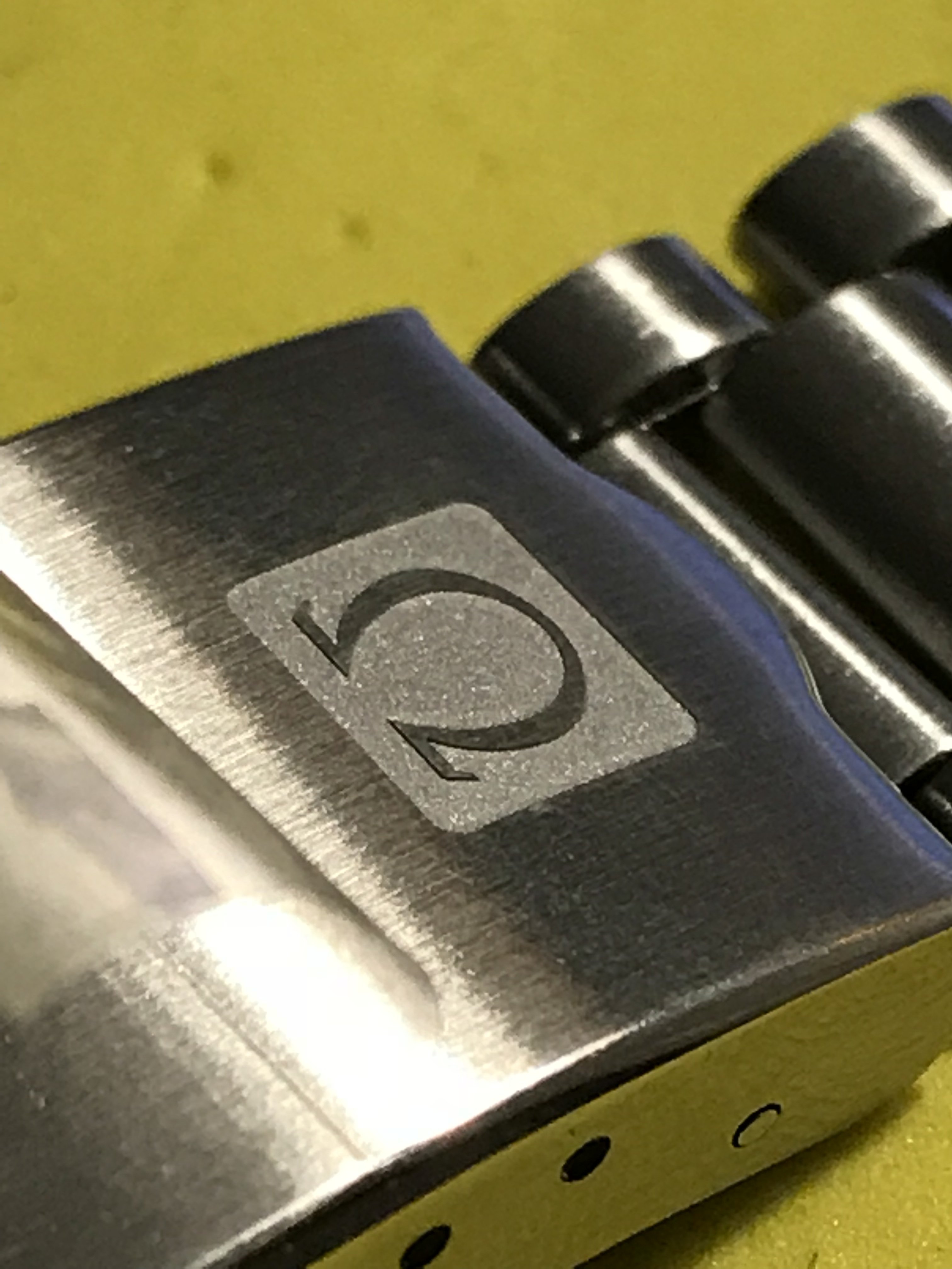

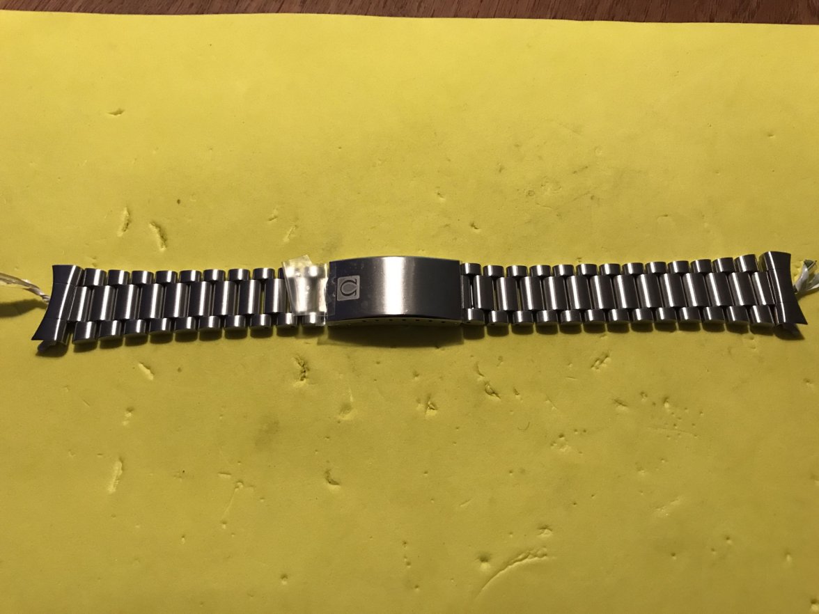

Hi All
I have just bought a new, reproduced, 1171/663 bracelet on eBay (560USD), please see pictures below.
My question in here is: Is it original Omega or a replica??
The square and logo is laser etched on the buckle, and it has the number "70" in the circle on the buckle. Further, it does NOT say "Omega" under the triangle.
What are your thoughts?
Many thanks in advance.
Soren
458
2,135
That's how I never saw it in 1171. Either that is brand new, or it is a fake.
5
It is brand new, but the question is if it is from Omega or a replica? Does anyone have one like it?
