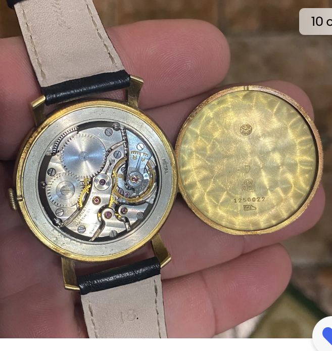

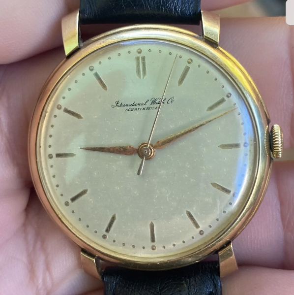

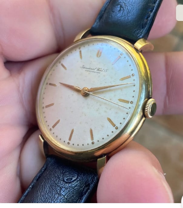

I’m looking to purchase my first vintage watch - a simple gold dress watch 33-35mm (not plate or rolled). I’m really pulled toward IWC and while I’m still new I know the cal. 89 is well-regarded. I’d love to hear any comments on this one. I found online for sale. The seller is asking $1500.

I like vintage IWC dress watches as well but one needs to watch out for redials as they are notorious for them. Hard to decipher from your photo if that dial is Kosher but perhaps another member will be more confident in making that judgement.

Personally I've really enjoyed owning quite a few vintage iwc dress watches in my time - I'd say you could probably find something in better condition than this. The movements are pretty robust so you'd probably be fine there, but the dial is a bit damaged and the case also, and the hands. looks like the claw lugs case which means it's 36 or 37mm which is nice.
As far as I can tell though looks like not-a-redial so that's good. Something closer to 1000 could be fairer to be honest? Or maybe 1200 or 1300 USD. Similar to rolex, I think the value derives from the condition of the dial and hands, and secondarily the case.

I like this reference, but it's not a good example. Ugly dial, lugs thin and bent. On the other hand, a good example will cost nearly 2x the asking price.

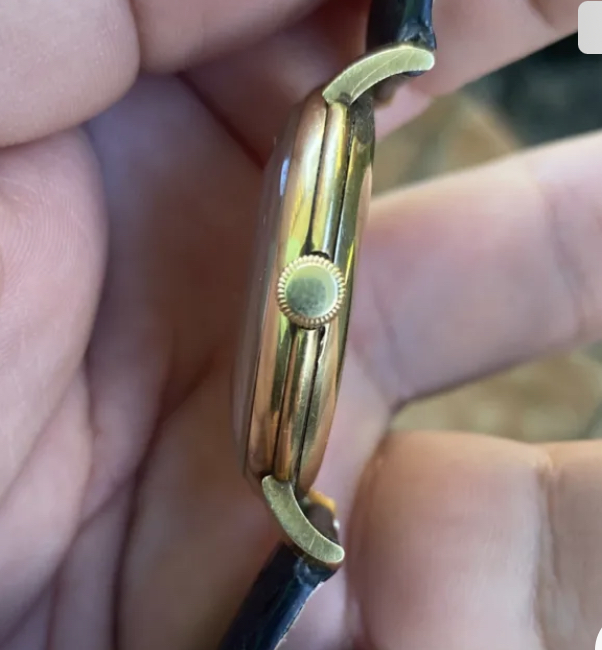

It is not unpolished. The original shark fin lugs are thicker and more wedge shaped. I suggest going a google image search and studying a bunch of good examples. The shape of the lugs is the key feature on these.

However OP's dial seems repainted to my eye: logo looks a bit off and the lack of "swiss" at 6 makes me suspicious, because I always see it on these.
