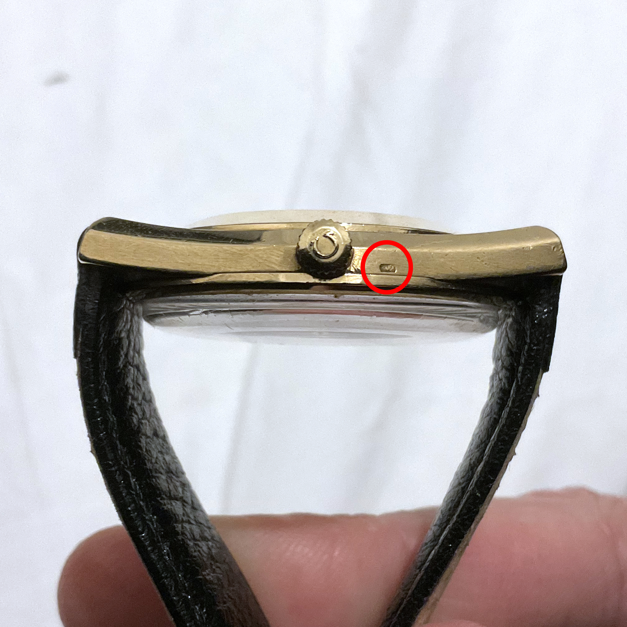

After reading Ashley's awesome article https://stories.omegaforums.net/constellation-monocoque-piepan/ on the Constellation Monocoque watches I dreamed of obtaining the 168.025 pie-pan tuxedo. It took one year before one finally appeared online for sale. I took the chance and bought it. In the meantime, I read Desmond's blog http://download1923.mediafire.com/9x9xkg9ymu7g/zjzxx3wwtdh/omega+constellation168.025.pdf to educate myself, but with so many variations in the Constellation range, I feel unsuited to make a qualified judgment of the watch. Hence I turn to you and ask for your opinion. Due to the case design, I haven't documented the movement, so I can only provide external pictures. The hands move but I prefer not to hand-wind the movement until a full service.
My questions:
Please judge the possible authenticity and overall condition, is it an 18K gold case?
I couldn't spot an etched Omega symbol on the crystal - does it mean the crystal is an aftermarket replacement? The modern Omegas that I bought brand new in an OB do not have the logo on the crystal either, so does it matter for authenticity?
The crown - Desmond states that the 168.025 has some different crown than the companion series 167.015/25, is this one legit?
The case contains some weird marks/dents (signaled on pictures). Do you have an explanation for them?
Thank you!

The thing near the crown is the hallmark, caseback thing is a dent, you could easily wear it down and get rid of it, if it causes discomfort on wrist

This is one of the very few watches where it’s really unnecessary to open it up, unless it’s being serviced.
All the information you need is in the outside of the case, including the Swiss gold hallmark. The crowns for both the 168.015 and .025 are the same and were made to fit only this case style. This crown looks OK to me.

Thanks for your observations, the hallmark and dent are now clear to me. What about the case itself? I assume 18K gold is soft, hence the scratches accumulate and the edges soften over 50 years. But what would be your assessment? And the logo-less crystal?

Yes, the stars and observatory seem a little different than other Connies I've seen, albeit all were different models, none was 168.025 in gold. Given the variation in dial configurations, I cannot make any conclusions about the case. I tried searching for Swiss hallmarks https://www.vintagewatchstraps.com/swisshallmarks.php but I am no expert and the imprint on the case is super small and maybe a little patinated for me to decipher. I hope there will be something on the back of the case once the watchmaker extracts the movement.

your case and caseback are correct for a Swiss gold168.025
Gold 168.025s don’t have brickwork observatories.
See this link from Desmond’s site
https://download848.mediafire.com/k.../8kofwybgfsqmsp1/Constellation+medallions.pdf
The case has the Swiss Helvetia mark for 18k gold - the lower mark shown here but on its side
