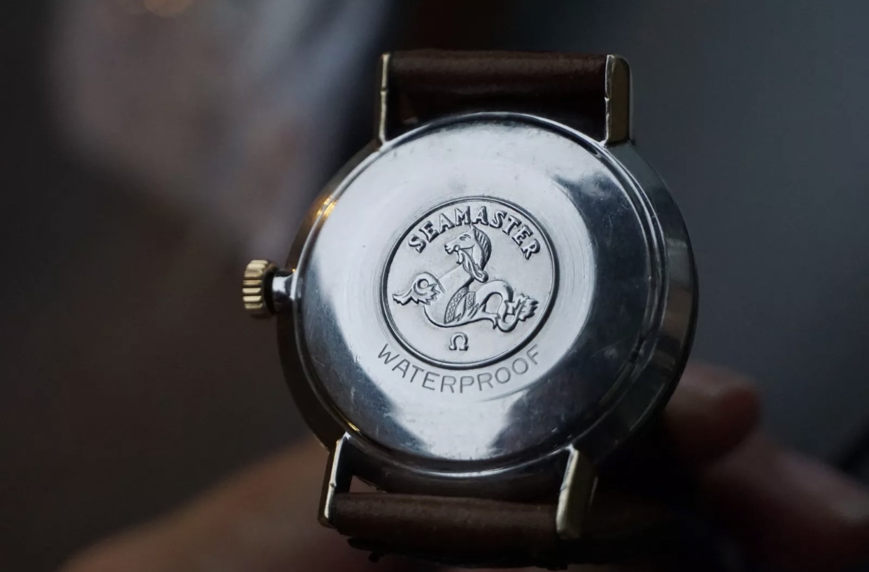

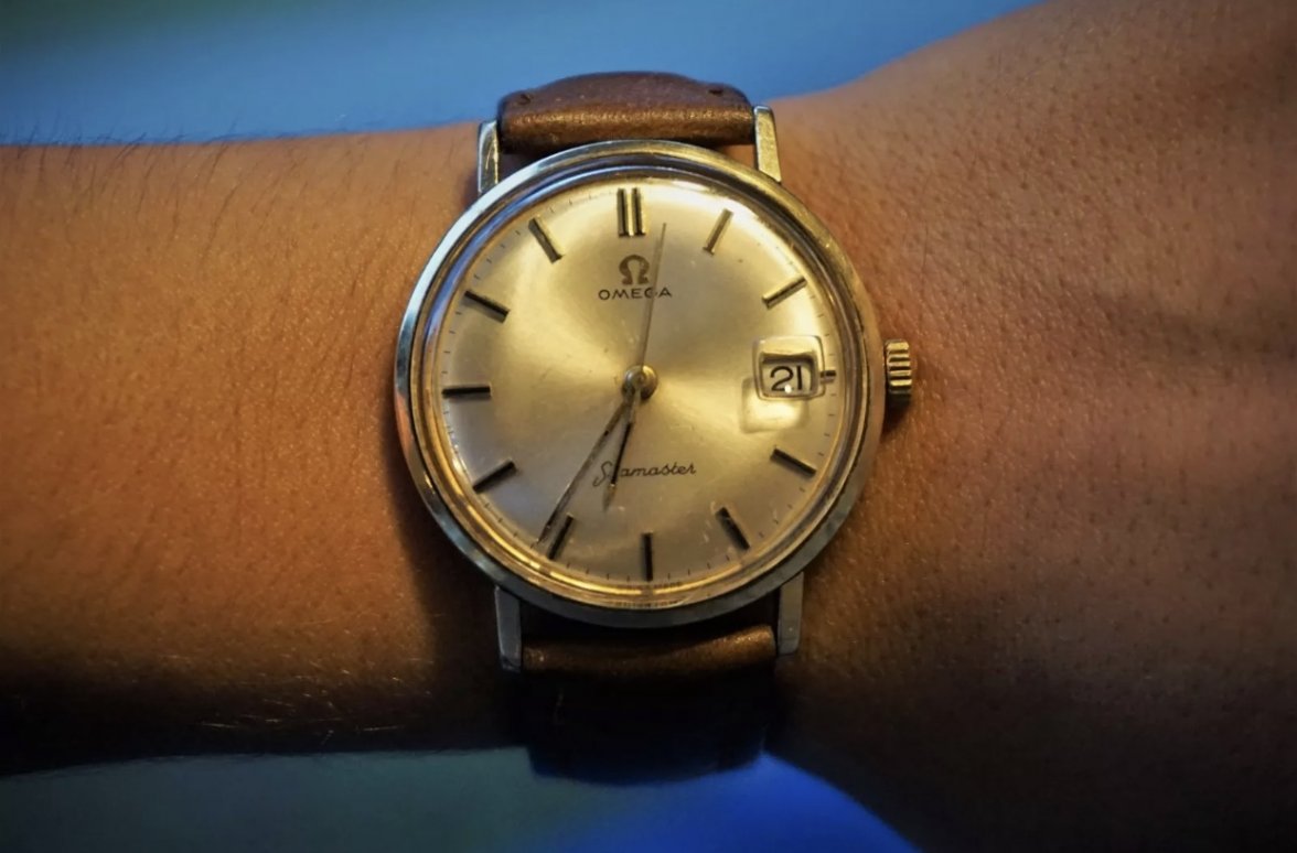

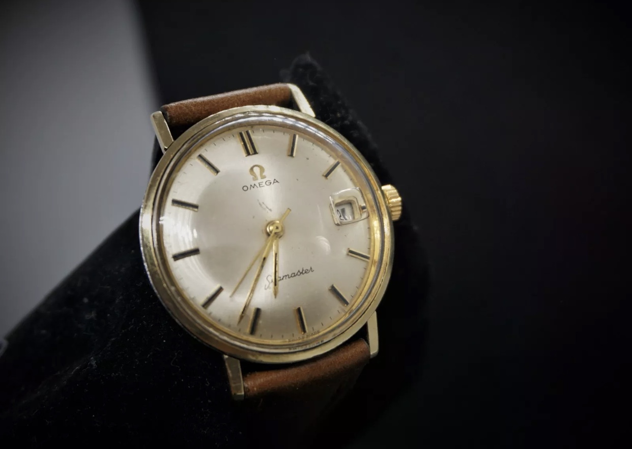

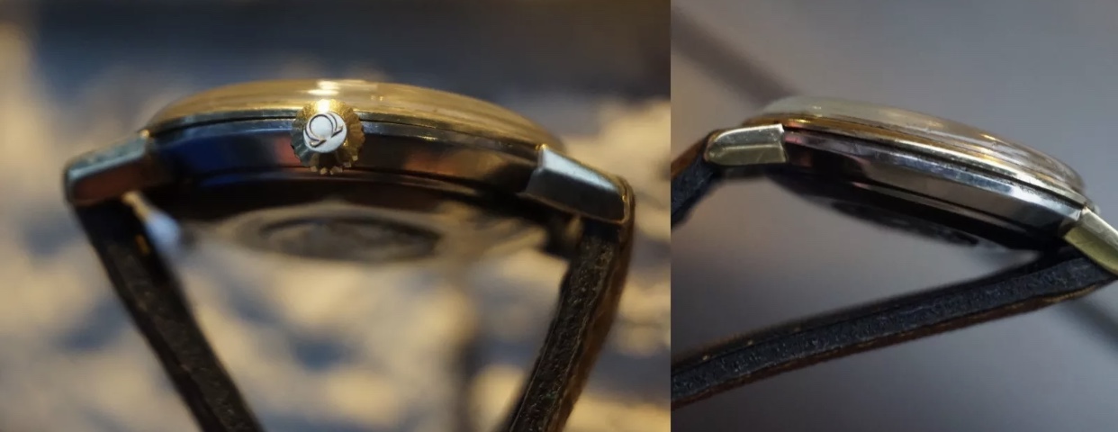

    Hello!
    New member to the forum here with some questions about an Omega for sale on eBay.
    I've been reading through some stuff here to try and get more information on Omega watches in general, but I have to admit I know just enough to know that I'm essentially ignorant.
    Below are some pictures of the piece in question. The thing that makes me somewhat uneasy is the fact that there aren't any pictures of the movement or the inside of the caseback. I'm not sure but I think the "Seamaster" on the dial is correct, and to my very untrained eye it doesn't seem to have been refinished. Regarding the hands, I haven't seen very many non DeVille model seamasters with them so there's another point of hesitation.
    What do you think? I'd rather start a collection of vintage watches off on the right foot than make a costly mistake immediately.
    Edit: per the post - This is a cal. 610 ref. 14775
    Edited Dec 9, 2018

    You're definitely going to be more confident if you can see photos of the inside. Can you request them?
  3. BenBagbag Dec 9, 2018
    2,820
    8,983
    Good luck getting those. This is a front loader case. Not clear I would even want someone trying to open the watch who didn't know what they were doing. I find these watches typically are less messed with than screw back or snap on casebacks.
    Tldr I'd be more confident buying a monocoque watch without seeing movement photos.
    Dan S likes this.

    The description states it’s a monocoque
  5. David_W Dec 9, 2018
    4
    After reading some more about these Omegas I saw where it was a front loader. It definitely makes more sense to me that they would have a tendency to have less tinkering done with them.
    In the description it says it’s an original dial. I can’t see any (in my opinion) obvious signs of a redial. What do you guys think? Unless the bidding really starts to move I think it’d be a good deal for sub $300 compared to the other Omegas with a dial this (I consider) clean.

  7. Edward53 Dec 10, 2018
    3,127
    5,384
    Photos not brilliant but the dial looks original to me.
  8. kelev_ra Dec 10, 2018
    492
    238
    If you like you could post photos once you got the watch. The pictures are just too dark...
  9. Hnansen Dec 10, 2018
    980
    2,089
    I am positive that the dial is not a redial.
