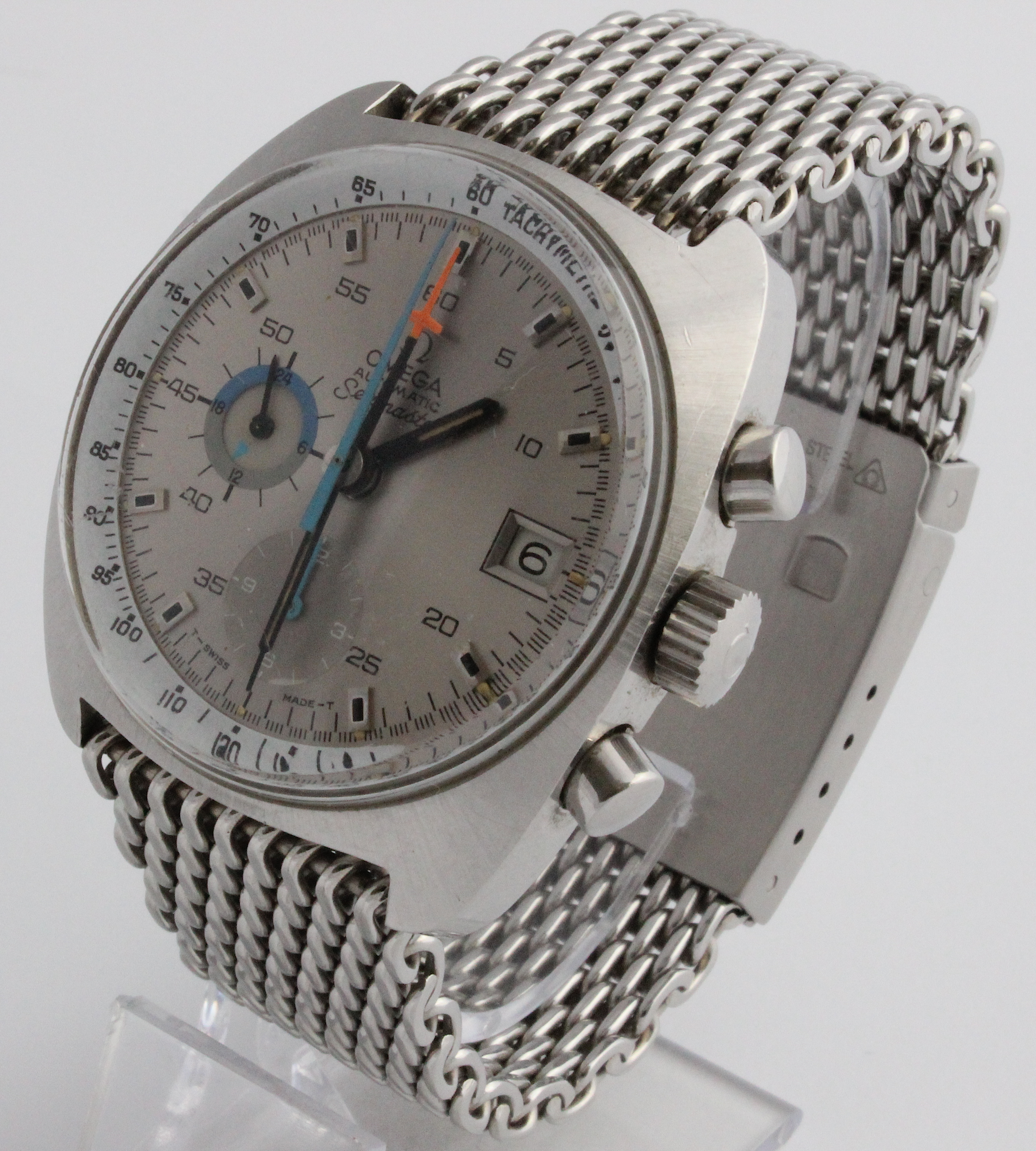

Lol much appreciated guys - yeah I tried to delete the thread because I realised these are somewhat rare and I just advertised it to the whole community of potential purchasers. Couldn't see any way of actually deleting it so I just wrote 'deleted post'. To a mixture of controversy and amusement all around lol
Anyway, I have attached a few pics of the watch from the advertisement including that strange caseback. It's being sold by Casowatches in Italy. From what I read they are a reputable seller, and they are telling me the watch is entirely original.
But it seems some of you disagree. I would be very interested to know. I don't think the bezel is from a GP yachting - the watch essentially looks identical to the Seamaster Yachting 176.010 to me, just with a different colour dial?
And it looks identical to the one previously on sale in Watchuseek as mentioned above.

Still think you're looking at a franken. The dial and bezel you show here are different than the dial and bezel in the WUS ad. Do you have a pic of the outside of the caseback? Here's what I see with the watch you're considering:
-Yachting case is correct
-Bezel is correct for a steel Yachting
-Dial and hands and caseback all appear to be from the more common 176.007
The dial in the WUS ad is an odd one- it follows the design scenario of the yachting but it is most often seen in case ref. 176.005 or 176.007, though has appeared on GP yachtings (which are even less common than steel Yachtings). So though it is hard to be conclusive my guess would be that this one is put together. See this thread and the links within for in-depth musings on all cal. 1040s: https://omegaforums.net/threads/176-007-and-cal-1040-family-review.32325/

I've never dealt with them, but I wouldn't be too hard on them either. There is no consensus on what is correct and original when it comes to cal. 1040 watches. Most dials, hands, cases, and casebacks for these watches are compatible across case references and in the 40 years since the movement was discontinued only certain parts were kept or still manufactured for replacements. Thus many "frankens" come by their franken status honestly at least. My above assessment is just my opinion based on observation. I've come to learn that when a dealer says that a watch is 100% original one should take that with a grain of salt. It may be 100% original as far as they know, but that's a claim that is almost impossible to prove.

I bought my favorite watch from Fabrizio at Casowatches, and found him to be very straightforward. We've chatted about a few other watches over the years, and he's always been very forthcoming about what's a redial, what's been relumed, etc. Though Andy K's point, above, is valid. Who knows what's definitively "100% original."

All-in-all, a good looking 176.001 - I do, however, note that the case-front may have been re-brushed (note the 'radial' rather than typical 'starburst' brushing); on the other hand, perhaps some 176.001's had radial brushing?
