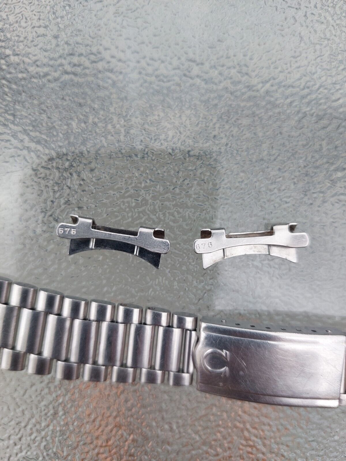

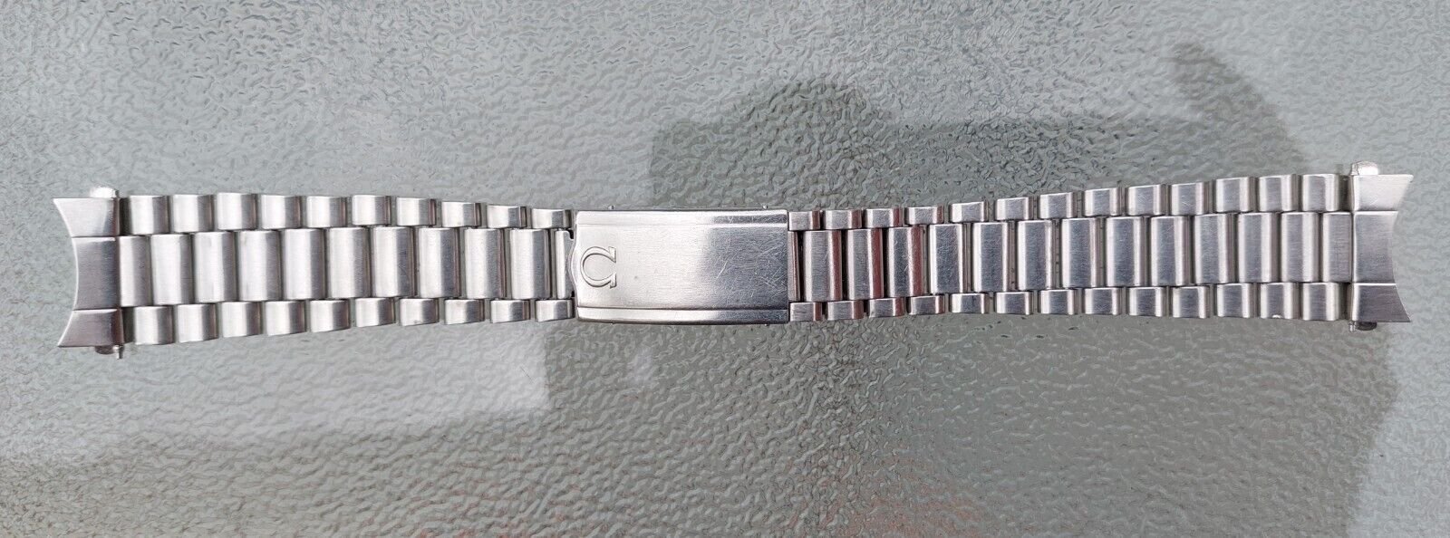

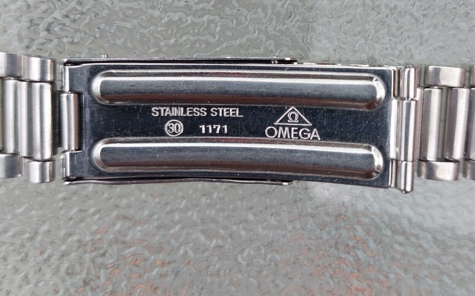

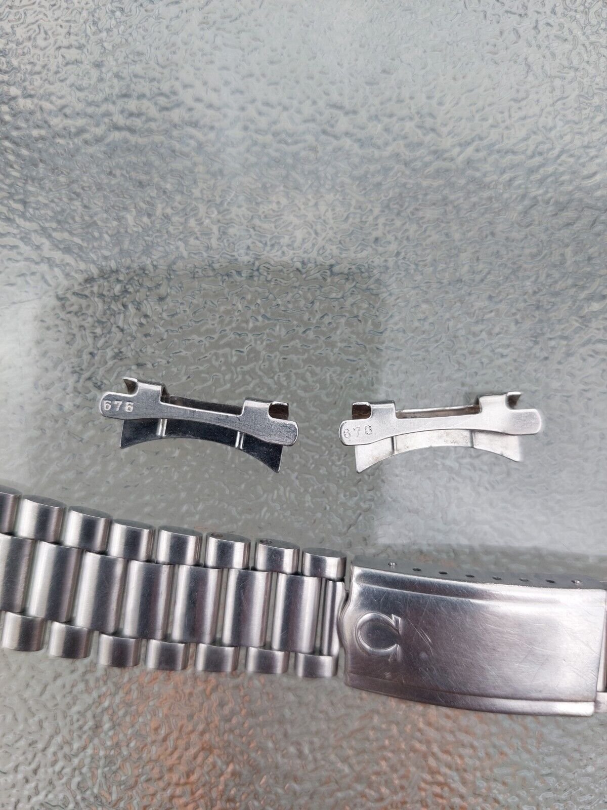

This vintage Omega 1171 with 676 end links would be correct for what year of Moonwatch?

What would be the correct moonwatch year for this bracelet with 676 endlinks? Thanks.

From experience; the 676 end links do fit a standard Moonwatch case. Not as well as an 633, but they do provide a pretty snug fit still.

Thanks, ok so it looks like it is not an original speedmaster bracelet.

How much should I expect to pay for a bracelet like this?

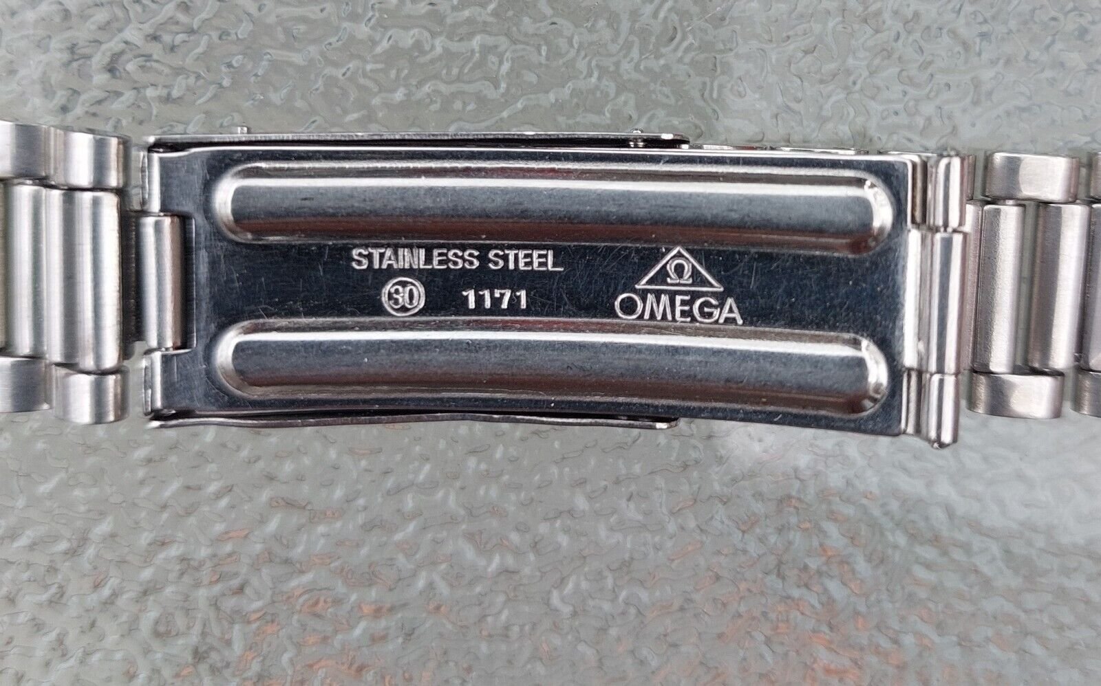

The -171 is a Speedmaster bracelet but 686 endlink aren’t for the Speedmaster. They can just about be made to fit but not that well in my experience. 633 are the factory Speedmaster Endlinks but 677 although not factory correct also fit very well on some cases
