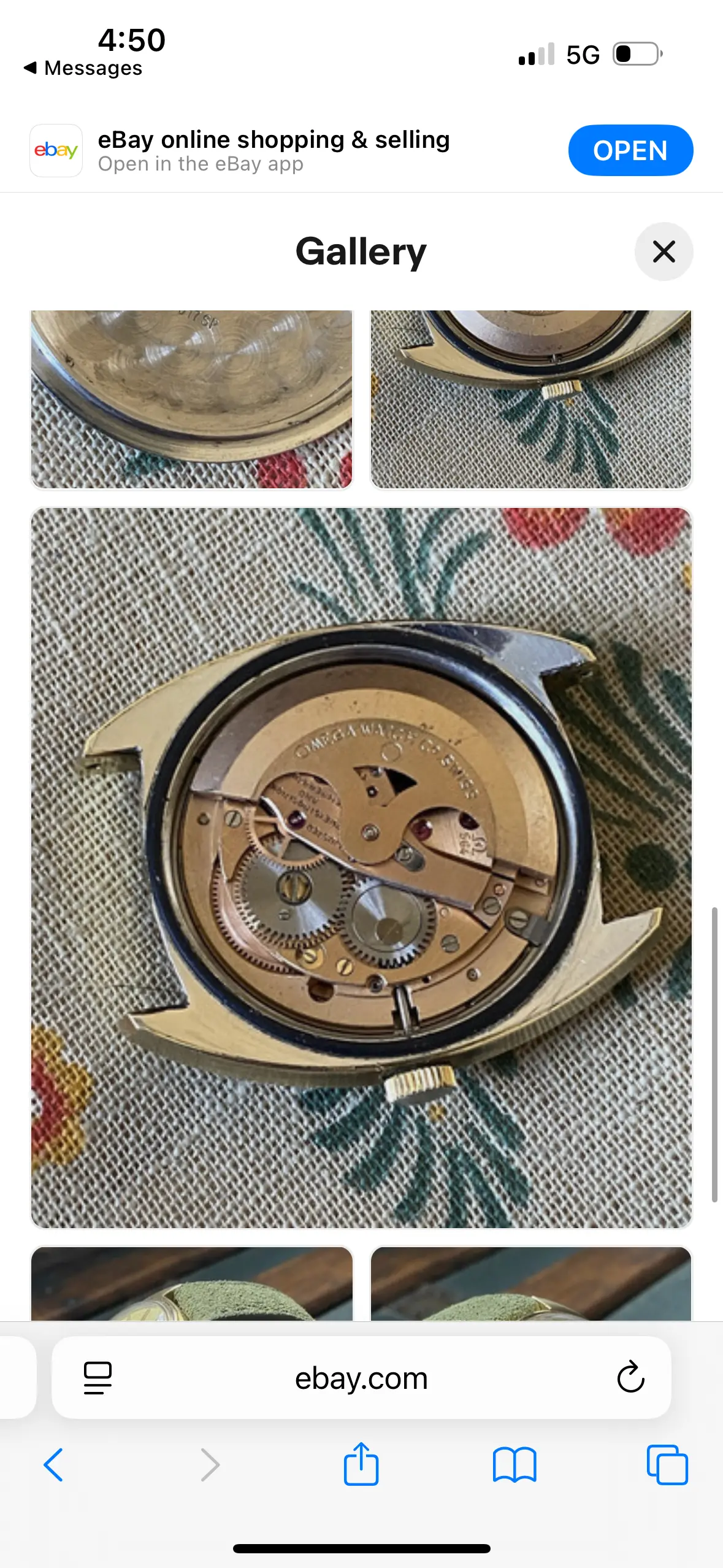

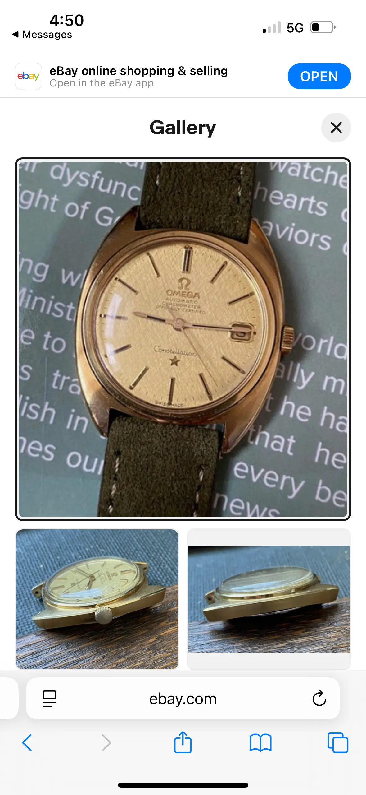

This seller is willing to go down to $775 for me. This would be my first Omega and I know that I'll need to get it serviced. I also noticed that the crown would need to be replaced to an original Omega.
70's Vintage Omega
What are your expertise thoughts on this purchase?

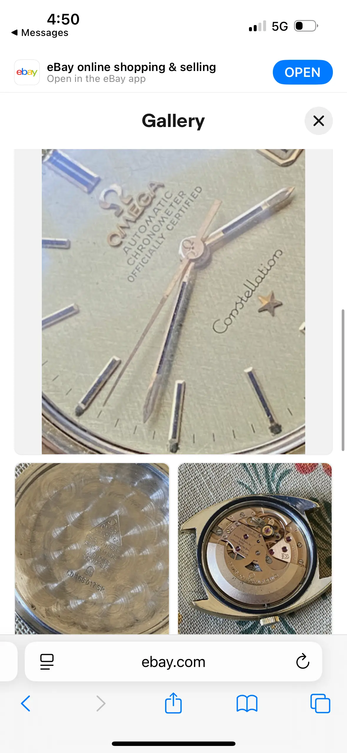

The price isn't crazy, I just wish the photos were better to judge condition. The dial appears to have some spots, darkened lume, and maybe some minor damage around the lume. This might be negligible on the wrist, but it's hard to say. And we really can't say much about the condition of the movement.

I wouldnt buy it without well focused photos of case and dial and movement.

That ding on the bezel at 10 would bother me. I did it. Not so much, but buying. Yeah

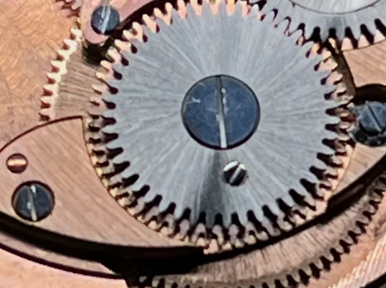

To OP: The ratchet wheel screw (part #2718) doesn't look original. Makes me wonder who serviced that watch and potential damage from the service elsewhere in the movement. I would absolutely require sharp photos before buying.
This is what this screw (the large one) is supposed to look like - it's flat.

Before purchasing - I would want to see the case back, for sure. There are no pictures in the listing but the seller says “ …major scratches on the caseback”
