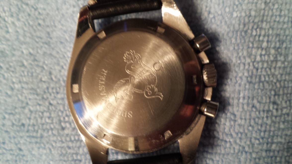

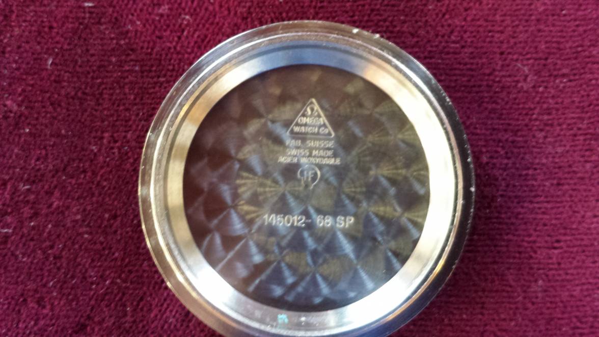

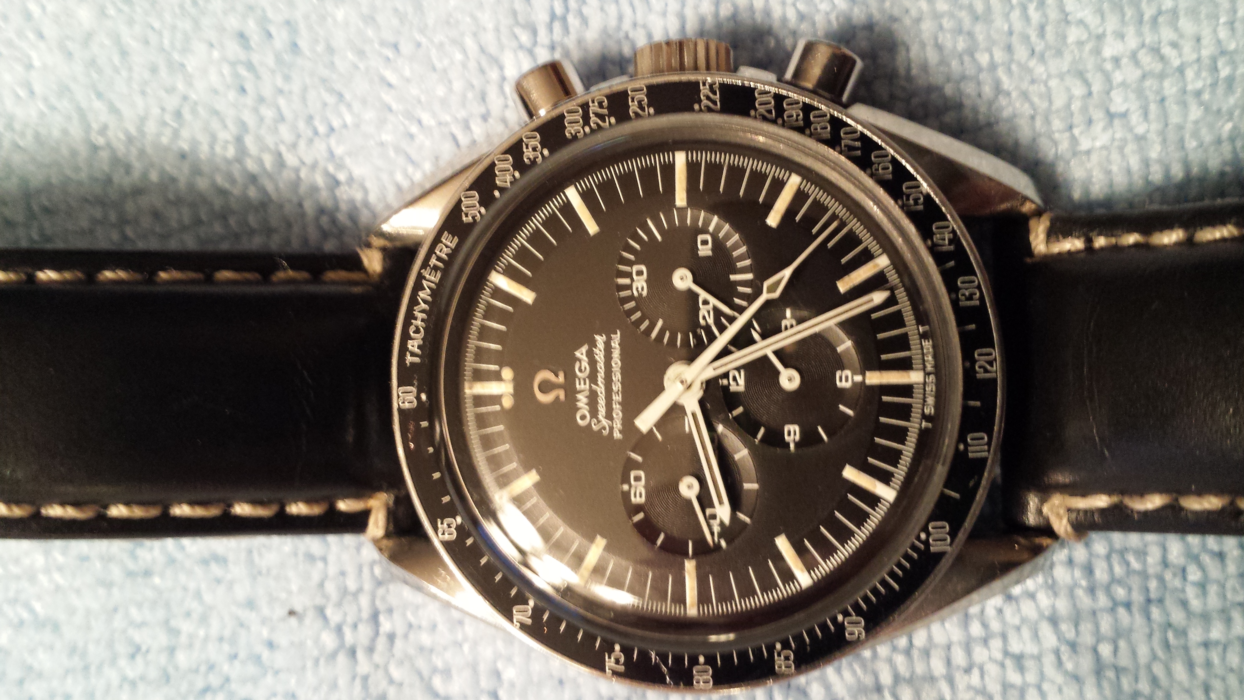

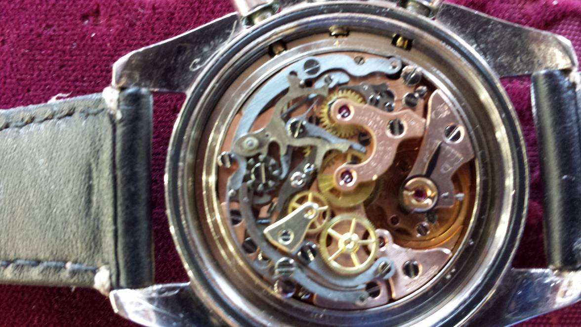

    20140317_202726 (3).jpg 20140304_150851.jpg 20140317_202848.jpg 20140304_151054.jpg I have an original 145-012-68 SP. My serial # 26553050 is only 464 earlier than the one being talked about. I purchased it a few years back and if the seller gets even close to what they are asking, then I made out like a Bandit!;)
    Spacefruit likes this.
  20. Joe K. Curious about this text thingy below his avatar Mar 27, 2014
    1,648
    2,100
    This watch is probably the best comparison we have to the watch in the eBAY auction. Being only 464 earlier than the watch in question it strongly suggests that the dial and bezel on the eBAY watch had been replaced at some point and not original to the watch. As always, there is no way to be 100% sure, but this would be strong enough evidence for me.
