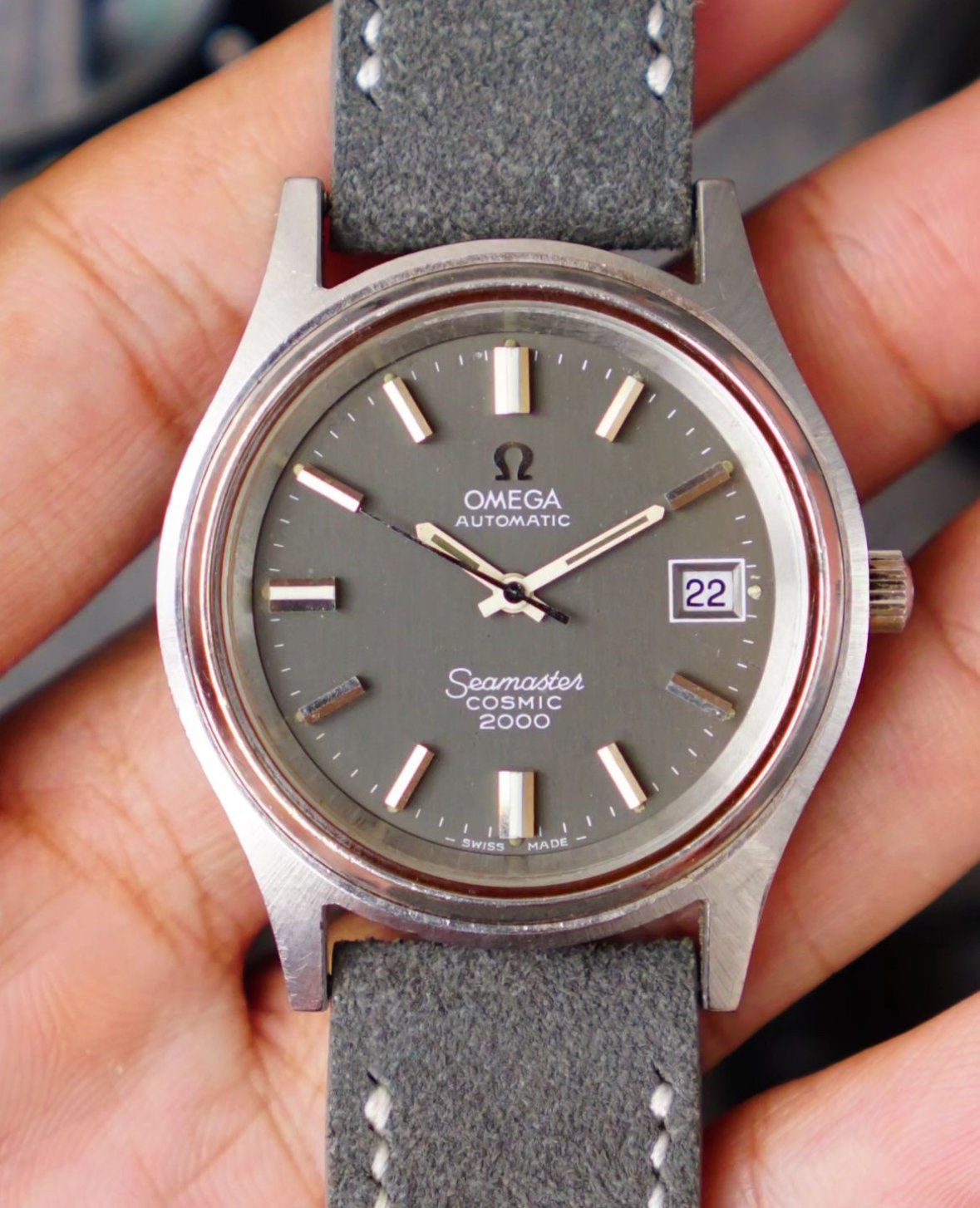

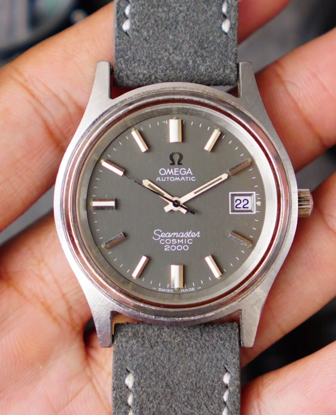

Hi forum, first time posting.
thinking about buying a Seamaster cosmic 2000 Ref 166.128
as far as im aware the Calibre 1012 have some parts made out of plastic, not sure the function of the parts, but worried about wear and tear.
is this a small issue or is it a deal breaker?
What do you guys think? am i just overthinking about it?

Thanks for the reply.
you’re right,been reading about some people being not a fan of 1012 movements.
the thing that attract me the most about this watch is the grey color dial and simplicity of the dial.
not sure if there's another vintage grey dial omega, any recommendations?

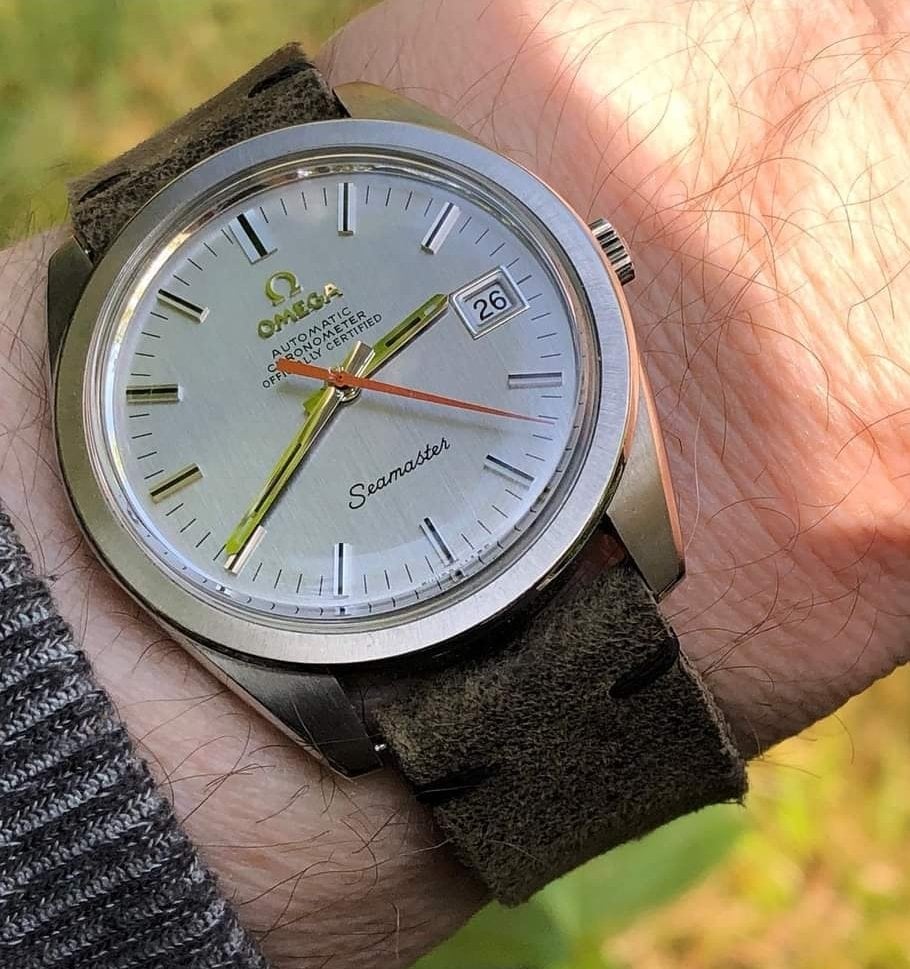

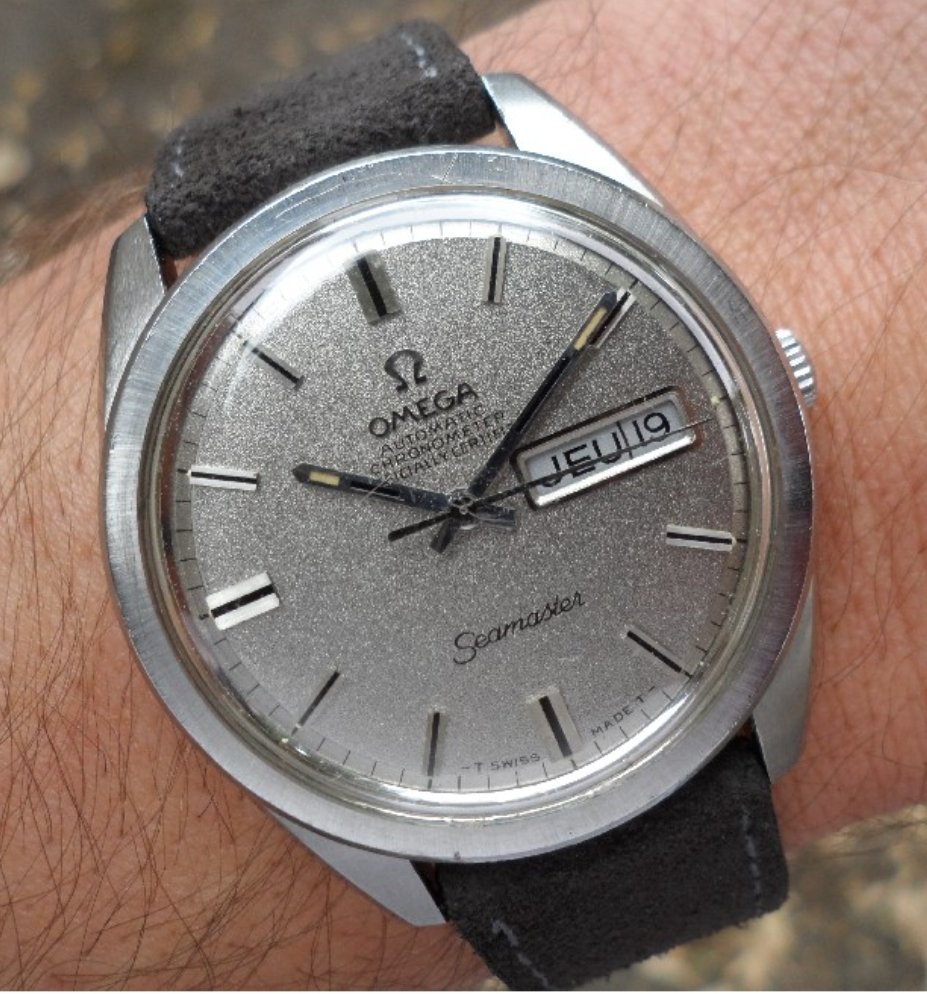

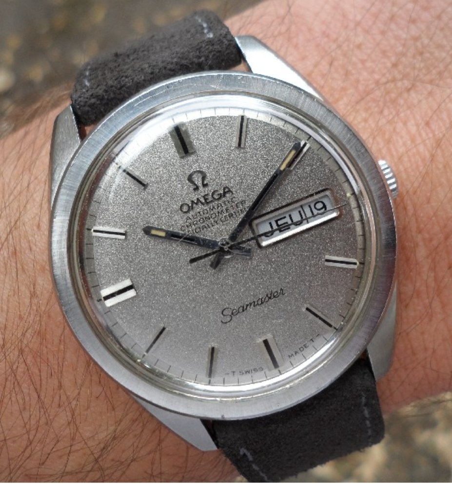

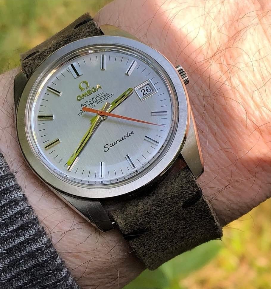

I'm biased because I really like these references, but 168.022 and 168.023 have silver dials in sunburst or sparkle, the latter appear slightly darker depending how the light hits. The date only 168.022 with a chronometer-grade 564 is my personal favorite of the series.
