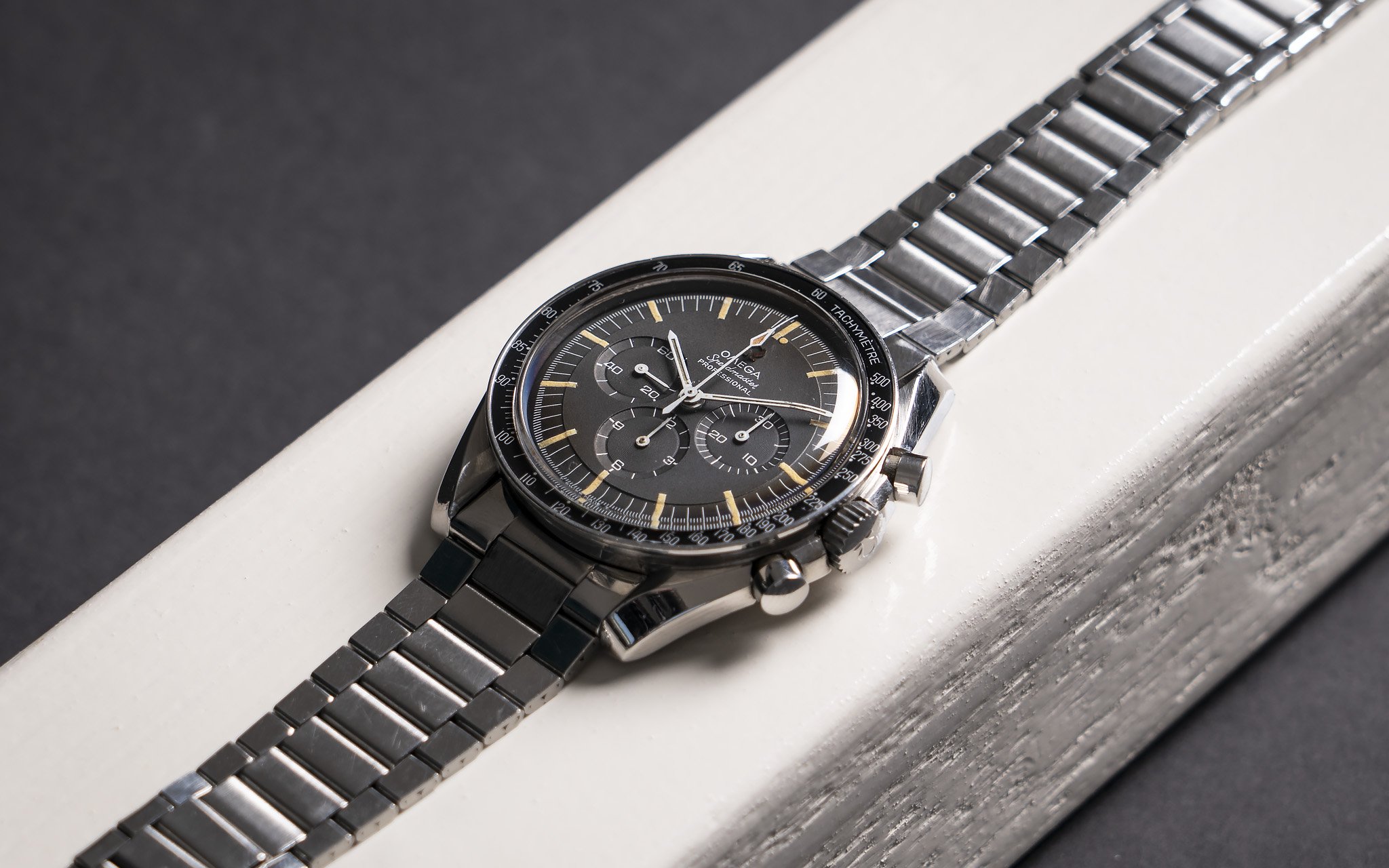

Thinking about buying an OEM flatlink for my 3861 speedy
319
339
So I love my 3861 and the bracelet, but every time I see pics of a 105012 in its original flatlink, I can't help wishing Omega made a 3861 flatlink.
I have the forstner version, and while it's very nice, I really wish it was OEM. I know that sounds shallow, but I just really like the look of those early 1960s Speedmaster Pros.
So I'm thinking about getting an OEM flatlink, and was just wondering if anyone had any advice about which one to get, and more importantly, which end links will fit.
Cheers

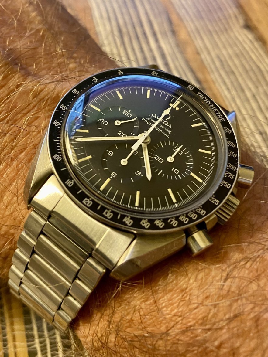

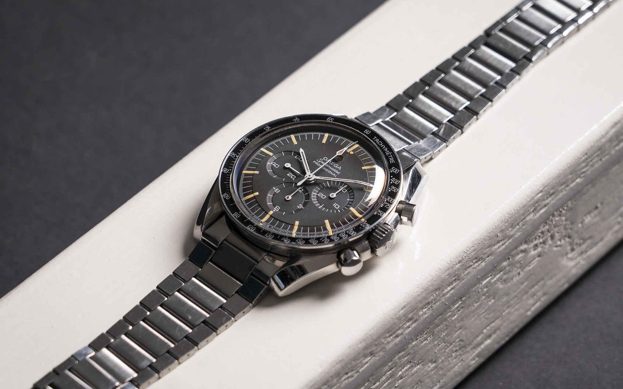

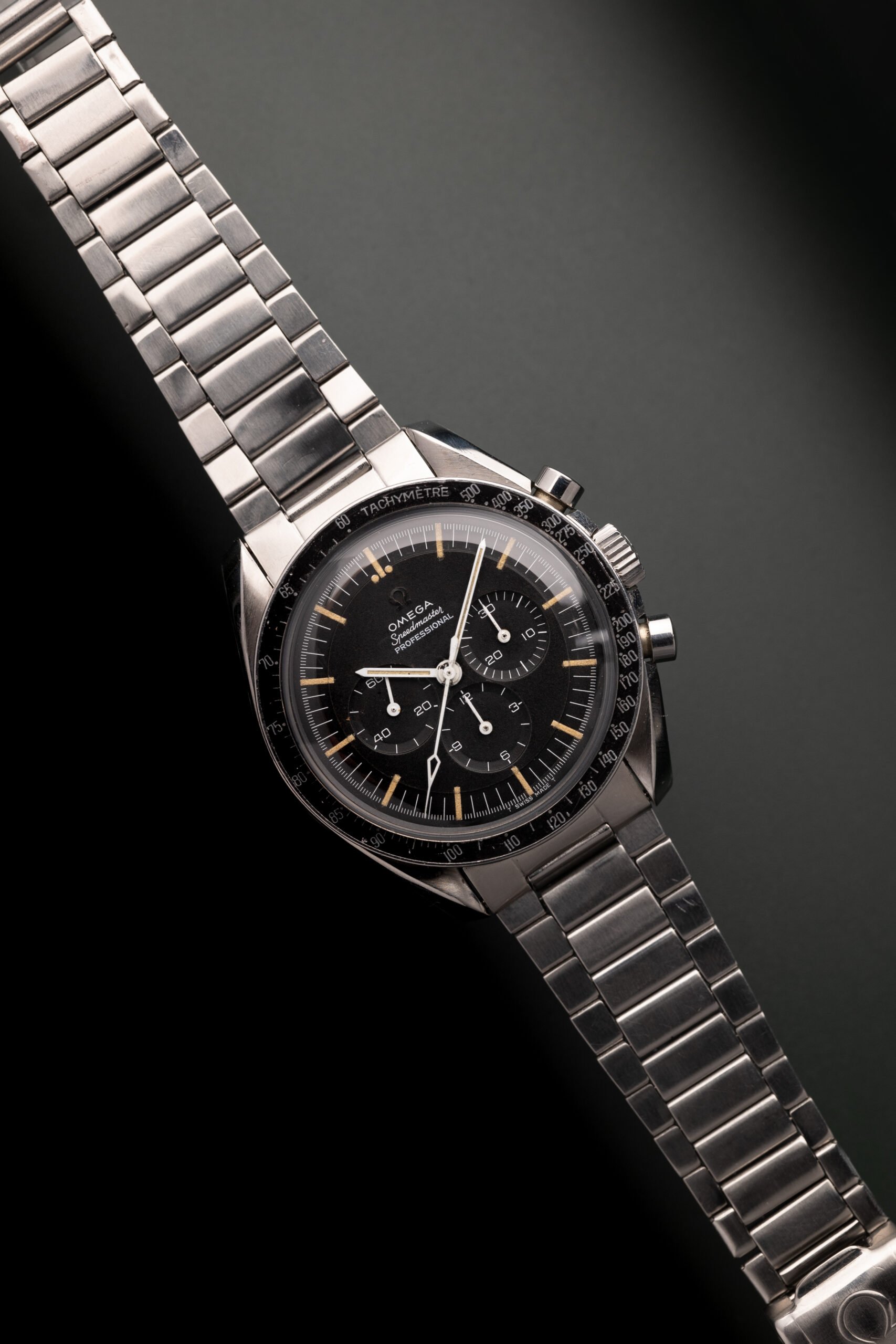

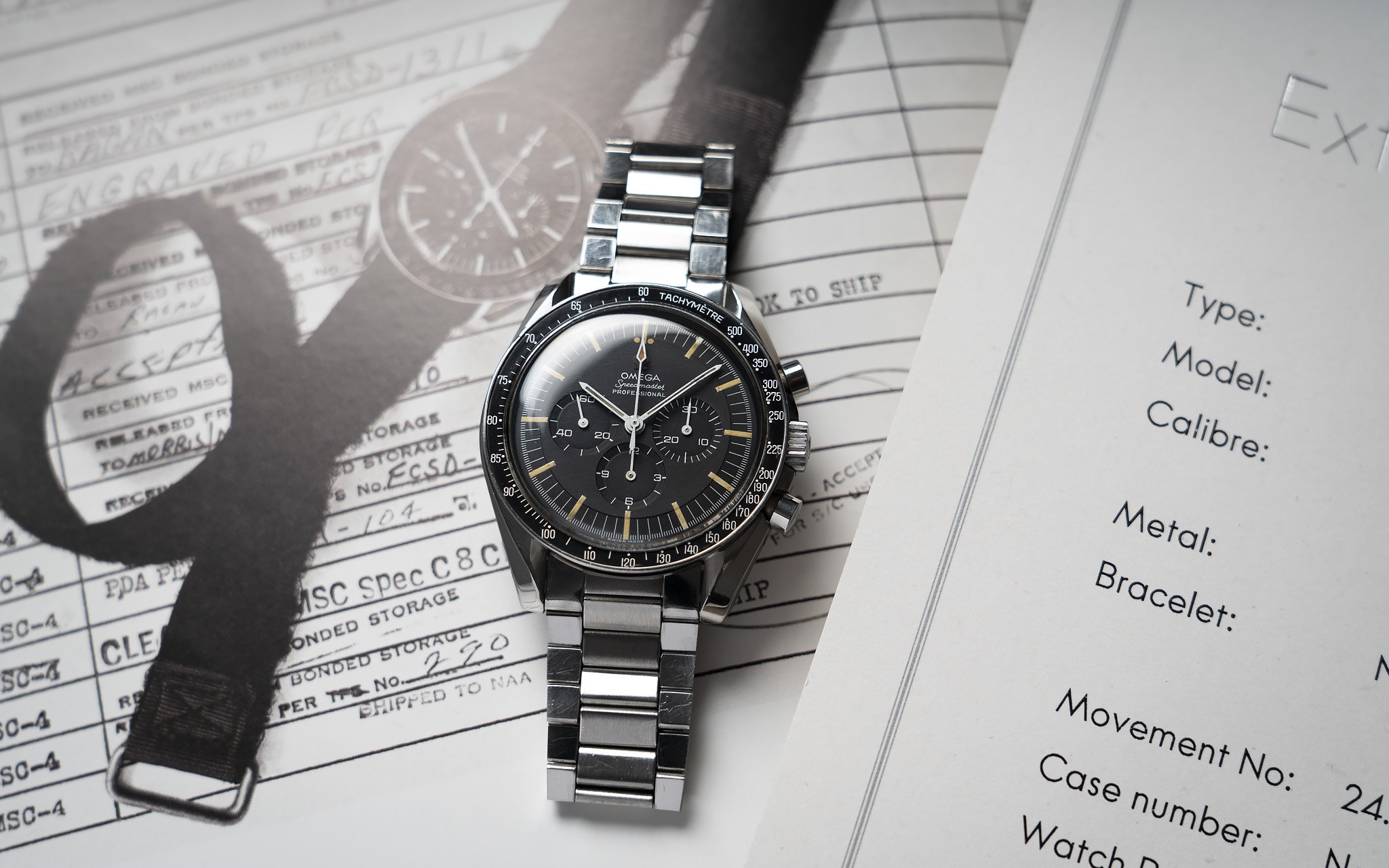

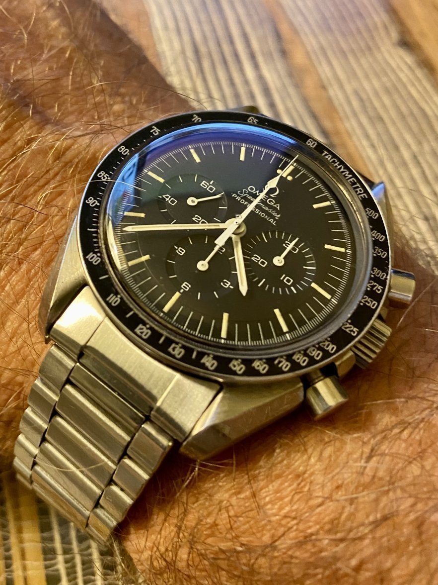

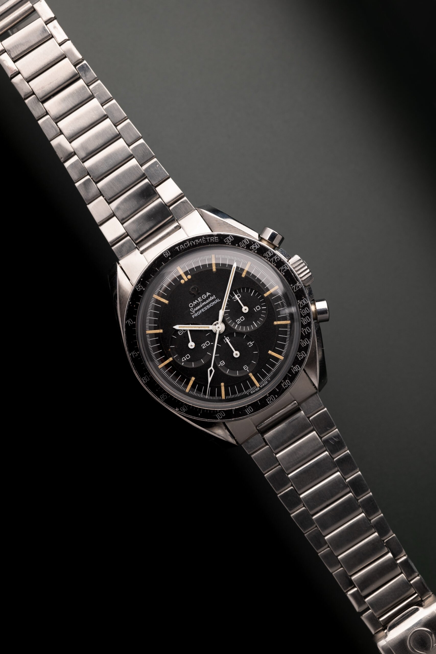

Edit: here's a few pics so people can see what I'm talking about.
Just to clarify, these are pics of original 105012 Speedmasters I found on the Internet, with their original bracelets. I just posted them to show people the look I'm going for.

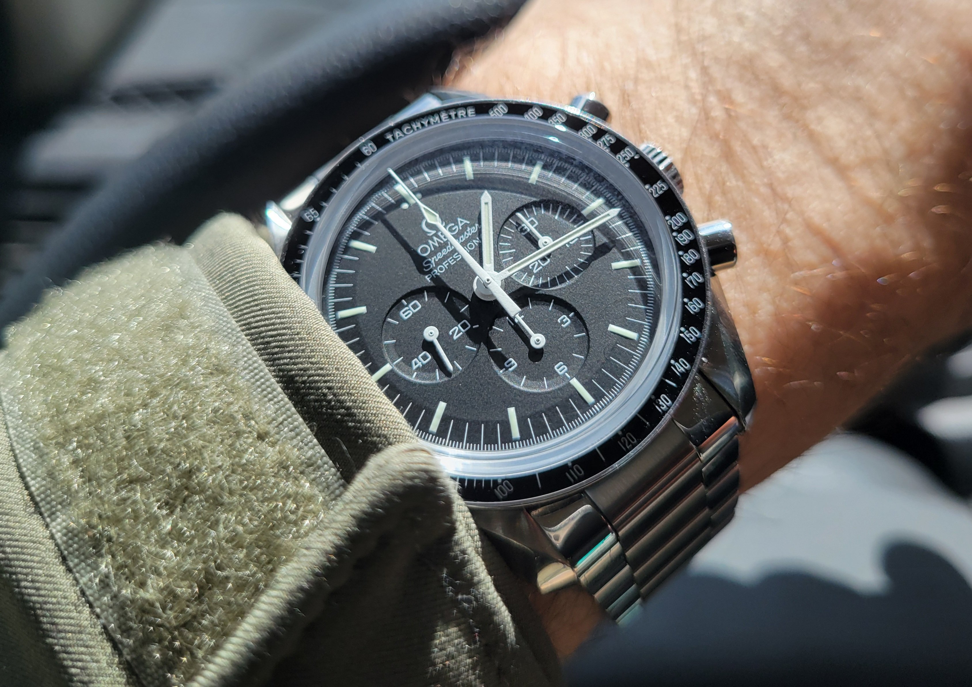

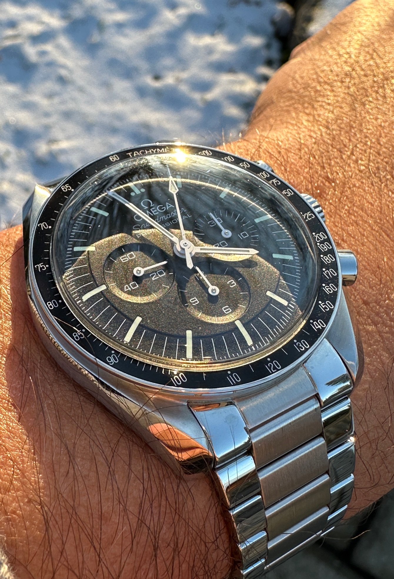

Apollo 11 50th flat link fits. The end links need to be modified to fit the 1861/3 cases or you can use uncle Seiko (hollow) or forstner end links.
Looks and wears great. (Image taken while not driving)

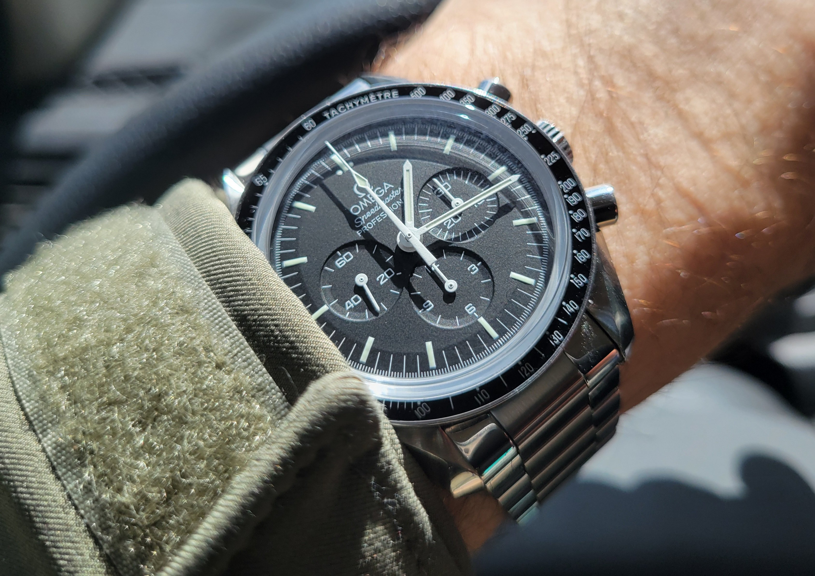

Before you go down the OEM route, I’d suggest trying a Forstner or UncleStraps version. As the previous post noted, you’d likely need the end pieces from one of them anyway.

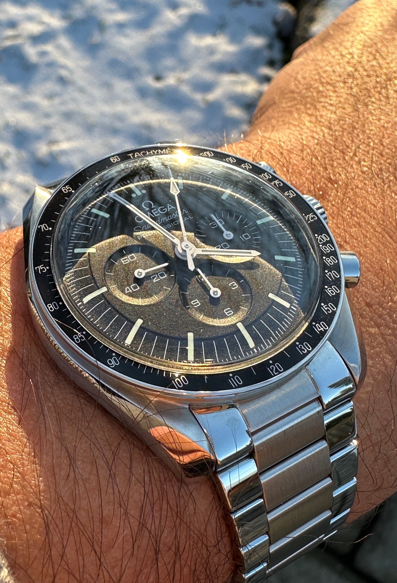

I wear the Forstner contemporary flat-link on my FOiS Speedy all the time - it’s a good bracelet.

I already have a forstner contemporary flatlink, but it's just not the same as having an oem.

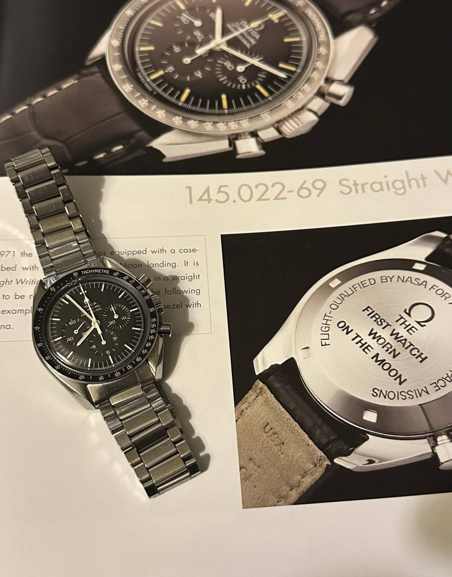

I have the Apollo 11 50th bracelet on my 3861 hesalite. After doing some research, I decided to use the Forstner end links to fit it with. The idea of fiddling with the OEM A11 links was not appealing, and the Forstners seem to fit the 3861 case better than the Uncle Seiko links.

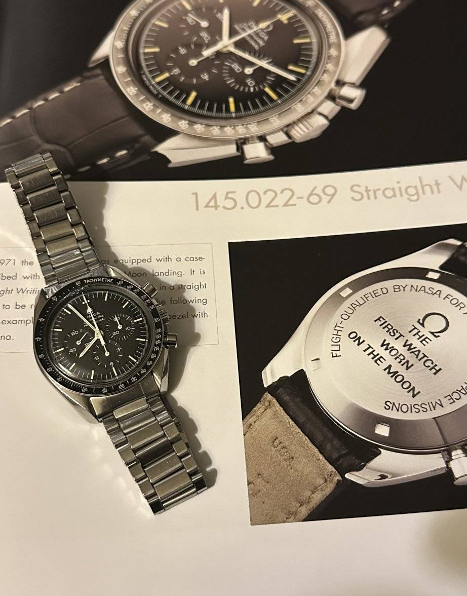

Although not period correct for a 105.012, the most affordable option for an OEM flat link is the 1175 with 640 end links. With some work and a bit of luck you can sometimes find the bracelet for $500 and Swatch/Omega still makes the 640 end links. The 1175 doesn’t have the spring links like the 1039 (which I think is a good thing) and the construction is more robust. It has a decidedly vintage look. Not sure whether it will fit a 3861 case, but worth looking into. Here’s my 1969 Straight Writing with the 1175/640:

Regarding the Apollo 11 end links: I see no downside to trying to modify them if you have the tools on hand. Who's going to need them unaltered? 😉

I have a 3861. My understanding is they will fit unaltered but I might need slightly thinner spring bars.
I've also heard using thinner spring bars is quite a bad idea. So I don't really know who to trust.
I want to keep it 100 percent OEM though.

I've had bad experiences with Swiss-made thinner spring bars bending/failing, I'd try to stay away from them.

A smaller spring bar is going to also cause the endlink to pivot, so it won't be resting against the case evenly because of how the bottom of the endlink is constructed.

The correct bracelet for a 105.012 is a 1506 with 16 Endlinks. Perhaps very late ones came with a 1039 + 516.
You’re looking at £1k minimum for a decent one with end links.
