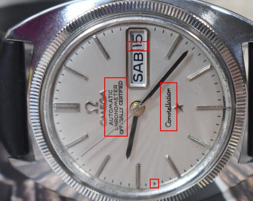

Think these are re dials, seller hiding the truth?
138
103
Definitely a redial. I think so because the 43rd minute marker is off and the wording at the top of the dial is just off in terms of spacing. I'm still new to spotting redials. To others in this thread: is my reasoning for why it's a redial correct?
138
103
And note the "100%" positive feedback. Very comforting.

Not only a redial, but also a badly done one I must say
13
21
Everybody is saying redial. I think that's very much the case as well. Because there's little feedback why, I'd like to give it a go where I see the flaws. I'm a complete noob at watches (just started the whole thing very recently) and I'd like to improve my skills. So please correct me if I see things wrong or if I missed things:
- What's with the "1" in the 15? That looks weird, no?
- looking to the minute markers, some of them are obviously thicker where there's no reason for it. (already mentioned)
- Kind of mentioned, but how to spot a reprint / repaint? Is it because the printing is too thick? Ffor sure on "Constellation", I'd say.
- Hands reems to be off, like already mentioned.
