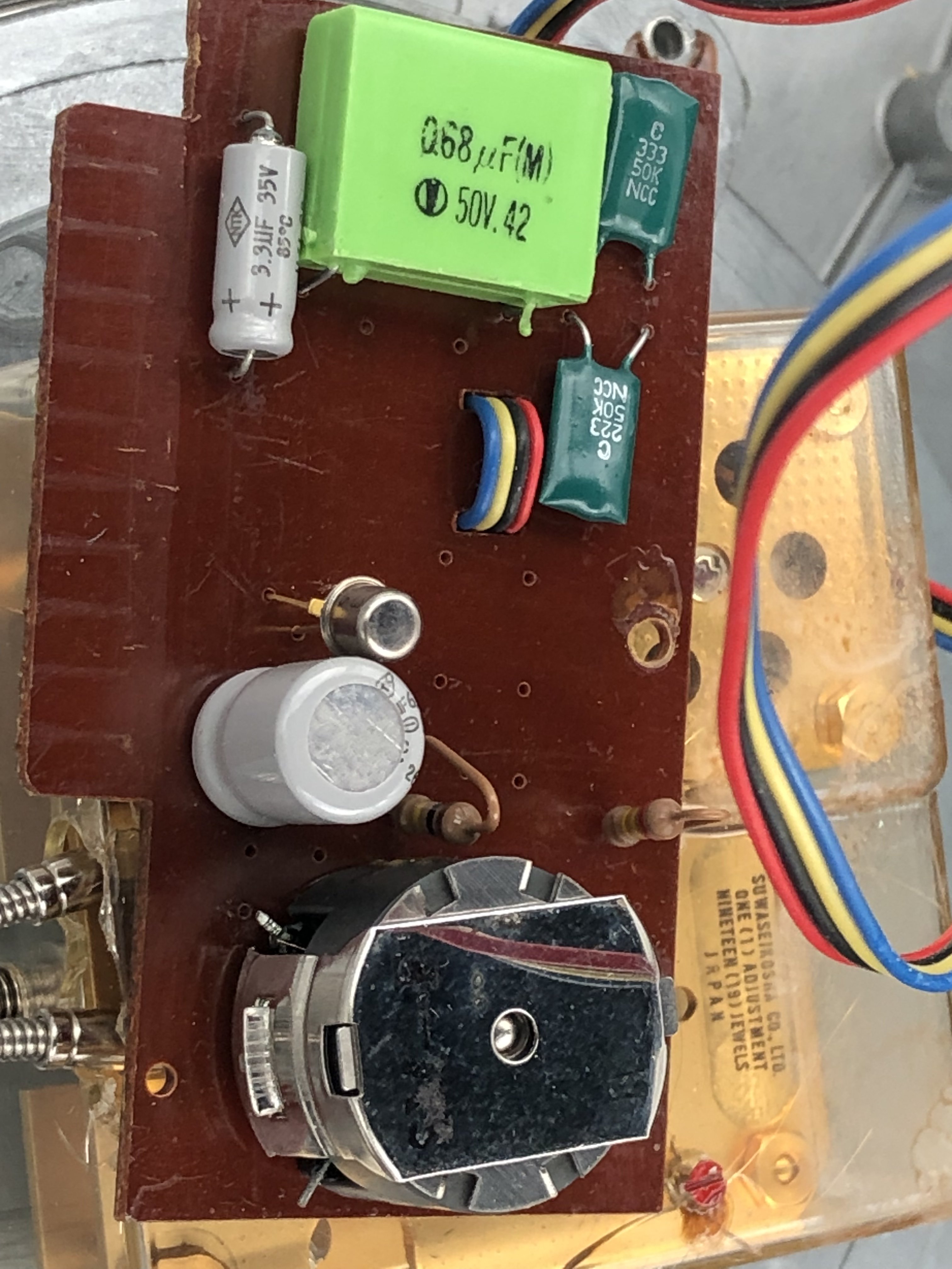

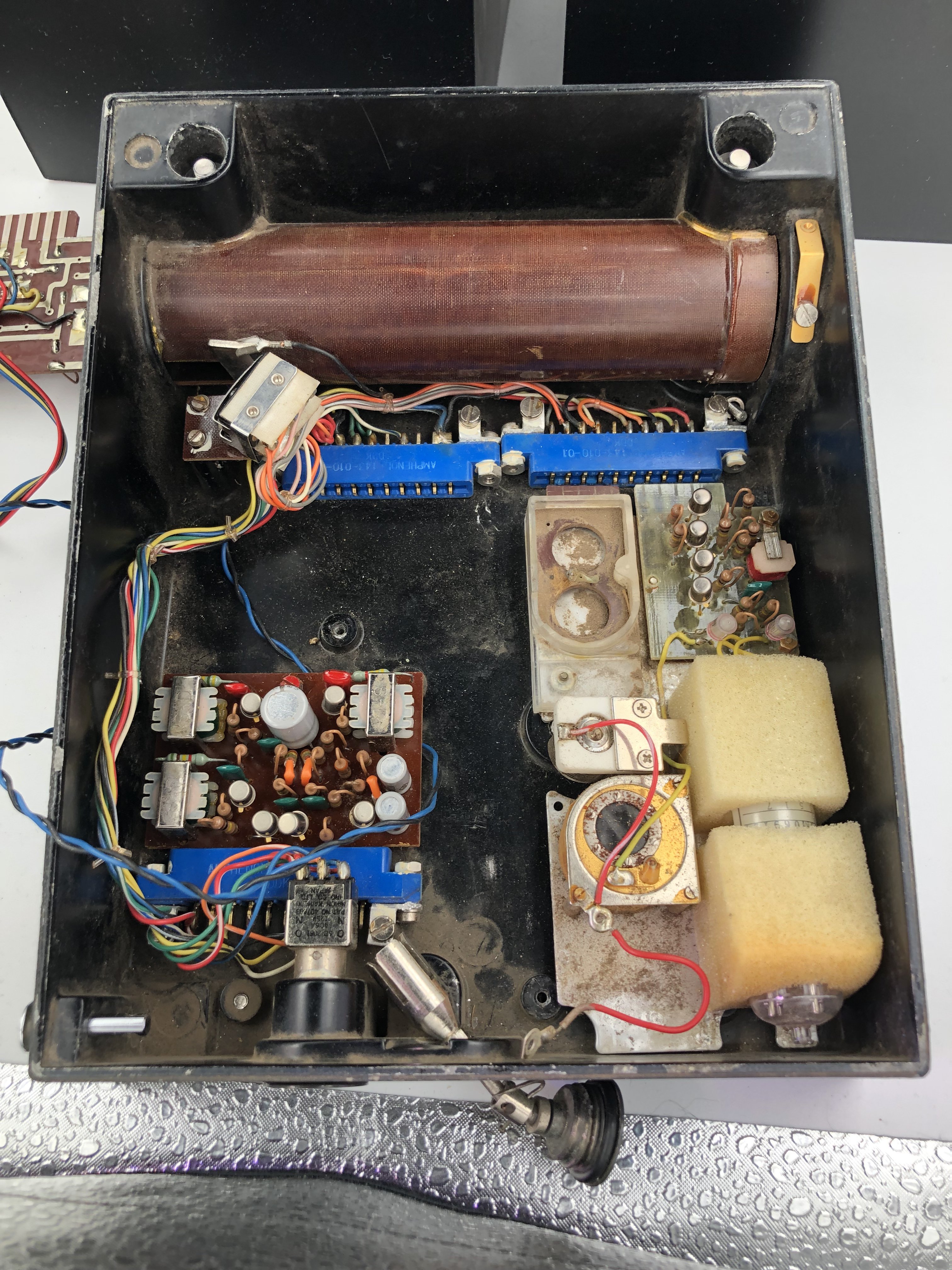

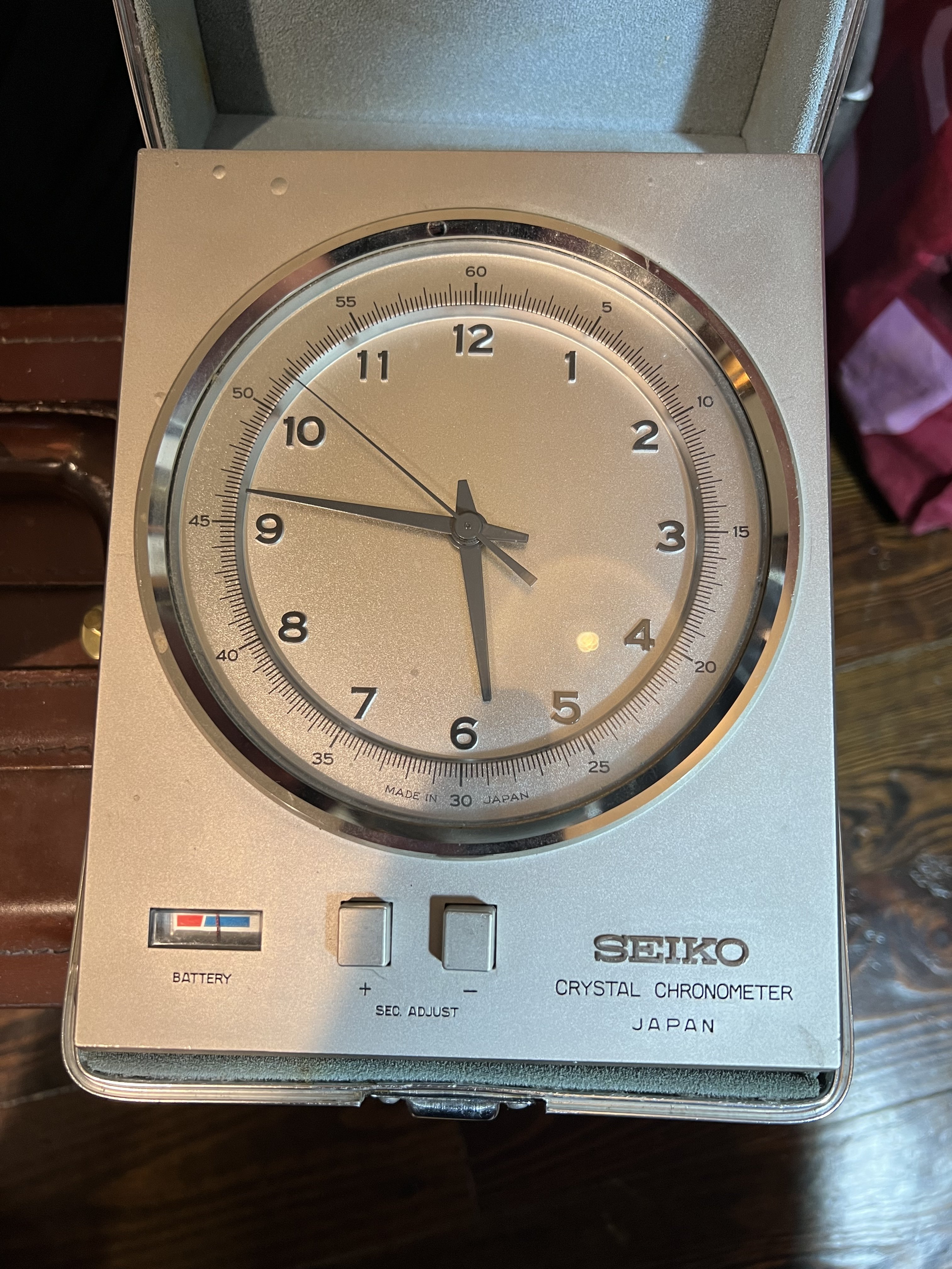

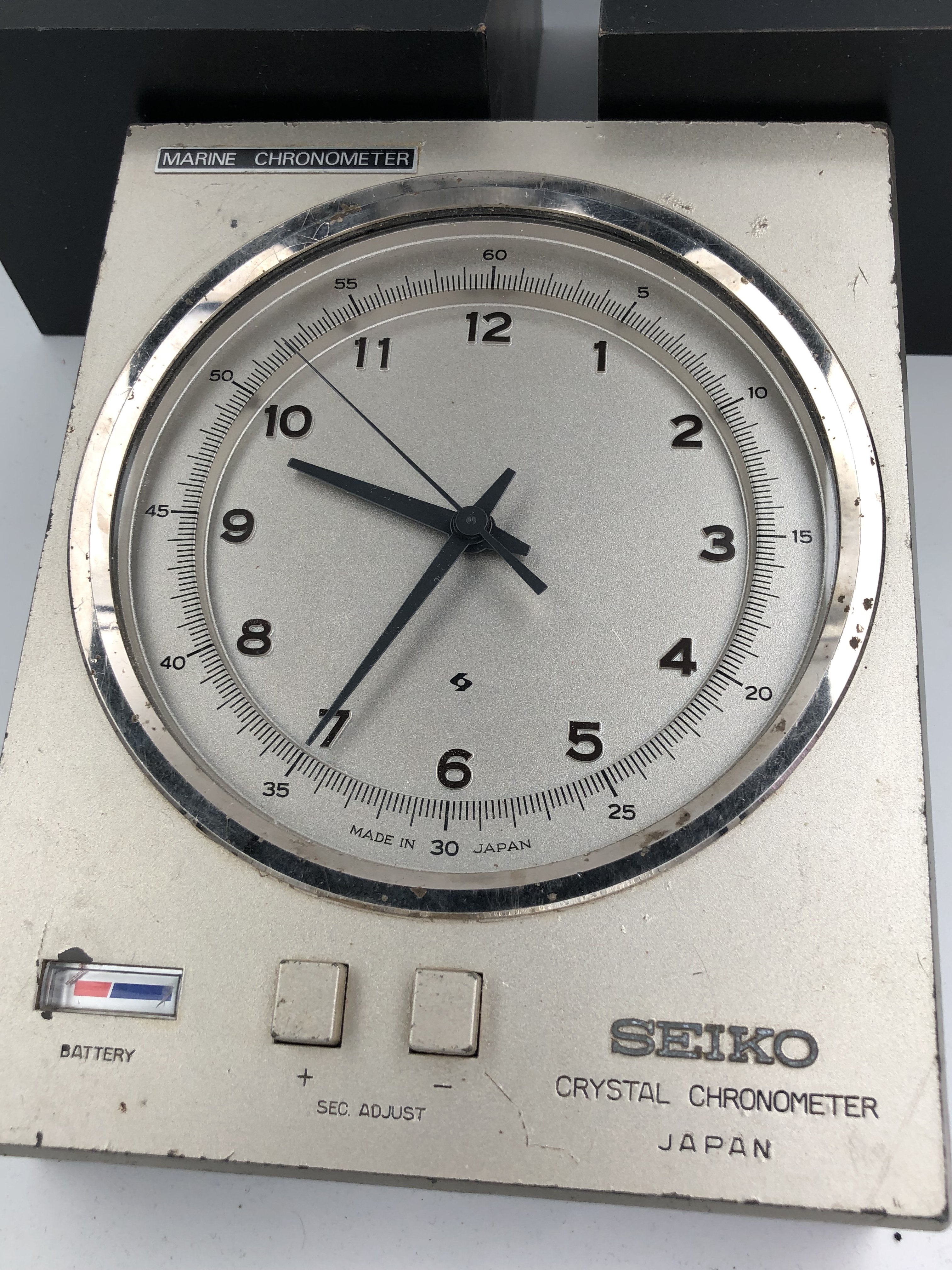

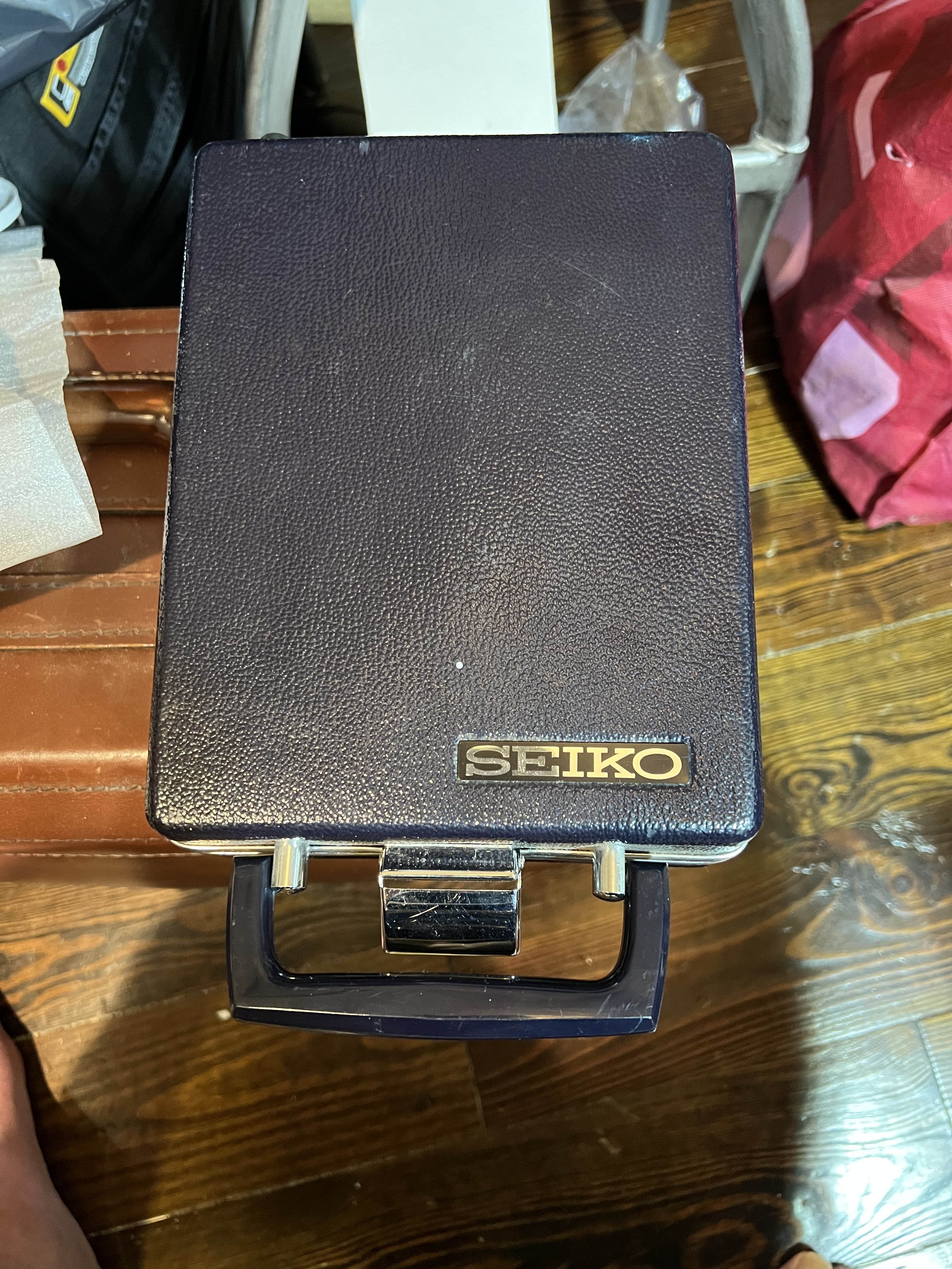

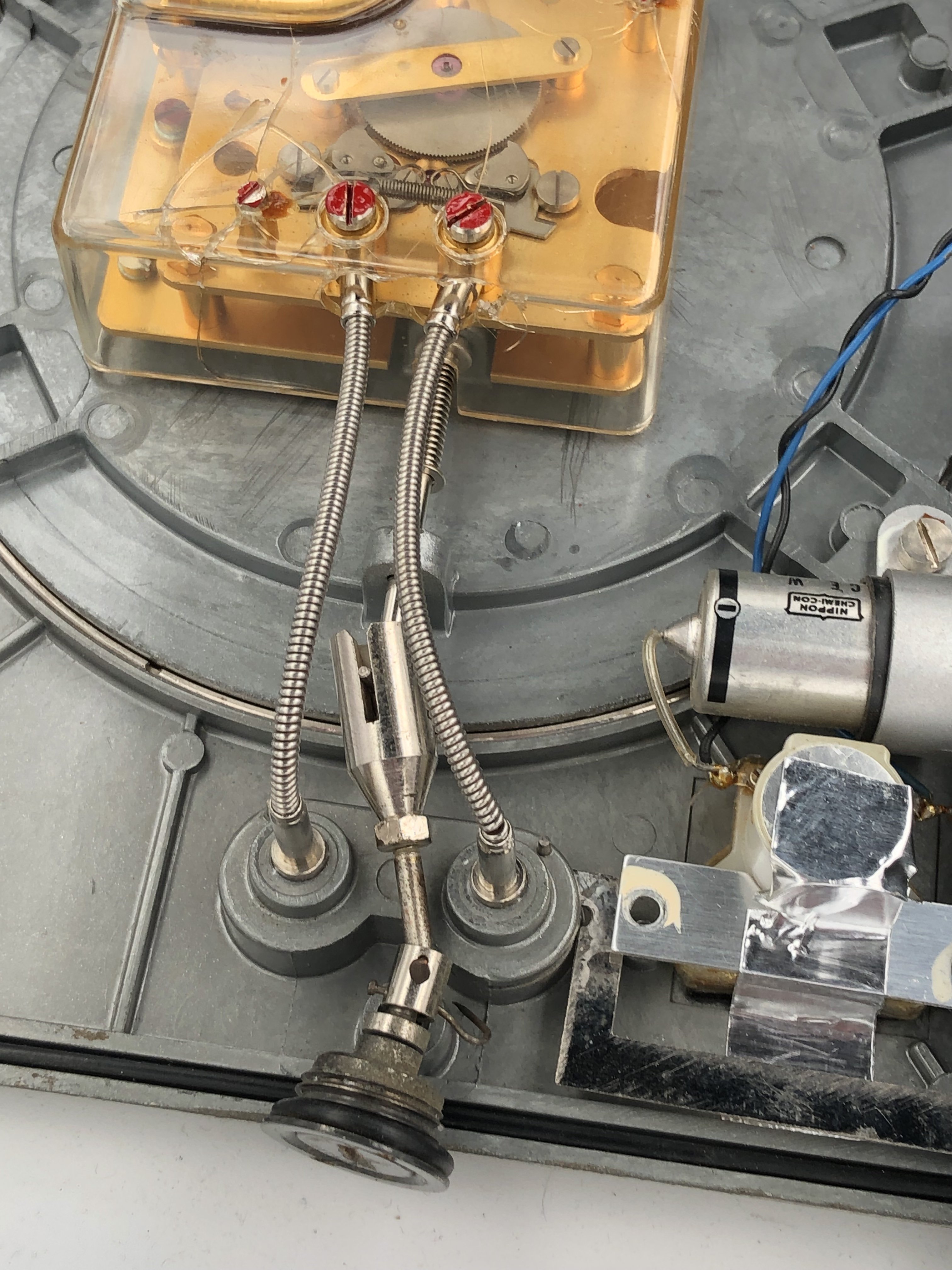

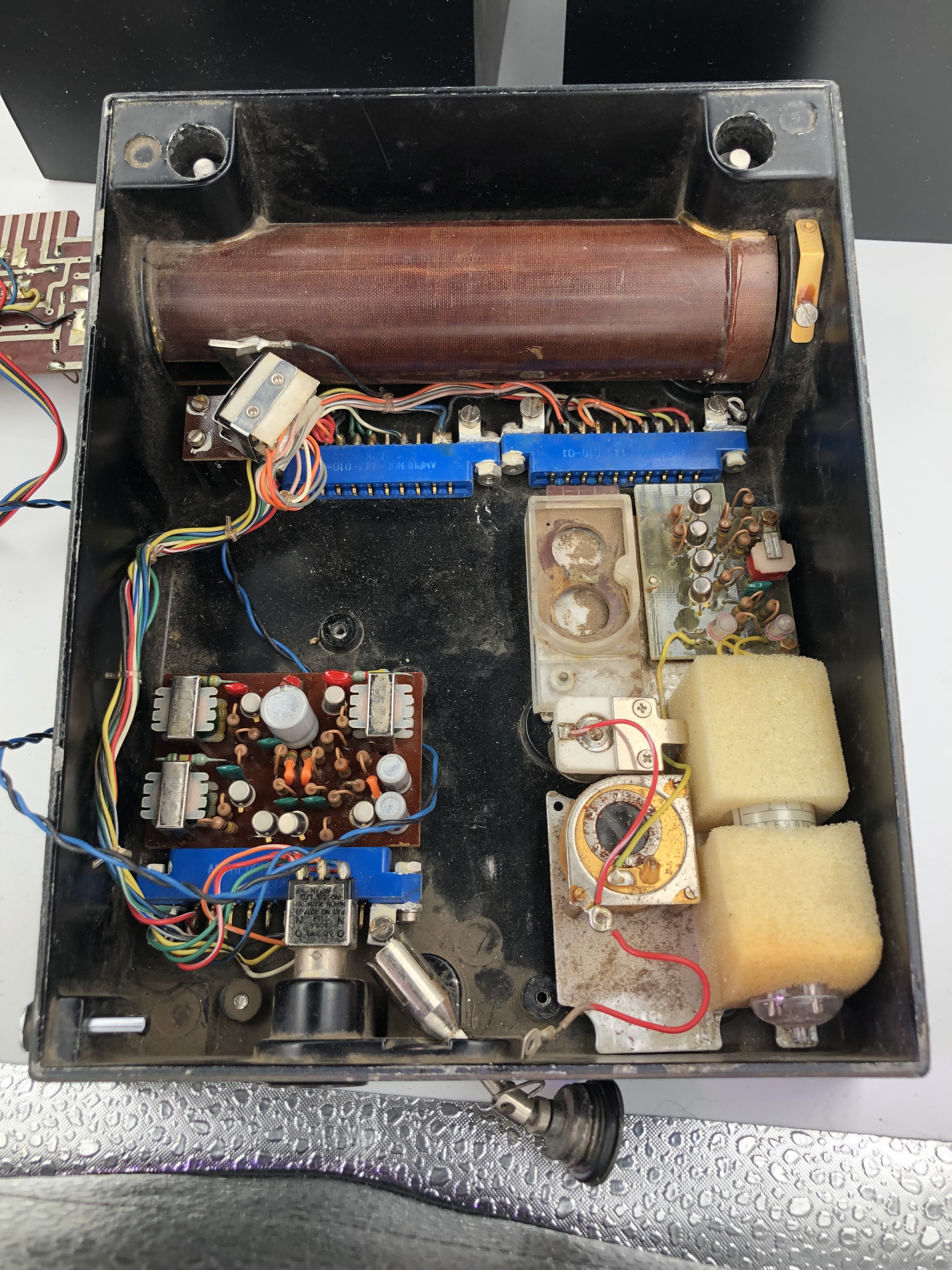

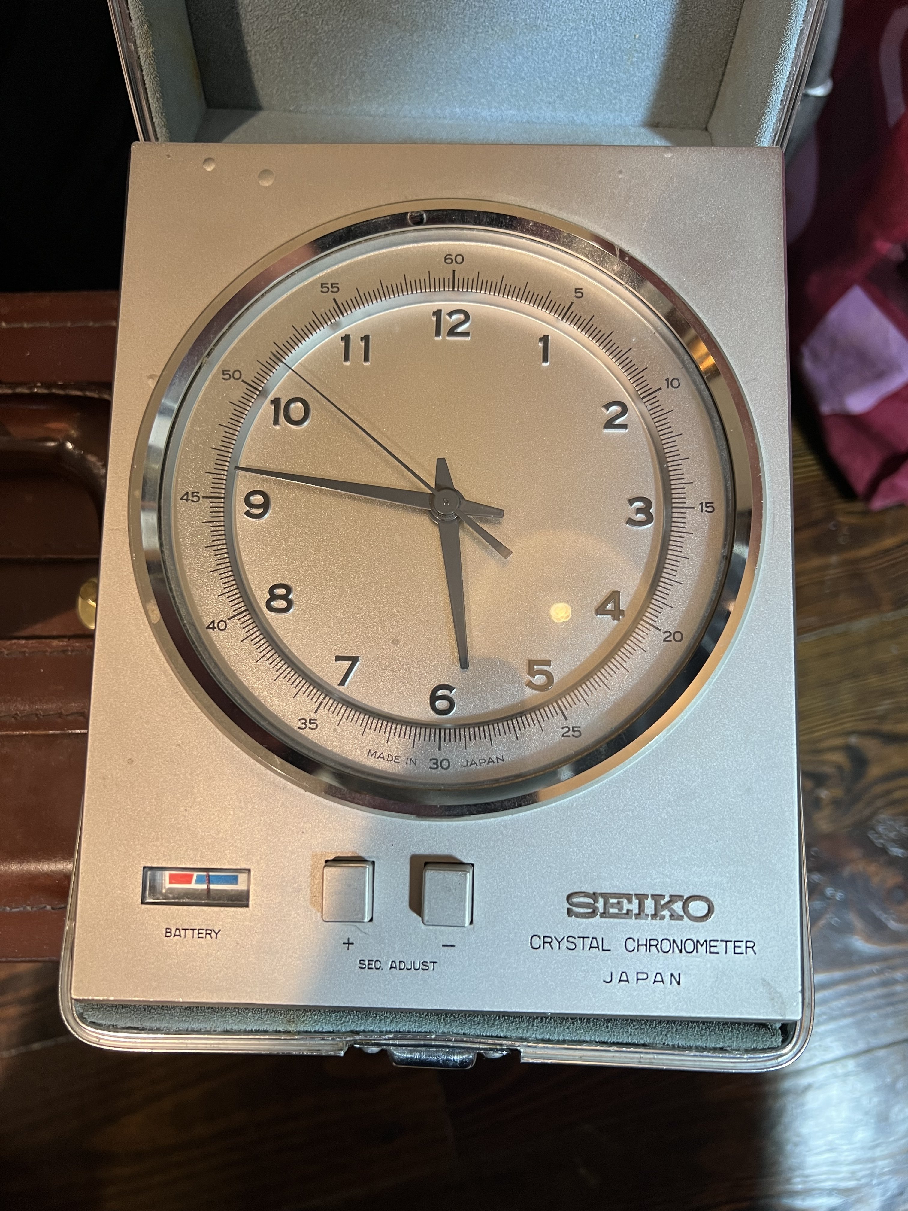

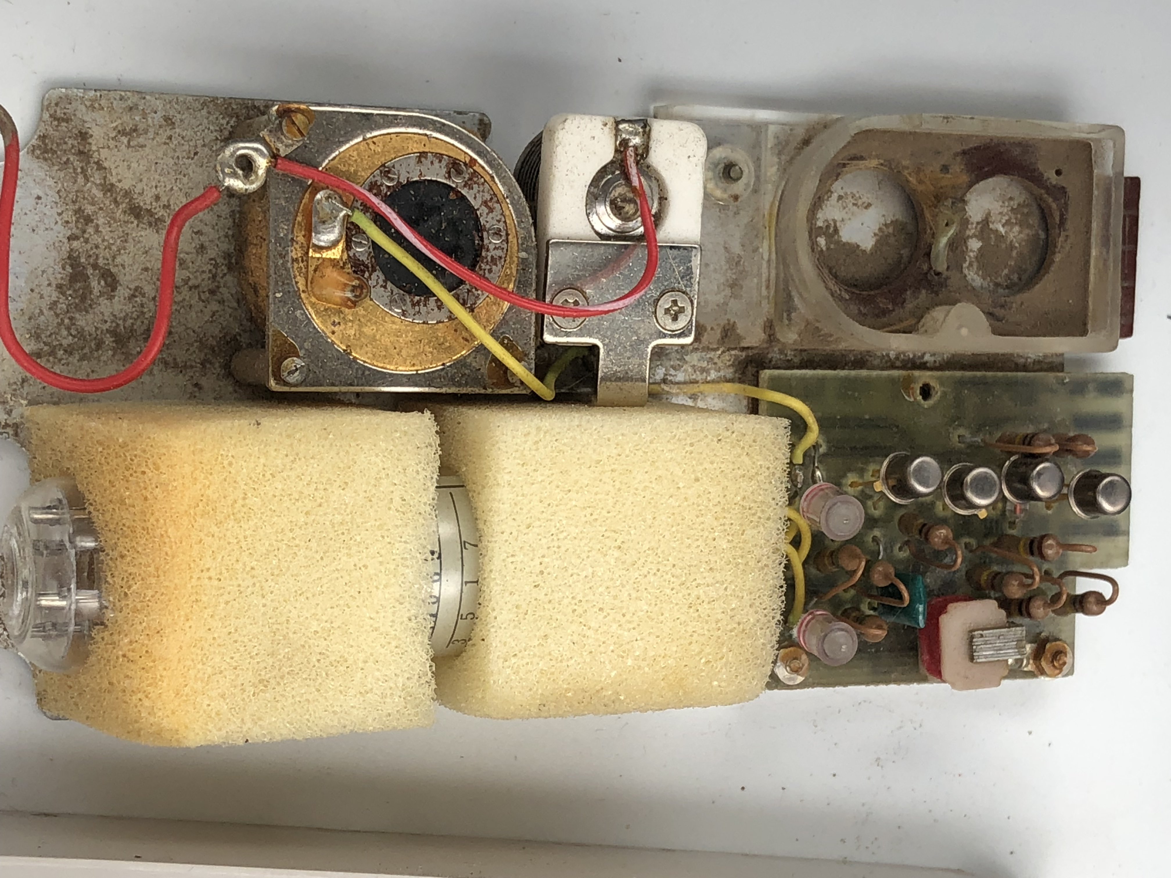

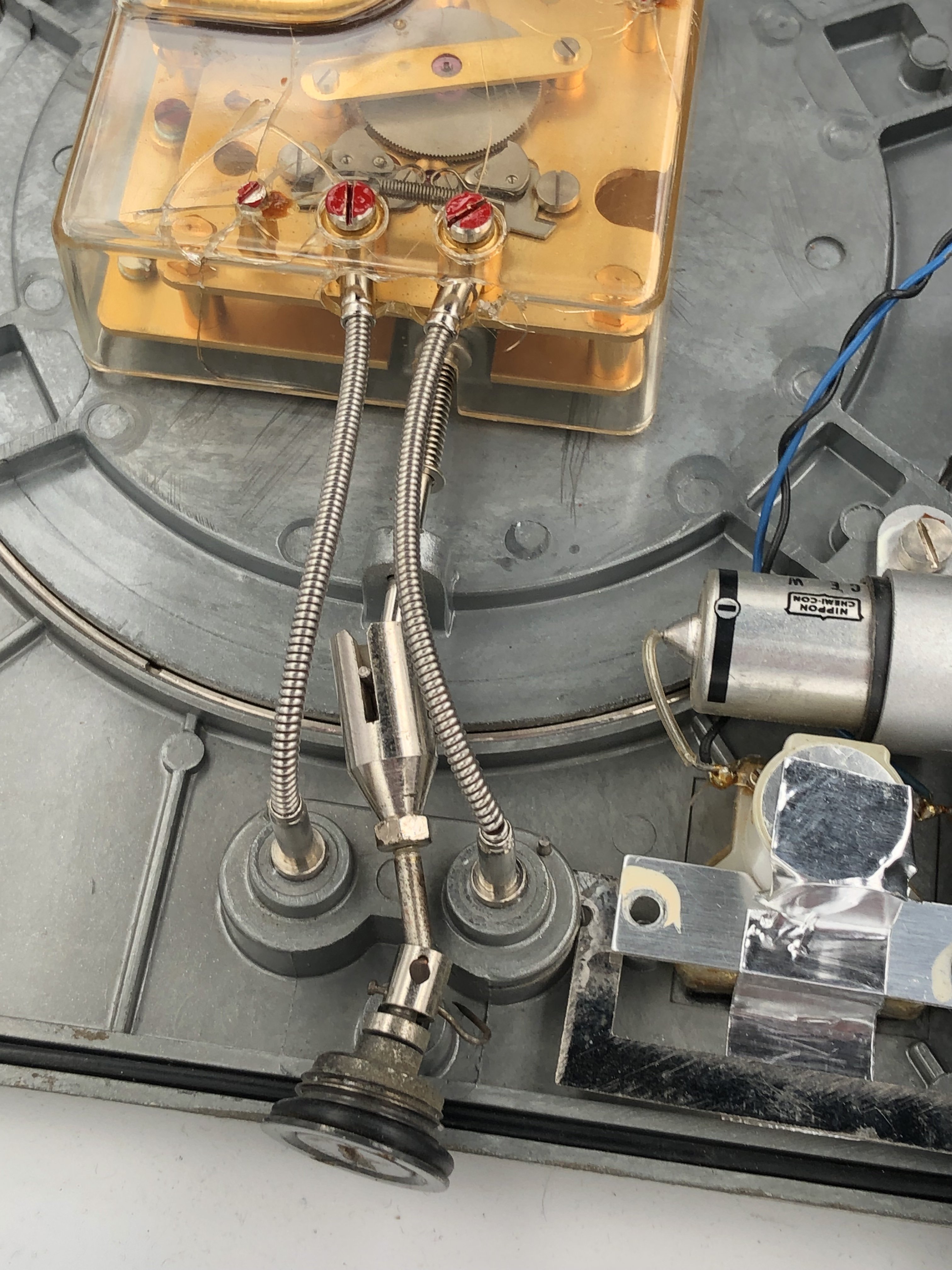

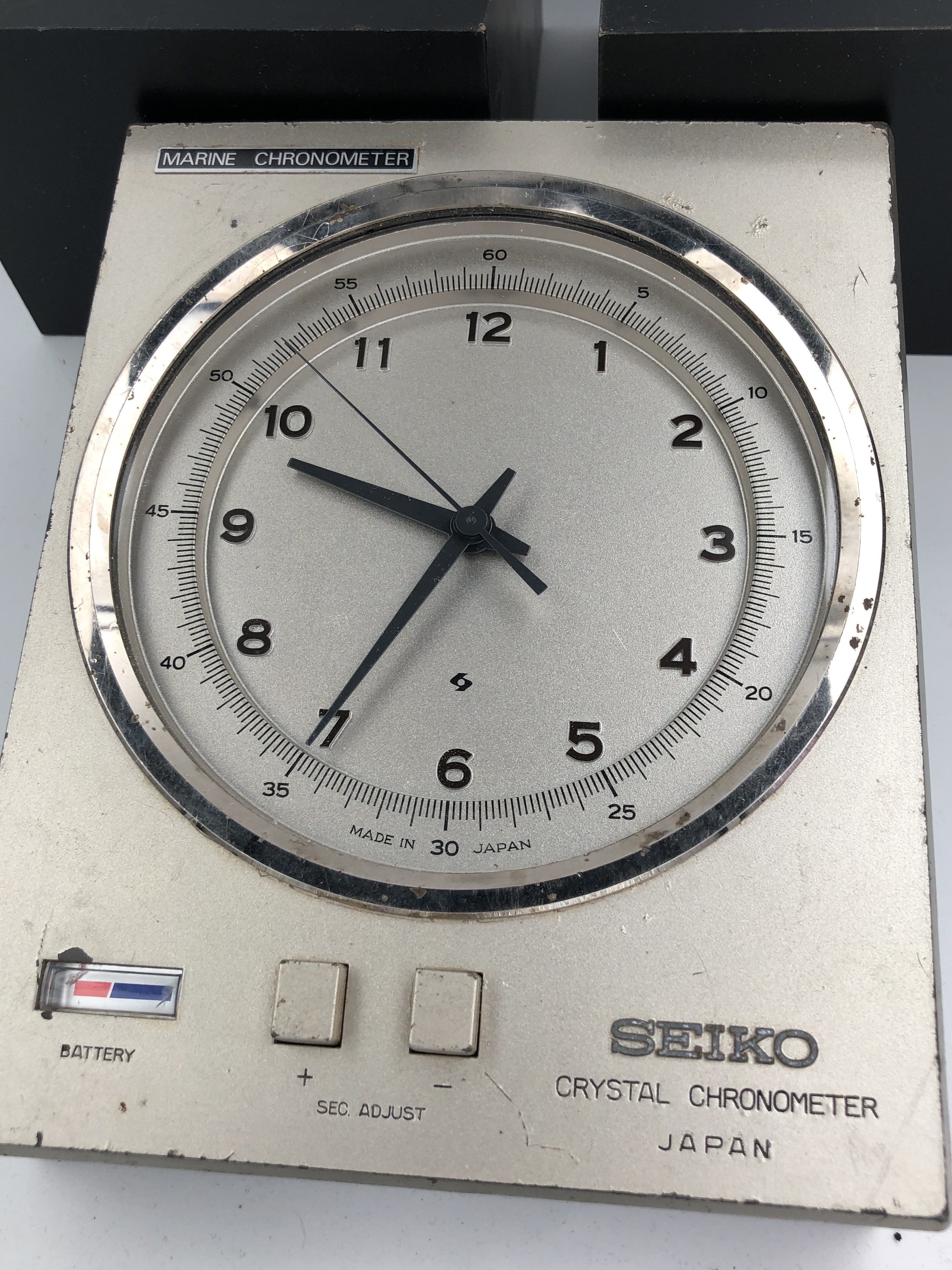

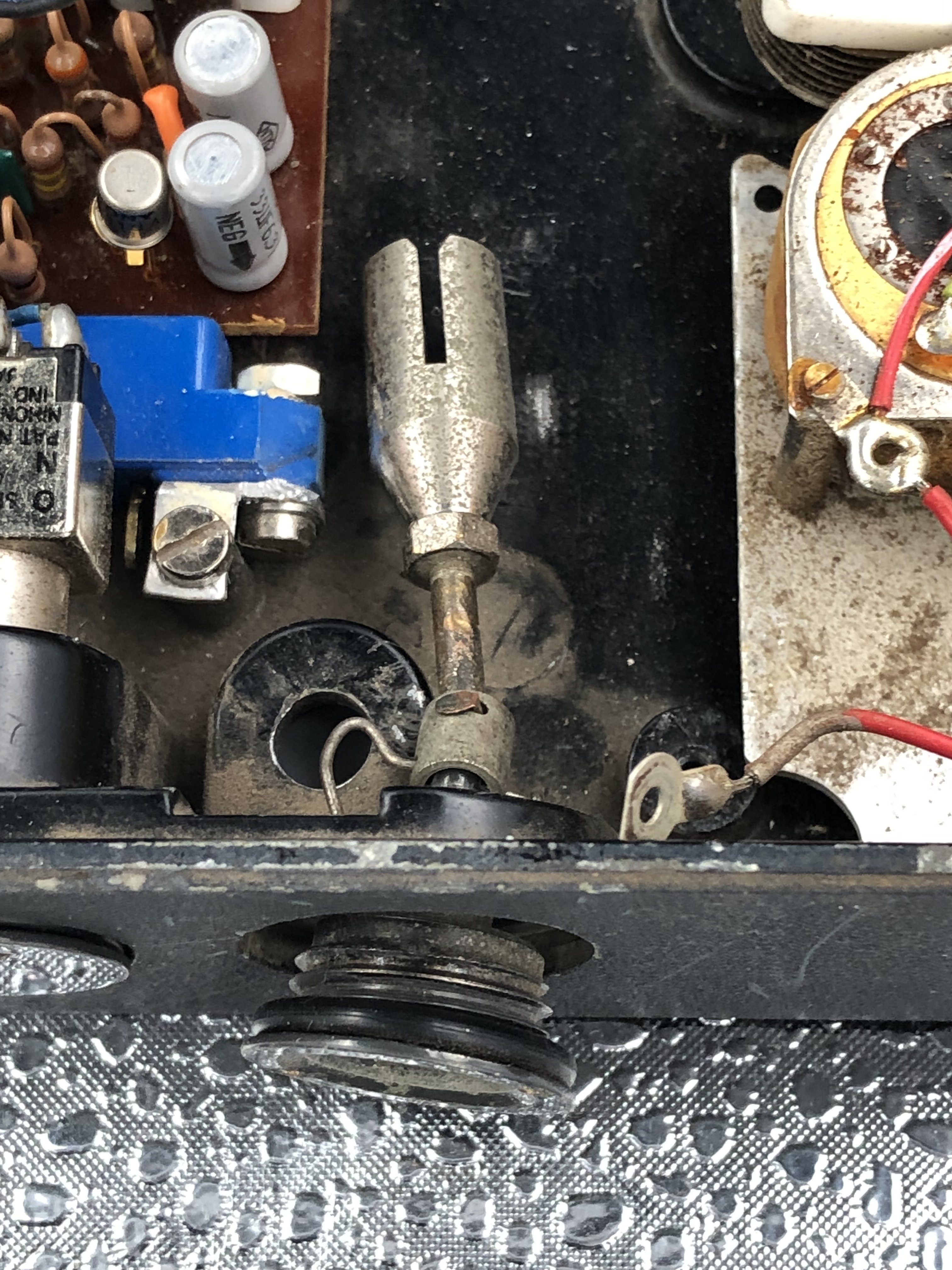

Here’s some pictures of a project Seiko QC951 II quartz chronometer. It might be more of a relic as it has a lot of what looks like sediment inside the case. But it gives you an idea of late 60’s/early 70’s quartz technology.

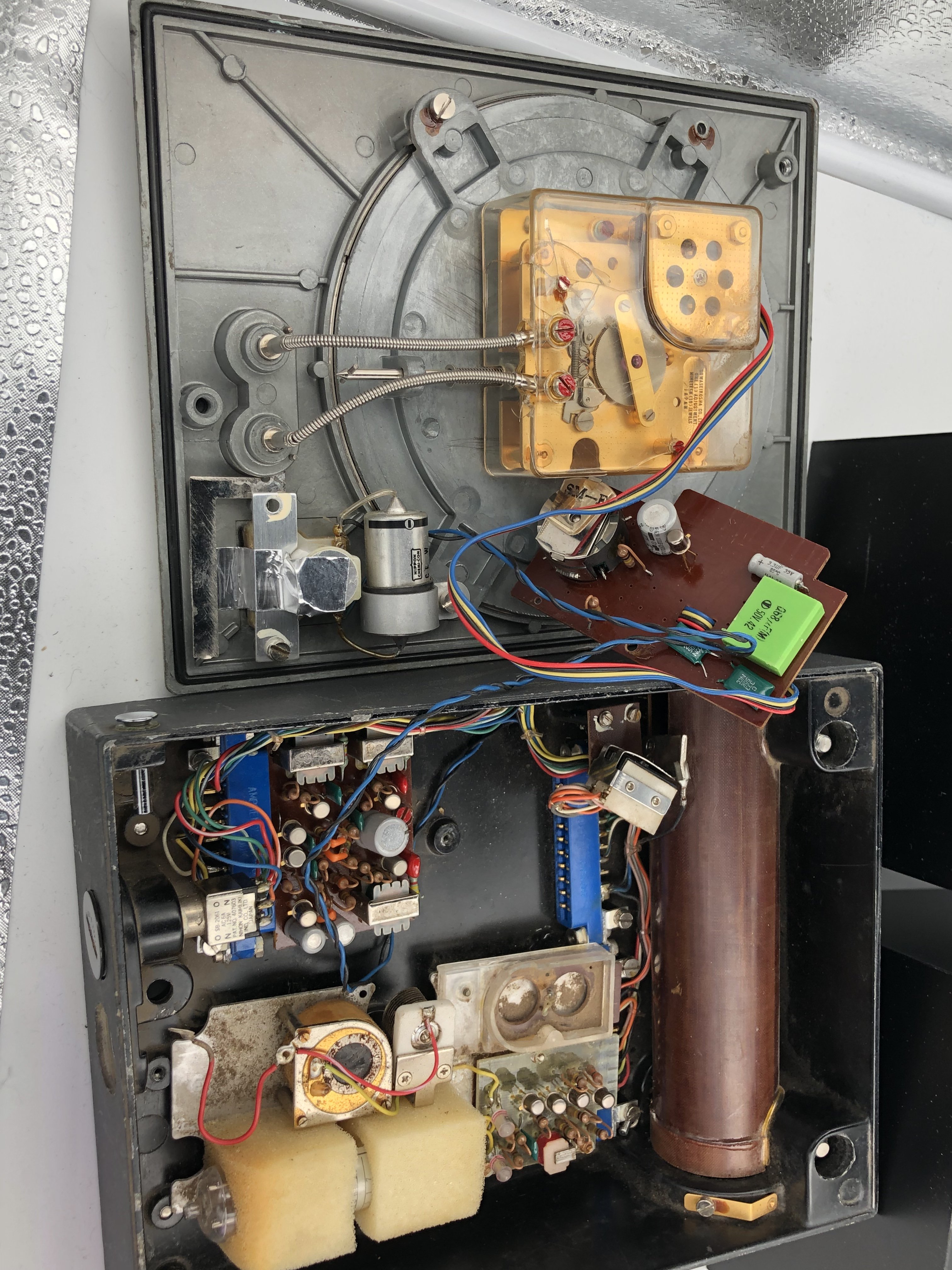

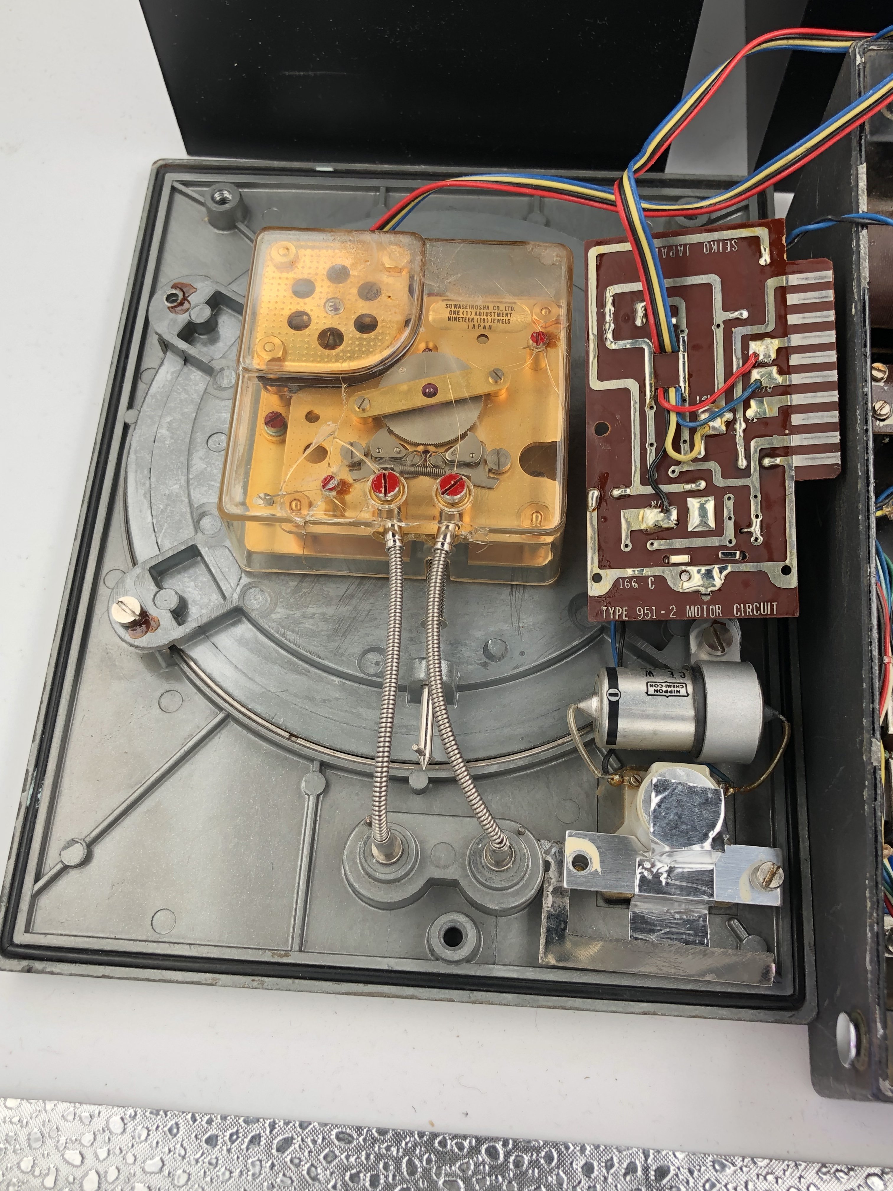

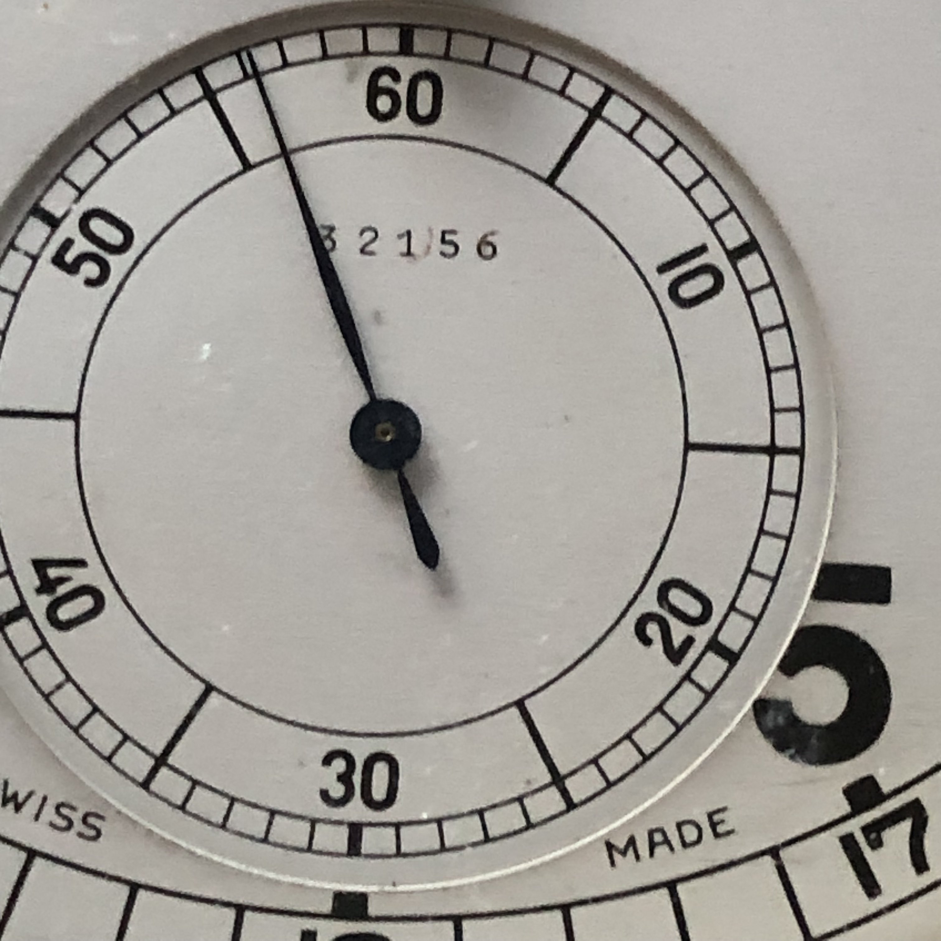

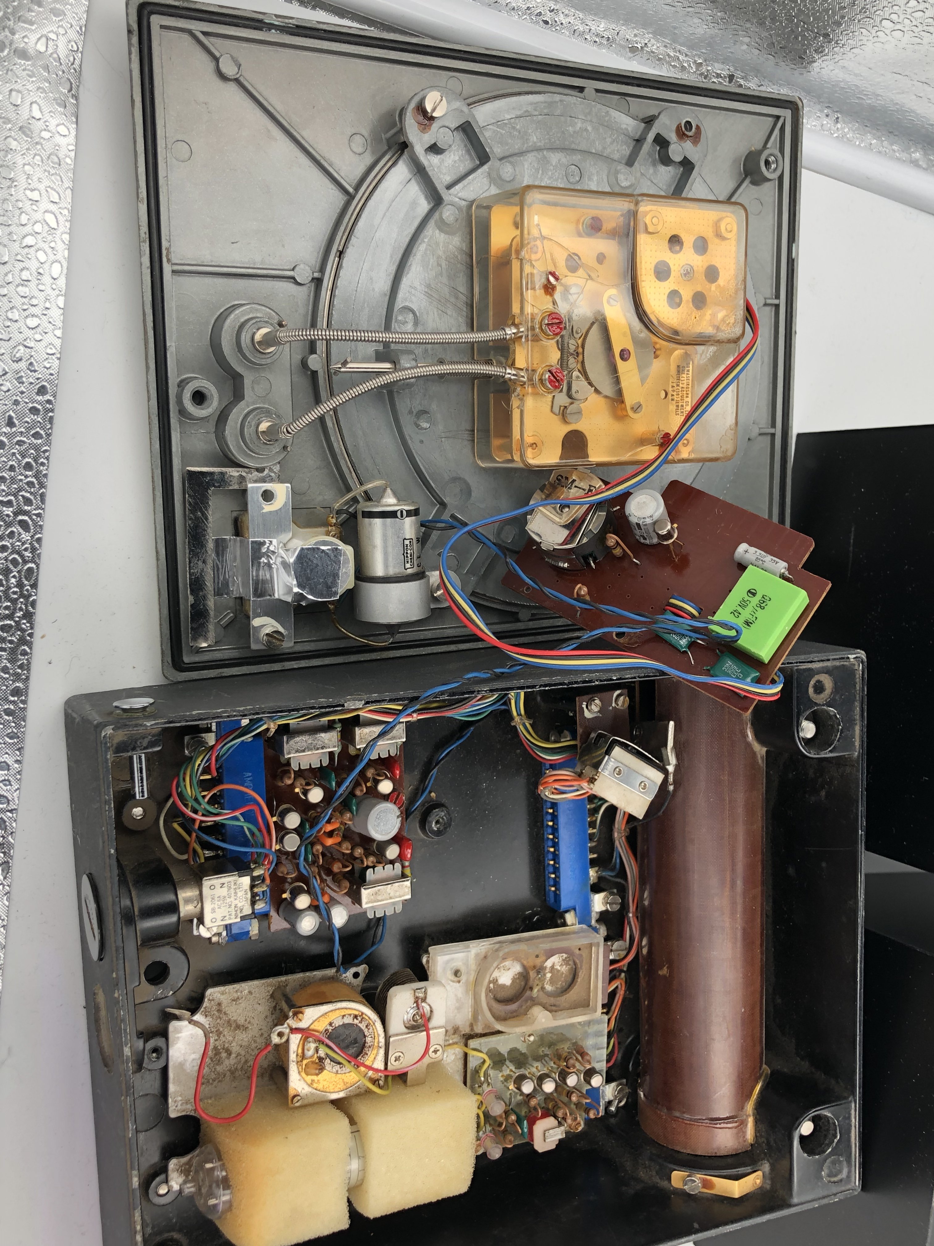

The innards - the top deck has the time display, battery level meter and seconds adjustment buttons.

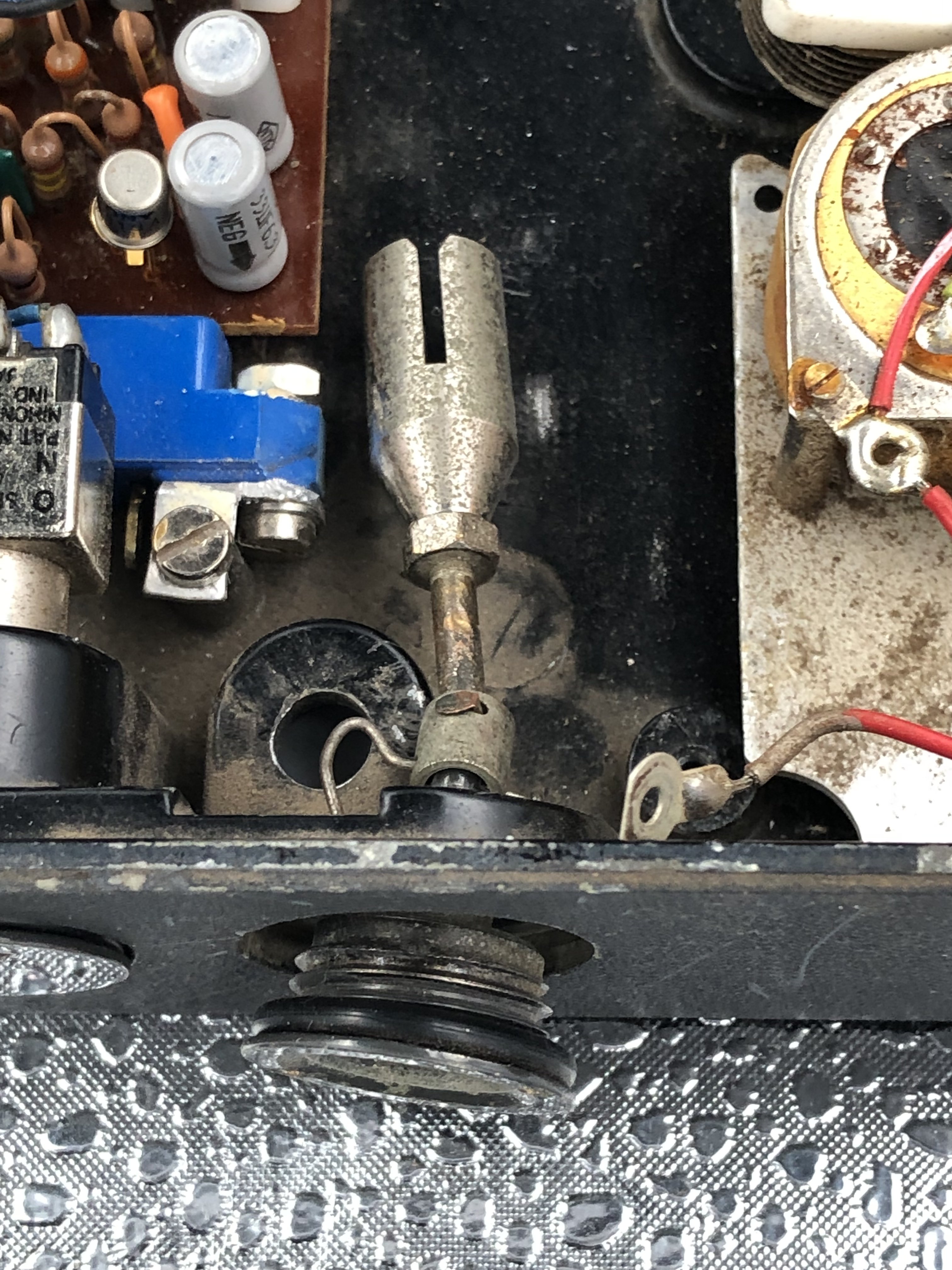

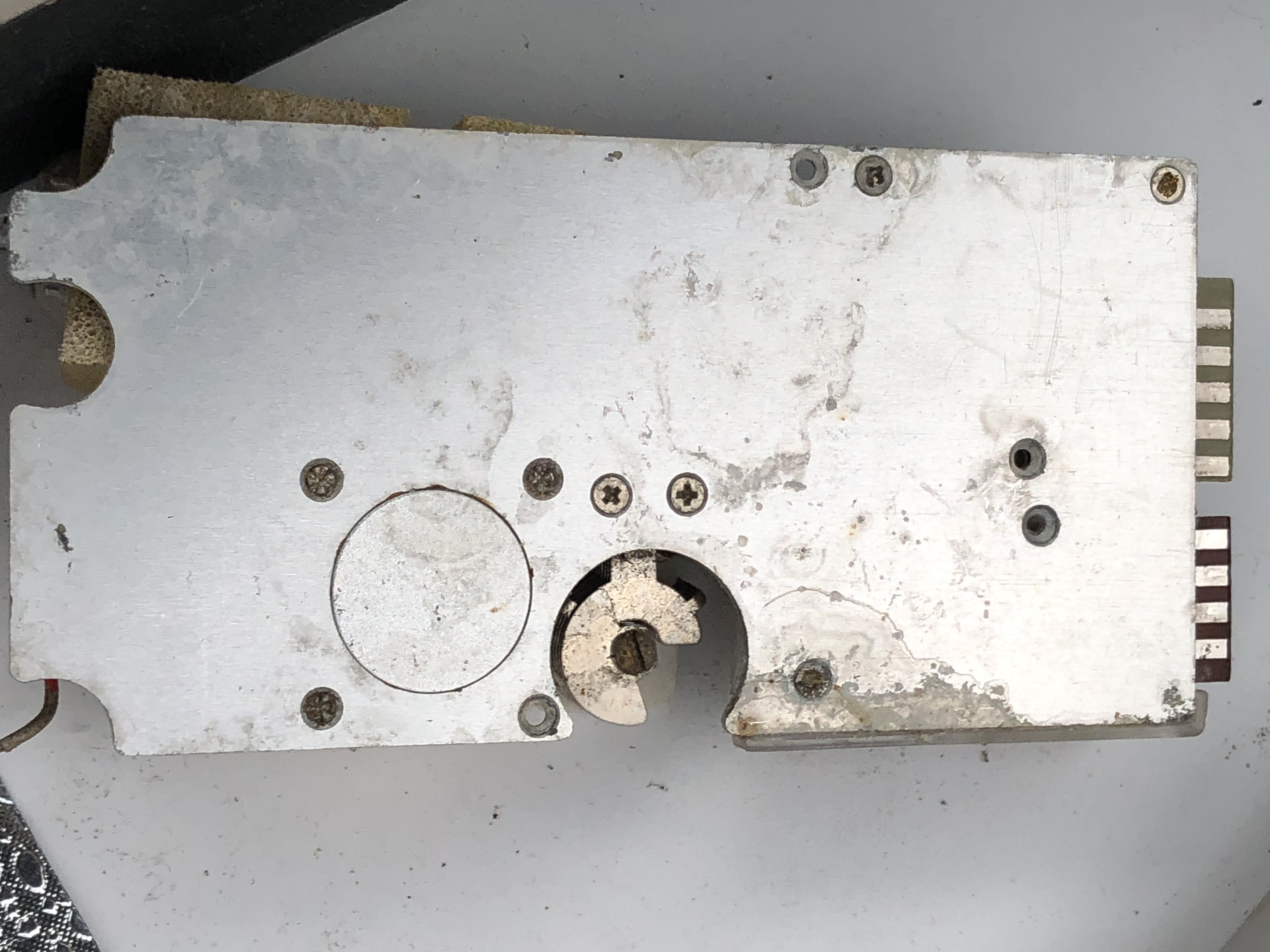

A closeup of the mechanical time setting shaft

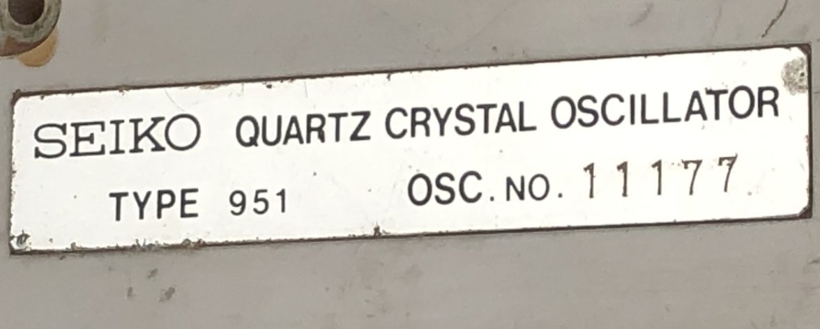

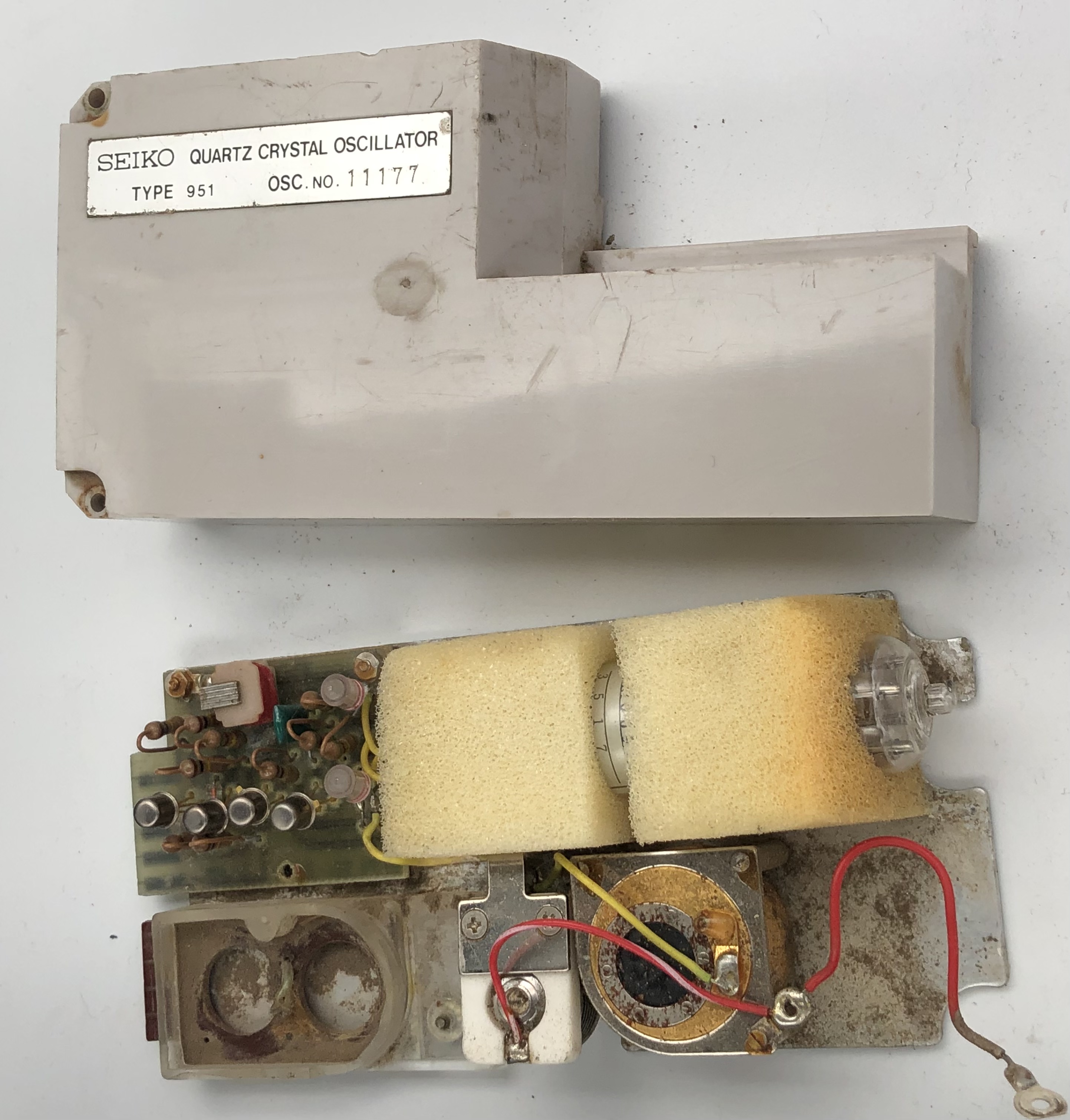

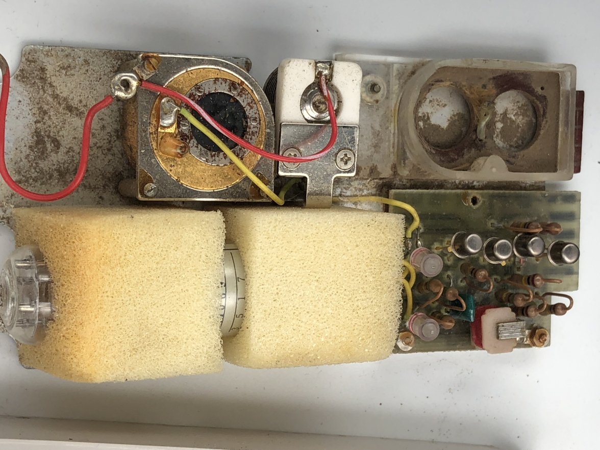

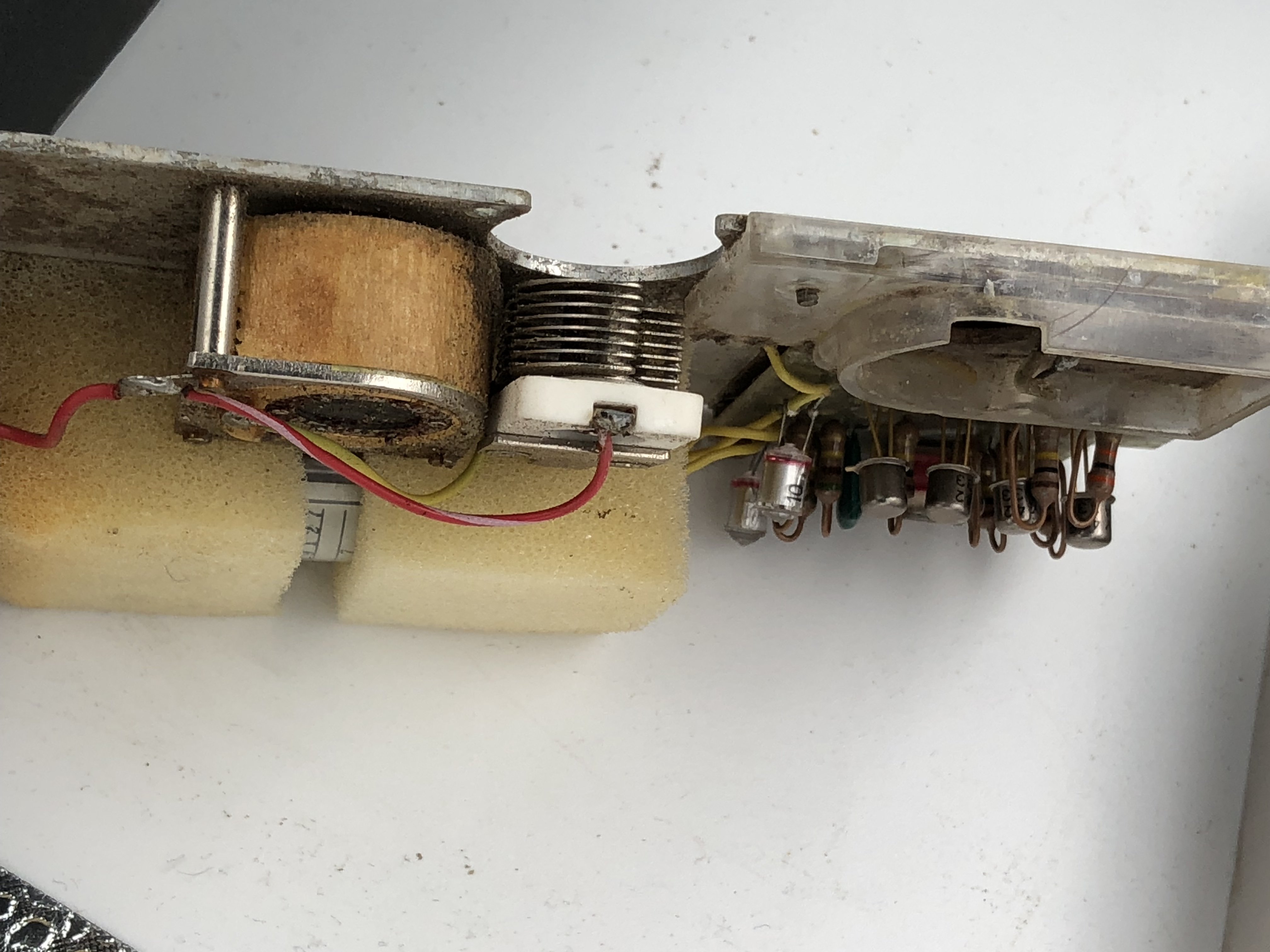

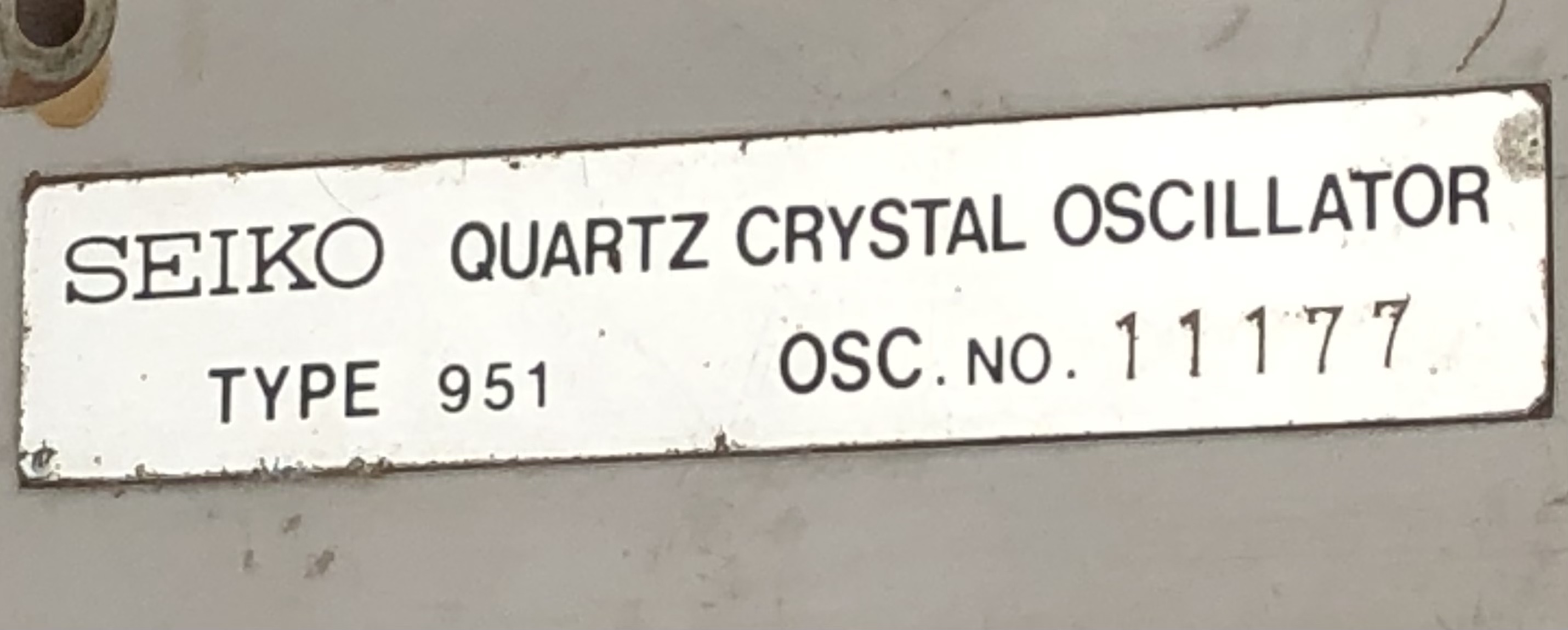

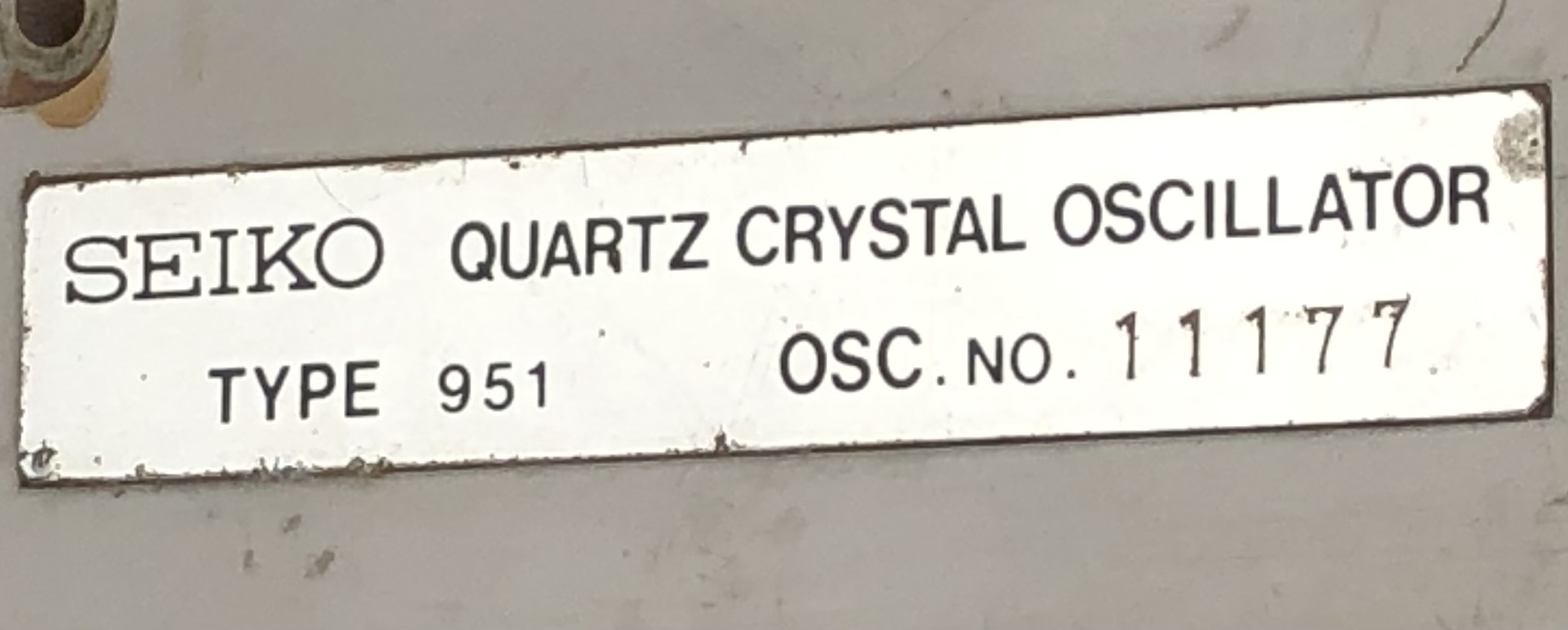

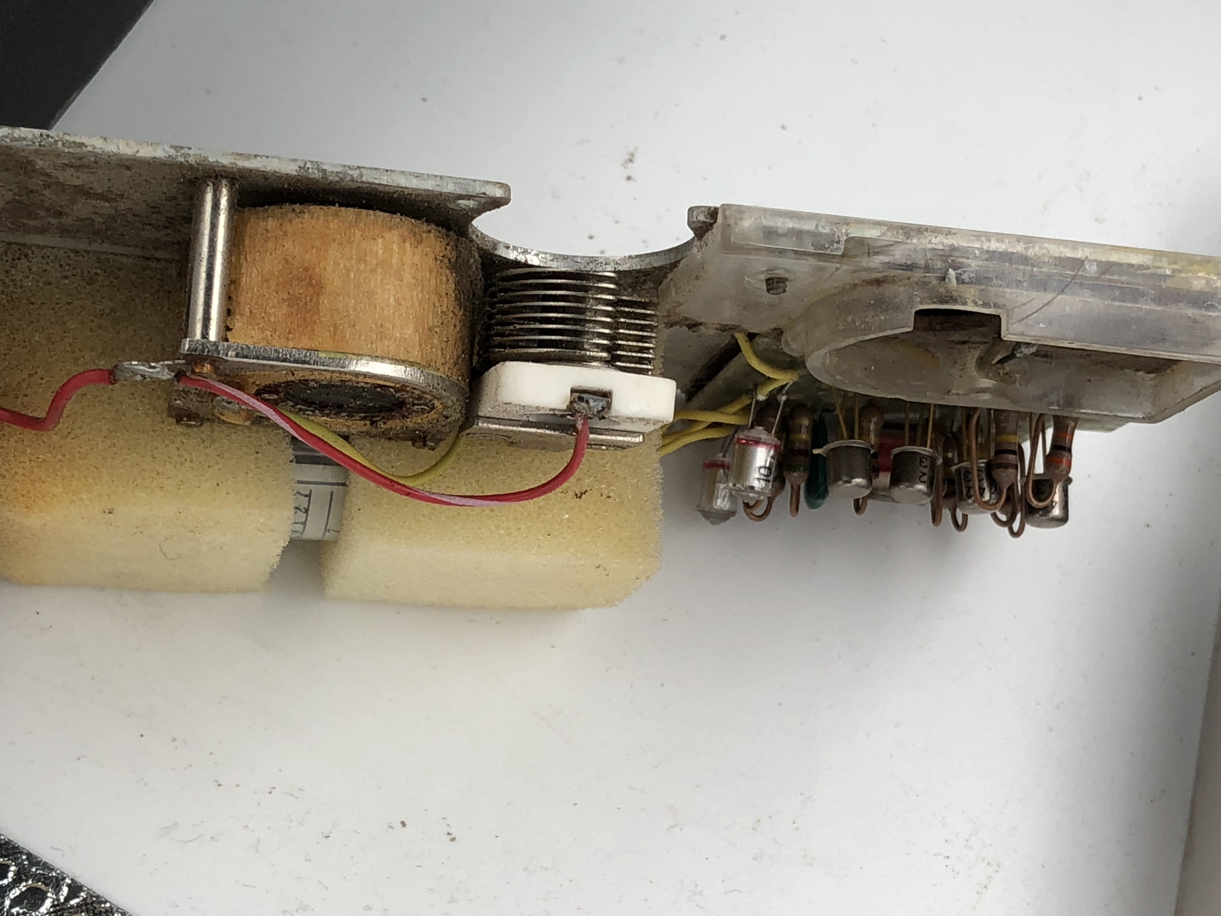

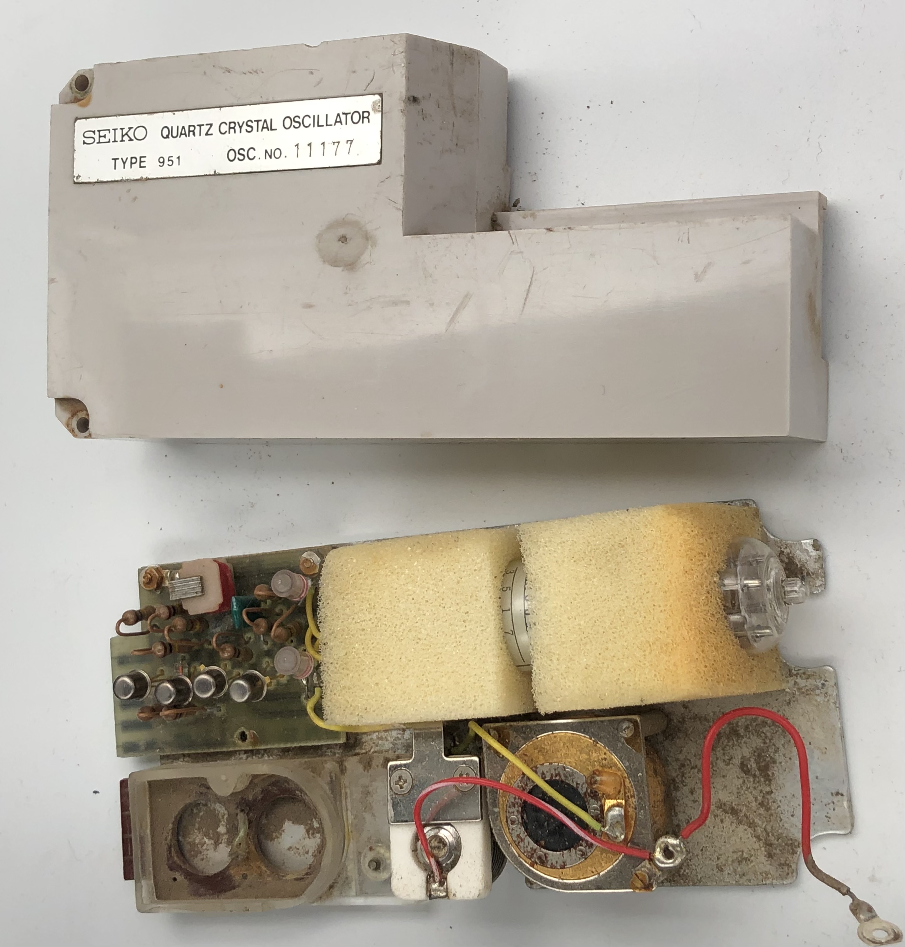

Side view of the oscillator module showing frequency adjustment capacitor

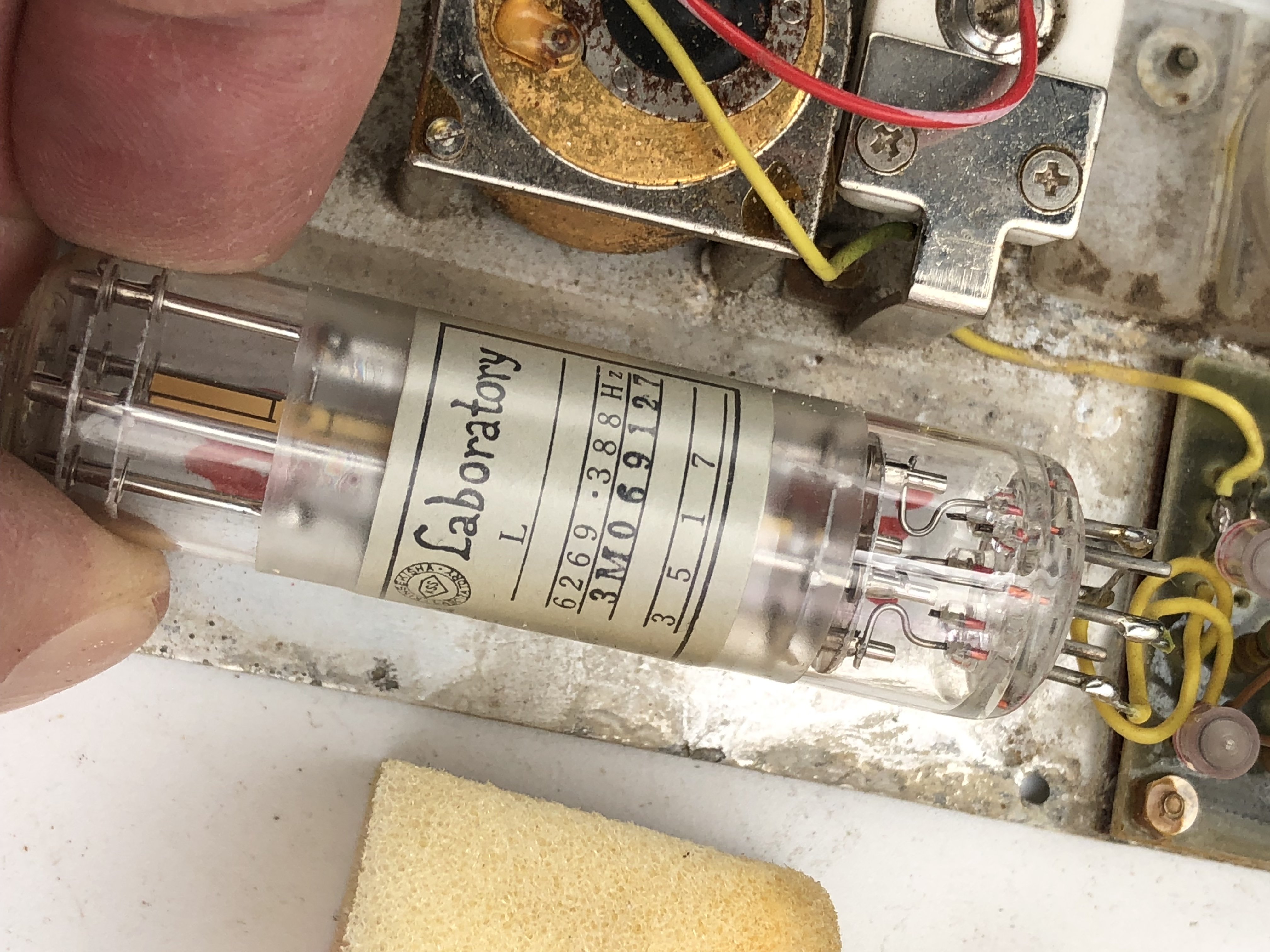

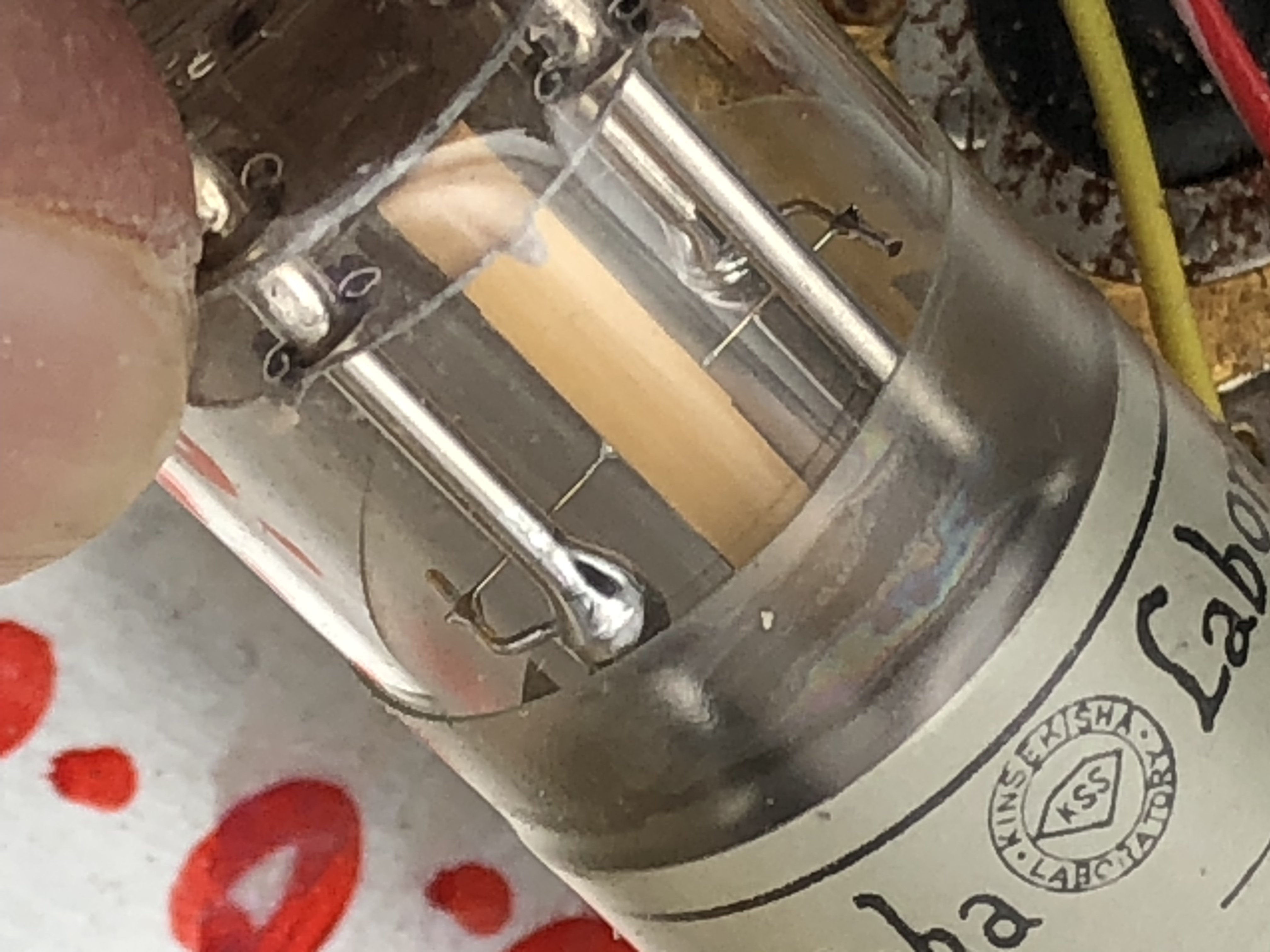

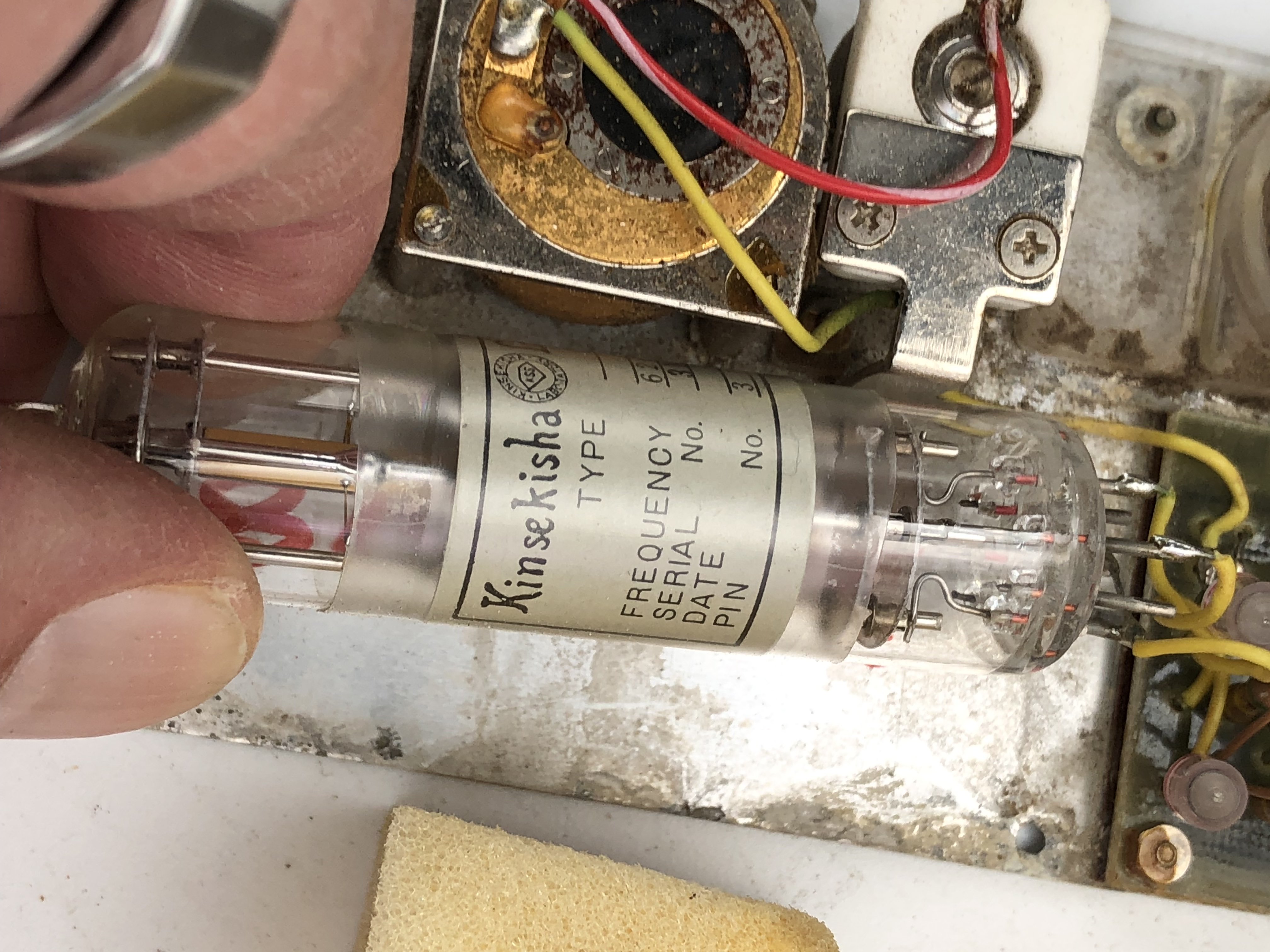

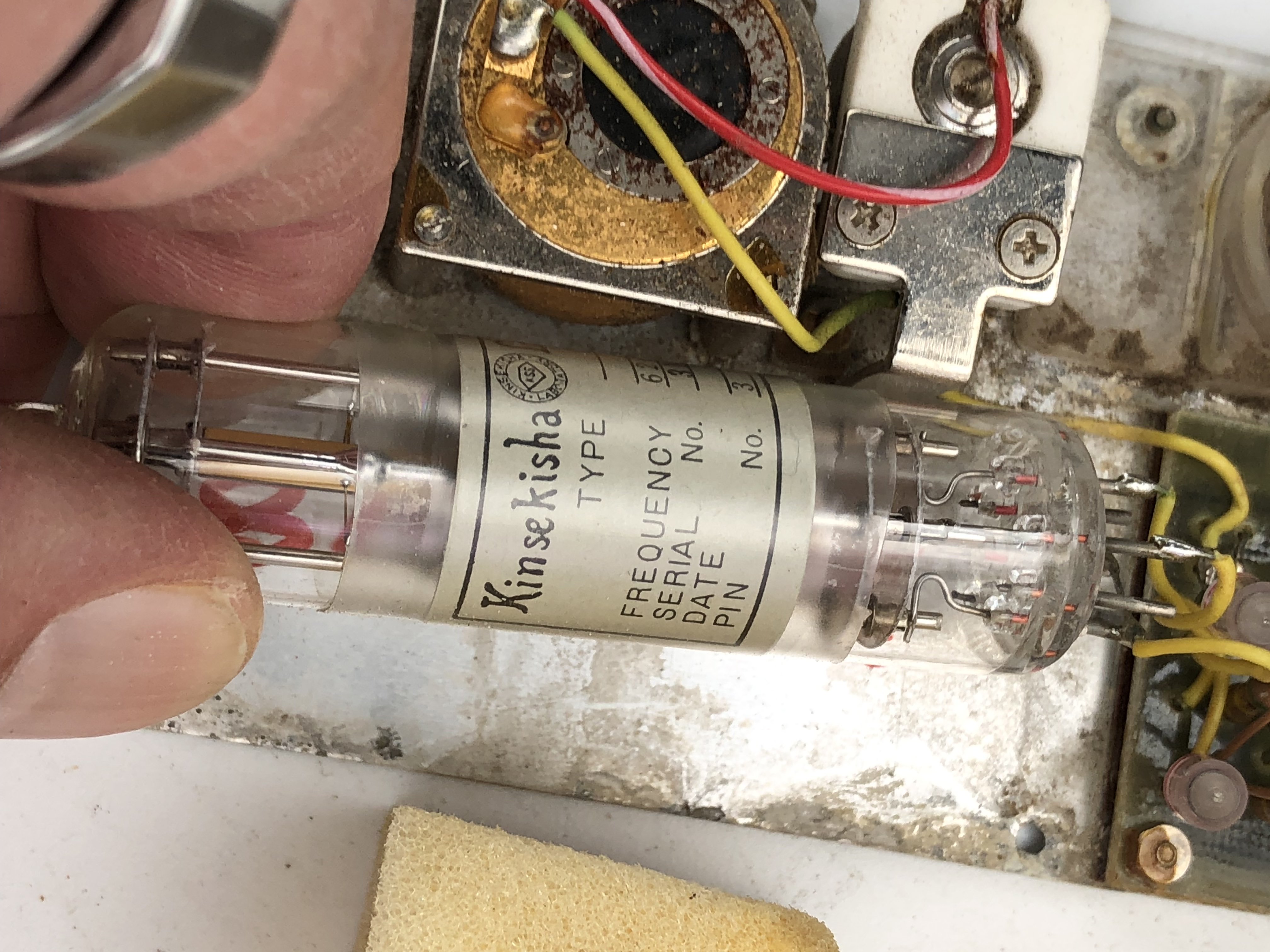

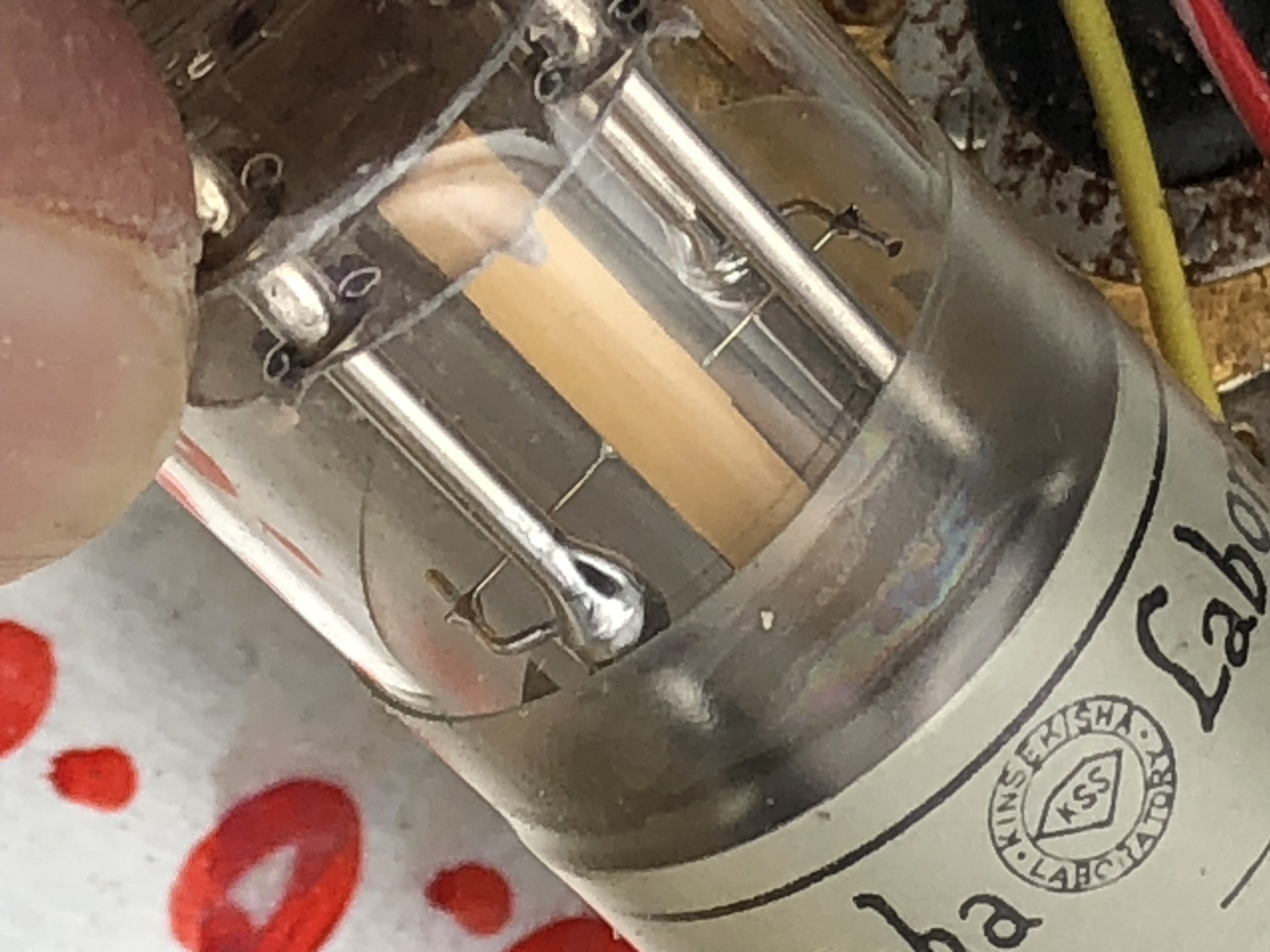

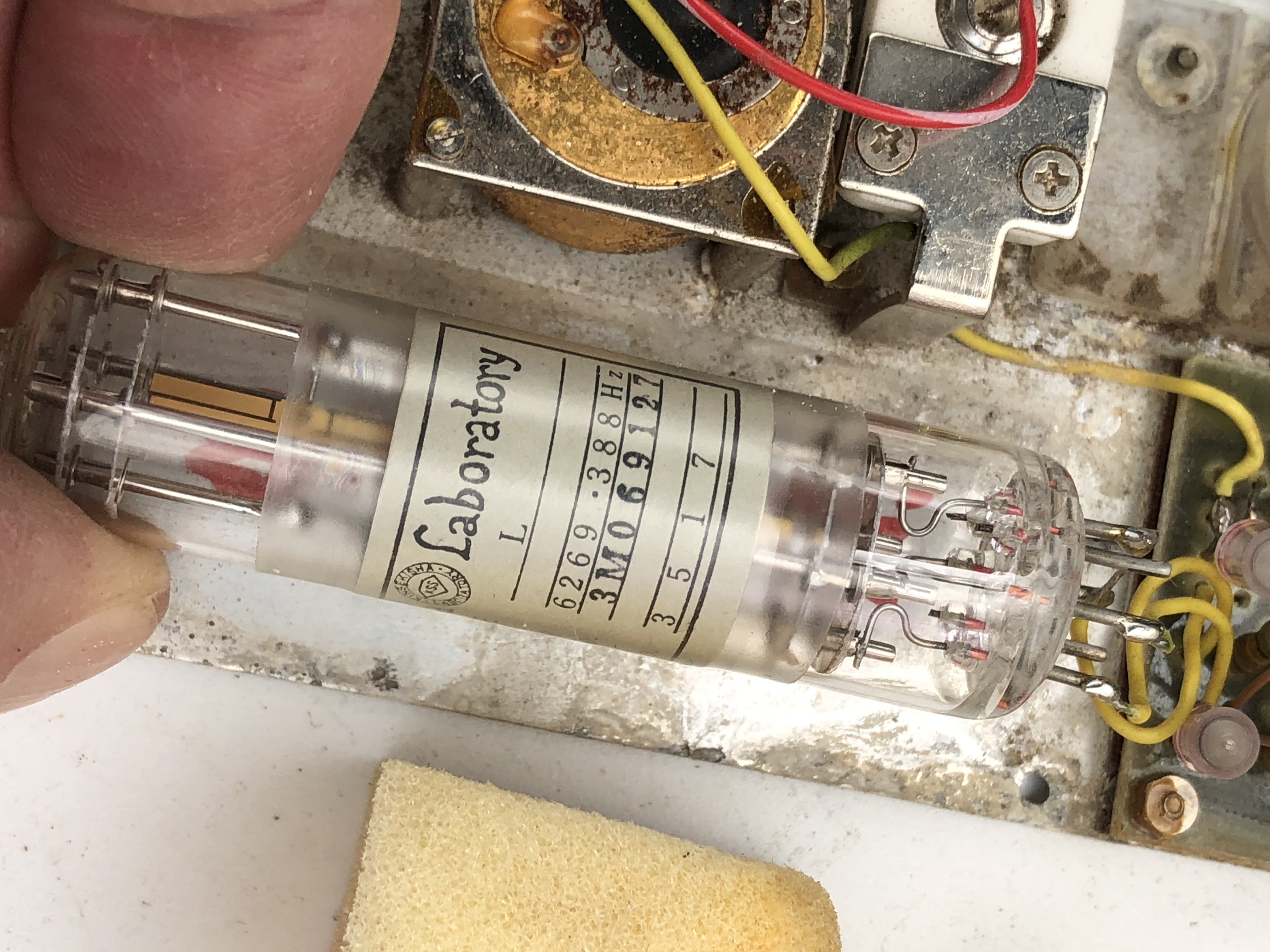

Closeup of the low frequency quartz crystal

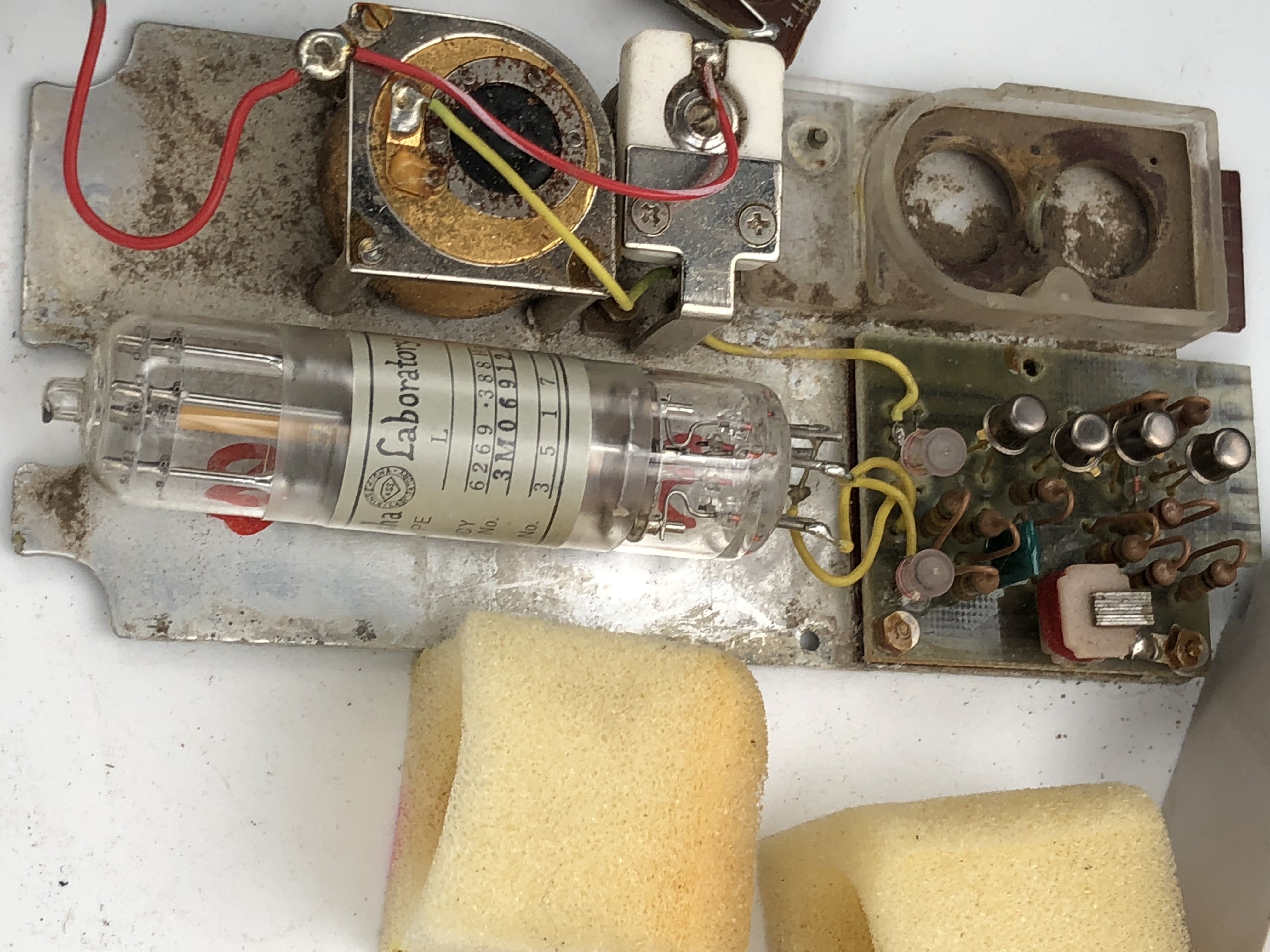

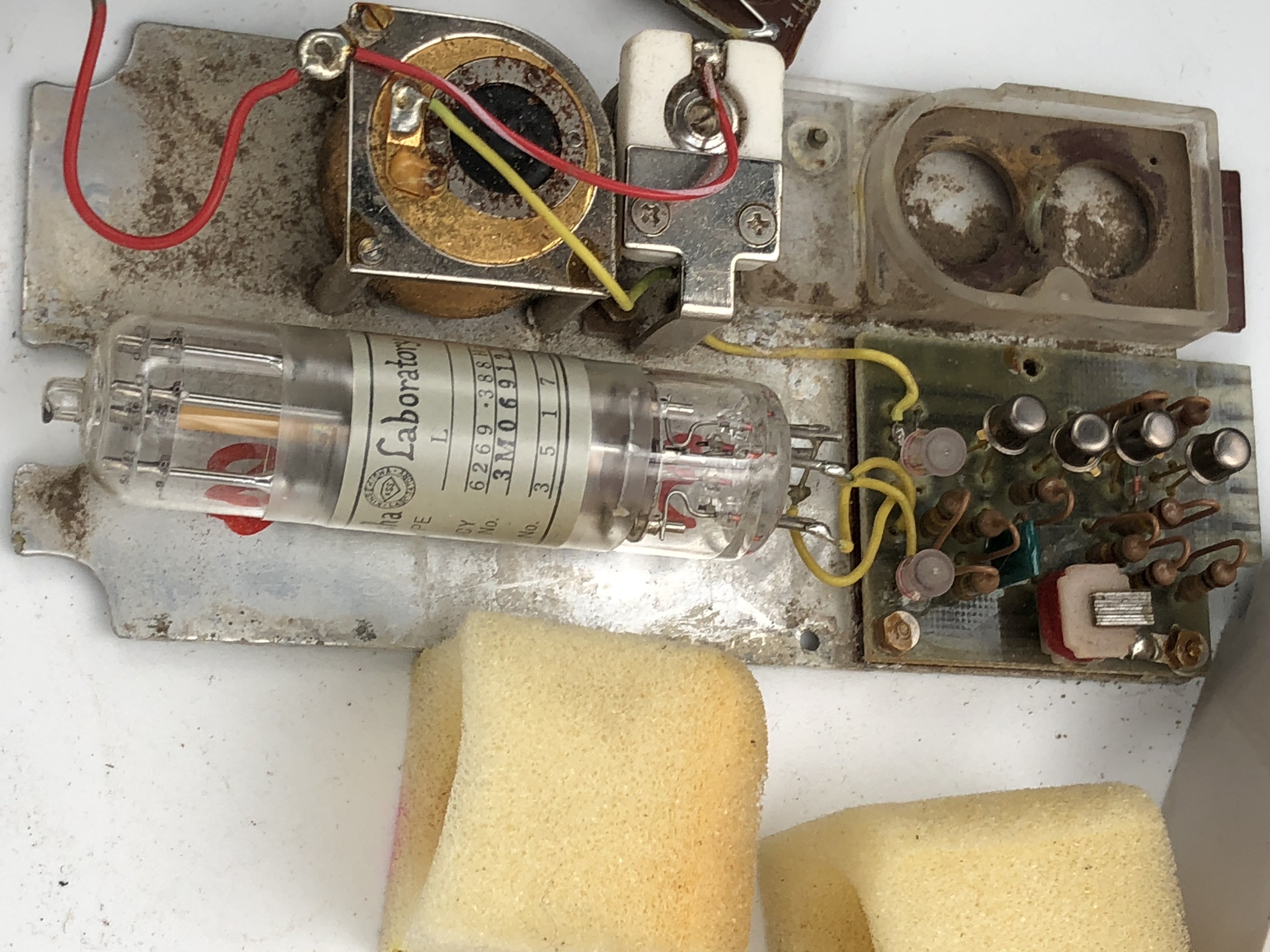

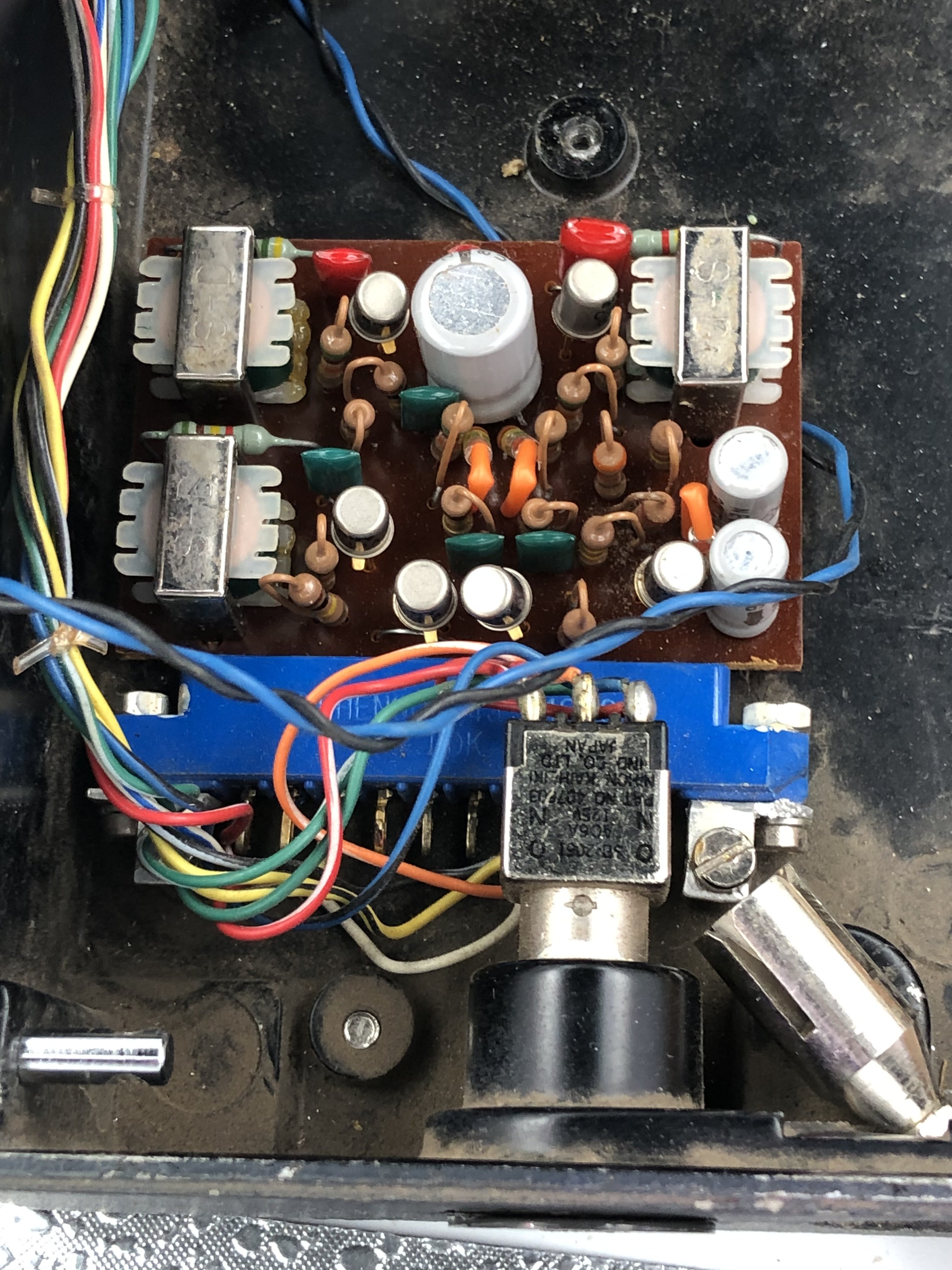

Oscillator board and metal coated plastic cover.

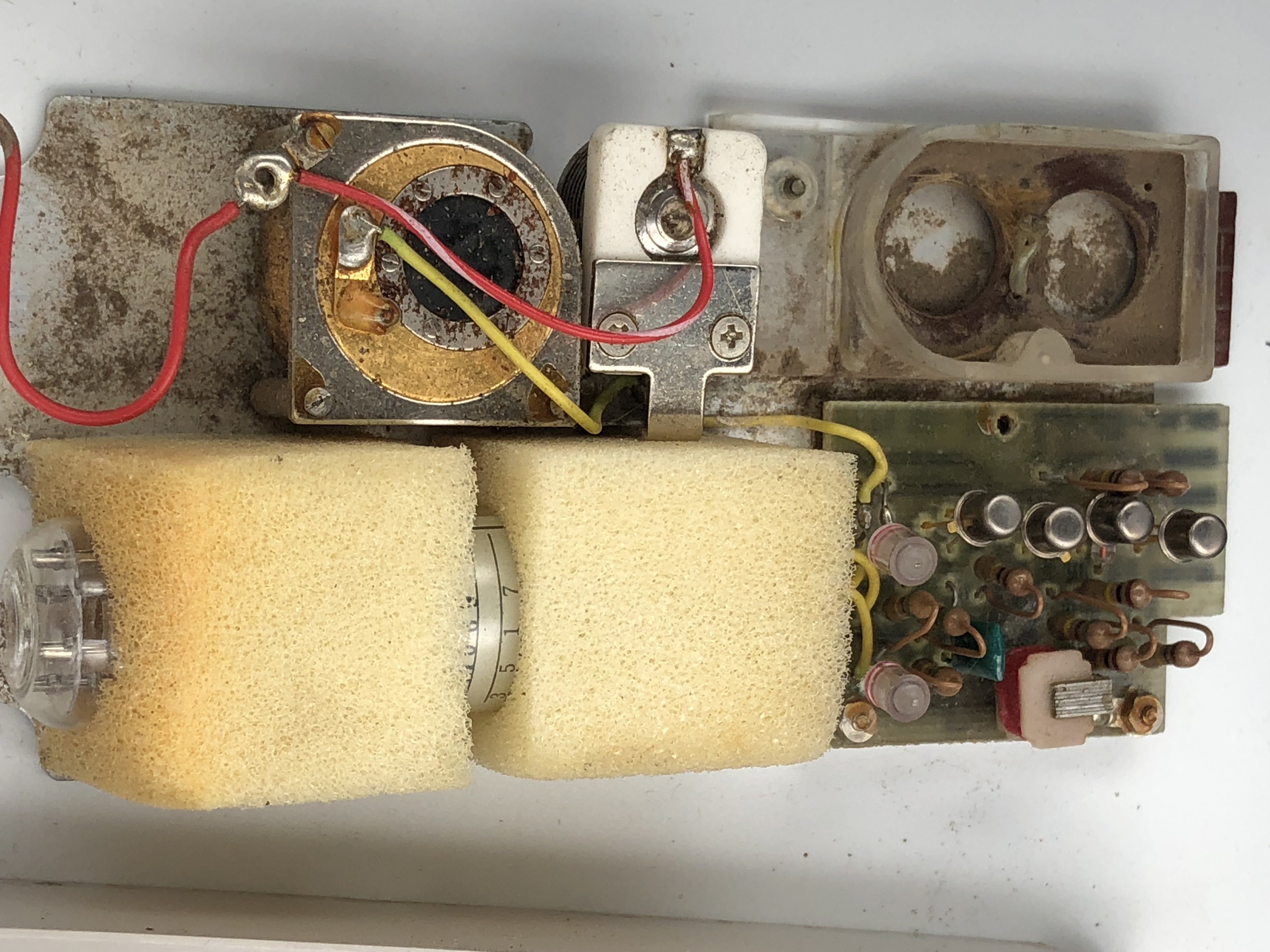

The quartz crystal is inside the foam rubber blocks which are surprisingly in decent condition.

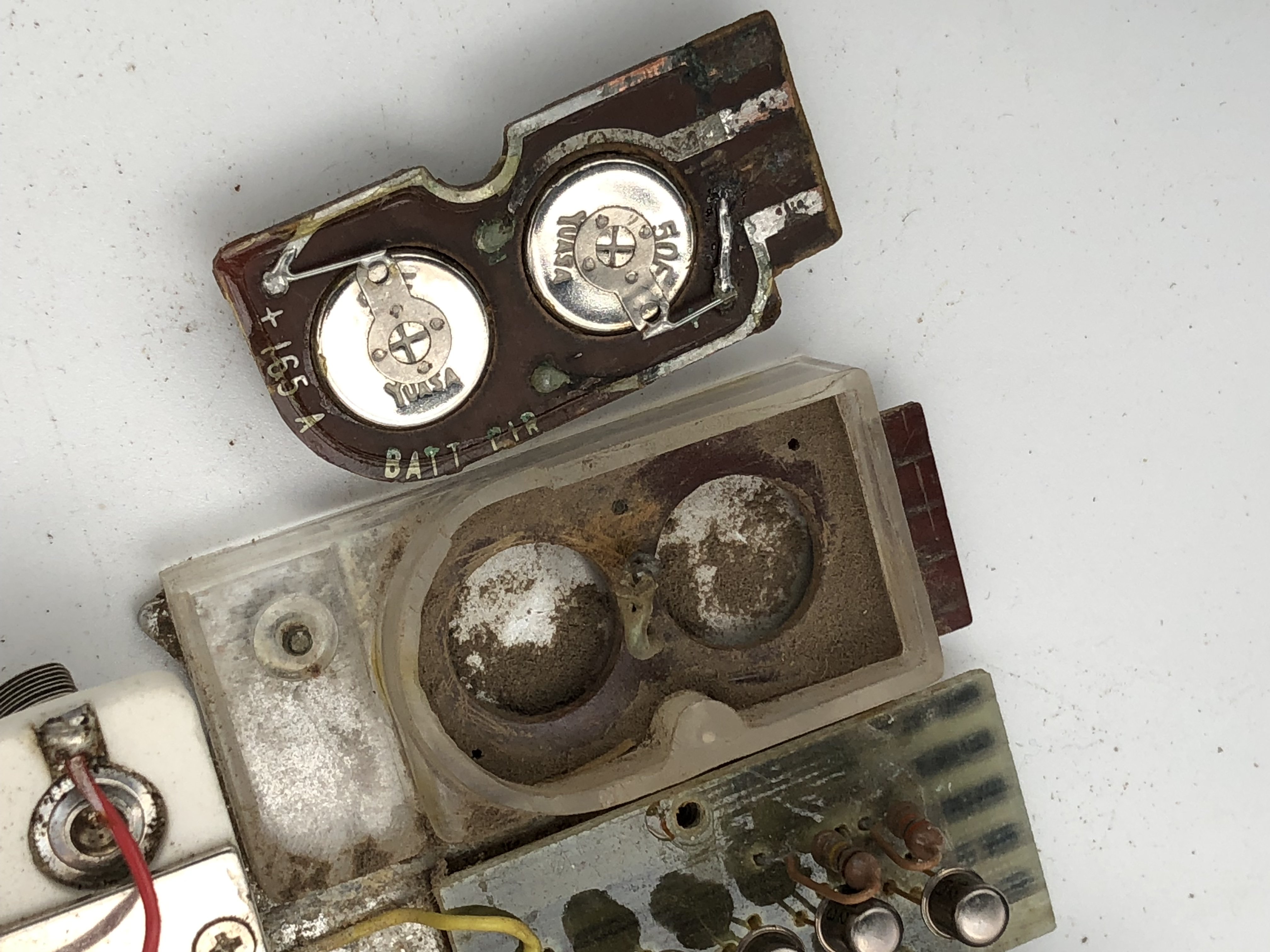

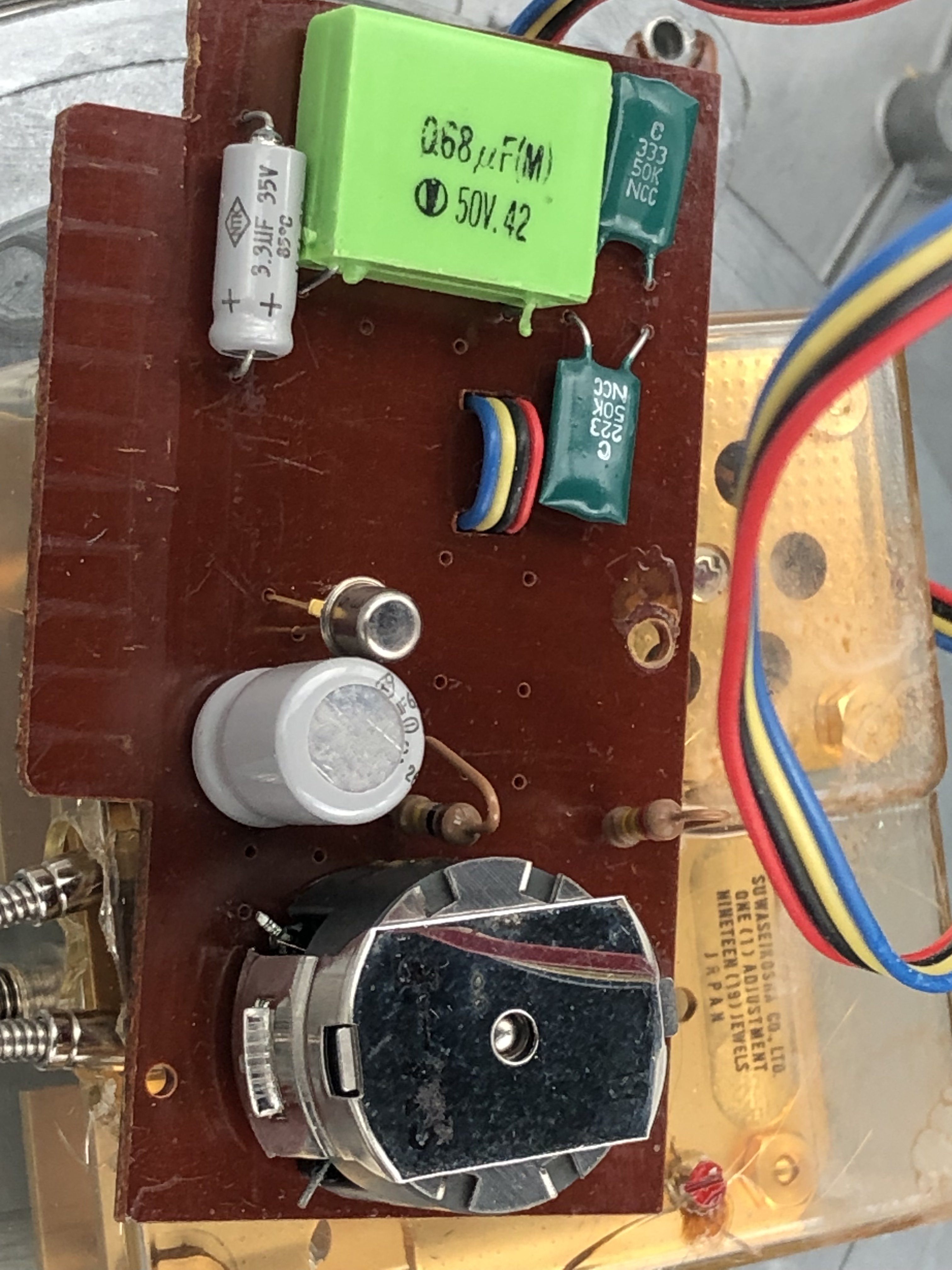

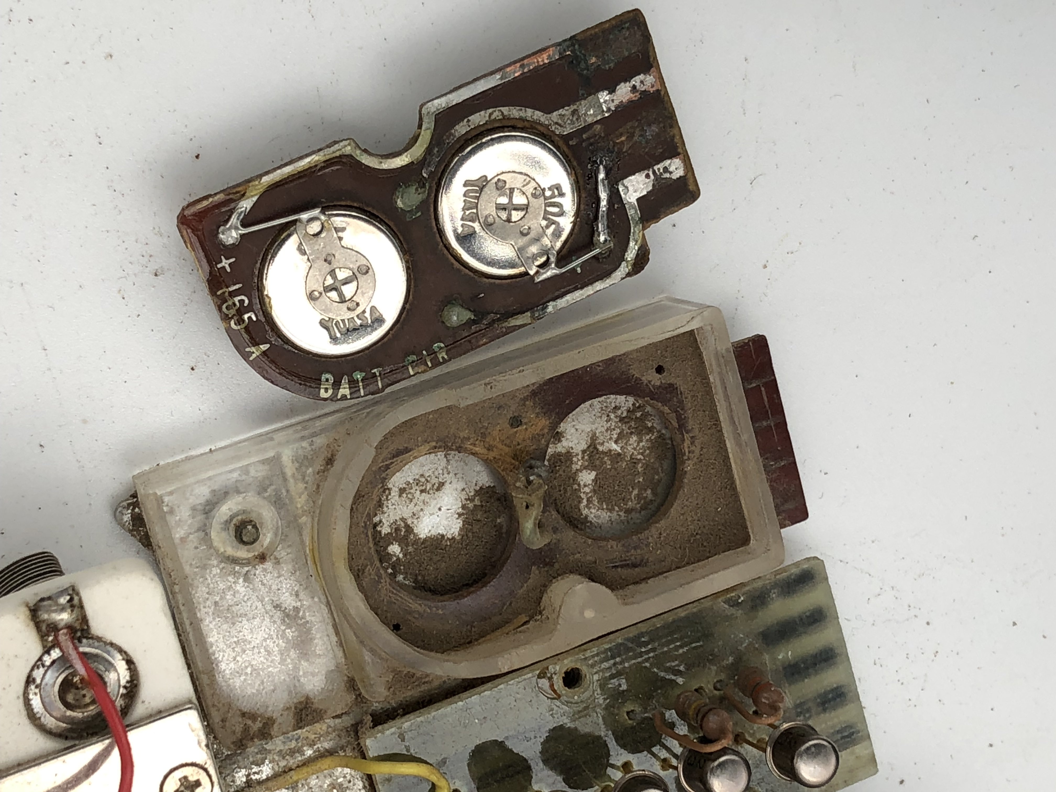

backup battery board that keeps the clock running while the main “D” cells are replaced. The upper board came out of a different clock. The lower board is still attached to the oscillator base by a screw that won’t come out and its batteries are missing. I don’t know what the battery technology is.

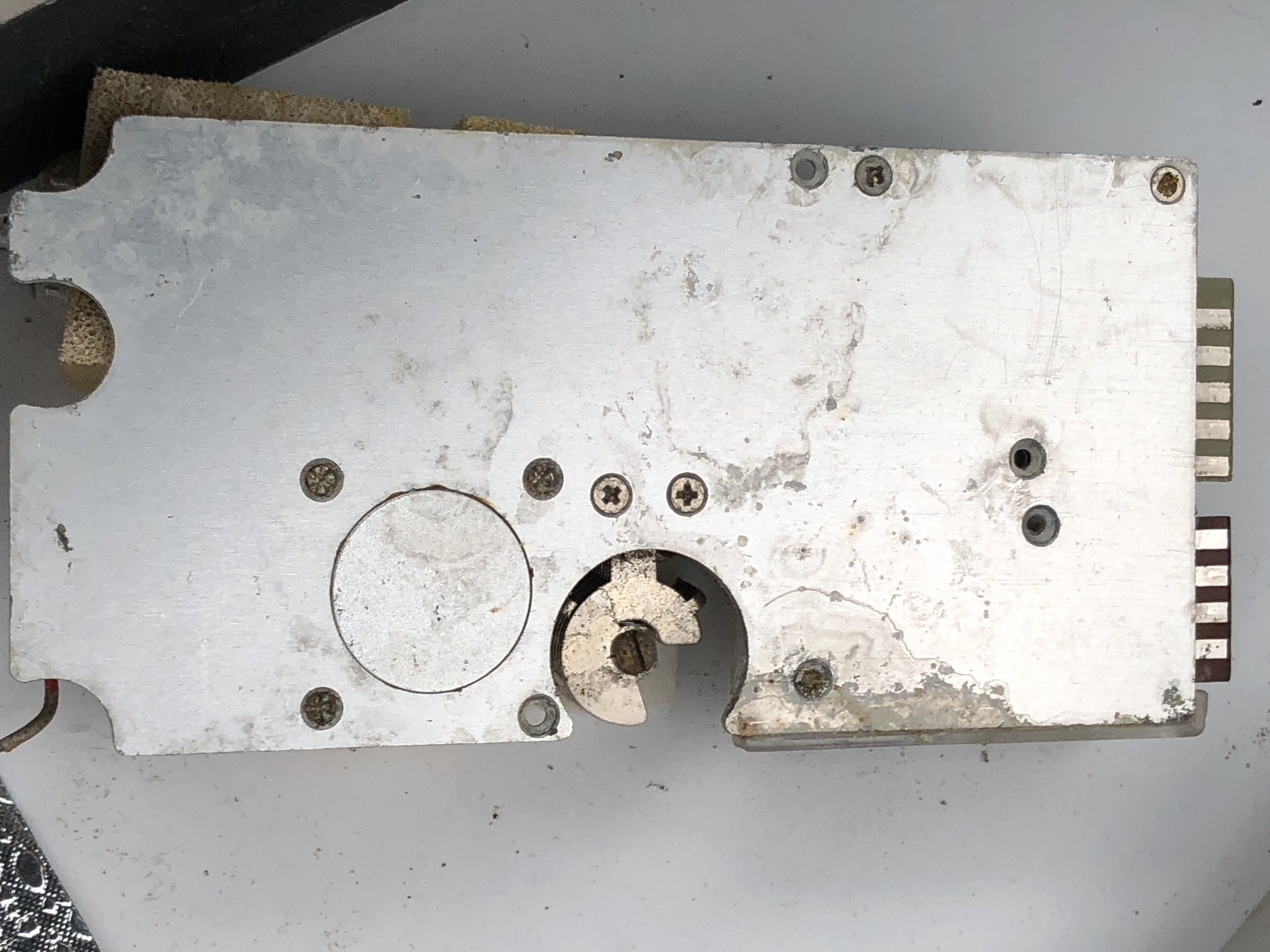

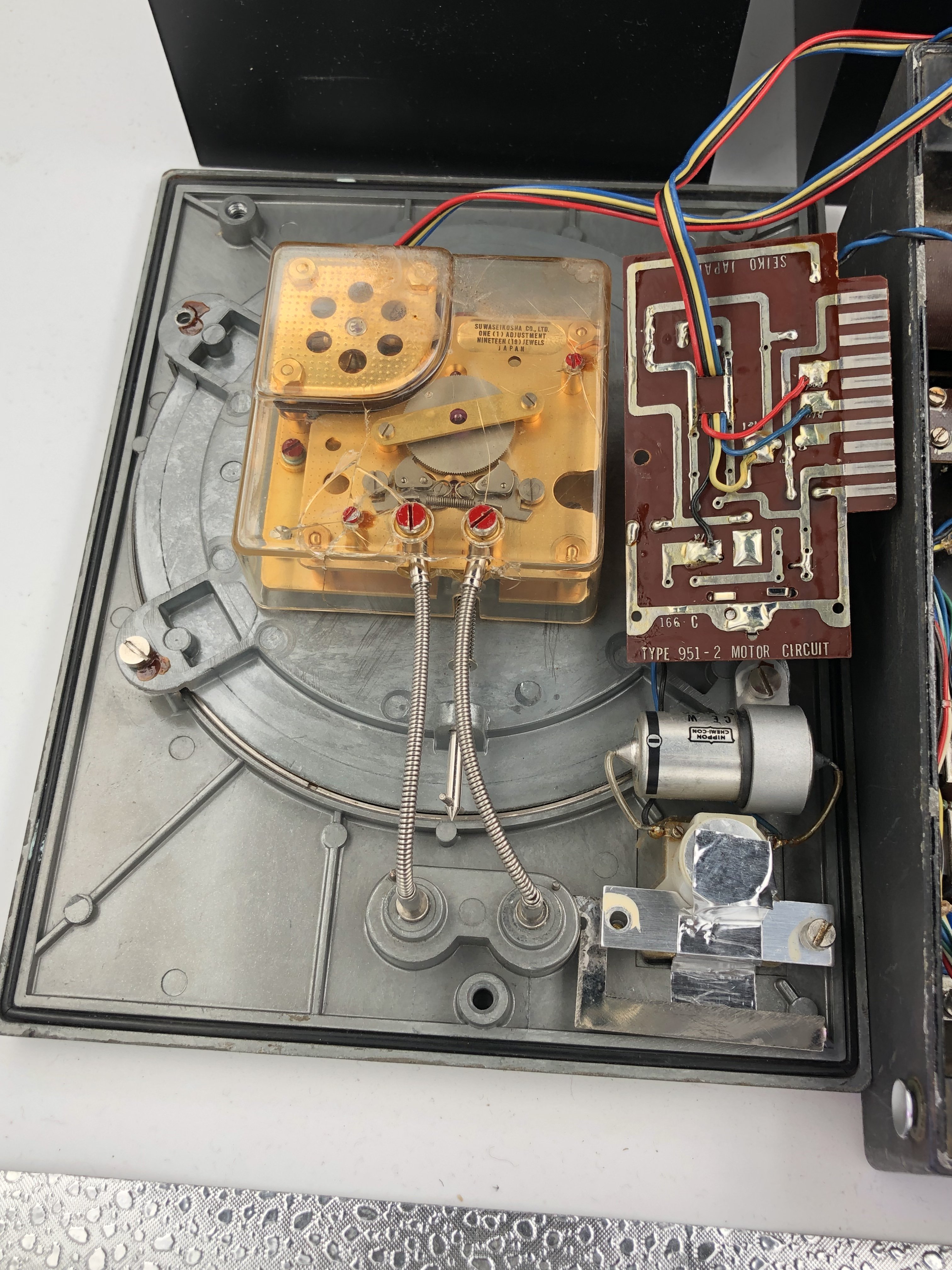

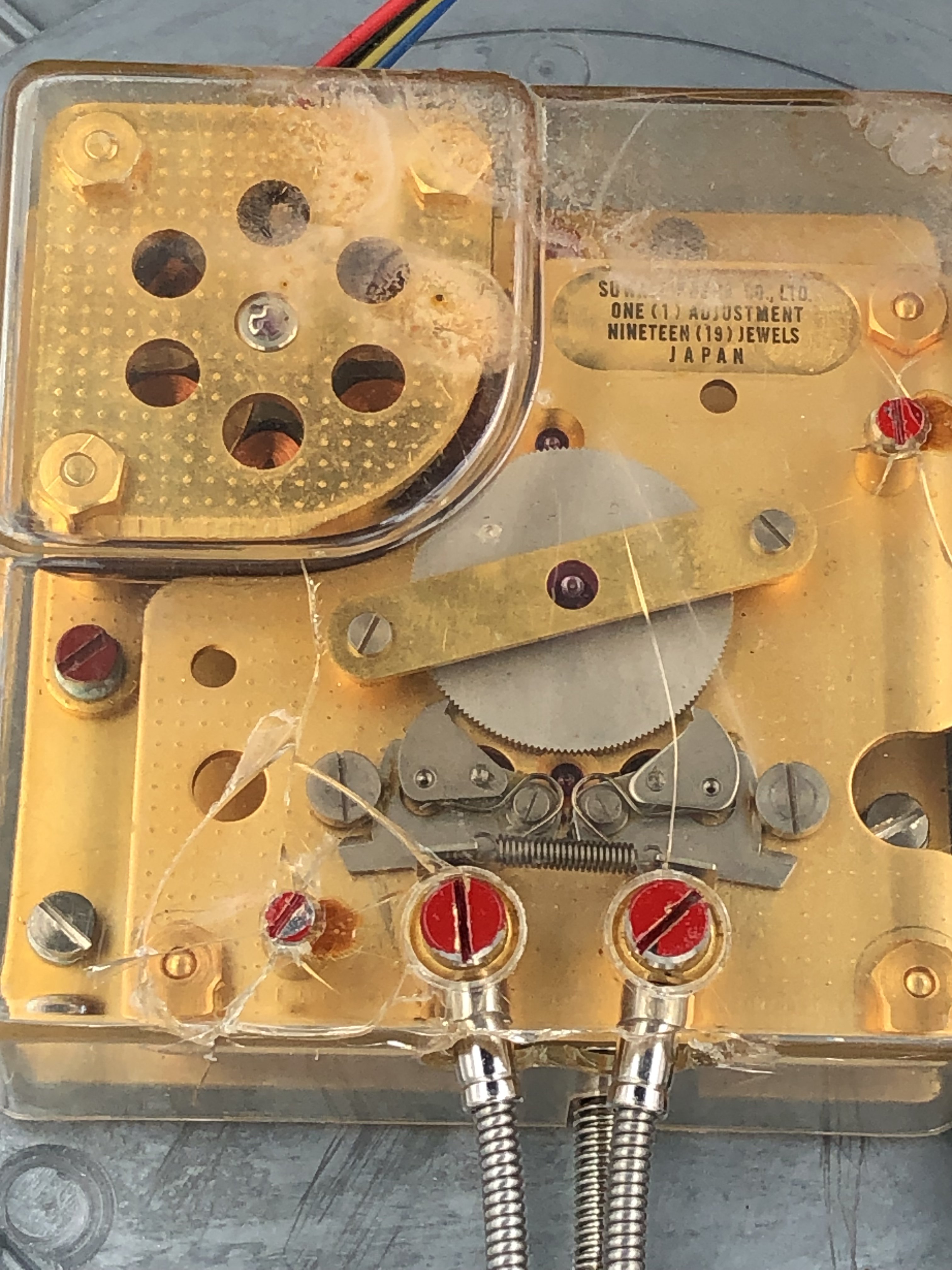

Backside of the top deck with the motor driver board.

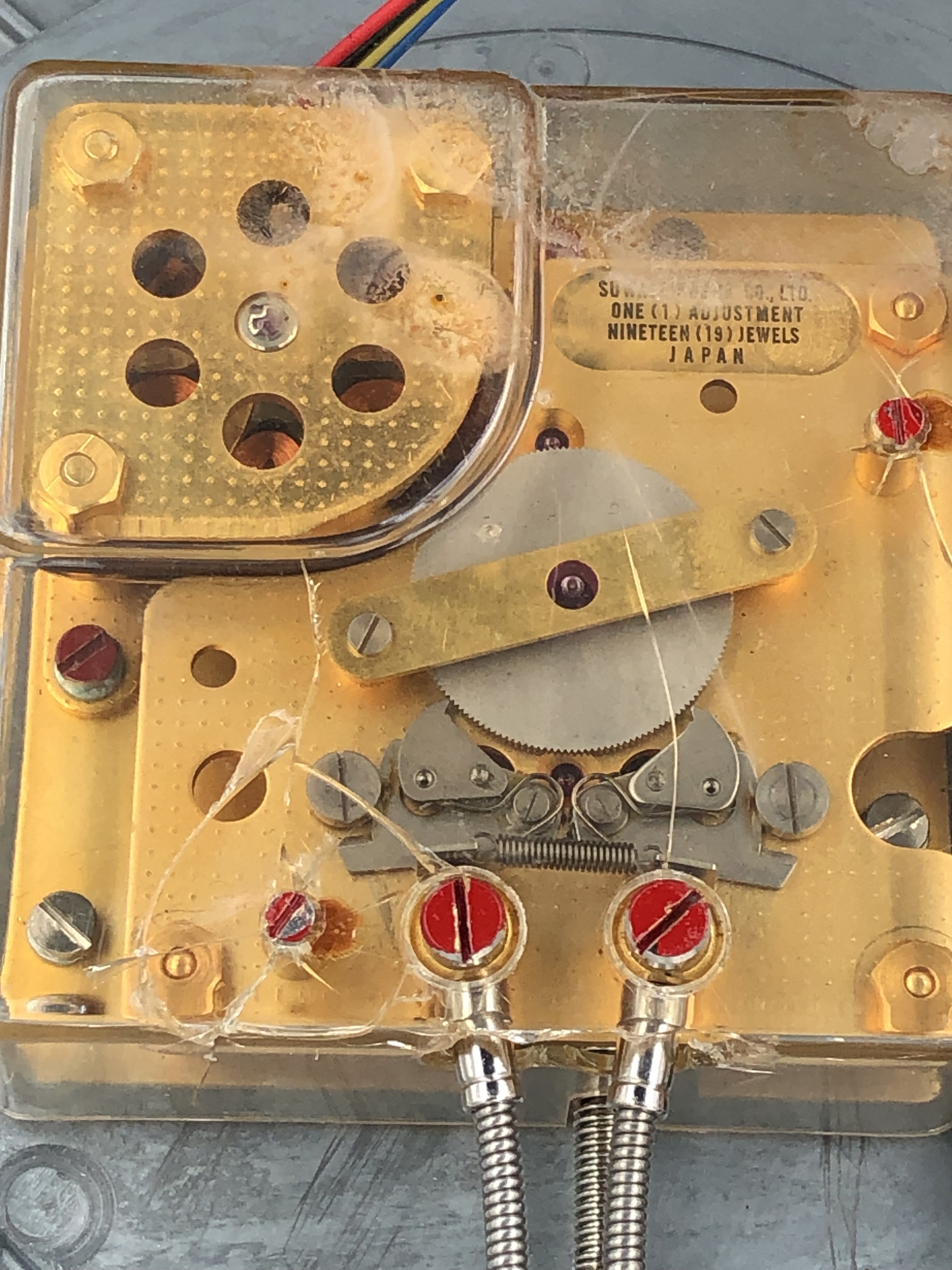

display mechanism with the mechanical seconds adjustment mechanism.
Motor driver board
Mechanical time adjustment linkage

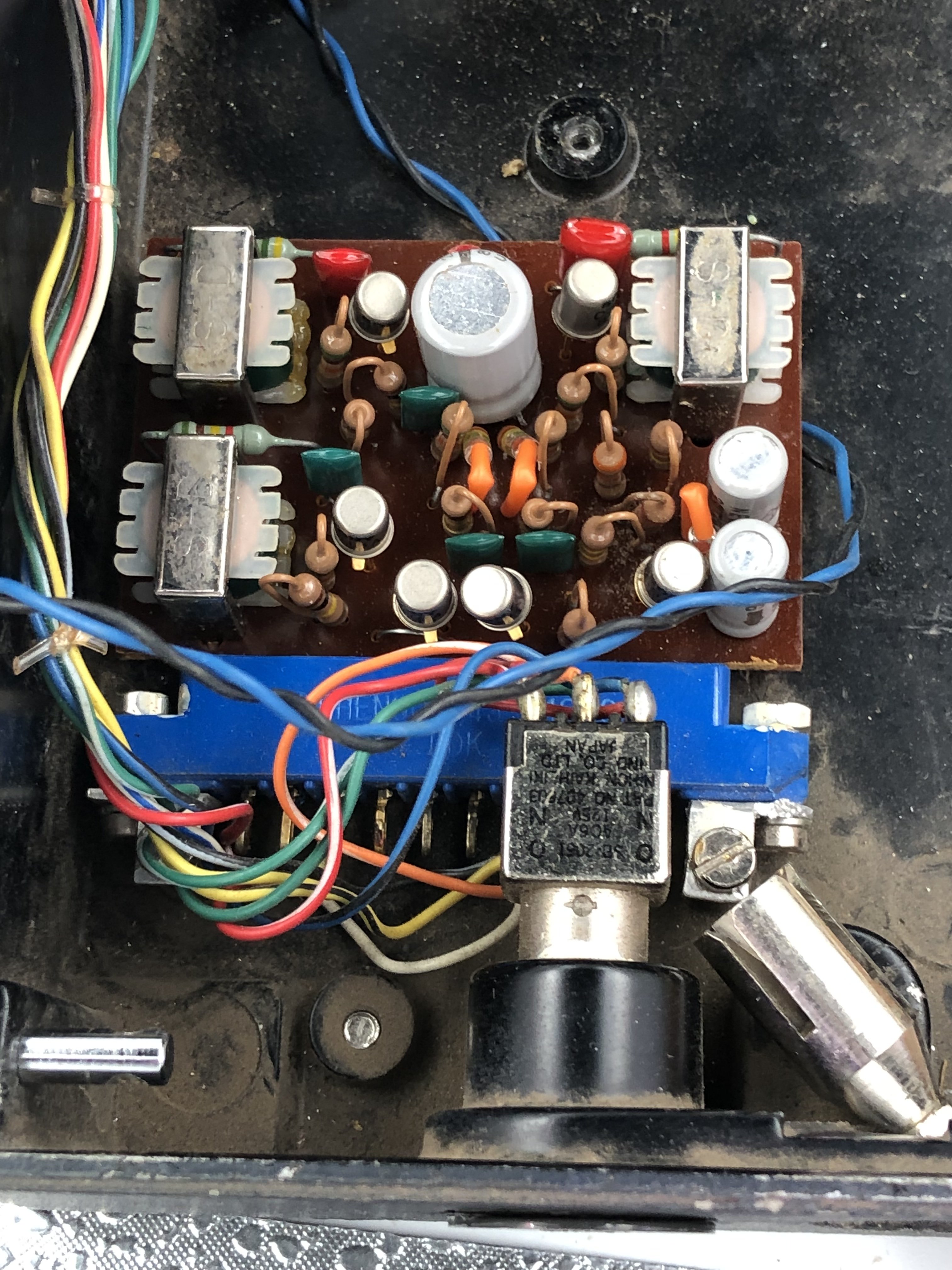

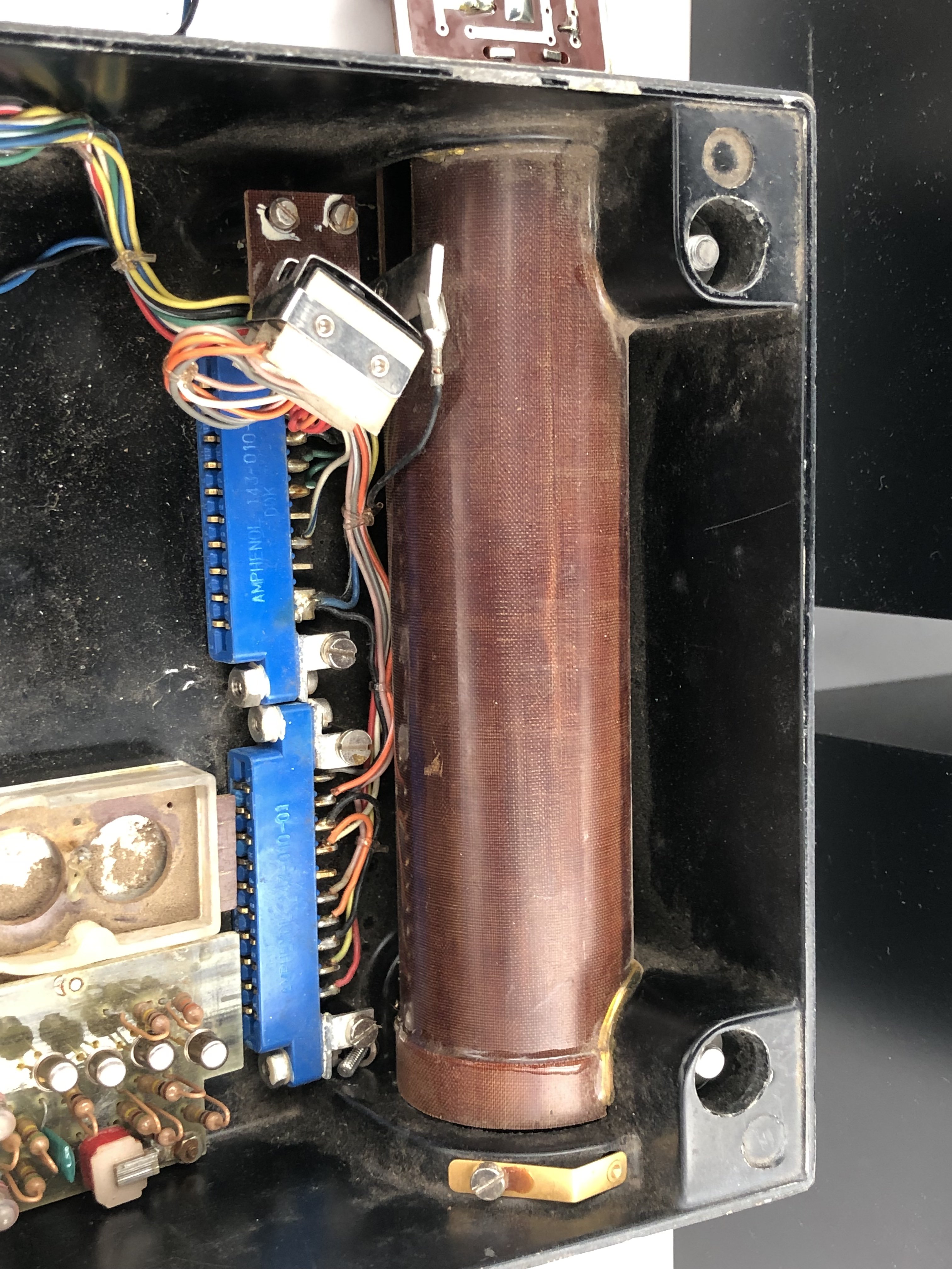

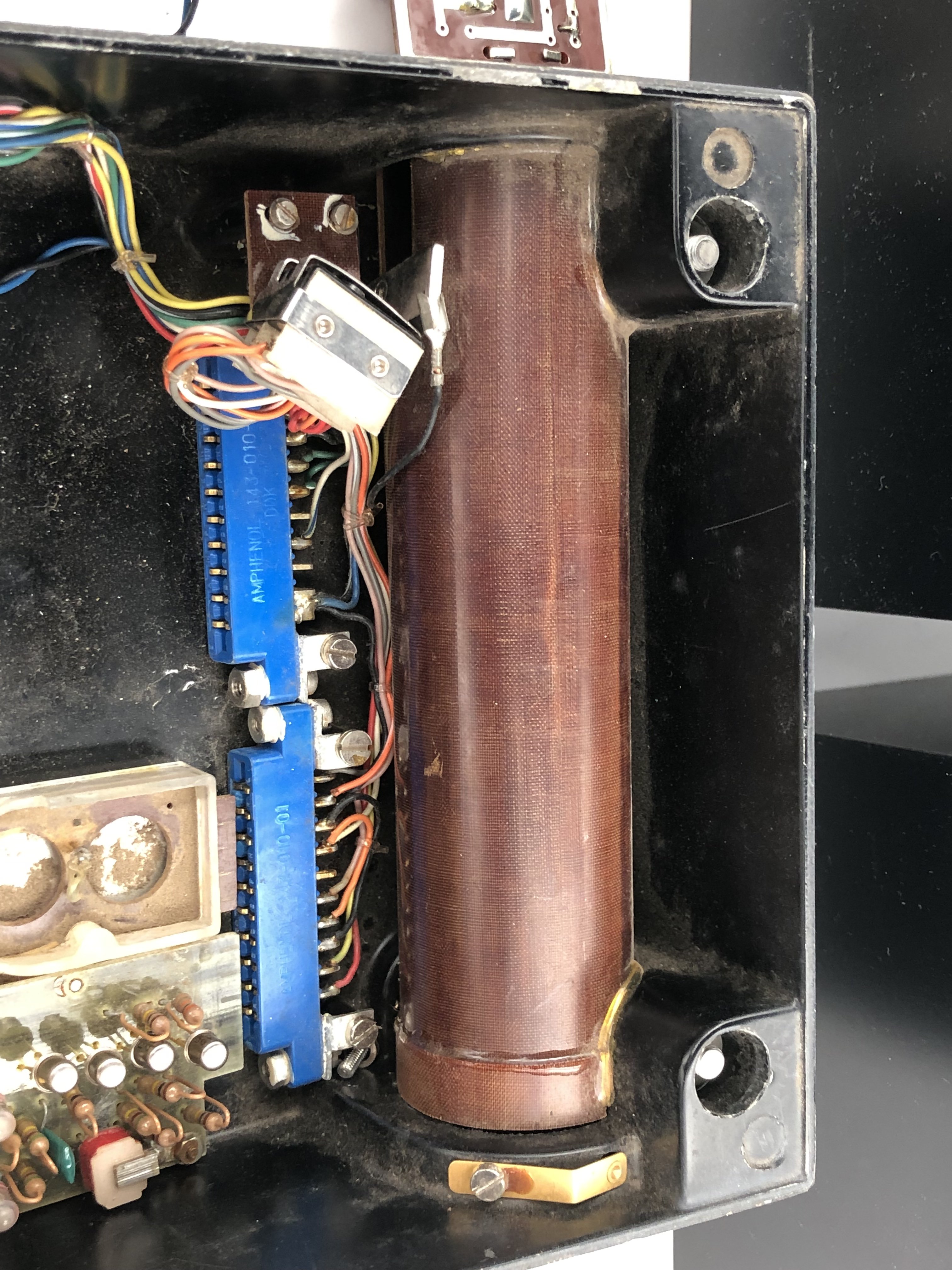

base showing oscillator, frequency divider, battery holder and wiring. Time setting linkage on the bottom
The battery tube has a micro switch attached that connects the backup batteries when the main batteries are removed.
The quartz crystal
