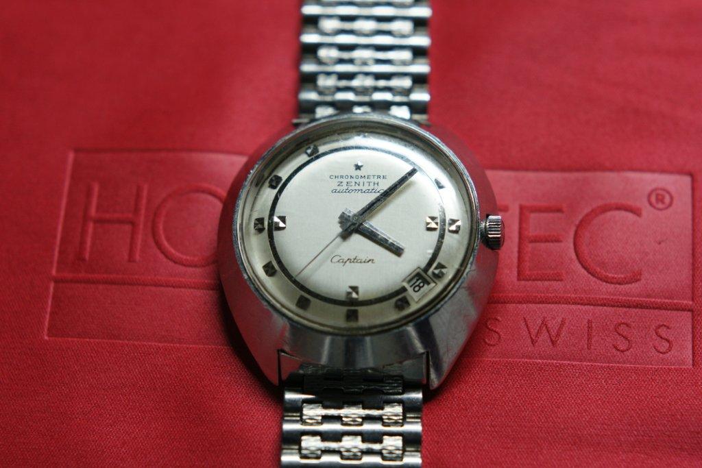

    I know Kommis has one of these because he posted pictures of it in another thread but I recently bought one off eBay. It was described as "not working". What really attracted me to this watch was the fact that it has the NSA bracelet - rare to see one of these.

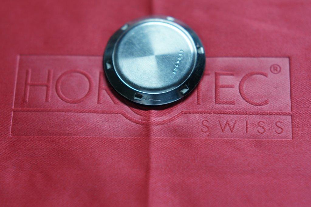

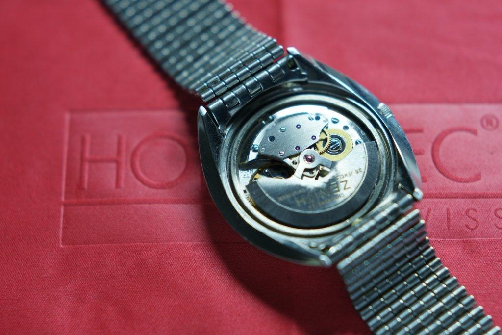

    When it arrived, I gave it a gentle shake and was rewarded by a horrible tinny rattling sound - no wonder it was described as not working. The good surprise was that it started ticking and ran for a good 45 minutes before stopping so there's not too much wrong with it. I guess the seller had tried to take off the back to photograph it and had failed because there are scars in the case back from a Jaxa tool. Fortunately, they gave up before damaging the cut-outs. Having failed with the rubber ball, I took the back off with my Horotec Mini Press. I would implore you all to invest in a decent tool to avoid causing damage to your watches - you'd be surprised how grateful you will be.
    Anyway, here are the pictures:

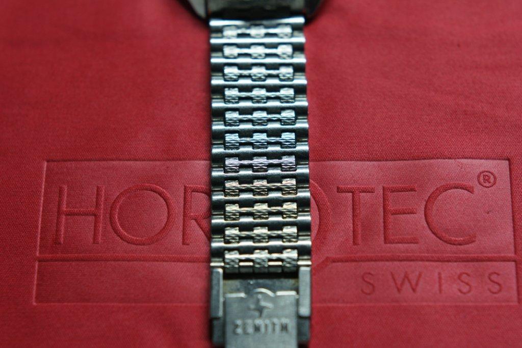

    First the NSA bracelet.
    A good tight clasp and no discernible free play in the links.

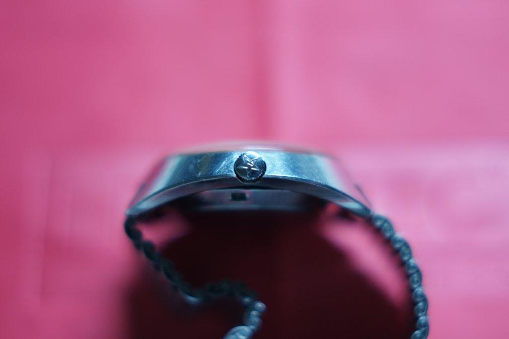

    Original crown

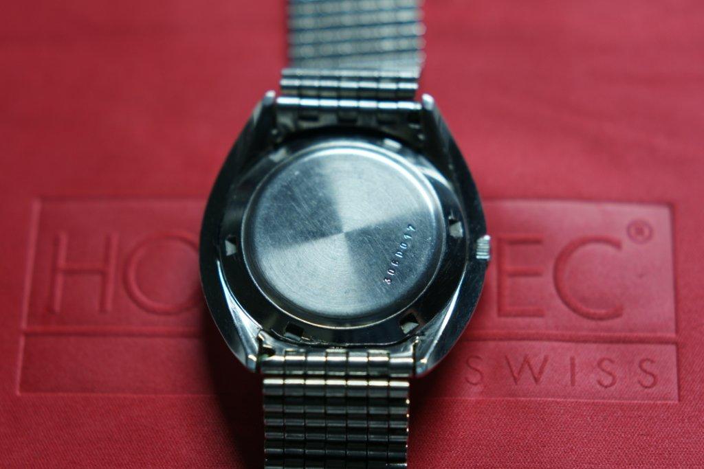

    The case back. Note some of the apparent damage is actually reflection.
    The worst of the three Jaxa scars

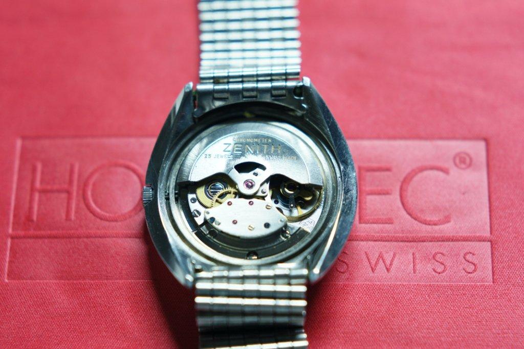

    A bit of a poke around and the cause of the tinny rattle was obvious - a broken staff for the oscillating weight. A quick trawl around the internet and I sourced a new one for €20 rather than the £36 from my usual parts supplier. When it turns up, I'll update this post with a quick fix for a not uncommon problem.

    23,801

  3. Stewart H Honorary NJ Resident Jan 5, 2013

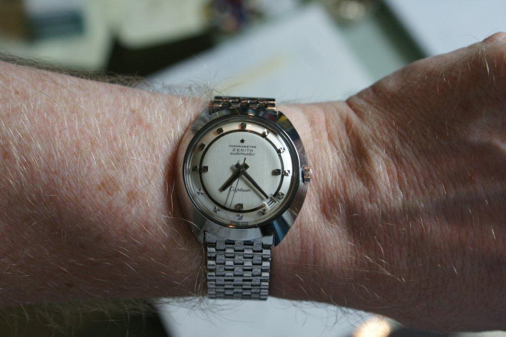

  18. Stewart H Honorary NJ Resident Feb 11, 2013
    3,070
    3,510
    ..... and here it is, collected at lunchtime. They have done a fantastic job on the case - the Jaxa scars are completely gone, as are the minor ones on the side of the case.
