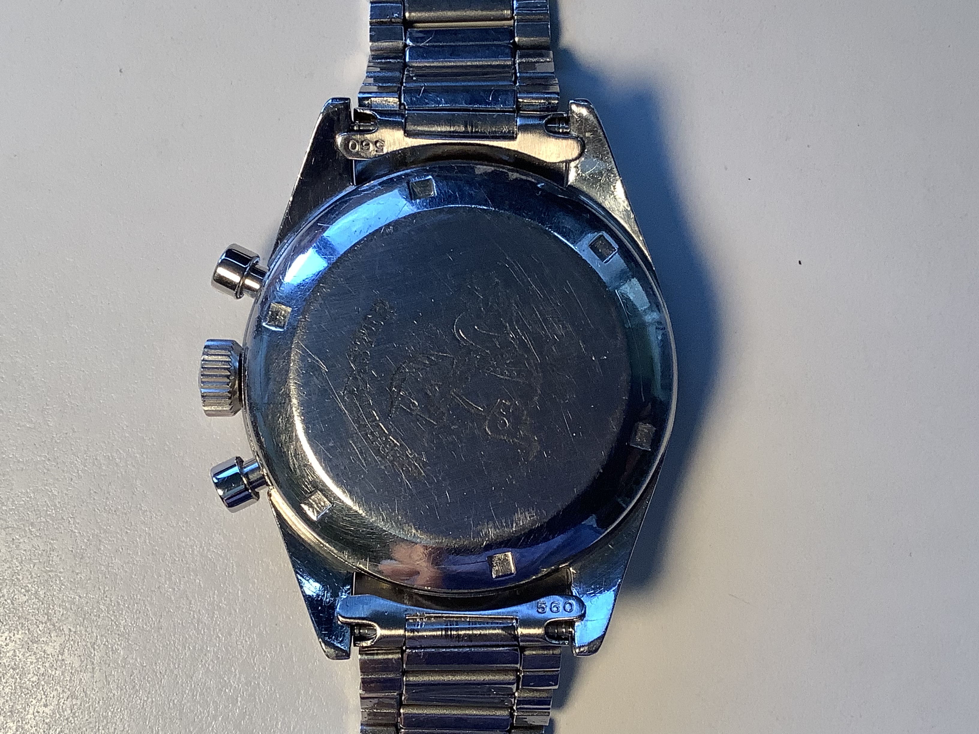

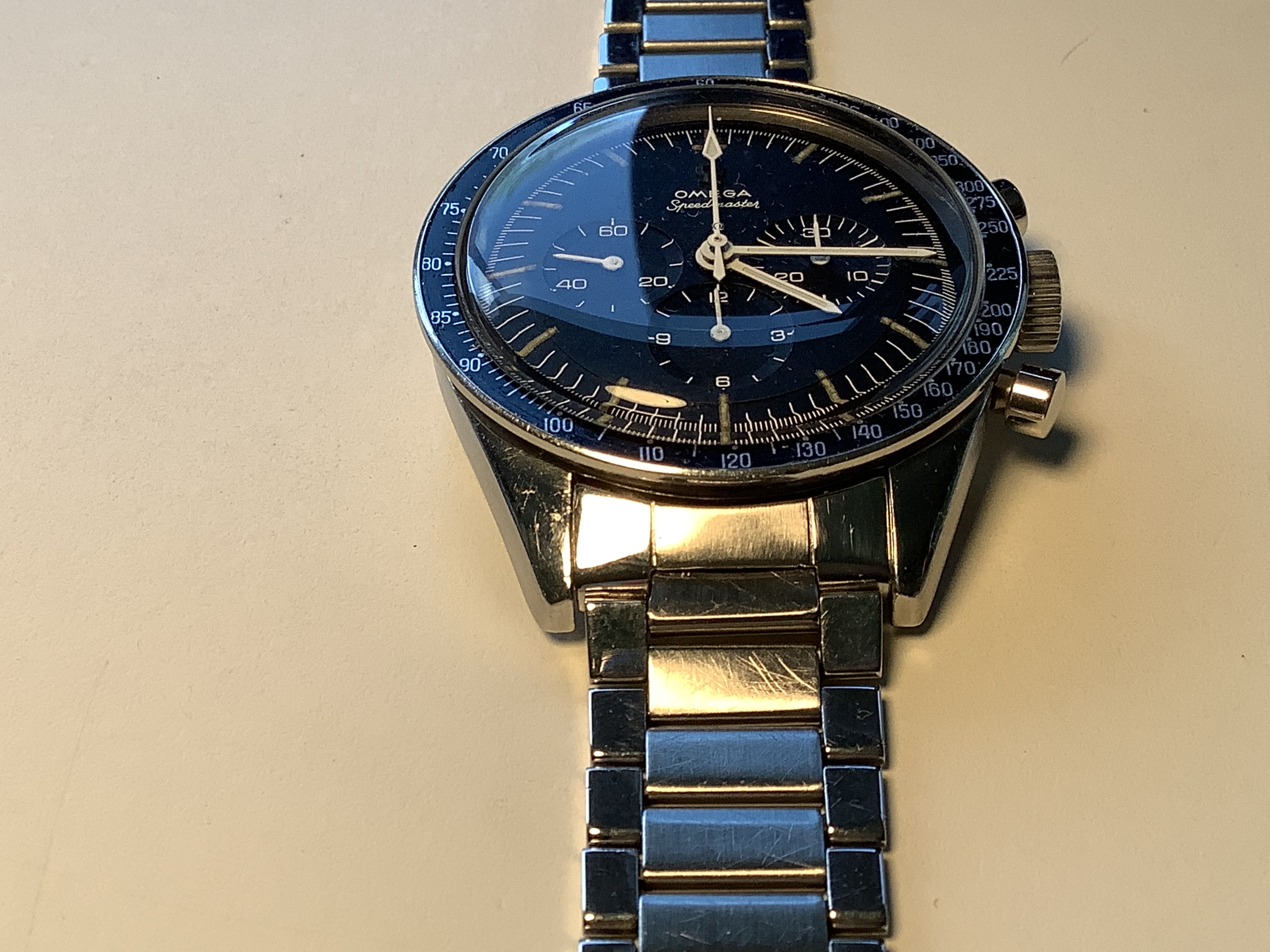

Whilst galavanting through my bracelets parts bin, I came across this interesting combo: a 19mm flat-link, with 560 end-pieces. Normally, they work together like Democrats and Republicans.
Now, I didn’t do this, but someone had their creative hat on, and filed down the first link beyond the end-piece a bit, because it’s too wide to fit into the 560 slot. Or put another way, the 560 slot is smaller than the usual no. 6/506.

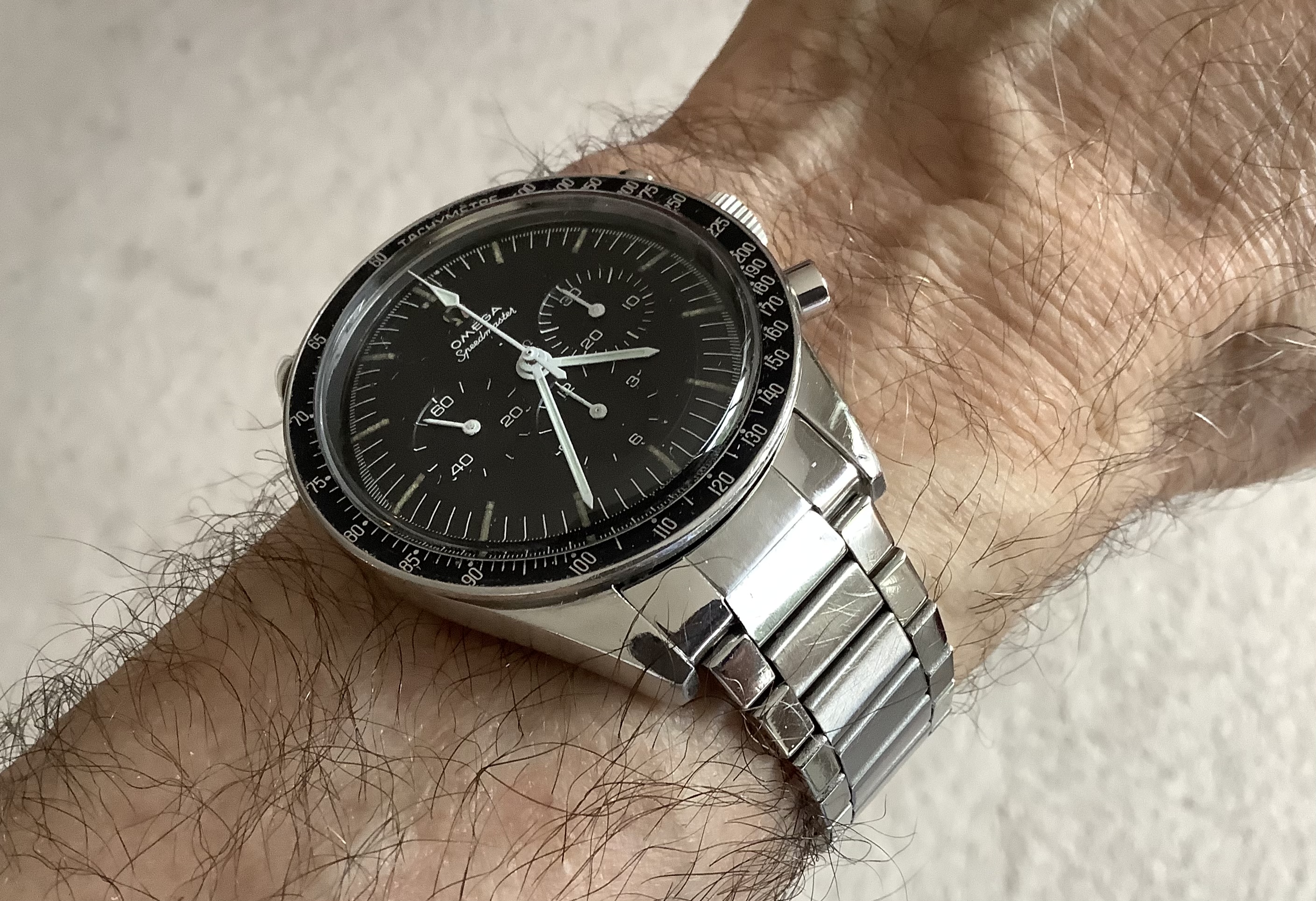

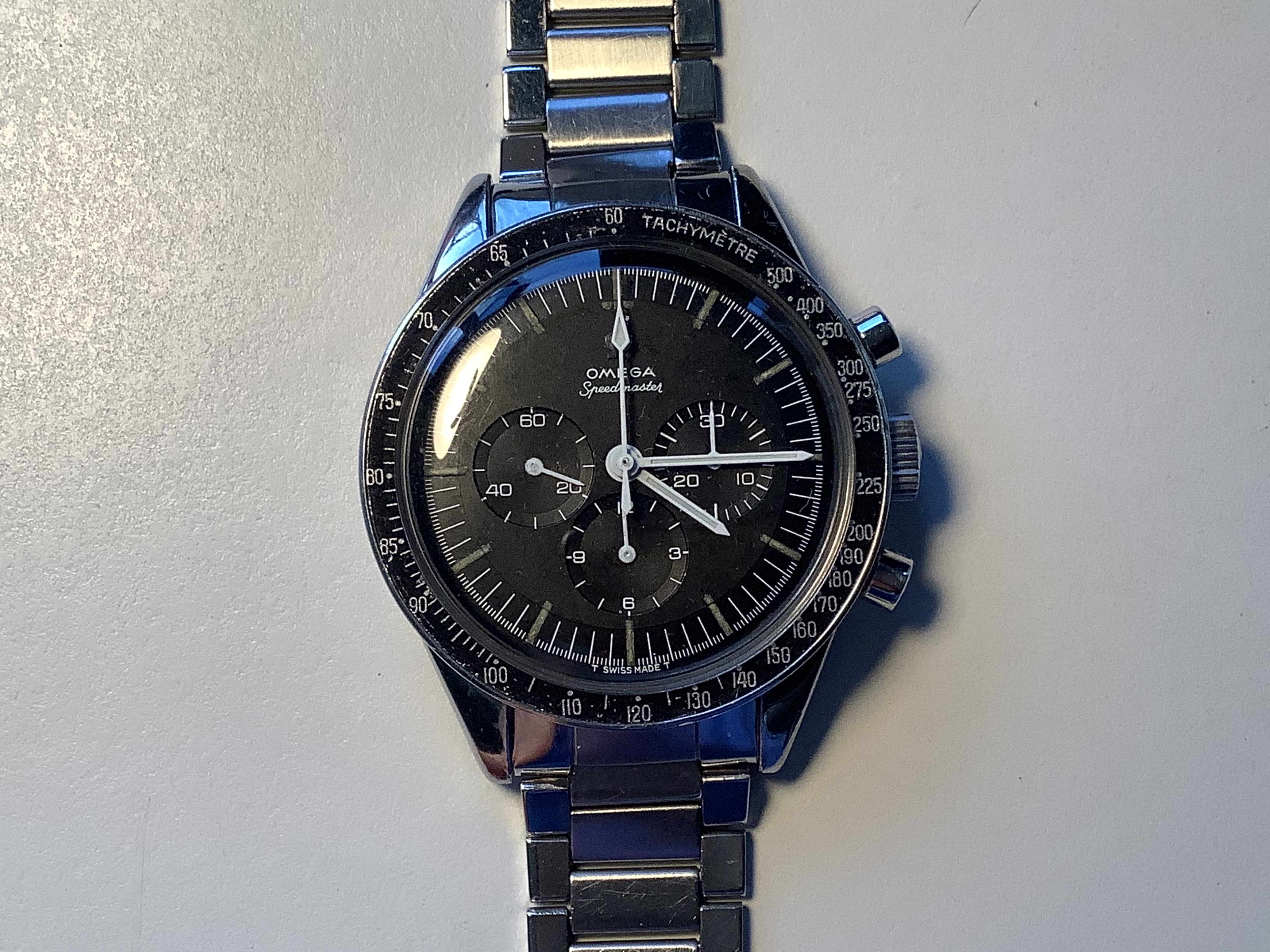

So here is the result:
Clearly, it’s not perfect, but definitely adequate for a daily wearer, and a decent option if you’re on a tighter budget, and enjoy a little DIY watch modification. Thanks for looking.
