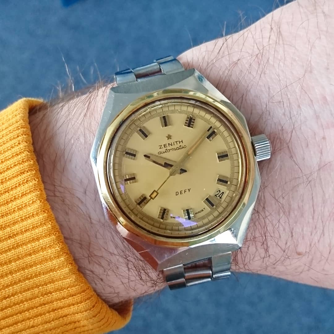

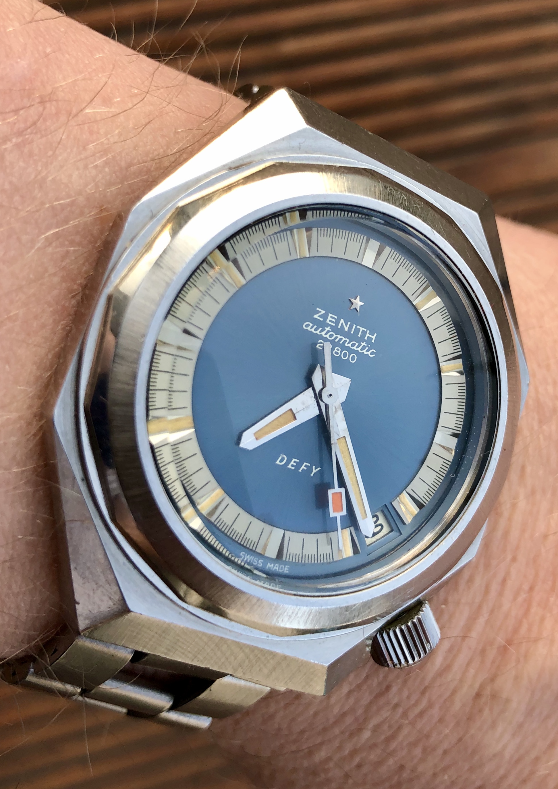

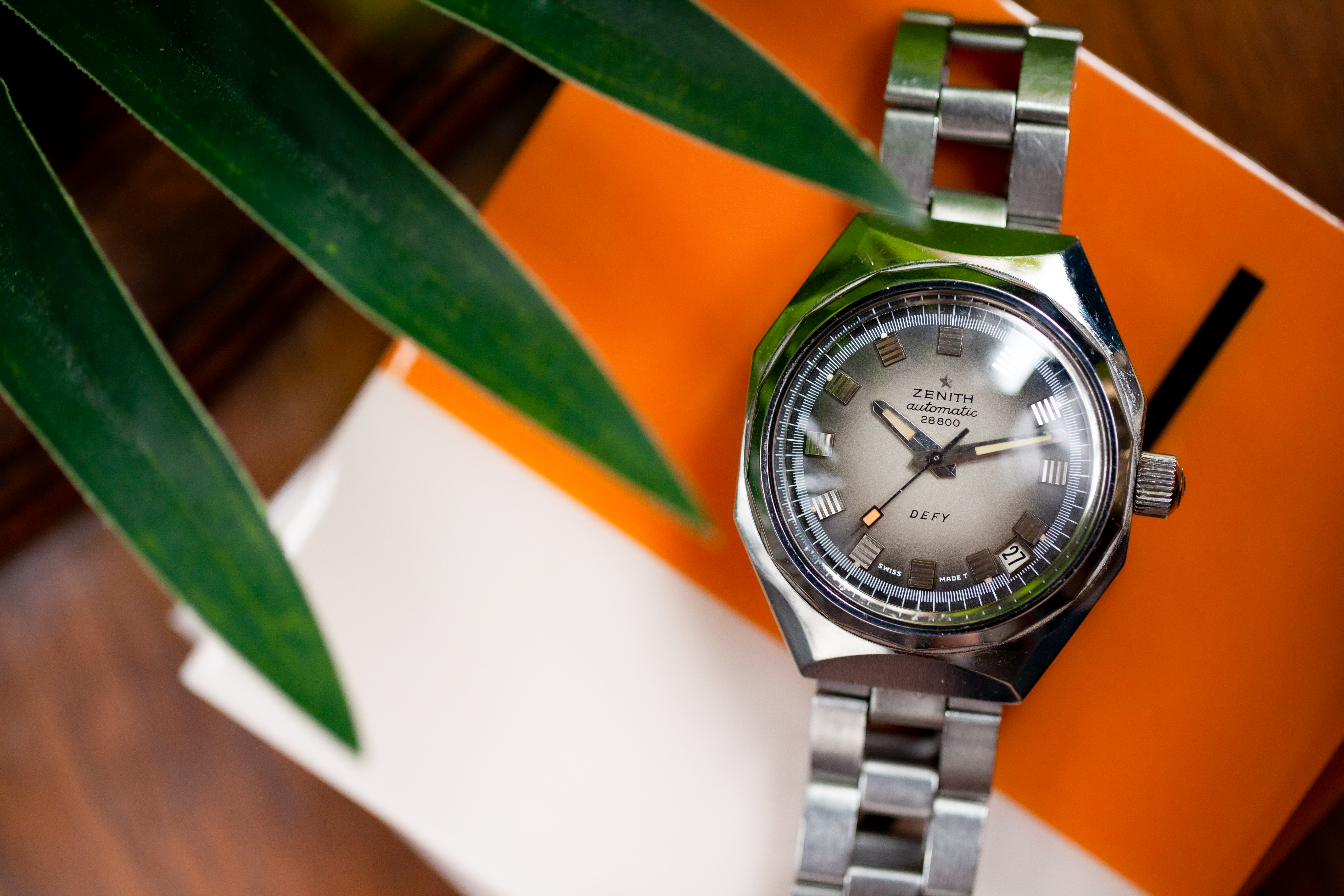

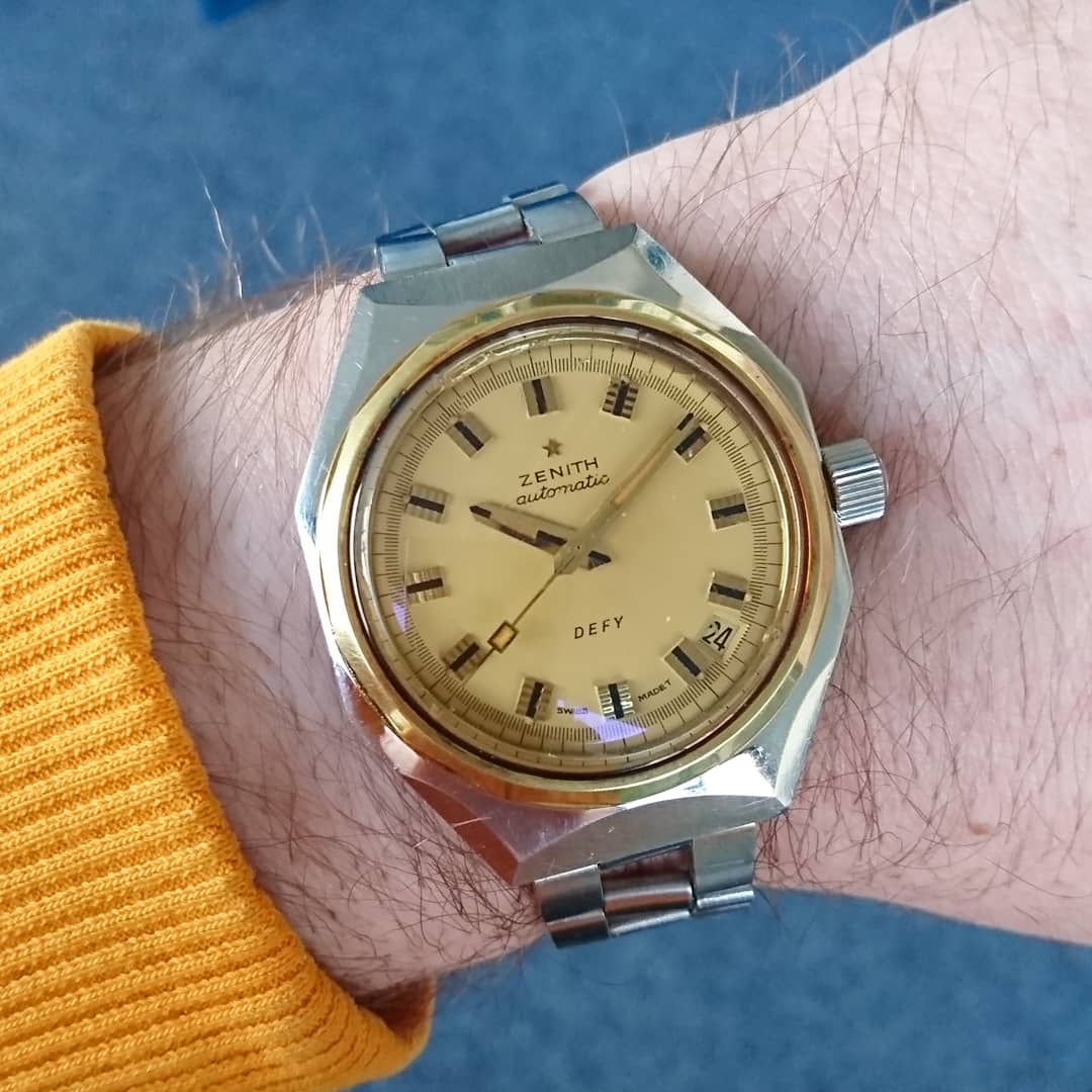

Here is another "new" vintage Defy model: so called bi-colour Defy. Reference is still unknown, but it is exactly the same as rare A3673 but this has gilted bezel and yellow mineral glass. Glass makes dial, markers and hands look like gold coloured but dial is actually cream white and markers and hands are steel.

Here is another "new" vintage Defy model: so called bi-colour Defy. Reference is still unknown, but it is exactly the same as rare A3673 but this has gilted bezel and yellow mineral glass. Glass makes dial, markers and hands look like gold colored but dial is actually cream white and markers and hands are steel.
Great piece! Didn't know that bi-colour were available. Thanks for sharing.

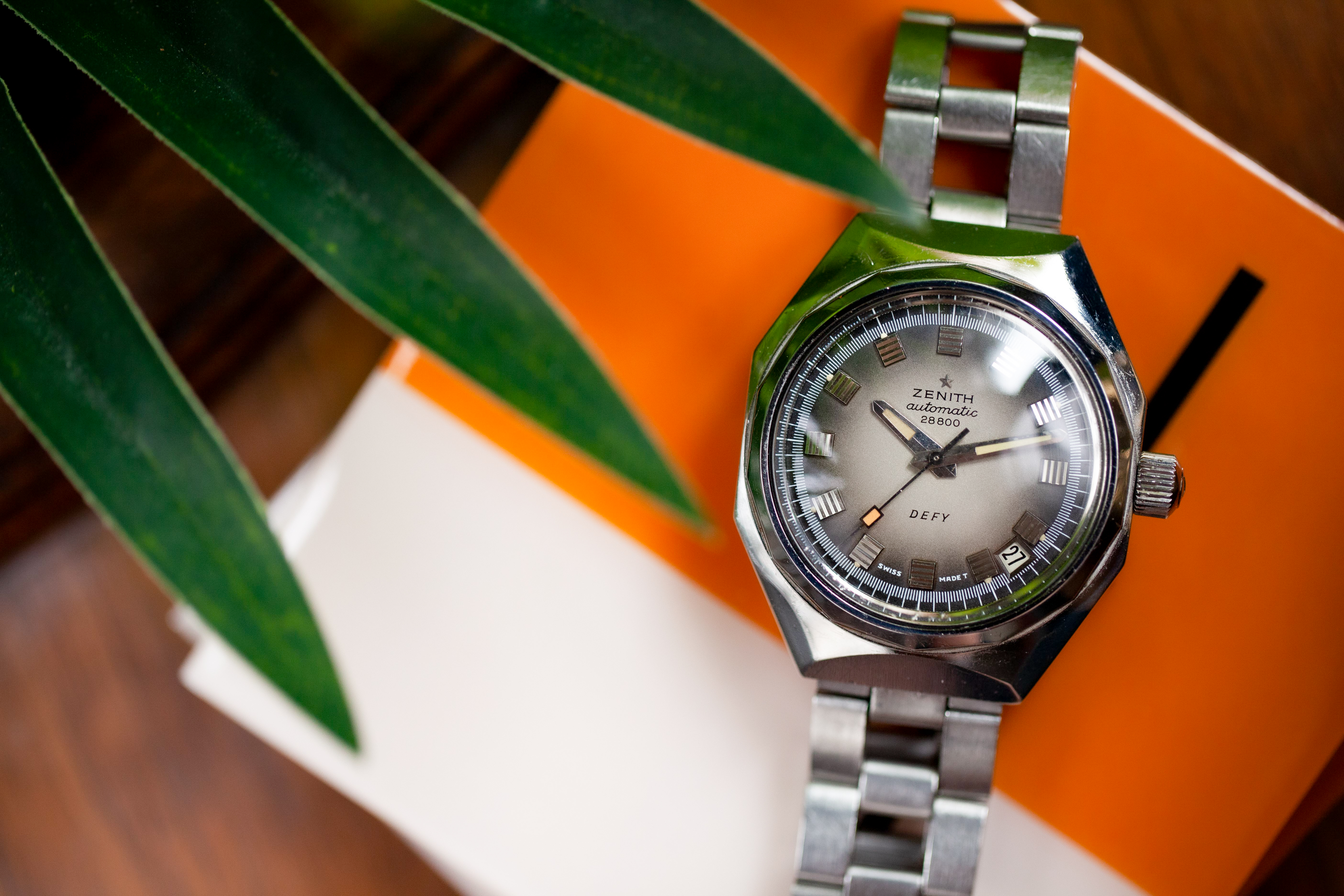

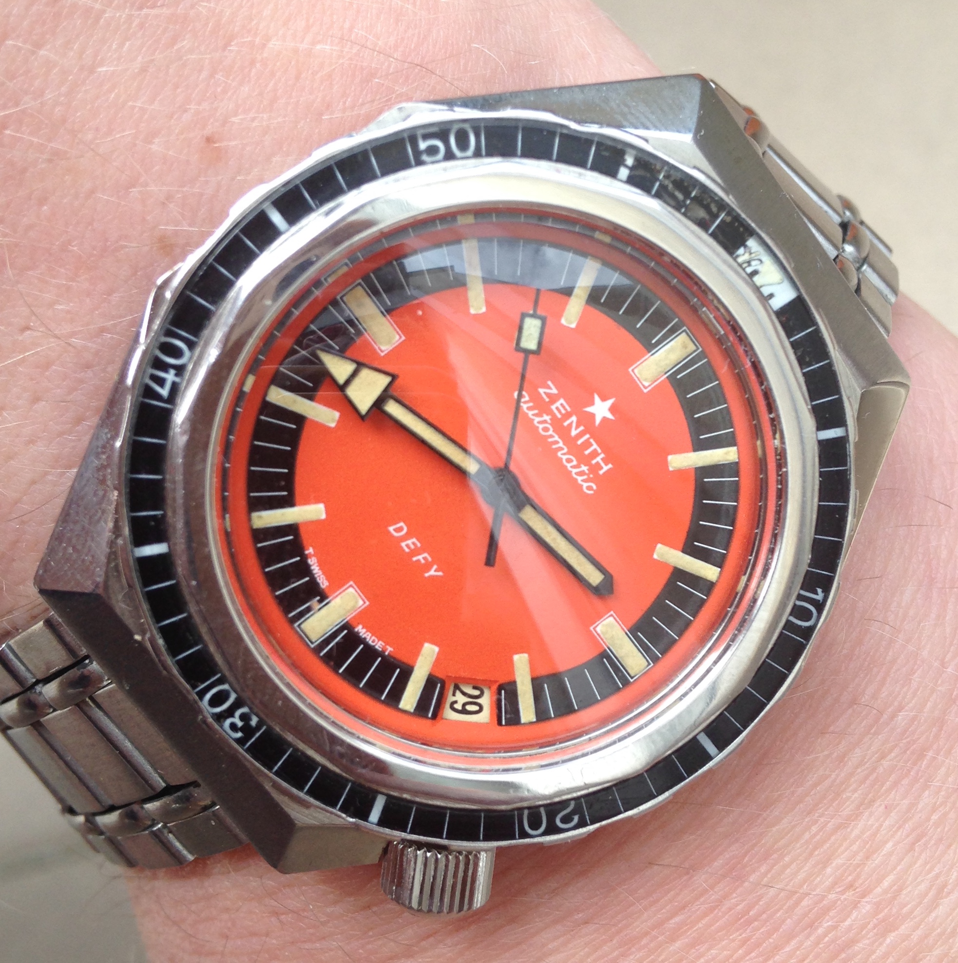

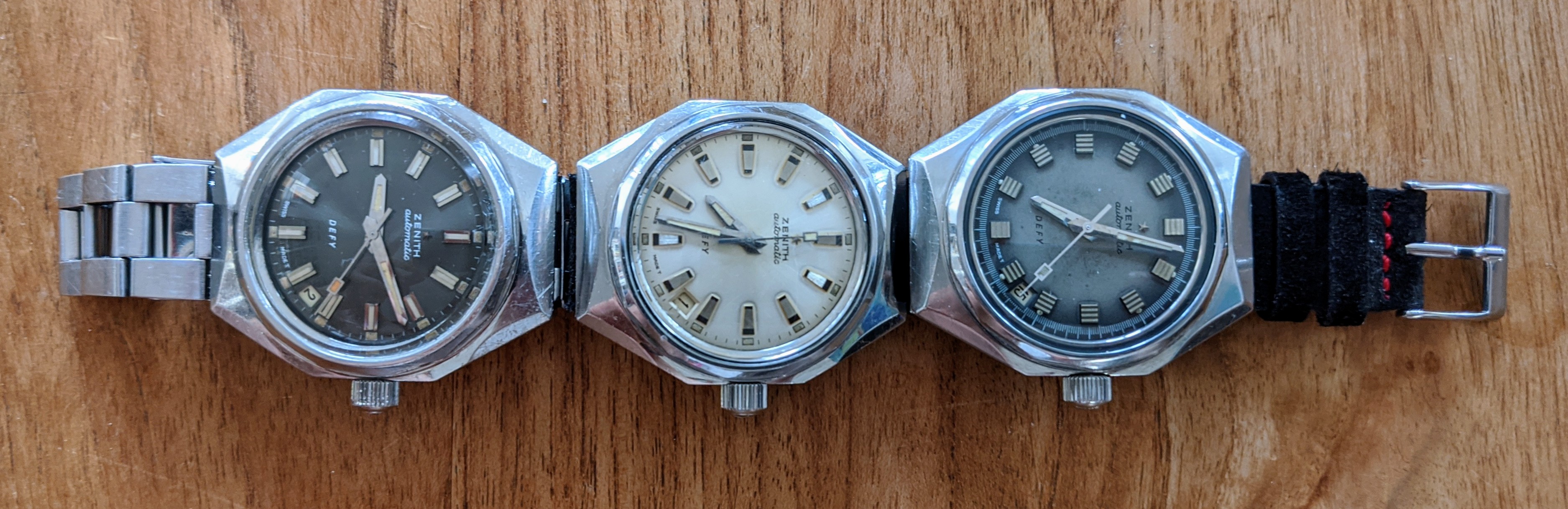

Just "flashing" my octogonals. Sorry for the respirator thread"pollution" 馃槈
What amazing boxes! Watches aren鈥檛 bad either.

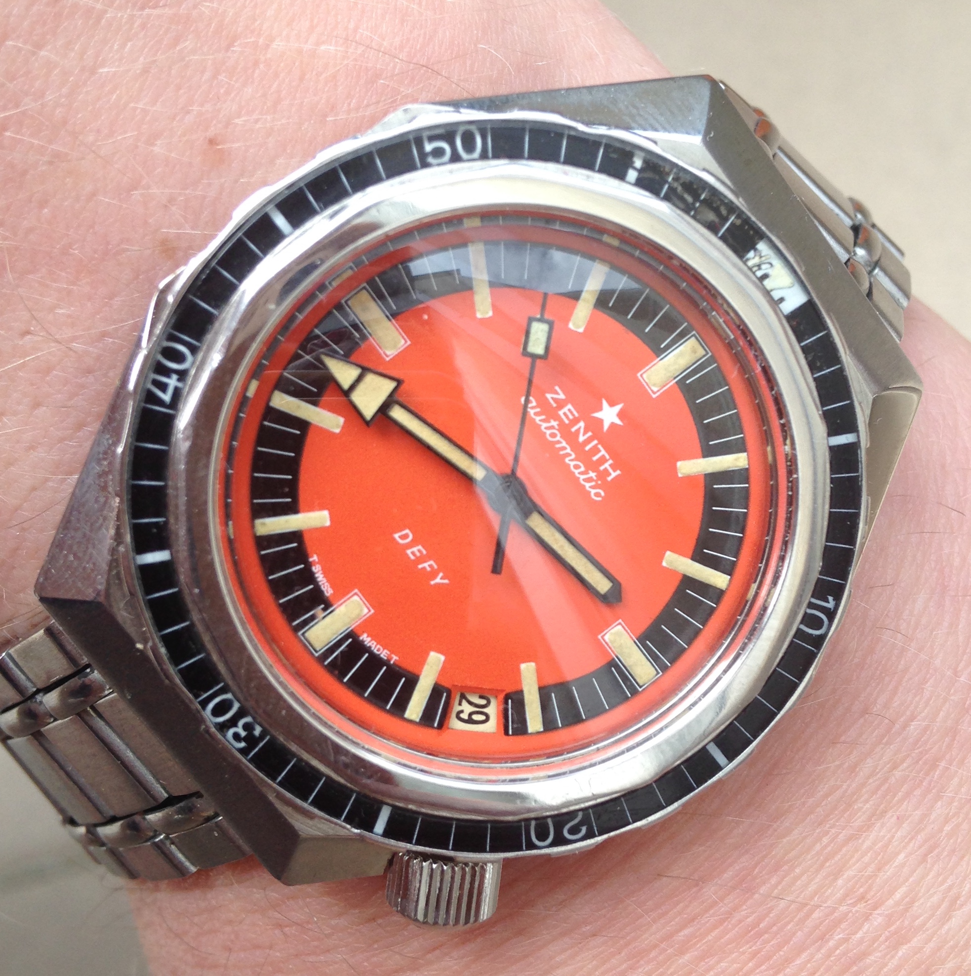

I have only two...
Great pieces! Especially that orange Plongeur is awesome and in great shape.

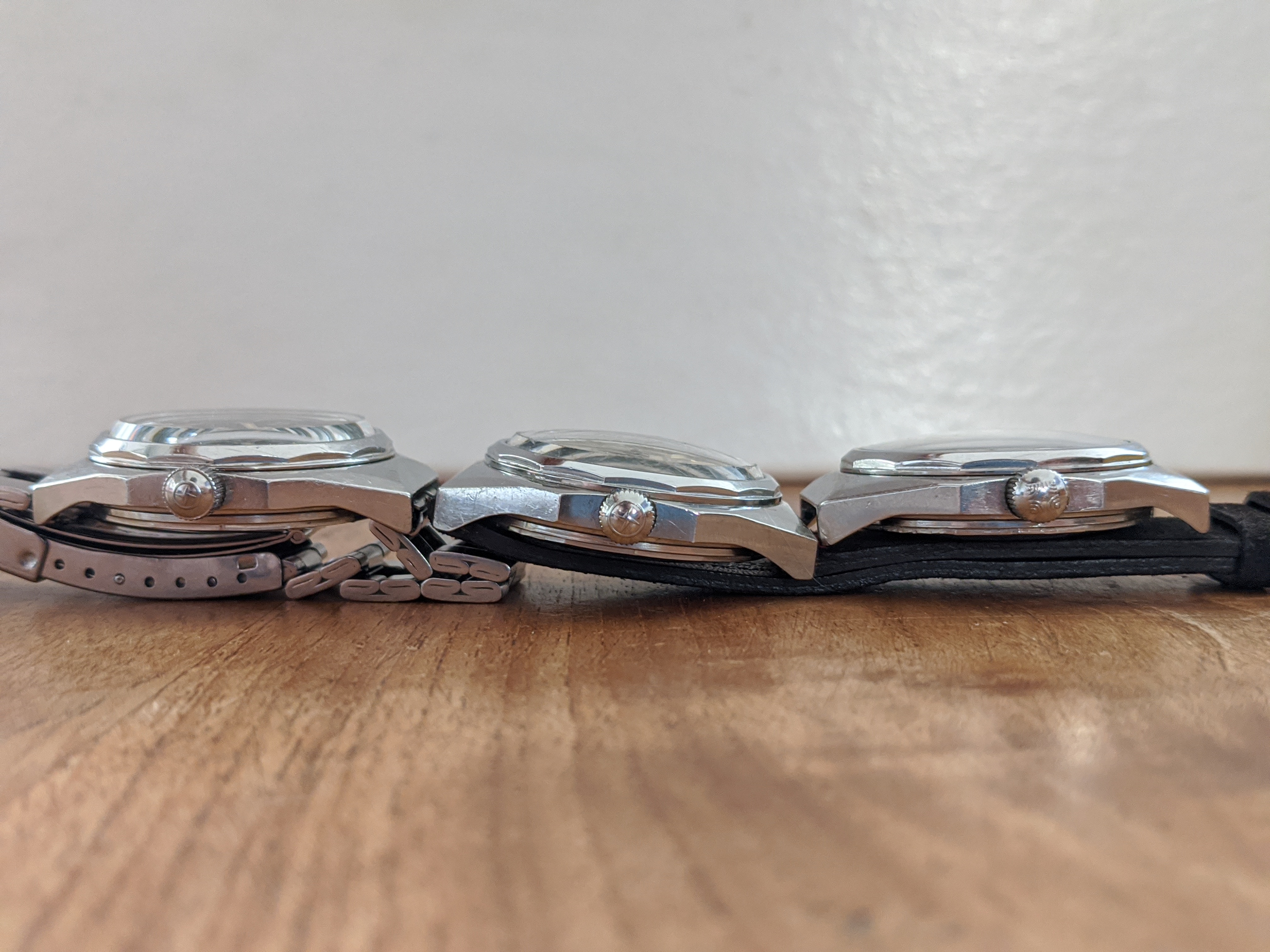

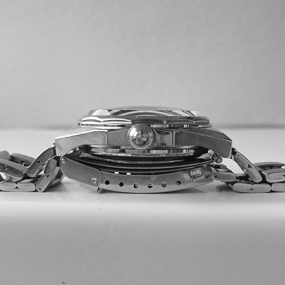

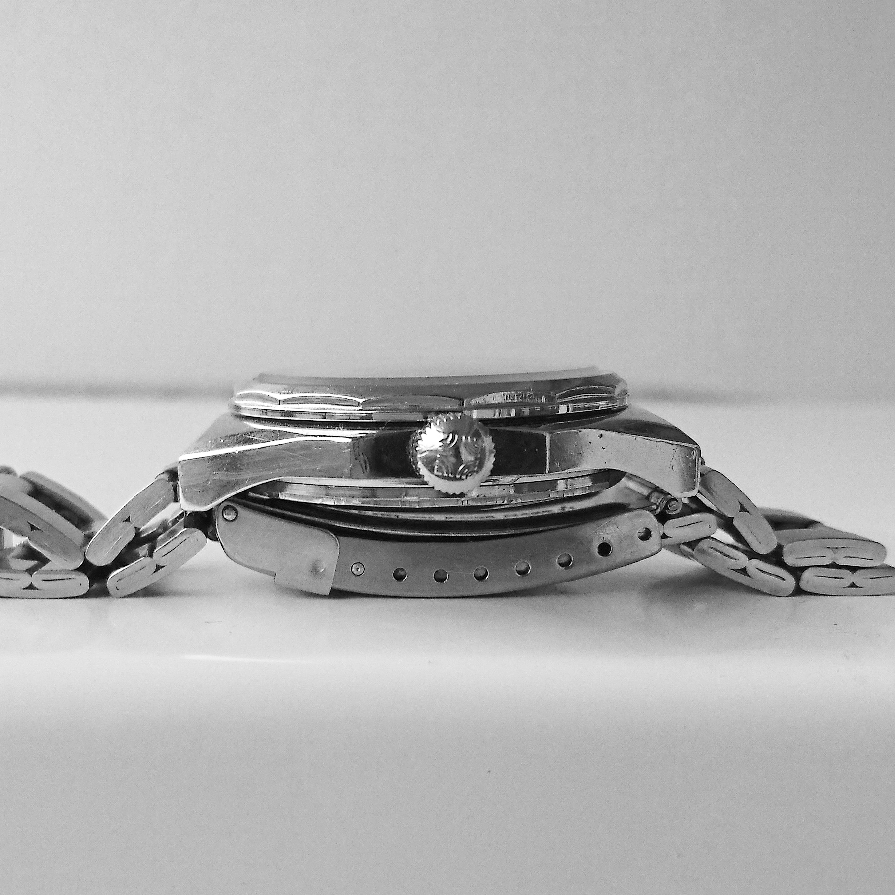

To the defy crowd here: a question:

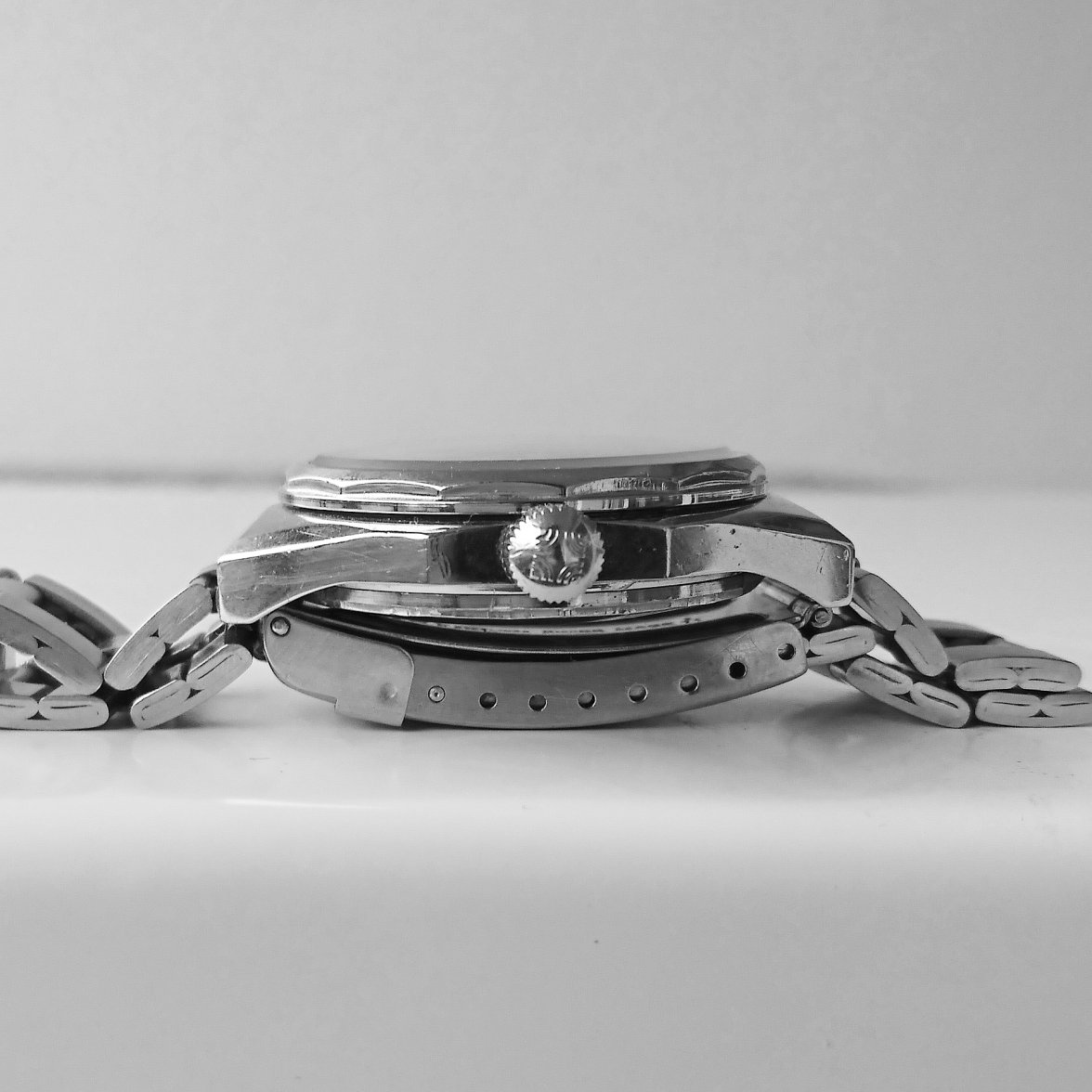

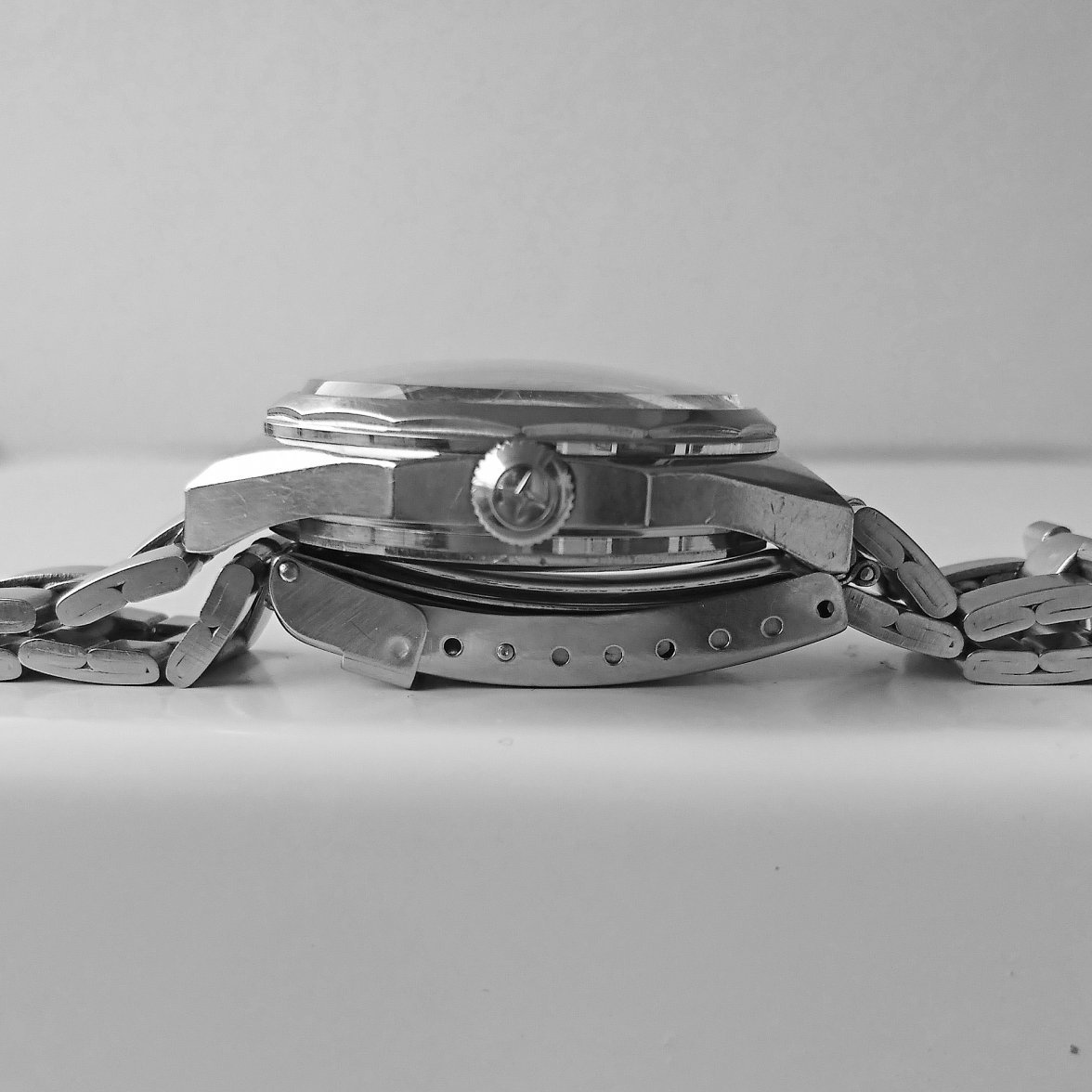

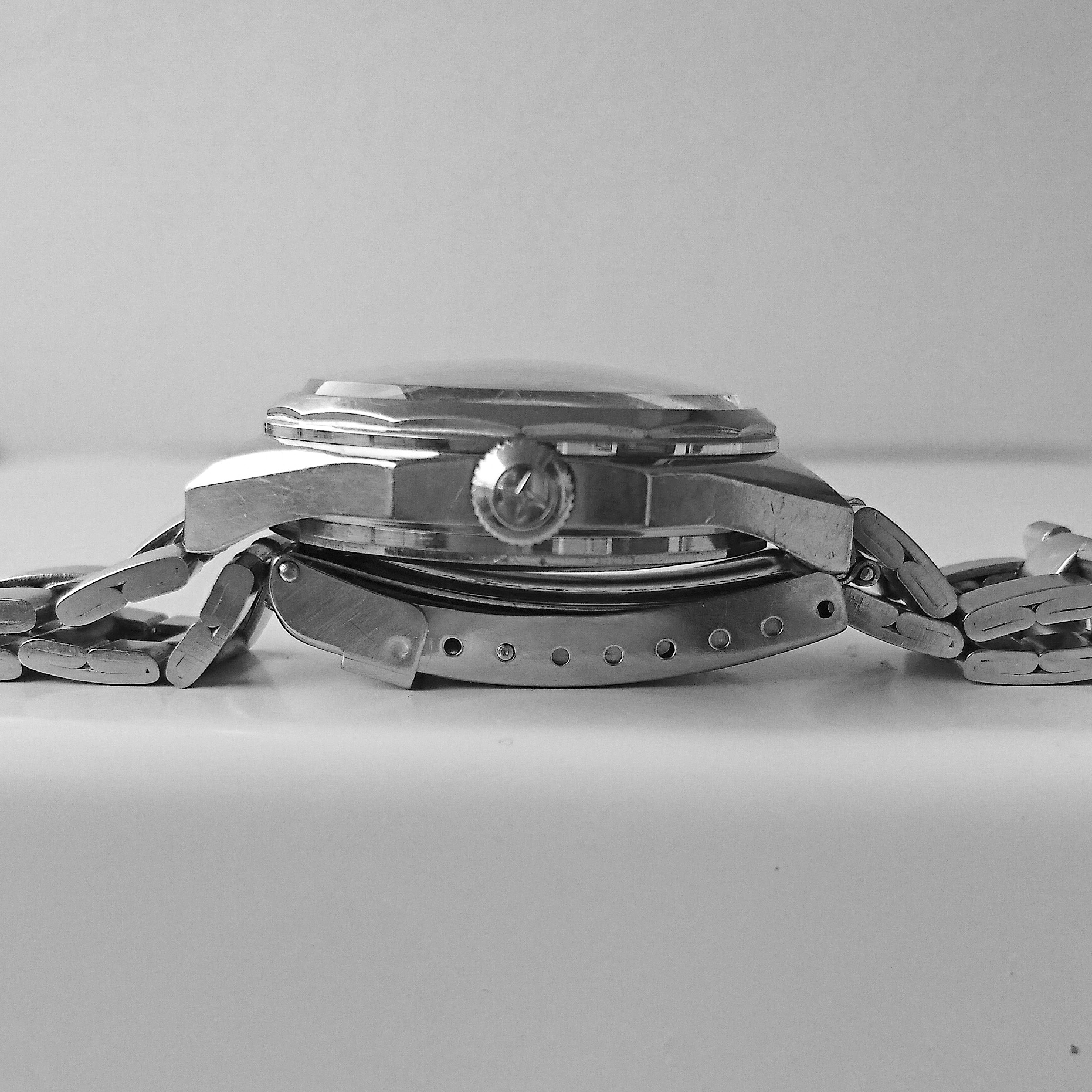

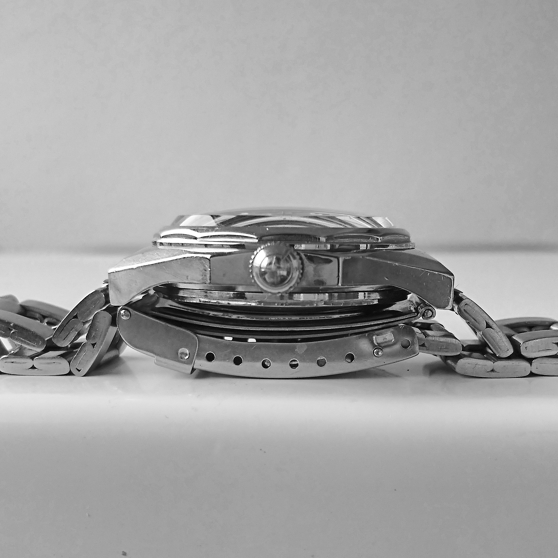

Could someone post pics from A3643 and 3644 from the side to be able to see the crystals?
There is this step from the mineral crystal, but are the originals domed or not? I have both versions.
Already curious 馃嵖
There are two crystals that are made for octagonal Zenith Defy. Orginal chrystal is very thick. At some point crystal changed (different manufacturer?) to a much thinner version. This thinner version is almost at the same level as bezel but thicker version is about 2 mm higher than bezel. I guess octagonal Defy models were orginally sold with this thicker crystal so thinner one is a replacement crystal.

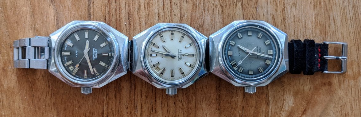

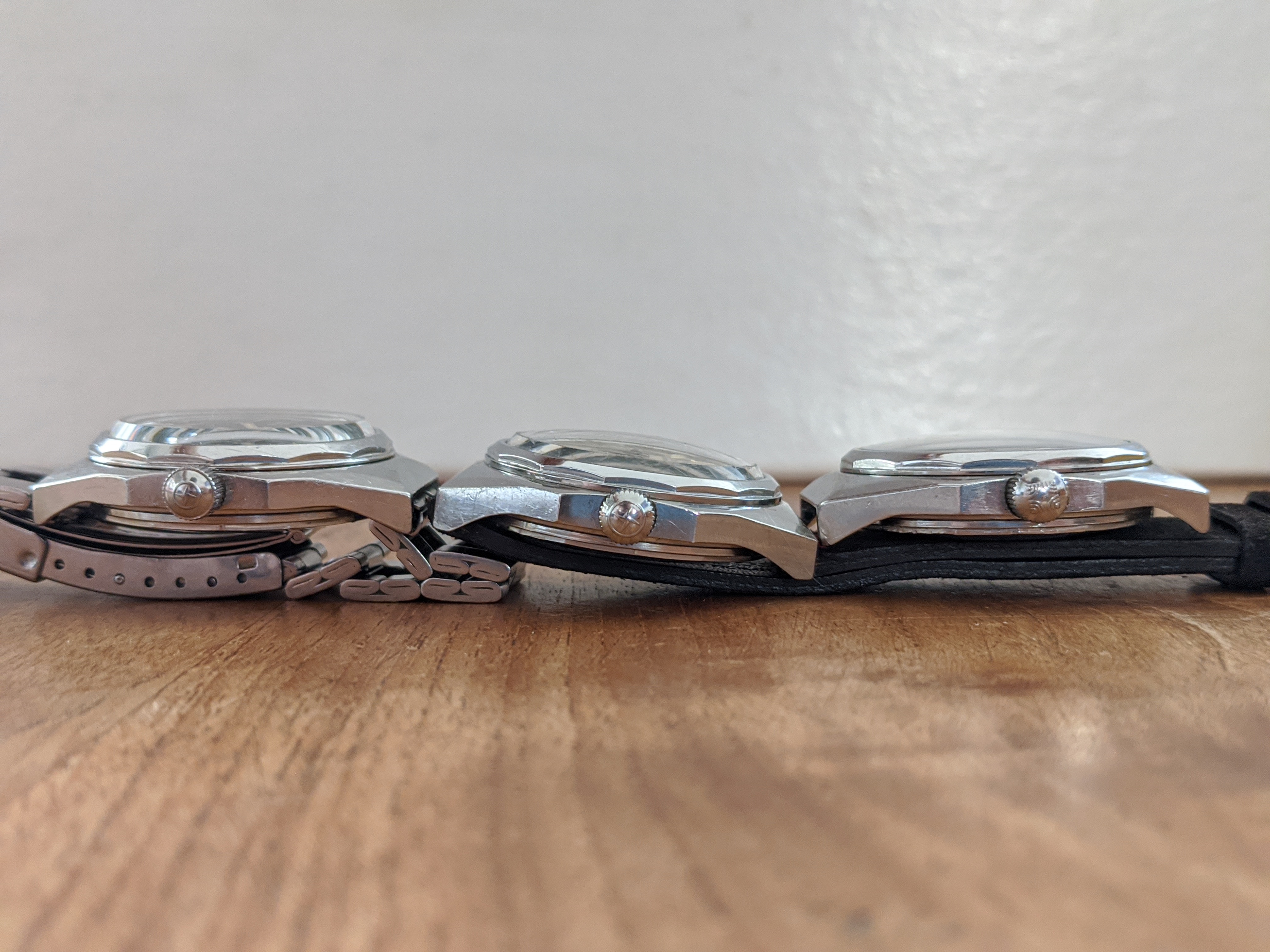

The pictures are the reason for my question: the right is aftermarket (missing 2mm) but left and middle have the mineral crystal while one is domed and one flat. Any ideas/infos?
Yes, that is intresting. I looked my watches and they had three kind of crystal:
1. Very thick (2 mm higher than bezel) domed crystal
2. Thick (1 mm higher than bezel) domed crystal
3. Thin (about the same level as bezel) crystal that is domed/sligthly domed. (=newer replacement crystal). I didn't have any thick and flat one.
I've read (one Finnish site that has lots of information about vintage watches, like Defy models) that octagonal Defy was orginally sold with thick domed crystal. Domed crystal made Defy unique while other brands had flat crystals at that time. So if that really is flat (a hard to see from the pics) it is a mystery one.

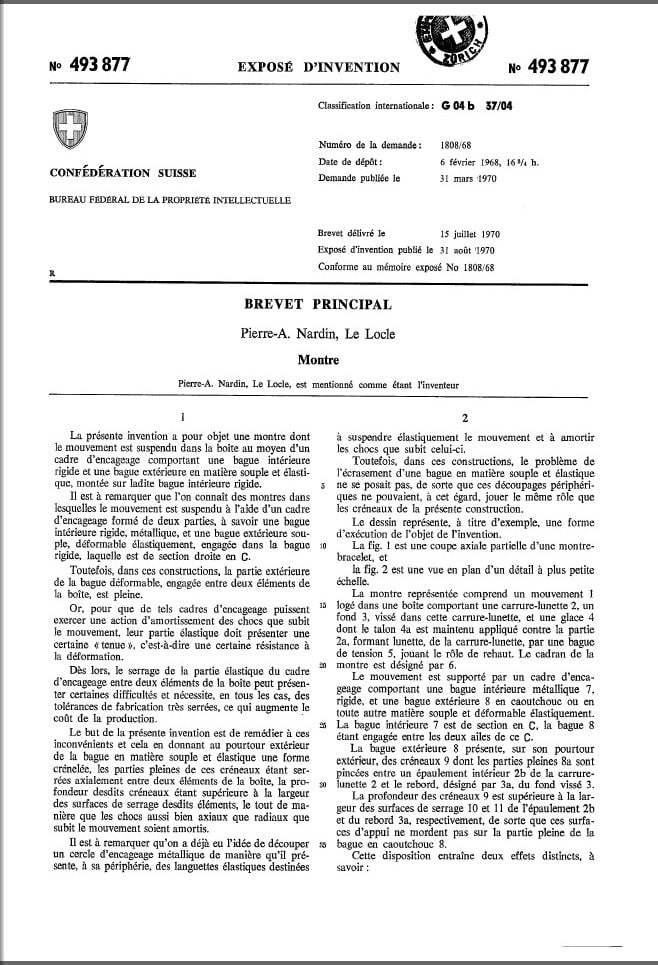

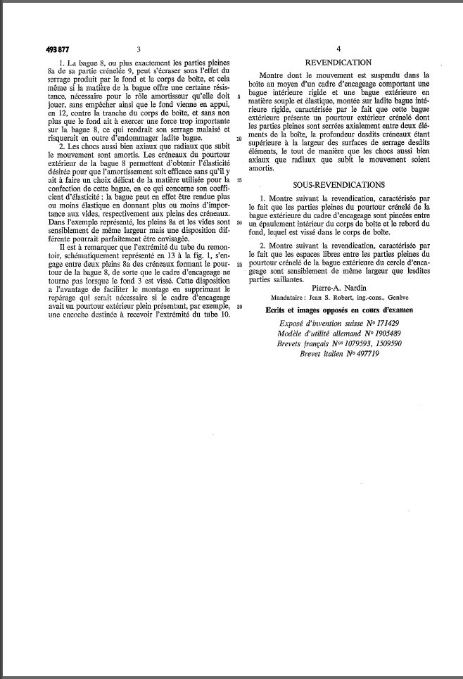

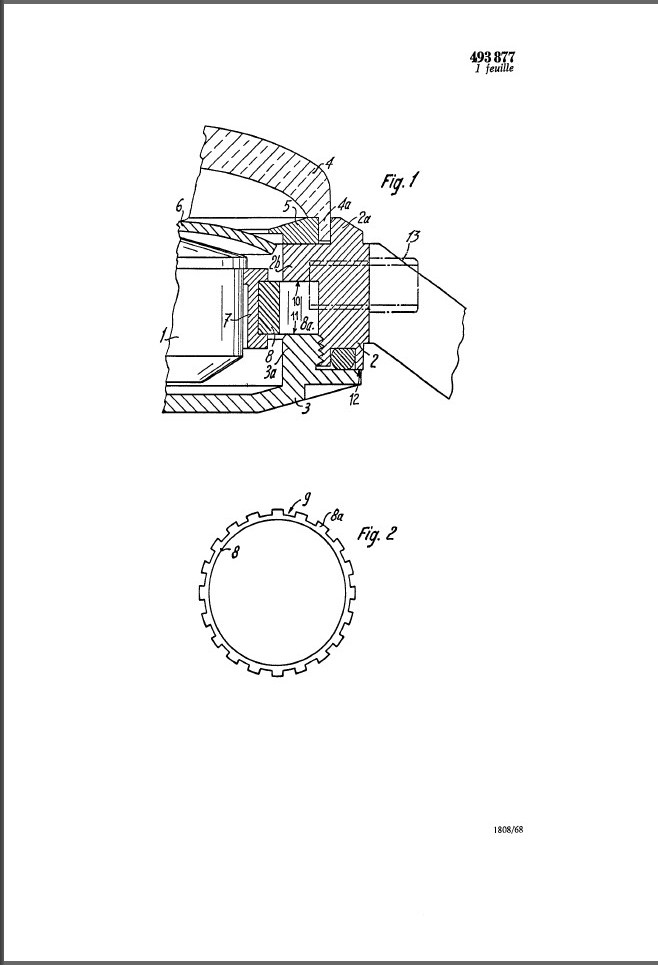

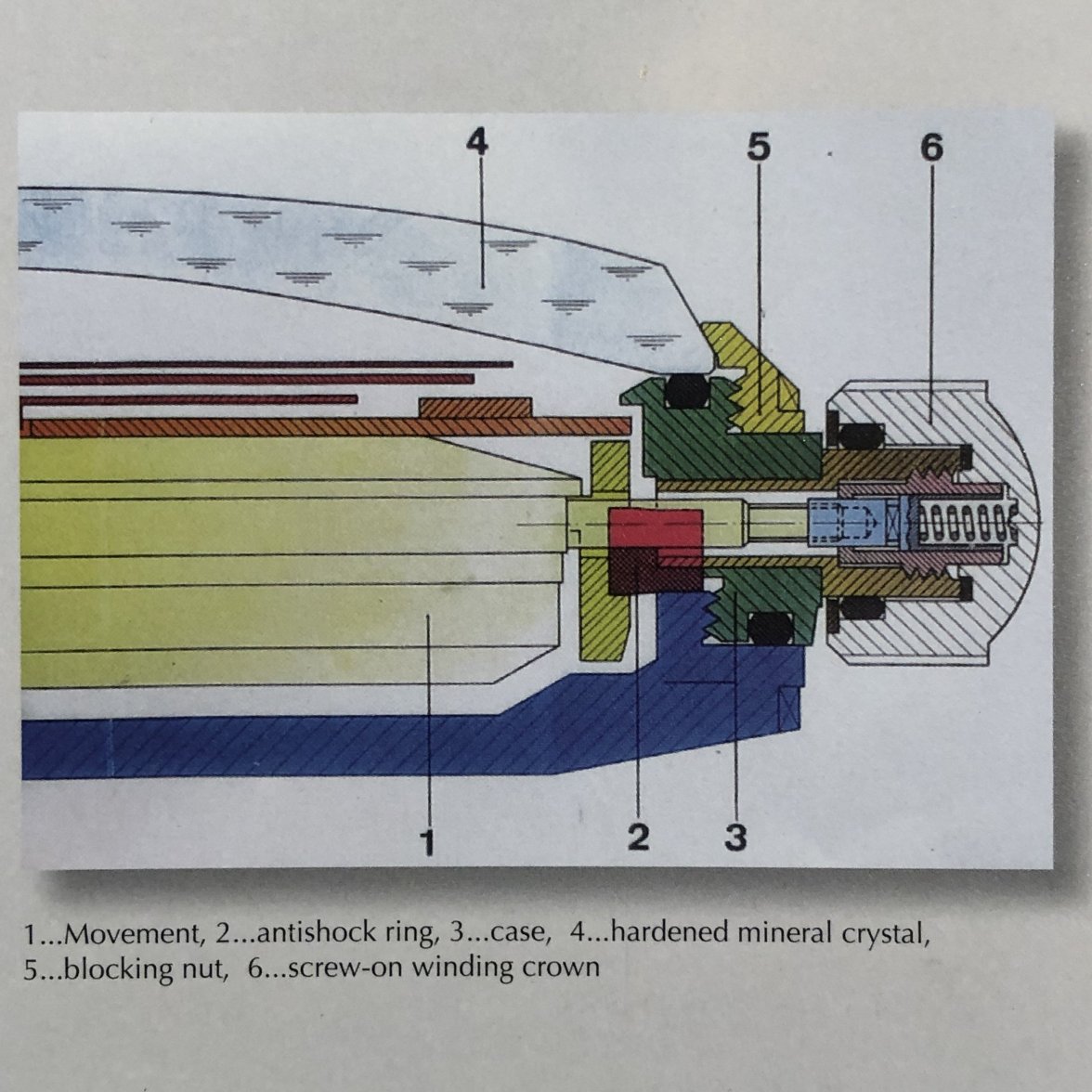

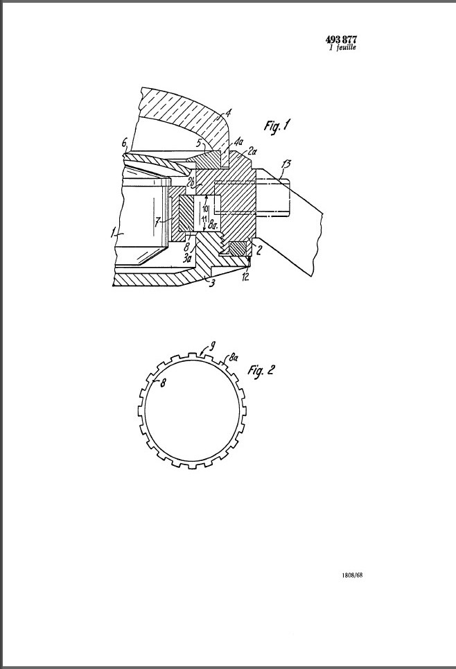

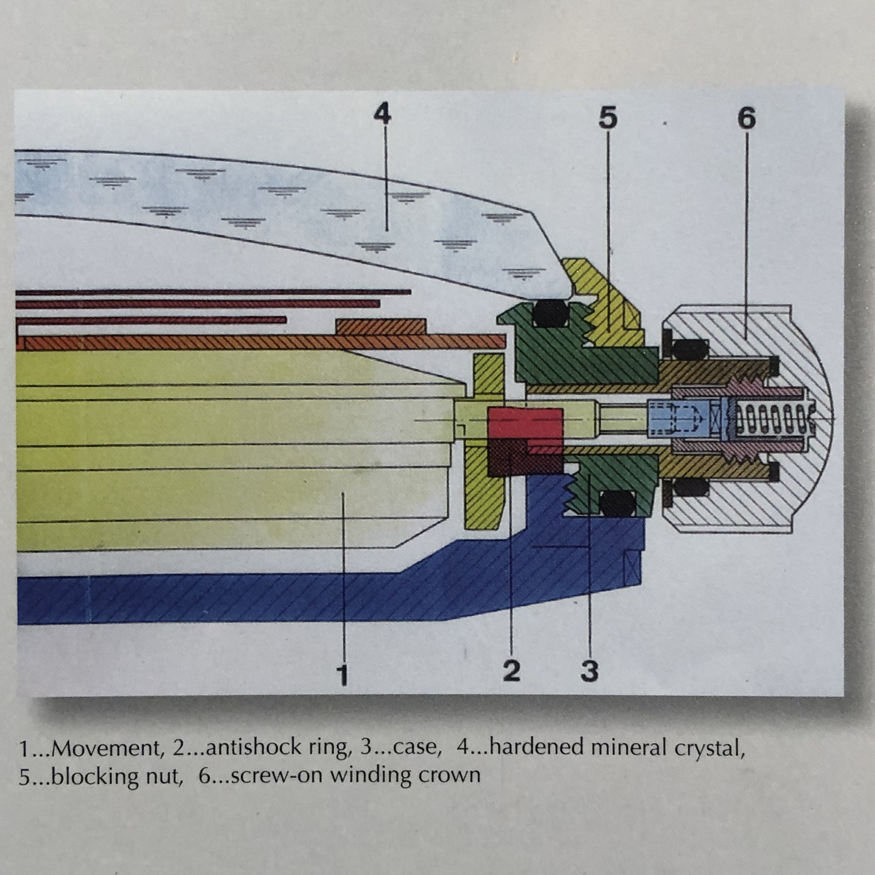

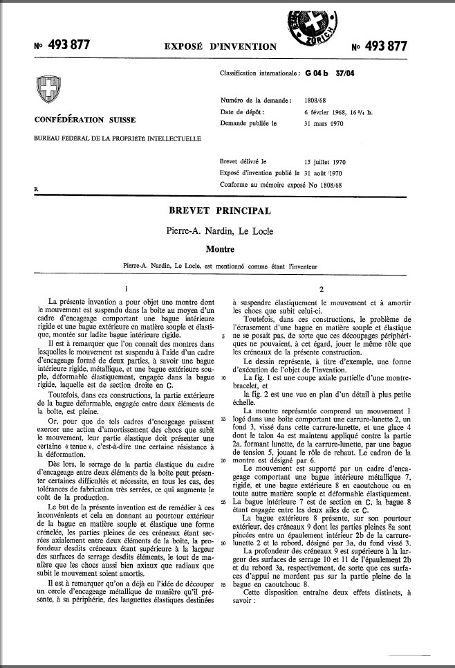

It is interesting that the patent drawing from 1968 demonstrates a more markedly domed crystal than the one we see in the color illustration from R枚ssler鈥檚 book. Perhaps the profile of the crystal was higher in earlier models.
Thanks for your pics.
My Defy watches have three different kind of crystals:
1. This crystal is domed and it is about 2 mm higher than bezel.
2. This crystal is about 1 mm higher than bezel and it seems to be even more domed than crystal above.
3. This should be the replacement crystal. It Is almost flat and almost at the same level as bezel, maybe 0.5 mm higher.
So my guess is that octagonal Defy was orginally sold with two different kind of crystal and then there is this replacement crystal that was sold much later.

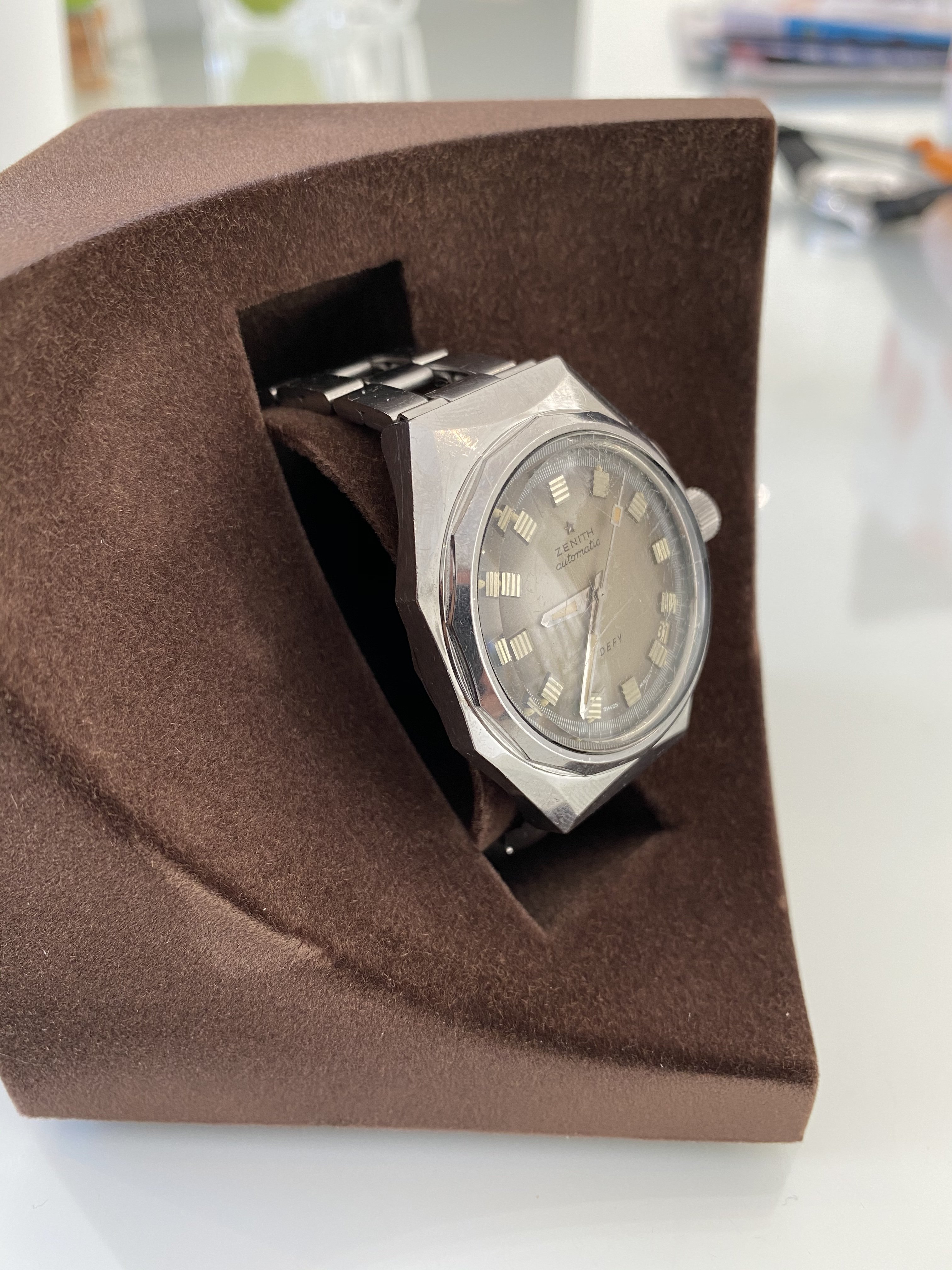

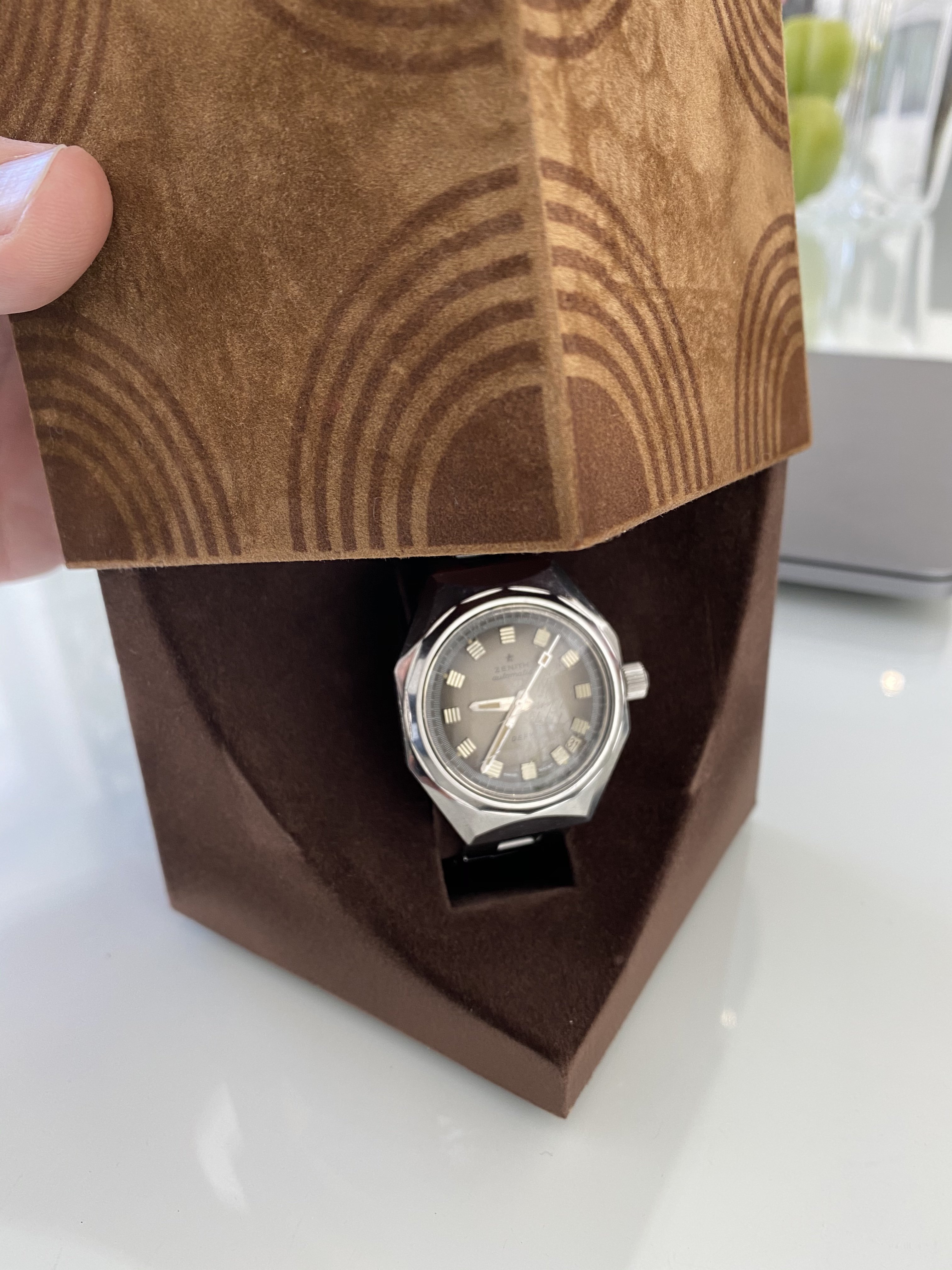

I'm not so sure about the box. I have read that octagonal Defy was orginally sold on the different kind of box.

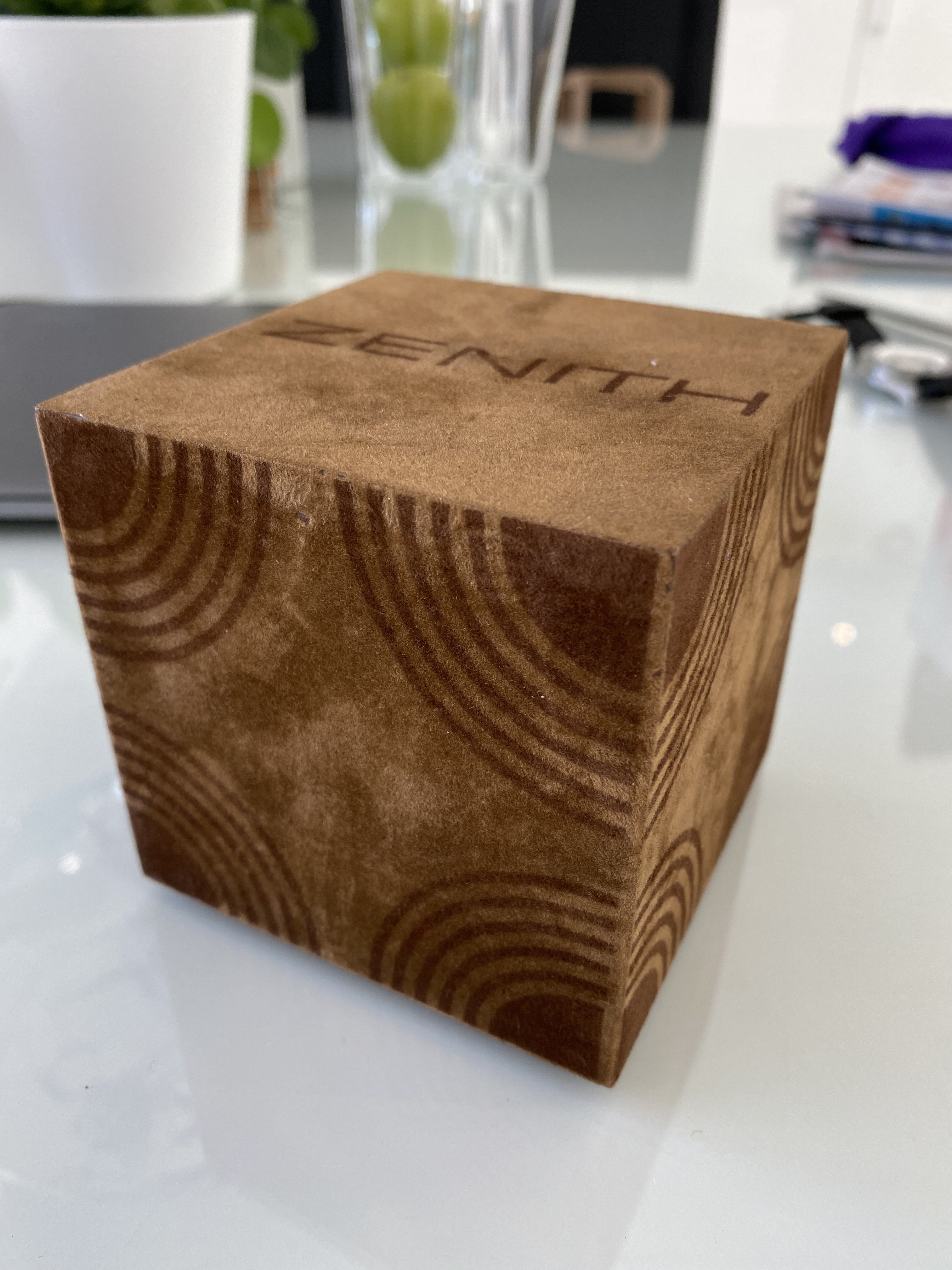

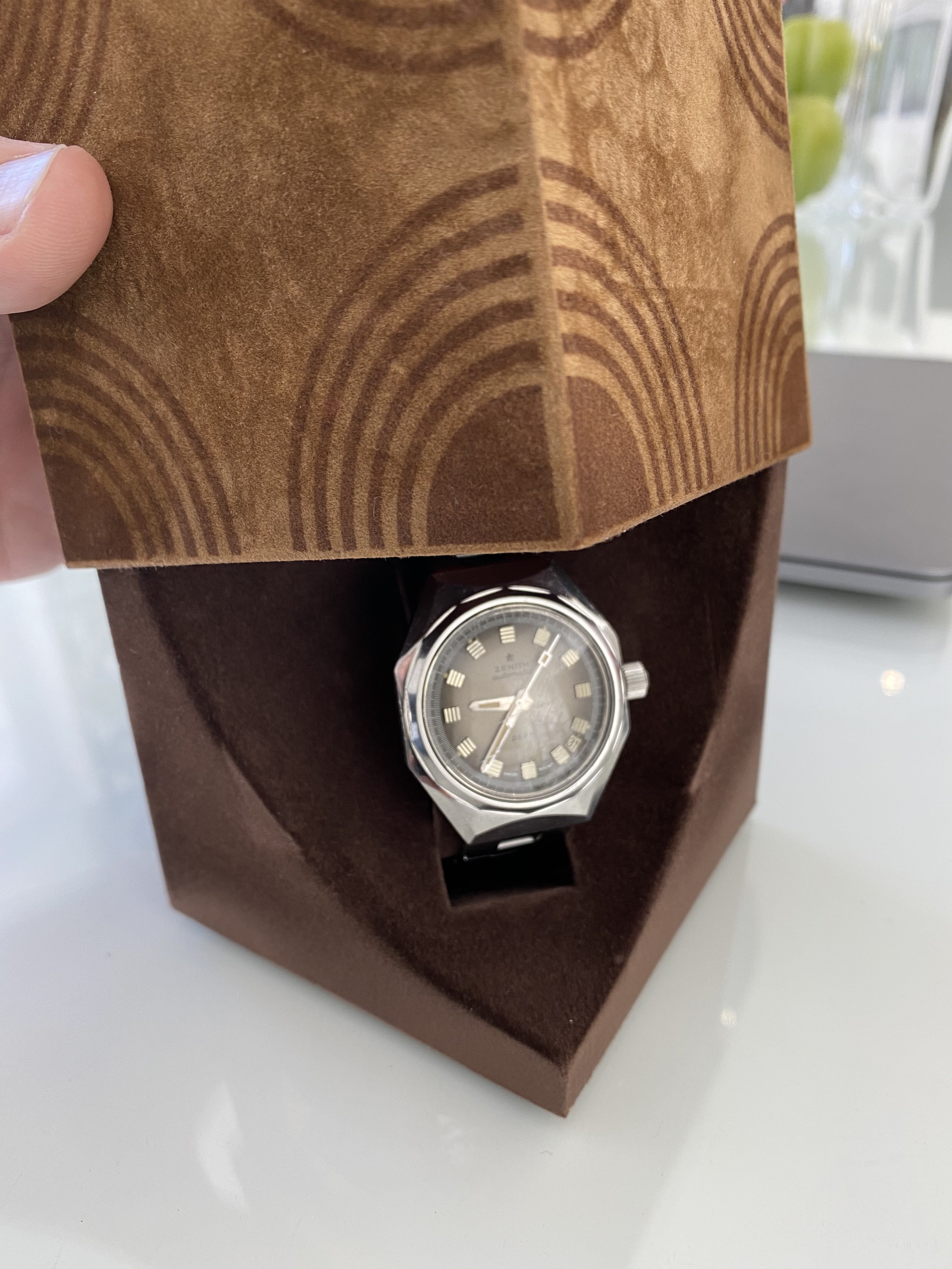

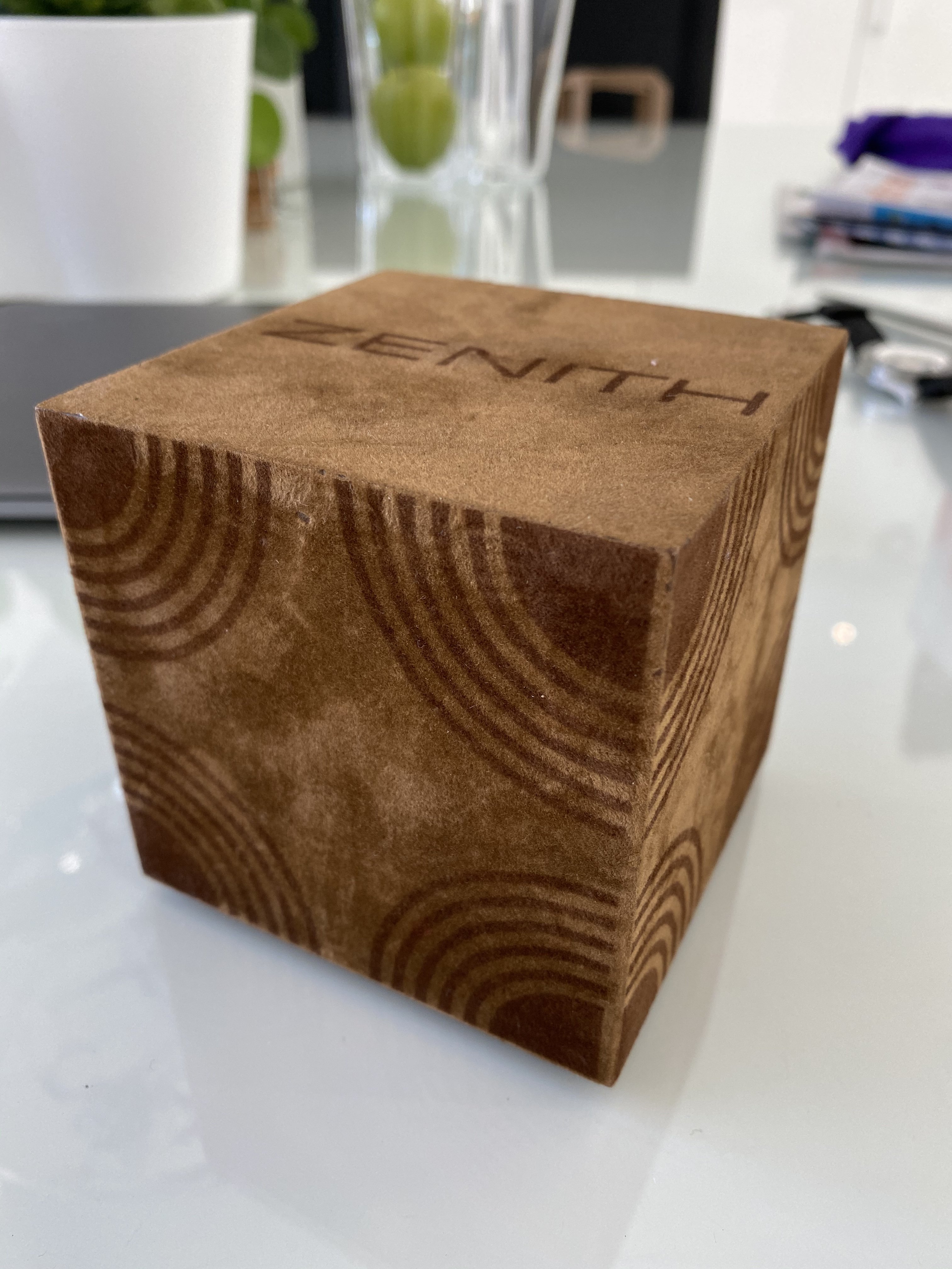

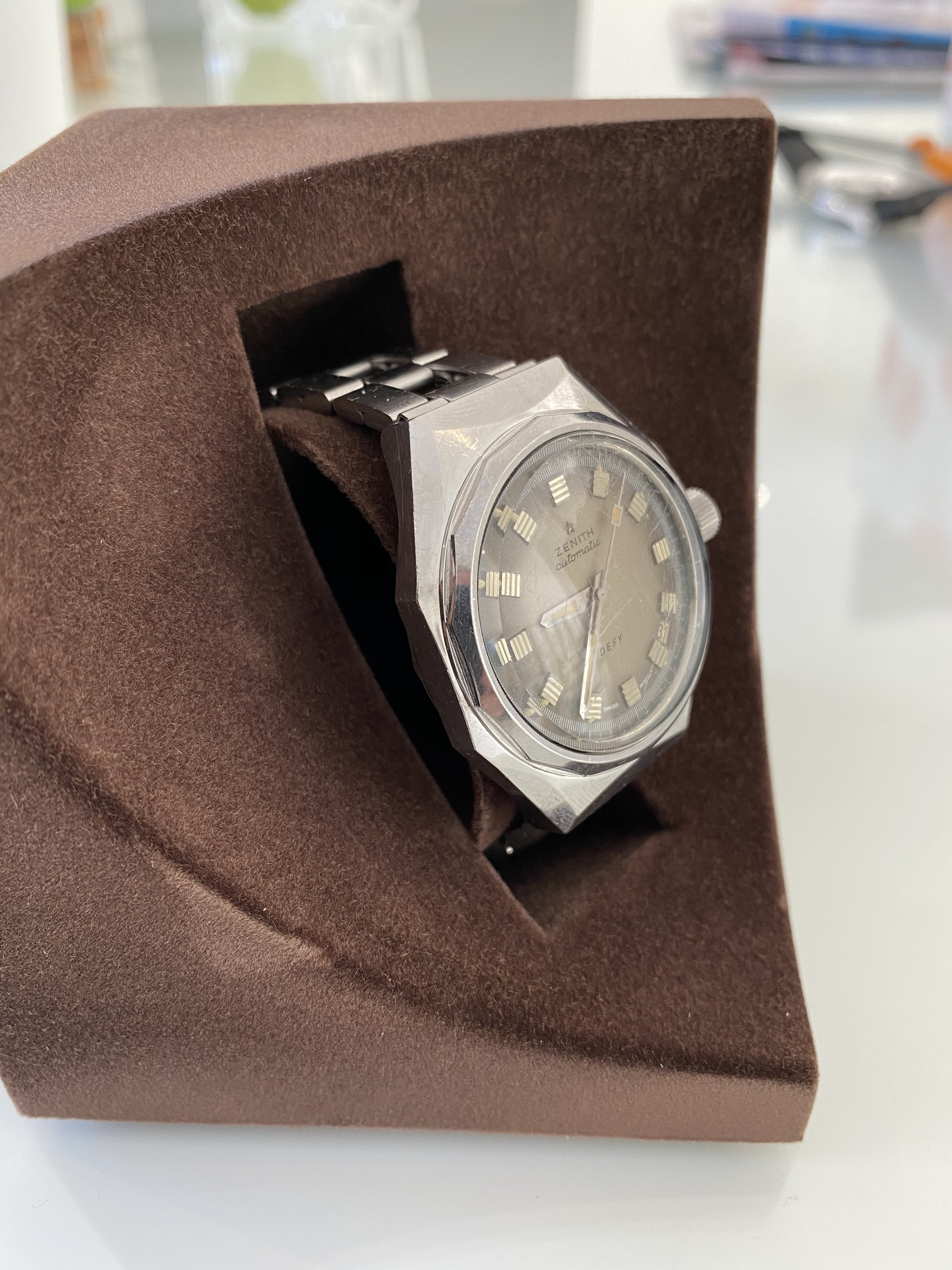

I think different countries may have had different boxes delivered with the watches? Would love to get more info on what boxes are considered correct for a Defy. And of course to know more what watches came with this brown velour box i have and is seen in previous posts in this thread.
My sourse (webpages of Finnish vintage watch expert and watchmaker) says that Zenith Defy was sold with modest red or black case that was made of cardboard. After 1972 they were sold with dark blue plastic case.

My sourse (webpages of Finnish vintage watch expert and watchmaker) says that Zenith Defy was sold with red or black case that was made of cardboard. After 1972 they were sold with dark blue plastic case.
Ok, i know and read his writings. Just saw this also. Thanks for the info. Then a question for what the velour box was made for?
