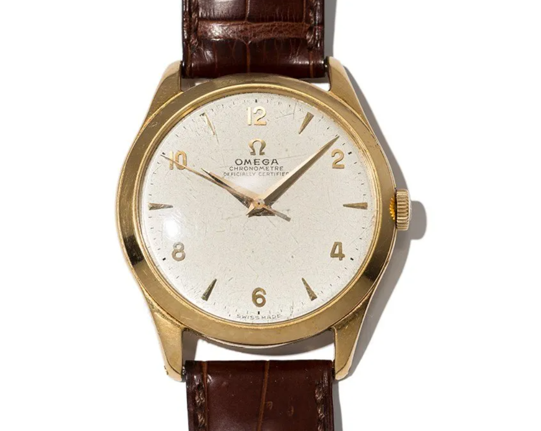

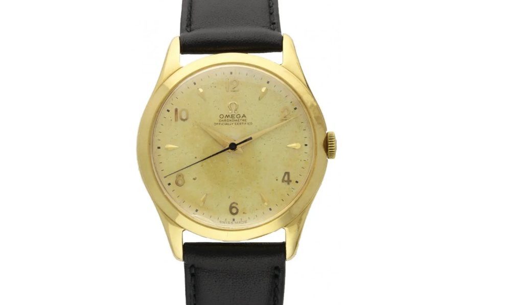

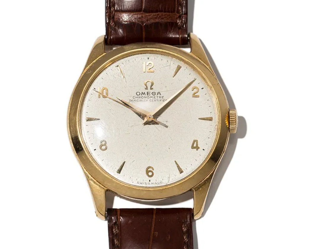

Hello Don,
I have never heard of this reference nor did I find any info on the microfiche when I researched in the Omega archive.
Do you happen to have a larger version of this AD ? the photo is not large enough and its a bit blurry, so I can´t read the text.
10,804
16,814

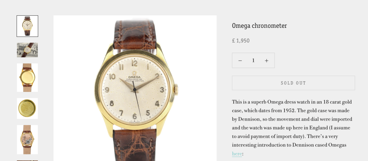

Note the Advert is English. This may suggest that the watch in question was UK national production, ie built up using a Dennison (or similar) case, hence the strange model number. Omega may not even have a record of this since they supplied only movement, dial and hands and it could be a local prototype that never made it. Were there an extant Dennision archive, and if there is I'm not aware of it, that would be the place to look maybe.
2,346
1,475

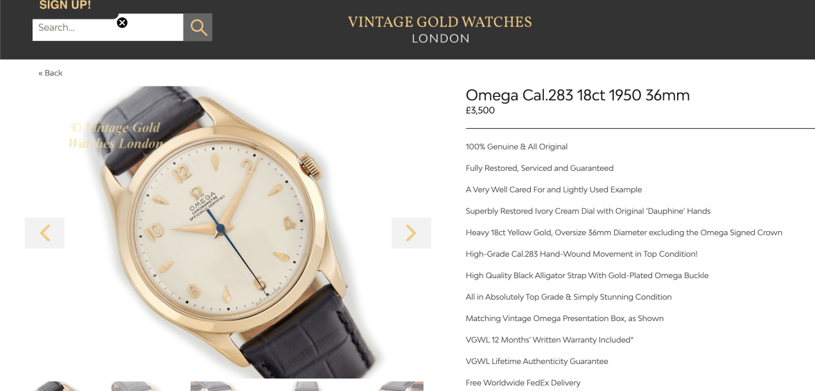

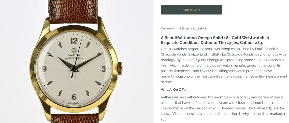

The ad does say English hall marked case. The caliber 283 was produced with a swan neck regulator, but nothing saying it was a chronometer movement and production was extremely limited
Image posted by Sharp shows a standard 283. No added features. Plain crown and ratchet wheels, so no added polishing as the RG models
