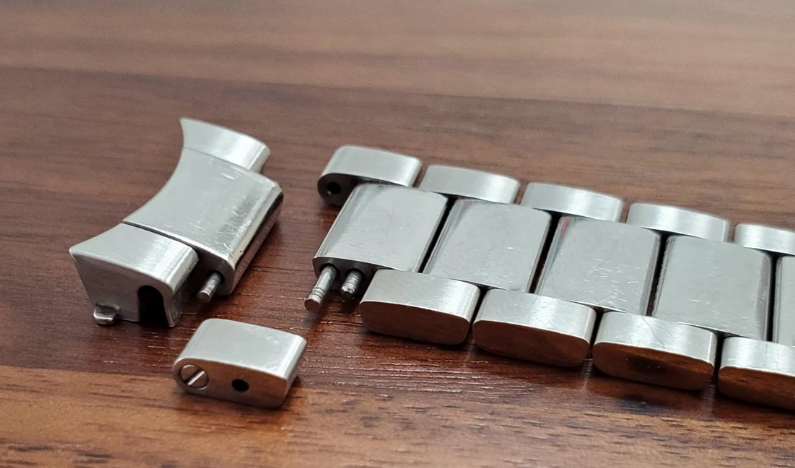

Okay here goes. So I dropped my (at the time) 1.5 year old Seamaster 300 Master Coaxial (233.30.41.21.01.001) from waist hight and the non removable link just fell apart. When I brought it to the AD they said the Omega warranty only covers the movement/case, and that a new one would be roughly $1,000. Now I have a few questions. First of all, how are those pins and bracelet segments held together in the first place? Are the pins spot welded on the outside and then sanded and polished until it's smooth? If that's the case then I believe my bracelet was defective from the factory because as you can see (circled) in the pictures, the pin was never flush with the side of the bracelet segment, it was always loose in there, just a hair under the surface. Further, if this is how it is assembled would this be a simple fix for a watchmaker/jeweler? I'm a little concerned to take it to a mom and pop shop and have them do some sort of flimsy soldering shenanigan done only to have my watch fly off while Kayaking 6 months later. I really want to fix/replace it and hopefully never worry about this again. It's been on the bond nato ever since because I haven't had time to get to the bottom of this.
So do I
1) pay roughly $1,000 at the AD for a replacement + separate watchmaker to polish the case to match the new bracelet
2) Find a good watchmaker (I'm in South Florida if anyone has recommendations) and have them repair it
3) try to get Omega to replace it (if it was indeed defective).
Pics
https://imgur.com/a/LTplUx5
Thank you!
just an fyi, the top broken link is not removable, those screw caps that are visible just hold the pin that retains the link above it (the one that attaches to the watch) in.

My waist is about 104 cm off the floor (around 41 inches if you are metrically challenged). If you drop a watch from this height, you cannot expect that there won't be damage. If there isn't any, consider yourself very lucky.
Warranties are for defects in materials and workmanship, not for accidental damage. What you are describing in your situation isn't really a warranty repair - it would be a courtesy repair. Same result for the customer, but an entirely different thing.
Having said that, I've just checked the Omega Extranet to see if there are any specific issues related to this particular bracelet, and there are - with the fixed link pins, so the OP should contact Omega directly to get it resolved.
