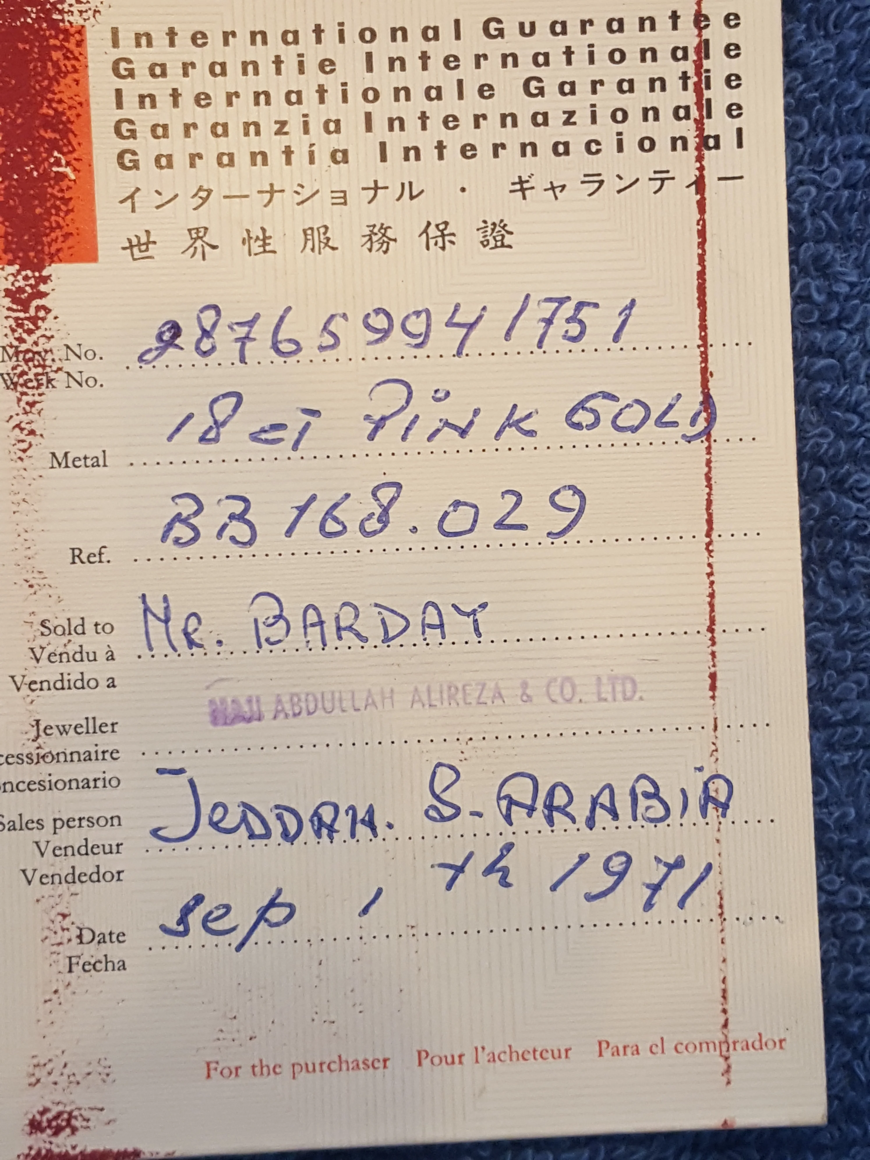

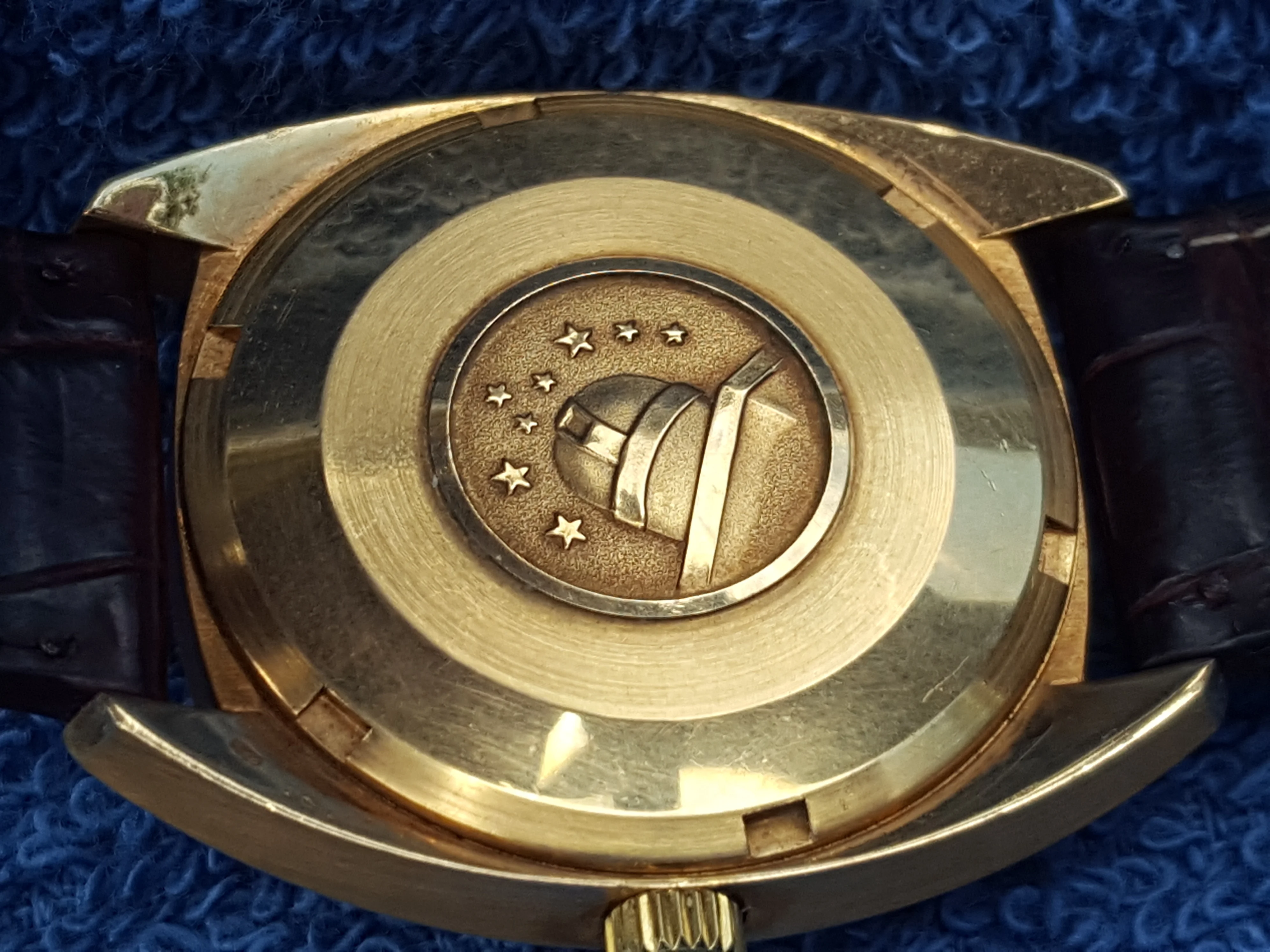

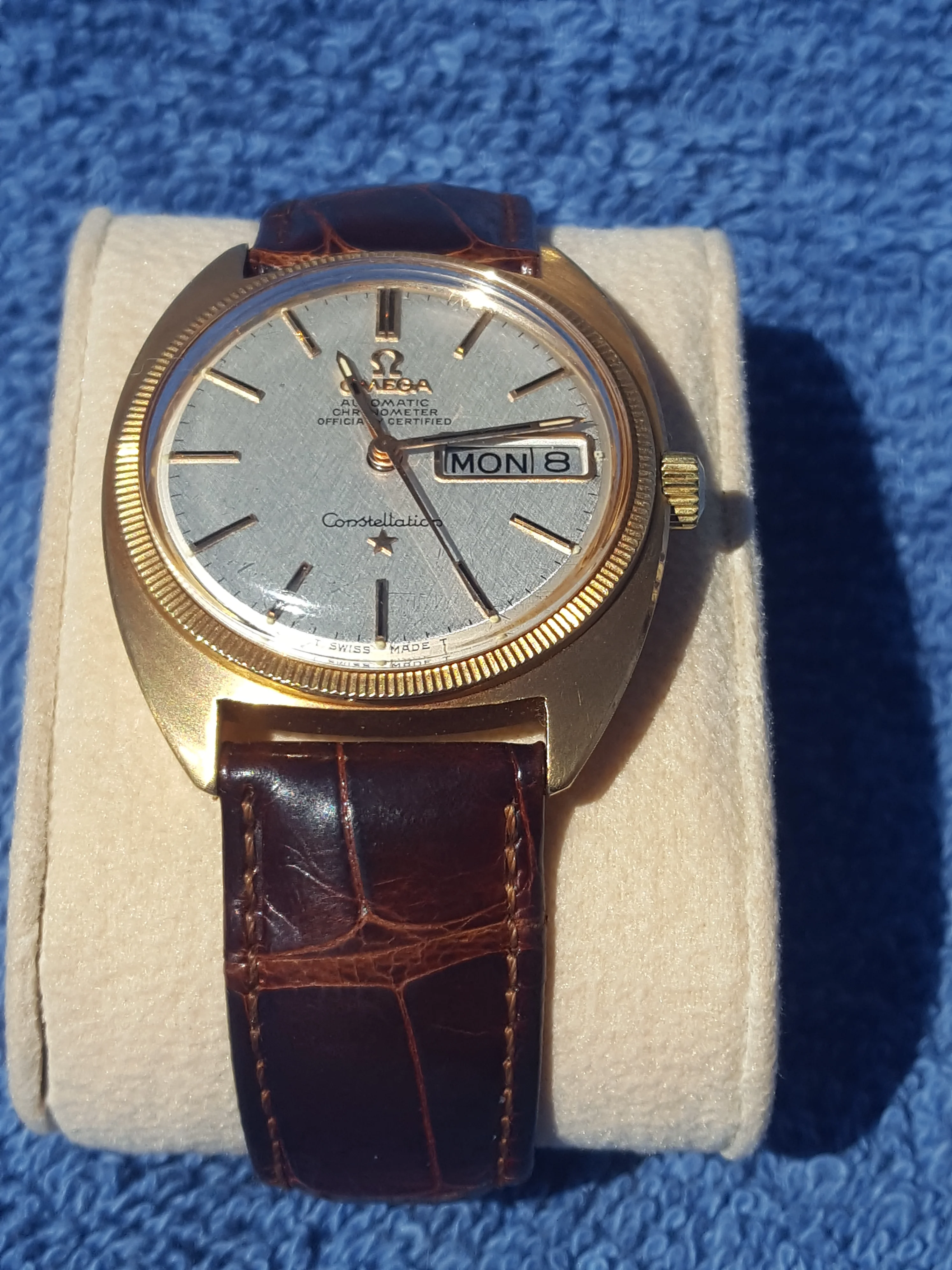

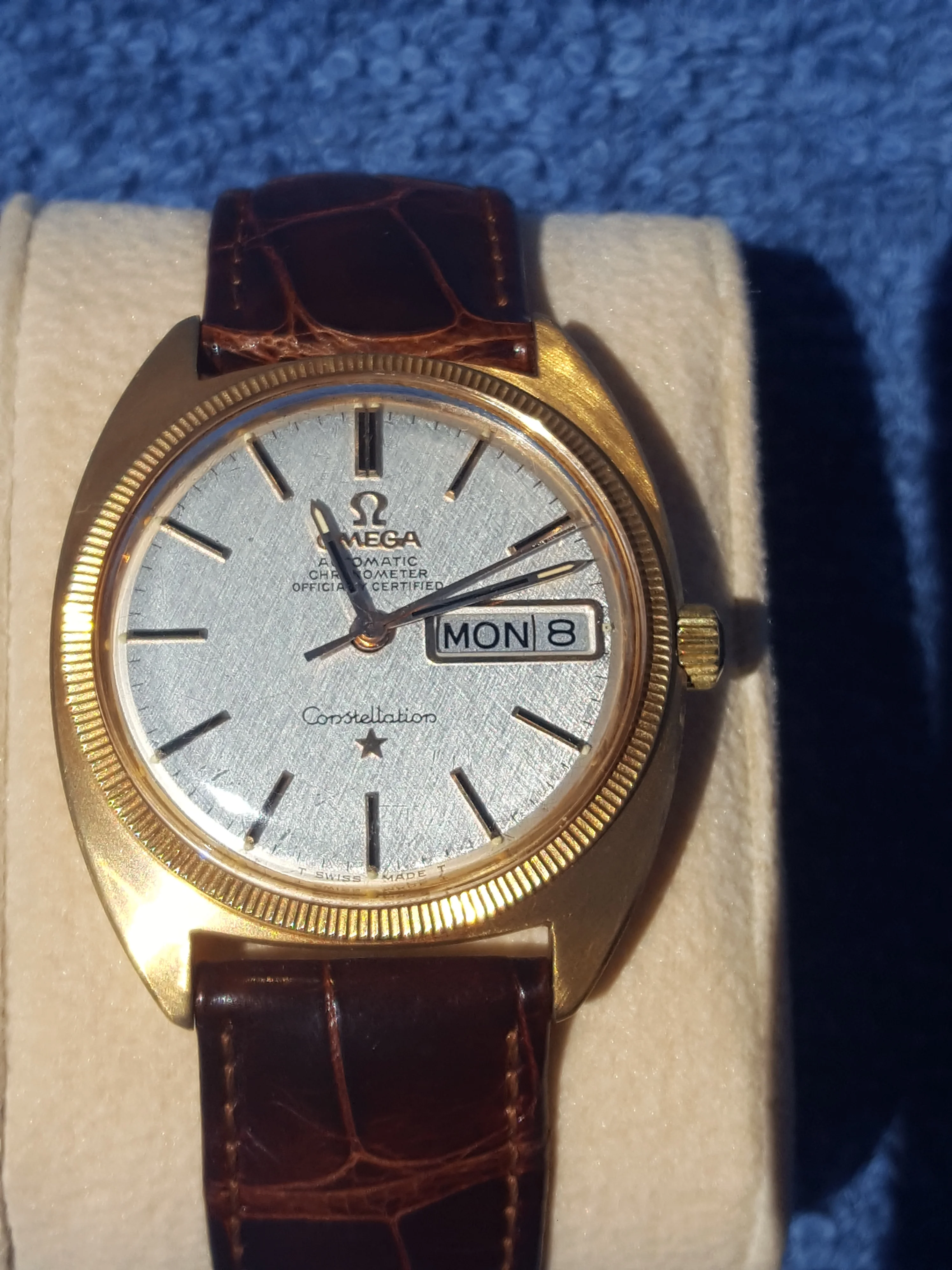

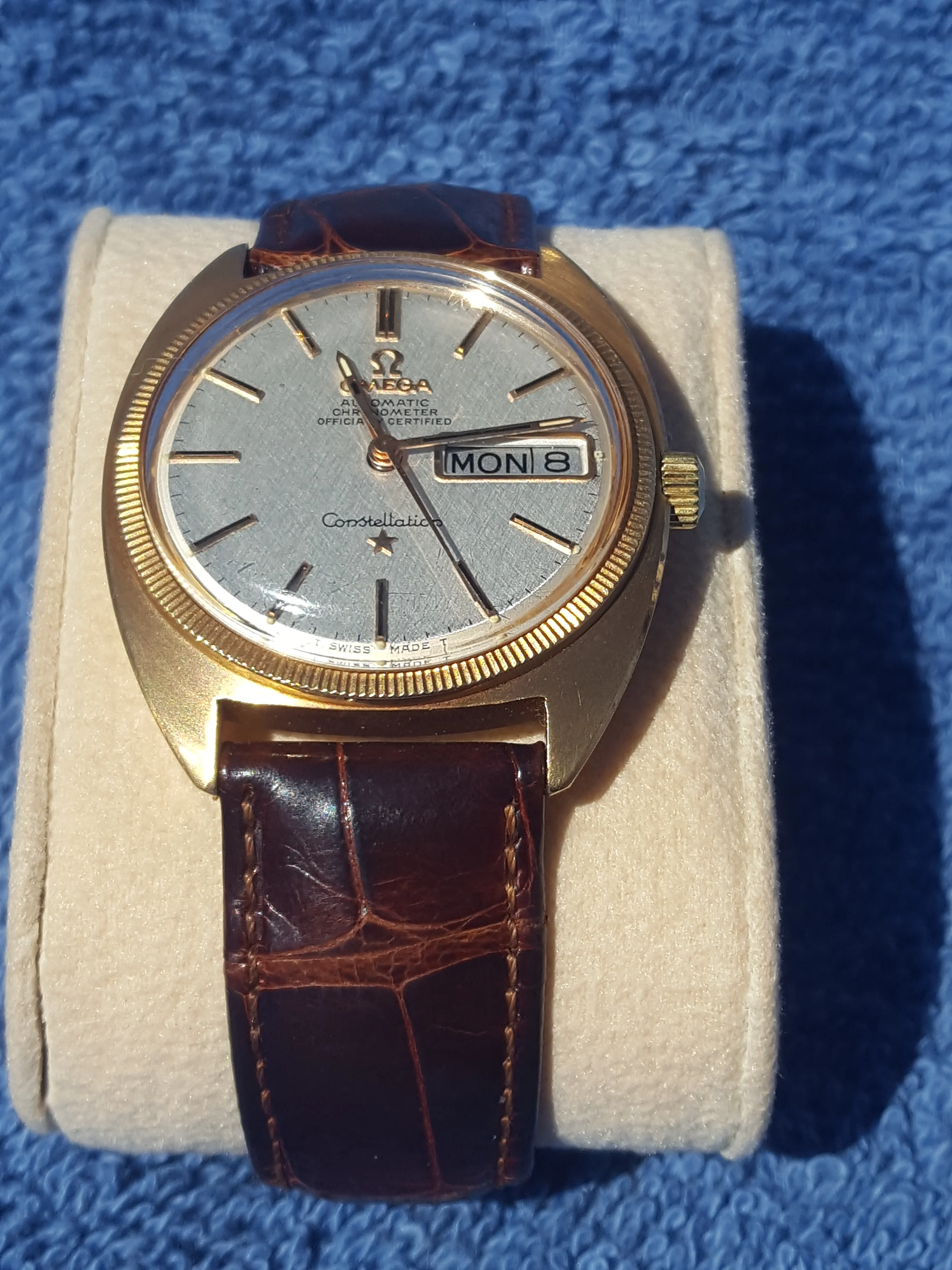

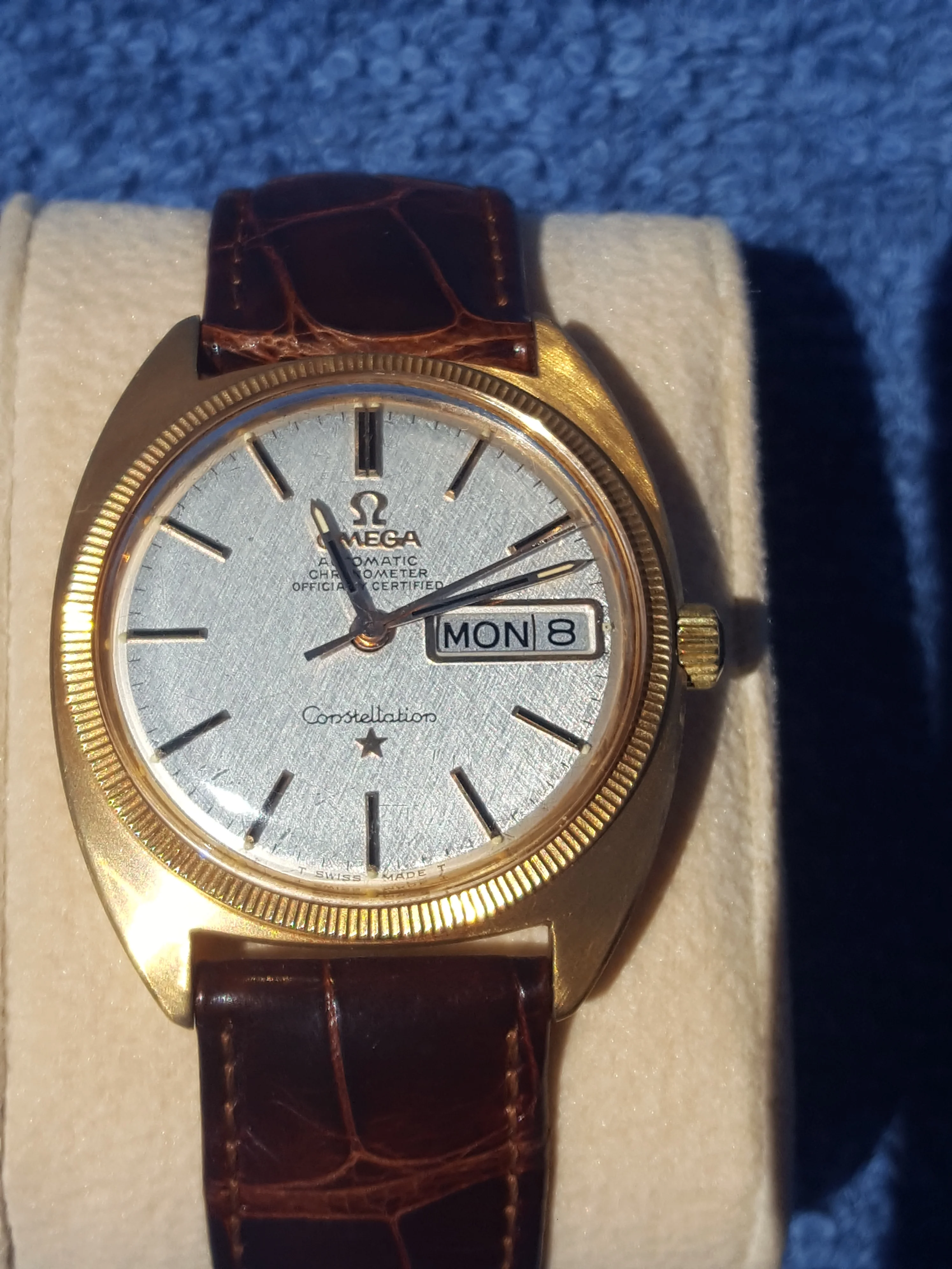

Hi all,

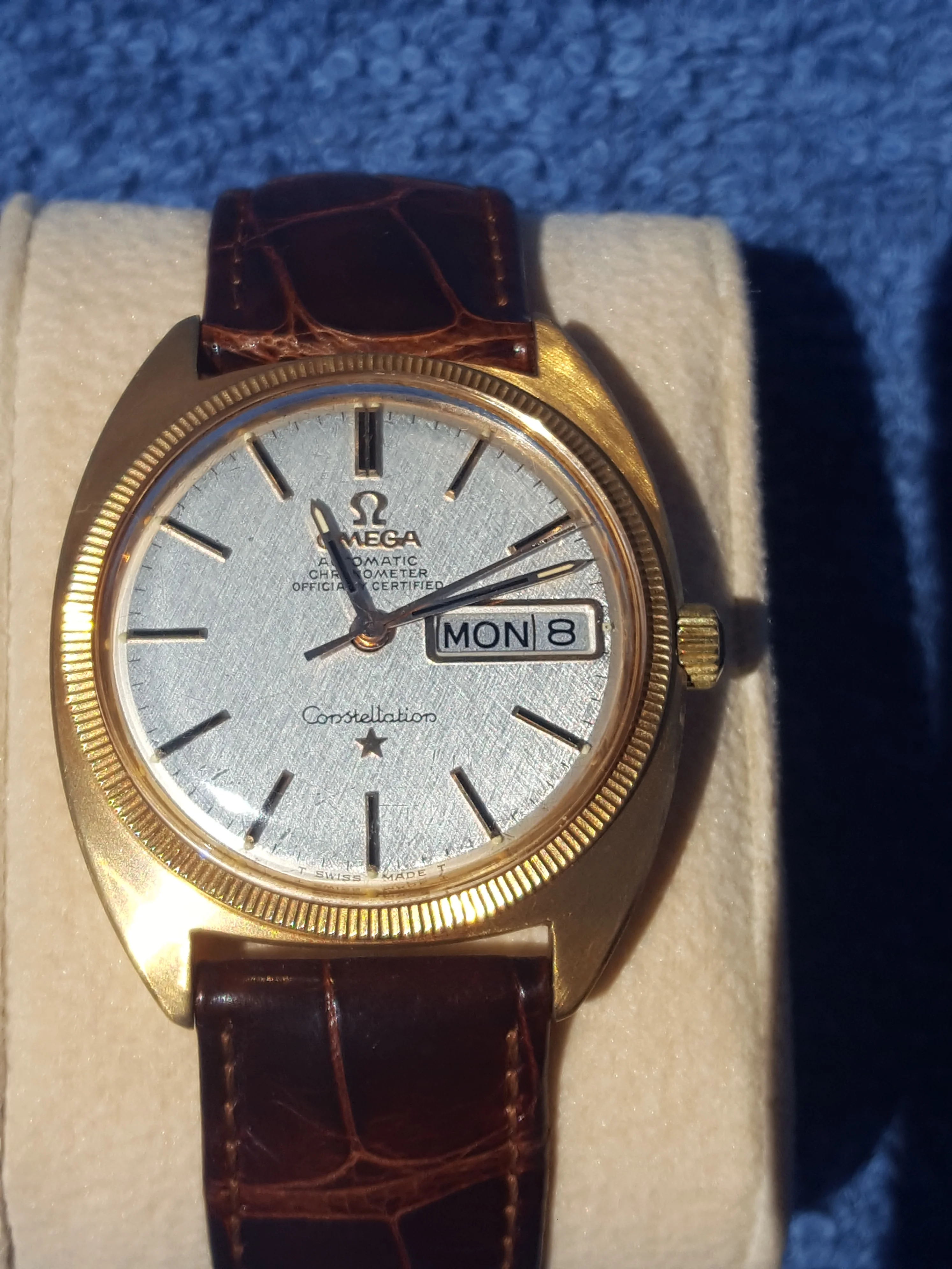

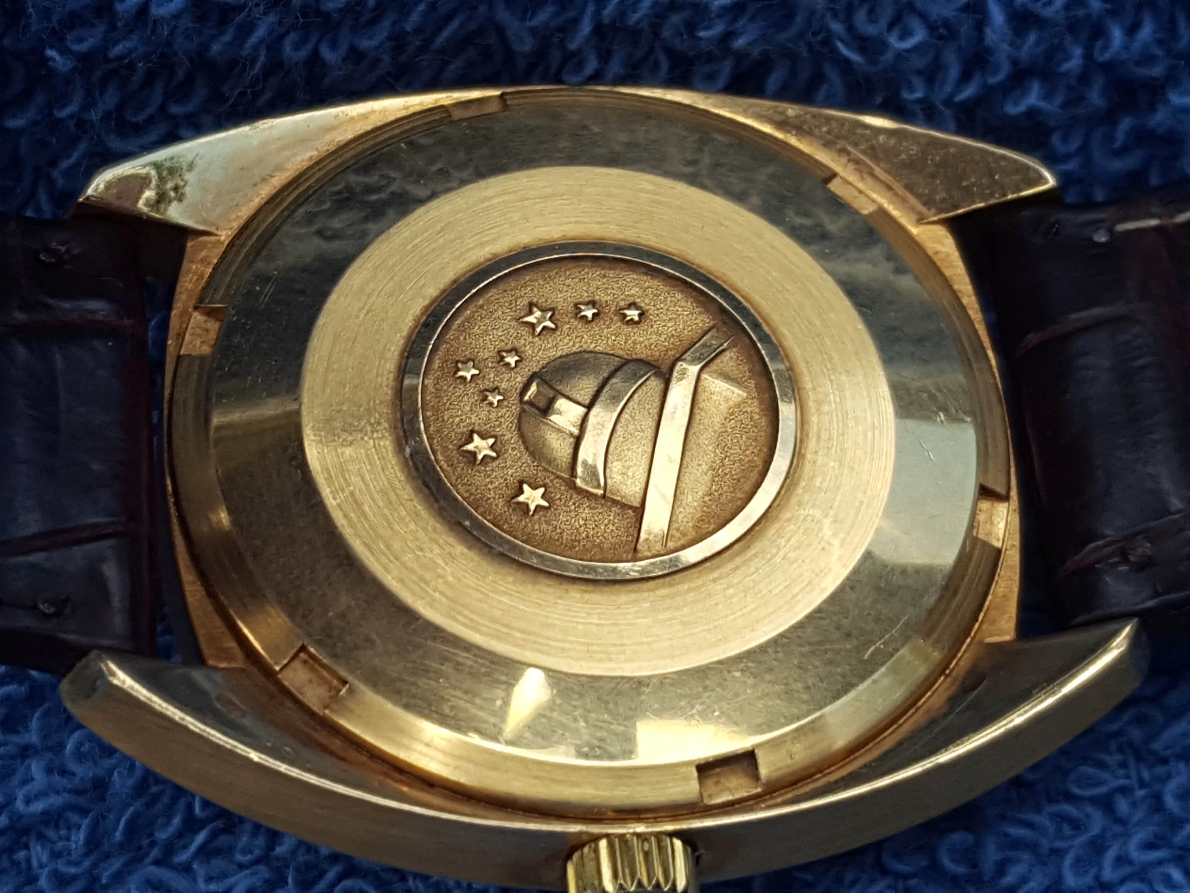

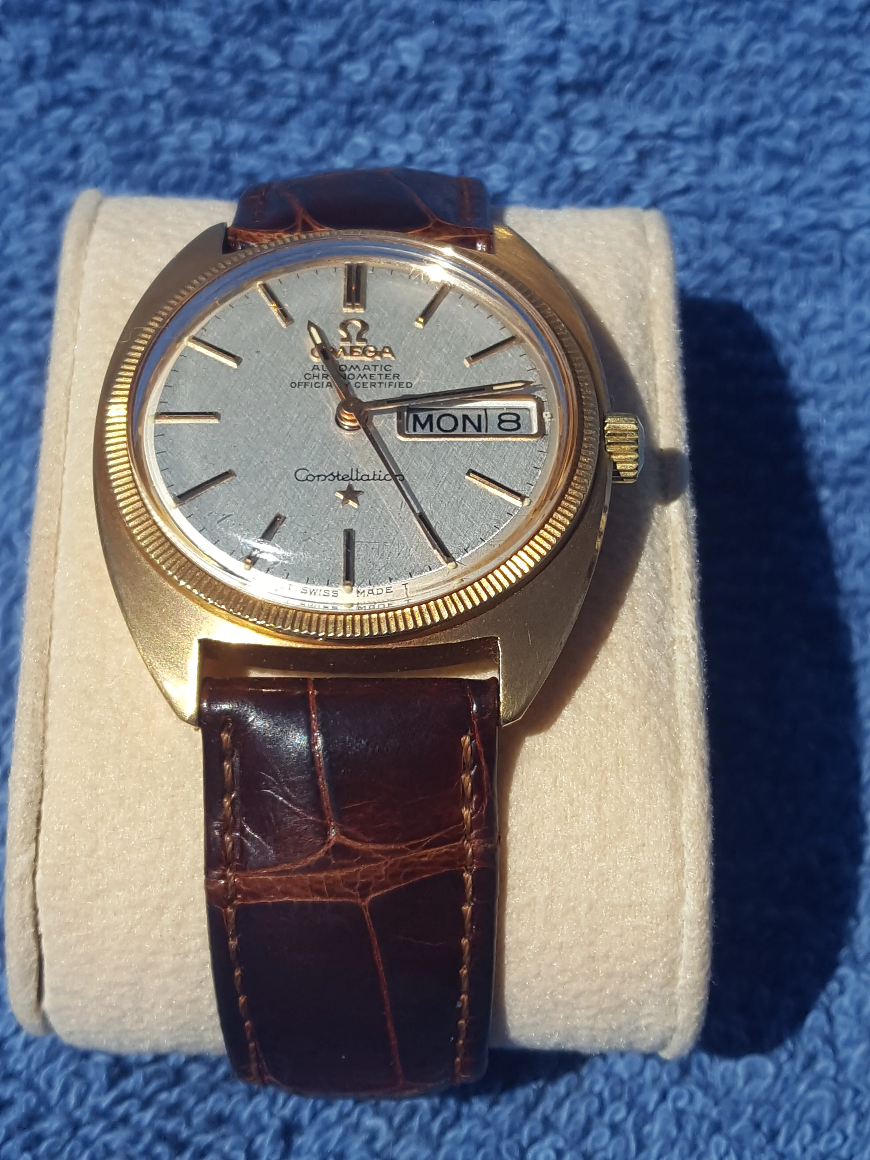

I recently posted on the "C Case Constellation" thread, my 168.019 "pink" gold Constellation (Pics below).
Full disclosure: I love the watch, have no question as to its authenticity/provenance, but being recently retired perhaps I have too much time on my hands to think about trivial things.
Questions and/or opinions for the experts/afficianados on this forum:
"BB" Omega code indicates "rose" gold. That seems to encompass a wide range of gold/copper/silver alloy hues as opposed to specifically differentiating between say pink, rose and red. Did Omega or sub-contracted case manufactures have different alloy "recipes" over the years?
If true, and given Omega's proclivity for reference numbers for everything, shouldn't there be a reference for a specific "rose" gold alloy hue, e.g., 168.019 BB.0XX.1234.25 (half kidding/half serious).
Does age/patina come into play with 18k copper alloy gold?
Tried my best with phone camera in sunshine.
Look forward to any comments...
Dan

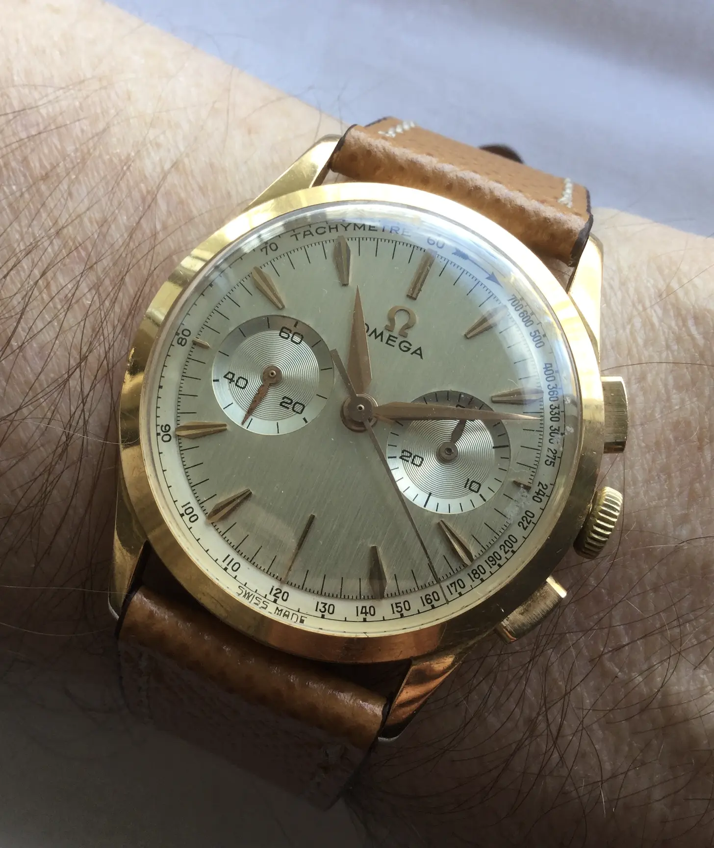

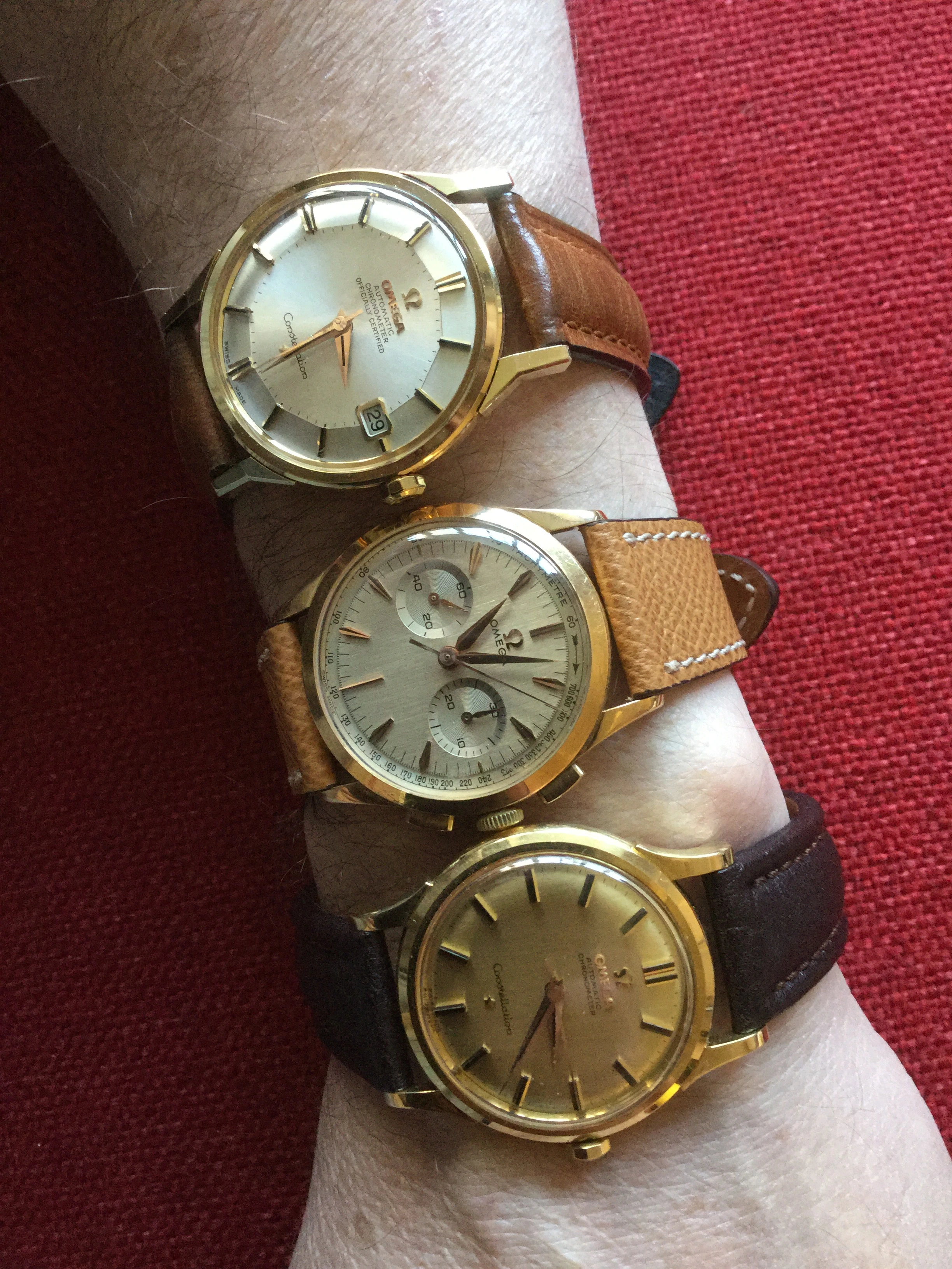

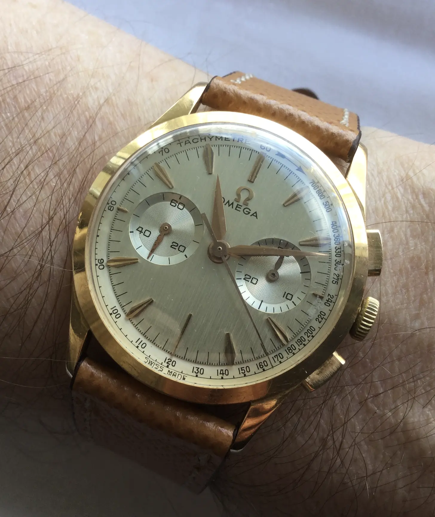

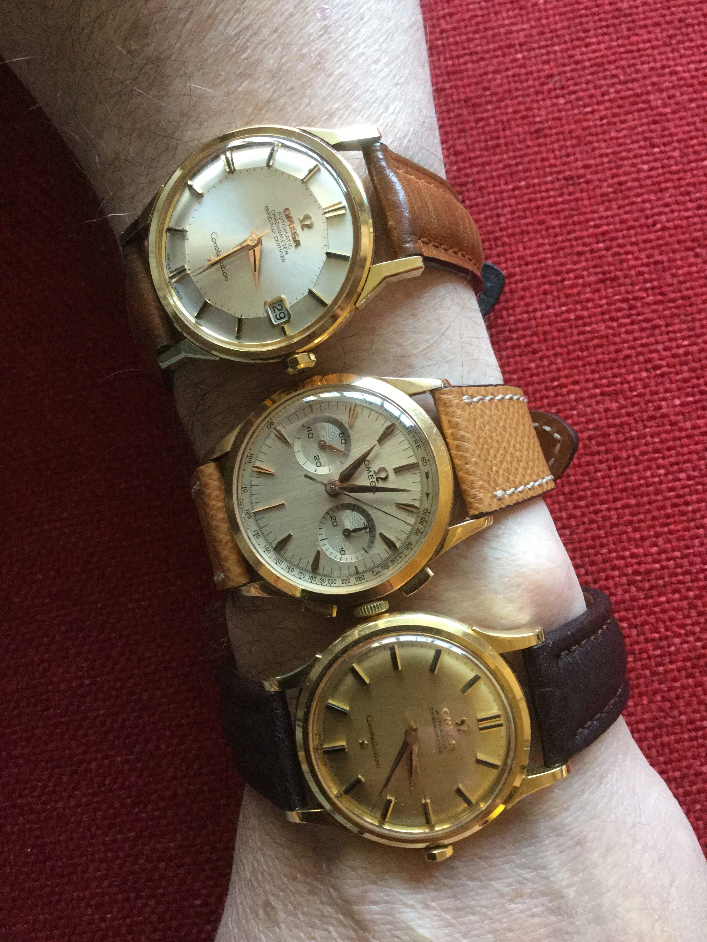

My 18k 320 2872 is most definitely 'pink' but has 'faded' to a very subtle colour that looks more like yellow gold at first glance.
Whilst at the same time my 18k yellow gold 14382 deluxe (which was unmistakably yellow when purchased) has taken on a much deeper rich patina that could be mistaken for pink.
I don’t have a current pic of the Constellation but here is the 2872, looking quite yellow.
side by side with a 14k yellow gold dogleg and the 18k deluxe constellation the 2872 was unmistakably pink.
