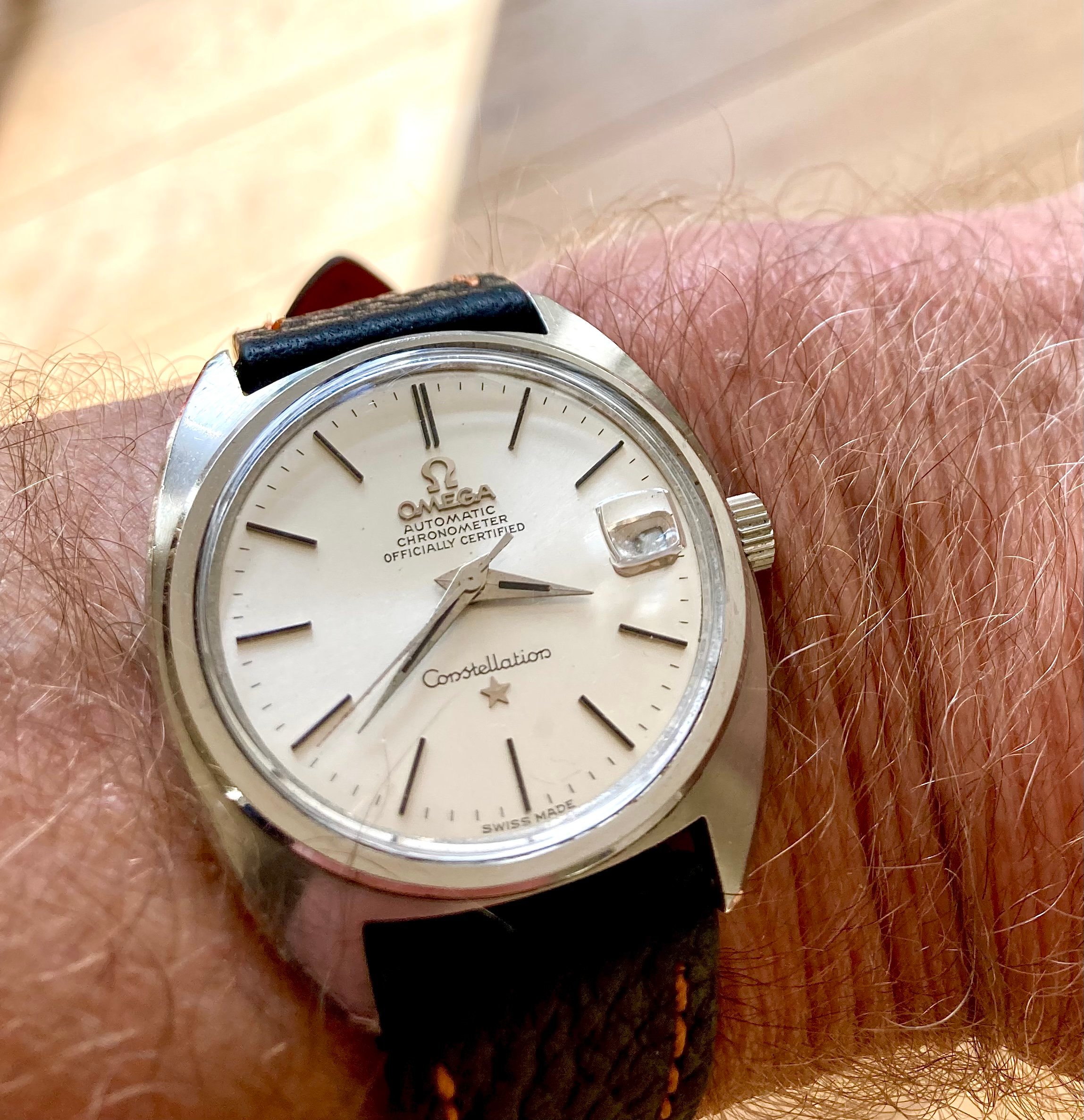

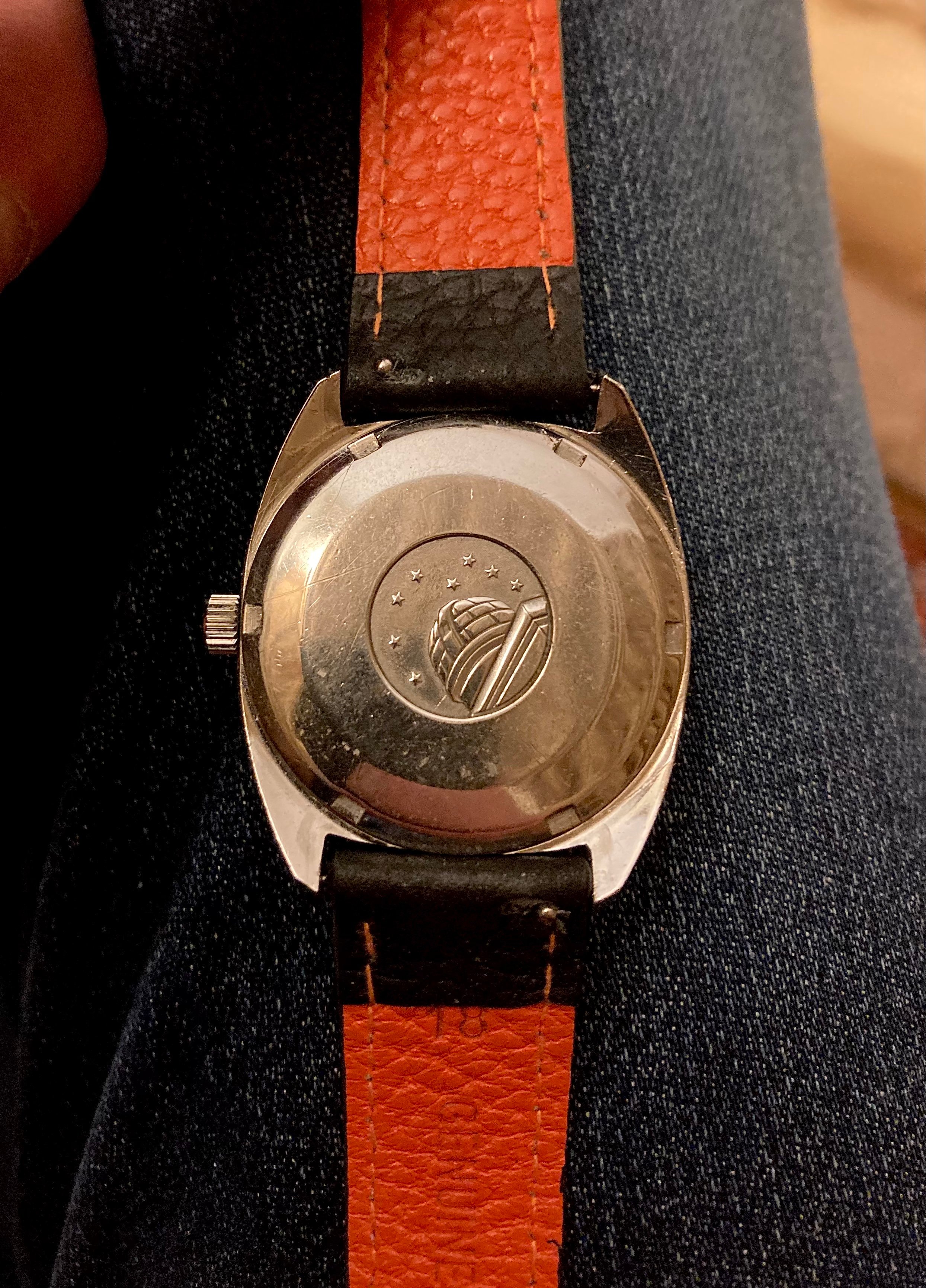

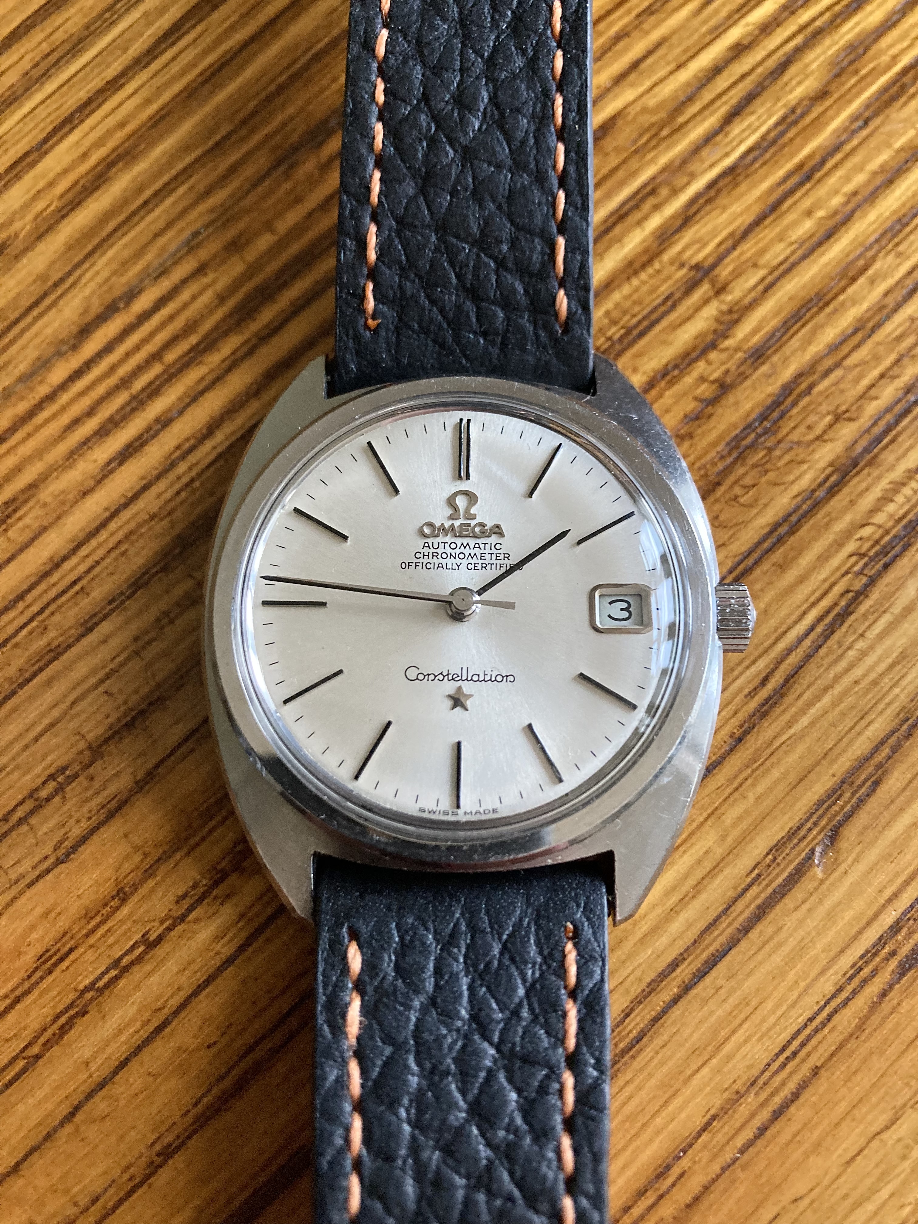

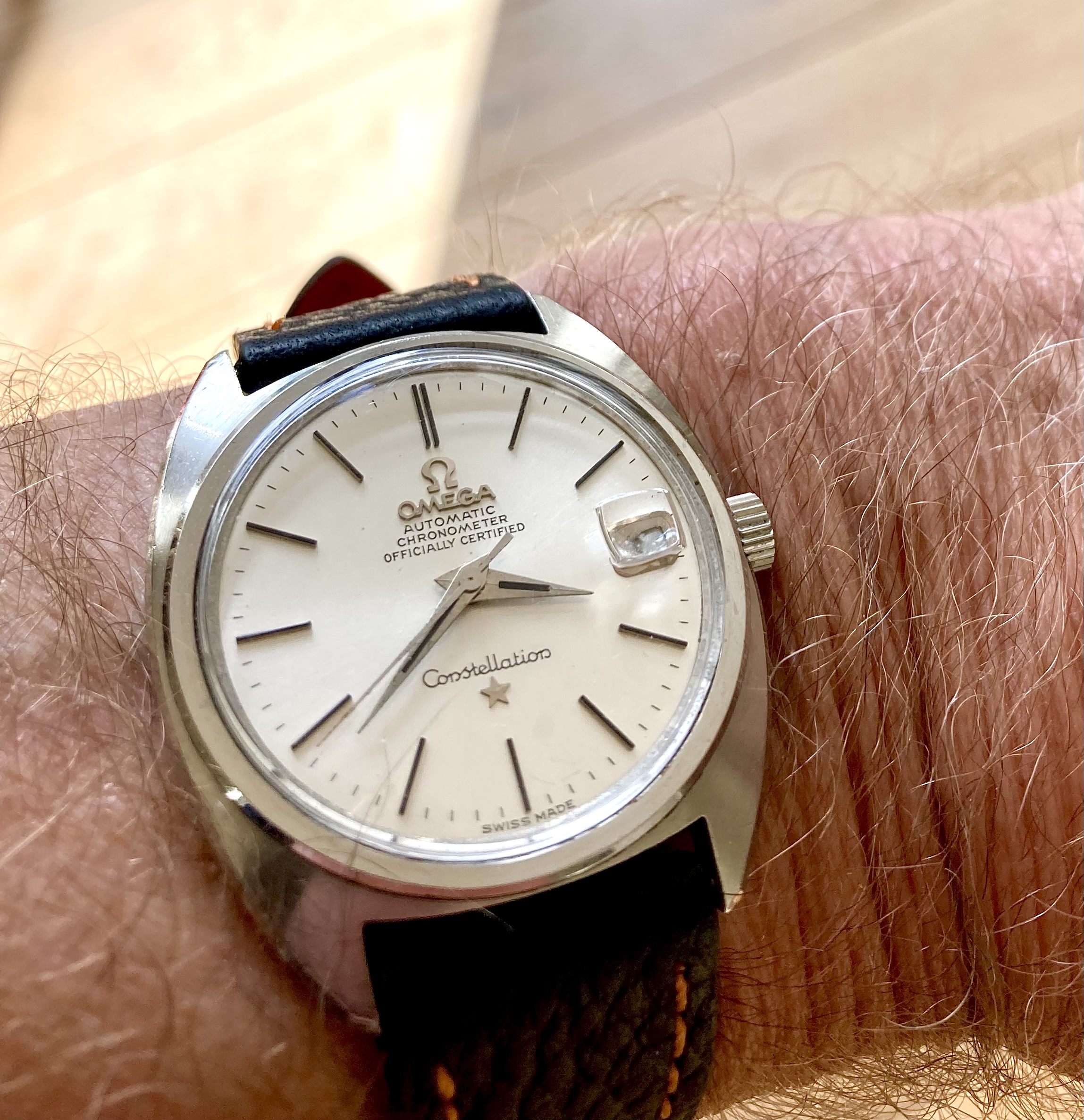

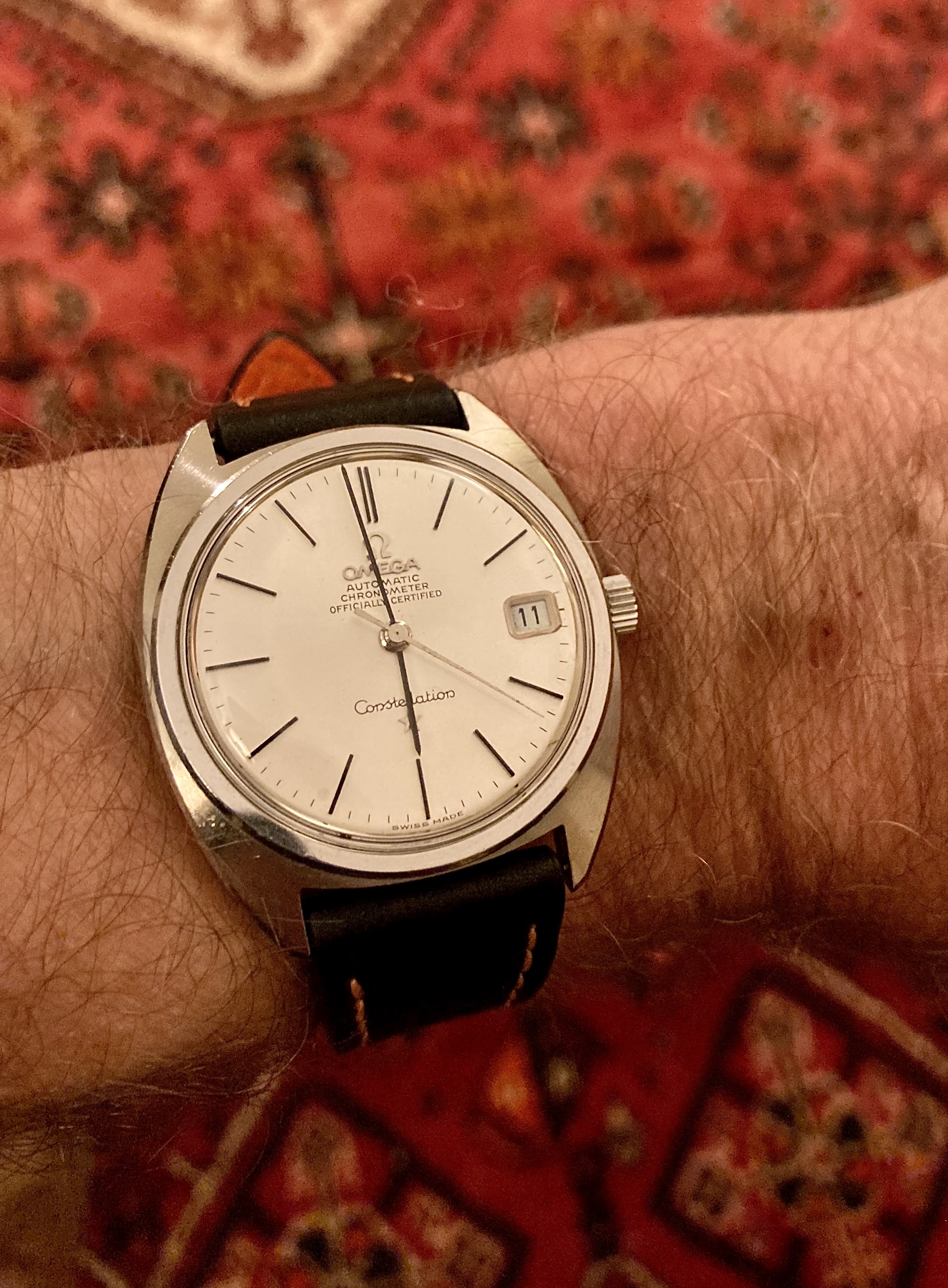

Back from service with a new crystal (so I can read the date) and more appropriate hands for the 561 movement.
The minute hand is possibly a millimetre or so longer than the original hand would have been but both the crystal and the hands are an improvement on the crystal and hands on the watch when I bought it.
Many thanks to @kaplan for finding the hands for me.
I’m told that the old dauphine hands were probably designed for a non-Genta case Constellation and I’m planning to sell them. Obviously if anyone needs the dauphine hands, let me know.

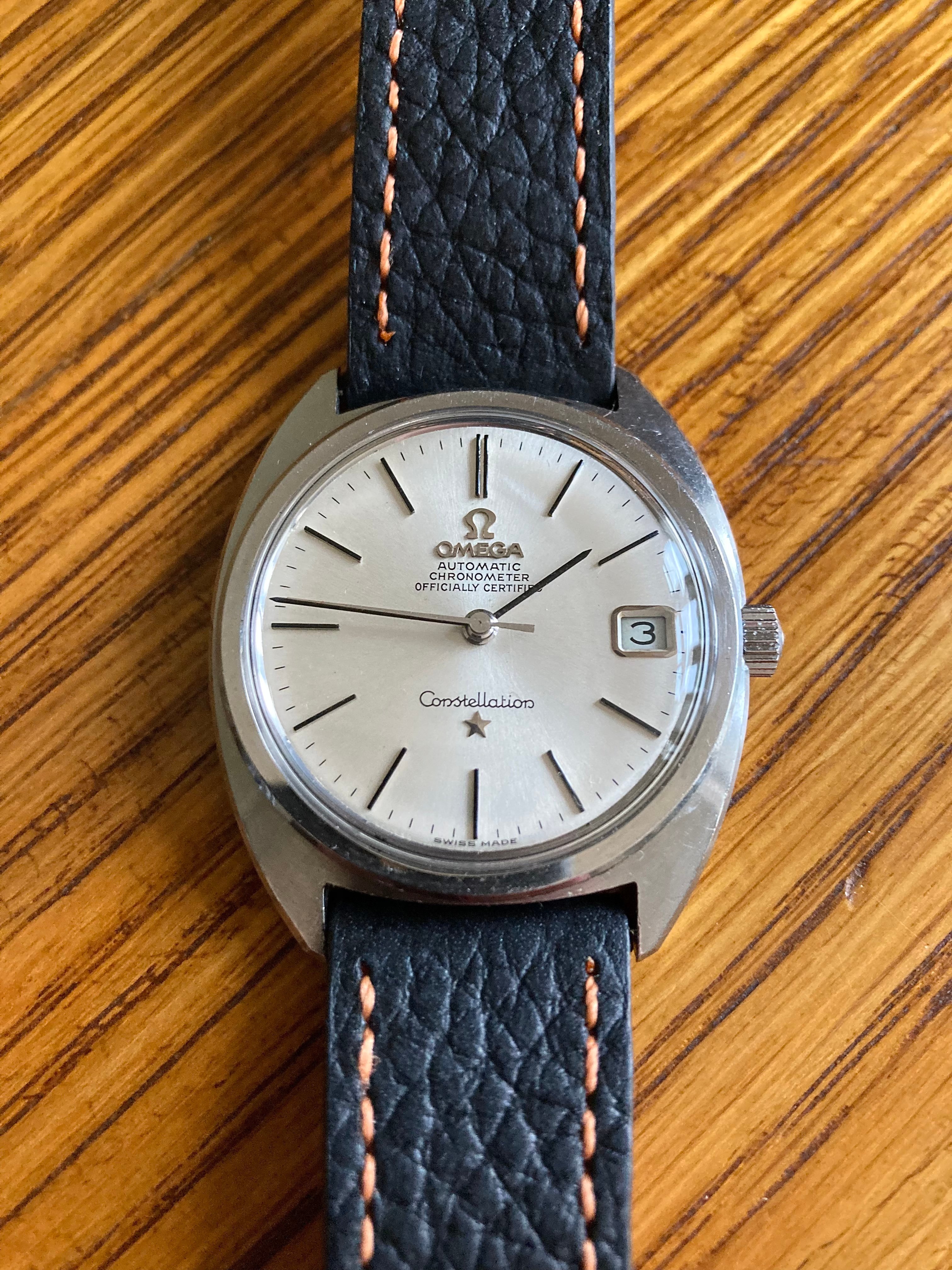

Finally joining the club.
Still sourcing for the endlinks though.
Please show me the direction if found any for sale.
My 168.029
I really like those milled edge bezels

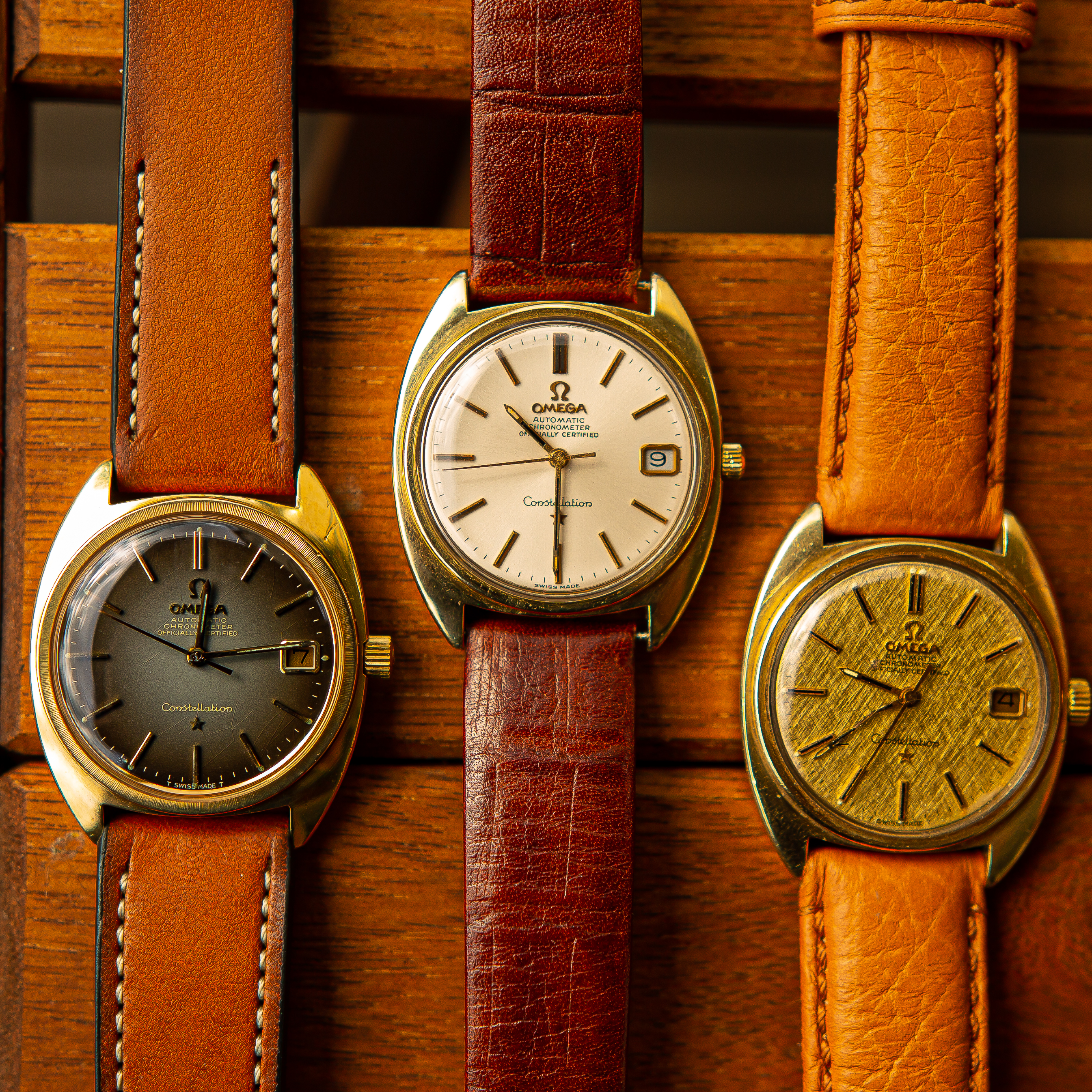

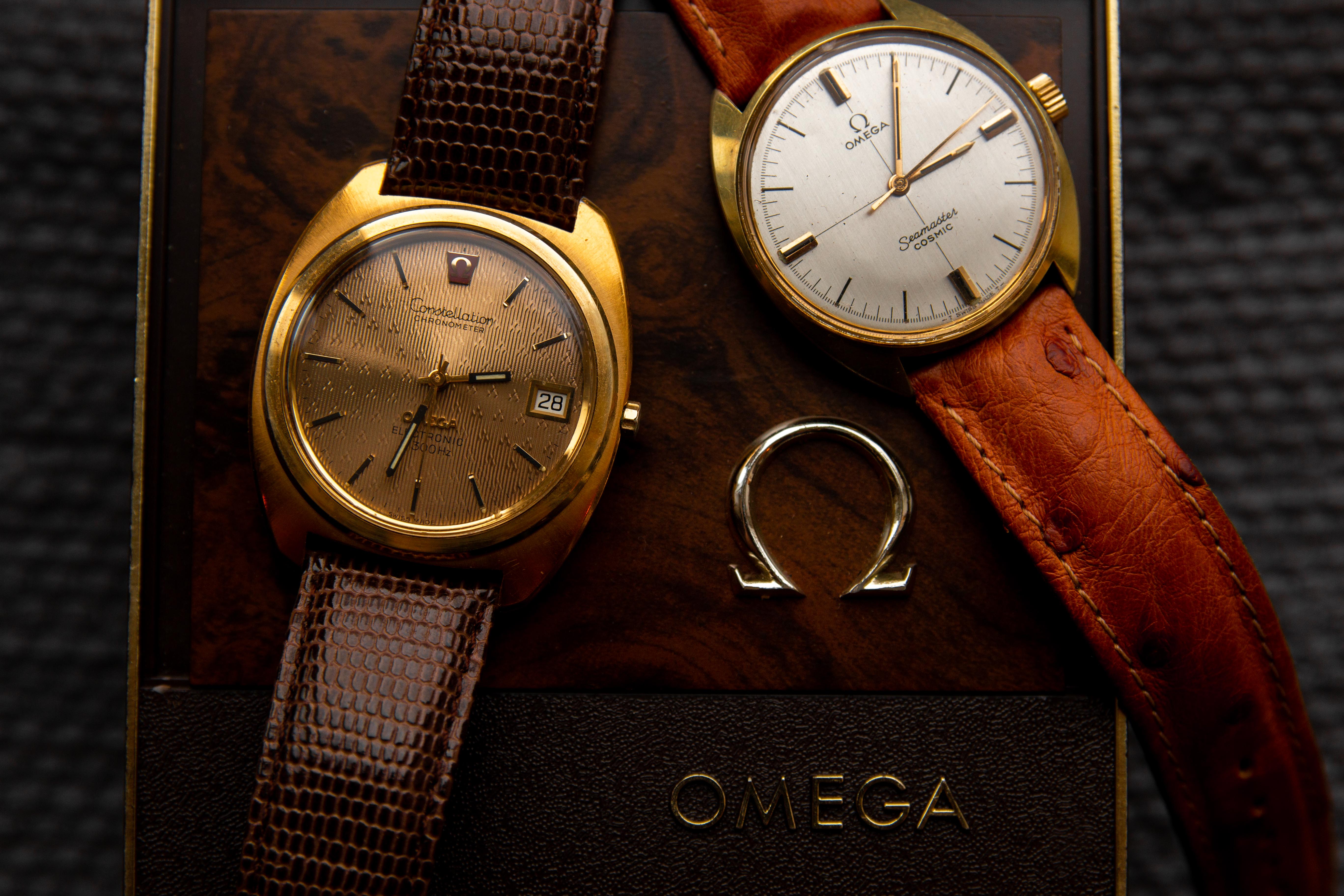

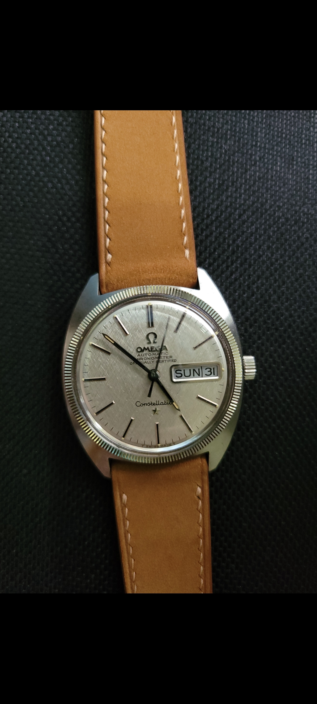

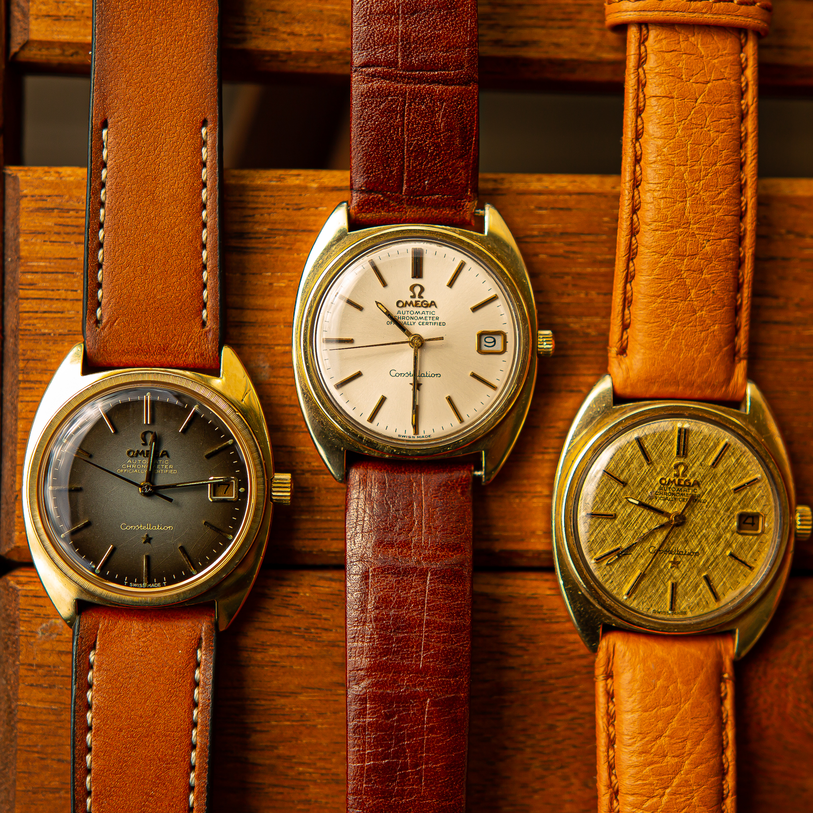

Hey guys. I posted this one a while back but somehow deleted the post unintentionally, so here I go again. The textured dial one on the right is unfortunately a bit out of focus as I was in a rush to get a shot of all three before the middle one was sold (also, sorry for the strap size on that one, the client insisted on it 😜).
Attached my old C-case F300 Connie too, regret selling that one. Super cool dial that you don't see too often. I dont even know what to call it 😕

Welcome to the forums! And great that you start with these under-appreciated beauties.
The moiré dialled version has very fine fluting - is it gold capped, or solid?
13
59
Thank you! The Fumé dial with fluted bezel is 18K solid gold, the rest are gold capped. I've had a lot of different C-case Connies over the years but this my first with this gradient dial 😀

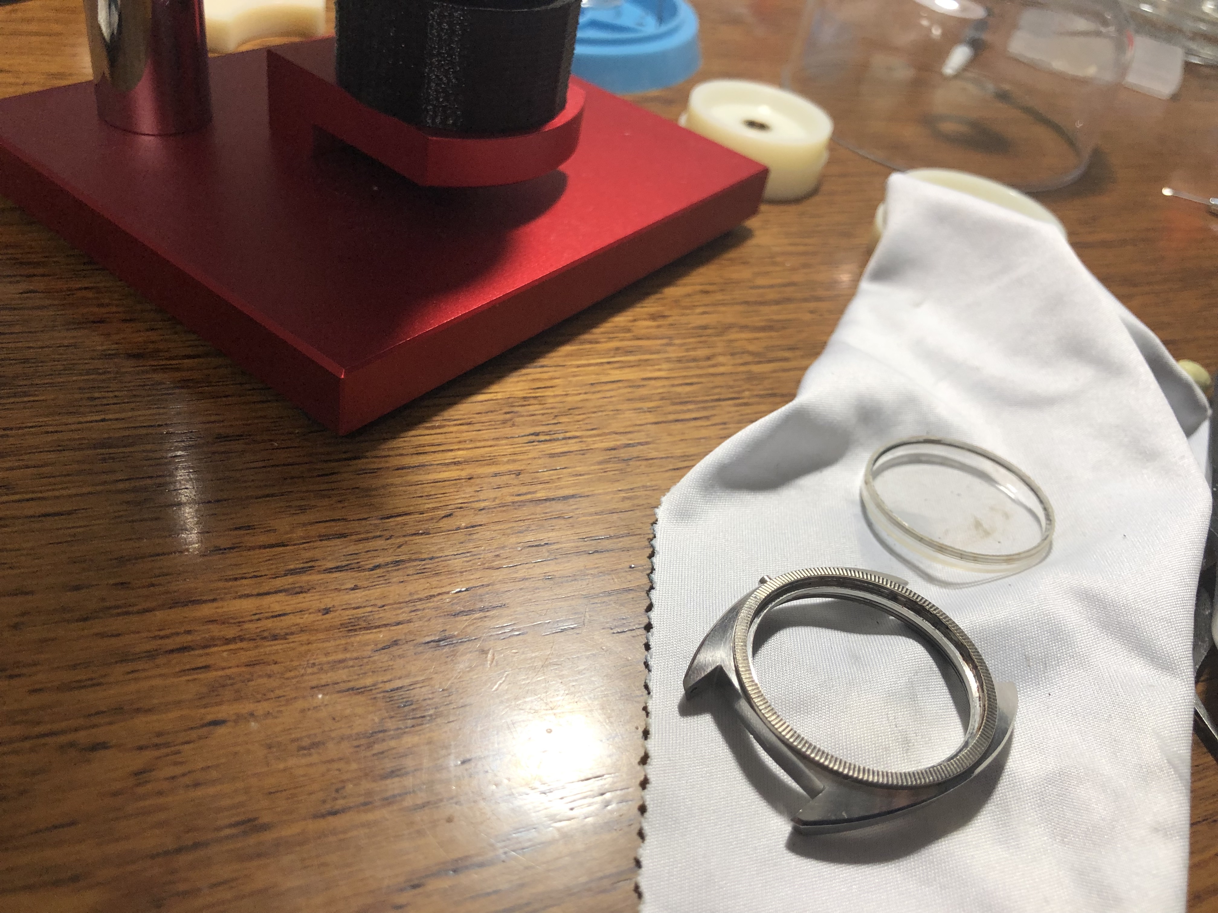

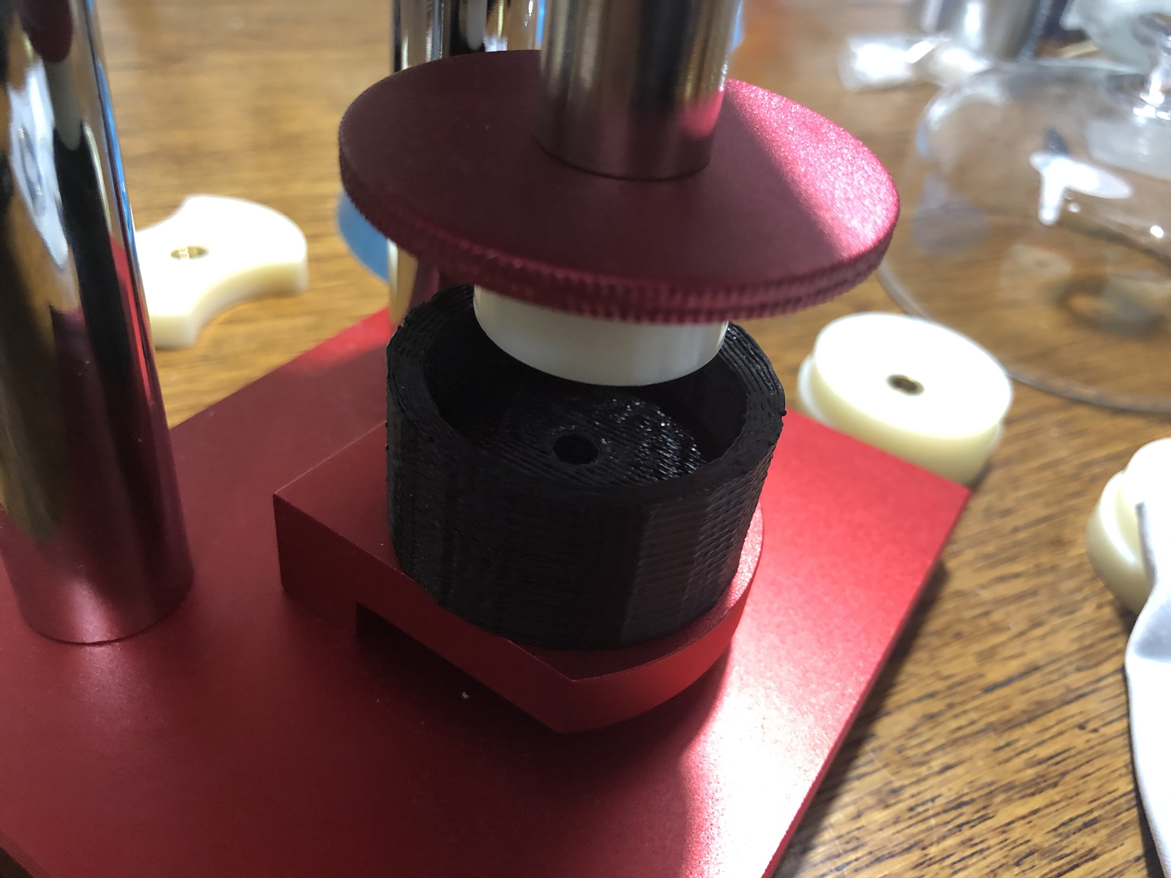

Some bits of amateur information that might help those who look for parts in the future
Crystals
Our crystals are 29.6mm in outer width, 297 / 29.7mm non-armored generic ones fit, but obviously one should seek 296 / 29.6mm armored / ringed / gilted ones with domes as high as possible - especially day/date movements have slightly higher sitting hands, so they are the most challenging, ironically the most accommodating day/date crystals are cheaper than the shorter date-only crystals when you are buying genuine ones, this is probably because I bought all the cheap/short ones on eBay and those that listed afterwards just reference the highest price later on 😀 TL;DR: Hard to find aftermarket crystals that are both ringed, really high domed and 29.6mm - this seems to be why 29.7mm non-armored ones seem to be used which is probably less water resistant
The crystal ring is part of the look, sometimes crystals have this very ugly staining on the edges, it's usually because rust dyed into the crystal, it can't be removed easily, but replacing the crystal gets rid of it

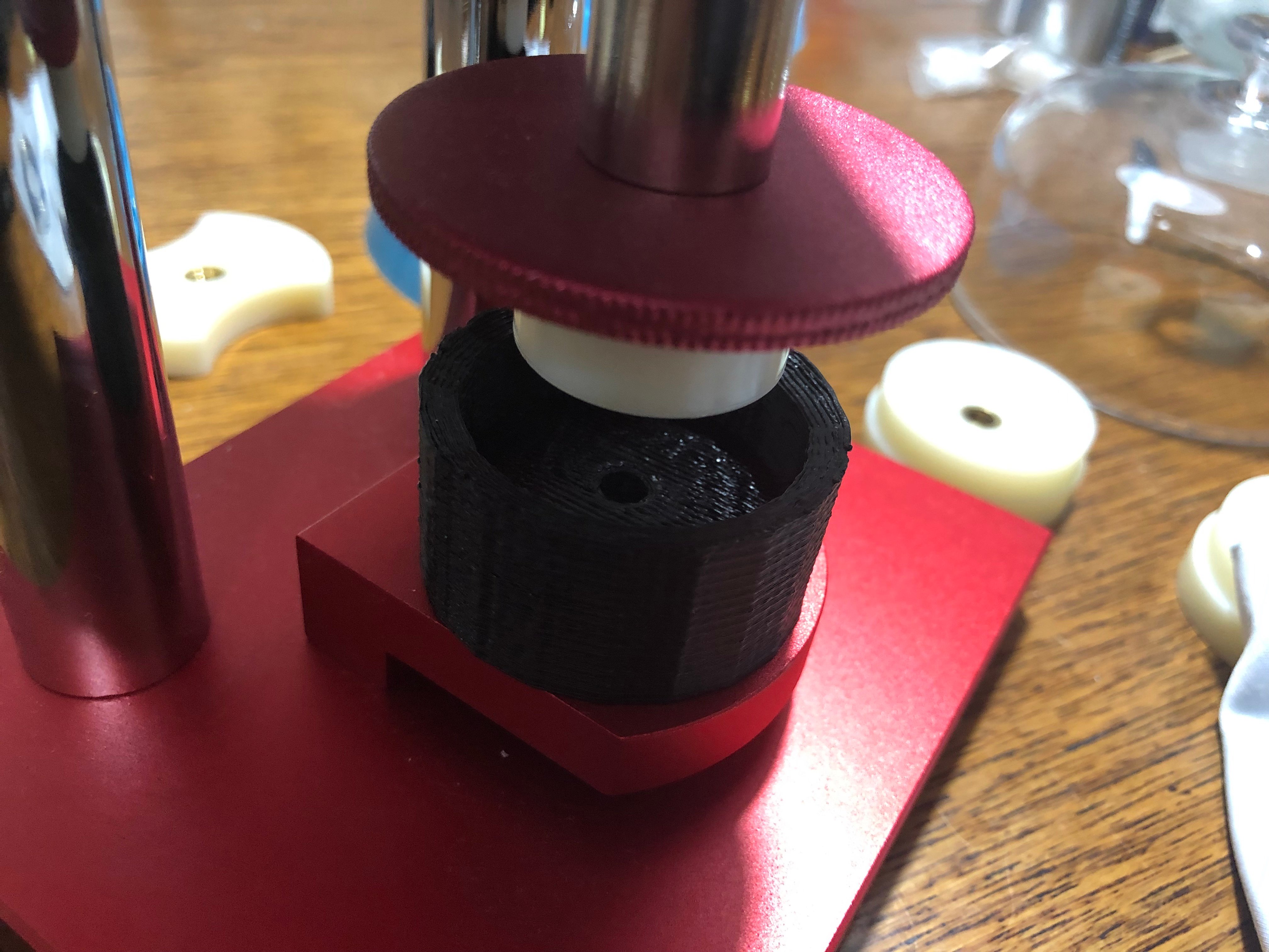

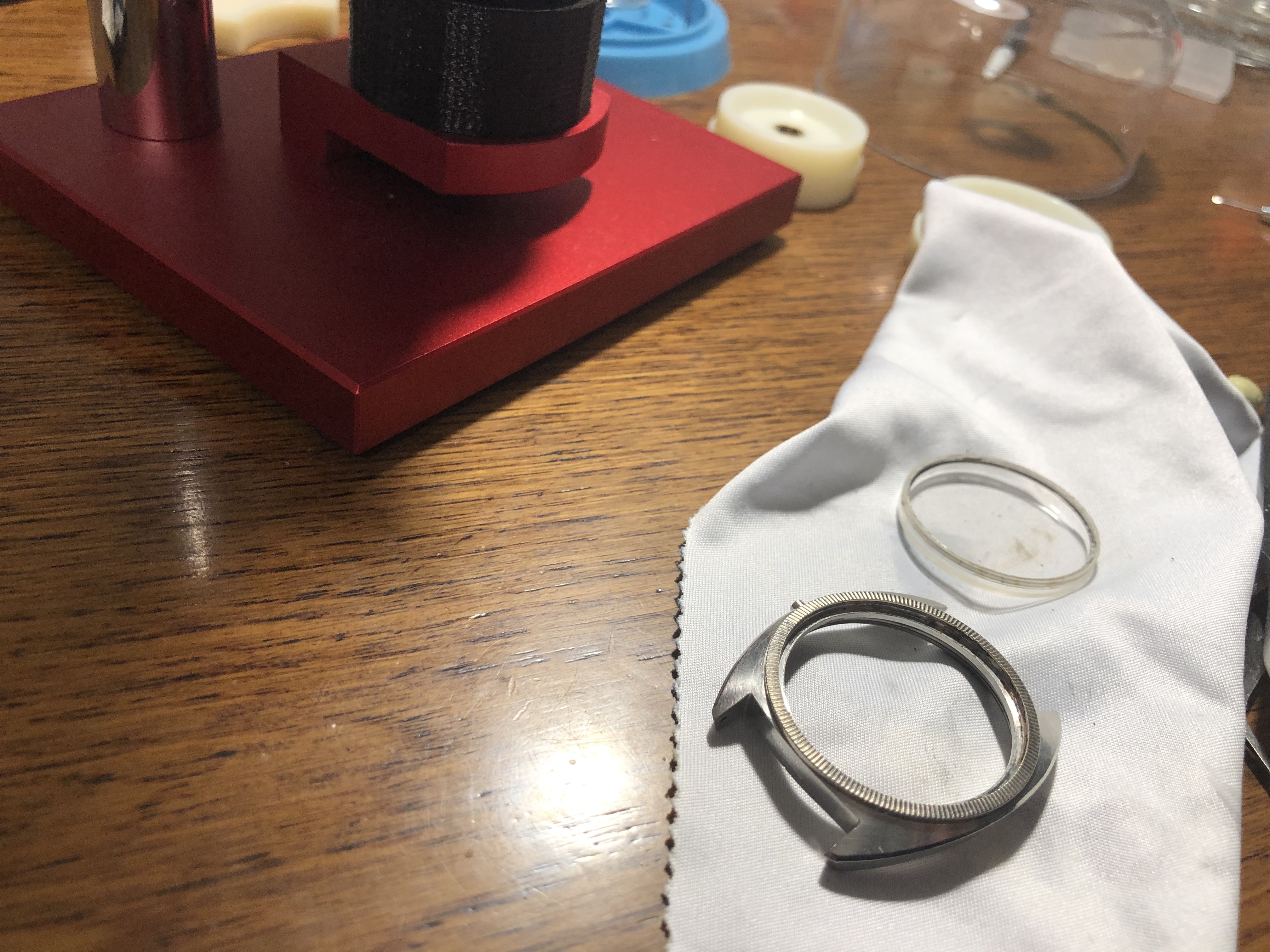

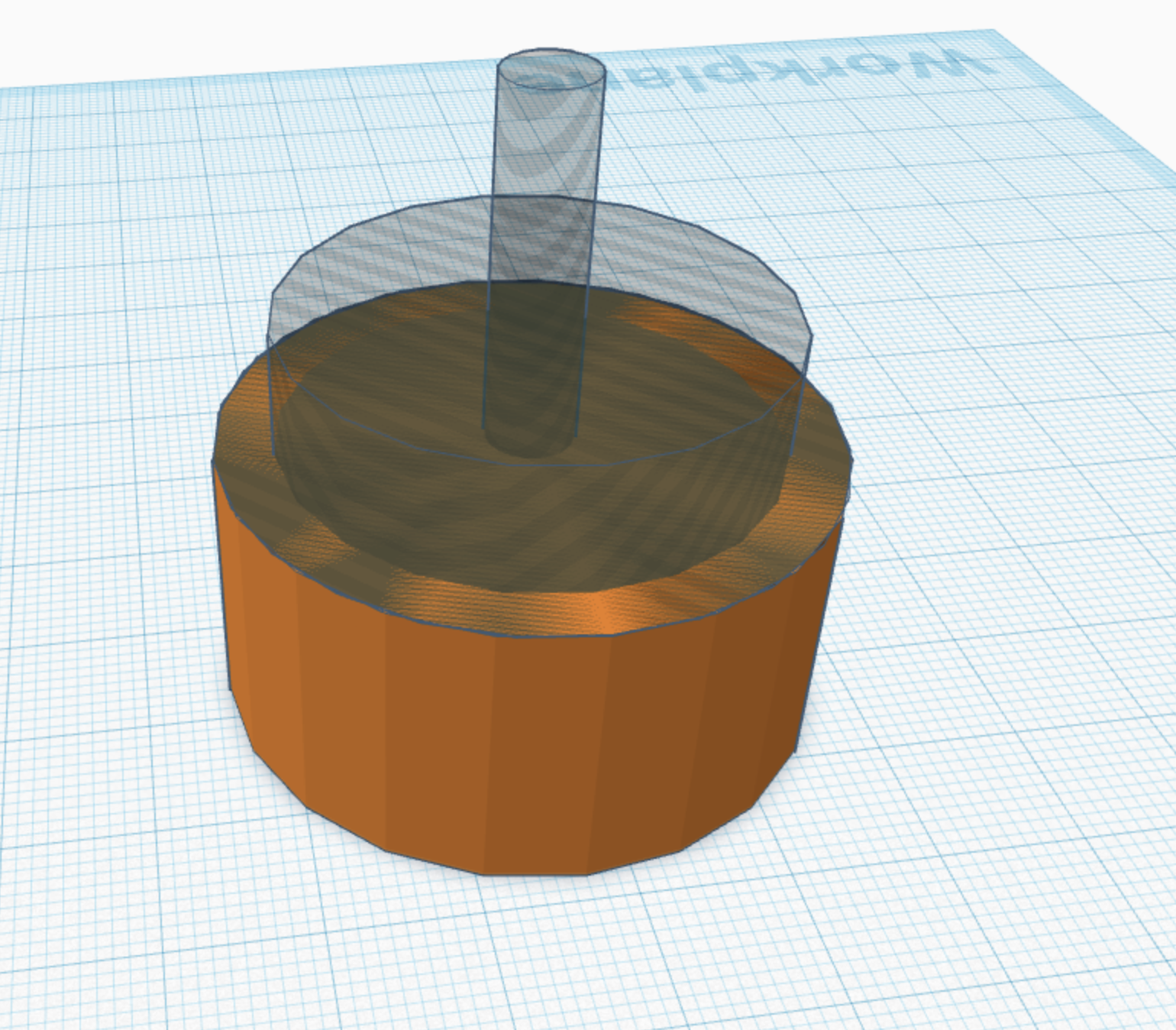

I'm sharing my crystal press case holder design, it's specifically for C-Case Constellations 168.0**'s - since the domes are super high you need a lot of space, with this tool the plastic presses on the case rather than the gold/steel bezel and there's much space for the crystal to freely fall
https://www.tinkercad.com/things/2CmxTsrGif2-cool-trug-jofo
Removing is easy and seems safe, could be done even for a good cleaning, which will probably reduce water resistance by removing the gunk that formed to make a seal. Pressing it back is obviously more challenging, I'd say it's risk free if the stem barrel isn't in the way as most watches don't have it in the way. If it's in the way you can't get inside the case with a peg, as it will be pressing on that stem tube, you'll need to press on the caseback, so a bit more challenging to get a good fit for a safe press

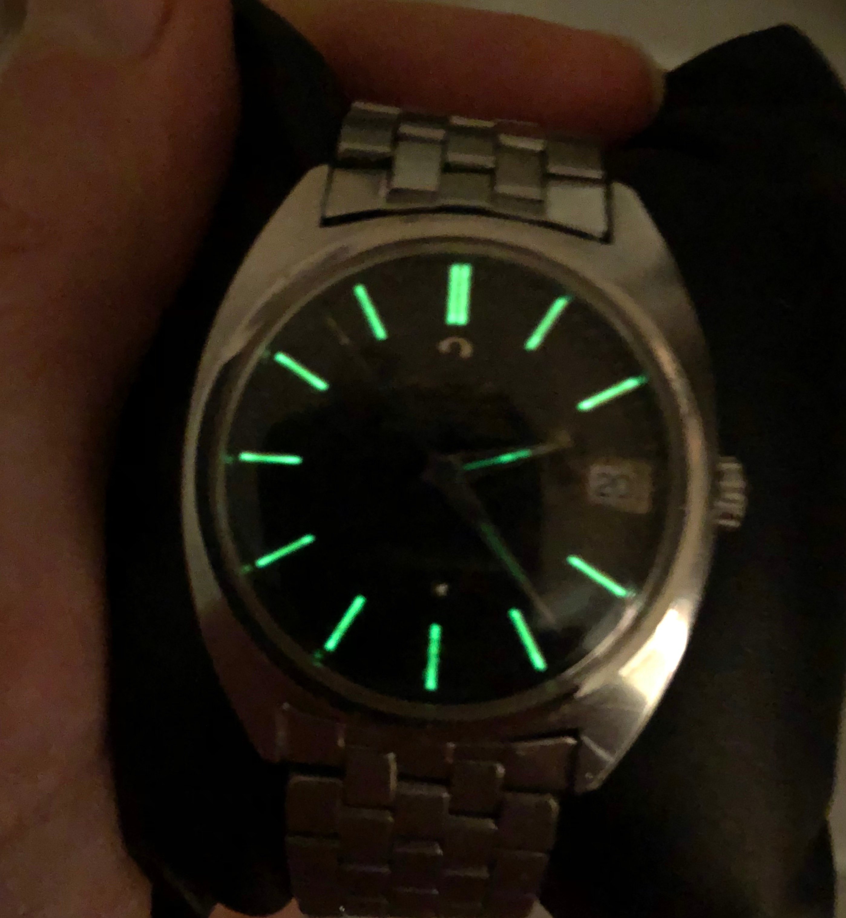

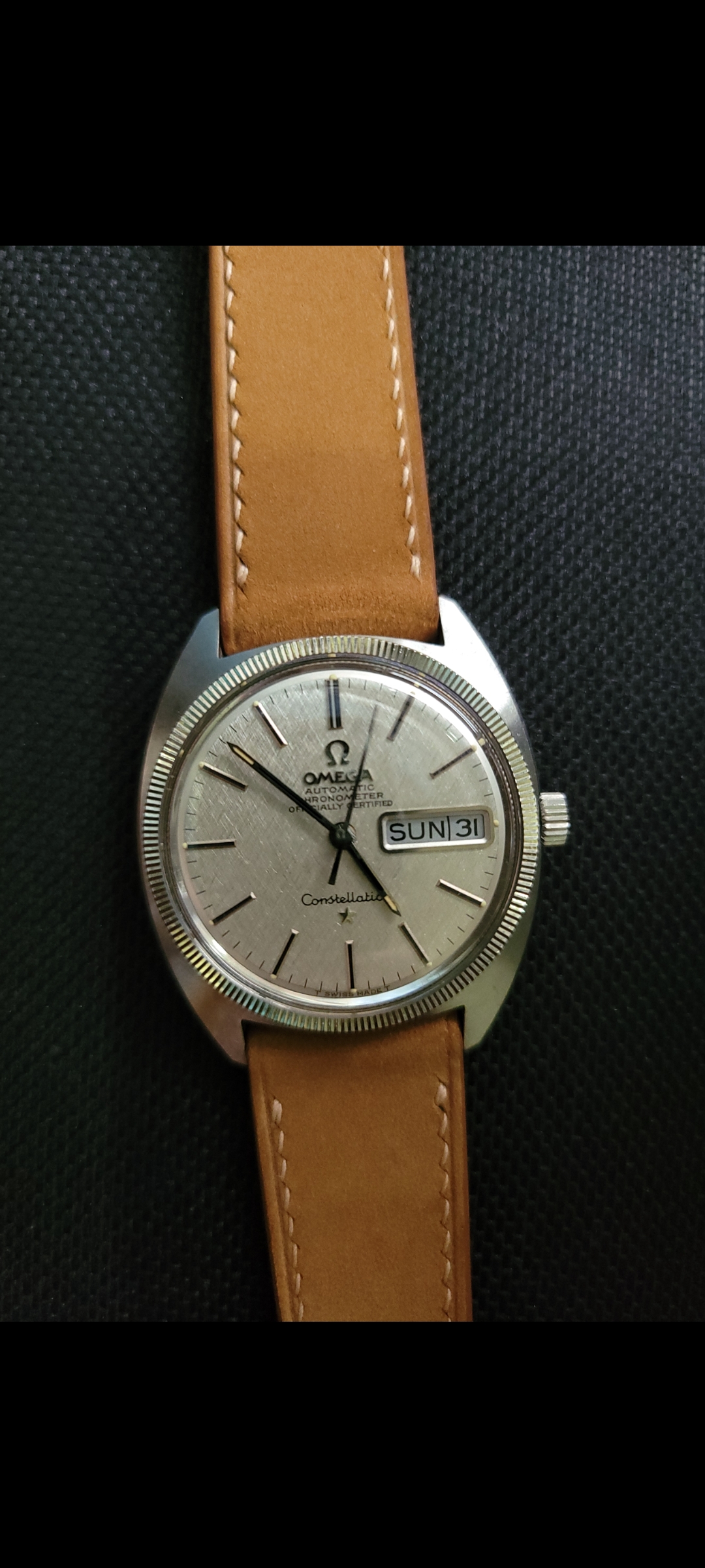

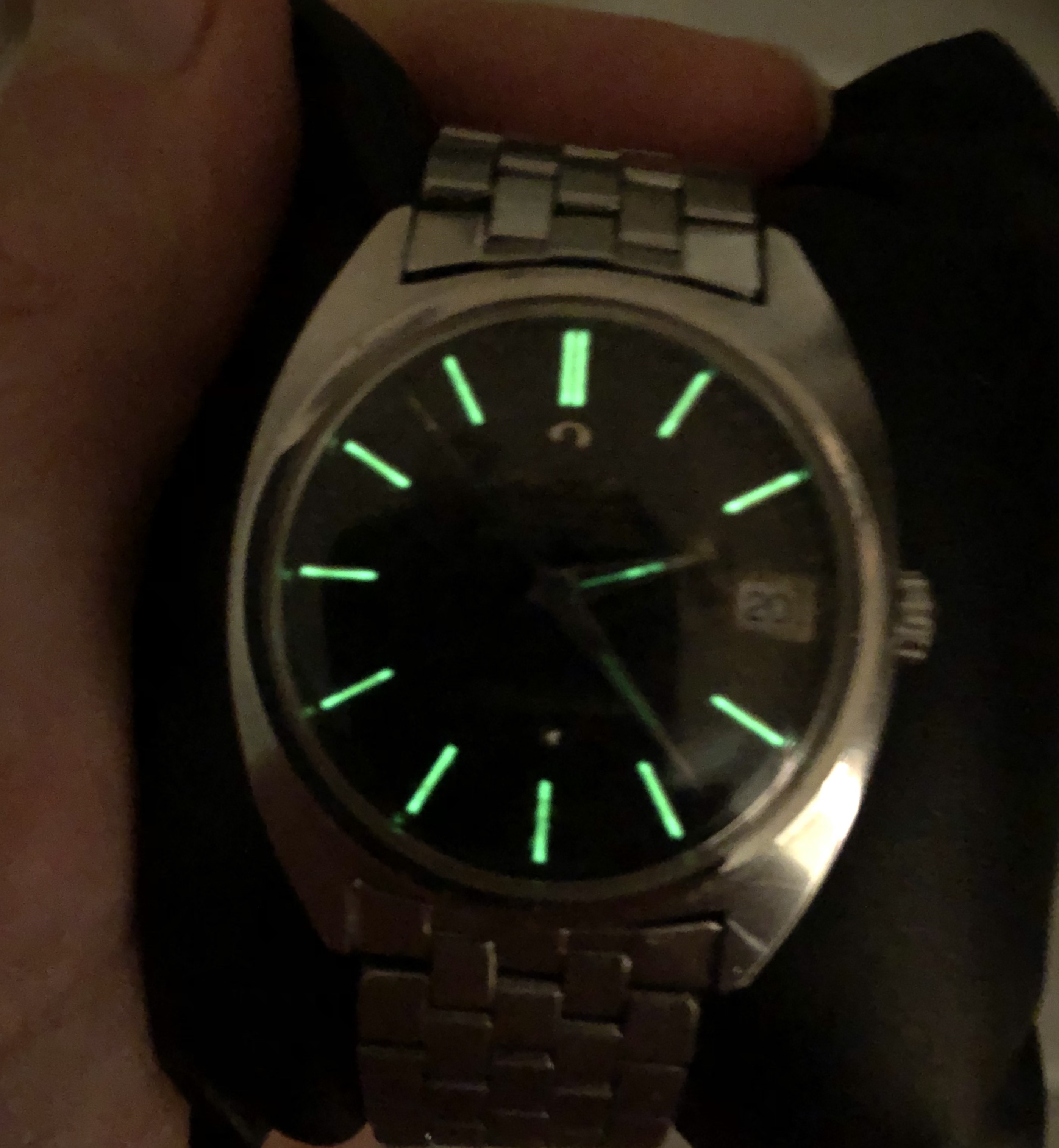

Took this lumeshot yesterday, had no idea these things still worked, or tritium absorbed light, I thought it just emitted light on it's own until it faded away - it only lasts for 2-3 seconds though after you charge it with light

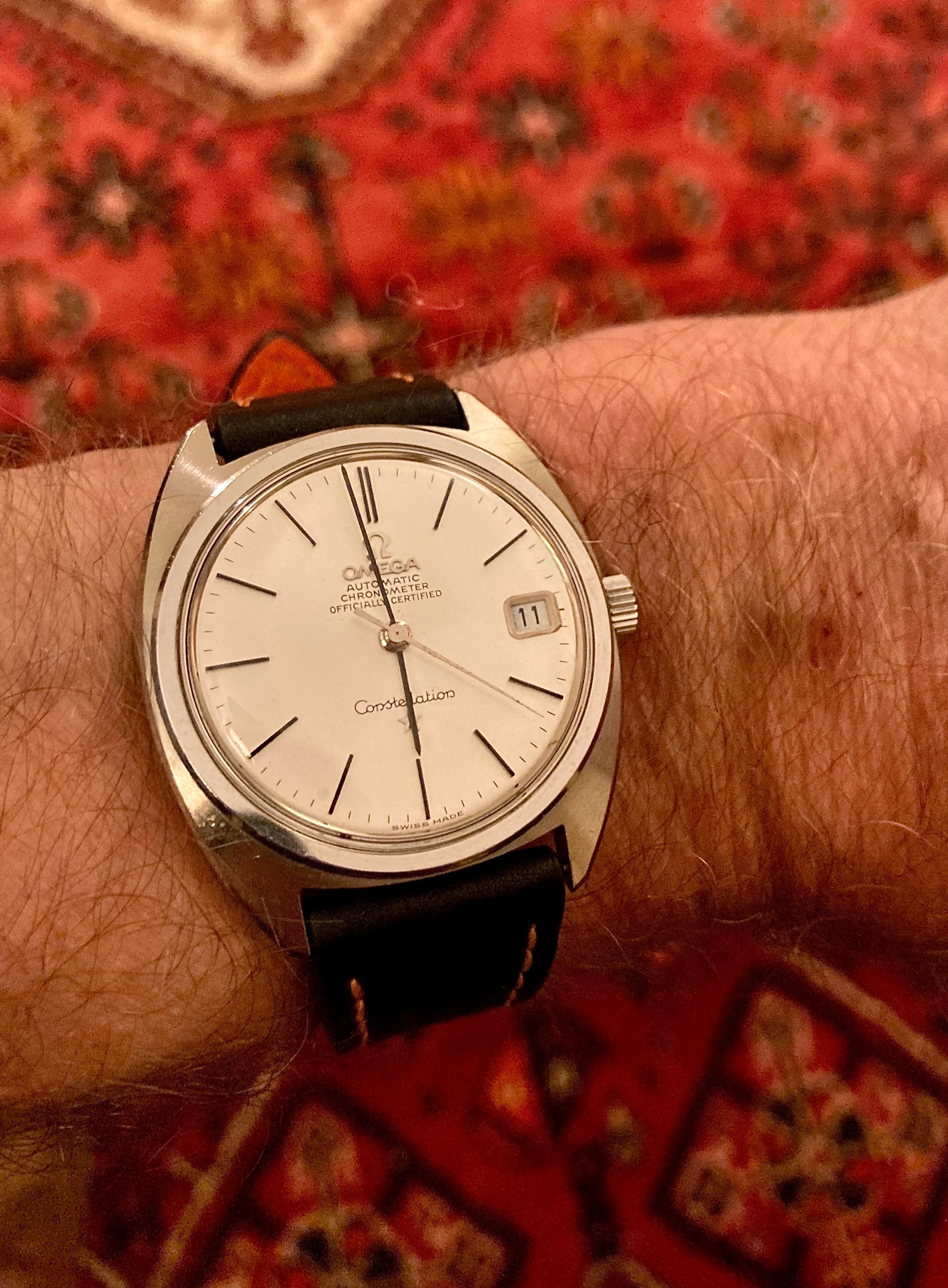

I’ve done my best to match up the inside of the strap with my carpet - as you do 🤨

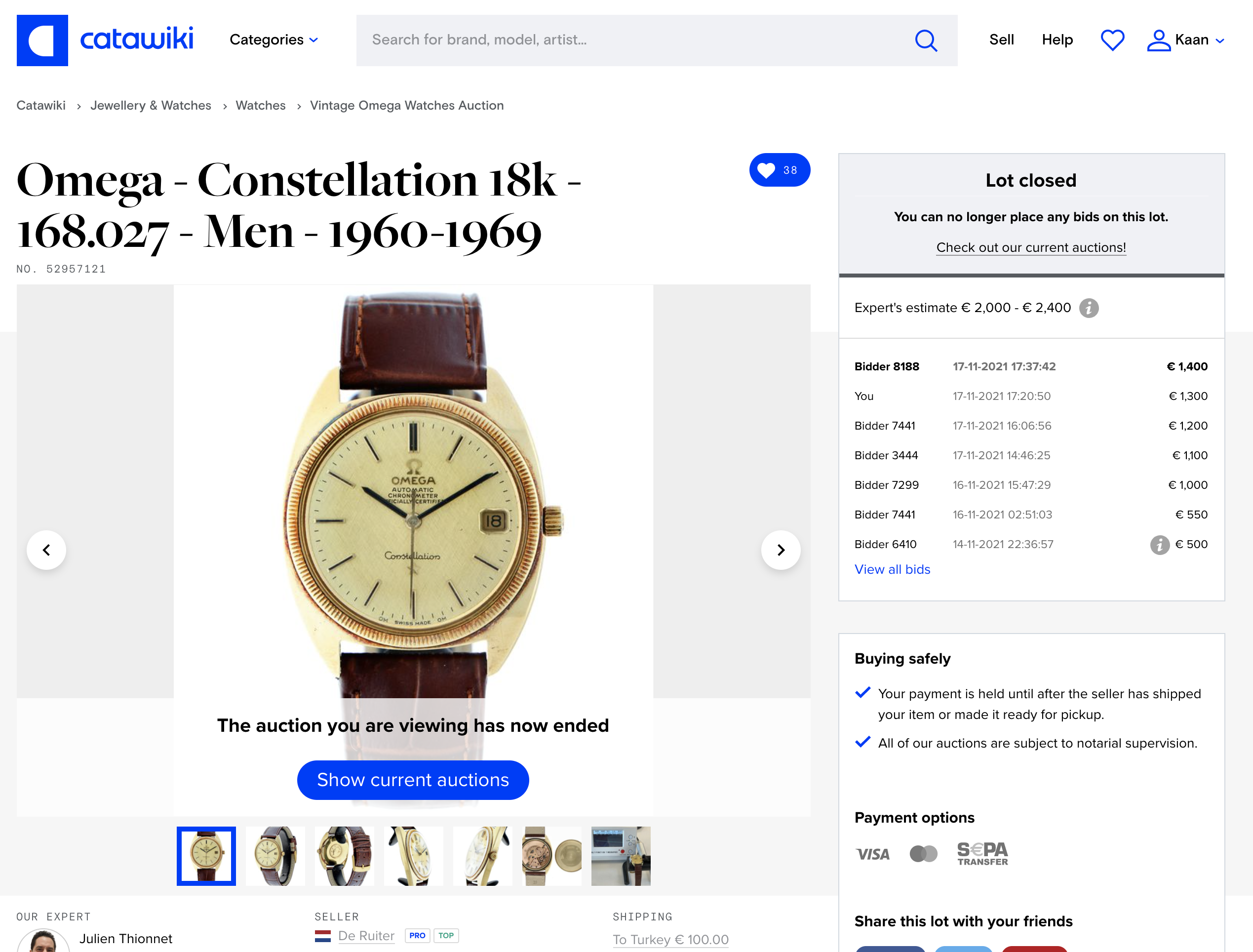

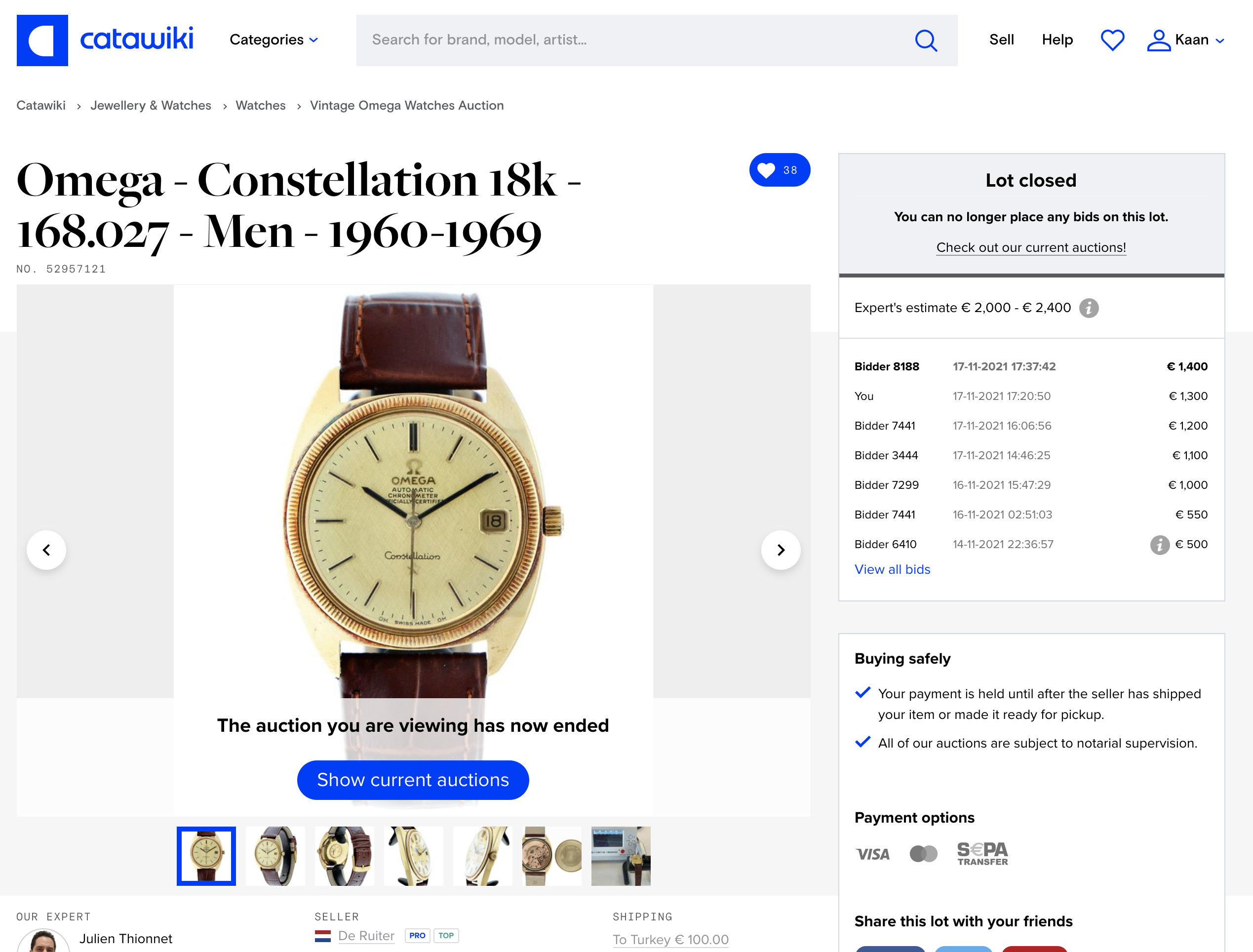

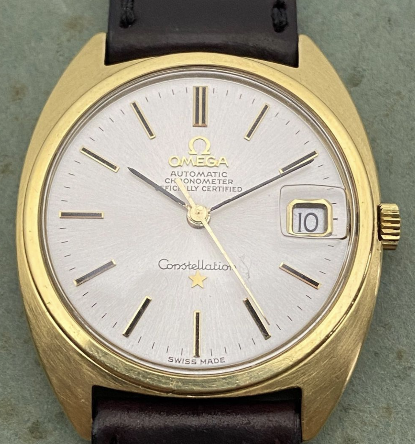

If the seller wonders why this happened, Catawiki was asking to reserve 1000 euros even though I was previously verified when I tried to bid 1400 so I decided to let it go, I guess this is a record low for 18K C-Case's
Also their filtering system is messed up, it wasn't working a while ago, and when a reserve is hit, it doesn't appear under "No Reserve" query, it should
Lucky buyer and unlucky seller 😀
