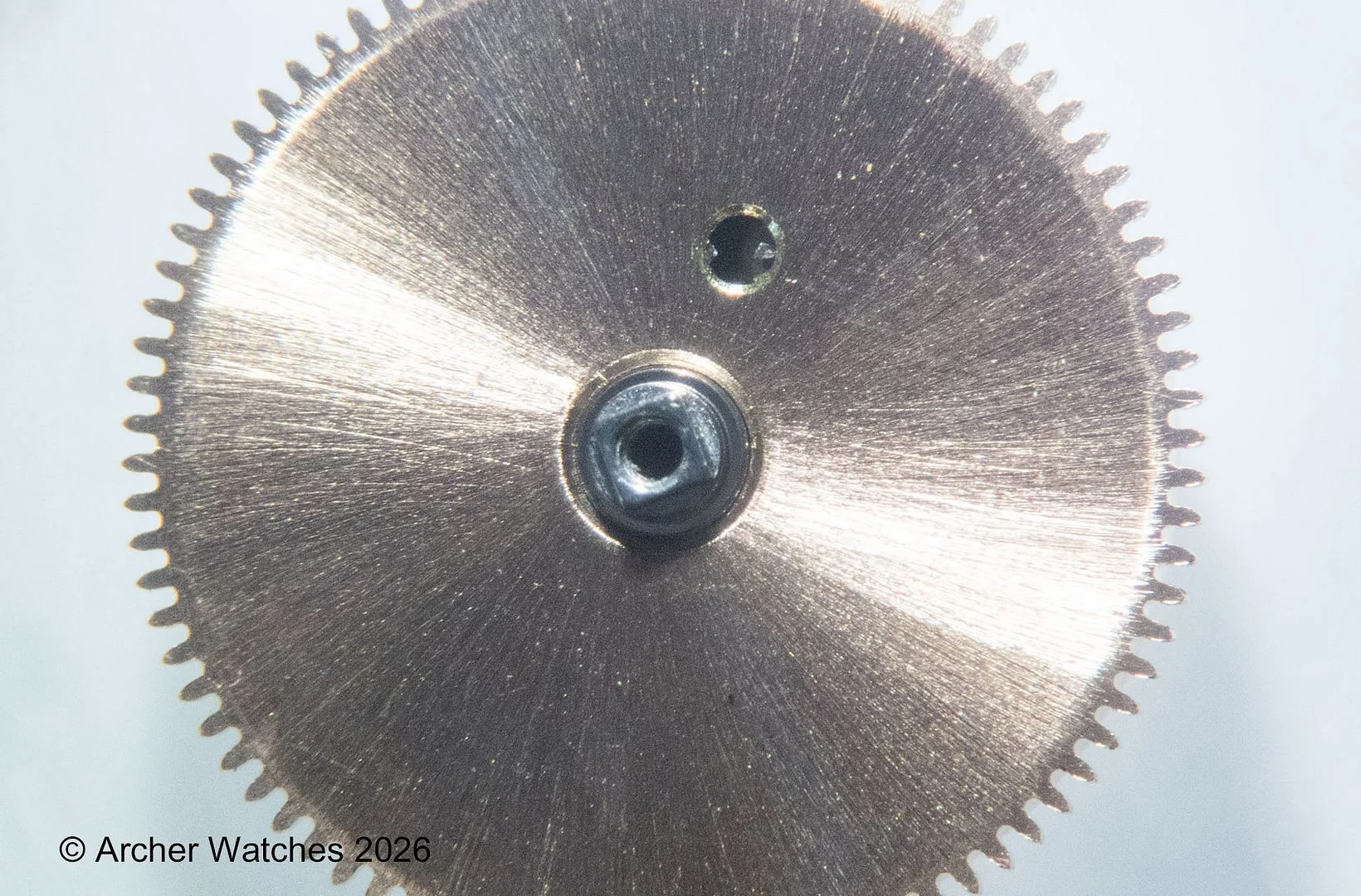

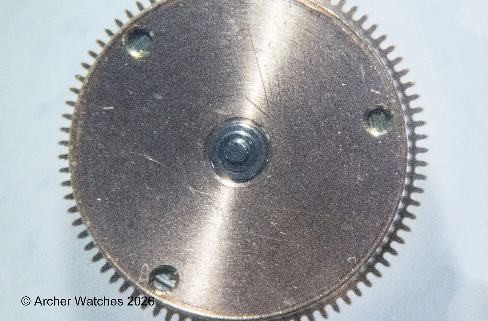

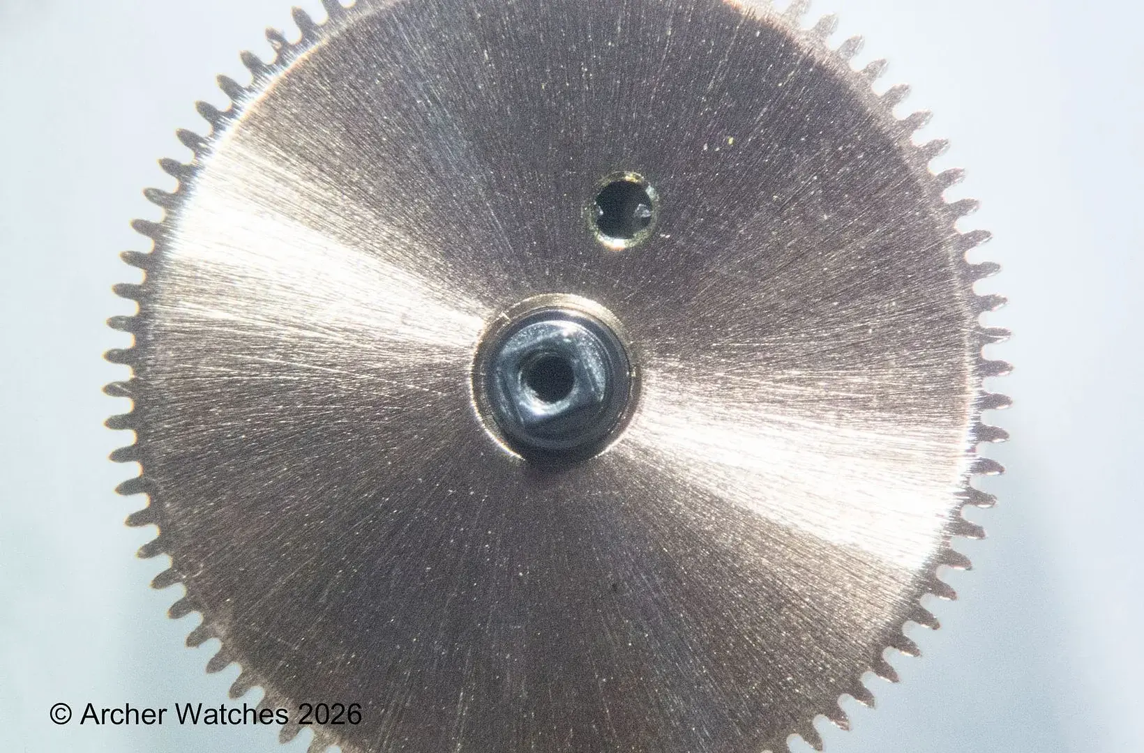

I see a lot of very bad work done by other watchmakers, but sometimes things I see are quite puzzling in addition to being bad. They often involve bad repairs that take more work to accomplish than the proper repair would take, but then again sometimes they are just strange and seem to have no real purpose. Here's an example from a watch that came in recently with a 550 series Omega movement inside. When I removed the barrel, I saw this:

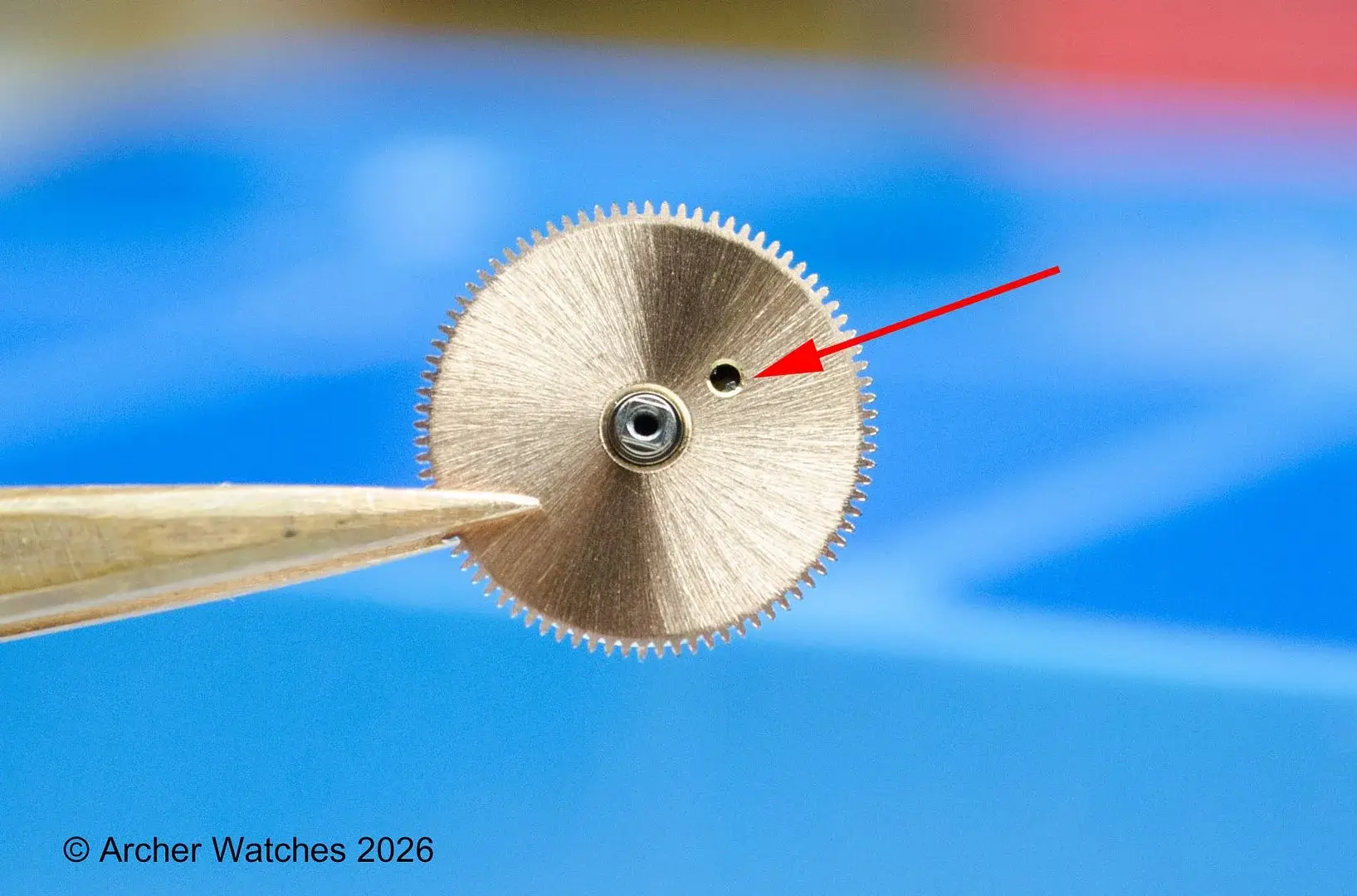

Now, I see a lot of mainspring barrels that are filled with so much oil, that I have often thought a drain plug would be nice, but this is the first I've seen where someone has actually drilled a hole in the barrel. Closer look:
I will say it's nice work - nice clean hole and a good countersink on it. Still have no idea why someone would do this. So the photos above show the barrel drum, but what about the cover?

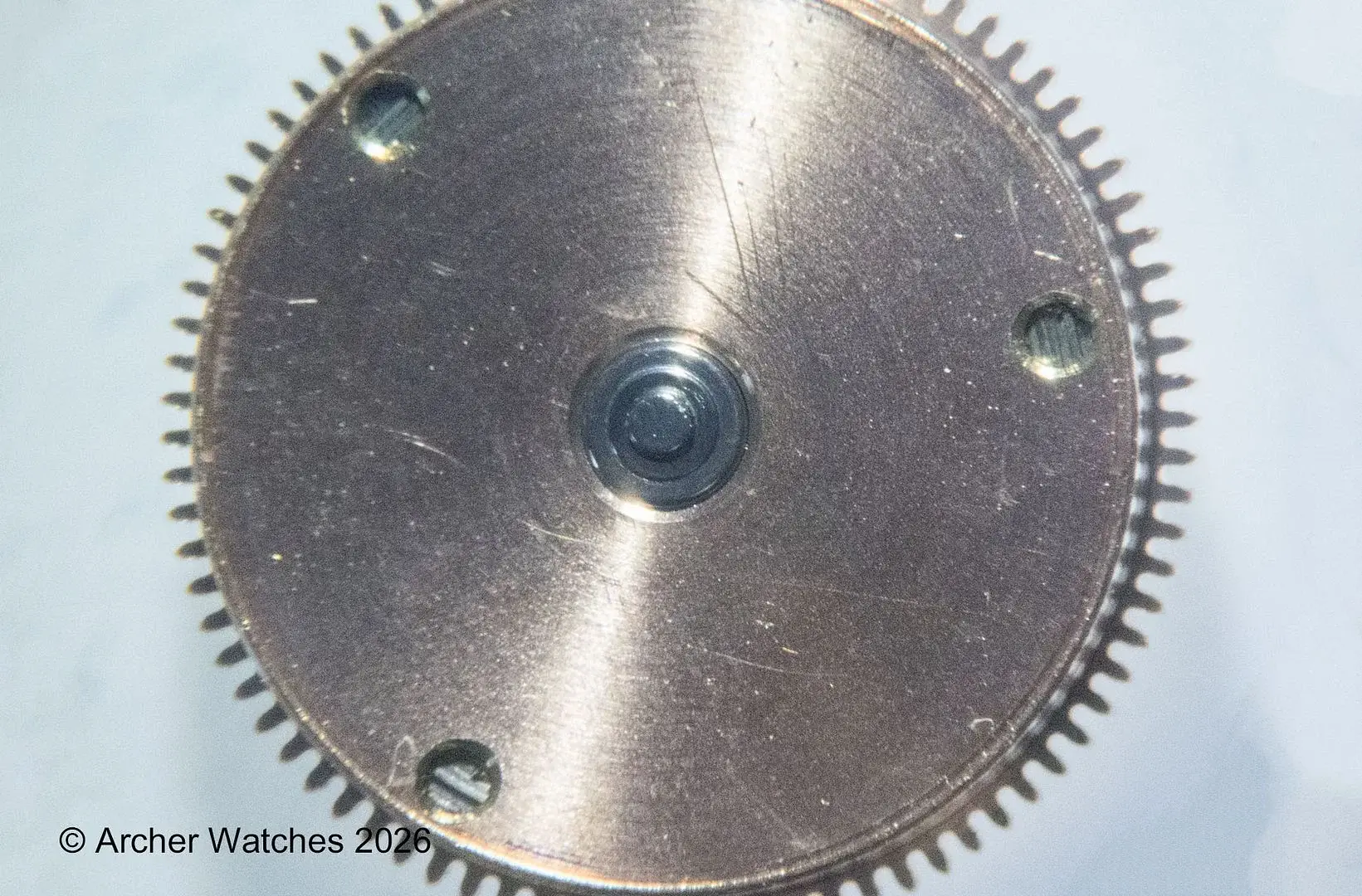

If 1 hole is good, then 3 must be even better! 🤣

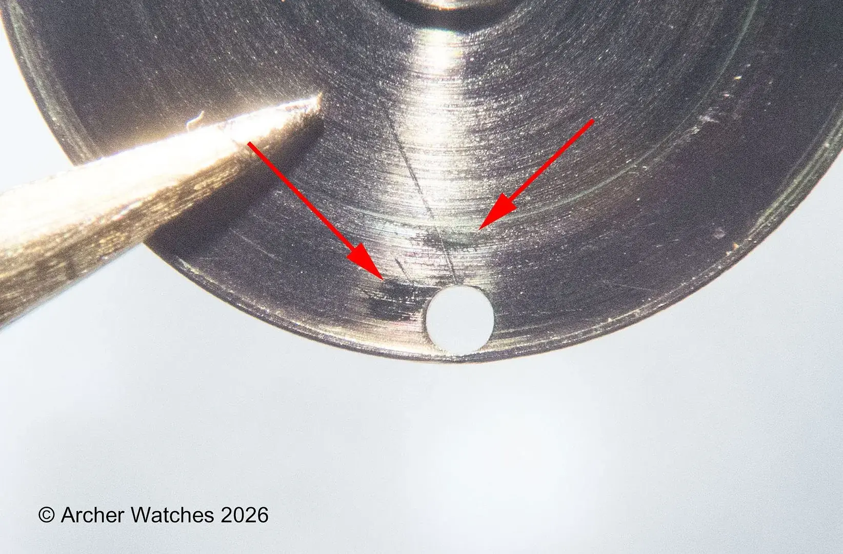

So what are the implications? The wall of the barrel drum is worn out so that had to be replaced anyway, but did this do any actual harm?

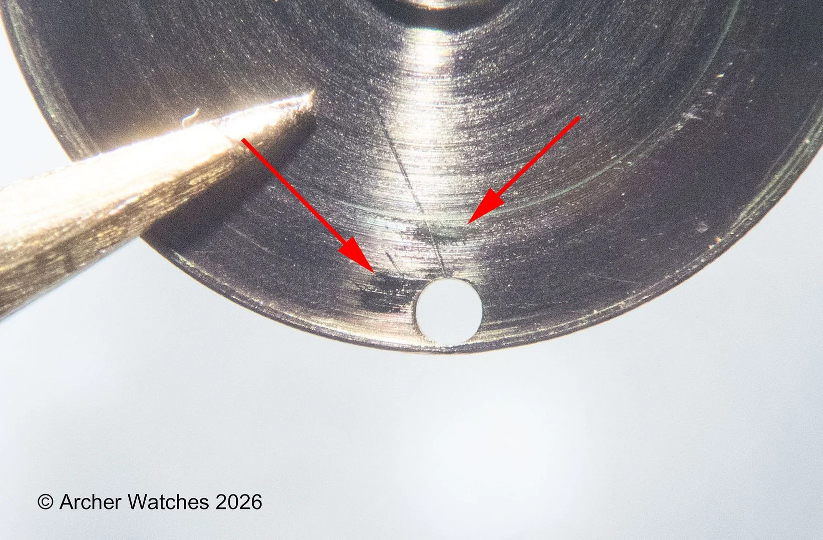

What you can see here in the barrel cover is that it had been deformed enough near the hole that the mainspring has been rubbing on the inside of the cover. This will cause drag, wear, and is generally not good.
Omega used to sell all 4 parts of the barrel separately (mainspring, drum, cover, and arbor), but then started selling the drum, cover, and arbor as a set of 3 parts. But very recently they changed to selling a "barrel complete" so the entire assembly already to go, so that's what will likely go into this watch once I address some other issues.

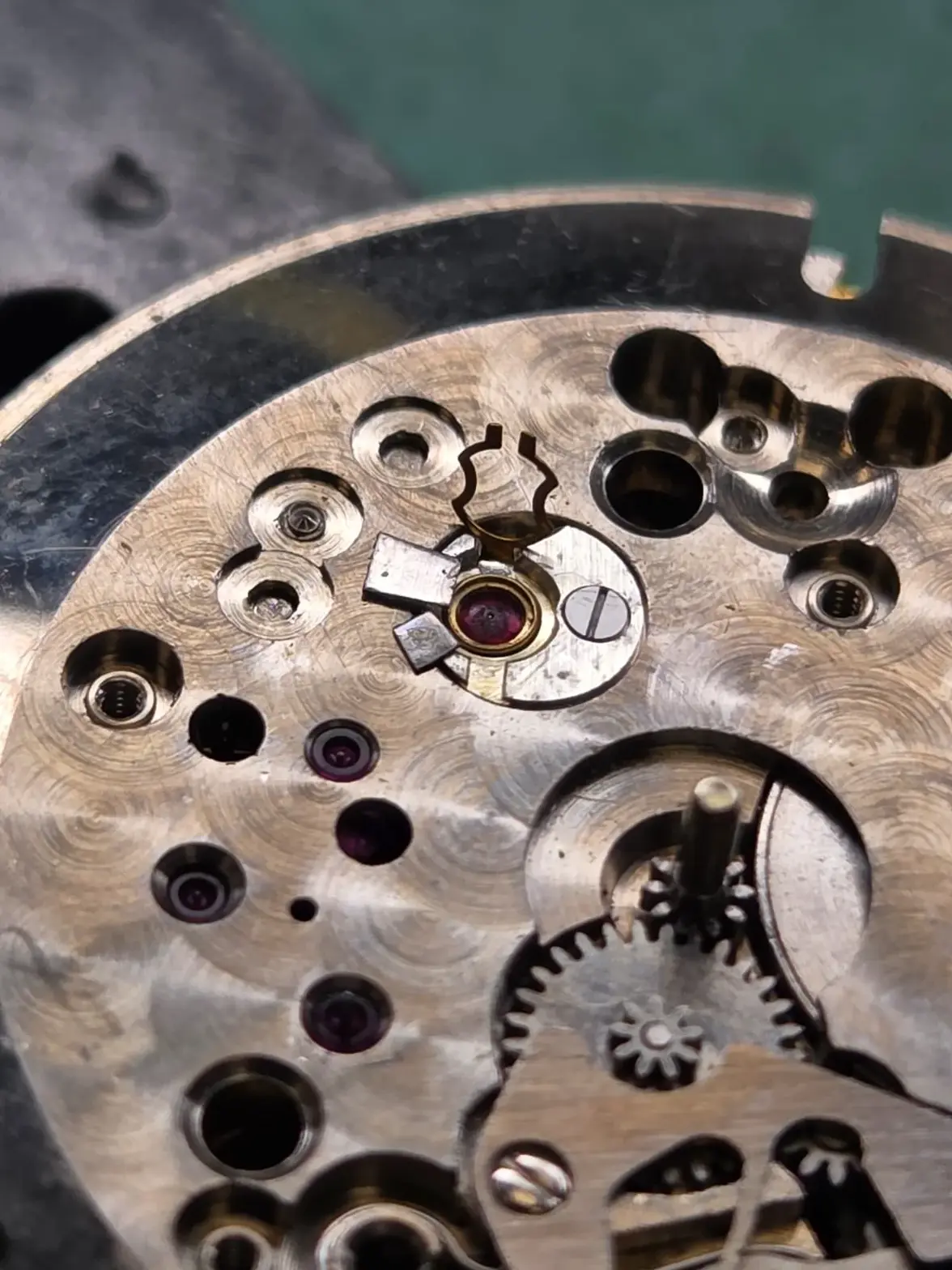

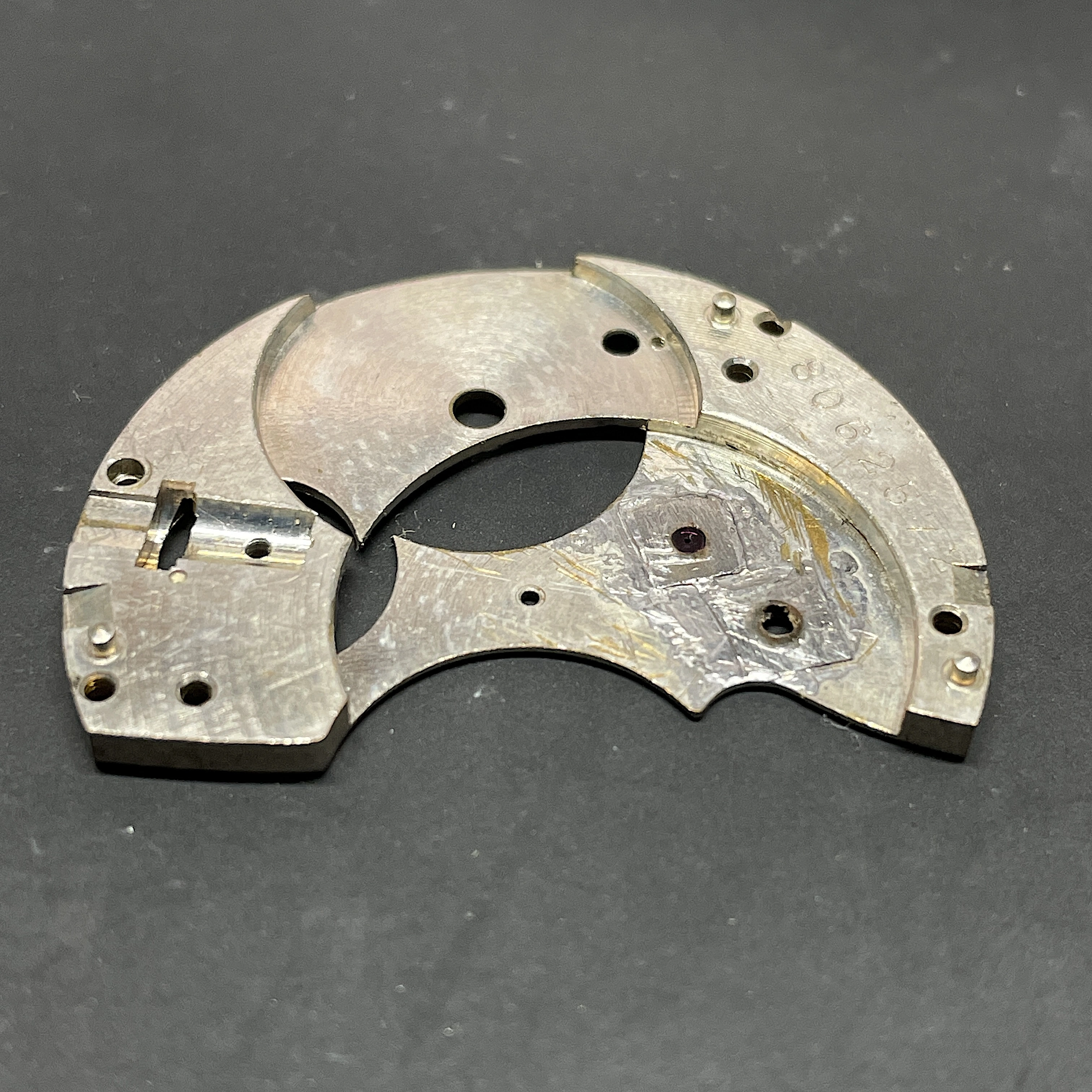

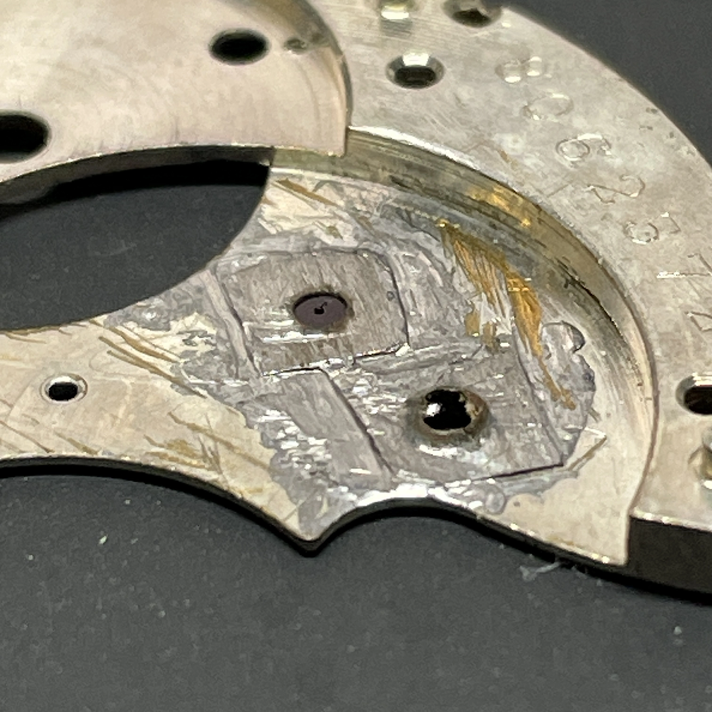

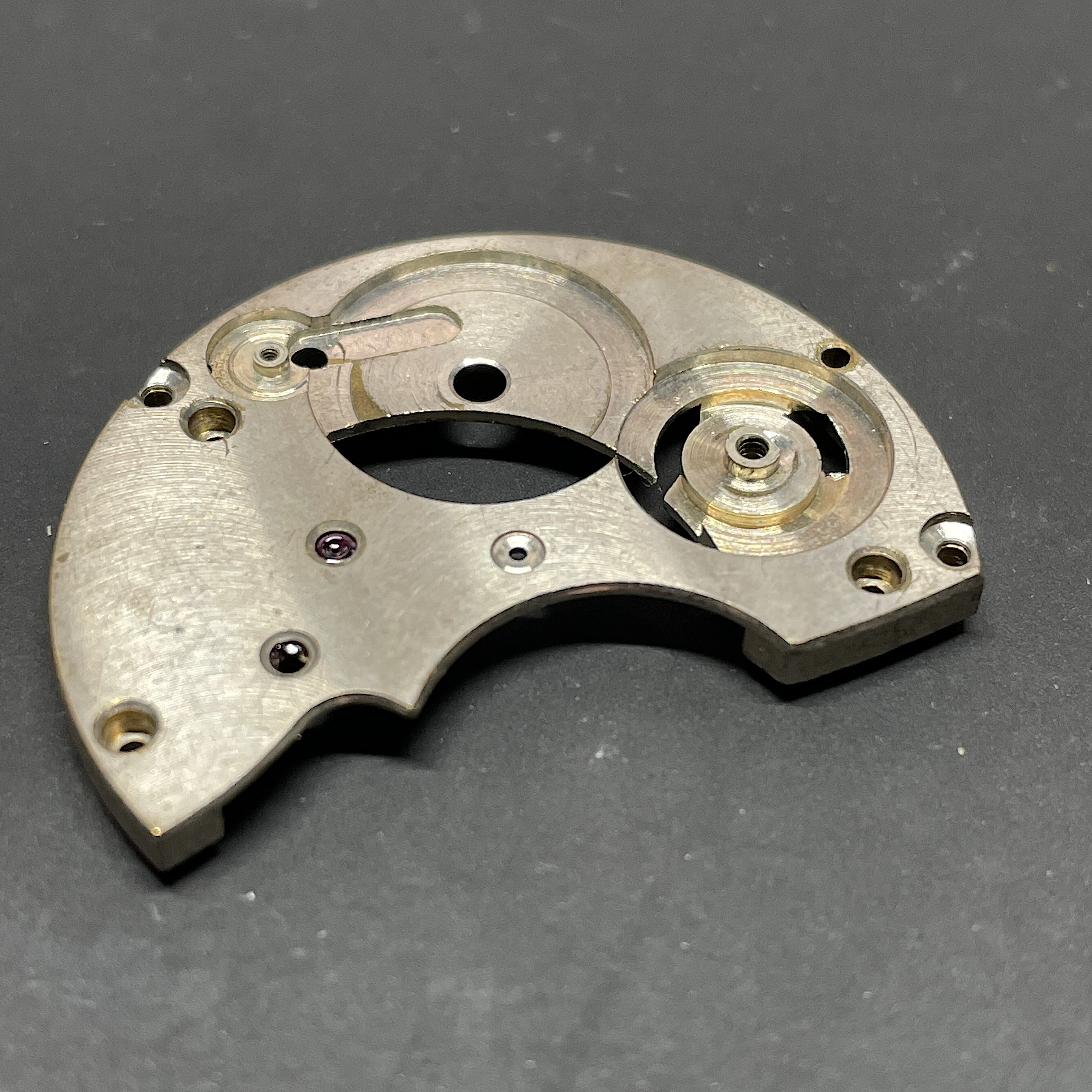

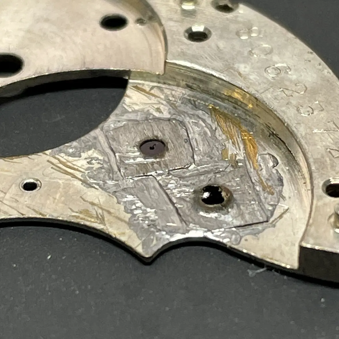

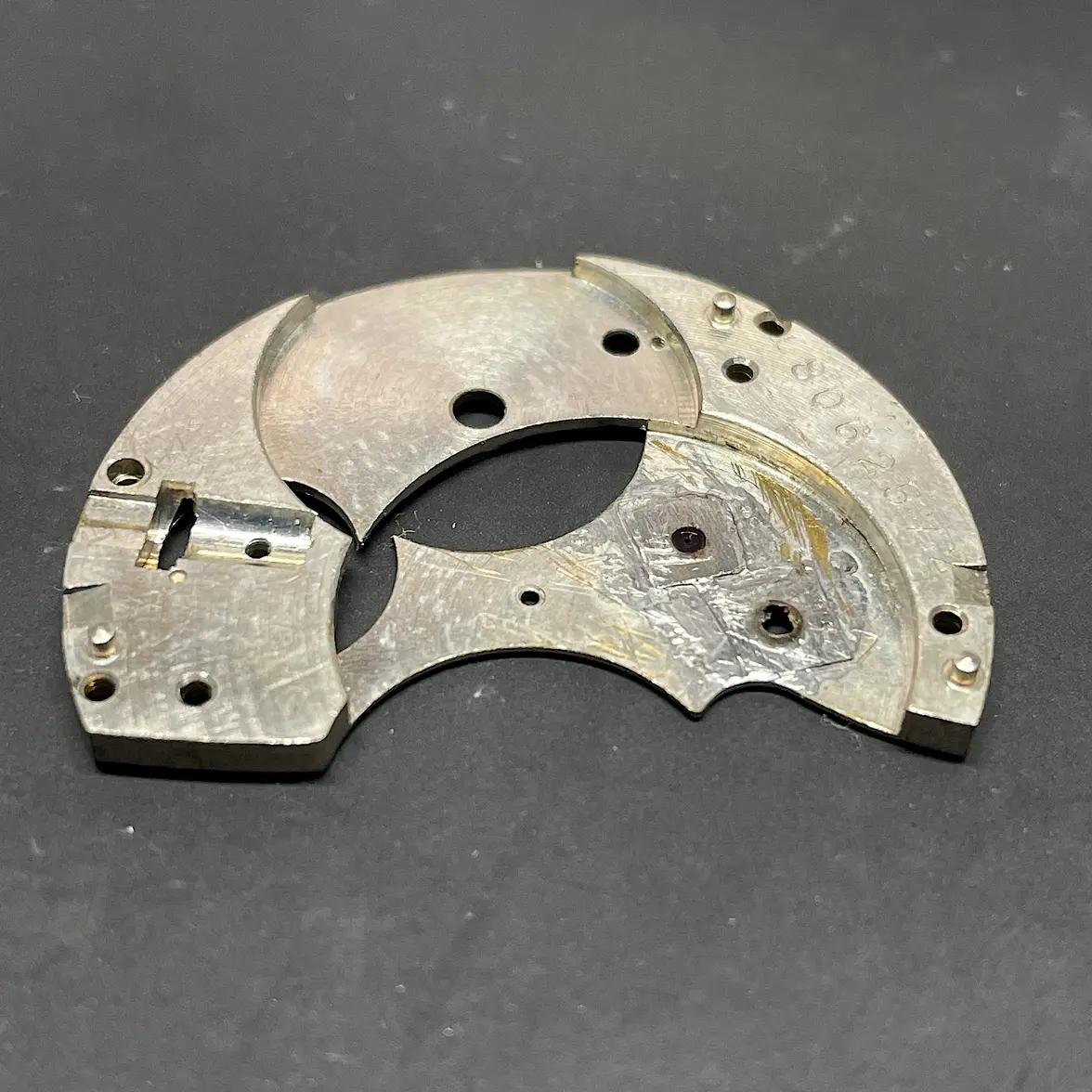

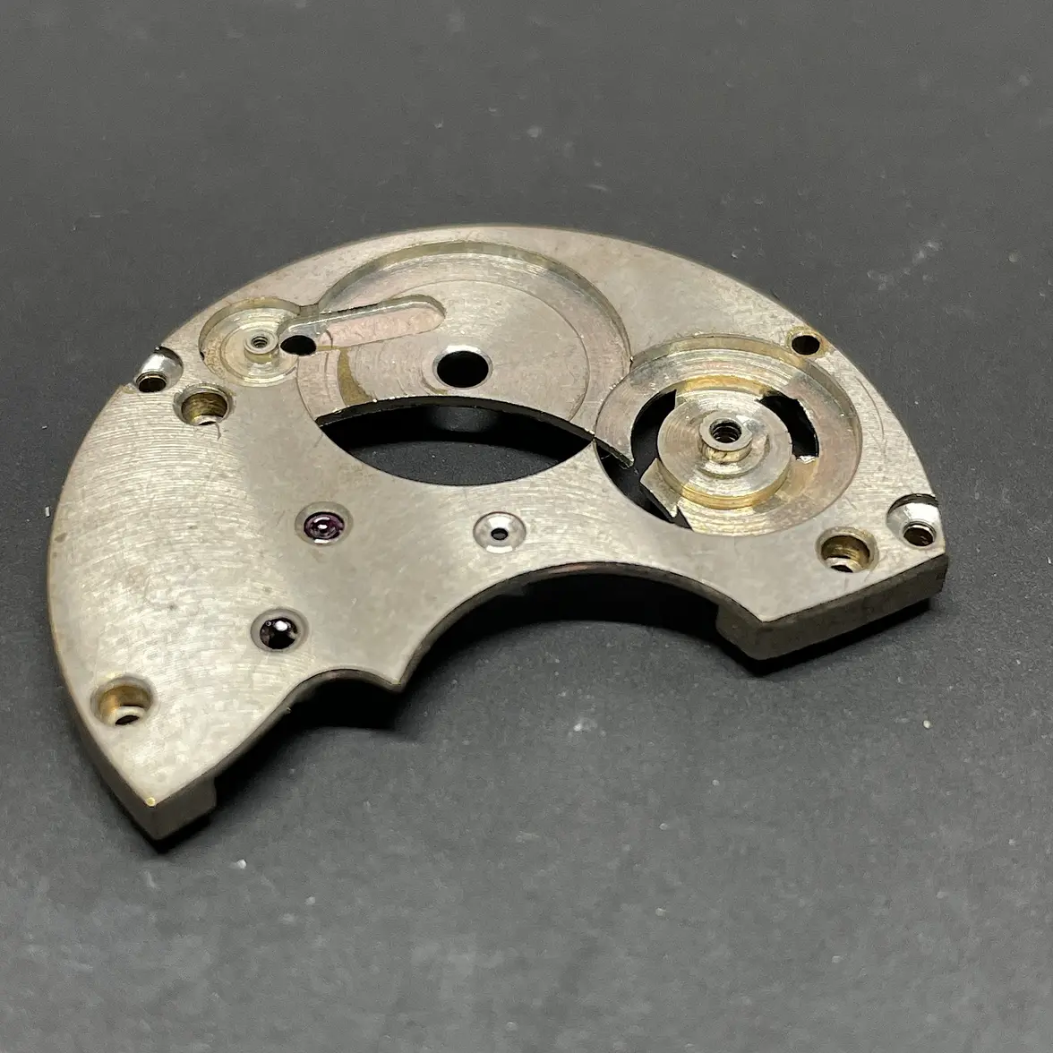

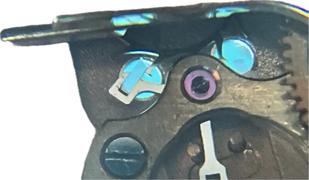

Here's an example I found when I went to restore a vintage Cyma pocket watch.
Barrel bridge looks OK
Uh Oh!
Somebody has been here before.
I quietly put the parts back in the old cigarette box and put it away again.
18,182
37,938
OMG, is that a piece of sheet metal?
As Al noted in the thread, a couple of pieces of shim metal.

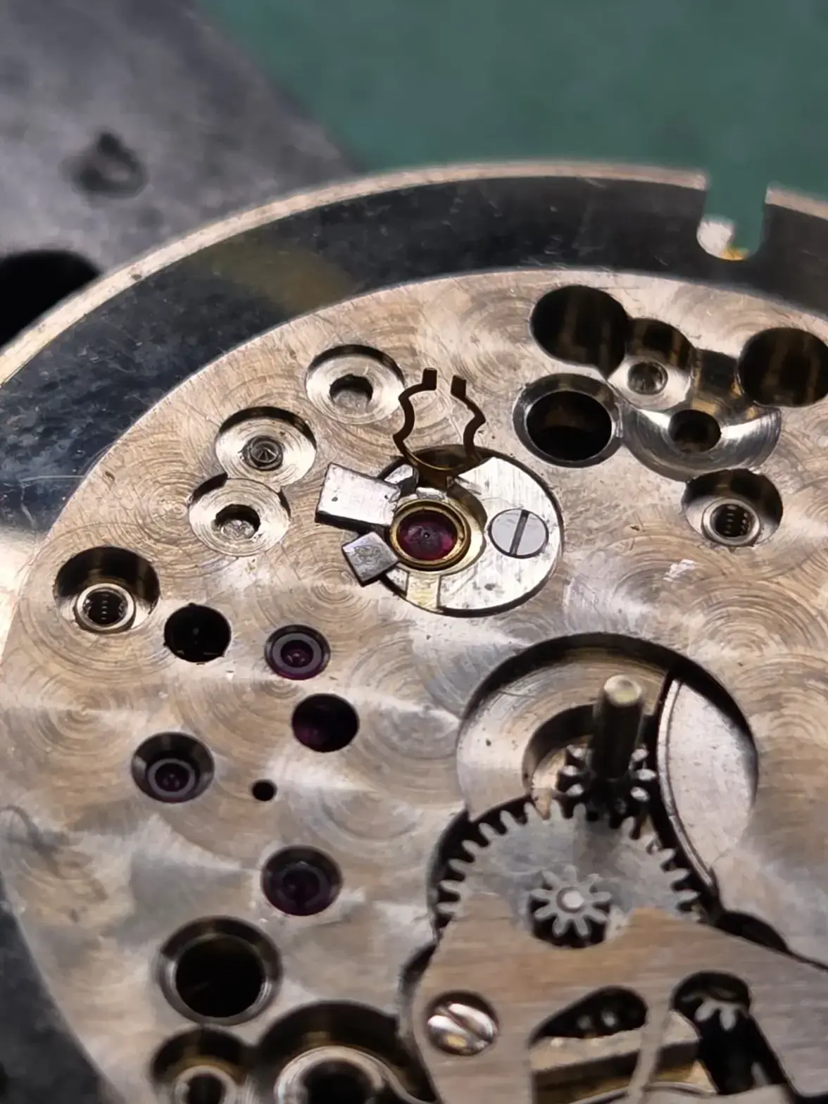

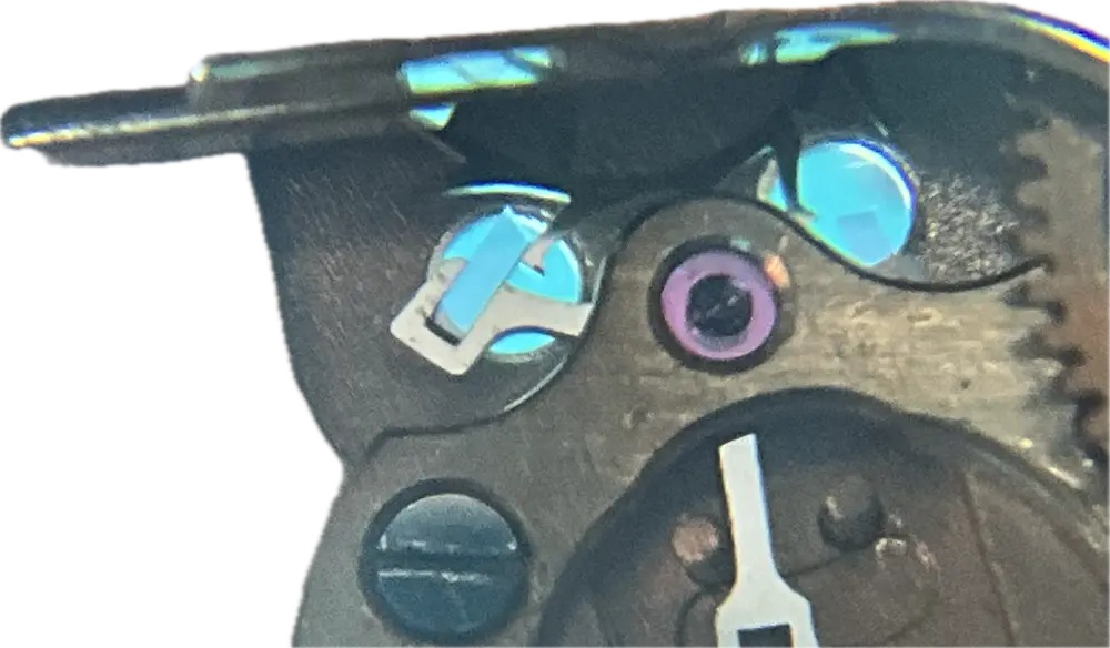

How about this Certina? Searching for dial retainer screws yielded nothing so I started to pry...and pry...and pry. Needless to say, the date was not functioning properly.

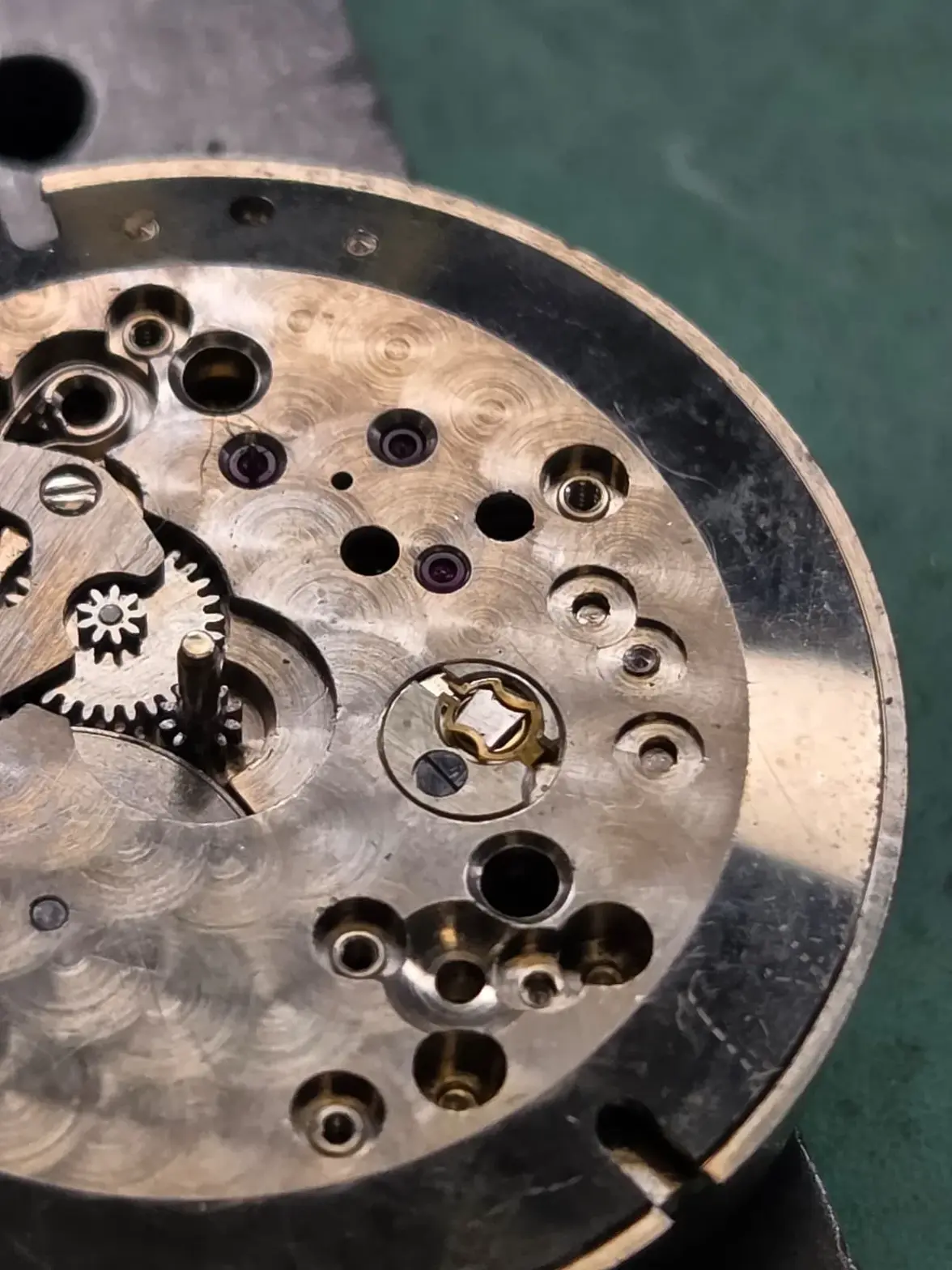

Don’t have photos but one of the Speedmaster Cal 321s I bought as a project watch had broken dial feet and had been glued down, not the first time I’ve seen that but my watchmaker had trouble getting it off and said it was held on with rubber.
With some heat and cutting he separated it and I was able to help him identify it was three small blobs of Sikaflex. I’ve used it myself on automotive trim but I never knew it was a watchmaking staple.

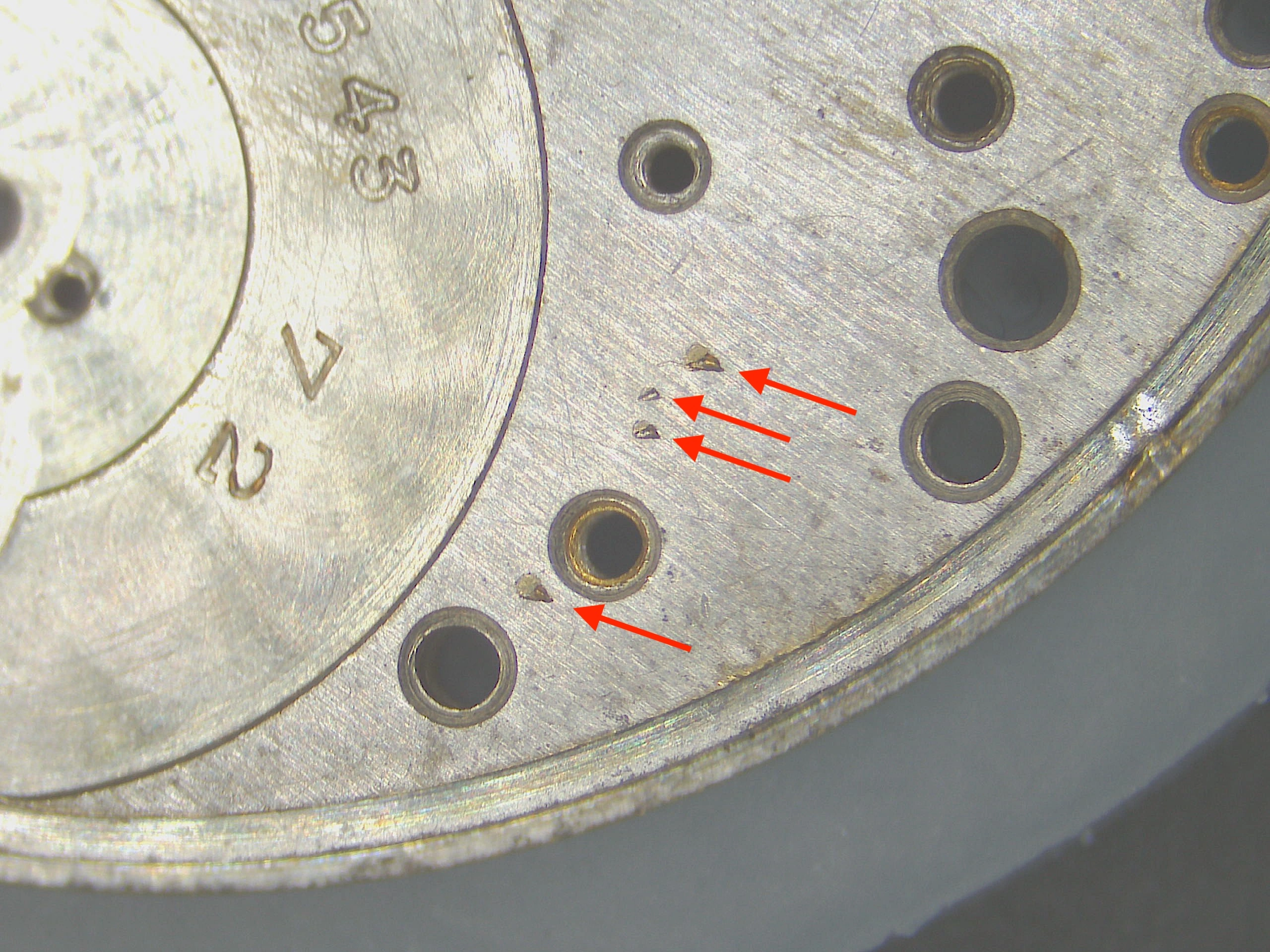

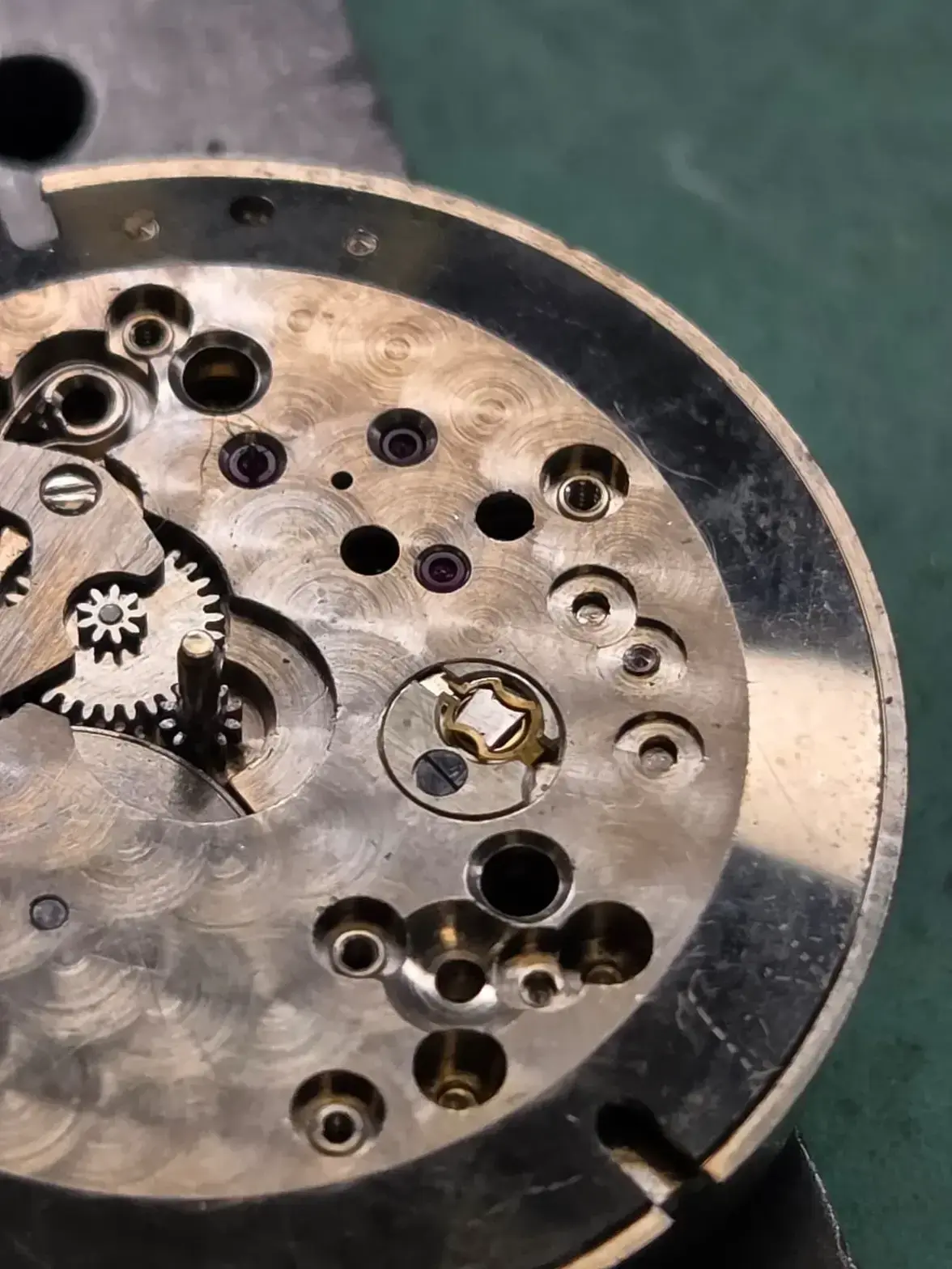

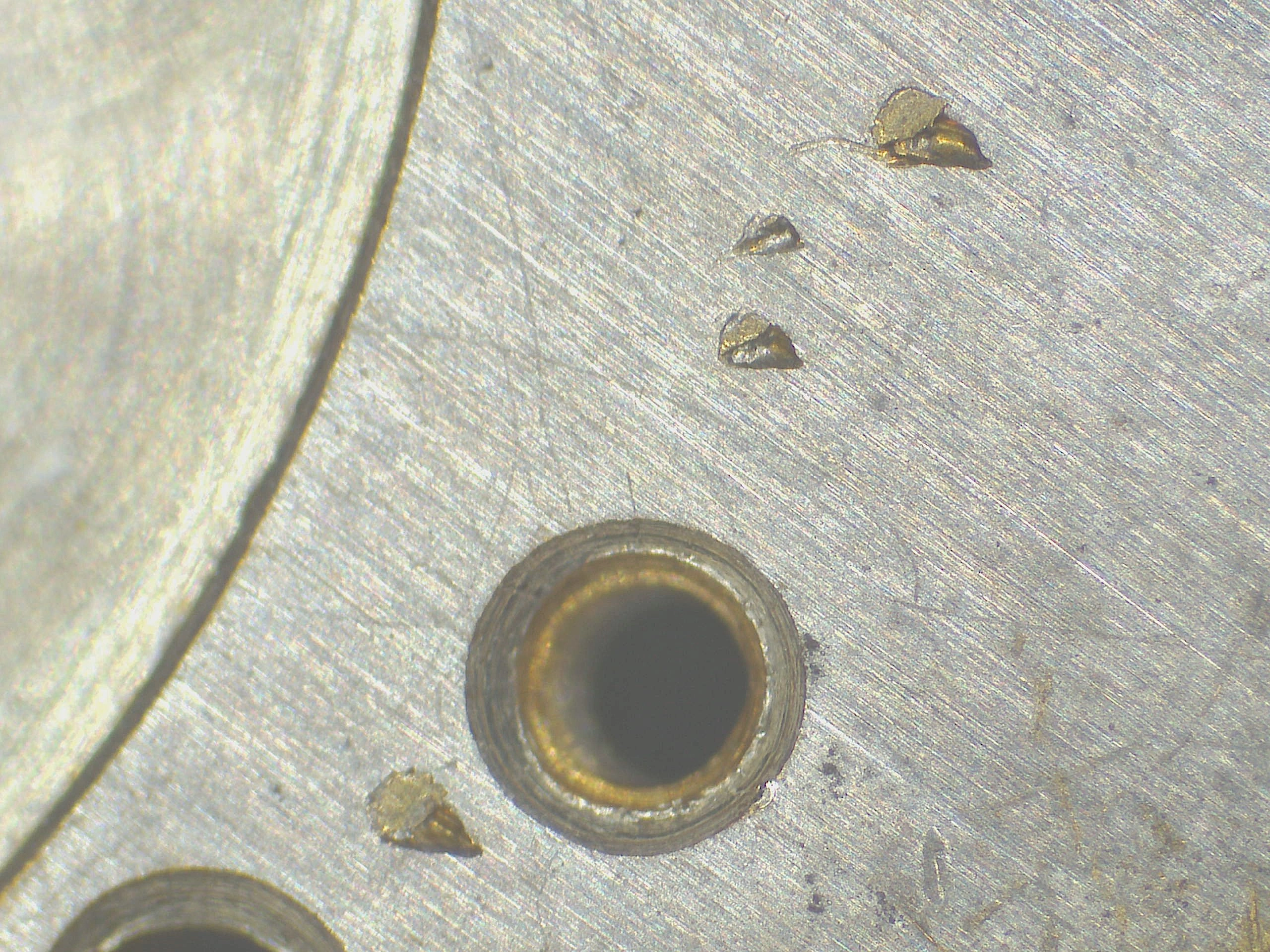

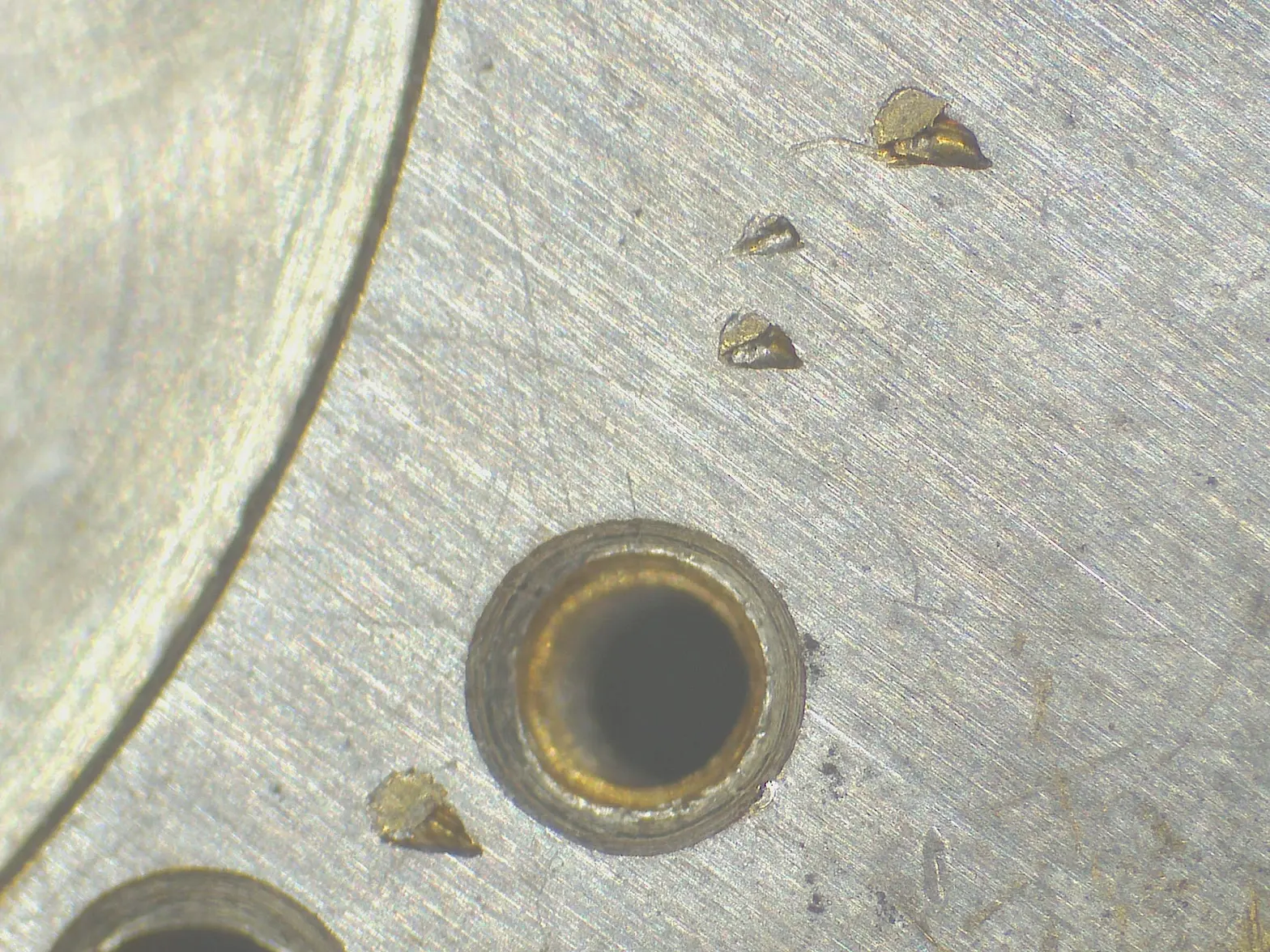

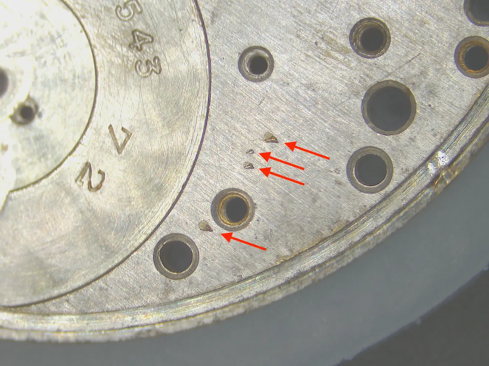

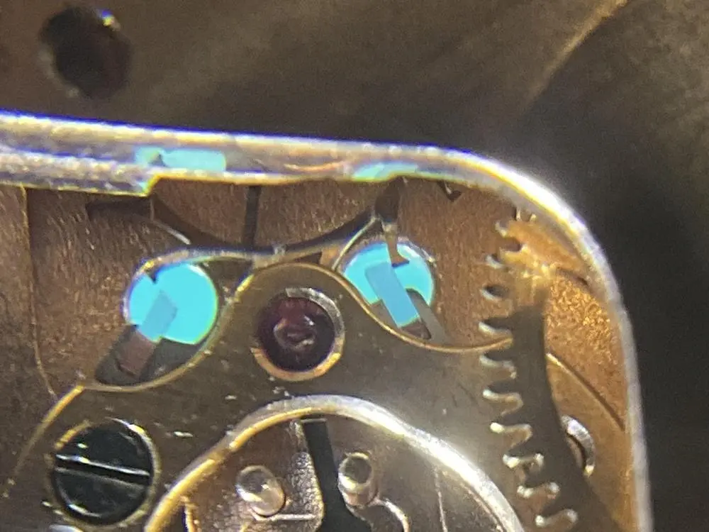

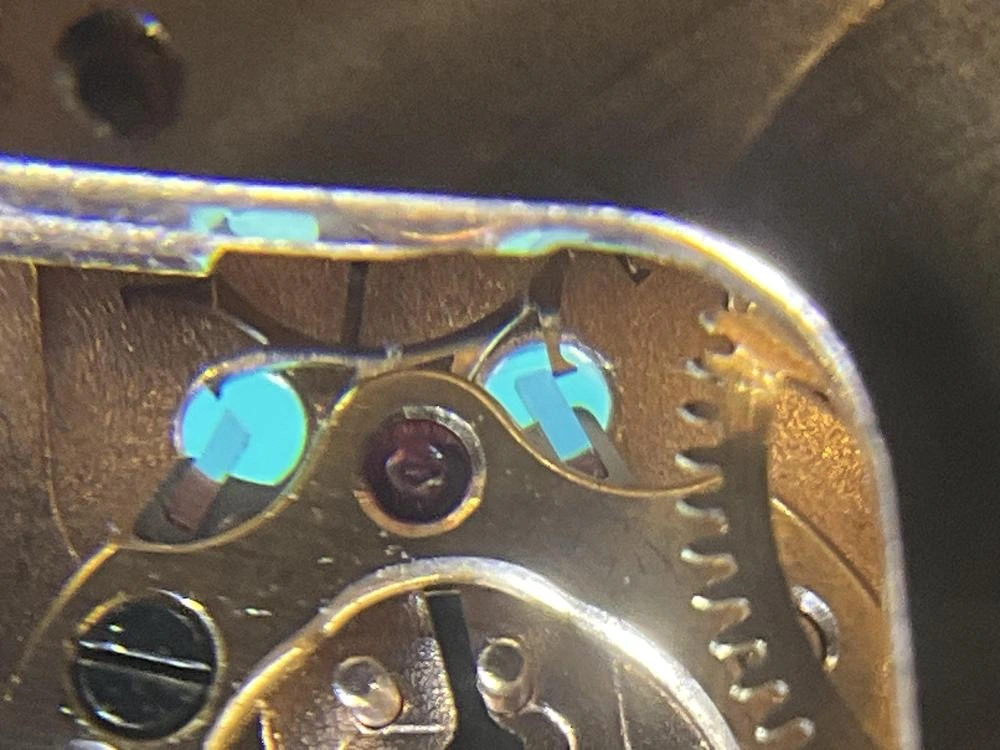

Here's a classic from the old days.
Balance staff too tight?
Not enough clearance?
Bugger, I haven't got time to do it the right way I need to get to the pub.
Quick fix.
Grabs a graver, gouges some grooves in the main plate under the balance cock. This raises little peaks at the end of the gouge.
When the balance cock is fitted, there'll probably be too much end shake now. No probs mate, just tighten it down, she'll be apples.
Tightening down causes the little flat parts on the "peaks" that you can see here.
He probably got to the pub on time though.
Bonus ❤️ if you can tell me what these marks are known as in official watchmaker terminology.
Quick fix.
Pig’s ears!

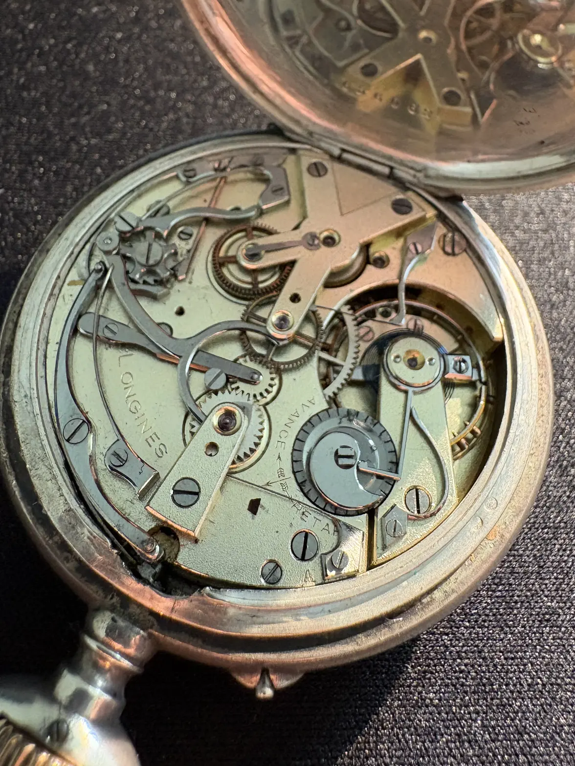

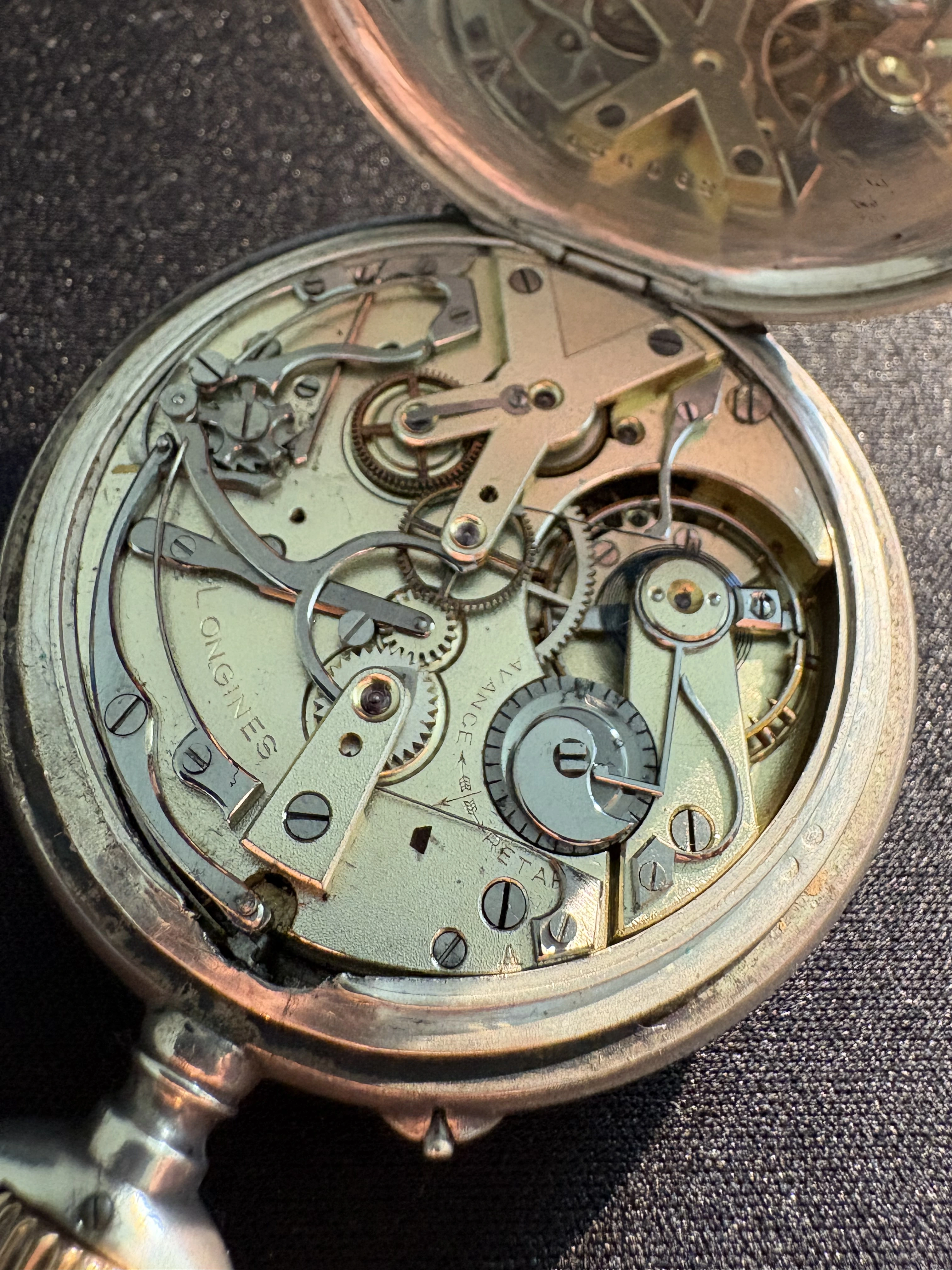

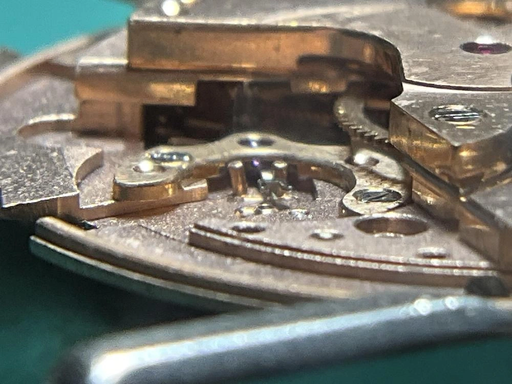

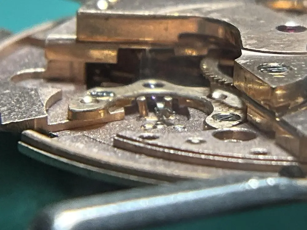

Whoever hacked out part of the case definitely qualifies. Presumably they couldn’t work out how to remove the movement. I am also going to blame them for loosing/breaking the missing lever.
I think I will file the damaged area to smoothen the edges and make it a bit less jarring. Doubt I will ever find a replacement lever.

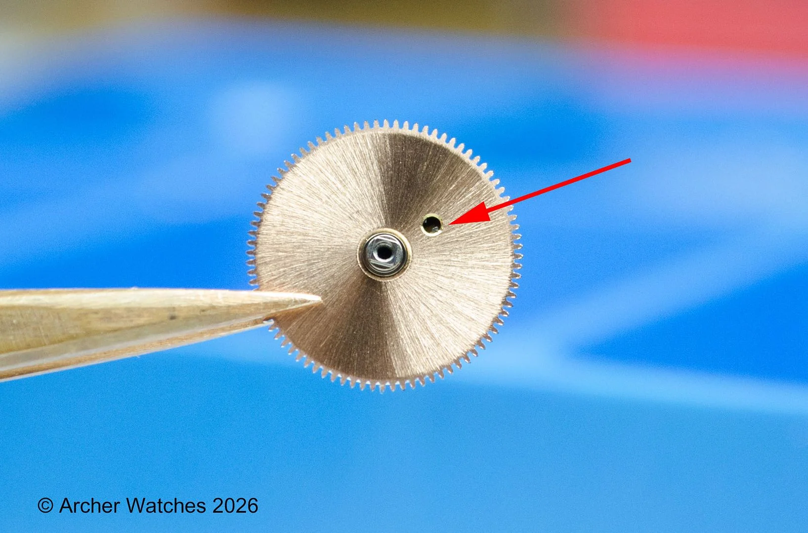

Holes in the barrel to reduce friction. Genius.
It also gives it that sleek skeletonized look.
