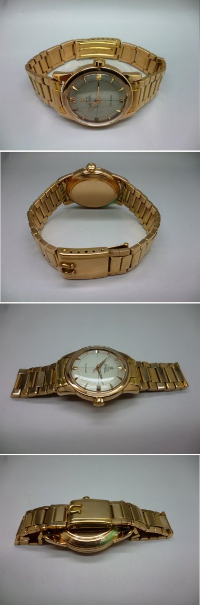

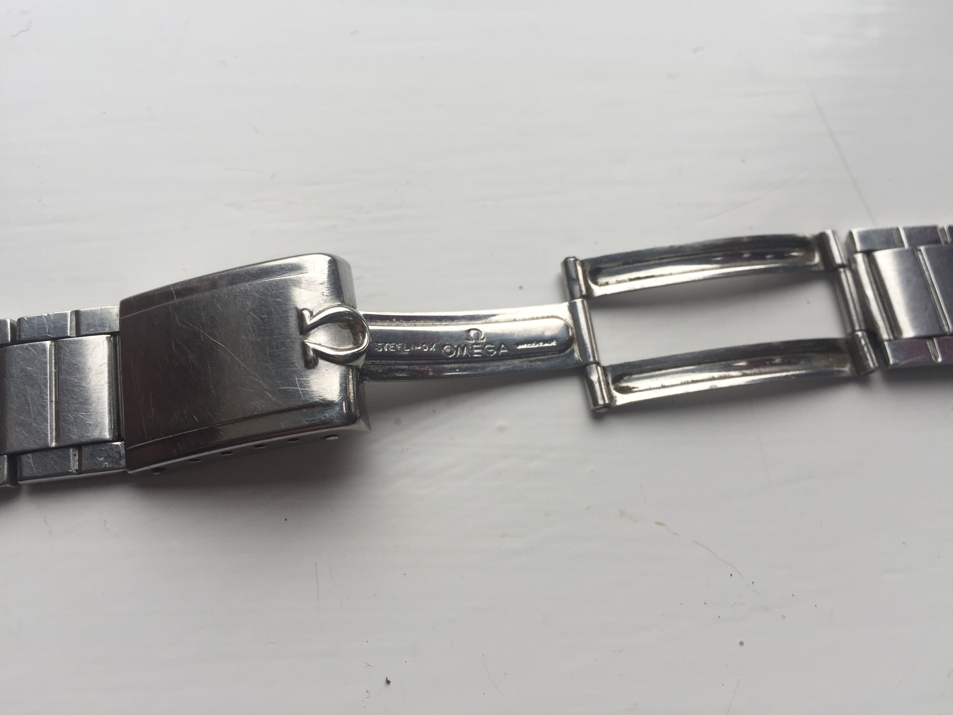

Another variety as well. Found mostly on 1950’s Seamasters and Constellations but MWO indicates a maybe for other holy trinity watches.
18K version as well
2,318
5,713
Correct.
I covered the "Split bottom" buckle above. Good to have a picture for reference.
*Even though I have seen a couple of 2915-1 Speedmasters that had the earlier split short buckle (bottom). I have yet to see a true 100% "Barn find" 2915-1 on that bracelet, so I cannot say with absolute confidence that these were not fitted to these watches at a later point.

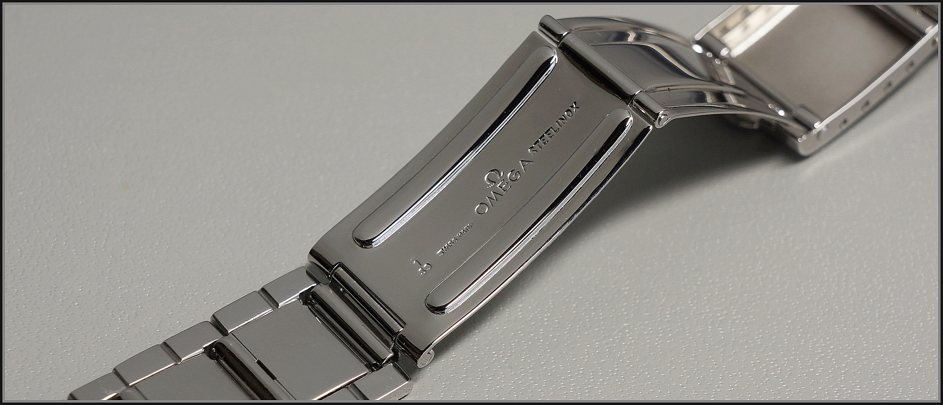

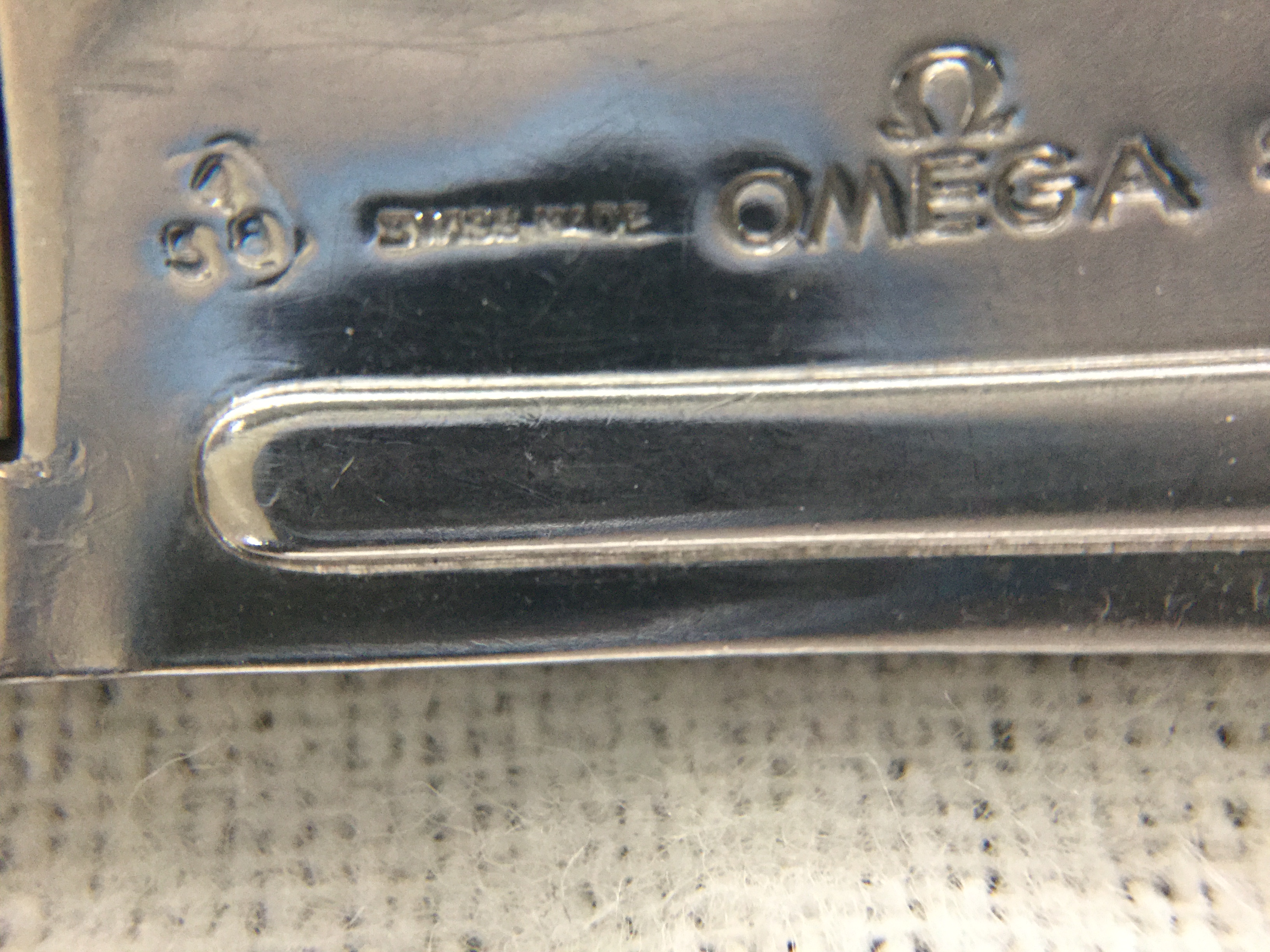

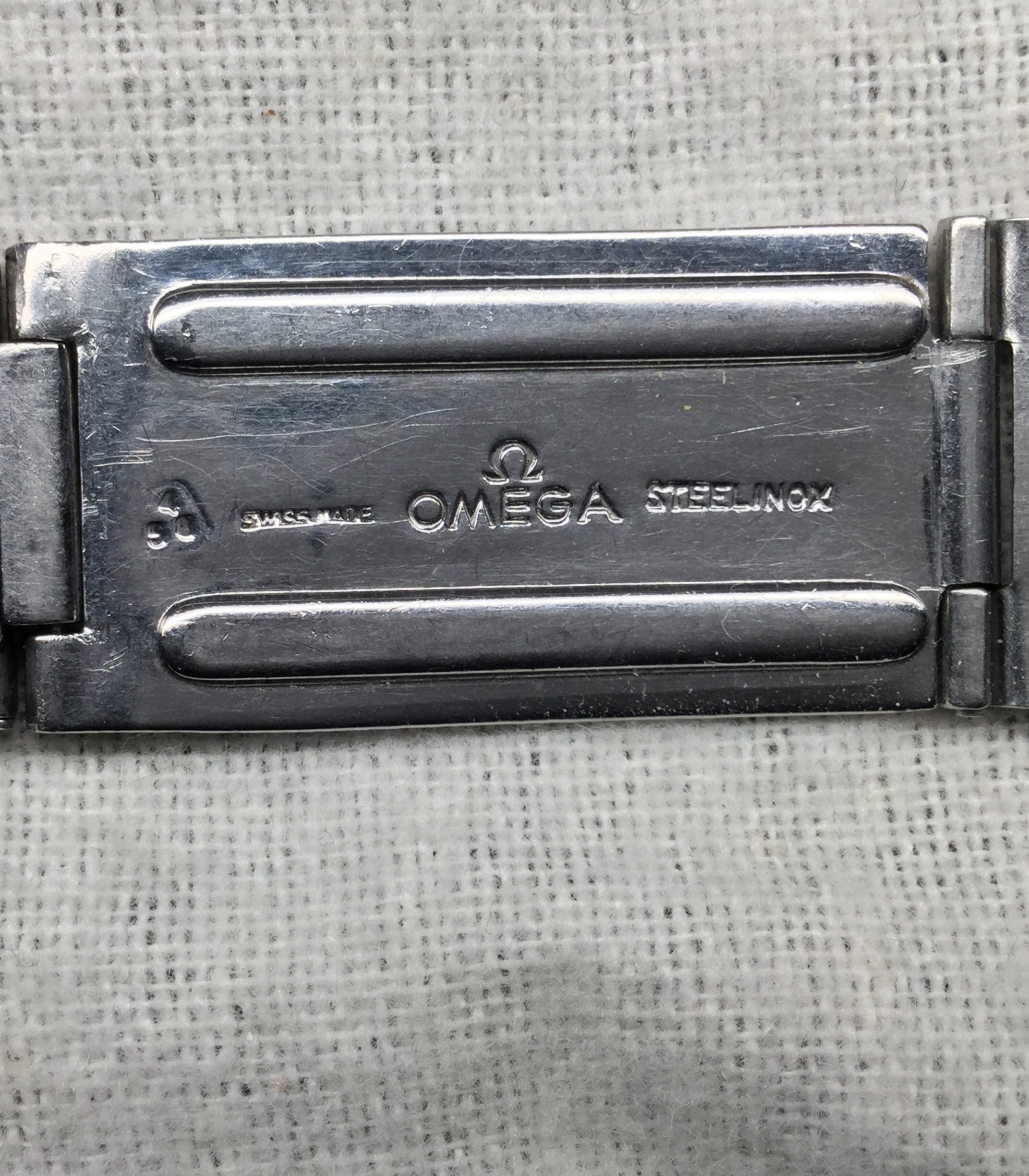

The very early ones (1957/58) were not dated. The buckle dates began in 1959.
It appears that the dating started in the fourth quarter, 1958.
2,318
5,713
Interesting that the date is on the opposite end of where they are usually found.
Also, notice that the SWISS MADE and STEELNOX have switched places between the last quarter of 1958 and the first quarter of 1959.

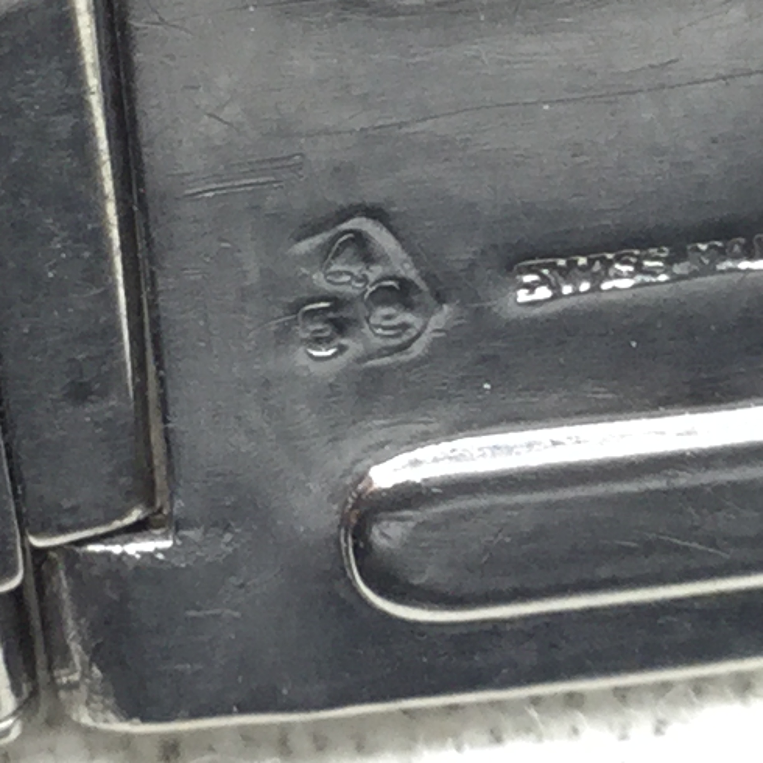

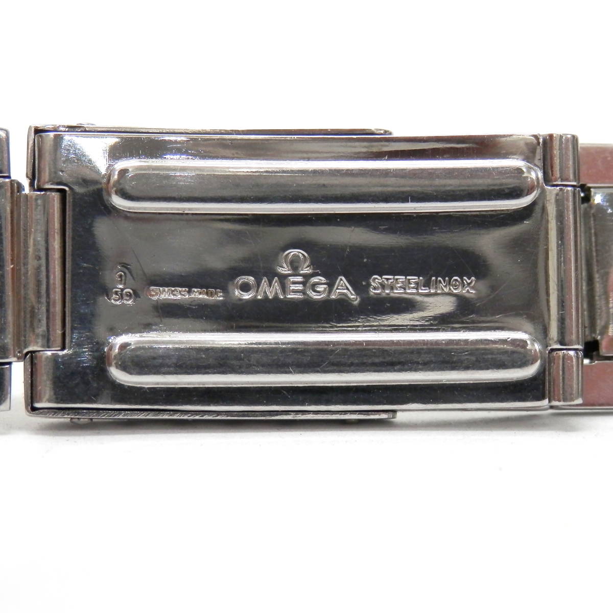

This 1-59 7077 engraving is aligned the same as the 4-58 example.

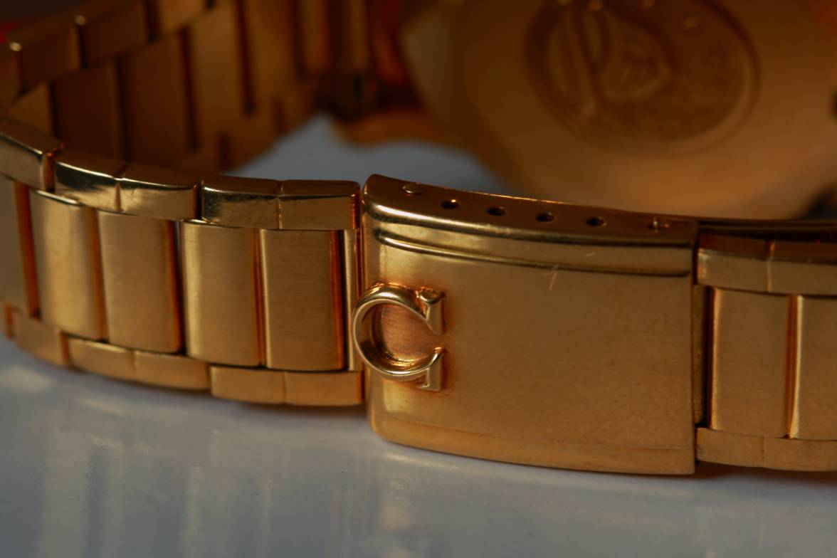

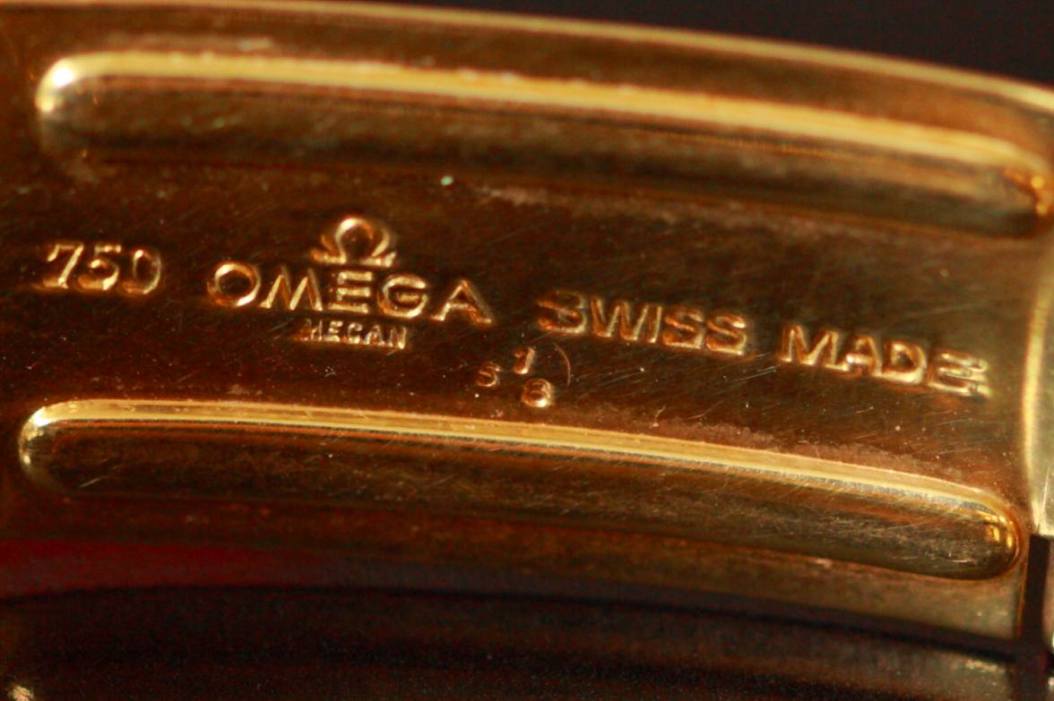

Even earlier for the 18kt versions, this one's from the first quarter '58. I'll need to check my others
And just out of interest to show here an 18kt logo which has a lot more detail than the steel version
My other 18kt 7077's are dated 4 57 and 2 60 respectively. I'm curious if anybody has earlier?
