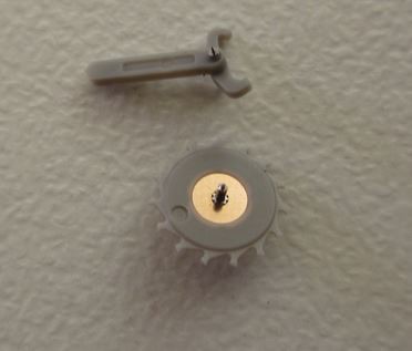

    Plastic escapement in System51 by ETA

    I think System51 is a cheap automatic watch which main interest is it has been assembled with minimum to not at all human intervention, including a mechanical regulation with laser and optical devices, with only 51 parts and a small screw.
    I must recognize this, itself, is an important technical achievement.
    Apart from that, It has not much interest for me. Those cheap plastic parts confirm my impressions.

    Disposable watches go back far beyond the 1980's. The US pumped out millions of "dollar watches" starting in 1896 when Ingersoll came out with the Yankee model. These were all crimped together (the 1890's equivalent to what Swatch is doing now) and were never designed to be serviced. When they died, they were tossed and another one was bought.
    Through until the 1970's, the Swiss made millions and millions of pin lever movements also. Cheap and disposable watches are nothing new for the Swiss, and to suggest they are is disingenuous at best.
    Honestly much of this letter is just hyperbole... "shocking beyond belief"...."Horoglogical vomit"..."you don't put a brothel in the basement of a church" - it's actually pretty hilarious. Maybe he has been taking writing lessons from his countryman Archie Luxury?
    Wait until he finds out there is a series of ETA movements used in Tissots with plastic escapements (has been since about 2009 - ETA C01.211). I think his head will explode...
    Although he seems to miss the point of this watch completely, I think most here understand this is an entry level piece made to get younger people interested in mechanical watches.

  12. Canuck Aug 4, 2015
    12,907
    35,496
    I have a Tissot T-RACE automatic in my shop right now. I can't say for certain, but the watch looks like it might be only a few months old. I pulled the back, saw the plastic escapement, and put the back, back on. I am returning it with a note to send it back to Tissot. Perhaps if there is a groundswell of owner dissatisfaction, Eta might smarten up? Let's hope plastic parts don't show up in other Swatch products! Looking for a cheap watch? Chinese anyone?

    To add to what Archer said, the big mechanical chronographs they sell also have the plastic escapement.

    Isn't the movement in that watch the ETA C01.211? Which is the Lemania 5100 (famous for its use of plastic parts even in $8000+ Omega Holy Grail Speedmaster form) re-released with some changes, supposedly the nylon escapement is rather issue free as is the rest of the movement.
  15. Archer Omega Qualified Watchmaker Aug 4, 2015
    25,866
    63,569
    Plastic parts are nothing new...ETA 7750 has plastic parts, Omega 101X series has plastic parts, Lemania 5100 is full of plastic parts, Omega 861/1861 has plastic parts...

    Added photos of both ETA C01.211 & Lemania 5100 for comparison, looks pretty much like the same movement just with a nylon escapement added and some other small changes.
    [​IMG] [​IMG]
  17. Canuck Aug 4, 2015
    12,907
    35,496
    Yes, but escapements? I am well aware that plastic parts are all over the industry. But surely these plastic escapements are a bit over the top? With any kind of luck, these won't be around for much longer than the lamentable Tissot all plastic watch! If ETA production is evolving to watches that are not repairable, maybe we needn't mourn the soon to be lack of availability of replacement ETA parts!
