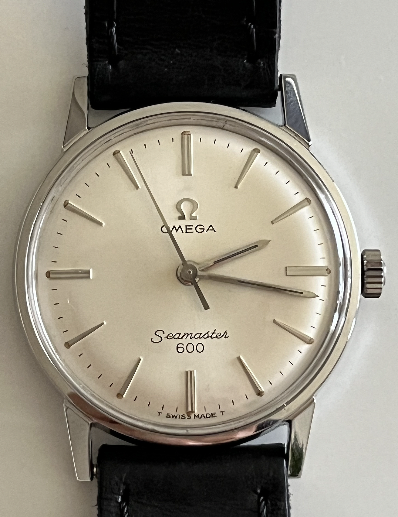

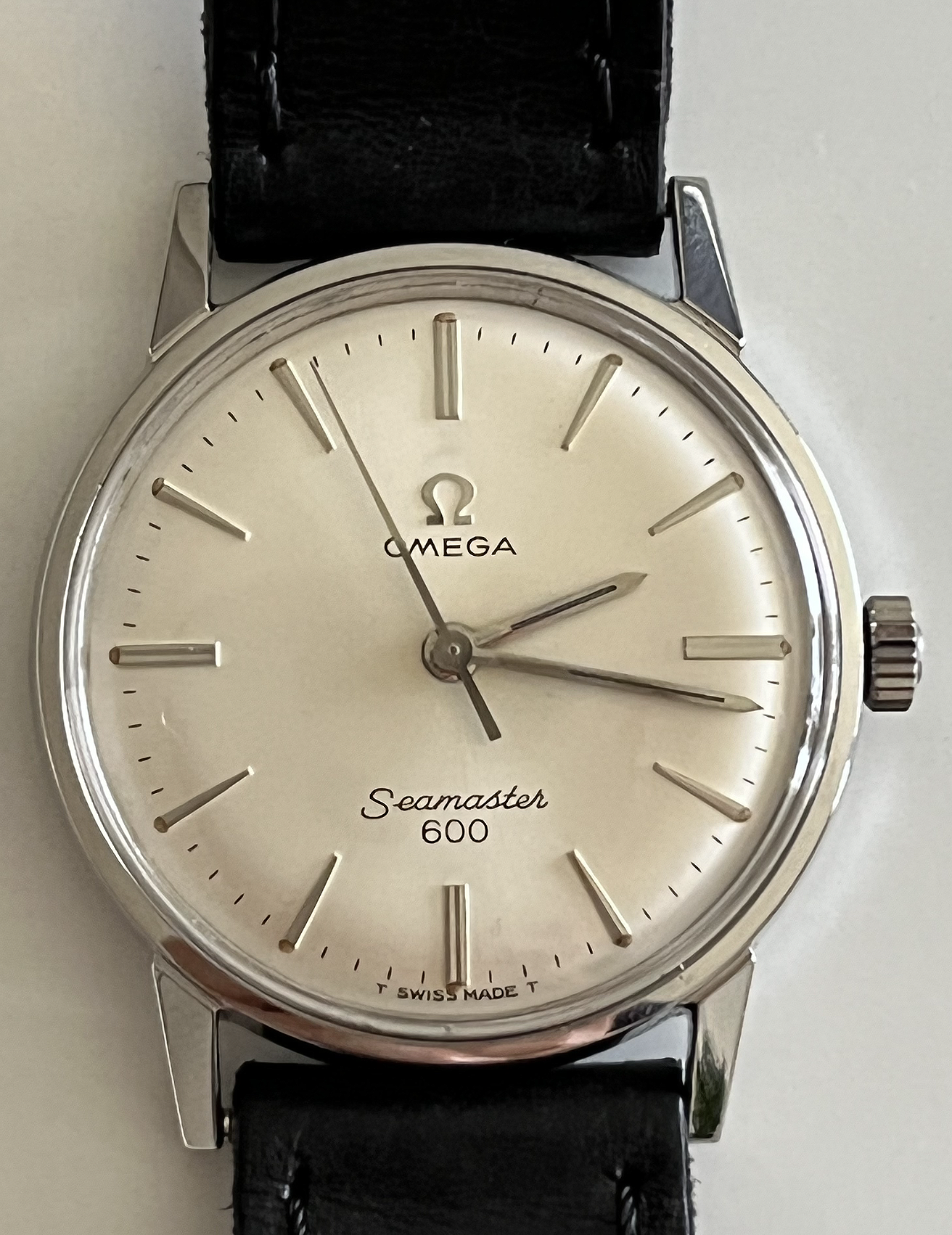

I found a T Swiss Made T Seamaster 600 from 1966. The dial is lumed but the hands aren't (they're black).
Would this mean this is probably not the correct hands? Or does tritium ever turn black after it ages?
13,559
23,507
Tritium can turn black but the hands could well have been replaced. Got a pic?
