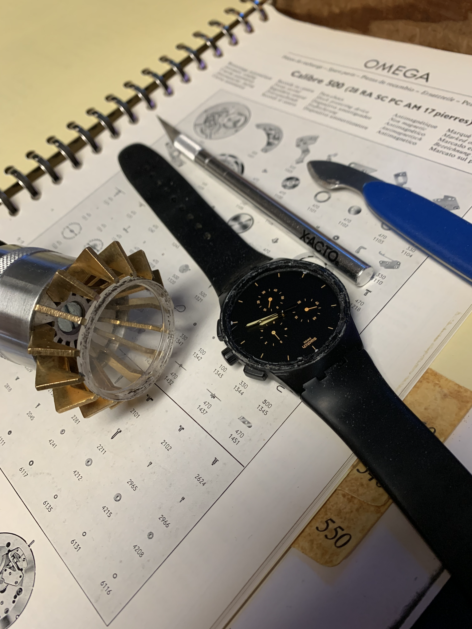

I finally got the crystal off in one piece.
Added a drop of acetone which wiked around the glue join.
I have also been cranking down the cyrstal lift a little bit at a time.
Black hands on a black dial is really silly.

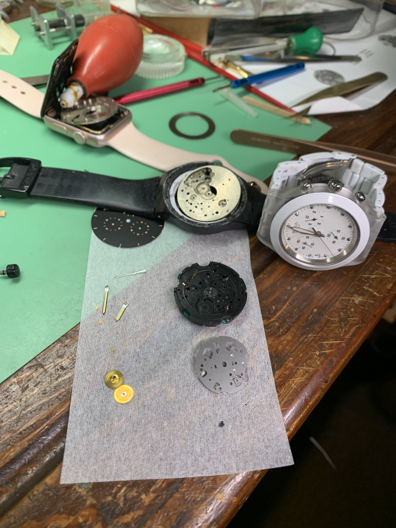

The idea was to see how easy it might be to put one of the 19 Landeron mechanical movements into the case.
More dismemberment:
The other option might be to swap the hands on the white one.
The hands on the black one are sort of based on the speedmaster hands. Black on black made them invisible.
Another possibility is to do the victor F. thing and see if the Swatch movement can fit into an apple watch case. I thought the movement was molded into the case, but it is an ETA module.
I popped some plastic melt rivets to get a ring off so I could release the stem. These things really are not designed to be worked on.
Ironically The Tissot Autolub plastic movement does come apart. Not sure those will be of much use more than an art project. The plastic has stress fractures in it. Curiously squeezing the movement and it will start to run. Sometimes a minute, sometimes hours. I think that the wheels may be pushing the case apart. This may be the subject of a different missive.
