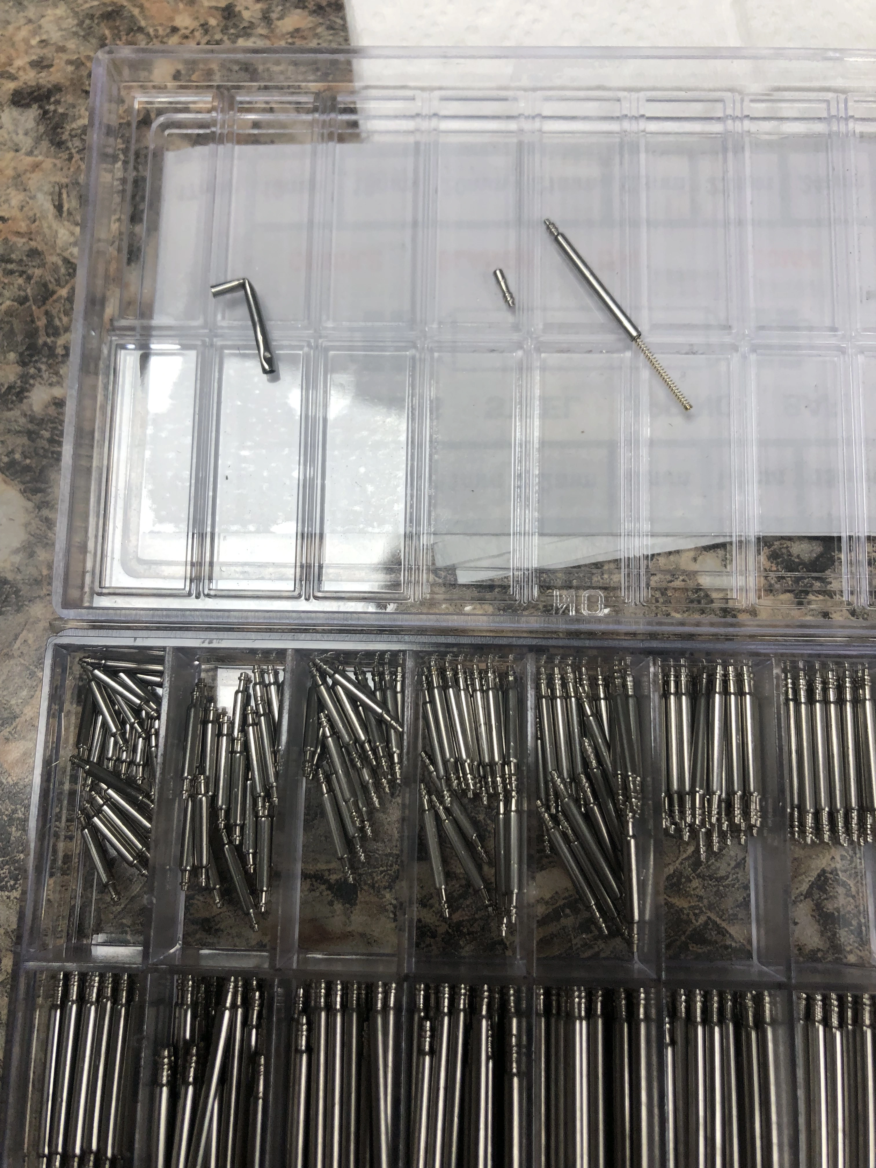

So I wanted to switch out my constellation to a different strap .
Got a new strap and ordered spring bar/pin off Amazon
Immediately saw a bent one , opened the case .
Saw a slightly bent one and it fell apart in my hand
Now , I don’t trust any of them
Is there a trusted or a brand that you all trust
Thanks again guys

In lots like that. Might find a dud. When I use. I test the spring strength by pressing on them and weak springs are tossed.
I bought 1000 lot bags. Haven’t found a dud yet. I bought direct from the manufacture

I tried a few more in this bunch and another one just fell apart in my hand
Returning these 😔

I only use Omega oem spring bars. Dont need a cheap pos spring bar be the cause of my watch dropping to the floor
