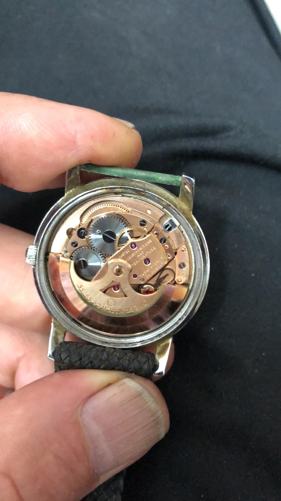

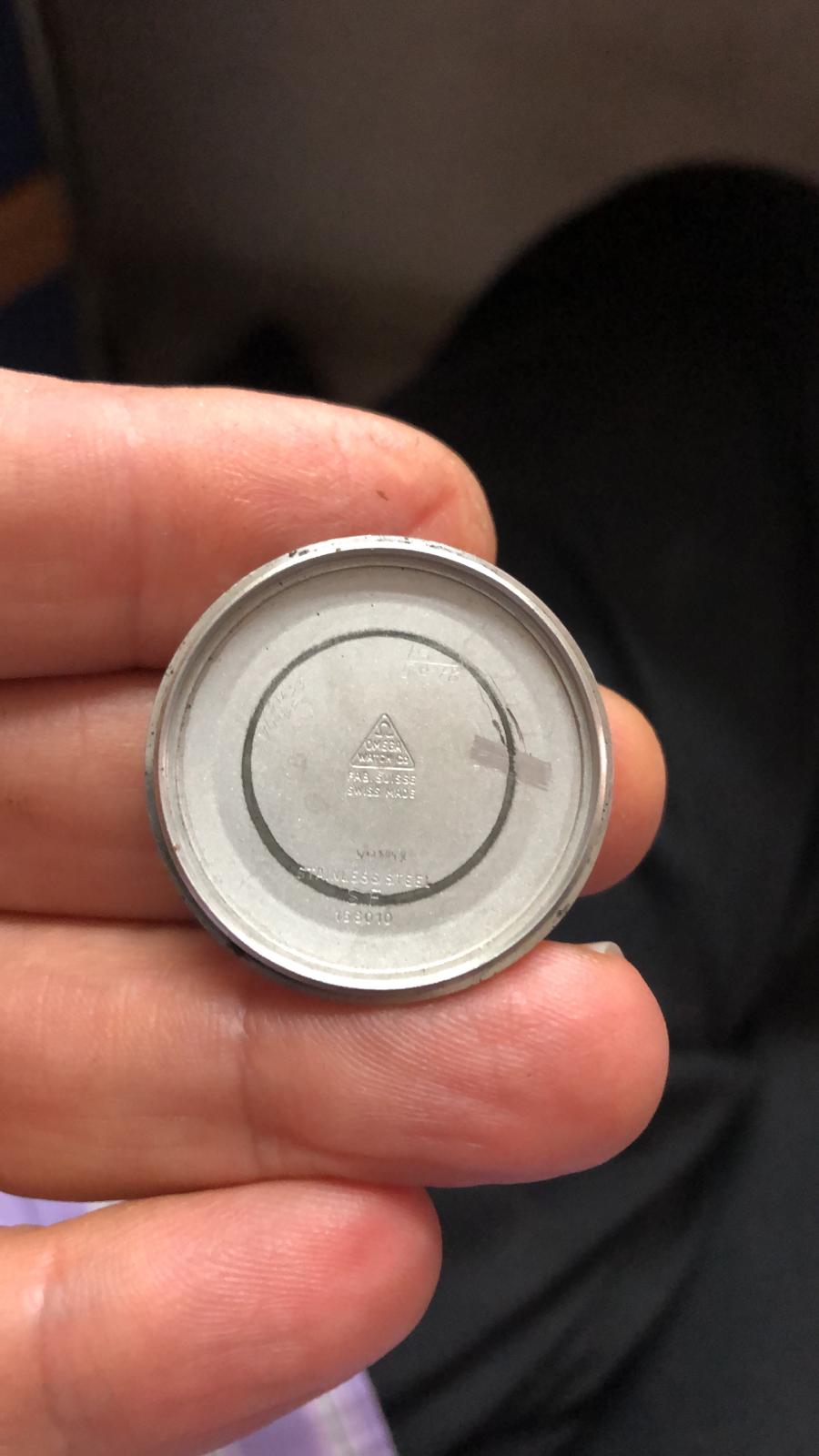

Here is some more info. I know absolutely nothing about omega watches... so I am including pictures and would appreciate any info. It’s turning to be a fun detective game for me.
The back says SF 168 010.
I cannot spend a lot on a strap at the moment.... do you think this one will do?

That's not a dogleg. It's normal that often water resistance isn't great on vintage Watches. Especially on Constellations.

Worst case of rotor rubbing I have seen so far 🙁
The watch is being serviced right now?
If your budget is limited I would wait on the bill from your service guy before spending money on bracelets...
Do you have pictures from the dial also?

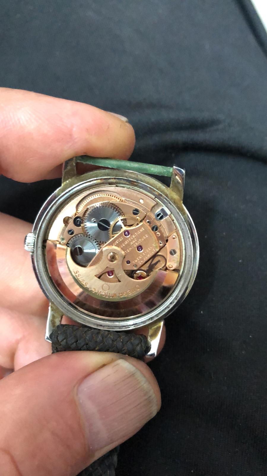

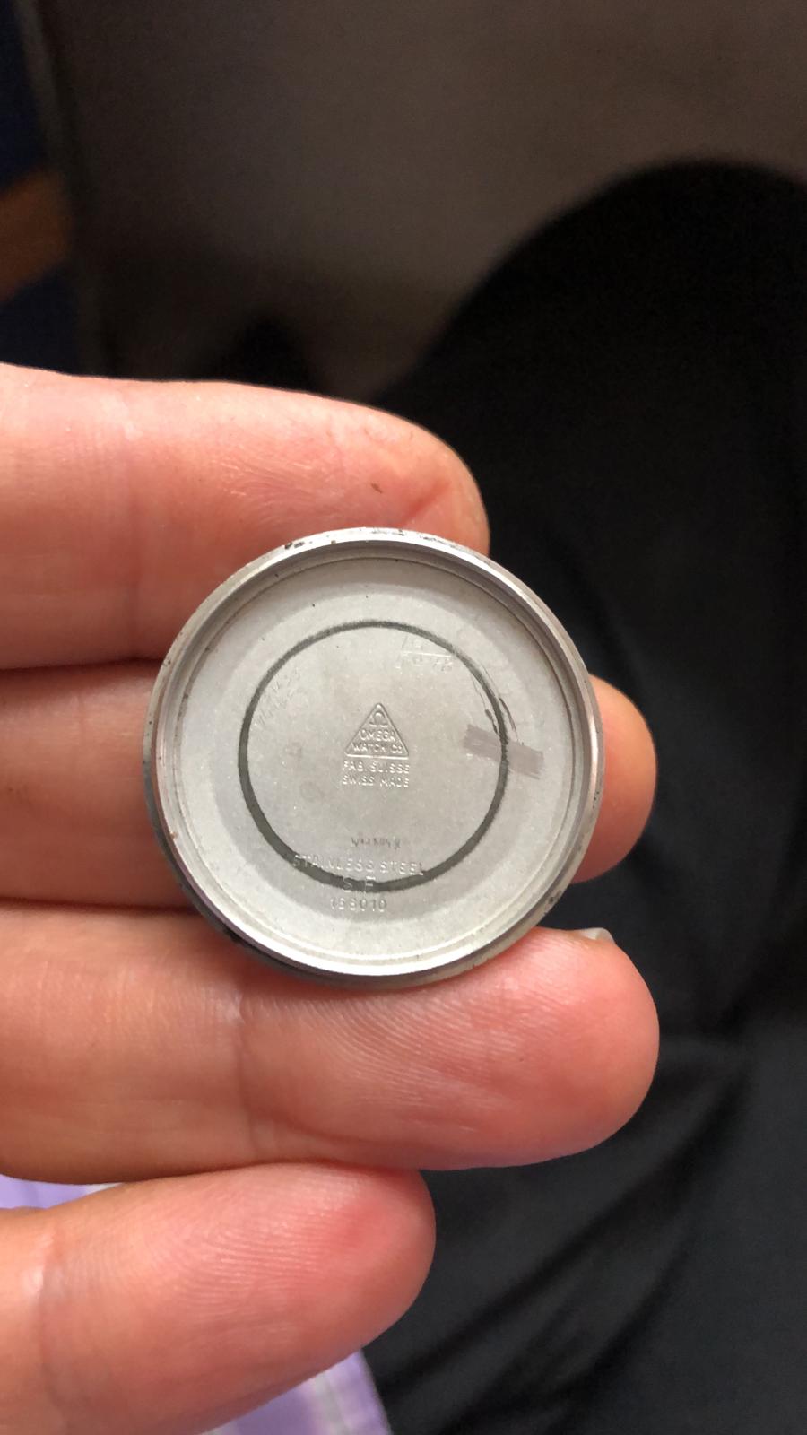

https://www.ebay.com/itm/NEW-18MM-B...260270?hash=item287b79a02e:g:aLAAAOSwO1Fc5Wti
This is why I asked about the lugs and the reference.
This is a round cased straight lug reference.
It also requires a 19mm (not 18mm) strap.
BORs for these are few and far between.
You can get inexpensive 19mm leather straps from Hirsch.
Correlation between extent of rotor rub and worn parts is quite high in my experience. Based on how badly the rotor pinion appears to be worn, I would consider this a sign that many parts will be needed, and the final bill won't be cheap if the watchmaker is doing a thorough service.
I understand.... I am not sure how thorough the job will be honestly. This is an old watch that has not been in use for quite some time.
I don’t believe the watchmaker will replace parts. In any event I don’t think I can afford a really seriously deep restoration work. I mainly want it to work well.

This is a watch that was *found* in a box that wasn’t opened for years and years, part of the stuff in my wife’s late Swiss grandfather flat. It’s a miracle it was even found. I am not interested in it being valuable, just want to be able to use it and keep the tradition.
Bummer.
Unfortunately as @Archer said, the wear pattern on the rotor and case back indicates that the rotor bearing/ axle is shot and probably took a bunch of parts with it. It may “run” with just a clean and oil, but it won’t run reliably, won’t keep accurate time, and will only get worse. These watches are worthy of repairing properly- particularly if it’s a family heirloom. We’re not talking thousands more, a couple hundred in parts most likely. Just set aside the money and pay the watchmaker to do the job right. Slap a strap on it for now and enjoy wearing it as you hunt for a period correct bracelet.
I buy straps from here- they have one of the larger assortment of 19mm straps I have seen.
https://www.bandrbands.com/19mm-watch-bands.aspx
