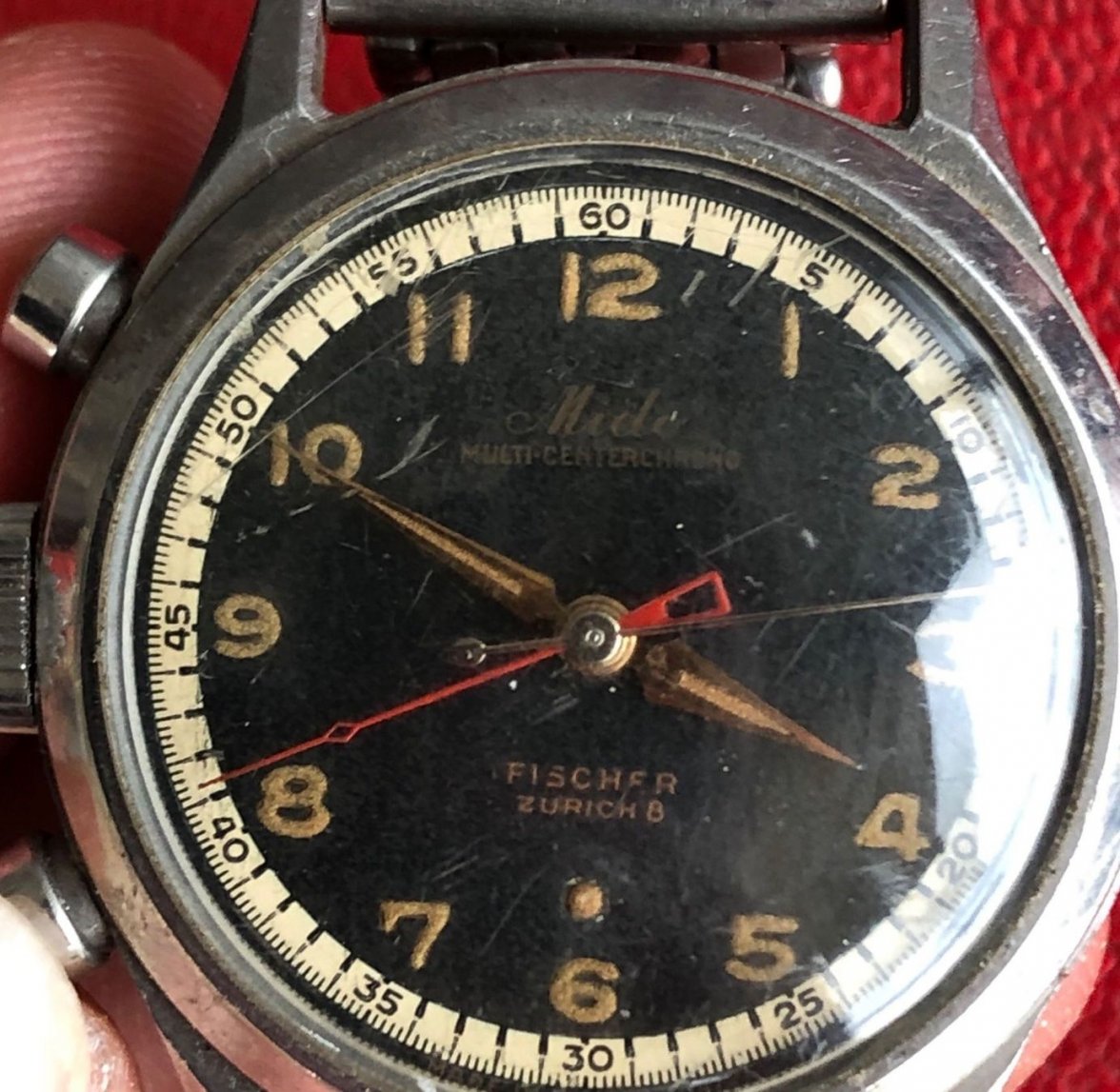

Looks like an extra lume dot above the six, perhaps a reminder that it has a left handed dial when one looks at it in the dark.

No, it was a correct (i.e. normal) case. The "tell" is on which side the case number is between the lugs.
Dial looks original to me. Probably just affixed incorrectly.

Probably for a left-handed

I was also thinking that the dial feet were missing, and someone decided to attach the dial upside-down. The extra lume dot is interesting, I haven't seen that before. It's too bad that the retailer logo is a bit crooked, but I doubt that it was faked. Probably not carefully done.
There are quite a few desirable parts on that watch.

Absolutely. Pricing was unfortunately not parts watch pricing.

That's a high price considering the incorrect hour and minute hands.

I wouldn't discount the hands completely. There were a number of different set ups on these.

Agree. I like the sword hands better, but these could very well be original.

OK, I will look at more photos, just haven't seen them previously. 😀

Echoing two previous comments, while uncommon, those type of hands were used on occasion. Both with and without lume.

I like the other version better
