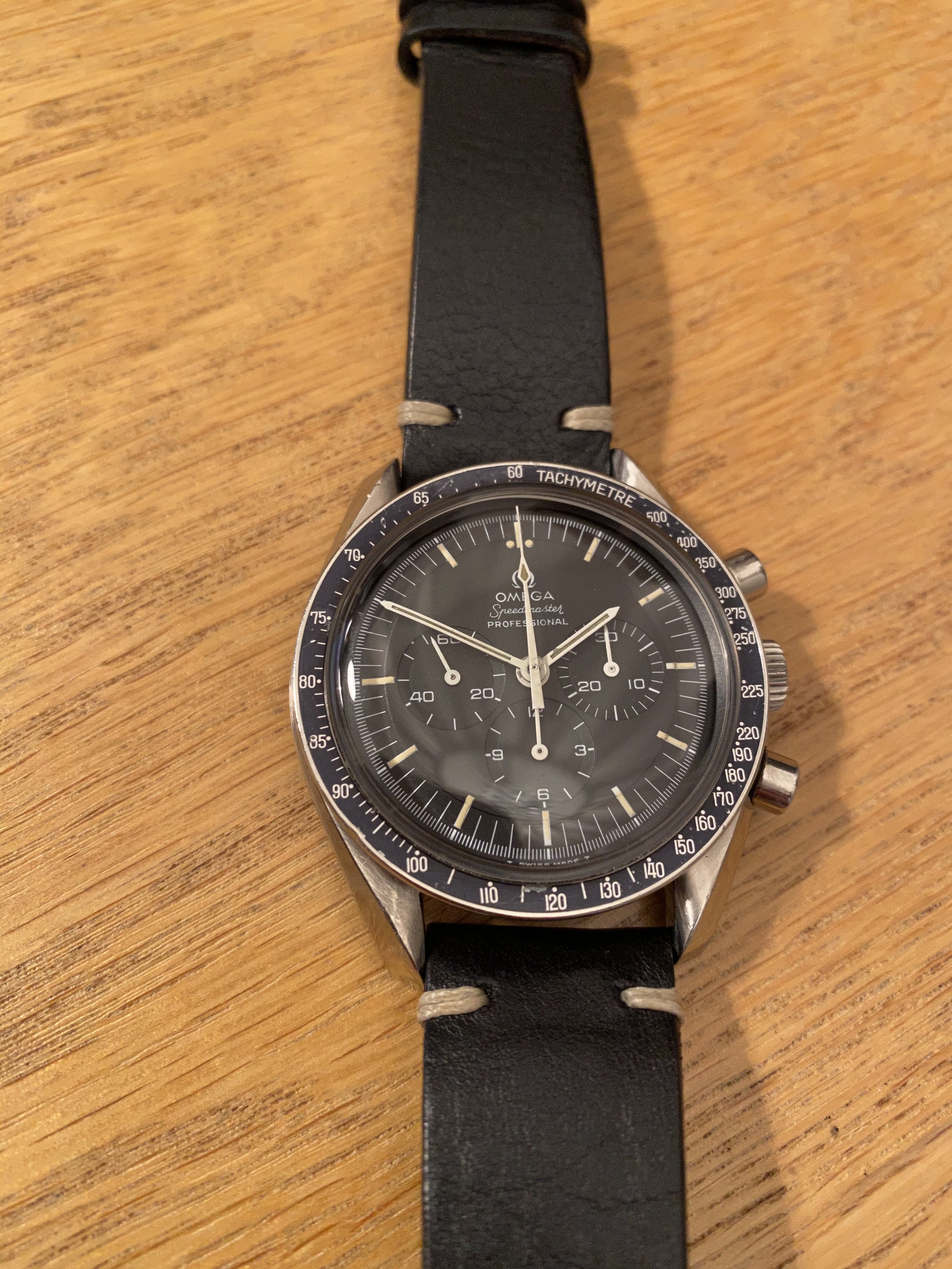

Hi OF members.
I purchased a Straight Writing Speedy earlier in the year which has a 220 misprint bezel, a B2bis.
The Extract of Archives states a serial number of 31.619.XXX, date is June 1971.
My watch fits MWO’s range for SW Speedmasters of 31.00X.XXX - 32.857.XXX yet it falls outside the assumed range of 220 bezels which MWO quotes as being 30.588.XXX - 31.008.XXX.
The book also states they have not seen any SW’s with a B2bis bezel.
If I follow this line of thought then the original bezel was likely to have been replaced at some point in time.
I’m not sure...but I would welcome any thoughts as to whether OF members consider the B2bis bezel could be original to the watch?
thanks in advance, here’s a few photos of the watch...

I think these were also used as service replacement bezels, as my one previous owner, ST145.012 from June 68 also has a 220 bezel on, so Omega may have had some ‘kicking around’ when yours went in for or a service, or somebody has replaced it at some point because they liked the idea of a different less common / error bezel. Just a guess, the experts will be along shortly to comment......

This thread is a good resource:
https://omegaforums.net/threads/bezel-misprint.23499/
This is the main conclusion from @@speedy4ever(Author of MWO)
More important is to consider the production date. Of the several hundreds 145.022-69 we have in our database, the relationship between production date and bezel type is rather clear:
- DON (type B1) until September/October 1970
- 220 (type B2bis) from end August 1970 to end December 1970 (possibly until January 1971 with new data we had, still to be verified)
- type B2 from November 1970
So with that in mind I would conclude that the bezel has been replaced at some point.
