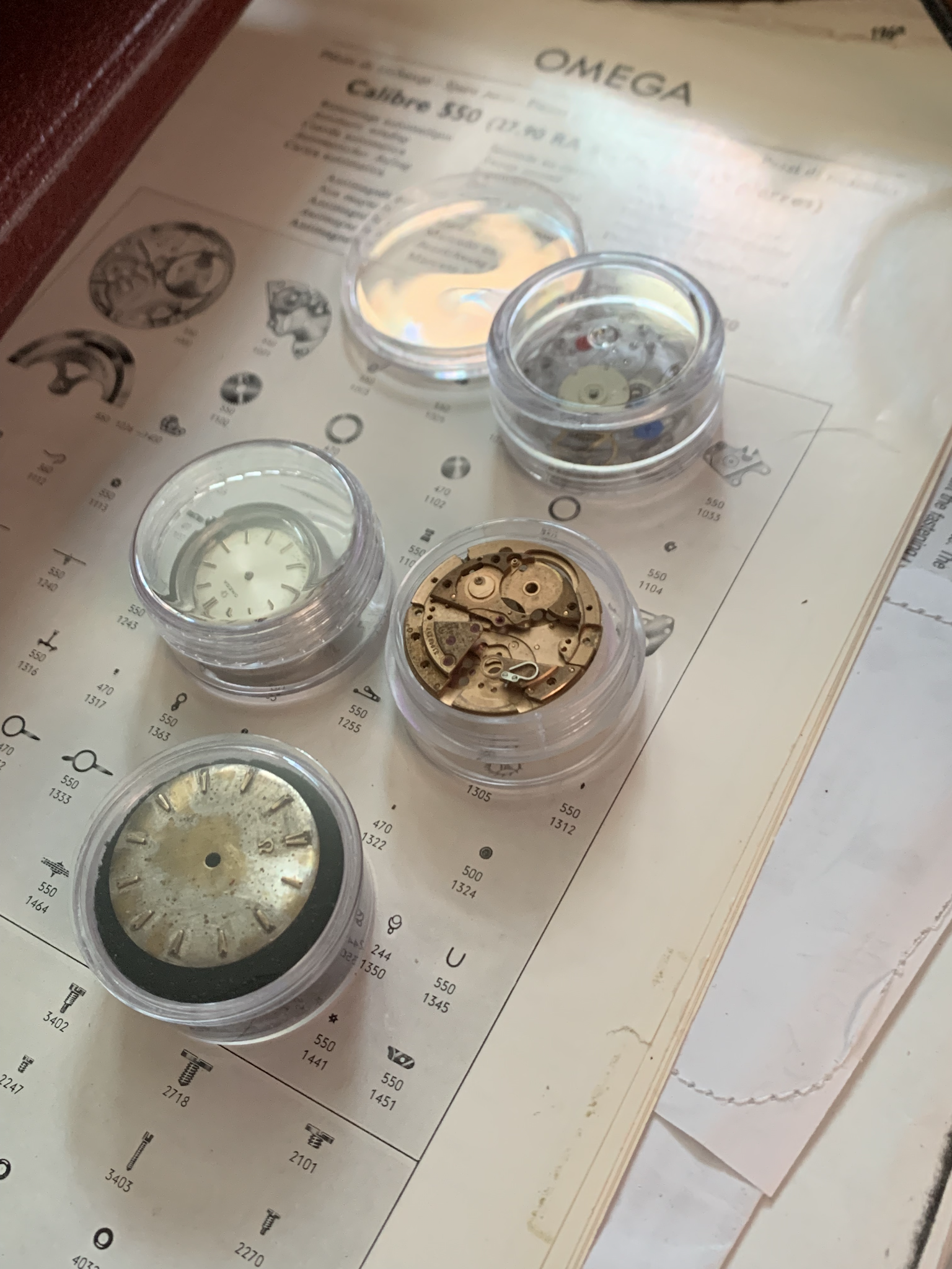

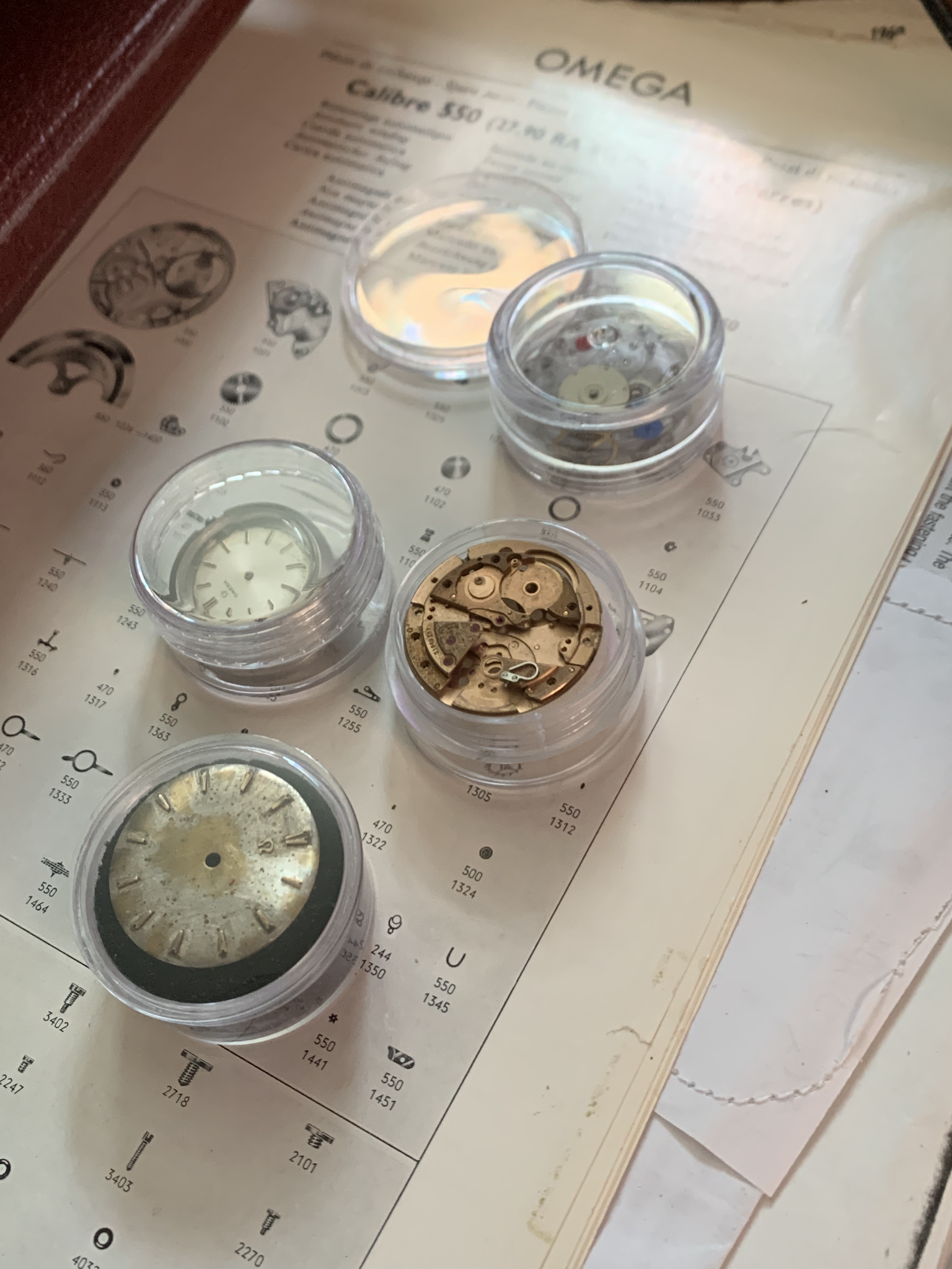

I have been getting watches shipped in the plastic 'lip balm' containers with the screw on lid. Found these at the local craft/hobby store in bulk. Usually in the craft 'soap' section. They are the perfect size for movements without stems. And with foam pads; dials too. Much better than the bags which the parts rub together and poke through.
Wow!!! a great idea!!!! If they are perfect size for movements without stems, one can drill a hole on the side and make a slot to allow stems to fit just the same. I wanted something like those eta 28XX plastic movement containers.and this is the next best substitute!!! When the shops open I will go right away first thing before going to work or during lunch break!!!

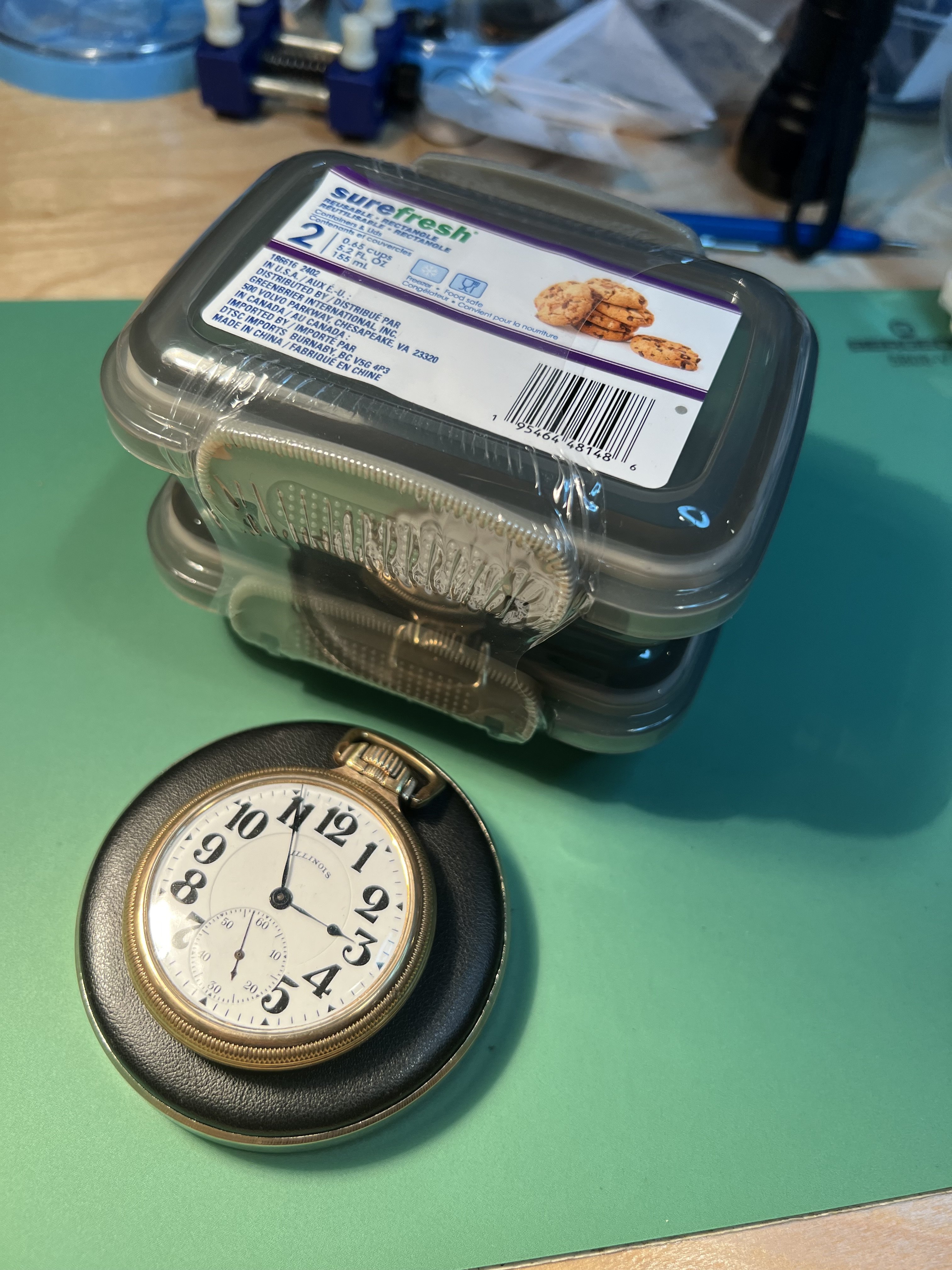

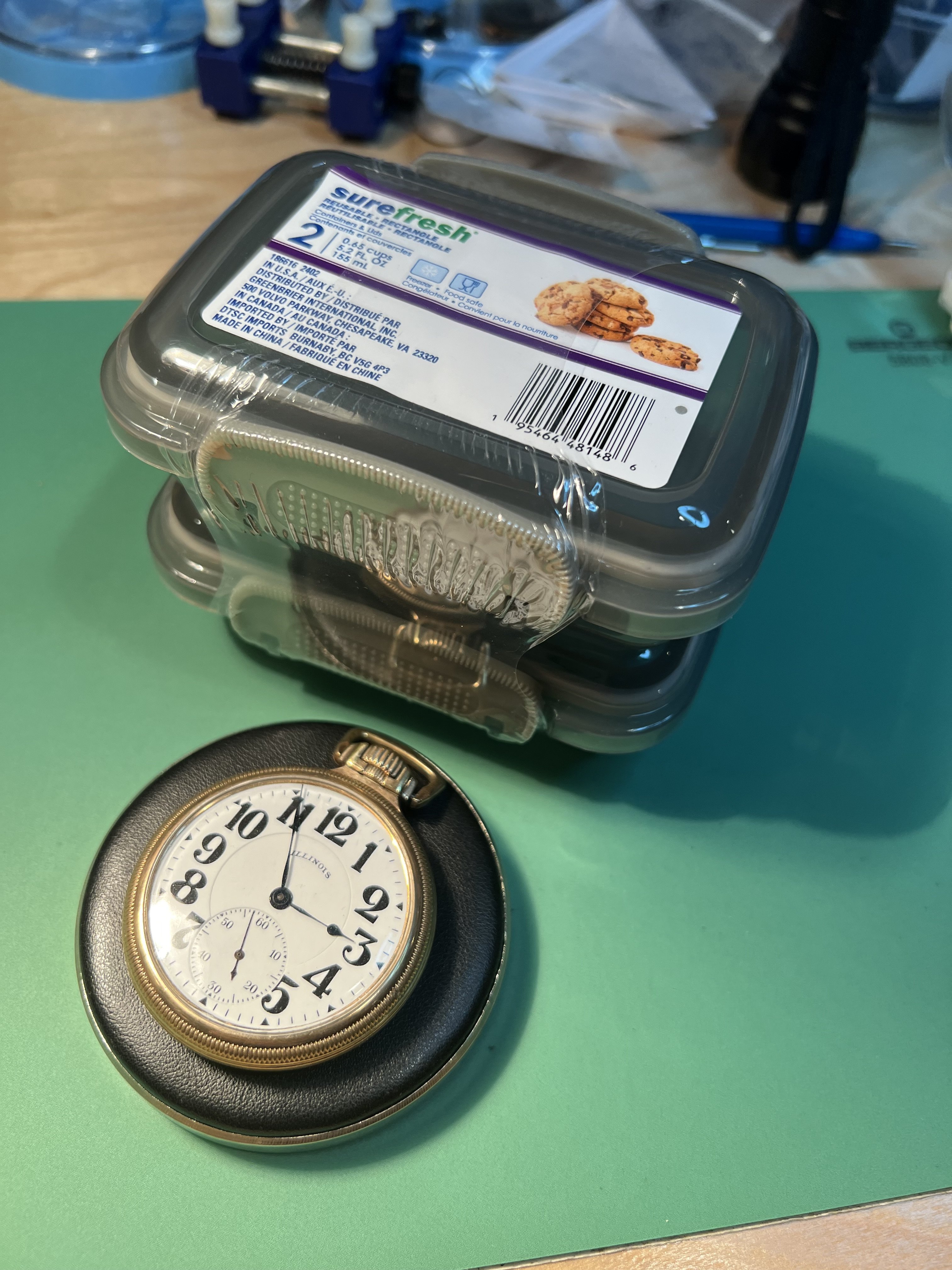

I found these little plastic snack containers with snap on lids at Dollar Store about $1 each and they are very sturdy for shipping. Watch in bubble wrap inside and some bubble wrap around outside and ship in padded mail envelope.
