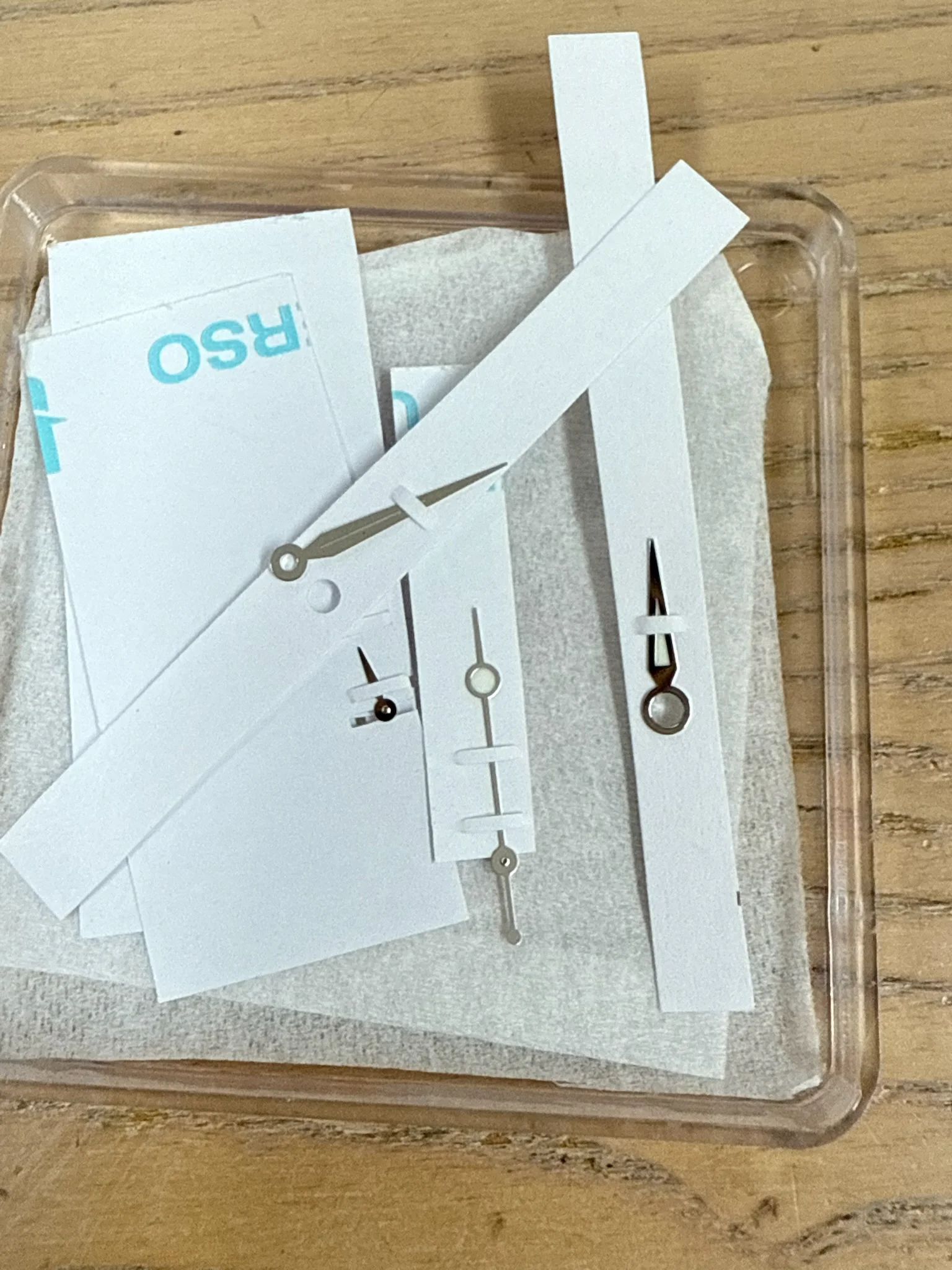

Any pictures?
These are the hands that are being sold to me. I understand that they may have to be adjusted to curveture...etc. Not putting the lolipop hand of course, since I already have the drop ends, but the hour and minute Alpha hands I wouls use. Even has the triangle. I wonder if I could paint, not relume them. I don't care about how they look at night.

Most re-lumers I’ve asked have actually said that it is not very doable to remove modern superluminova, but you can apply faux-lume top of it.
Yeah, most likely apply faux lume, or just repaint to match. Is there anything else to look out for to make these fit the 105.002 or vintage 2998? I read something about curveture and adjusting the tips, etc.

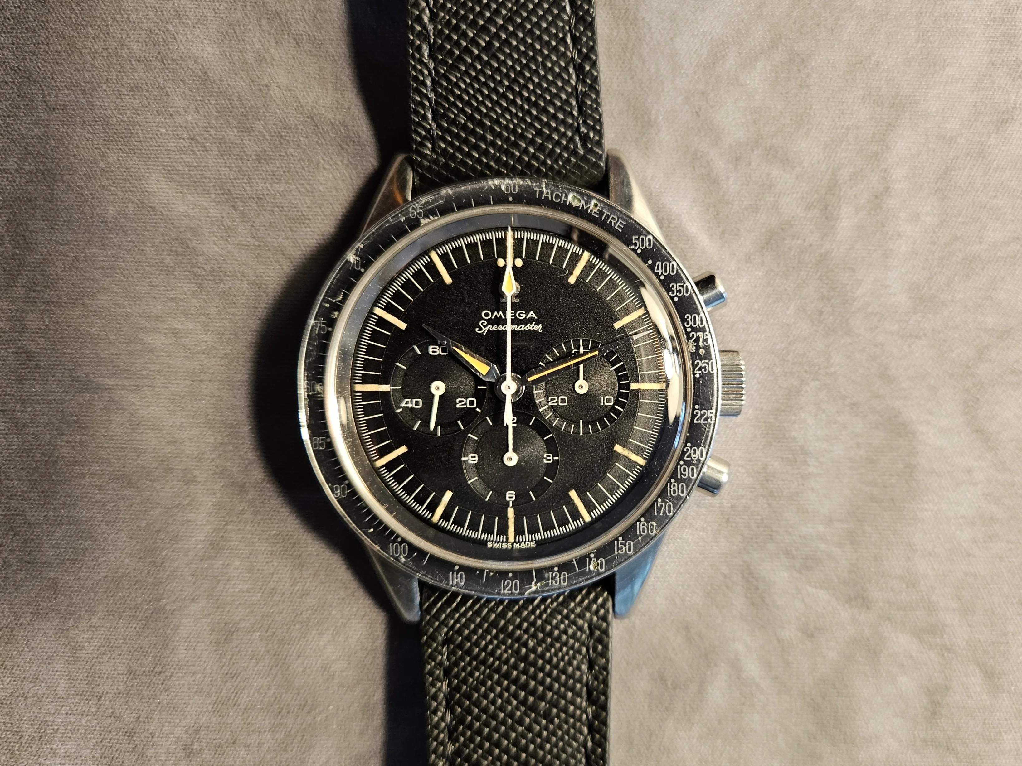

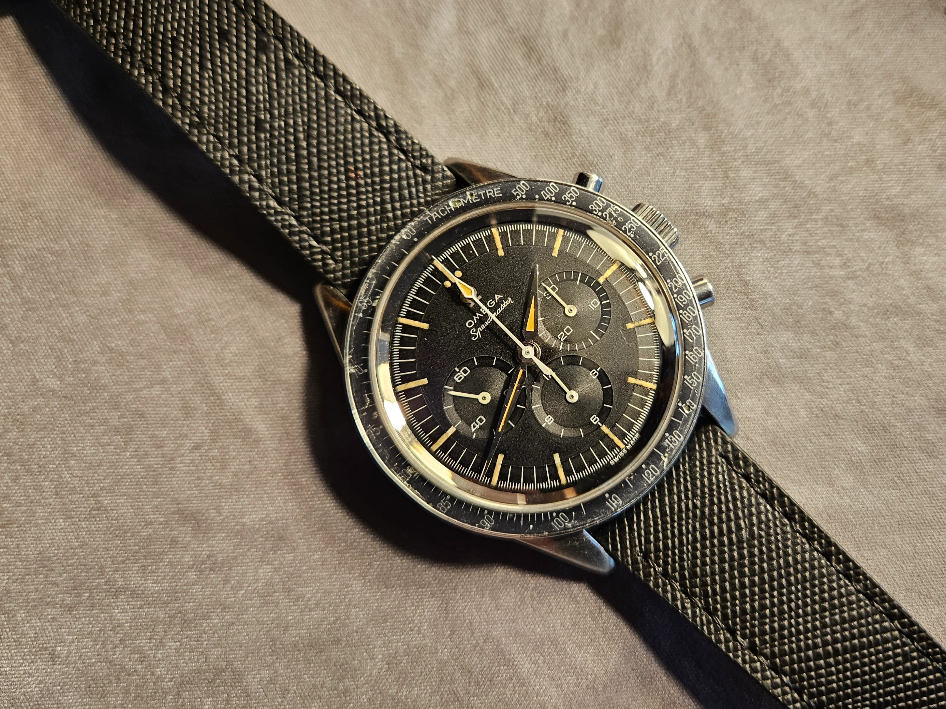

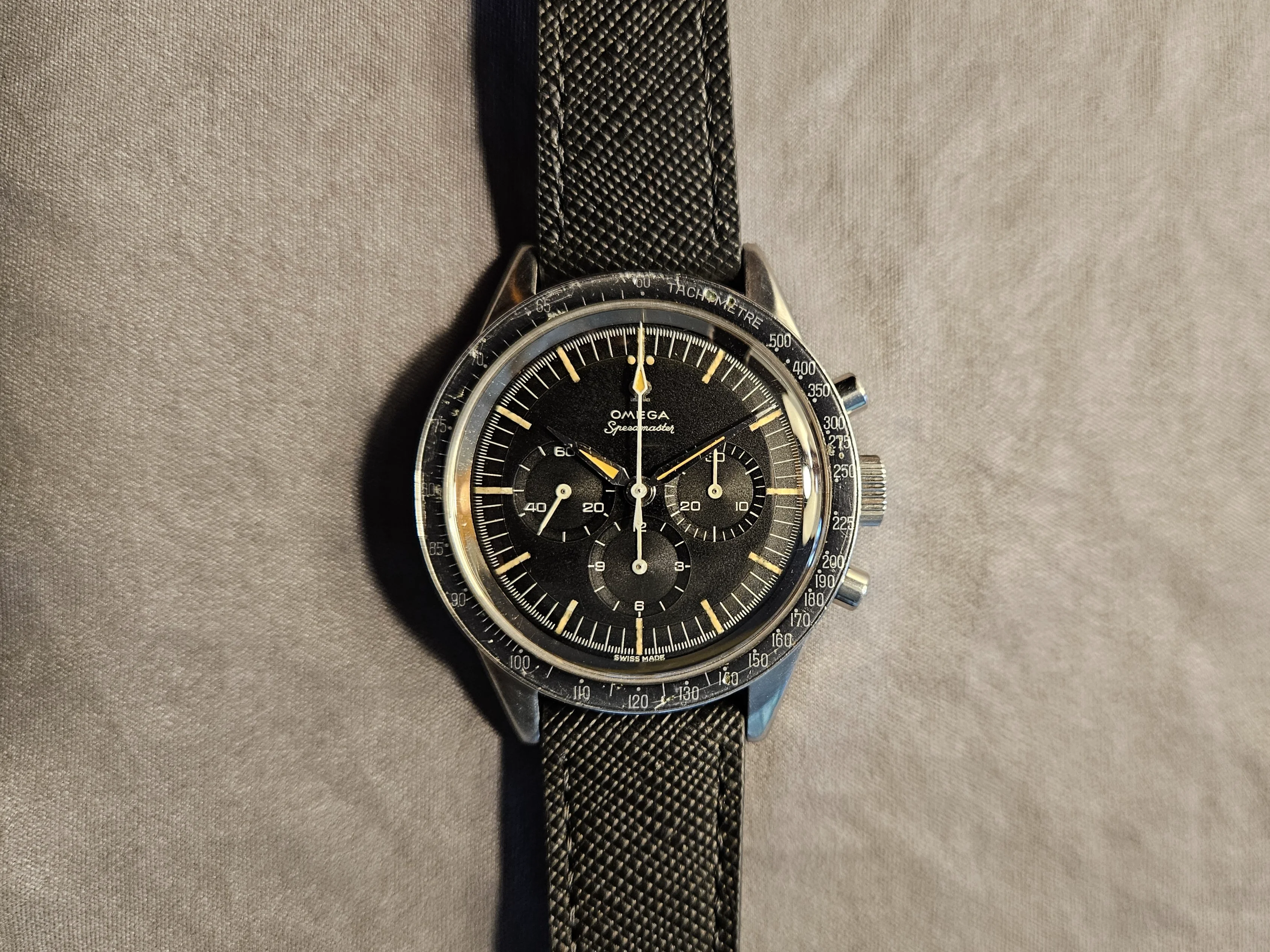

Here is how my watch came back from my watchmaker today. I had him adjust the paint on the hands because it was initially too dark. He removed the superluminova and then painted the modern CK2998 hands from the back.
What do you guys think? Wearable for now until I can source original Alpha hands? I also wanted to get a feel if I like the Alpha hands on my 105.002 or keep the tritium baton hands that I bought it with. It's a 19,xxx,xxx serial. I took pictures (still learning) under different lighting to see how the color matches the original lume on the dial.

I think it looks great.
27
95
I second that, I think it actually looks a lot better than I was expecting from your initial description!

Surprisingly the modern Alpha hands for the CK2998 has almost the exact same measurements as the old 2998 hands. The only exception is missing the transverse curve and lume differences But I guess from a wearability standpoint, it works. My prior debate on having the silver retention ring on the crystal has also been answered. Definetely yes, it changes the whole dial into the 2998 look.

I agree looks great. And reading MWO, the baton hands were only noted on the later examples on 20,52x.xxx serial range so the Alpha hands were correct for your watch. If you find original alpha hands great, but I wouldn't worry about it and wear as is - your watchmaker did good IMO
There is a nice one FS in Private Sale thread with lots of photos- this is a pretty rare reference worth a look

Very nice piece. If you don’t know, you’d need a very close look to see its hands have been worked on. The only thing that might give it away IRL would be the perfection of them. Compared to the rest of the watch, including the dial (which is attractive to me) is a bit more aged. It’s up to you to decide whether you’re happy with it as it currently is.

Thanks Aludic. Very true. My watchmaker felt conflicted trying to "mess" with the hands to show some scratches instead of the pristine polish of modern hands. Still looks very new compared to dial, which I love as well. As stated, it's a stop gap until I feel like I love the Alpha hands look and finally pony up the expense, or go back to baton hands. Though, I am very much leaning in one direction right now...lol.

Alpha hands always look great.
Who is your watchmaker? That's a very decent job on the lume.

My watchmaker is someone in Pasadena, CA. Lume is not his specialty, repair and service of vintage watches is. However, LAWW is also in Pasadena and they did an amazing job on another watch of mine
