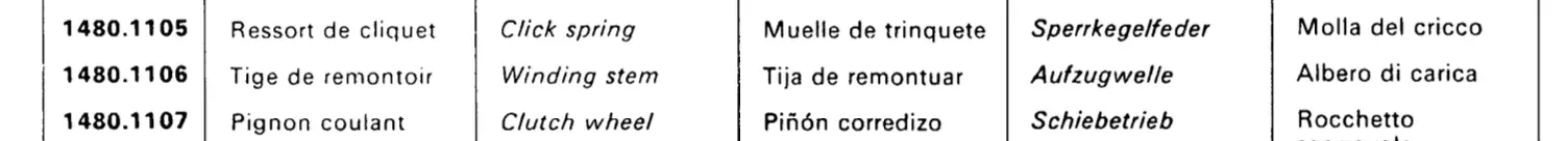

Quick question, is the stem for 1480 movement the same as 1481? Thanks in advance.
18,128
37,833
Yes. Part number 1480/1106.
29,863
77,273
Omega lists the 1481 and 1480 stem as 72214811106, so 1481/1106.
110
54
Thank you Archer.
18,128
37,833
My info came from a 1972 parts catalog where the stem is the same for both. The Extranet has the latest info.
If you're searching on the open market, then either part number should throw up a result.
