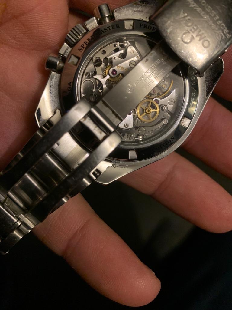

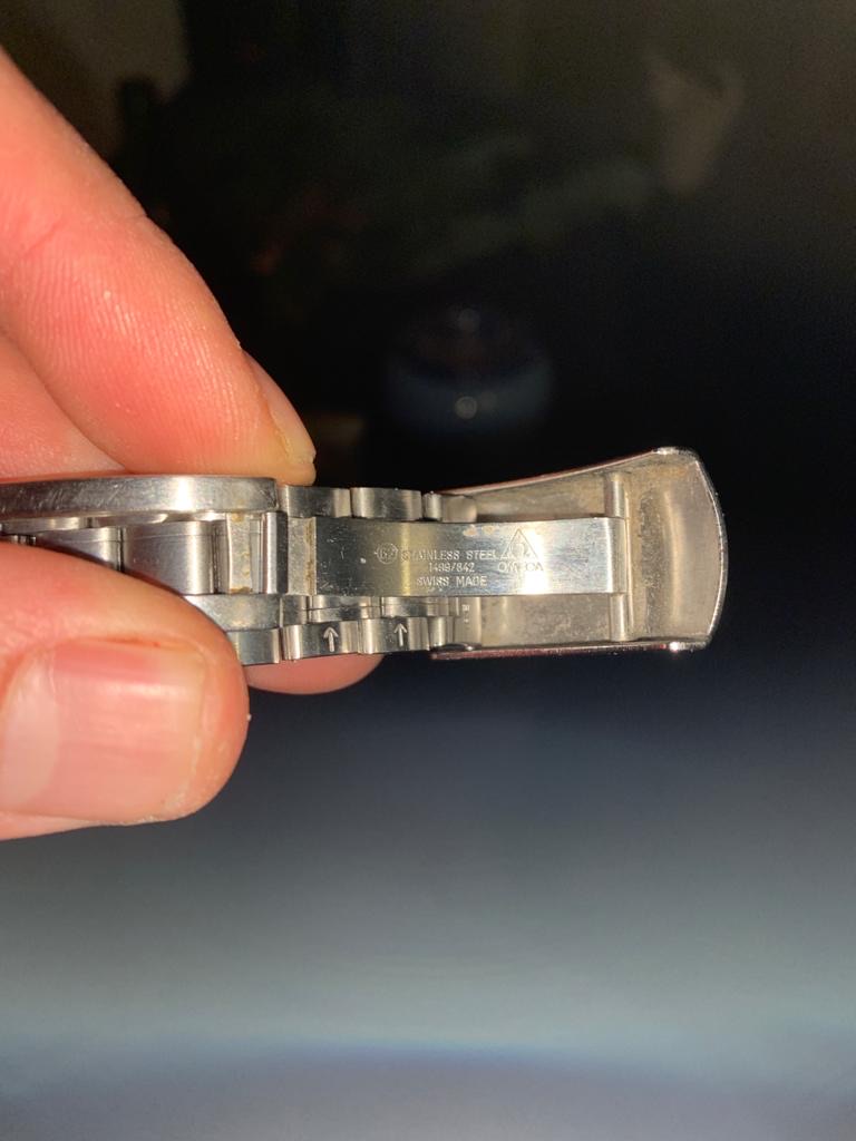

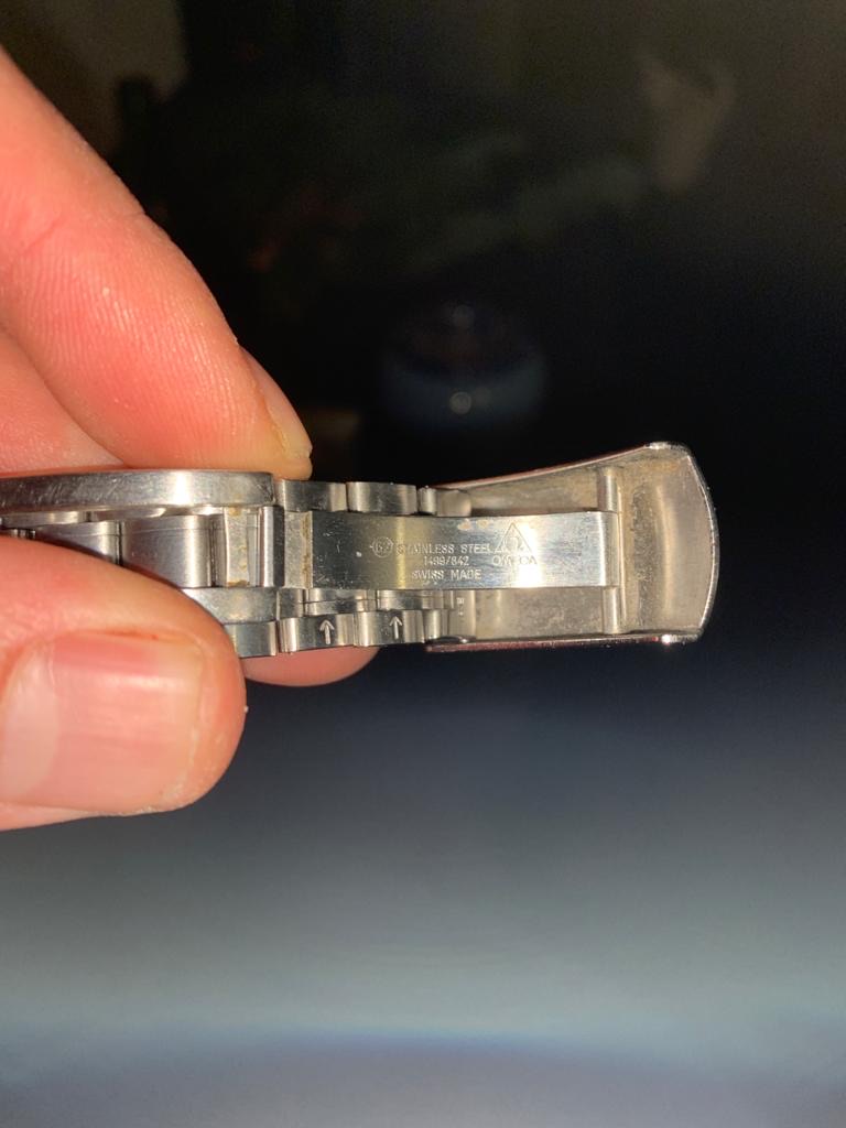

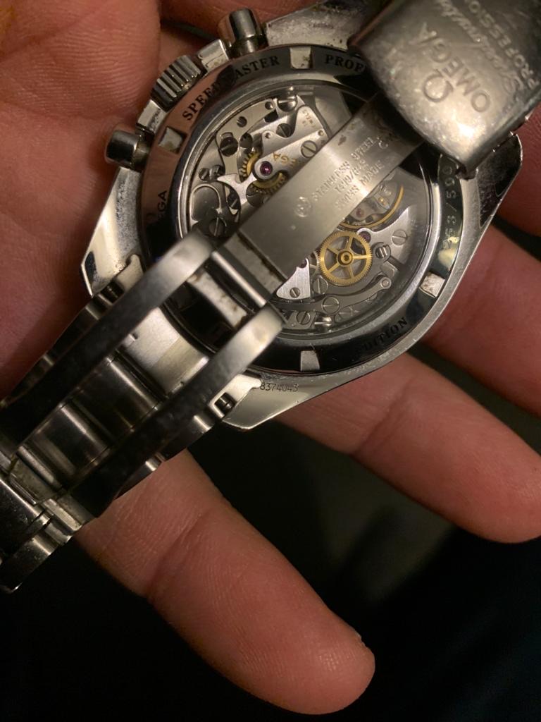

Hey,
I am making enquiries about a watch I can barely afford, and I'd like to authenticate it before I break my heart over the price. It is purportedly a ST 345.0818 - Italian Albino Speedmaster. The watch has a movement/serial number of 48374043. Below are some pics that I have of an extract and the watch and bracelet. Does anything look off to anybody? I don't suppose someone with access to the Omega Extranet can check the serial to see if it checks out as an Italian Ablino?

I think if you are considering to give that much money ,the seller should be nice enough to take some proper clear photos from every angle plus removing the bracelet and snapping one on that movement .

Don't have extranet access but I have seen another Albino with serial and LE numbers each about 10 off from yours.
Agree about the seller doing poor quality and insufficient photos for you to gauge the condition. Does this one come with LE certificate, black box, card, etc.?

I hear you - I won't be doing the deal on these pictures alone. For now I am wondering if anything can be made of the serial number before I go further.

Since that certificate specifies the movement number, I would suspect that it is as it purports to be (assuming of course that it is not a very clever fake).
The condition looks to be less than it could be. You should figure in the cost of a service, at minimum. Surely a good cleaning.

When you say "each about ten off", you mean they're +/- 10 off the serial number? This would indicate the serial is good, right?
Both the serial numbers and the 3 digit LE numbers, yours being 253, if I’m reading your caseback correctly, within 10 or 11.
