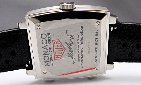

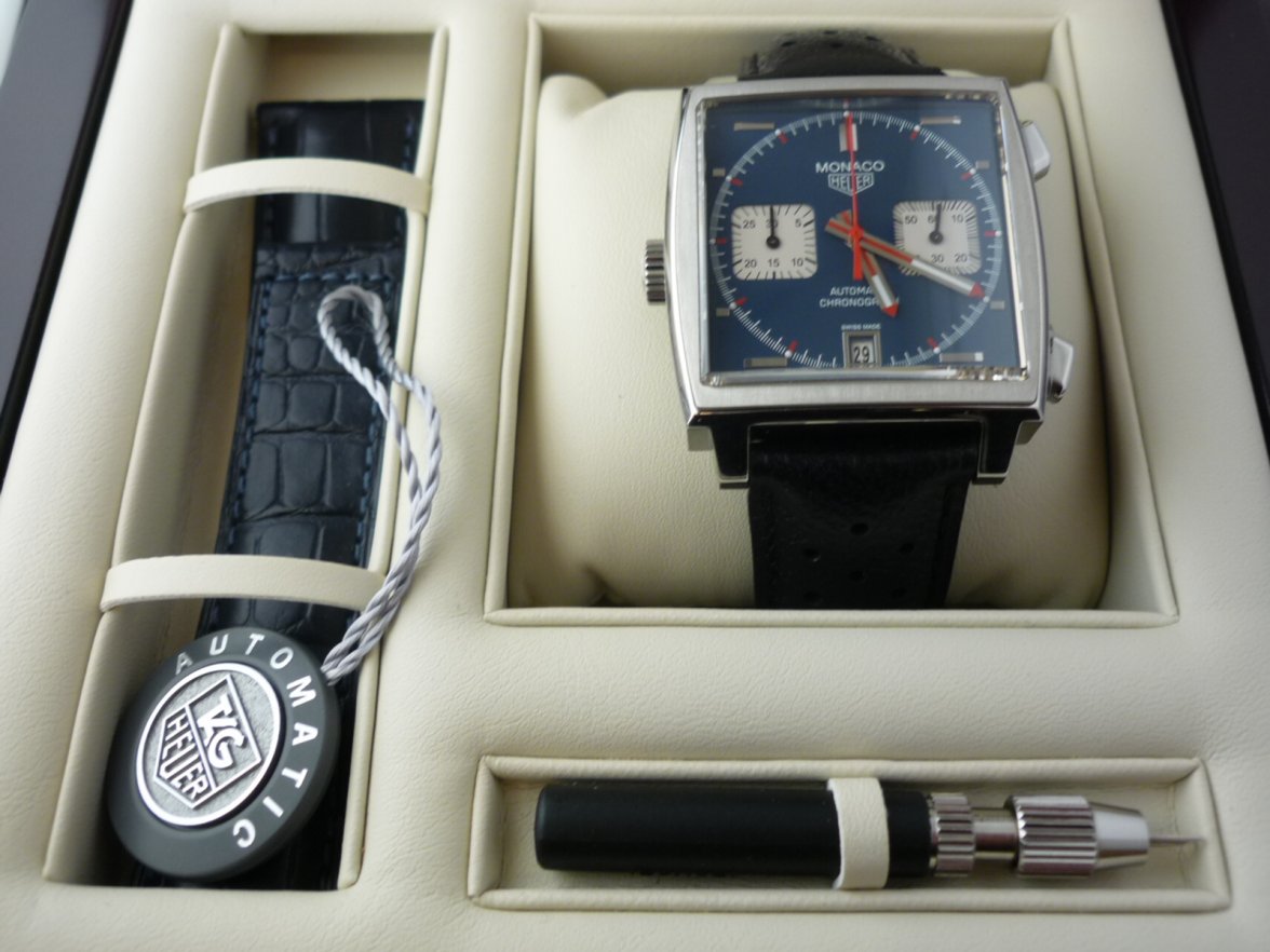

The (TAG) Heuer Monaco CAW211A 40th Anniversary special edition came with 2 straps that had those spring bars on them... and a spring bar tool in the box, too... Seems like a good idea if you're swapping the straps regularly and don't want to risk scratching the inside of the lugs with the spring bar tool...

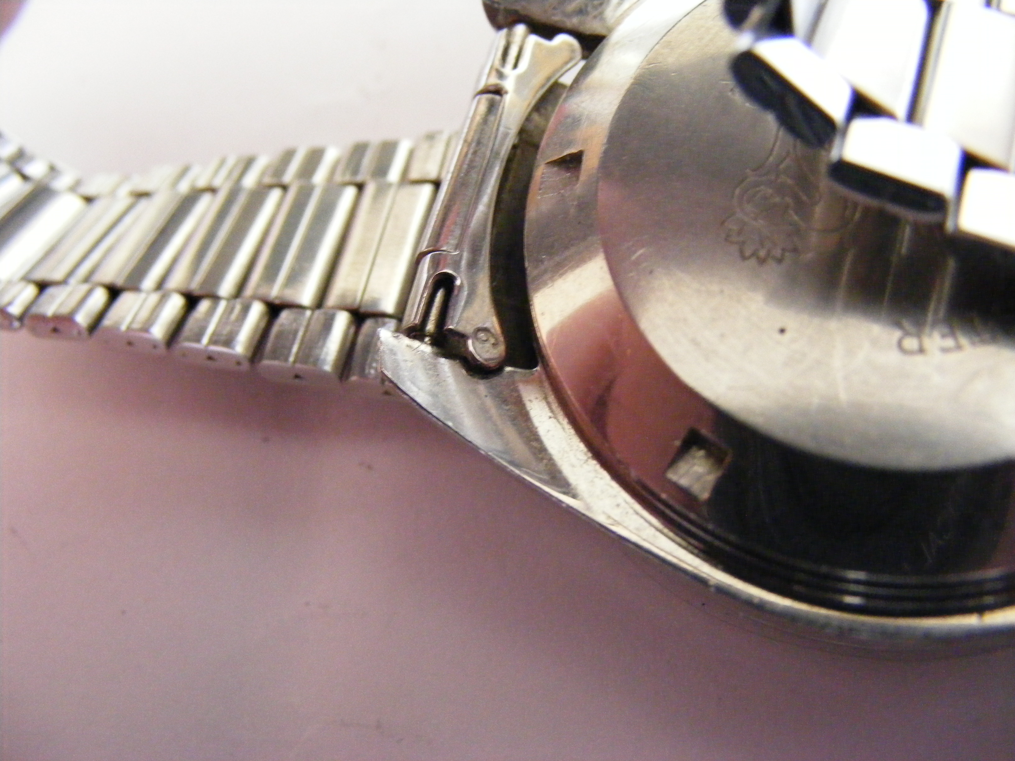

i have one like that on an old omega constellation watch i sold

Old thread I know but a subject I have been investigating. As @Archer says above these lever spring bars were OE fit by Omega in the 60's. Perhaps that's what the elongated channel is for in the no 6 end links. For authenticity these bars should be £500 each!!
