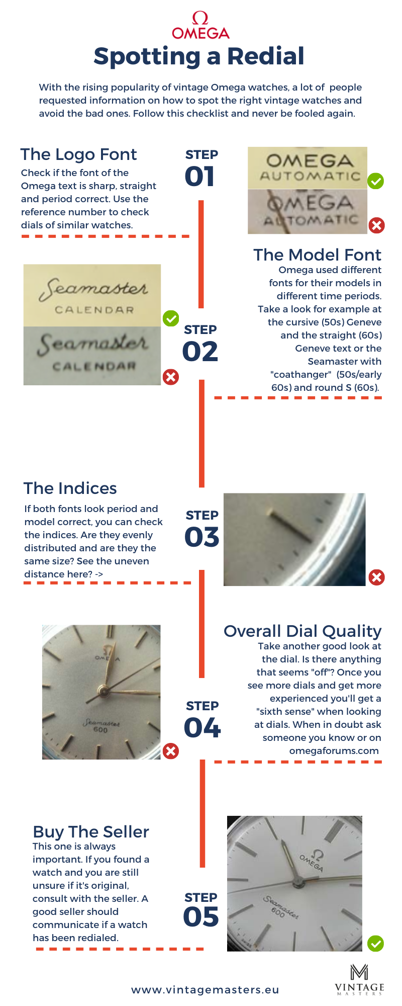

Hi guys,
After a rising amount of requests lately on how to identify redials I made a short infographic with the basic steps for novice omega enthusiasts.
I might post a more extensive article shortly with other important points (mainly a LOT of image examples but also an overview with handy links and documents (there simply didn't fit much)).
The guide by @ConElPueblo (https://omegaforums.net/threads/learn-how-to-fish.52603/), shows extensive information on the case, lume and patina so I won't go into detail on those things.
The infographic below is mainly intended for the beginner, but can also be important for the more experienced collectors as the sharpness sometimes decreases when you see a lot of watches 😉
Got a downloadable pdf version available as well if this image is badly visible. Just send me a PM with your email address to receive it.
Enjoy your day!
Stan

I would add about the concentric circles of the subdials of chronographs. Usually they are the easiest way to spot a touched dial as they either don't exist or are very uneven on a redial. 😉

Great addition!

Don't lose sight of the broader point: Is the dial consistent with the condition of the case and movement? Even a well-executed redial can be more easily discerned if it is much cleaner than the case and/or movement.

Couldn’t agree more. And I’ll add that the bit about developing a “sixth sense” in Step 4 is beyond critical. Spend enough time familiarizing yourself with examples you like, and it’ll come. Great post OP!

Good point!
