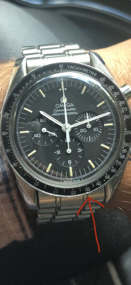

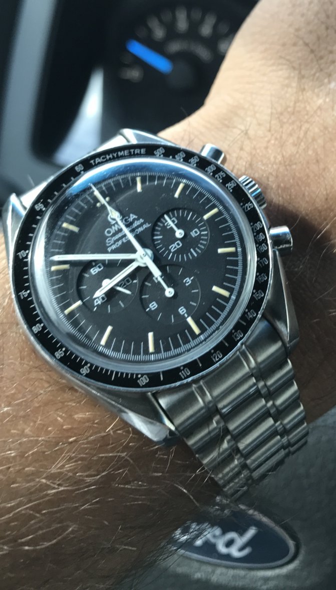

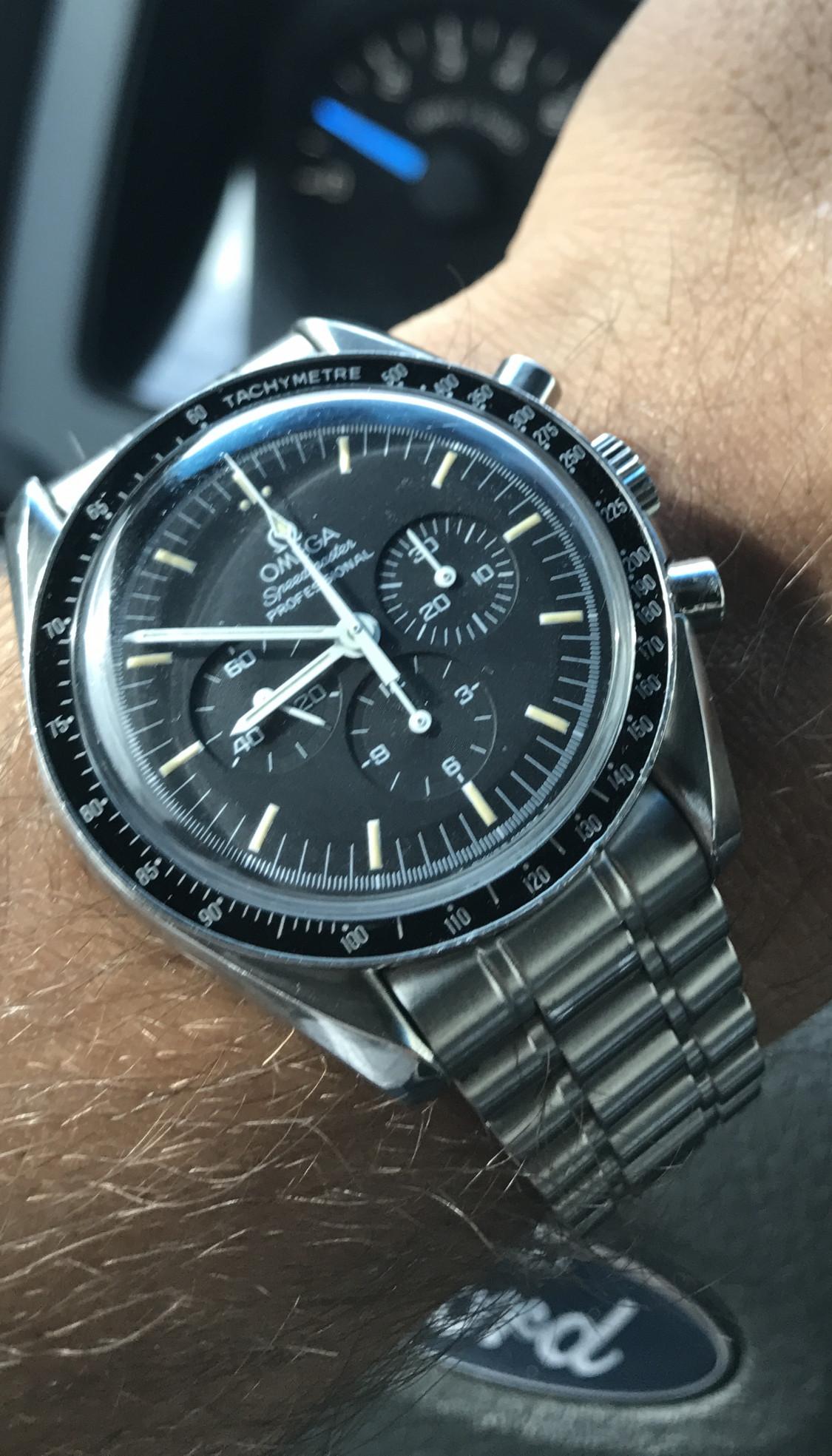

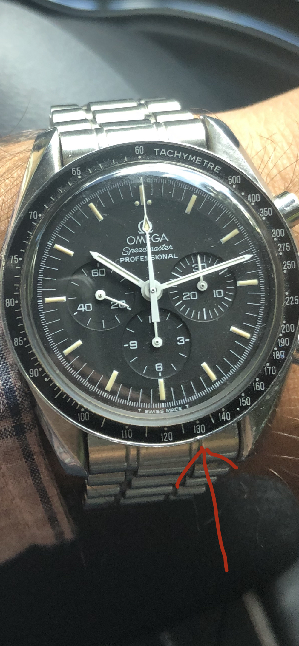

I drew an arrow pointing to the ding in question right under the 130 mark. Also, to clarify this was never something I was looking to fix prior to them bringing it up.

Personally I’d leave as it is, the damage is so minor. New case will probably include case back, and this will bring the value of the watch down. Omega don’t care about your watch, they’re just trying to get more money. Originality is very important, ding’s and all. It’s a nice Speedy that is ageing well.

The service will get the innards back to original working order 👍 - I’d leave the rest as it’s a good looking Speedy and the ding gives it its own story.

There is nothing wrong with your watch cosmetically apart from a very small dent on the bezel.
Do yourself a favour and have an independent watchmaker service it at half the cost Omega are quoting.
You don't need a new case with it's modern bezel which doesn't match your Tritium dial.

I would be inclined to keep it all original. It's a nice tritium-era watch, and I wouldn't be surprised if it becomes collectible within your lifetime.
