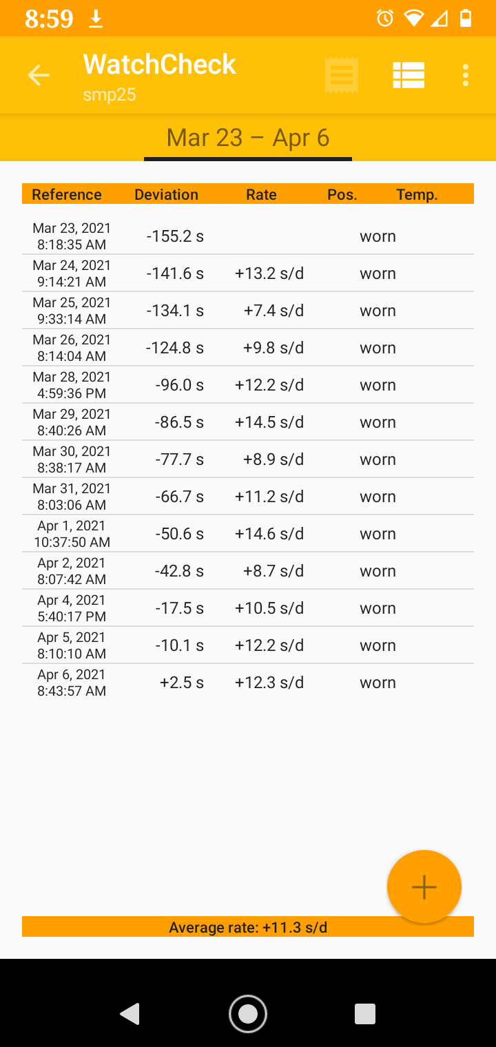

To regulate or not? My 2 year old daily wearer Speedmaster Pro has always run on average about 12 seconds fast. The problem is, there is no "slow" position for me. I took it to a local watch maker and he timed it for me. It was btw 9 and 12 seconds fast in all positions except, crown up was +20.
A few questions:
If it always runs fast in all position, is it a good candidate to regulate?
I heard if the case is opened it voids the warranty. Is that true?
Does Omega do any adjusting to try and get them more accurate when they leave the factory, or is it just time it when it comes off the line, and if it is in spec don't touch it?
Can you get it regulated at the Boutique and still have the warranty?
If not, can you ask to have it regulated during a service?
I can live with it the way it is, but if there is a way to get it more accurate, why not?
Thanks for your responses. I value and appreciate the knowledge available on the forum.

The issue with mine is that it's fast in every position. And consistently so. btw 10-12. It doesn't have a slow one.
